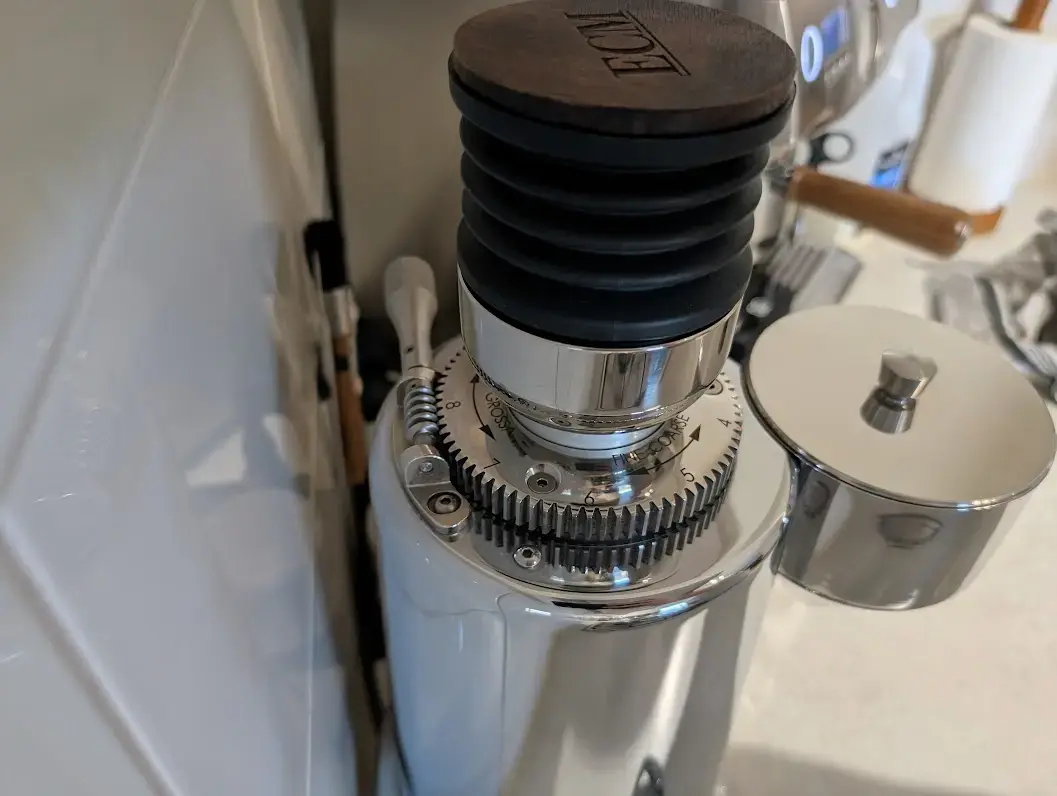

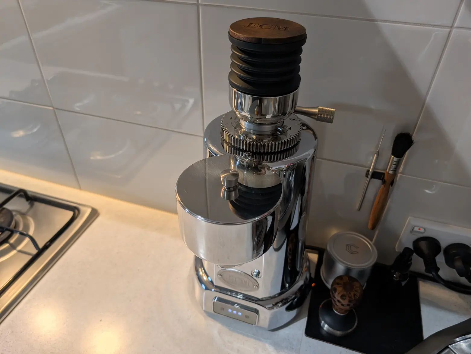

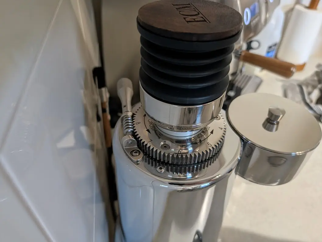

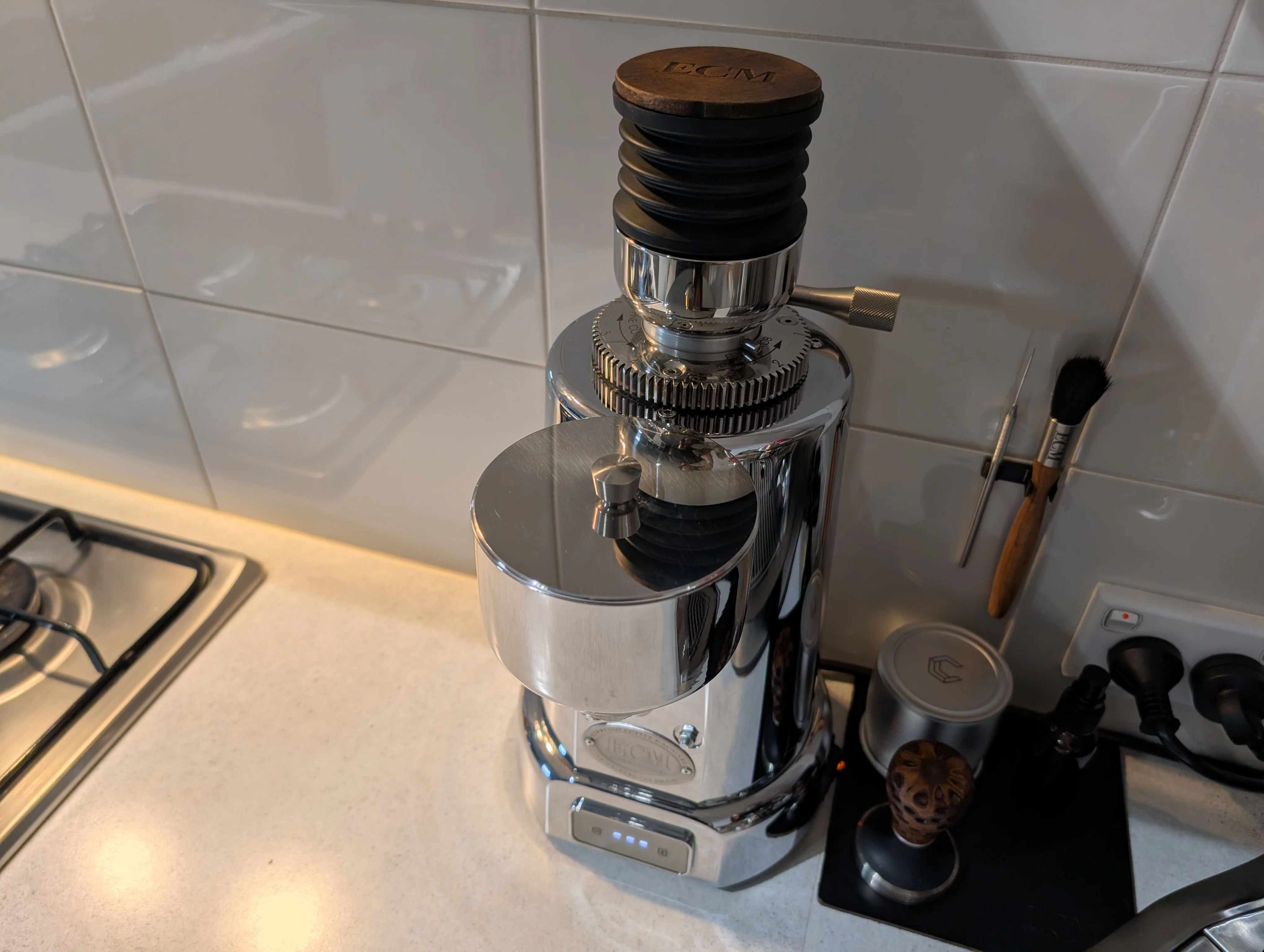

Unrelated, I can't remember if I mentioned in this thread but for years I've been running a custom modified ECM V-Titan 64 with some 3D printed parts I designed to convert it to a single doser. A few years after I designed mine, ECM released their own kit but I wasn't impressed by it, mine was better. Some time recently, a random Chinese company has done their own polished stainless version and it looks much better aesthetically than my silver plastic but supports my bellows and internal parts, so I've switched the cup holding the bellows over. It looks much nicer now. The laser etched wood lid I had someone on Etsy do for me.
This grinder is a massive titanium flat burr one, but in stock form it's meant for cafe volumes so it has horrific grind retention. Mine has <0.1g retention usually, though you do need to knock the side of the dosing chamber to drop any grinds clinging to the walls. Really it would work better without that but I love the old school look, this is my end game grinder.

I have the Fellow Ode grinder which works well enough, but this looks incredible.
Thanks! I love it. It took a lot of trial and error to turn it into a competent single doser, but I persisted because I think the design is gorgeous, best looking grinder on the market in my opinion. And it's a very robust design, it'll probably outlast me. I'd love to pair it with an ECM Synchronika one day, but I'm currently building a house so that's still a while away. 😜
