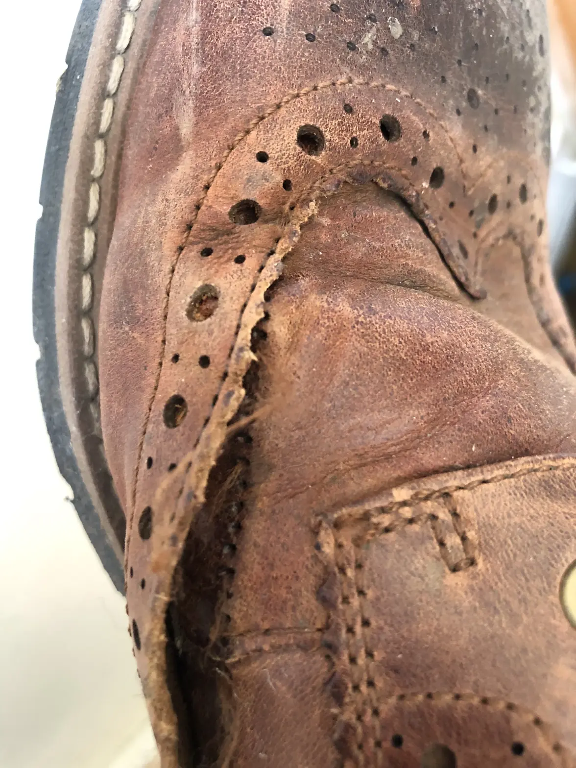

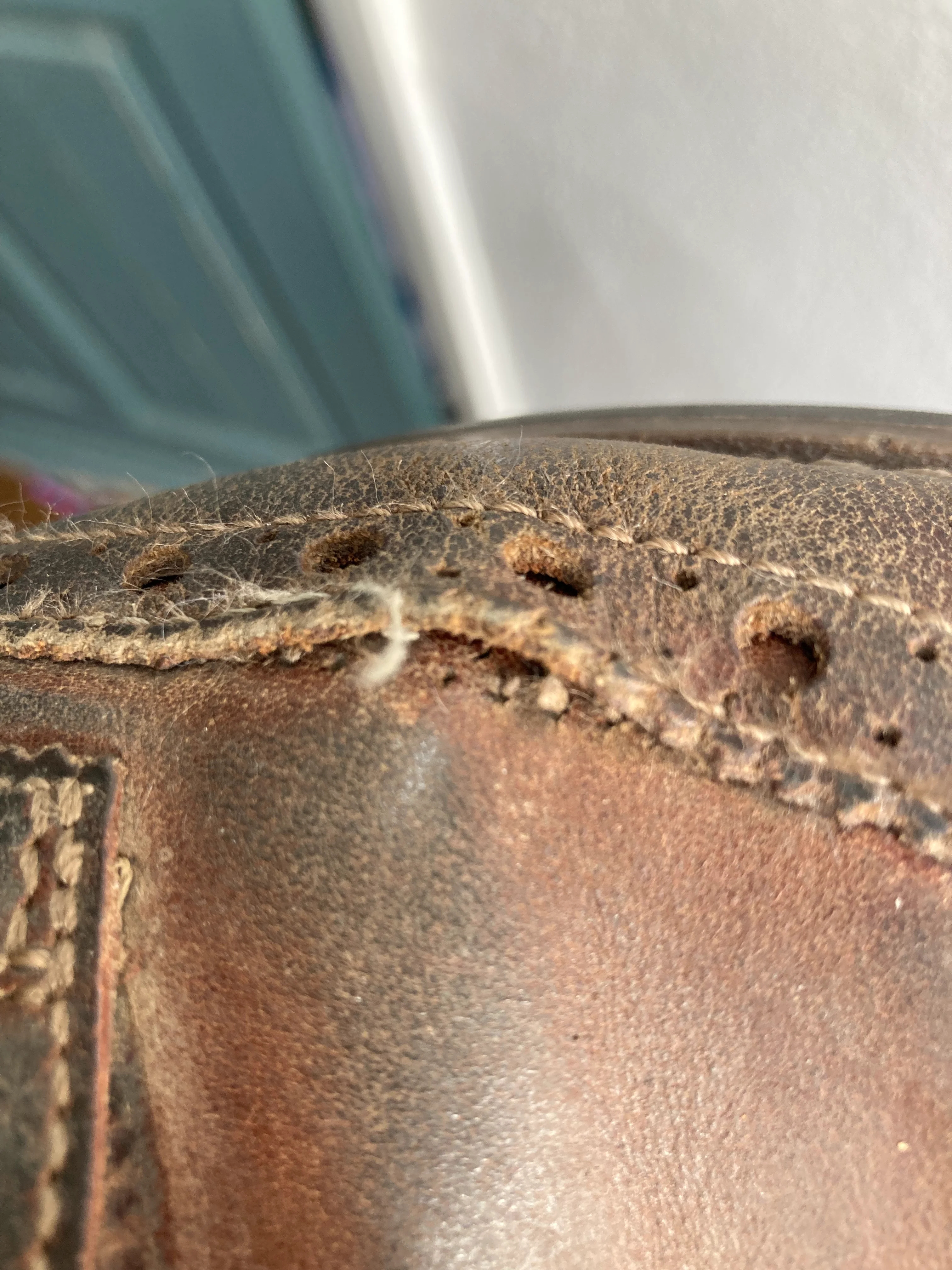

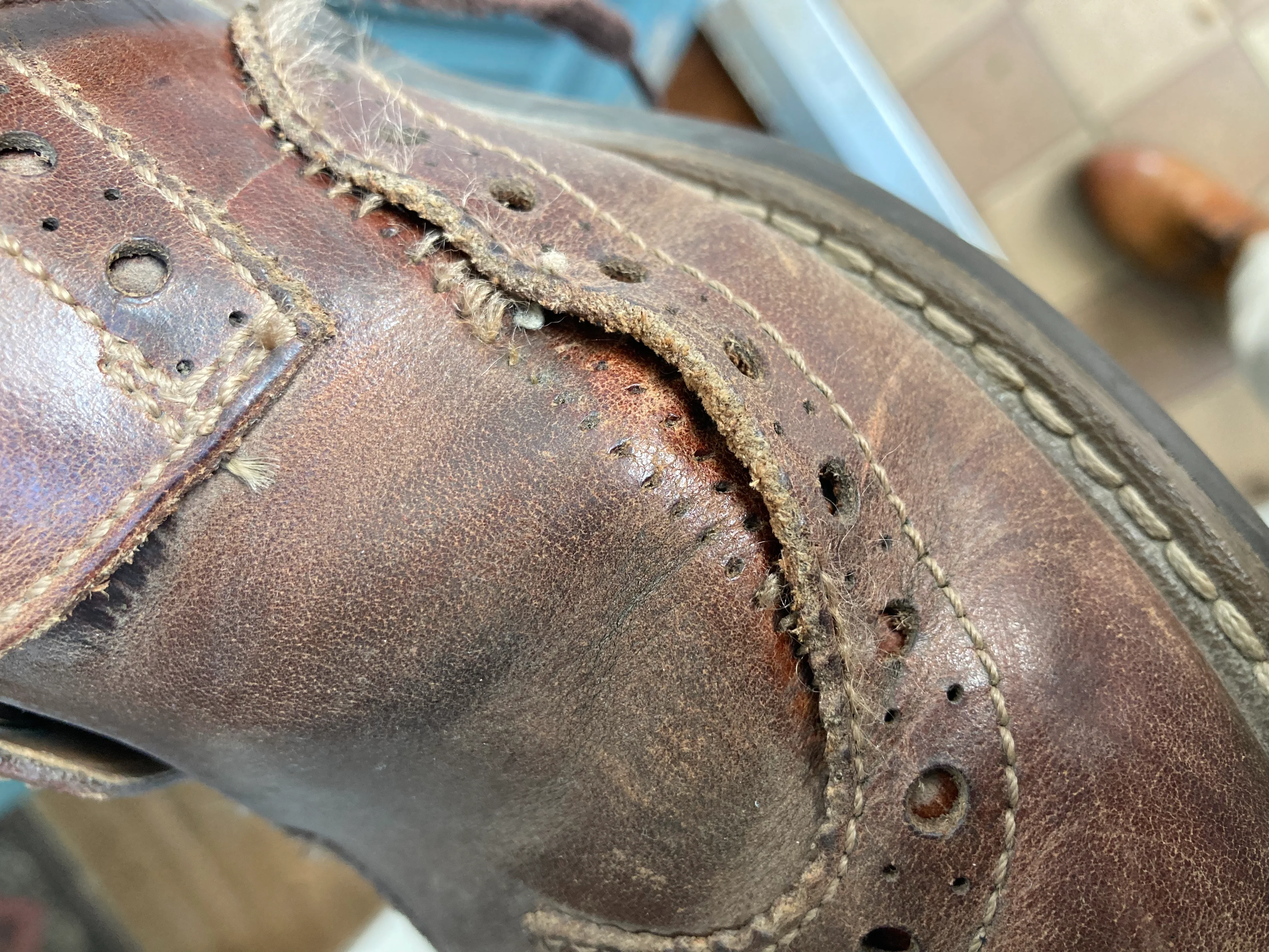

I have a comfy pair of Clarkes brogues with plenty of life left in them but are a bit loose at the seams.
I took them to my local Timken's, UK members will be familiar with the high street key cutting, shoe repair and miscellaneous bodgers
The chap used a sewing machine to stitch a new seam. Worked great but lasted only about 6 months, before letting go
I don't think another machine seam is a good idea as the leather will end up too punctured so I'm thinking of hand stitching them.
Any advice as to what stitch & hand tools I should use?

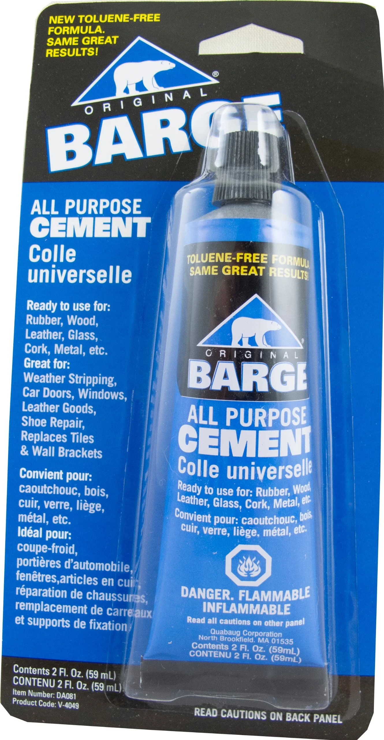

A shoe repair shop will result in a perfect job. The closer you are to the toes, the more challenging it will be for you to hand stitch.
But since you feel adventurous.
Get barge cement. Small tube…

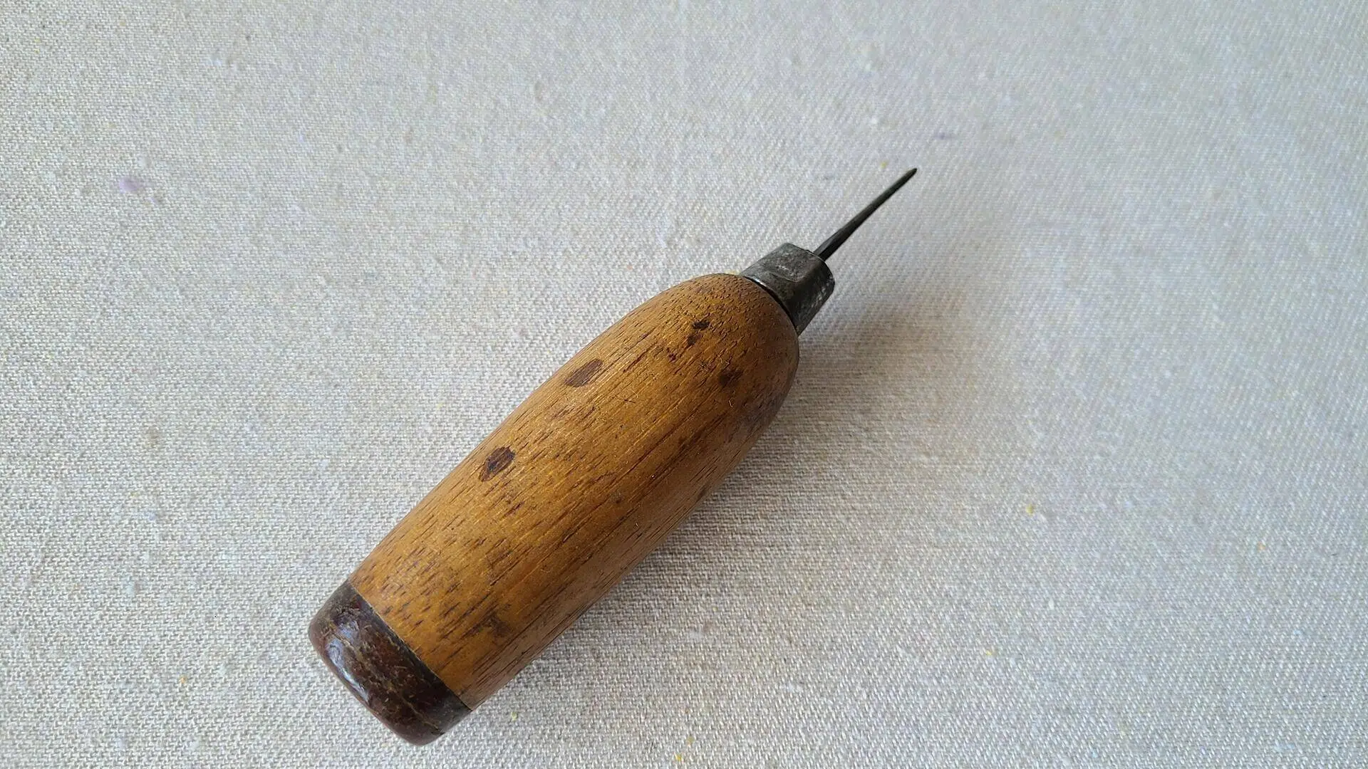

Get an awl…
Get Coats Extra
Strong nylon thread (brown spool).
Use your awl to rough up the pieces that you will join together.
With a toothpick, apply the Barge cement to both pieces.
Let the cement breathe for a minute or two, then press both pieces together.
Once set (see drying/curing time on tube), stitch.

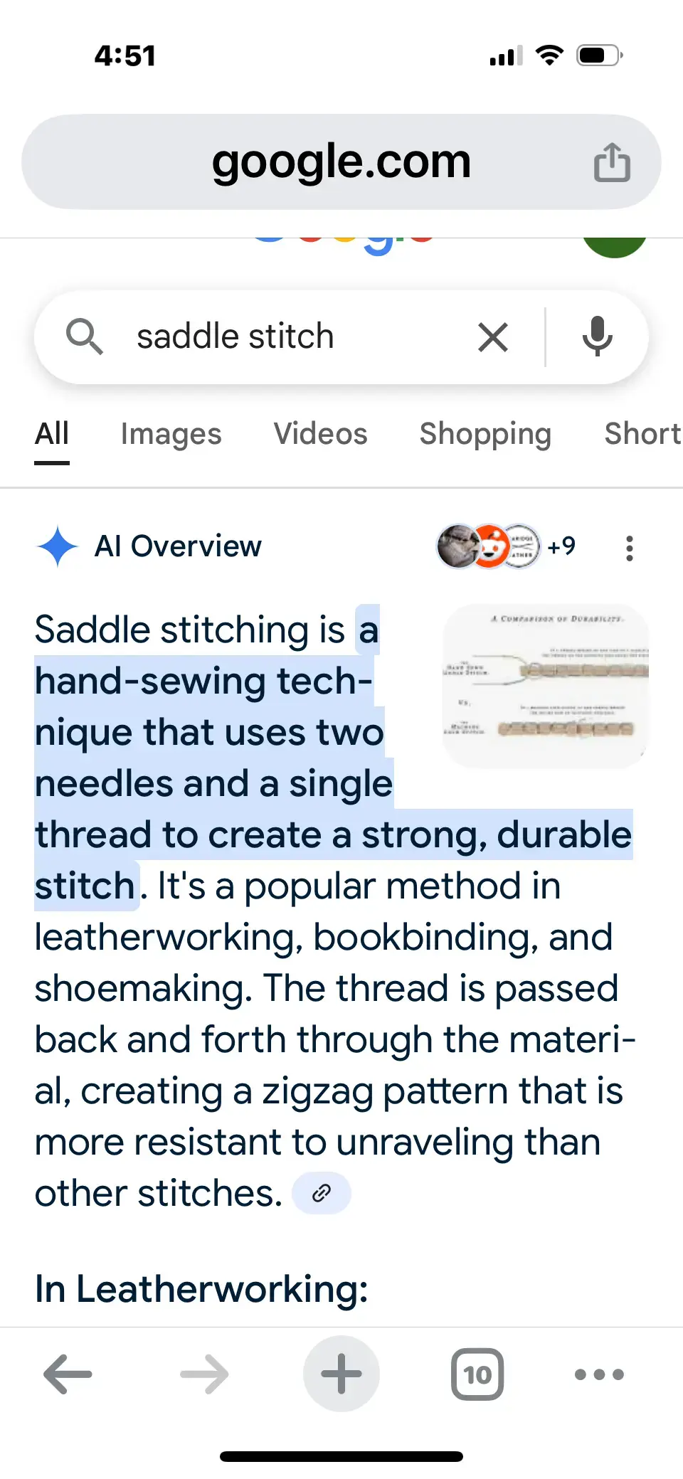

Look up saddle stitch… you will need two needles. There are several videos for your reference.
Use your awl to perforate the existing stitch holes.
Apply shoe polish, put on a nice watch, some decent clothes, and enjoy the repaired shoe!

Time to search saddle stitch on YouTube

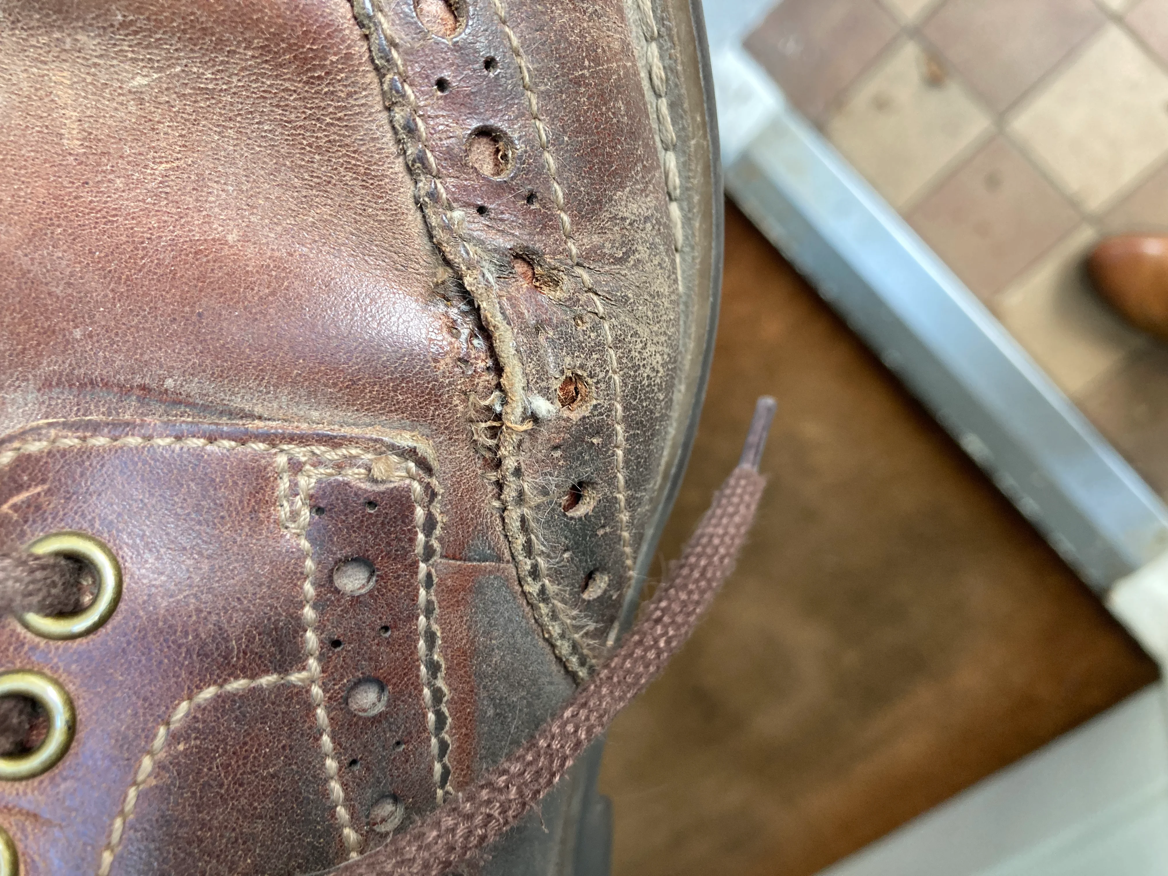

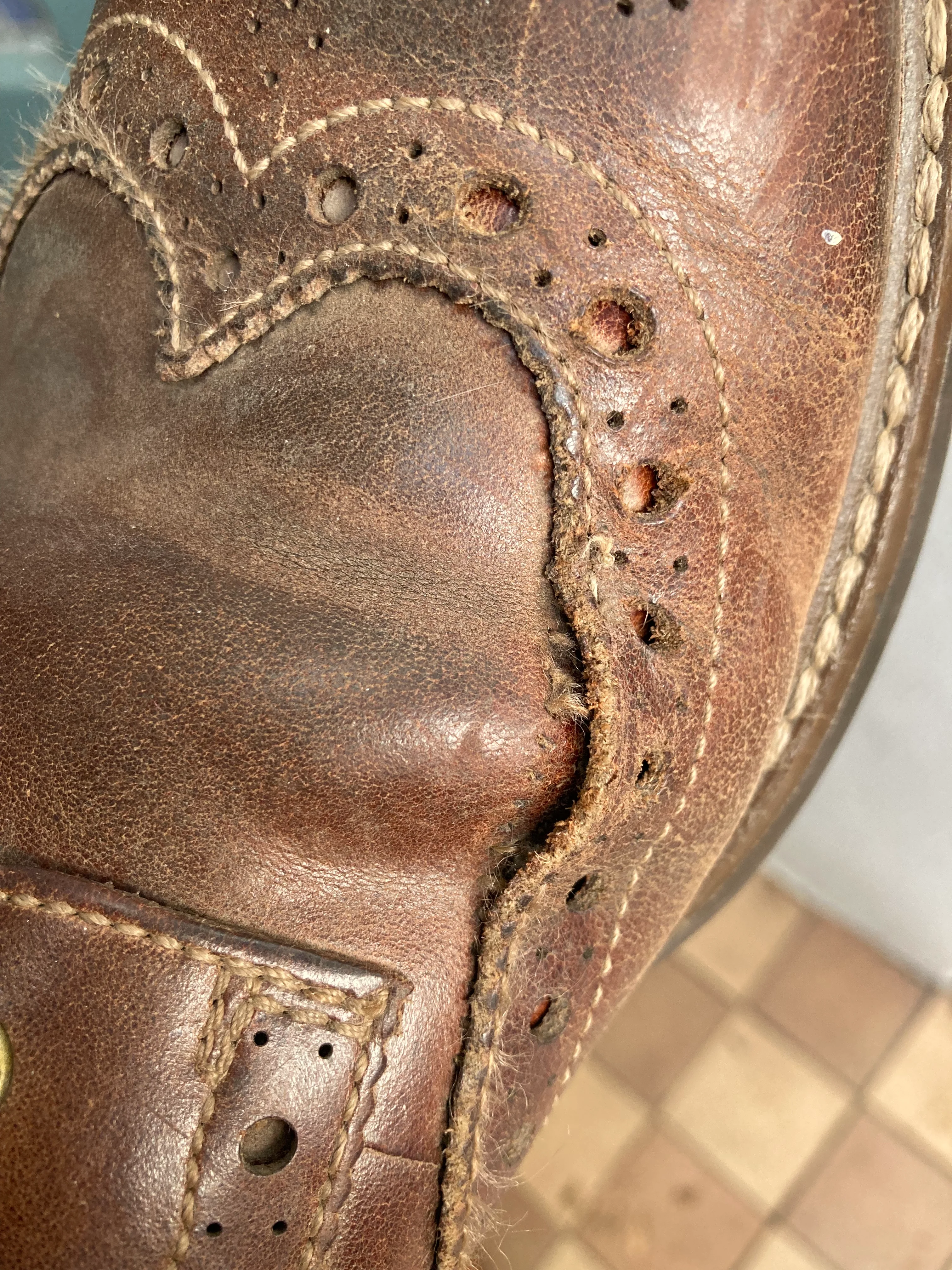

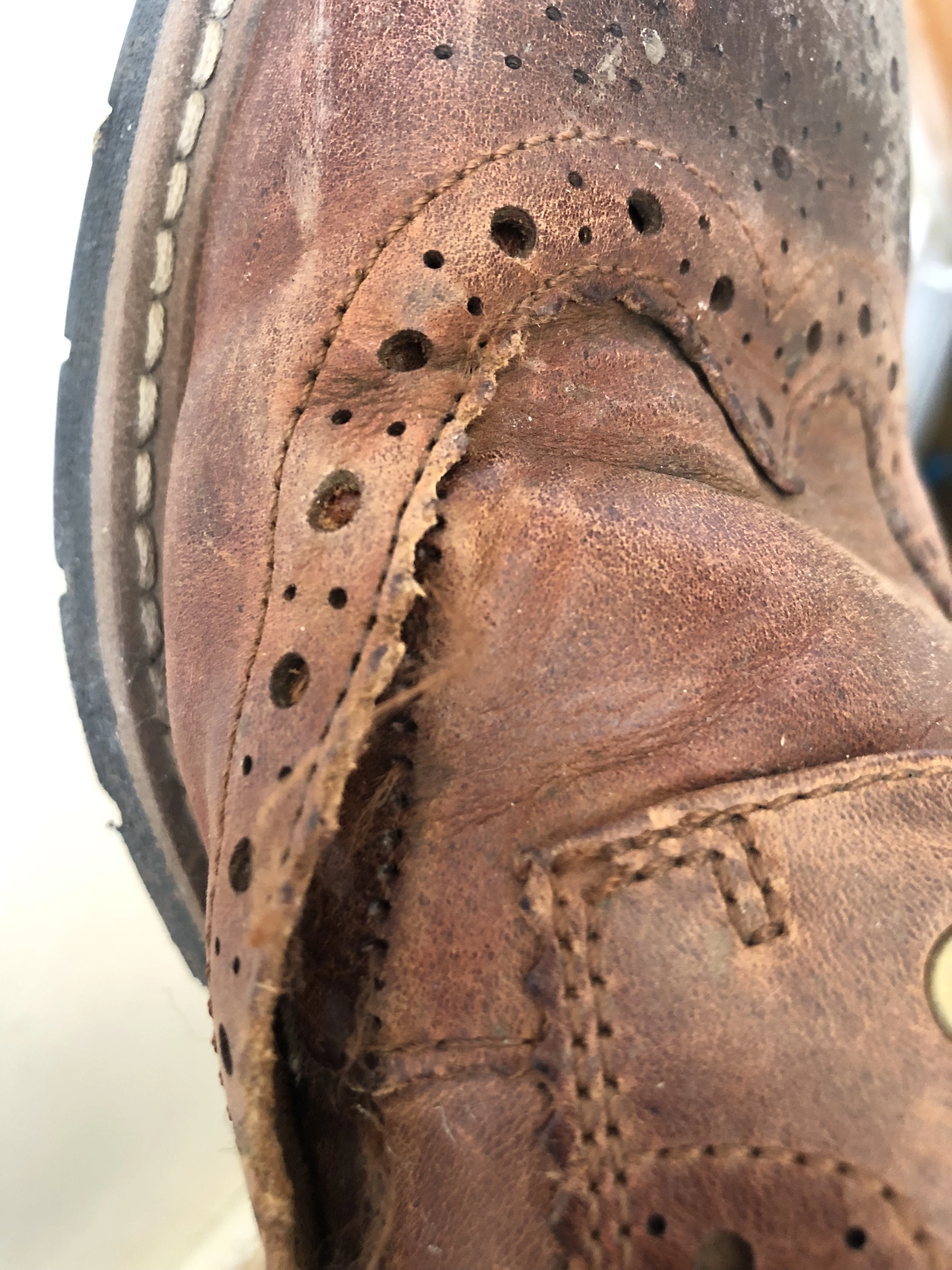

I have the same boot with the same issue.
We should start a support group. If you have any success would you have a go at mine, too? 😉

Same shoes, same problem. Hmm. Perhaps a class action is in order.
