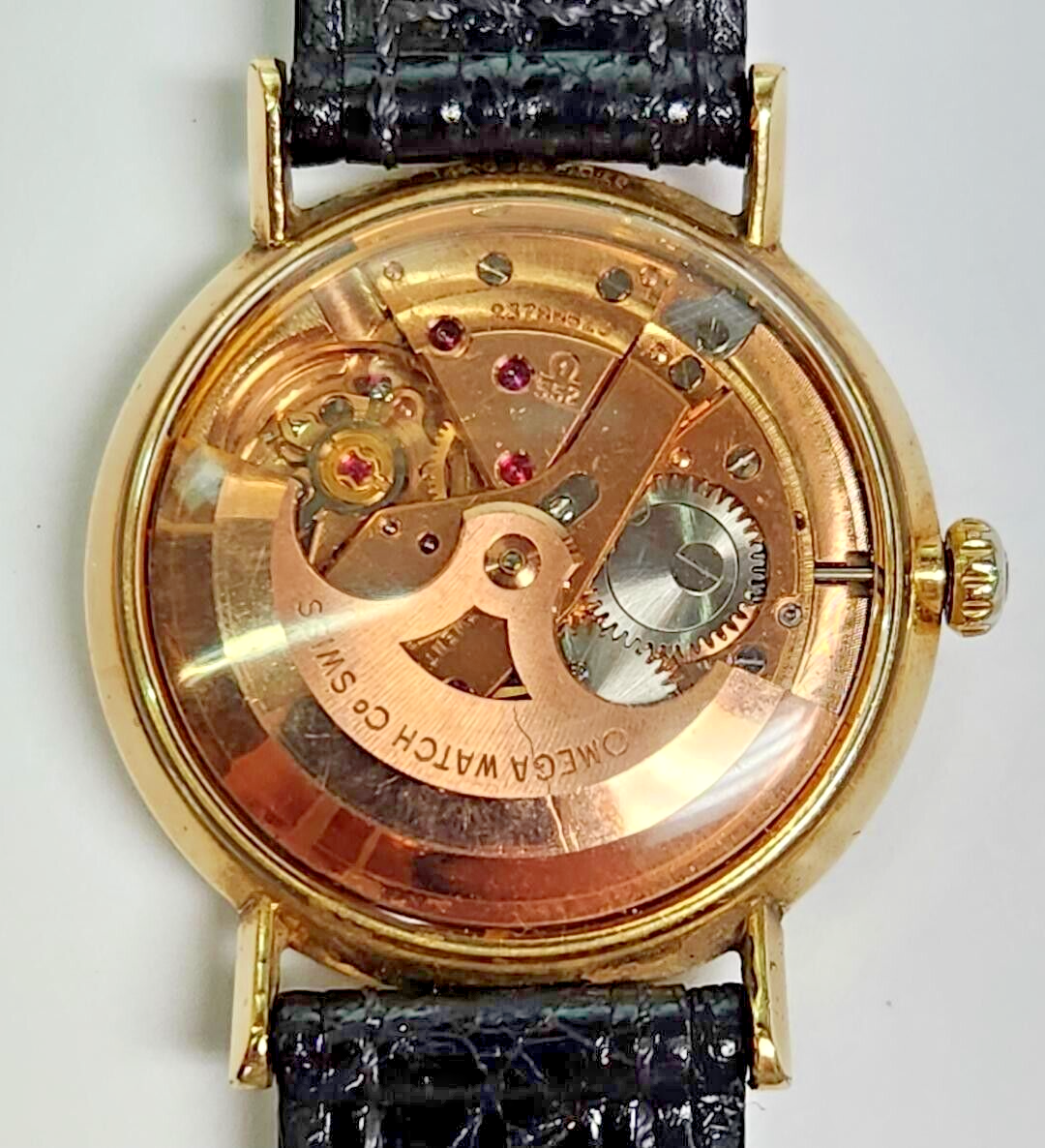

Posts 365 Likes 1,673 Rogerg ·May 19, 2023 Has anyone seen or heard of a clear plastic caseback like the one shown in the picture below? My daughter's fiancé is considering it but I don't know if it's practical to wear or if it could be a "salesman sample" as advertized?
Posts 35,766 Likes 40,045 dsio ·May 19, 2023·Ash @ ΩF Yea its called a De Ville Kleerback, article about them from last year here: https://stories.omegaforums.net/seamaster-deville-kleerback-kl-6292-vb/
Posts 365 Likes 1,673 Rogerg ·May 19, 2023 PlainVanilla The movement is wrong, should be cal. 560. I noticed that. I'm advising against the purchase at the price asked.
