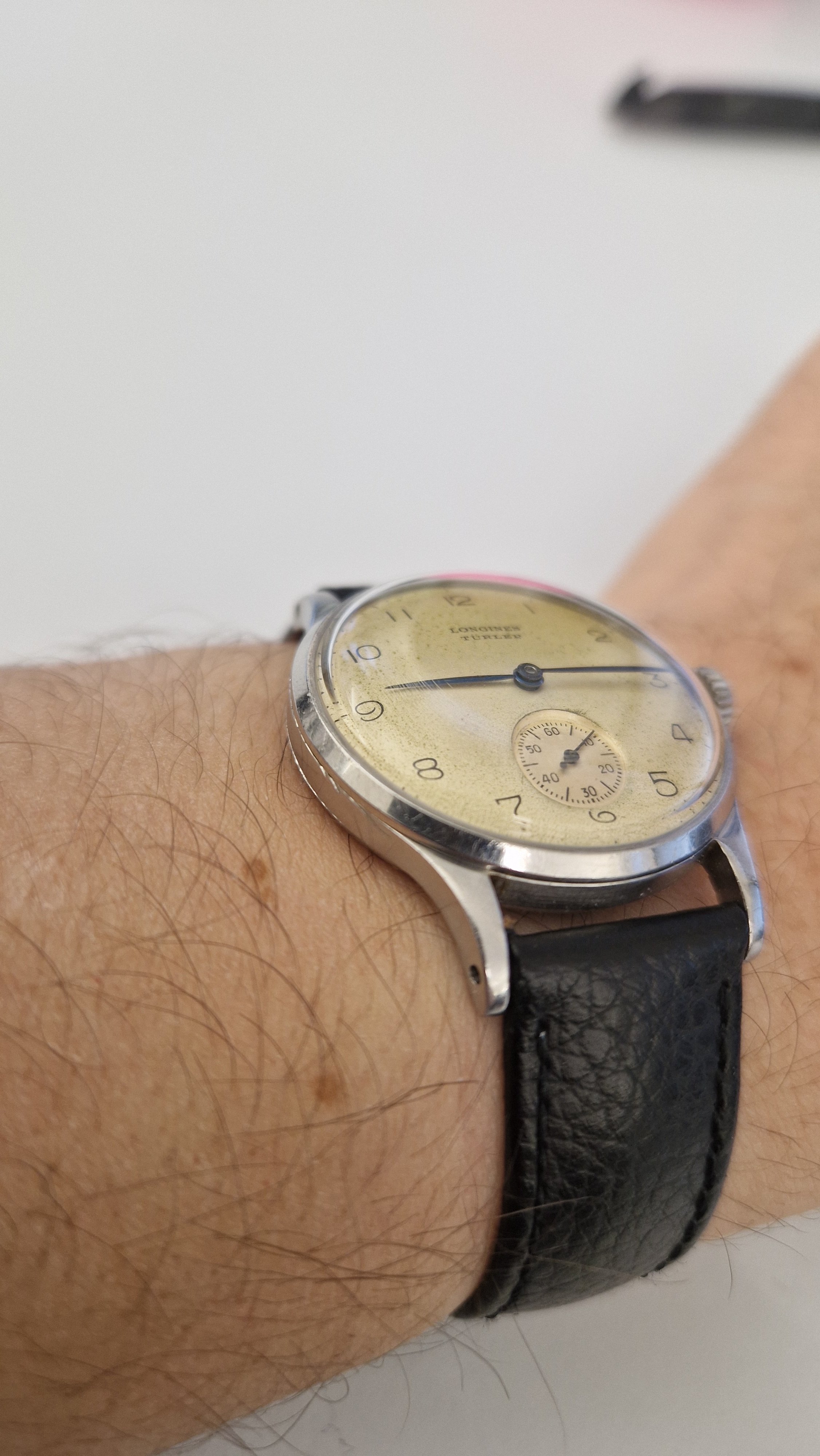

Hello everybody.
Yesterday i tightened a canon pinion and also cleaned the case.
After cleaning the case (including the crystal) in lighter fluid and rinsing it case in isopropylalcohol i noticed fine concentric hairlines in the crystal, that are so fine making it impossible to photograph.
Have i damaged the crystal this way or were they there before and i haven't noticed them because they are so small?
Thank you for your attention.
Have a nice day!
Lukas

You can see the hairlines over the hour hand.

The IPA may have made the crazing more visible if it seeped in and increased the refractive index contrast. But ultimately only you can tell us if the crazing was present previously. We don't know.
