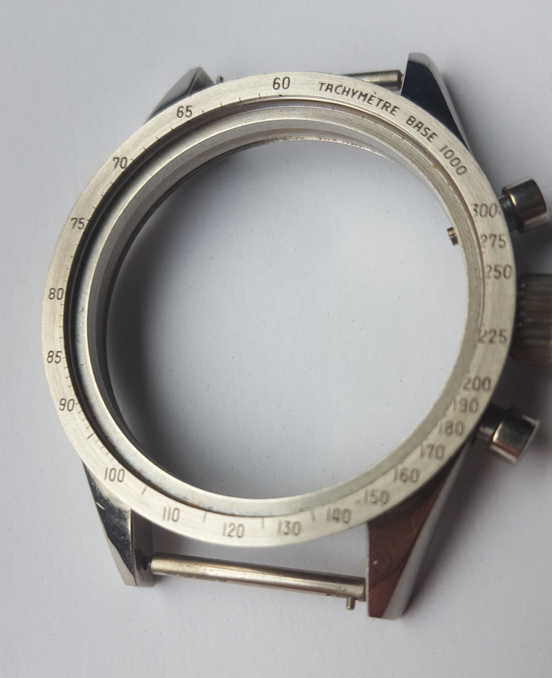

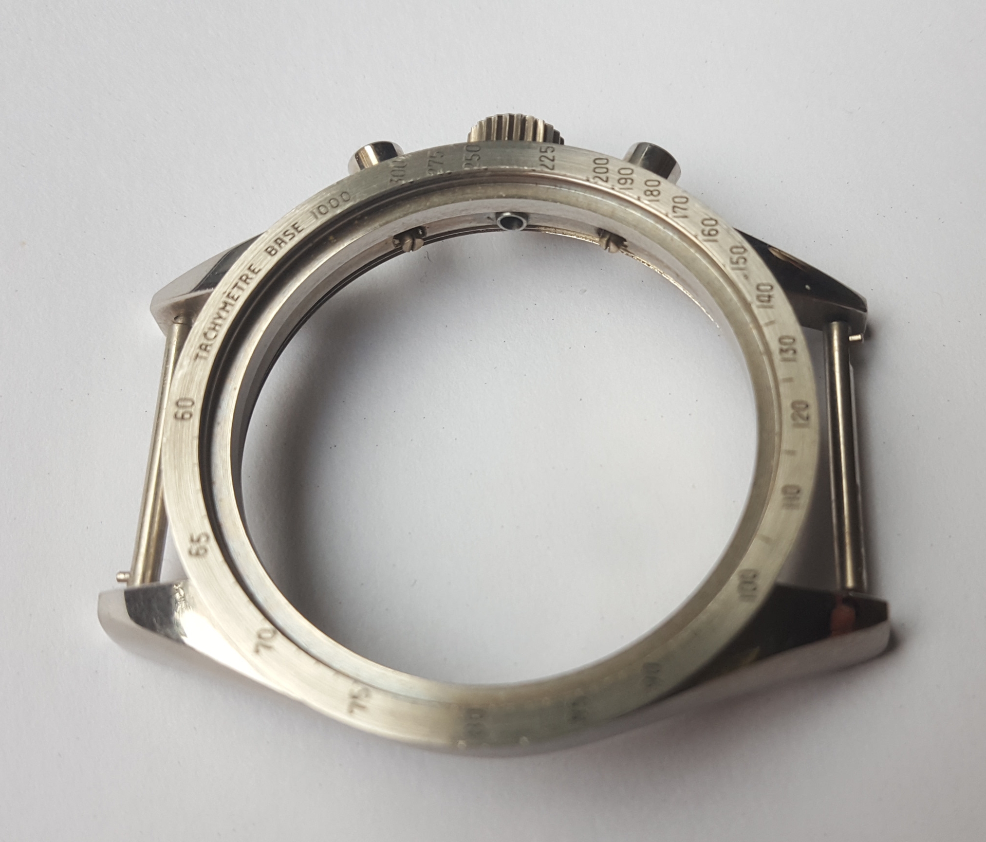

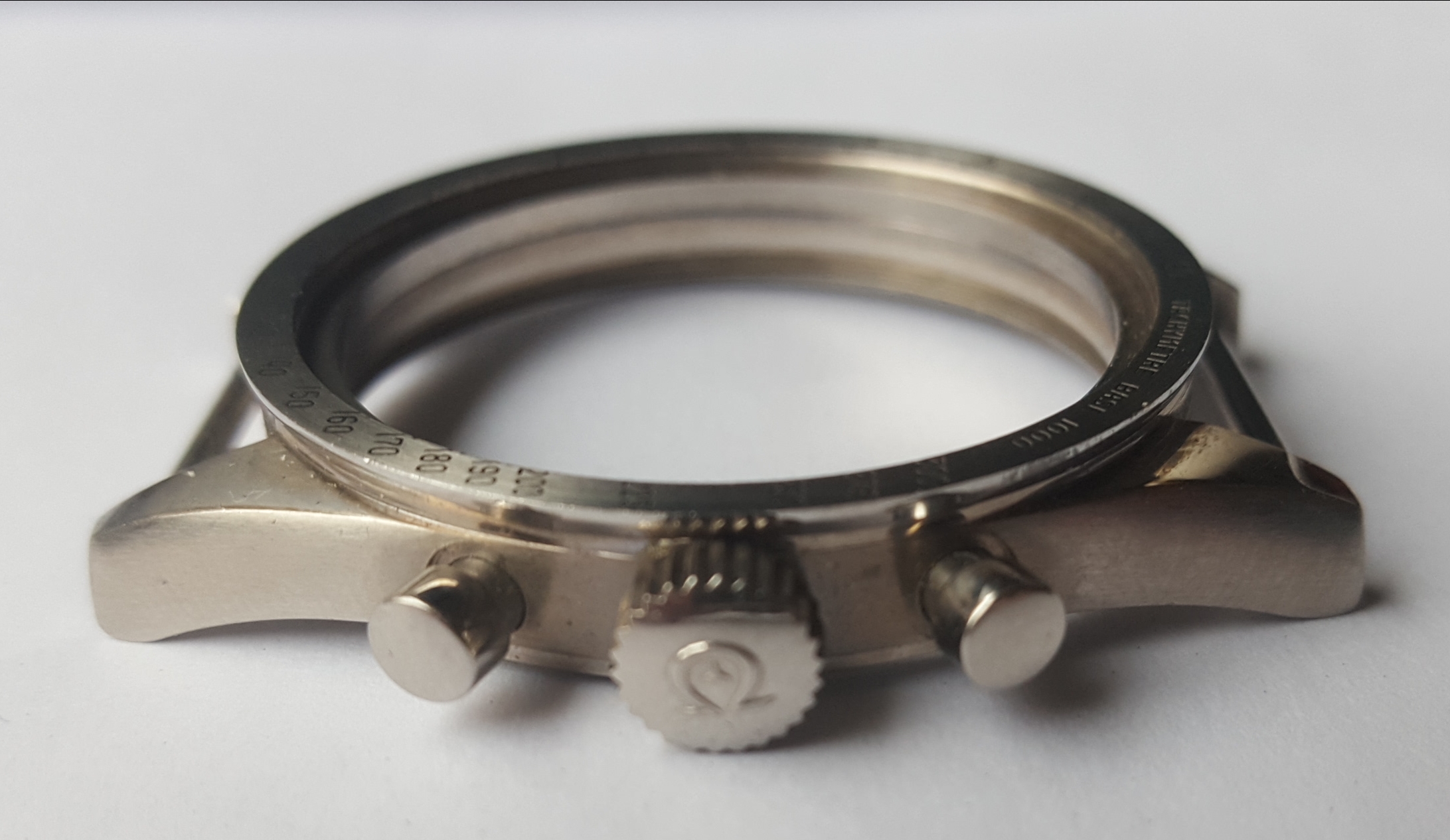

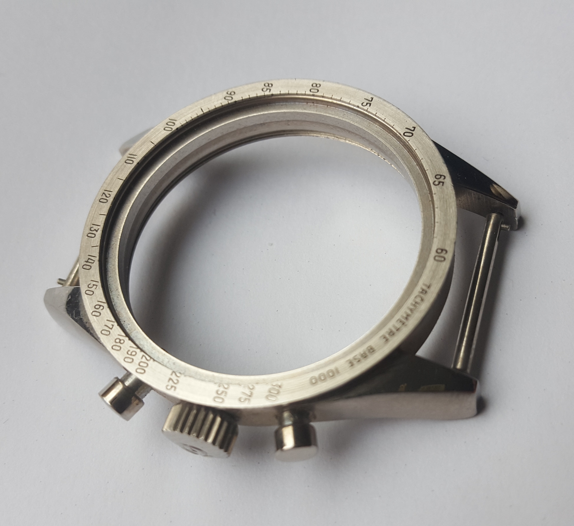

Just received this new old stock part. Some minor dents/scratches due to 60 years storage in watchmakers parts stash. Pushers are non threaded version and mint Naiad crown adds the creme de creme effect. Enjoy!

Does it have the notch on the case at 12?

would you mind showing more pics, please?

Pusher bottoms are threaded, which I don't think is period-correct for the 2915-1. However, the springbars seem like they're original, and I feel like that would be a detail easily overlooked. The missing groove at 12 probably means this isn't a 2915-1 case though? Perhaps the bezel and crown are correct, but it seems like the case may be from a later Speedmaster.

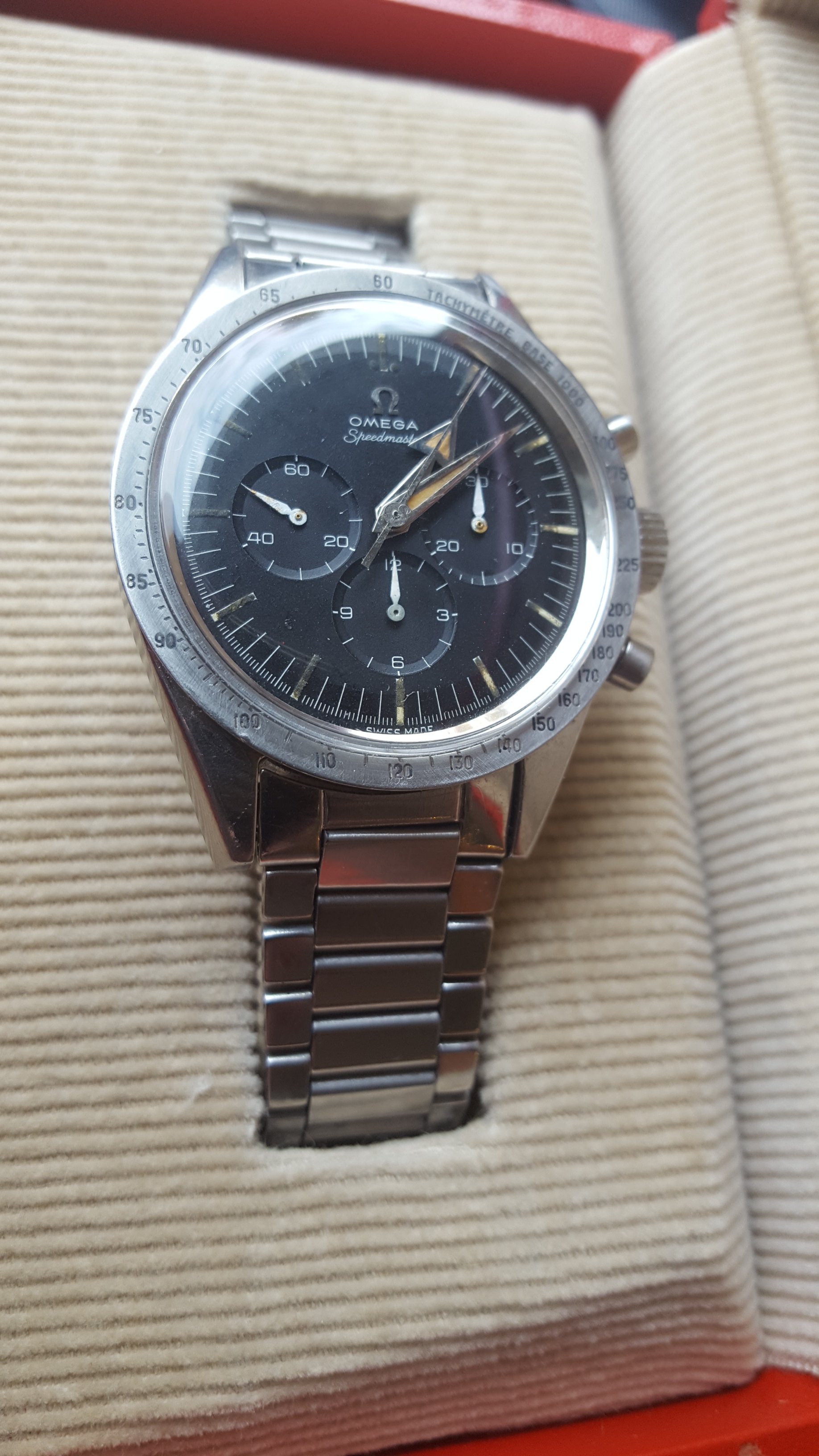

Very cool find and congrats!

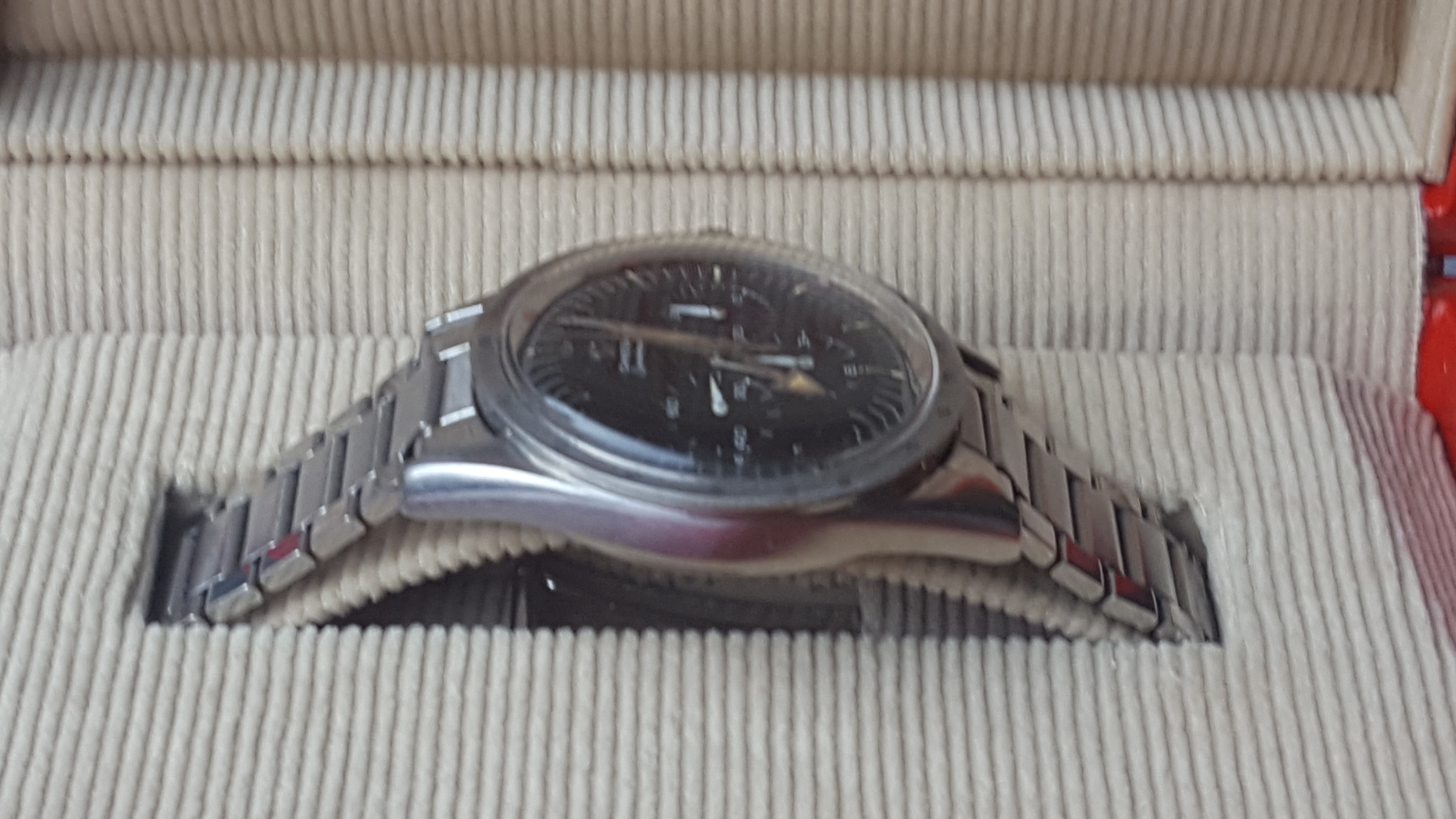

I had to check my 60th on the wrist and see the differences 😀
You have nicer subregisters 😀
Pushers on the very first 2915-1 are threaded into the case with a outer gasket like the ones seen here 👍
https://www.ebay.co.uk/itm/GENUINE-...599472?hash=item23d4a77470:g:0SAAAOSwNKlejf6g
