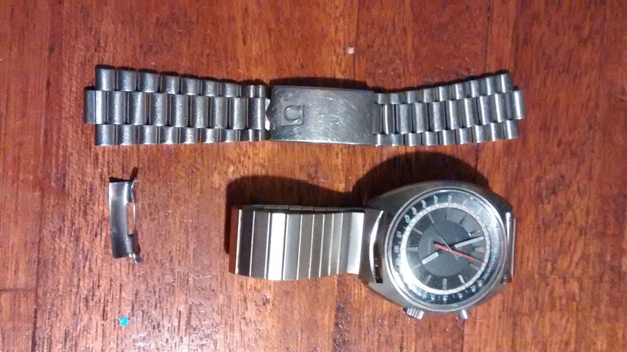

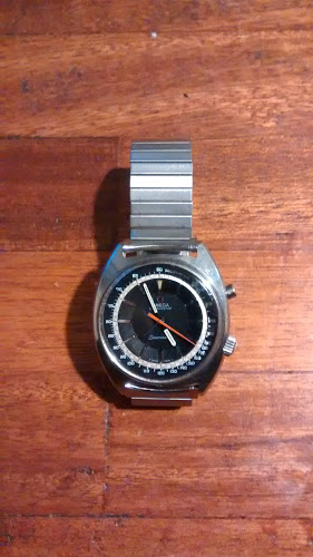

    Here it is

    Welcome Jakey. You have a nice 145.007 there. The movement of the inner part of the dial probably indicates that one of the dial feet has become detached. This is a specialist repair because it attaches on the slope of the dial and is very wide compared to many other dial feet. This is not uncommon because the dial foot has not been shaped to fit the angle, but relies on whatever solder finds its way into the gap.
    Without a shadow of a doubt, it does need a service and the part you are missing is known as an "end piece". What you need is one with the same markings as the one you still have.
    Current pricing with the dial repaired and the bracelet intact would be about £750 to £1,000. The top end would depend on it being in very original condition. As it is, currently, I would say it would fetch about £500, but the repairs and service will set you back about £400 if no parts, other than a mainspring, need replacing. It might fetch a bit more on sBay, but now you have declared the problem with the dial, this will have an effect on the price. Being honest on eBay does though reduce the chance of a return.

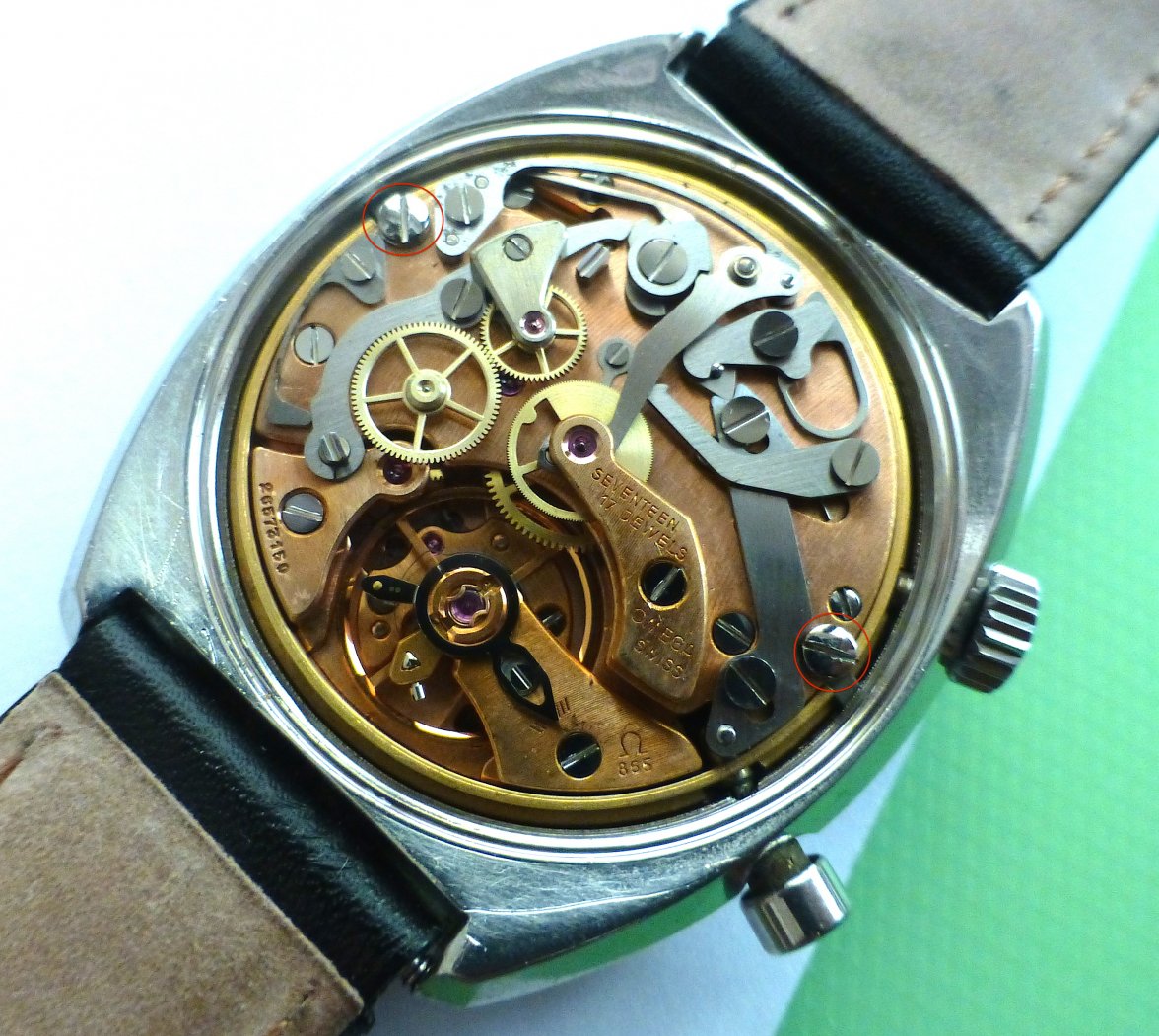

    Maybe it's just a loose movement screw, easily fixed if it is.

    Thanks for your advice. It was indeed not one but both loose movement screws. I should have made it clearer too. The dial was only moving when adjusting the time, so with the crown pulled right out. I guess the stem pushed in was locating the movement a little
