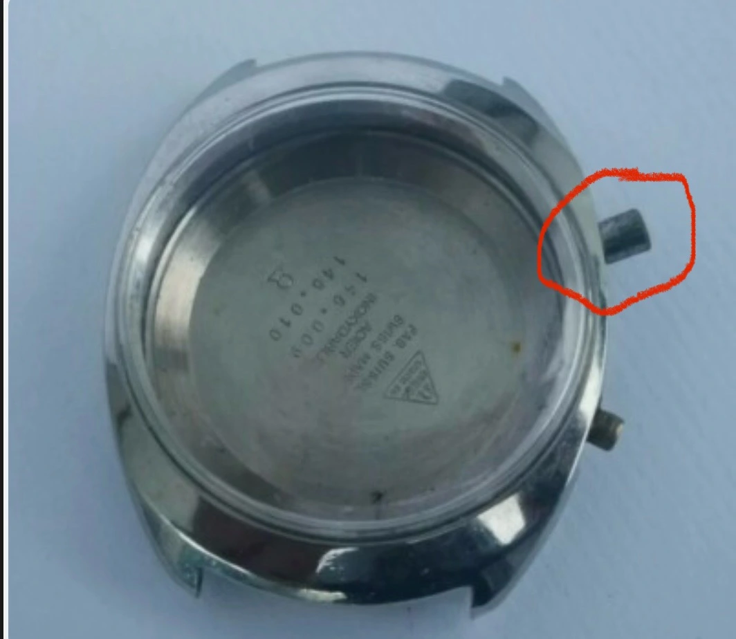

I’m looking to buy a 146.009 Chronostop.
Price is good because some reparation are necessary.
Button of chronometer is missing and necessary to buy an other one.
But my question is looking case, The cylinder guiding the button stem is missing or broken. Is this a separate component or is it integrated into the watch case? Could you help me? Do you have any technical drawings or plans?

I found
Pusher Omega Seamaster réf 086ST0002 for this part. It should be Ok?

This is the correct pusher for this case.
