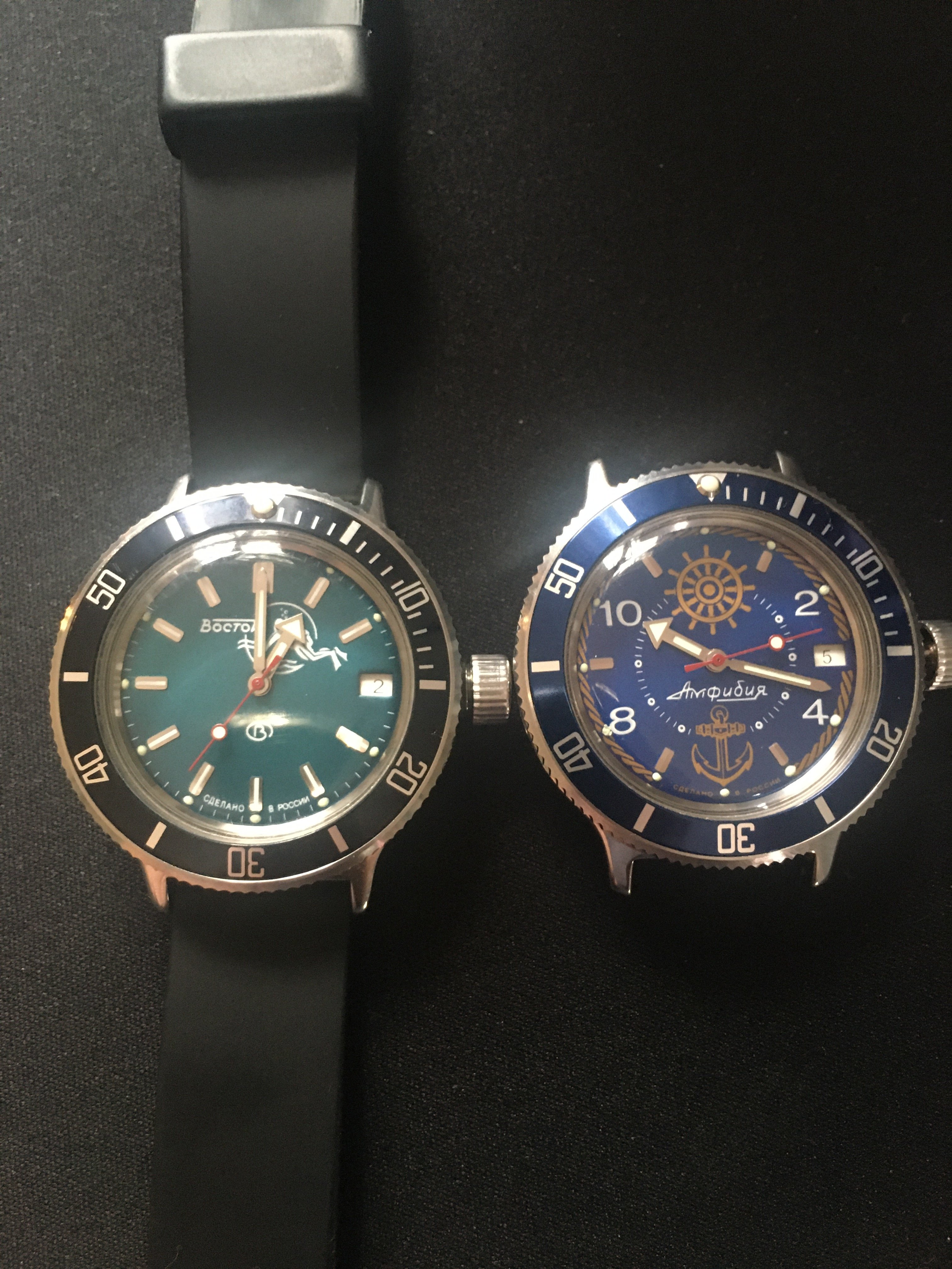

About a year ago I swapped the black dial on an AM Diver to a blue dial. When I did I managed to screw up the placement of the hands.
The hour hand lines up with the hour markers as the minute hand hits 17(ish). Can I just take the second hand and minute hand off again and re-seat the minute hand at 12? If I leave the hour hand on and line it up perfectly with an hour marker and pop the minute hand back at 12 that should take care of it right?
I think I have make sure the date change is happening correctly too. I have second Vostok AM Diver and the date flip happens about about 12:03. On the watch I screwed up it happens at about 11:52. So maybe I was off a little on the hour hand too?
Anyways, looking for recommendations on how to fix this without having to pull the hands off multiple times guess and check style?

Thanks Archer, super helpful! I'll give that a try this afternoon. The nice thing about these Vostok watches is that any part I manage to break only costs a few dollars to replace. Perfect for learning that I shouldn't try this on a vintage watch, ever. Still a lot of fun though 😀
