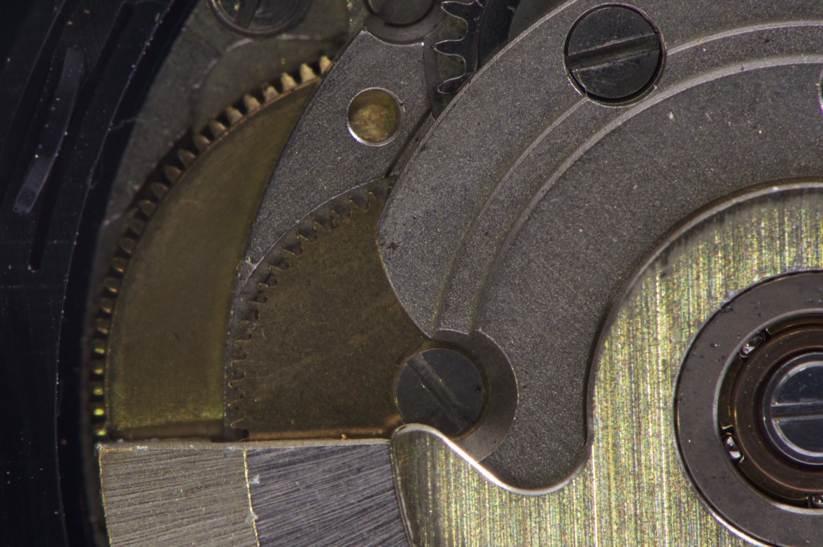

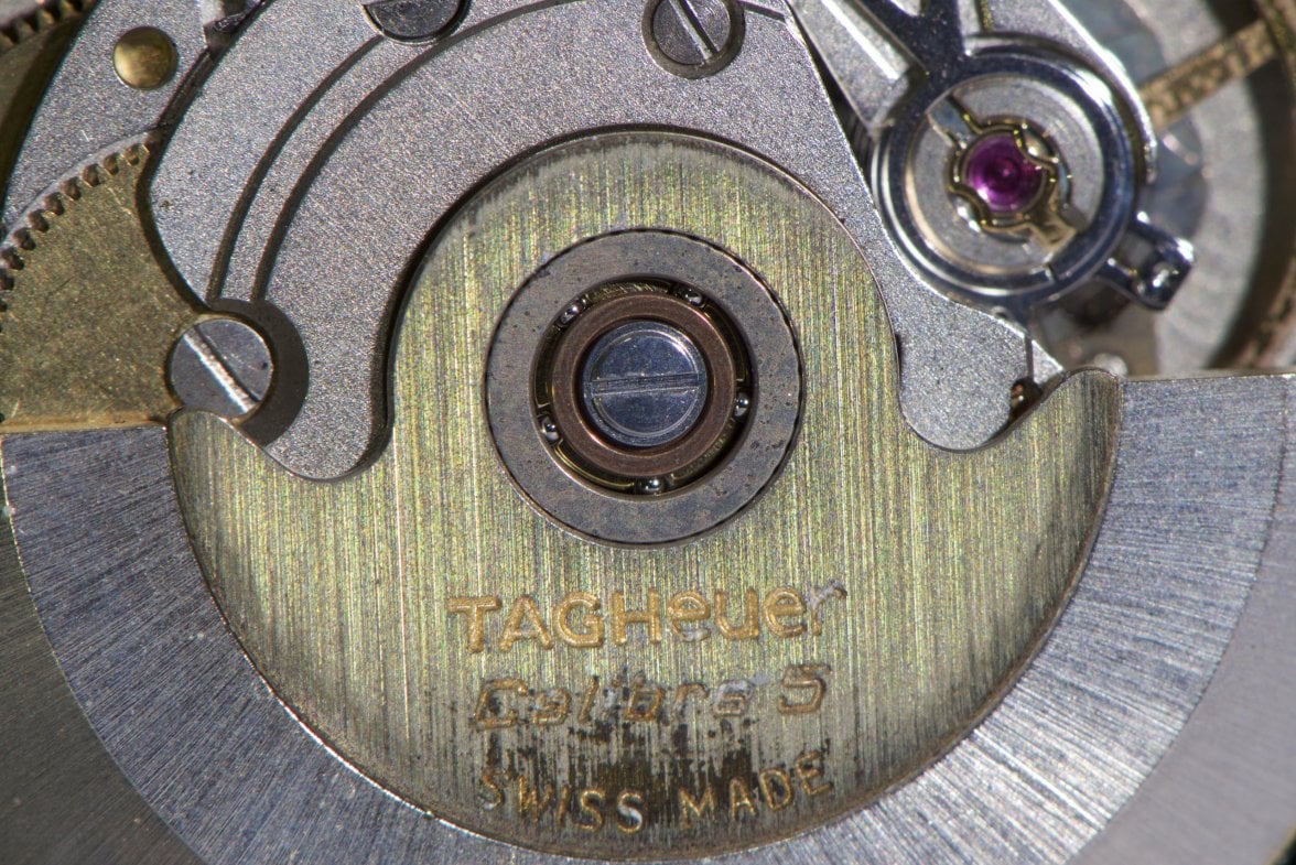

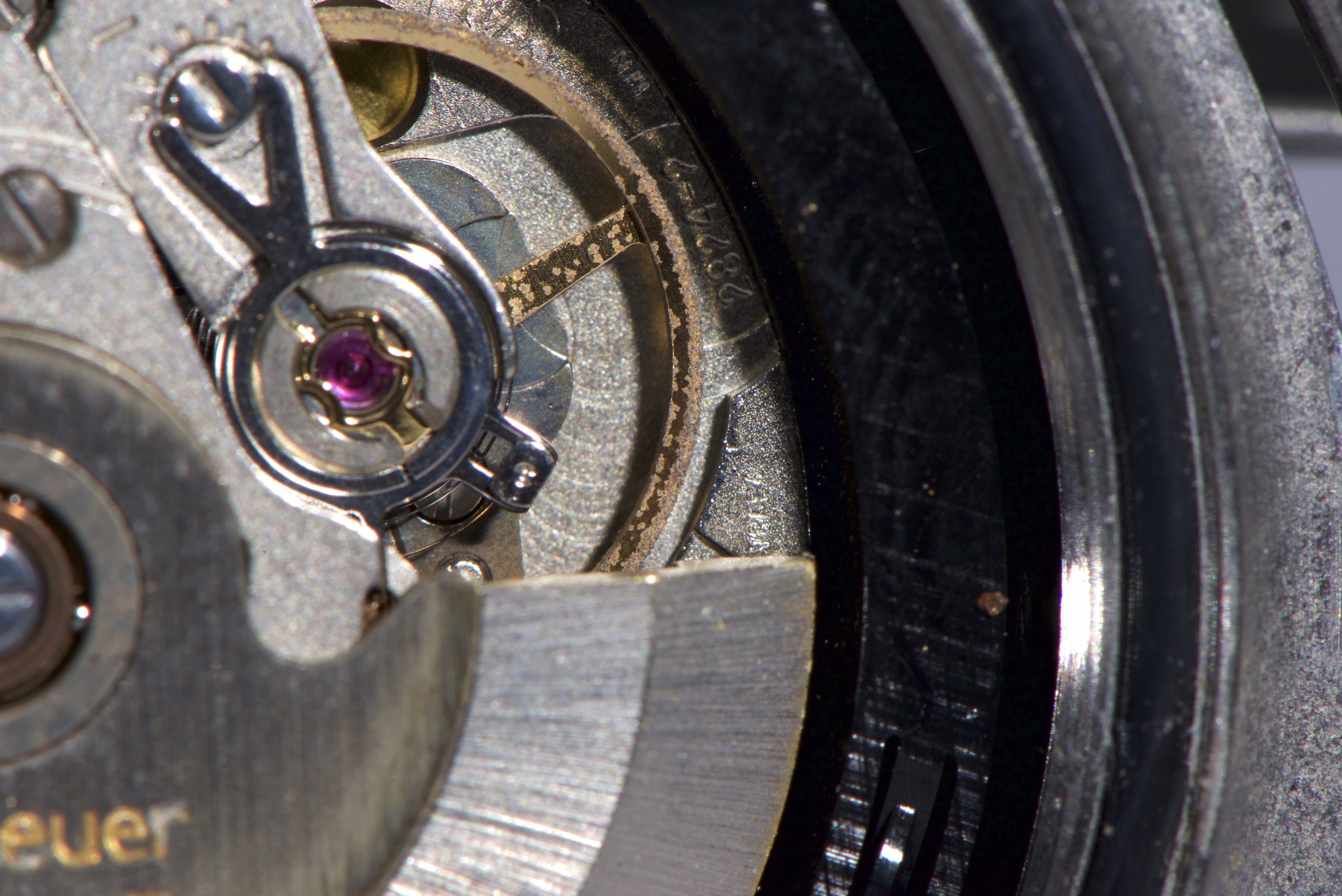

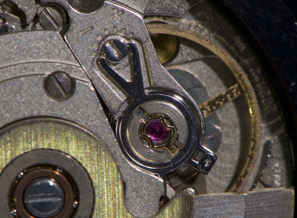

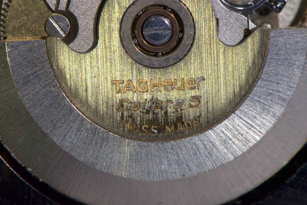

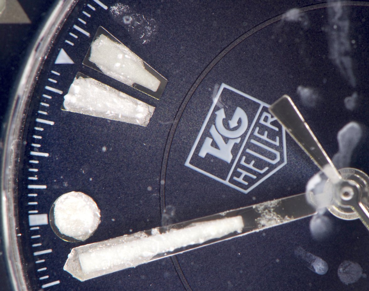

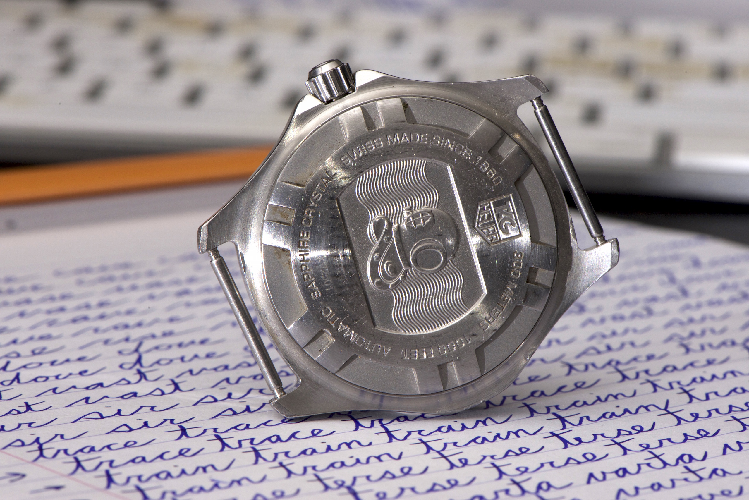

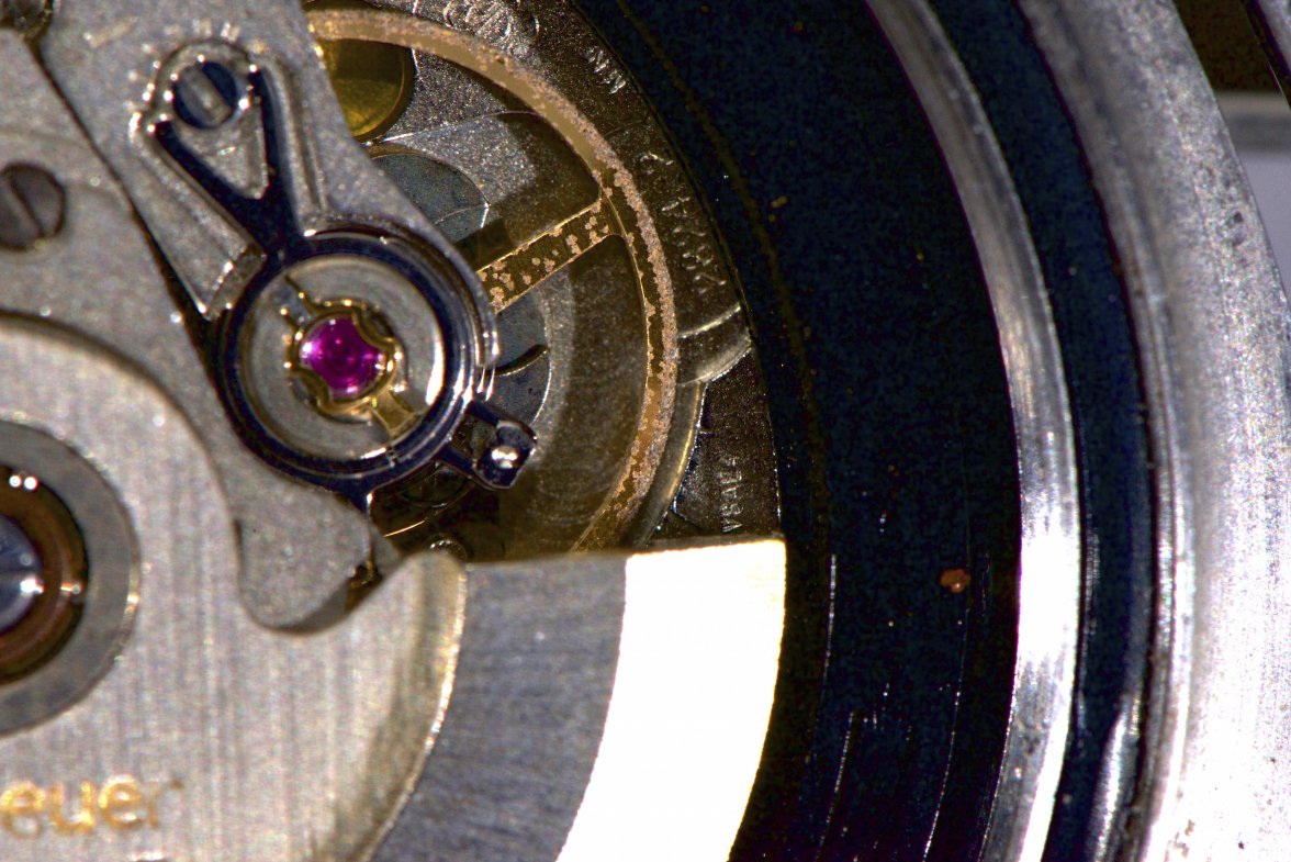

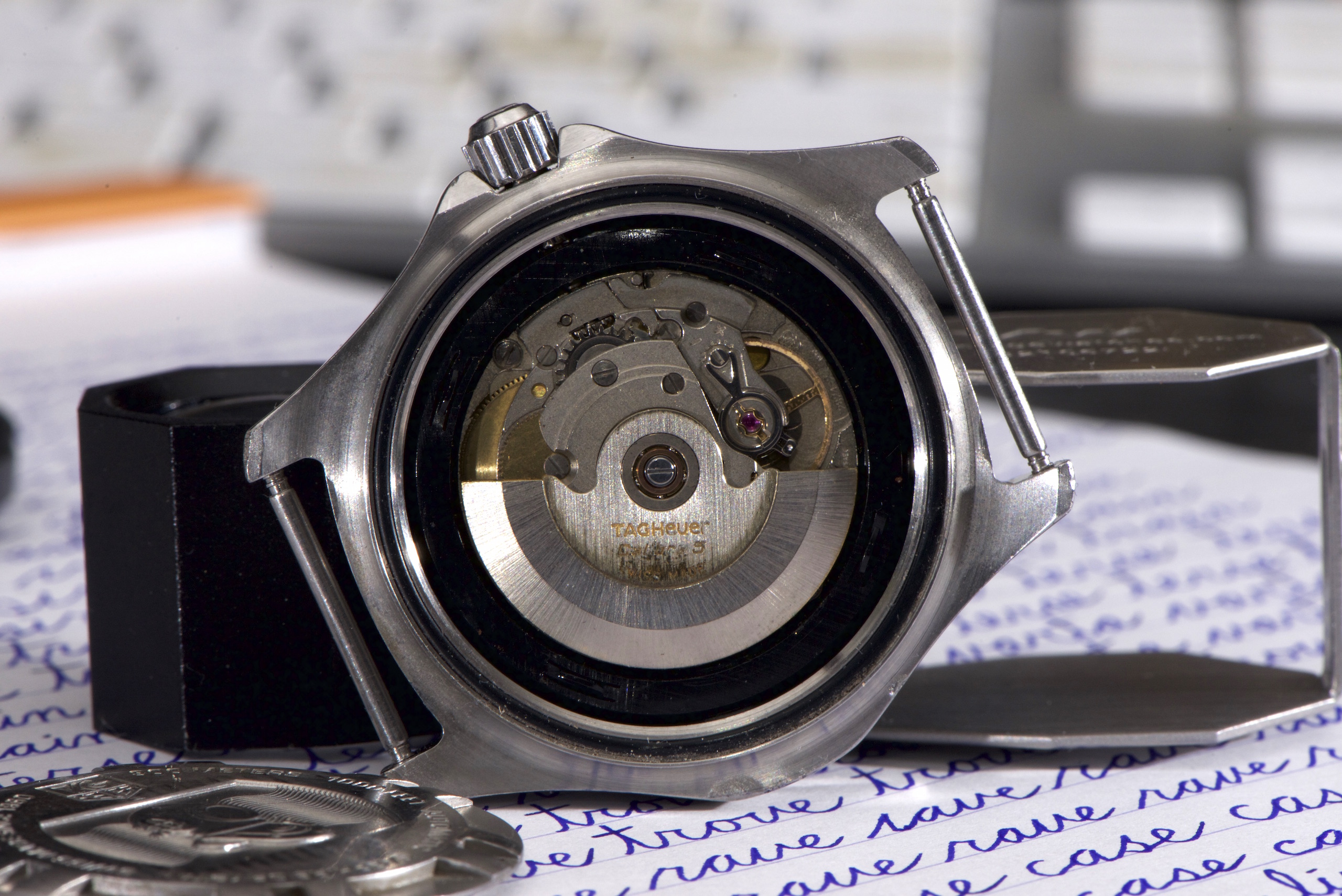

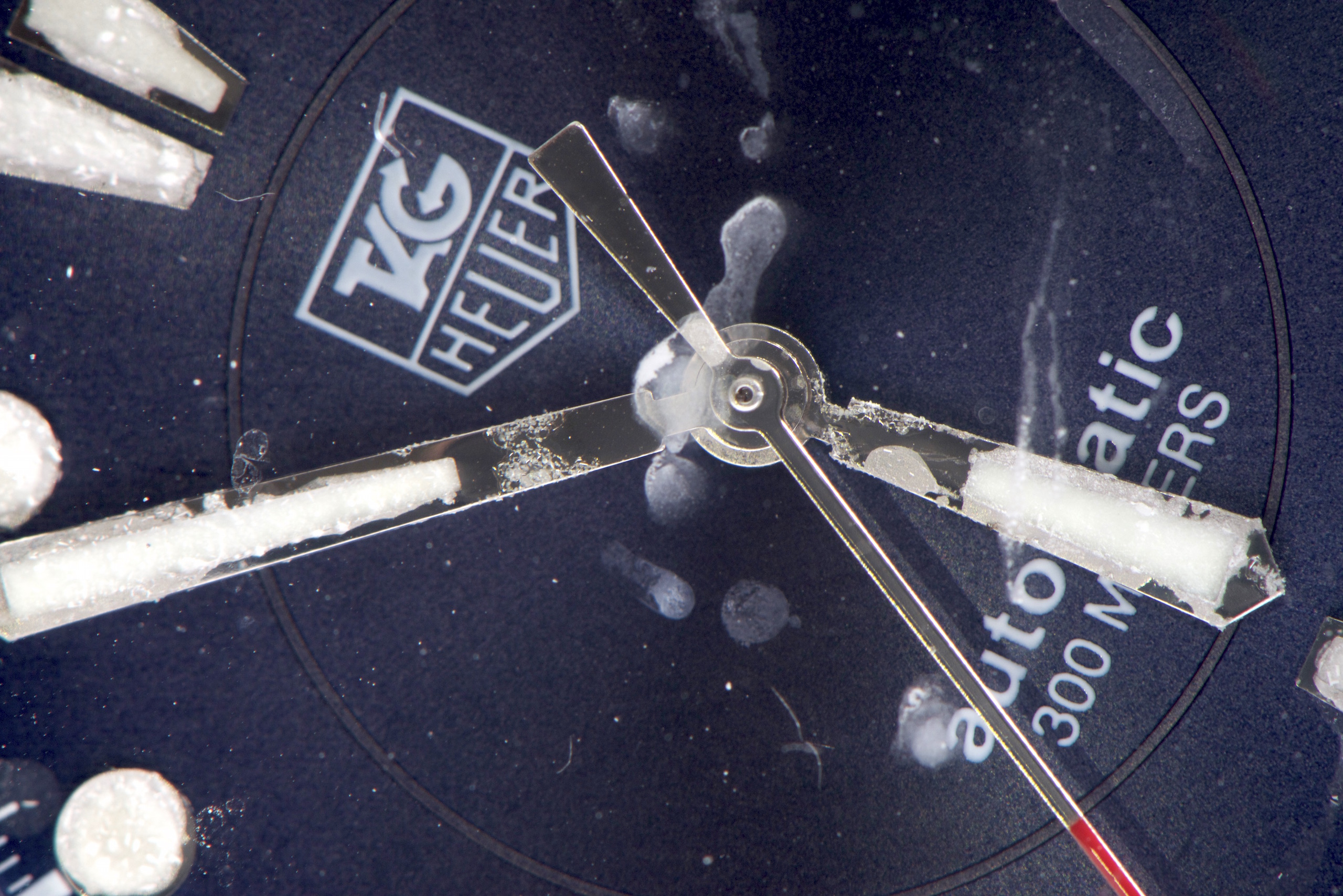

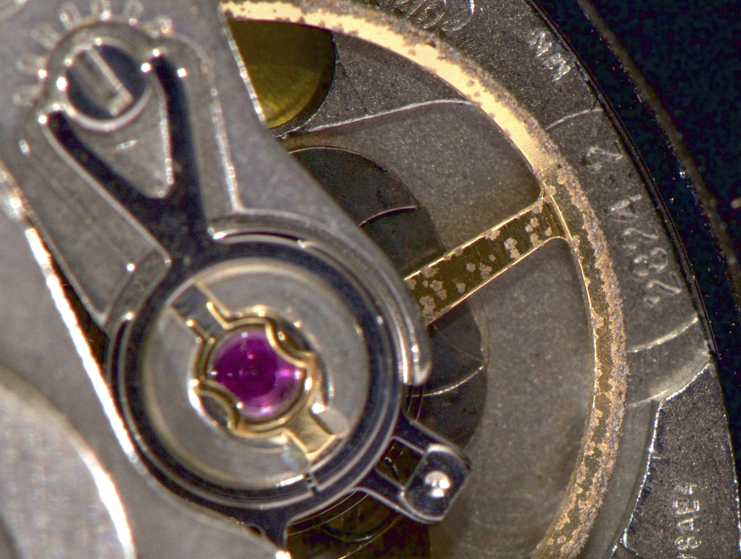

    You can tell people to change their seals regularly, especially people that are in salt water at the beach on a daily basis but that doesn't mean they will, even when they're family. This watch was take off its owner's wrist as it was full of water and put into a box which was then lost for a year before turning up this week. Before taking it to my watchmaker to see him shake his head disapprovingly and tally up the parts list I figured I'd take some high resolution shots of the watch as it is. All of these are 2560x resolution so you can click in the image to view the full size version.
    Photos were taken on a Nikon D600 + Micro-Nikkor F/2.8 105mm VR + Nikon TC-17E II 1.7 Teleconverter
    OF2_3263.jpeg OF2_3269.jpeg OF2_3273.jpeg OF2_3272.jpeg OF2_3274.jpeg OF2_3277.jpeg OF2_3281.jpeg OF2_3283.jpeg OF2_3284.jpeg OF2_3287.jpeg OF2_3286.jpeg OF2_3290.jpeg OF2_3291.jpeg OF2_3292.jpeg OF2_3294.jpeg

    4,402

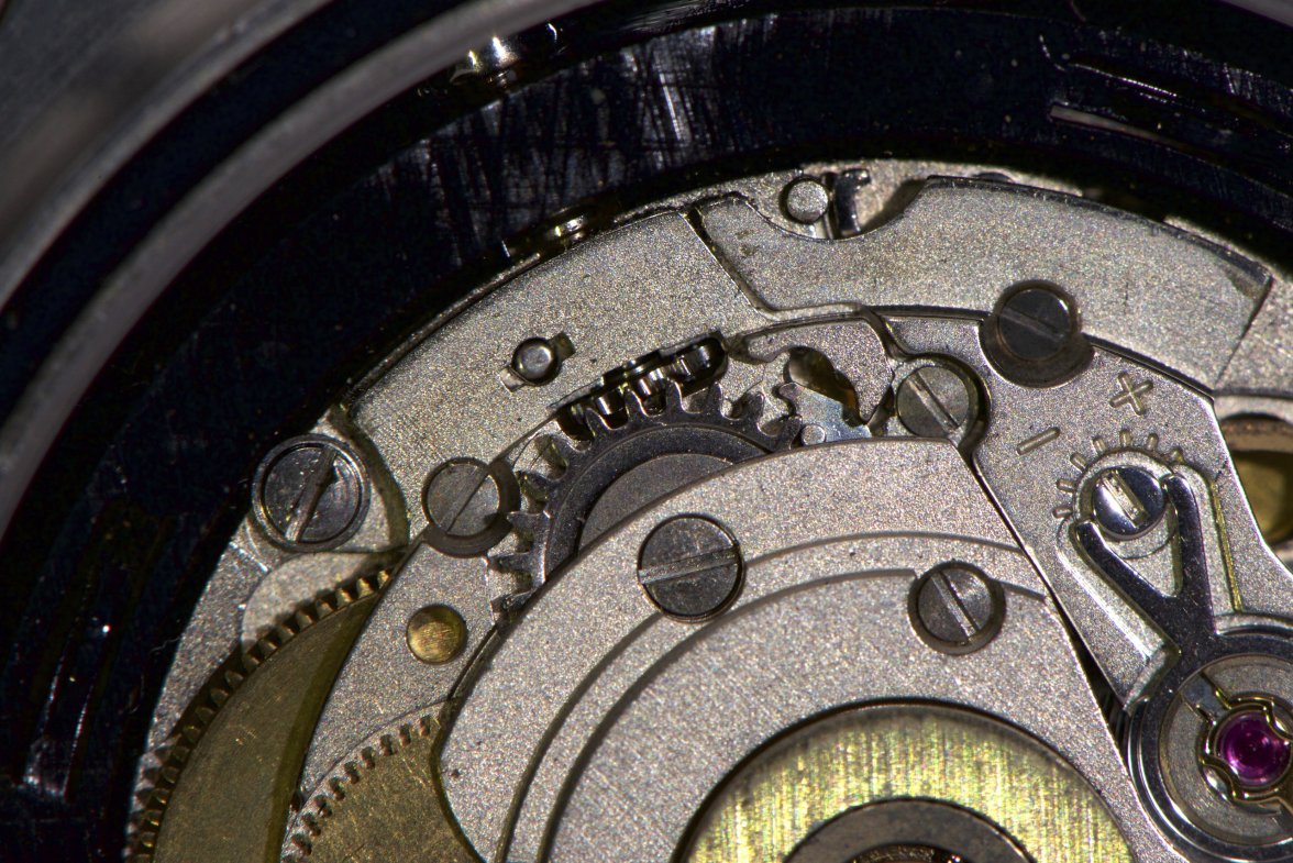

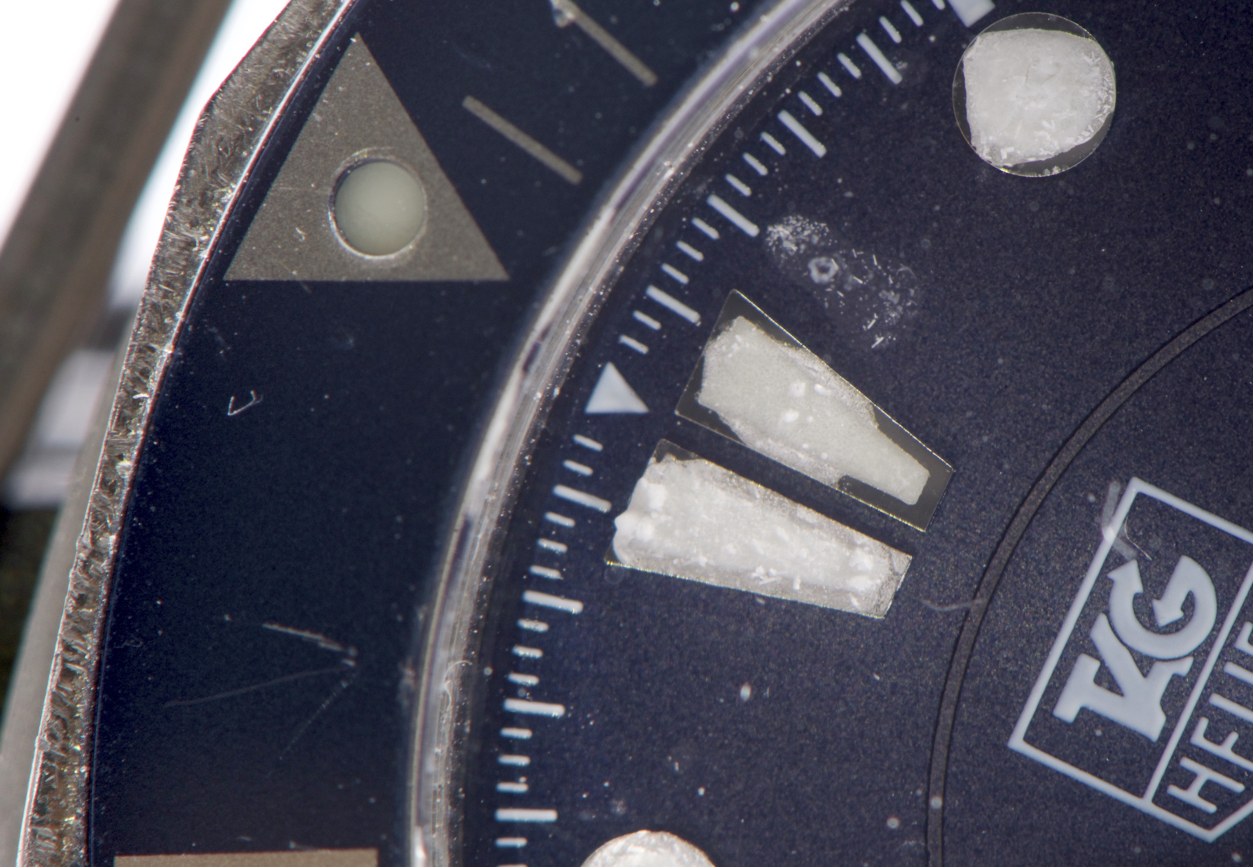

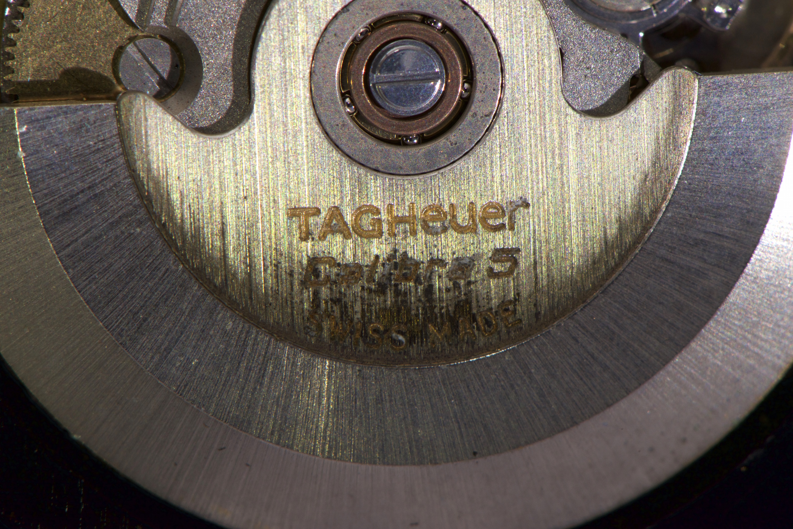

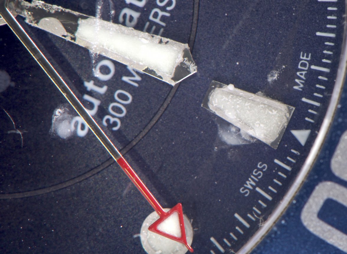

    32,711

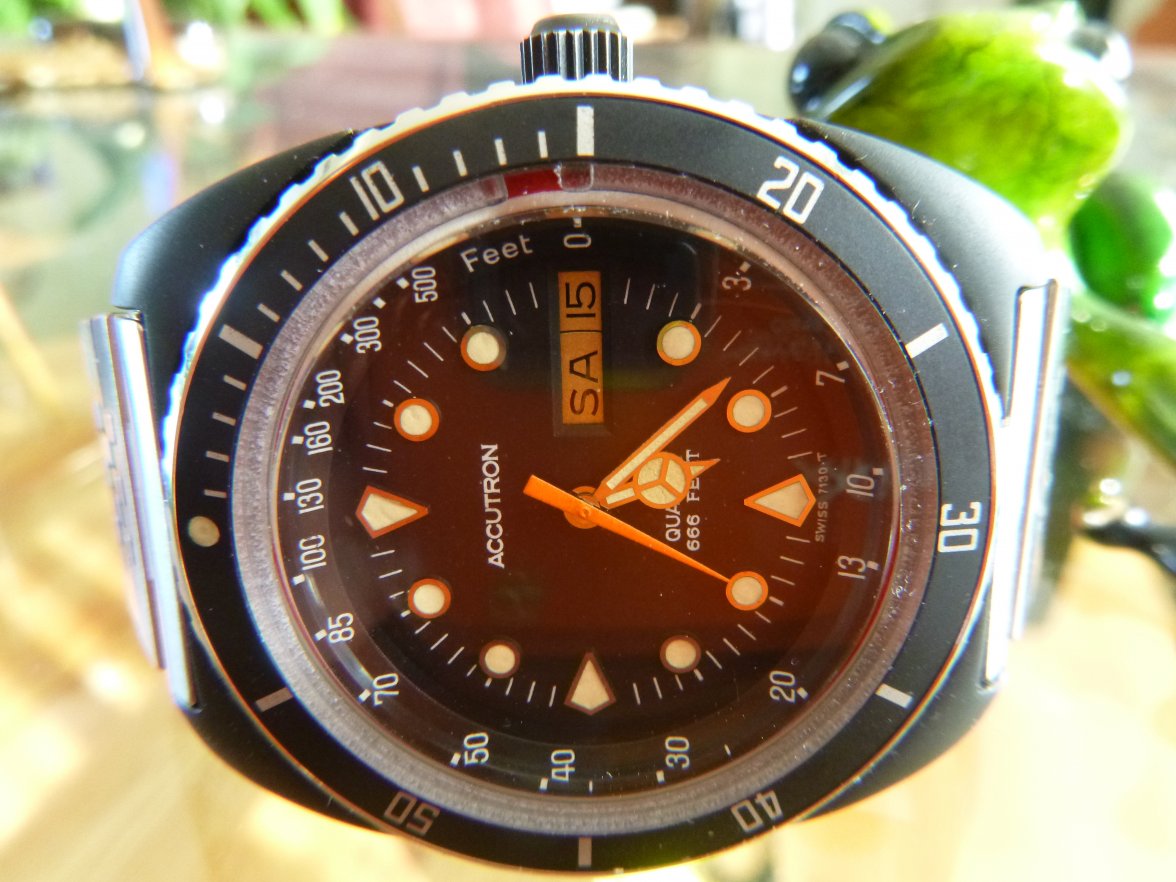

  12. Fritz genuflects before the mighty quartzophobe Mar 14, 2015
    3,817
    15,990
    My solution to this problem is to buy cheap "hundred dollar divers" for swimming..... if they drown, scrap 'em....
    that way your heart's not broken because you buggered your Seamaster!
    The Bulova was $100 (NOS!) and the Seiko $125 (lightly used, in the box with all the papers)
