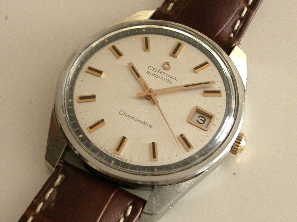

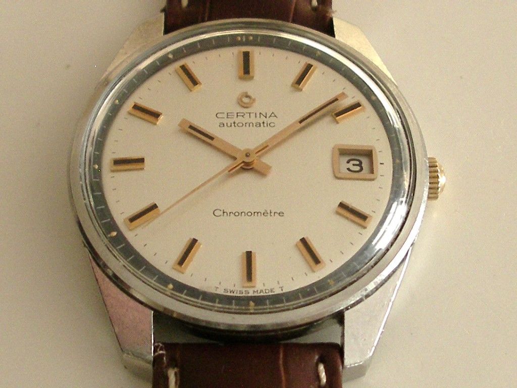

Chronometer-rated Certinas aren't that common and most seem to be quite dressy, many in either gold cap or solid gold cases. A number of 7221 produced in total is bandied about a lot, though I don't know if this is correct.
This one caught my eye:

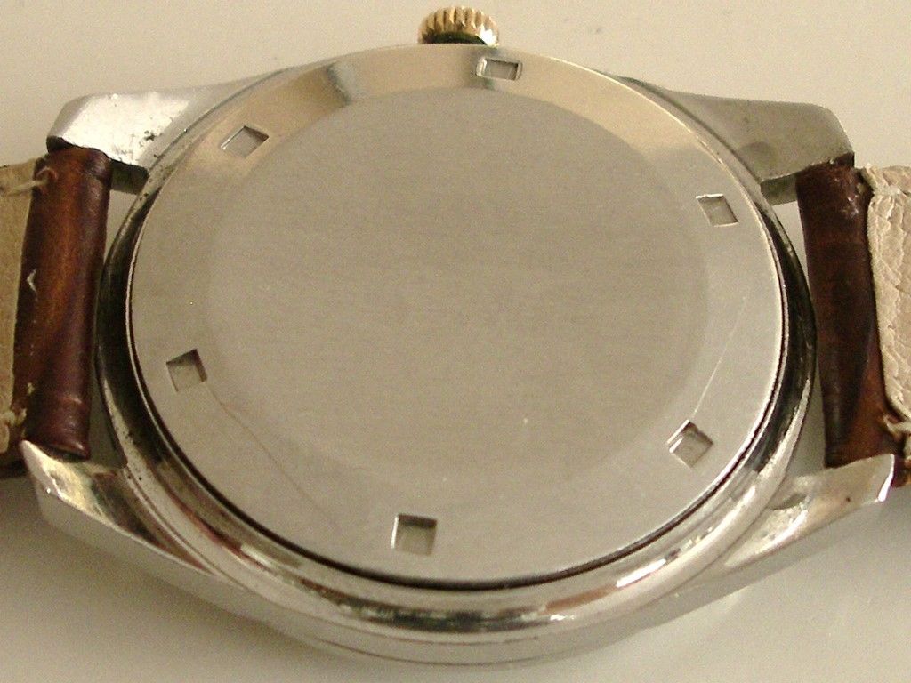

An attractive 36mm case and a lovely dial - but those lume plots? With those hands? A blank caseback is always a good sign 🤦
What do you think, is it a complete franken? Have the hands been replaced? Or is it correct with no lume on the hands 😀:screwloose:😀?
Hope for some insight from resident know-it-alls, including @Bill Sohne, @Skrotis and others..!

Franken, I'd say. Wrong case, and possibly movement.
Would a chronometer-rated movement be marked as such?
At the moment I'm leaning towards this being a franken of a chronometer movement from a melted-down golden case in a steel case.

Say that movement and dial was out of a gold case that was melted in the gold rush years ago.
9,596
27,688
Just realised that the crown is the correct type for a gold cased chronometer. It's a franken, no doubt.

Some (most?) of these had the case backs marked, also...

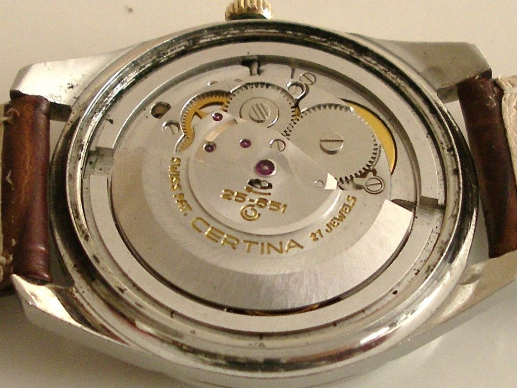

This movement is a Kurth Freres/Certina, and IMO is correct, and I am leaning toward it being a correct case. I am going to say that it would not be possible for a donor case to be such a perfect fit.
http://www.ranfft.de/cgi-bin/bidfun-db.cgi?10&ranfft&2&2uswk&Certina_25_651M
Image from the Ranfft archive.
I have two of these. Neither of mine are marked chronometer. One without the date, and the other with date. I don’t see the balance cock on the subject watch, but mine are both equipped with micrometer regulators, flat hairsprings (not Breguet with over coil). These are (IMO) a beautiful movement. I consider them to be on a par with many of the first line quality brands it was contemporary to. The esthetics and finish on all the components are as fine as I have seen on any of the top brands of the era. I opt for correct and original. I hope I don’t come off sounding contentious, but I like it!😀

I remain skeptical. Take a look at the cases shown here. They are different, albeit not significantly.
https://www.vintagecertinas.ch/en/chronometer-en/
Also, the crown and dial and hands are from a gold cased watch!

I remain certain it is correct.
"certain"? lol! Please do show another example. Just one.
The case on the subject watch doesn't even have a serial number.

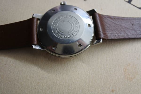

Here's the correct case back for the dial and hand-set, as found on Ranfft's site, and as seen on others:
After spending some time doing some rather basic research I am convinced it's a franken, no doubt in my mind. The missing lume on the hands, the crown that would fit the gold cased version of a chronometer-rated movement and the missing serial number on the back (which, according to vintagecertinas.ch, should match the movement number on chronometer-rated Certinas) and the fact that the model doesn't appear anywhere else are pretty strong arguments.
A lot of Certinas use what is basically the same movements, so I am not surprised to see this one fitting another case. Having looked at a number of DS' recently, movement and dial swaps are far, far from unheard of.

4,480
9,323
Hi @ConElPueblo
Does the movement have a serial number ?? please rotate the rotor and see if you can find a number....
I would agree with you that it was re-cased.... it looks nice.... I would wear with pride...
I have one that was re-cased , poor job in comparison to yours!
and one that somehow they goofed on the serial number on the caseback to the movement, i think its off by a single digit!
Looking forward to seeing the rest of the movement...
