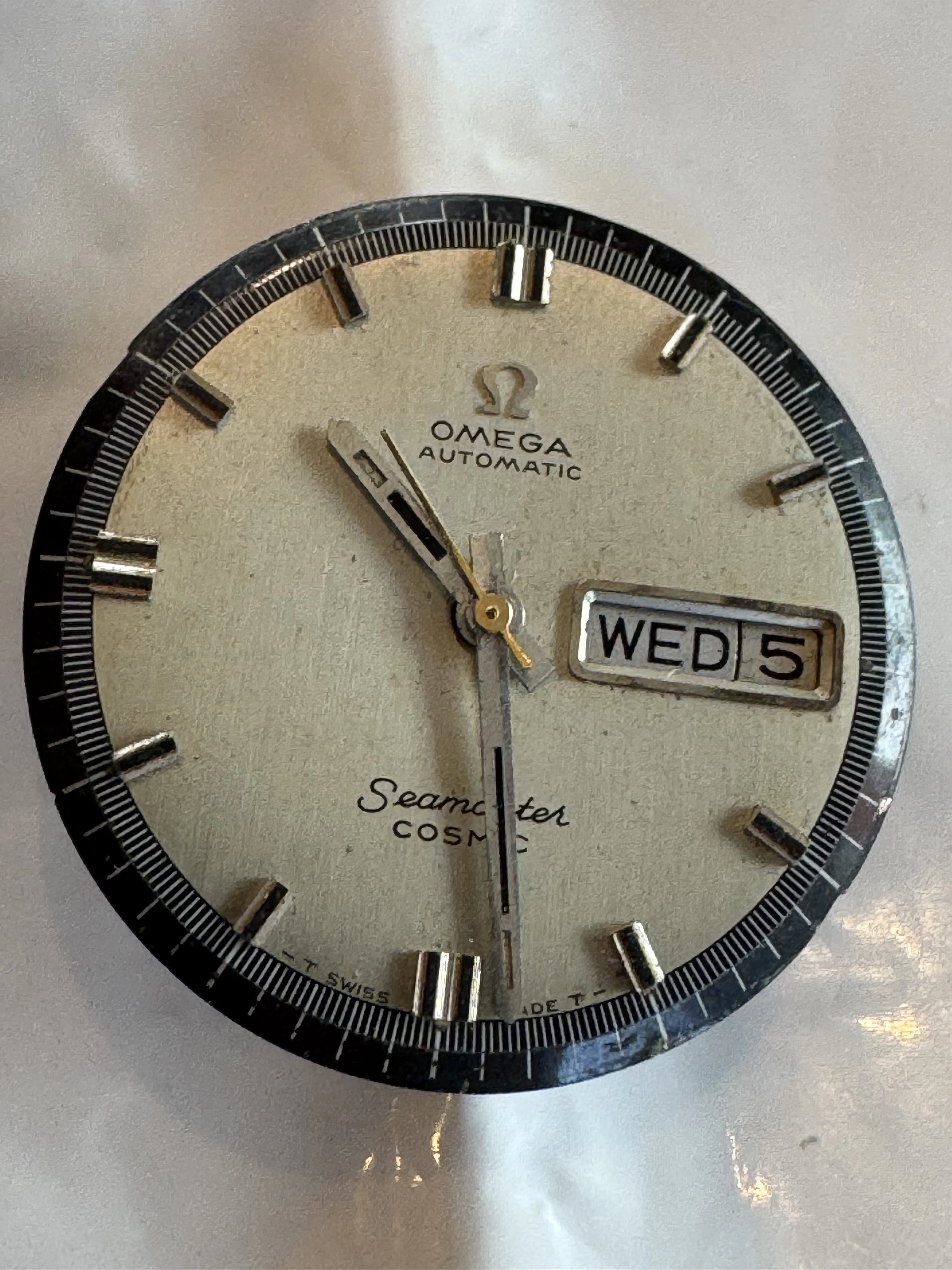

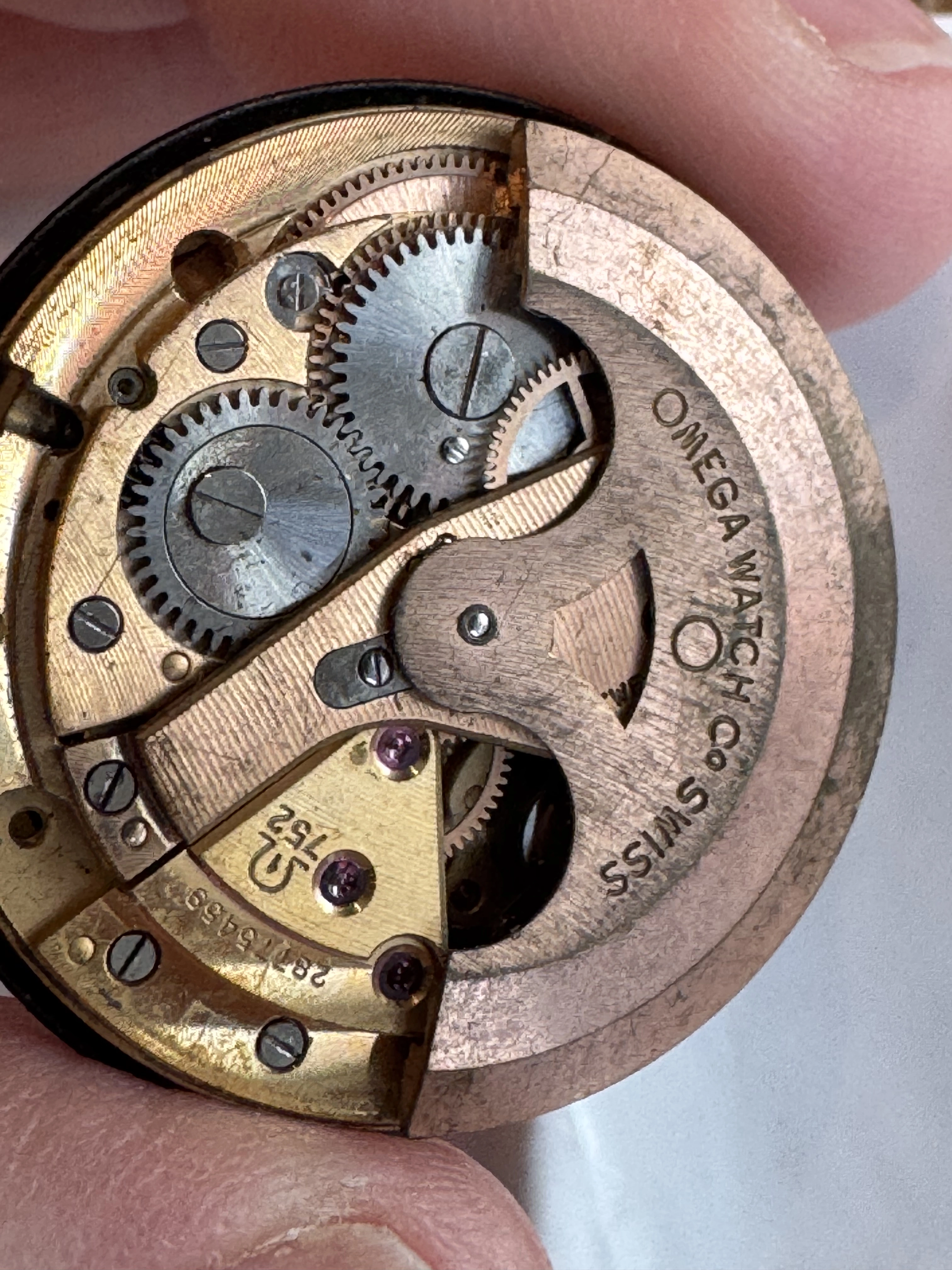

I got a cal.752 for a Seamaster Cosmic and I am looking for a casing to fit the movement.
I don't have a lot of info about the caliber:
Dial size:30.5 mm
Movement size:28 mm
I found several casings:
Cosmic 135.016 CASE
Cosmic 166.036 case
But I am not 100% it will fit the dial.
If you have any suggestions I would appreciate it
Thank you
792
845
Ref. 166.036 is the correct case for this dial and movement. The Ref. 135.016 case is too small and will not work for this movement
