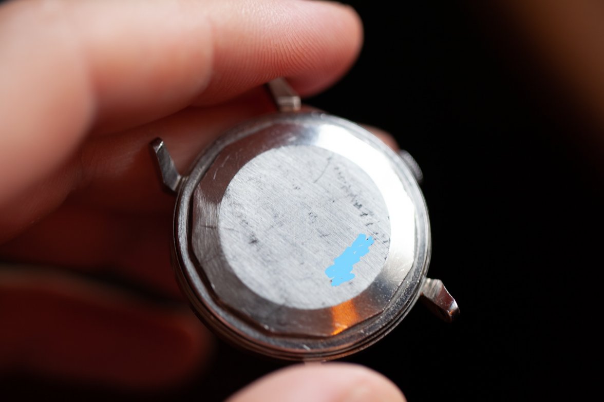

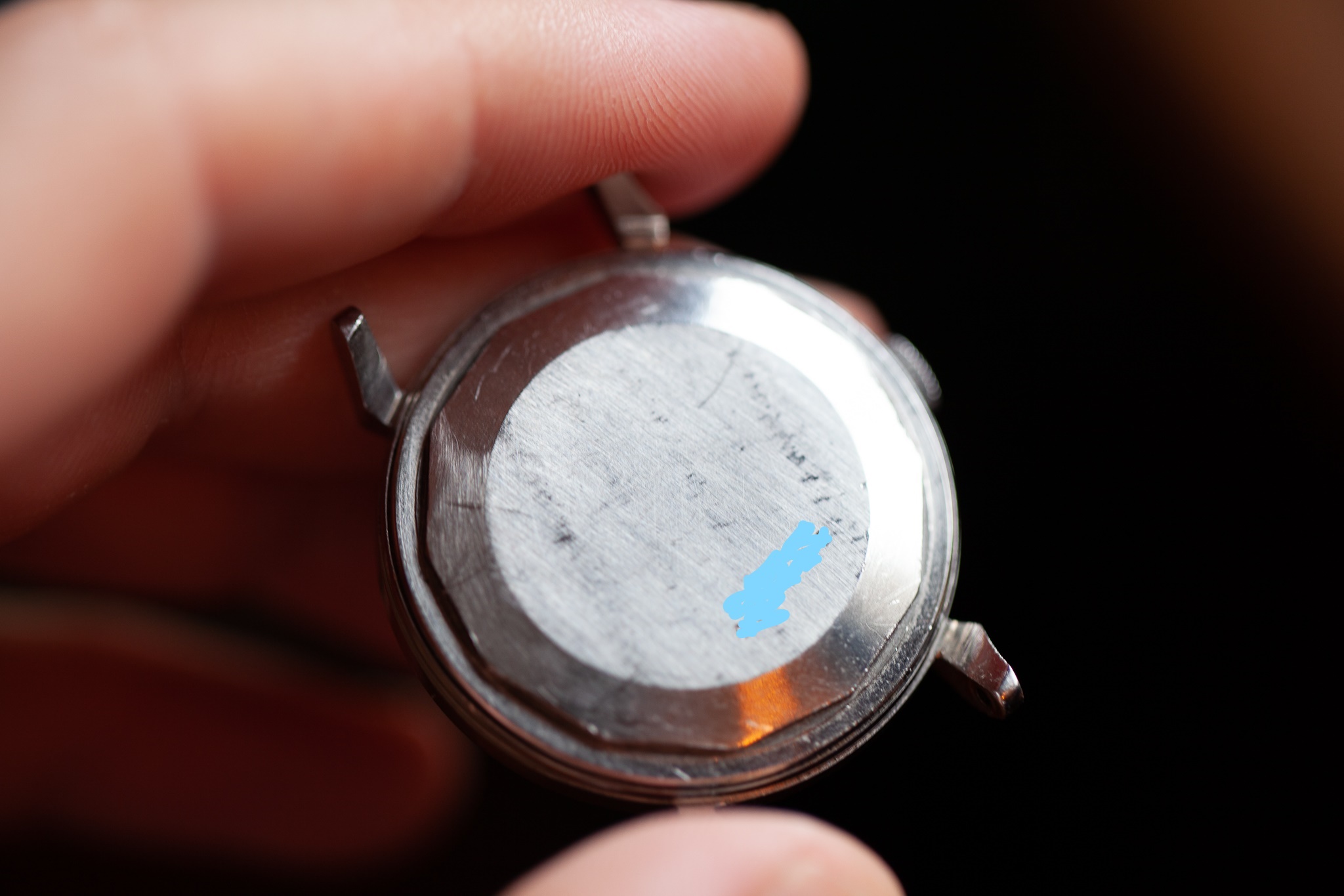

Hi all,
What is the type of tool called to get a caseback like this off (I can picture the tool in my head, just don't know what the name of it is)! Thank you!!
-J.
975
1,517

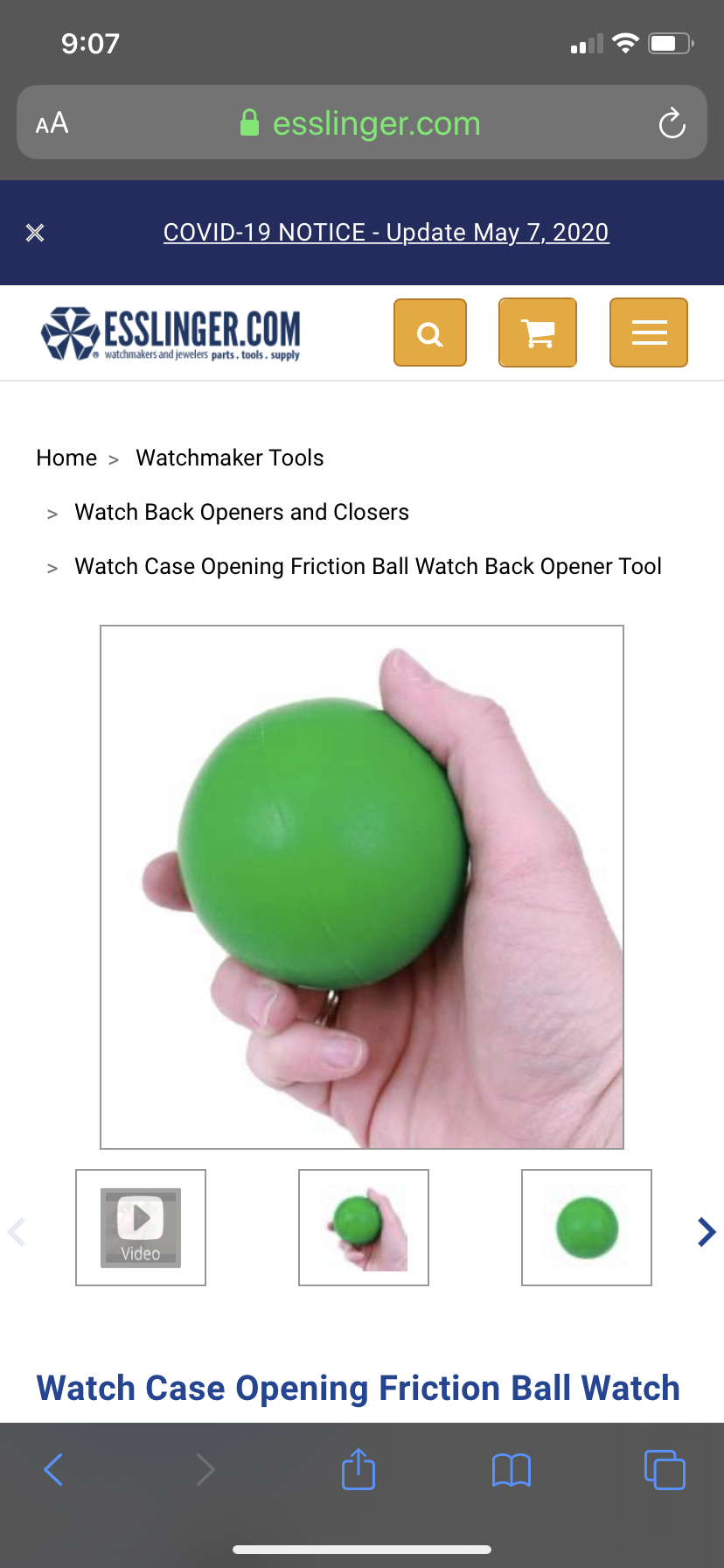

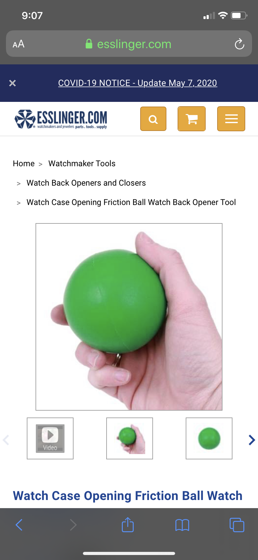

Have you tried the sticky balls? They seem to work well pretty often.
419
1,169
Thanks @X350 XJR, been trying to use this at home. Maybe I'm being too gentle, but haven't managed to get it off yet. The position of the lugs makes it challenging. I'll try again later
419
1,169
Have not, will look into it!

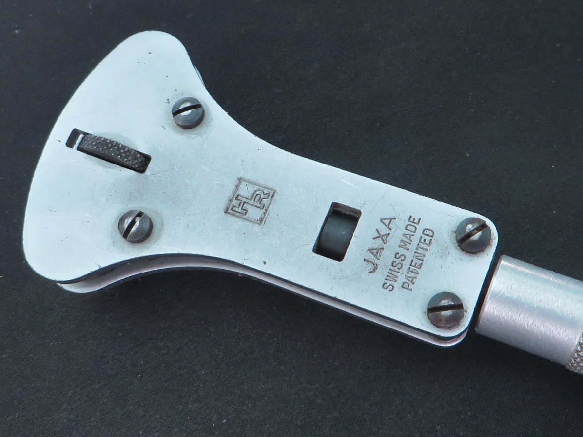

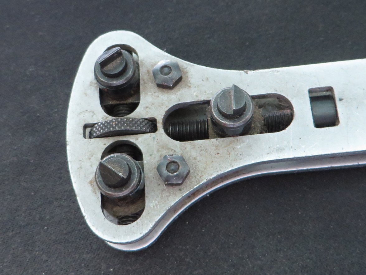

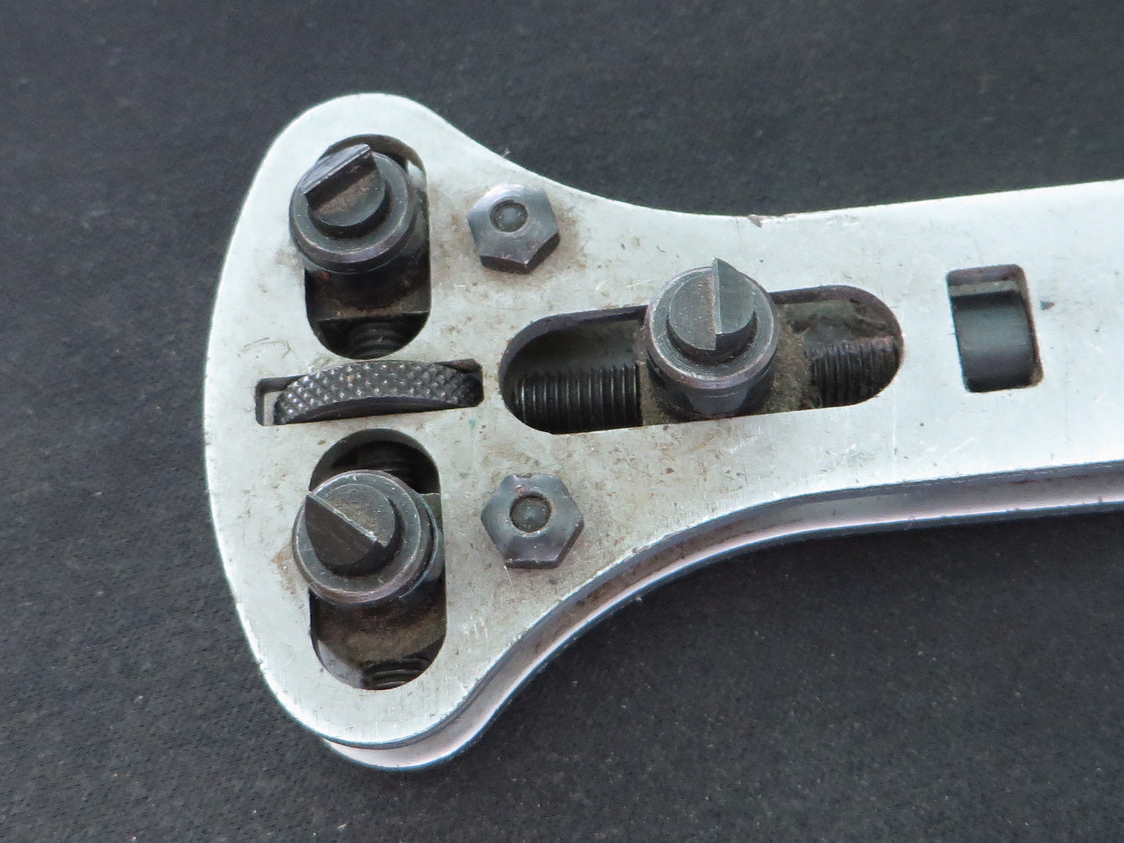

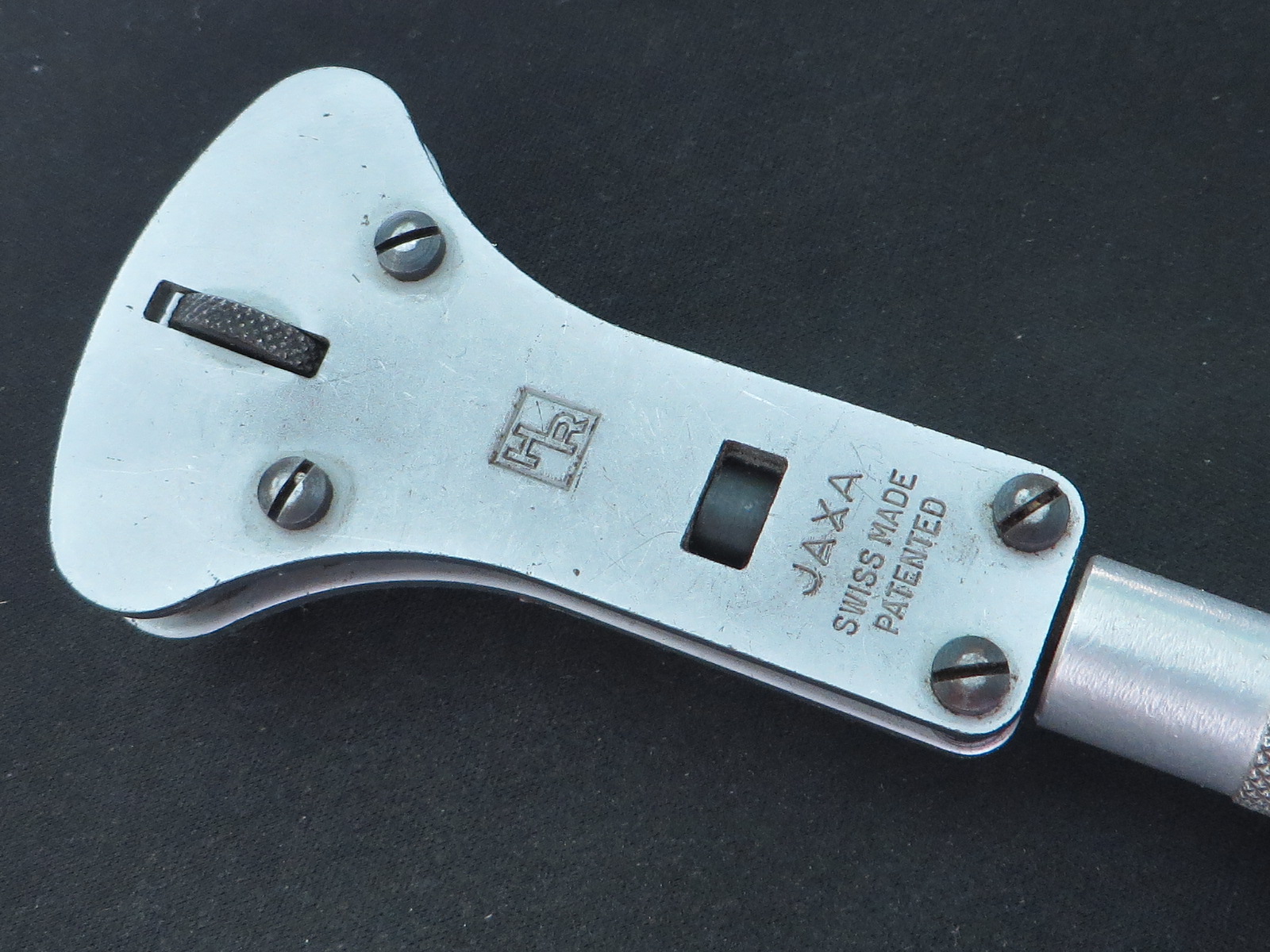

There are Breitling branded case back wrenches advertised on Ebay. They come in various sizes with differing numbers of facets.
907
1,295

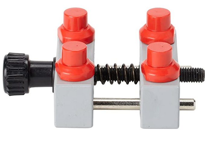

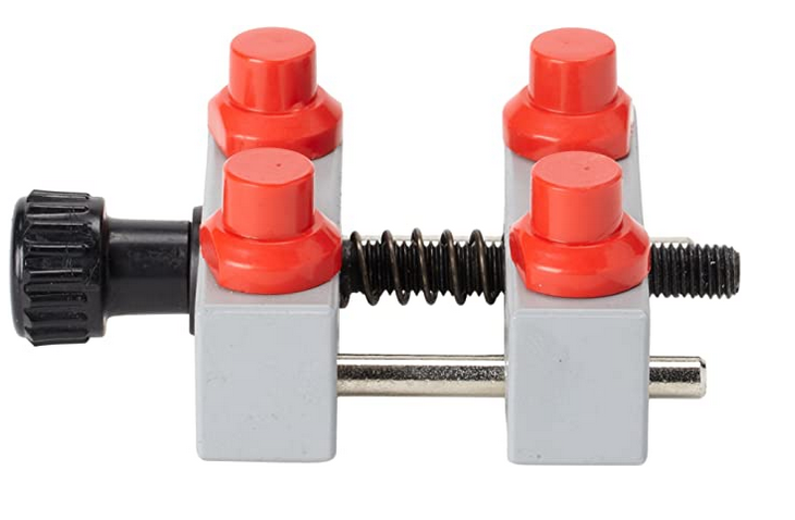

If it’s tight it’s not enough.
I have the same tool but I don’t have a base that can hold the case nicely and safer than my hand and I had problems opening a caseback.
My advice would be that tool in conjunction with something that can hold the case for best results.
419
1,169
KK I was holding it with my hand but I'll try using a case clamp

This balls are amazing and safe to use. The work about 85% of the time with my watches:
Yes, a case holder (with nylon pins) is very helpful. Put the watch in it, and then mount it in your bench vise. That way you can use both hands to keep the tool engaged. They really aren't too expensive and they come in pretty handy.
