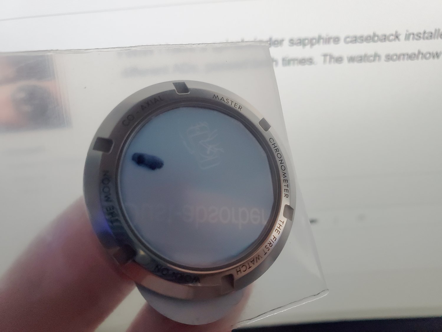

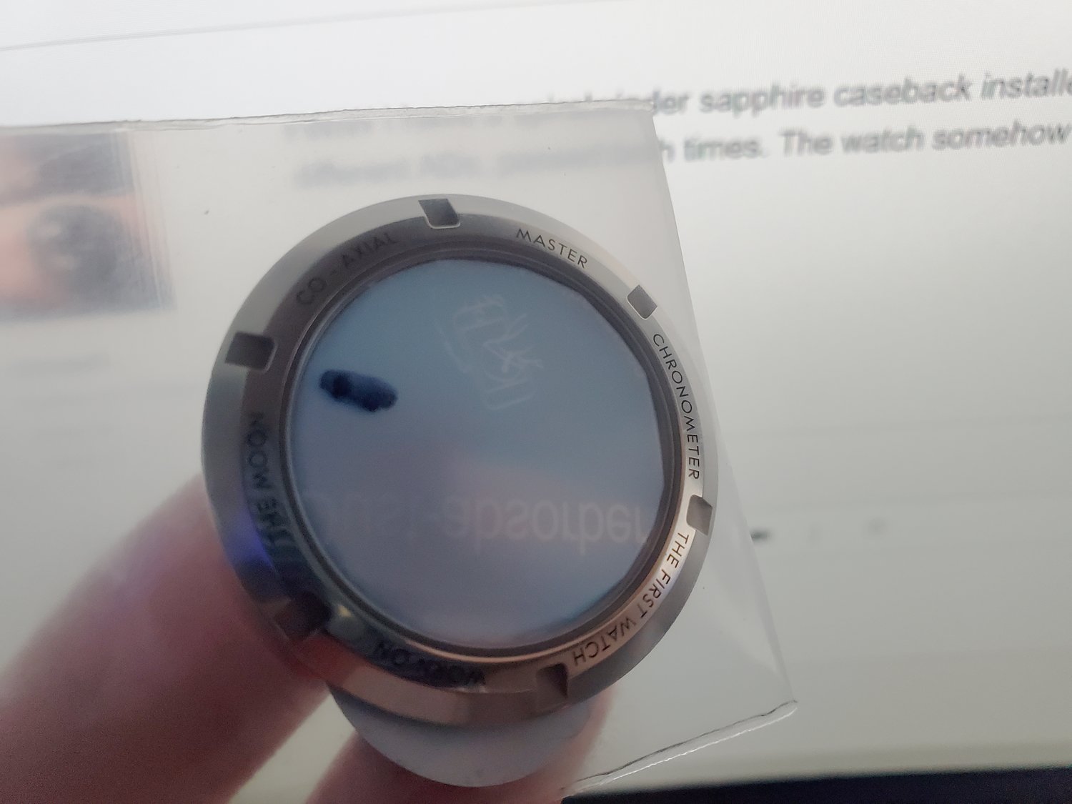

I managed to snag a genuine sapphire 3861 caseback from a seller on eBay in early 2022. Apparently very hard to come by as I have not seen another anywhere. Was going to buy a hesalite Speedy but then the issue with the 3861 bushing came out and I decided to wait. Now that time has passed, most new Speedies won't have this issue and as a bonus also come with the adjustable clasp. I'm just waiting for a good deal to pull the trigger then install this 😀
From the videos I've seen of people installing the Spiralwinder caseback on the hesalite model, it looks identical to the sapphire in that it is also set up to have 2 caseback gaskets. On the 1861 model, if you want to modify it with a genuine sapphire caseback, you would have to get a second gasket as well as replacing the movement ring (spacer?).
Great find! You'll have to post photos when you have it on your 3861! It's great that it is basically a 1:1 swap unlike on the 1861 with the movement ring etc. Did you happen to get a part no on the caseback when you bought it by any chance?
I'm not entirely opposed to the spiralwinder caseback/aftermarket mods for the most part. I have a number of modded Seikos with aftermarket parts. But something about a $100 caseback on a $7000+ watch just doesn't feel right. If I can get the genuine Omega part I'd happily a few extra bucks to keep it all-Omega.
