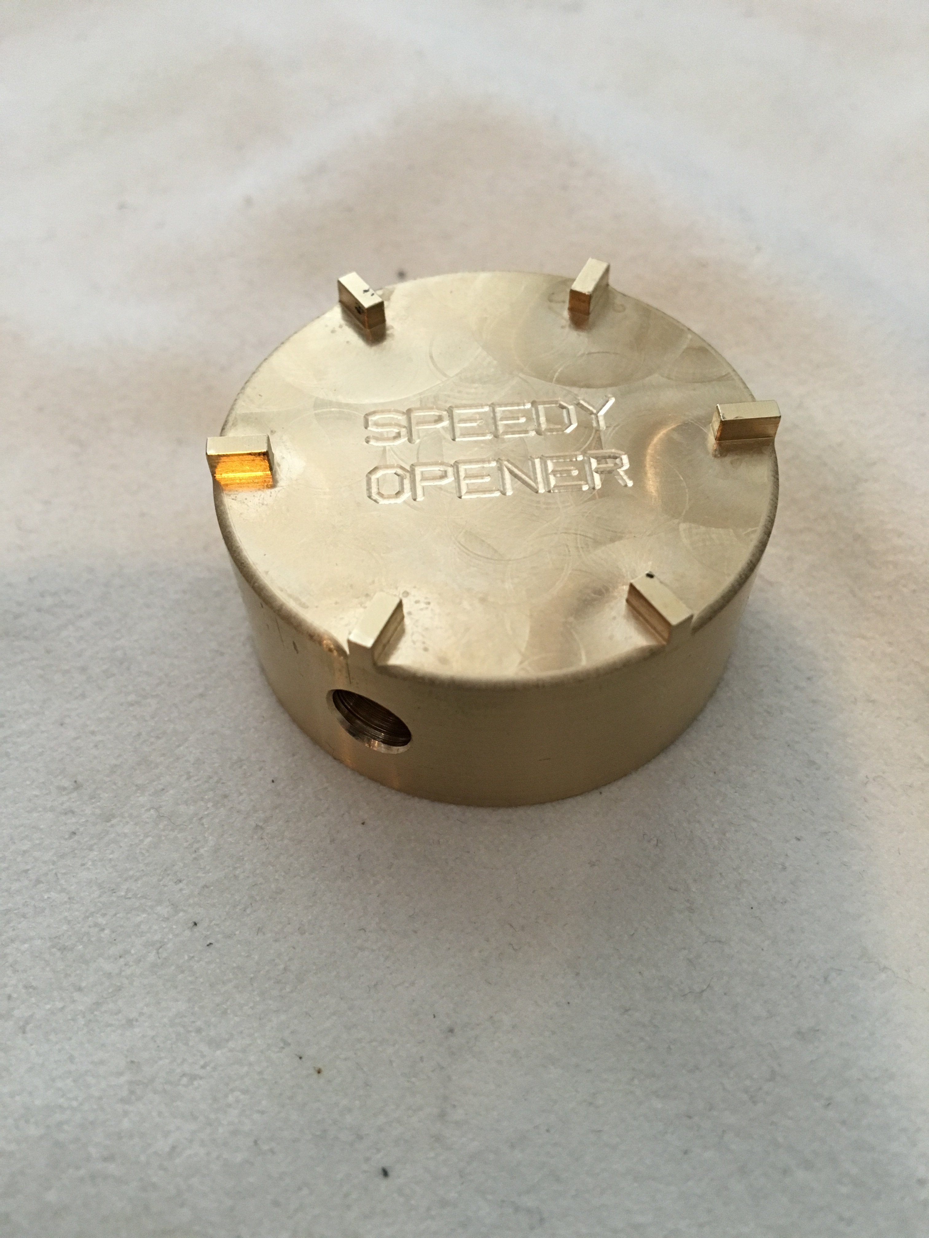

I’ve been using my Pahawi case opener on my Speedmaster, which I really like.
I had my Speedmaster at the watchmaker, and noticed he was using a three-prong tool similar to this one, with a handle to open and close the case back:
When I got the watch home, I realized I forgot to ask him to record the movement number, so I went to open it with the Pahawi. It was really difficult. When I closed it up again, I was certain that, while firm, it was very likely not as tight as the watchmaker left it.
This type of tool I also see used by professionals. My guess? Again, it offers greater torque than the Pahawi.
So the question is, how tight is really needed? I guess there are torque specs somewhere, but in lieu of that, does my little palm device, without as much levels the others, close the watch case tightly enough?
2,442
4,228
O-rings are marvelous, and protect against moisture with minimal torque. Watchmakers routinely over-tighten casebacks, for reasons that elude me. Reasonable hand-tightening using the Pahawi opener is quite sufficient.

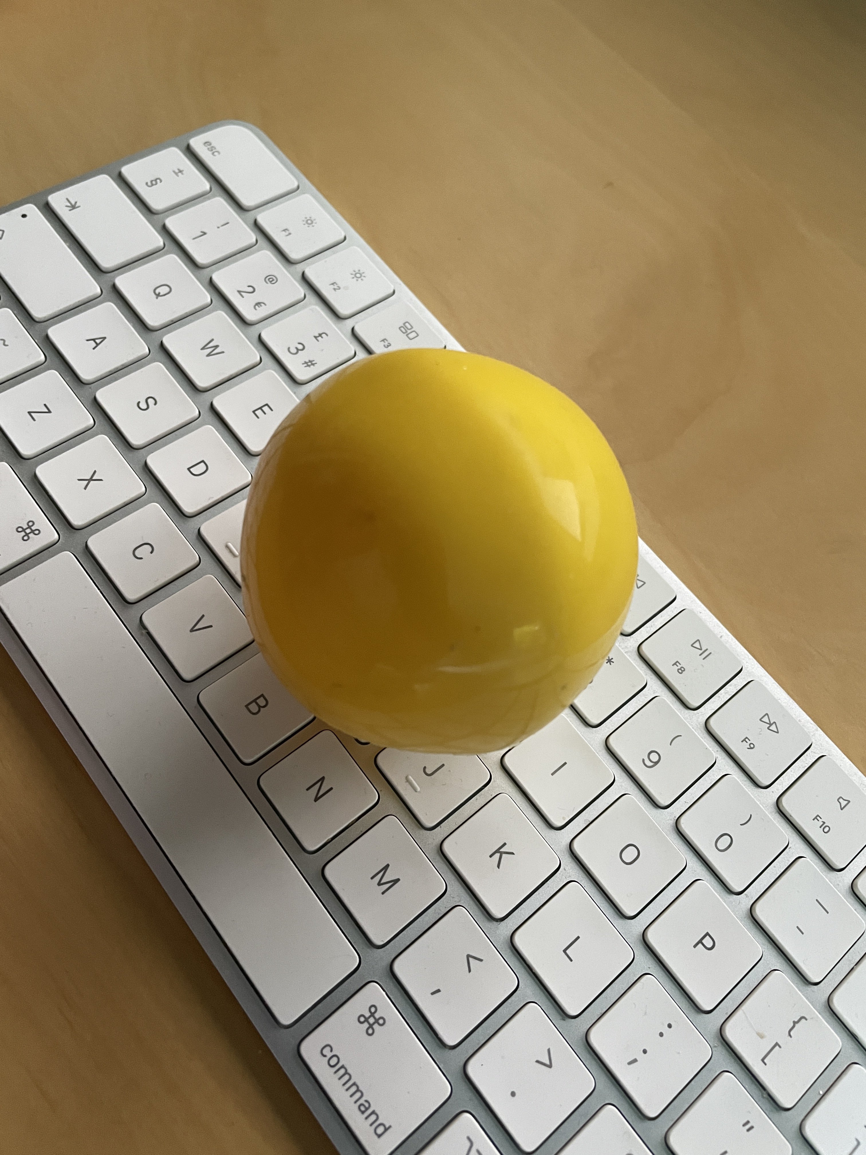

Sticky ball can occasionally work wonders without the risk of causing any damage,
