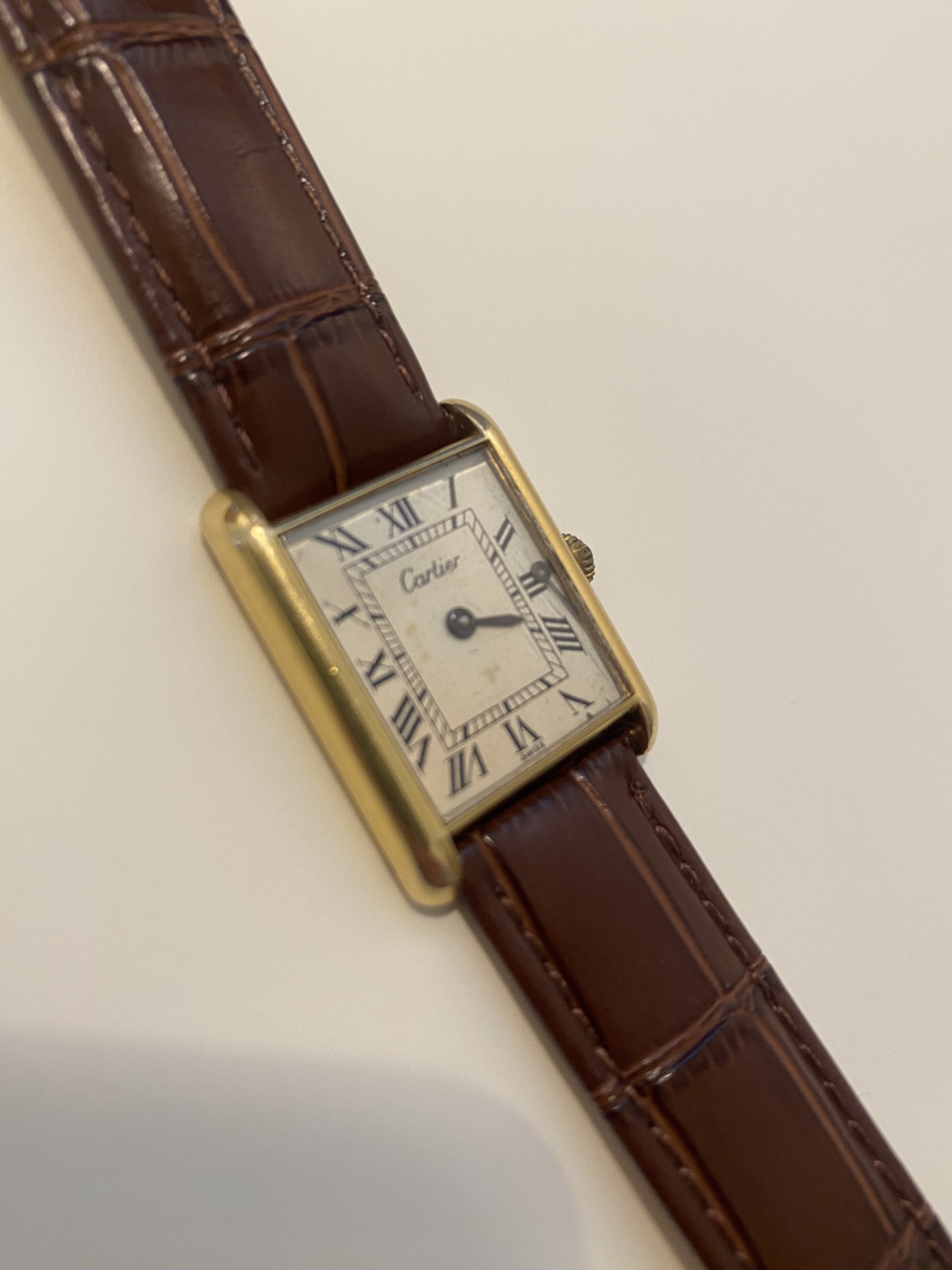

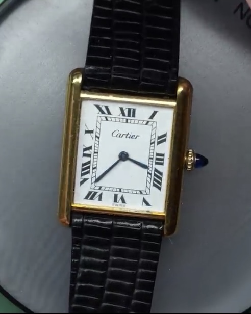

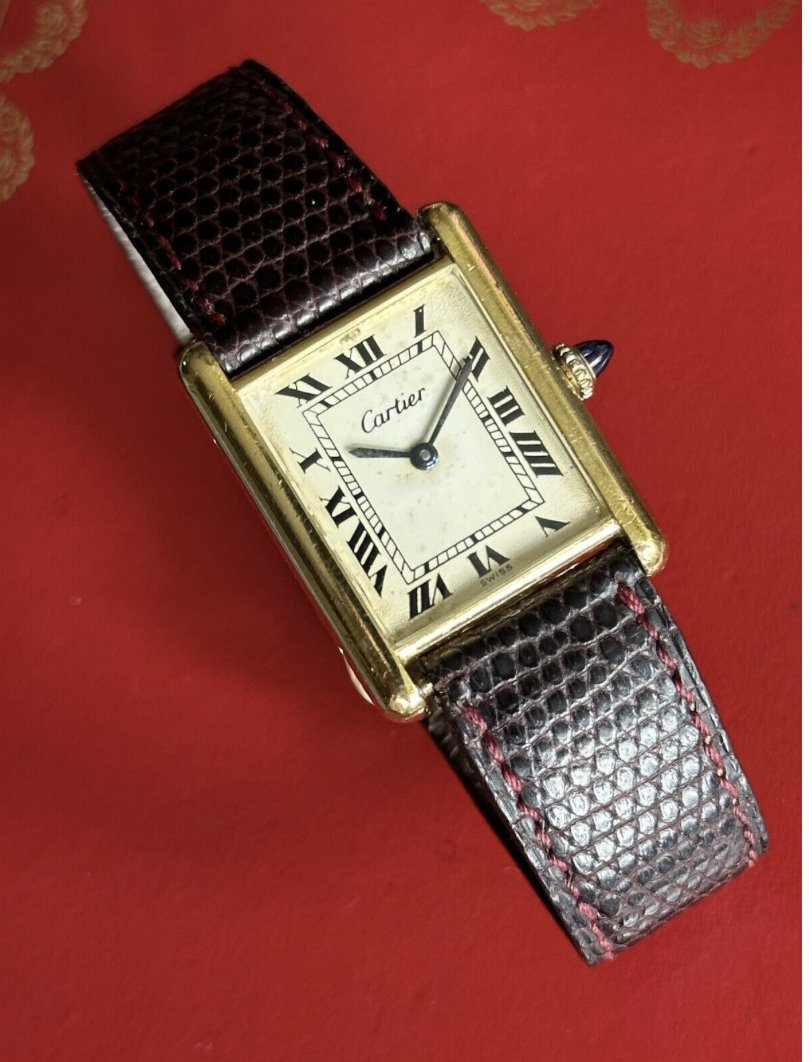

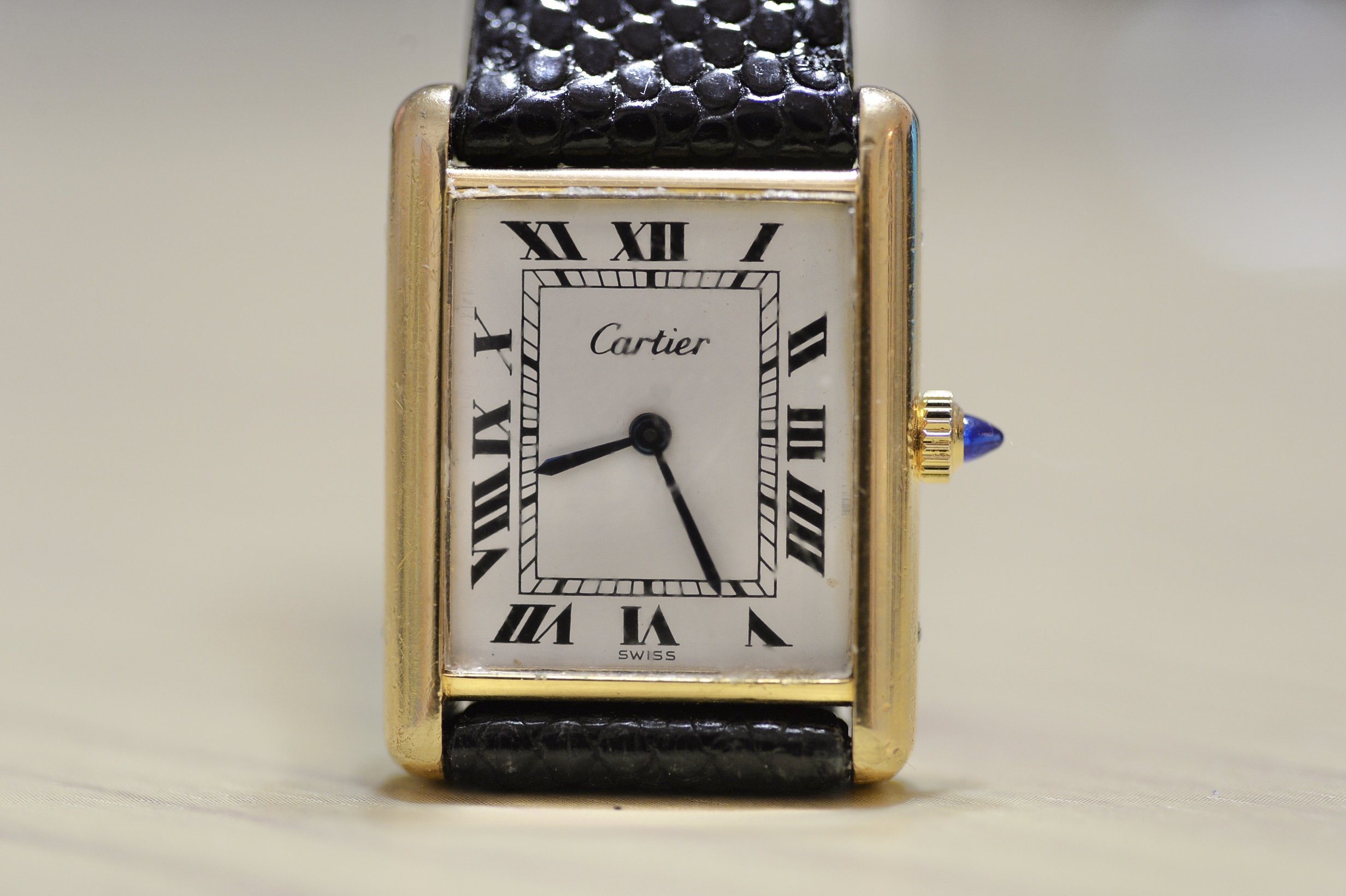

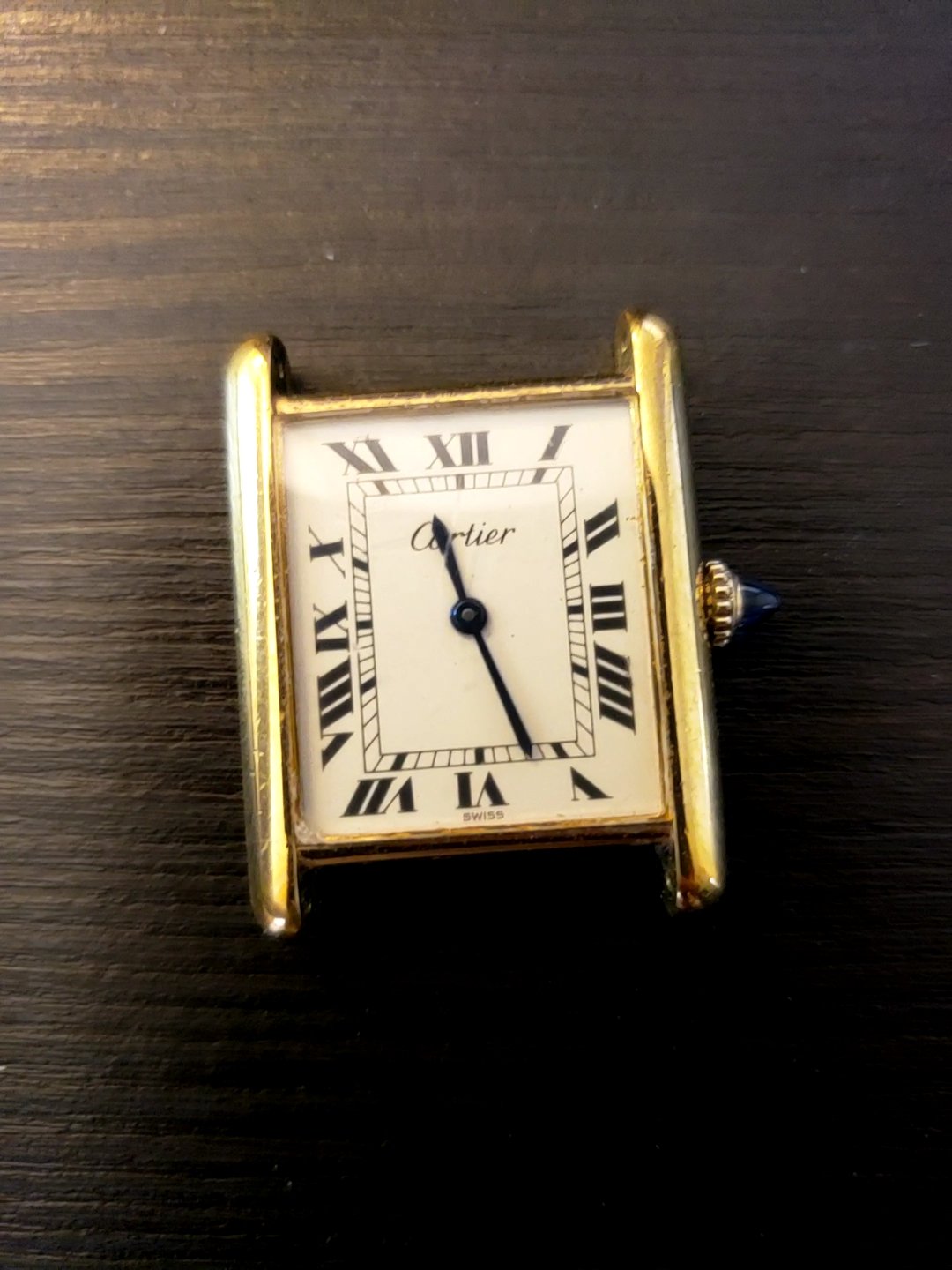

I recently acquired a ‘Pre Must’ Cartier Tank Louis with reference no. 15705 that I believe dates back to the early 1970s. It was made during the time when the Cartier boutiques were operated separately in New York, Paris and London.
I would love to know more about this watch so if there are others out there who own this piece, please share some photos and information on when and where it was purchased! I am no expert so all the information that is written in this post have been compiled after hours of research.

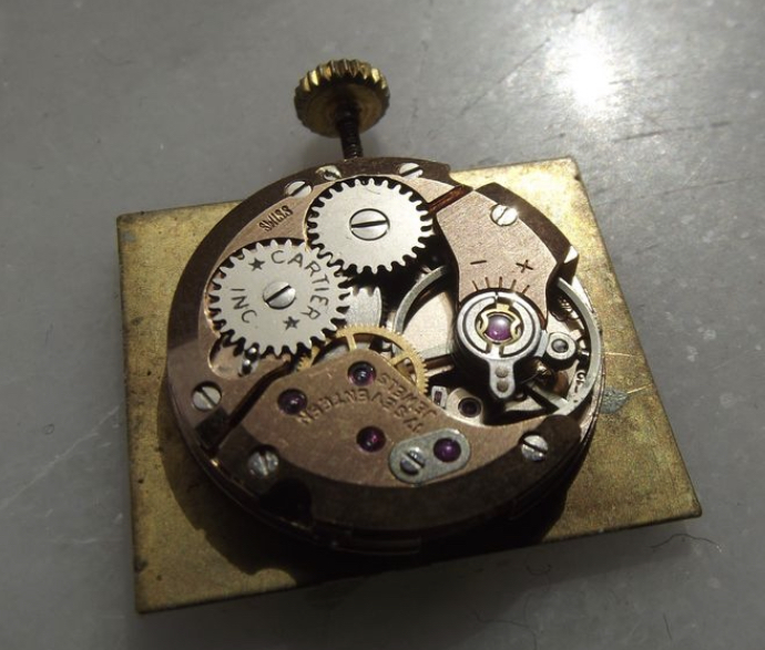

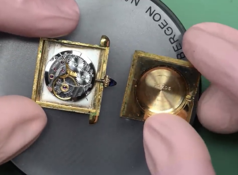

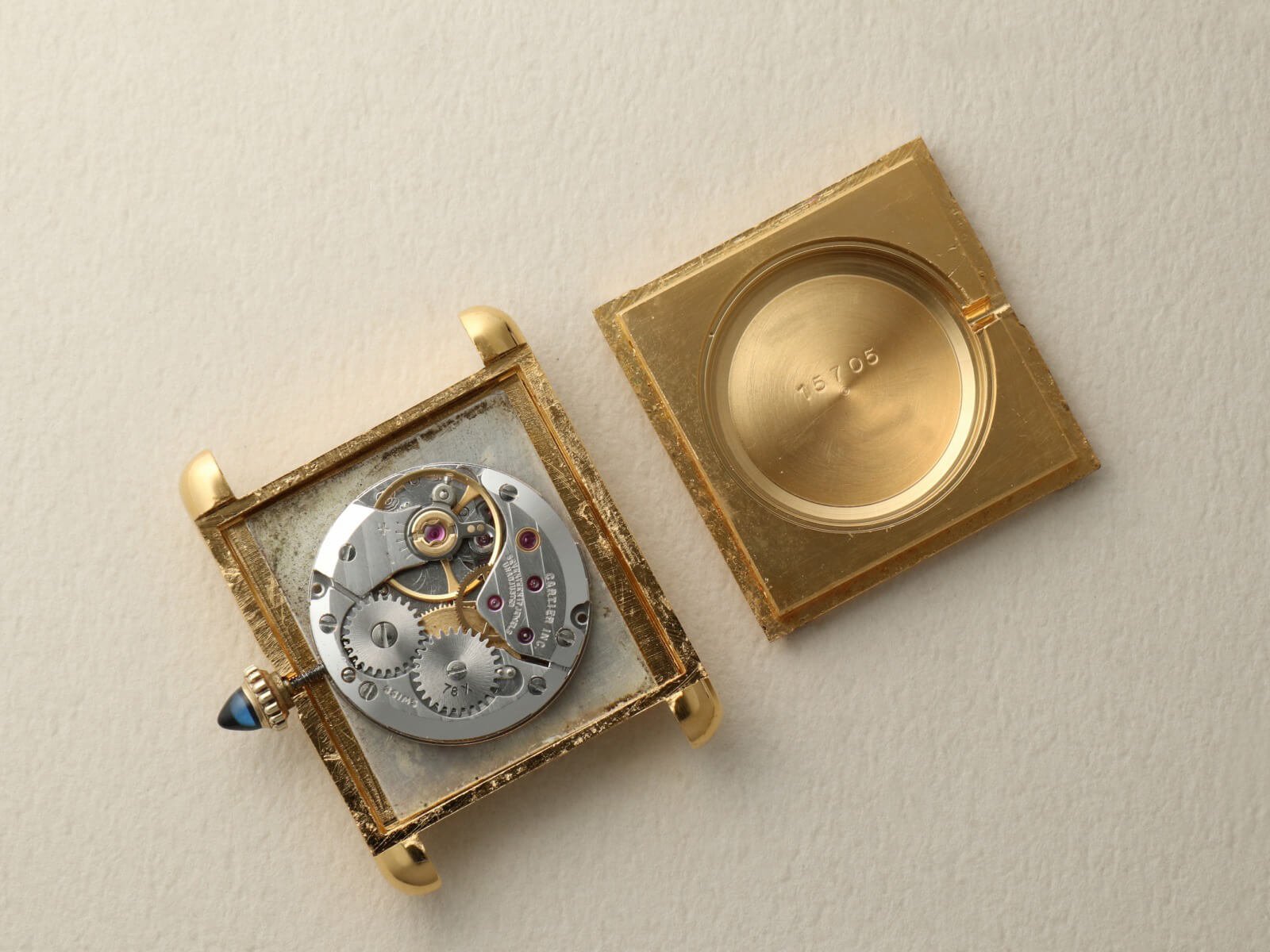

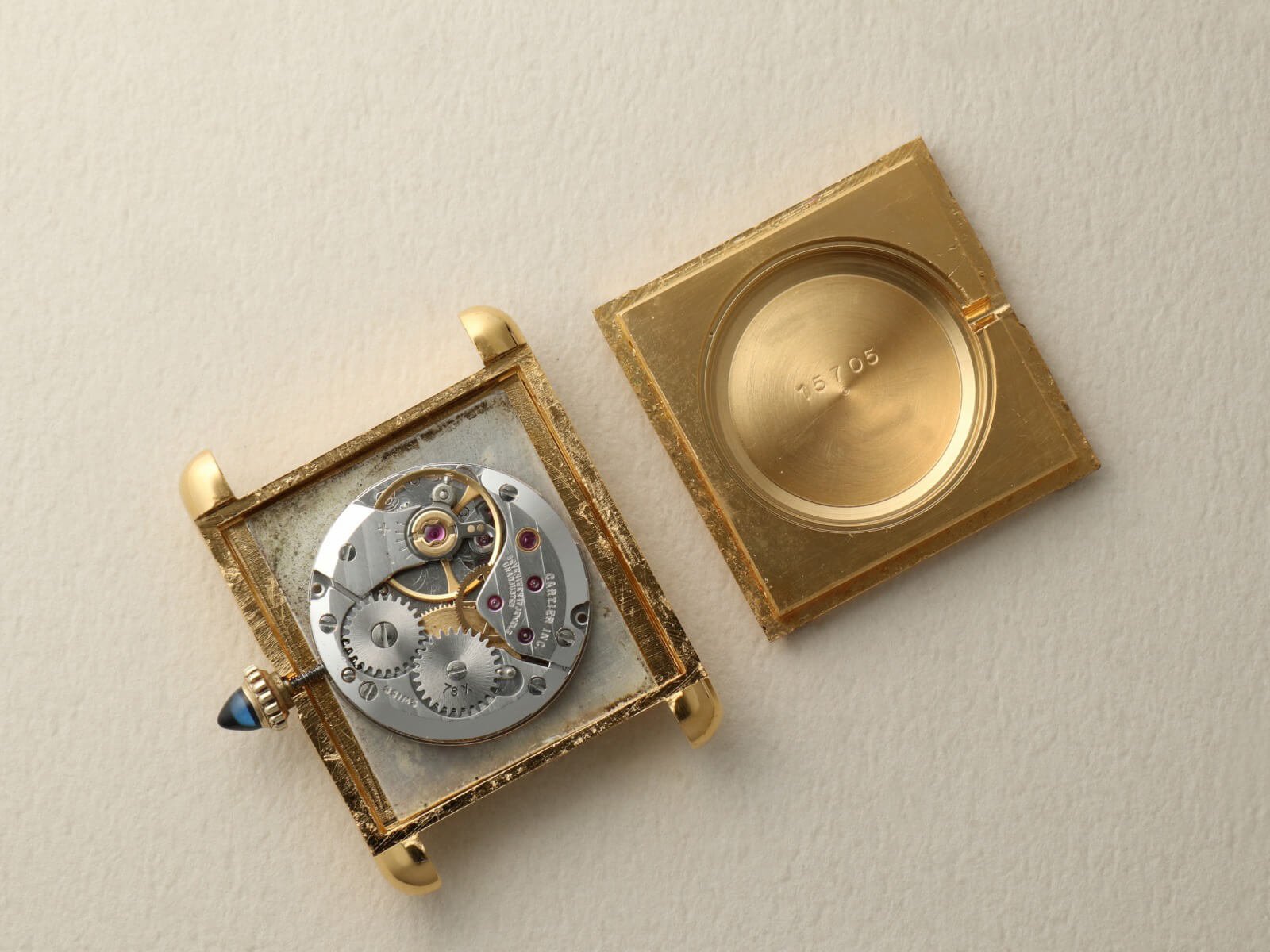

This Pre Must Tank has a manual wind Cartier 78X movement (ETA 2512 base). Later manual wind Must models from the late 1970s use the Cartier 78-1 movement (ETA 2512-1 base) instead.
Its size is approximately 30mm height by 23mm width excluding the crown, making it the model for men at that time.
This post only includes pictures of pieces with screw on case backs and punched logo, which is said to be from the New York boutique. Pieces with snap-on case backs have been excluded as they seem to be far more common.

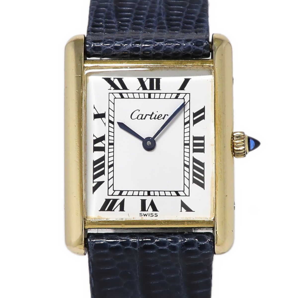

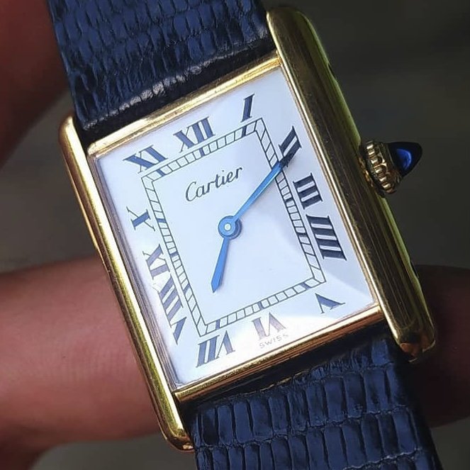

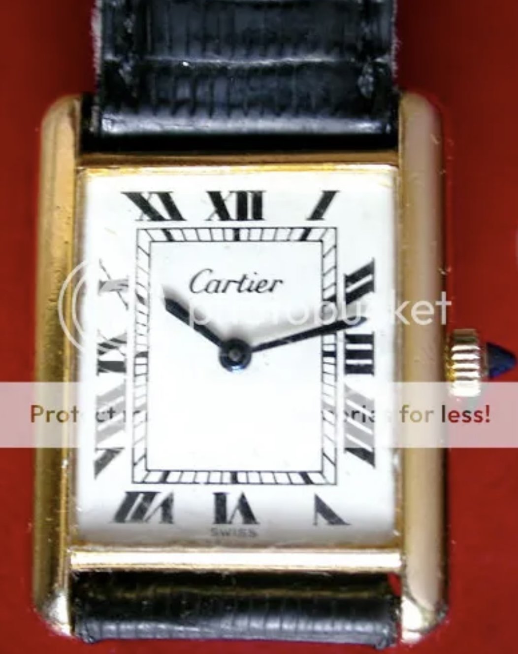

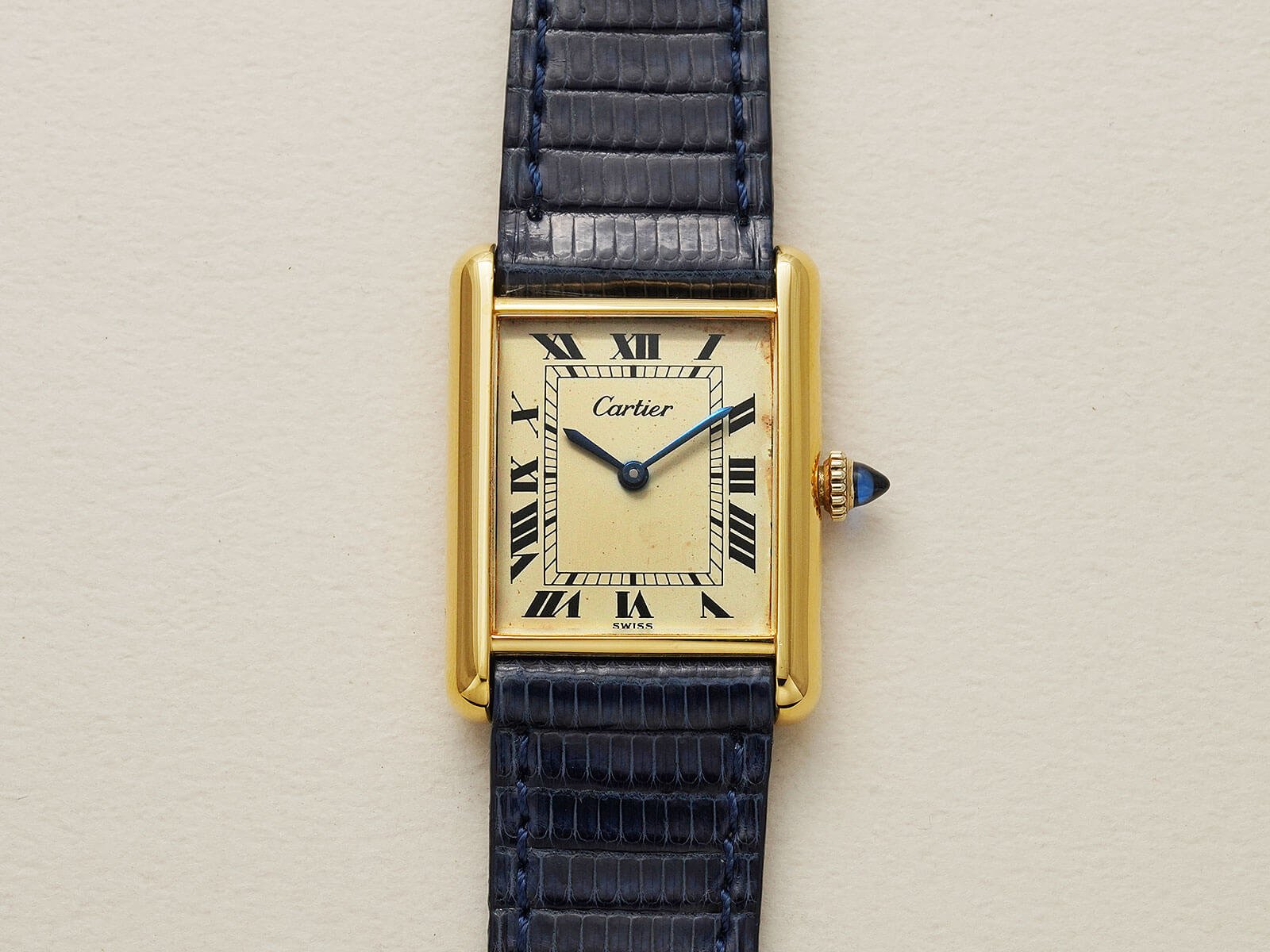

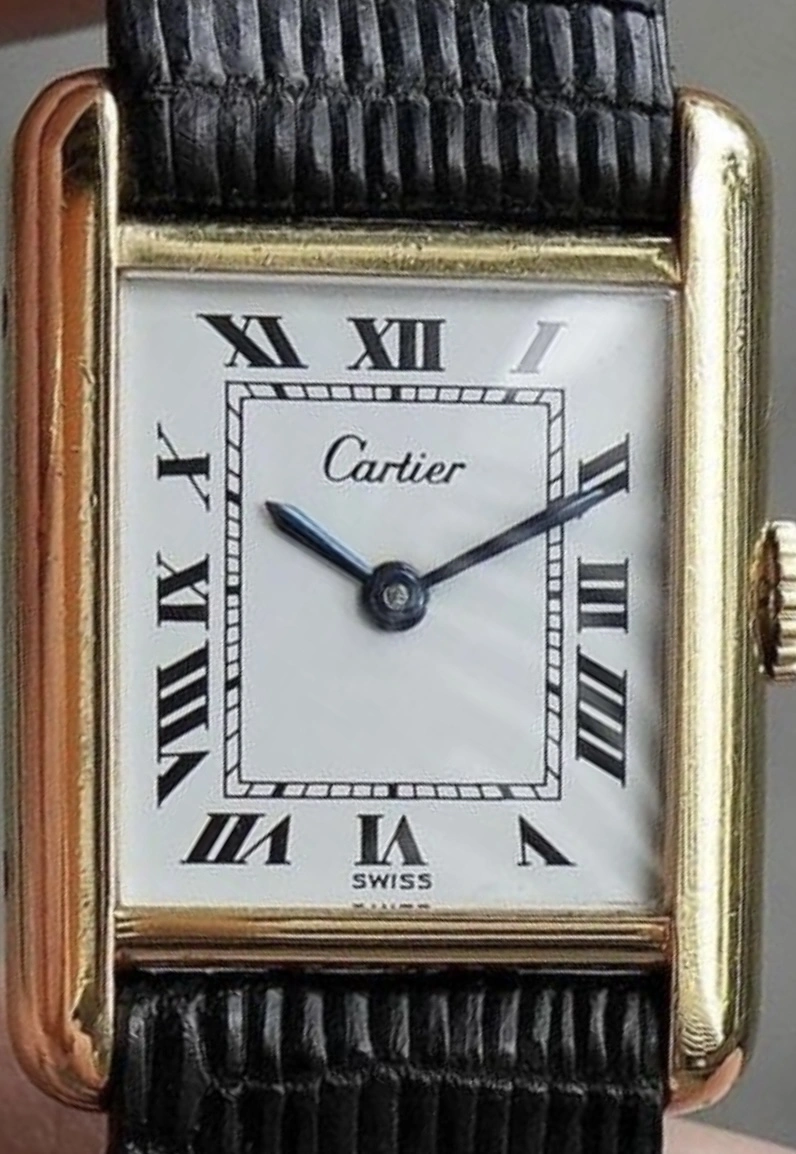

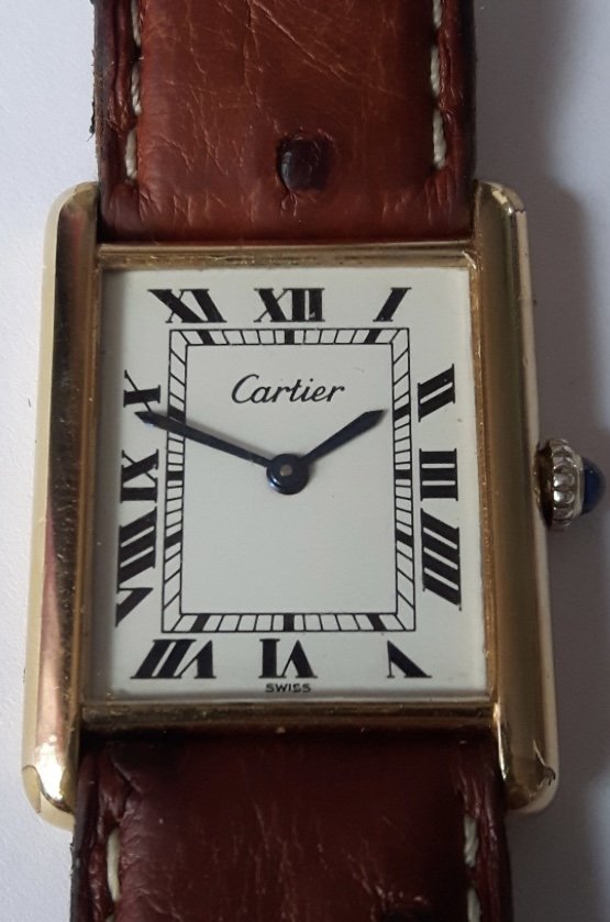

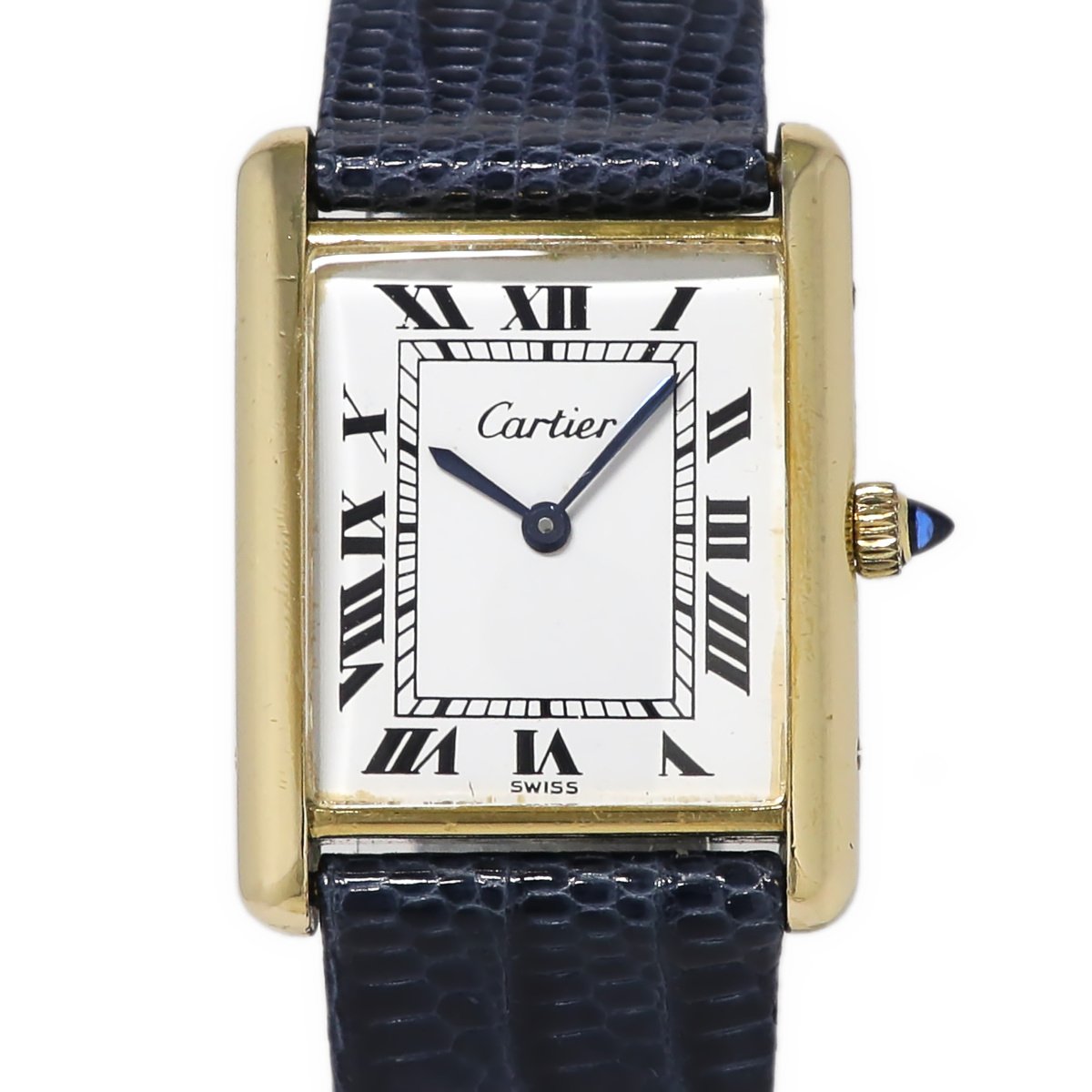

- White dial with SWISS under VI

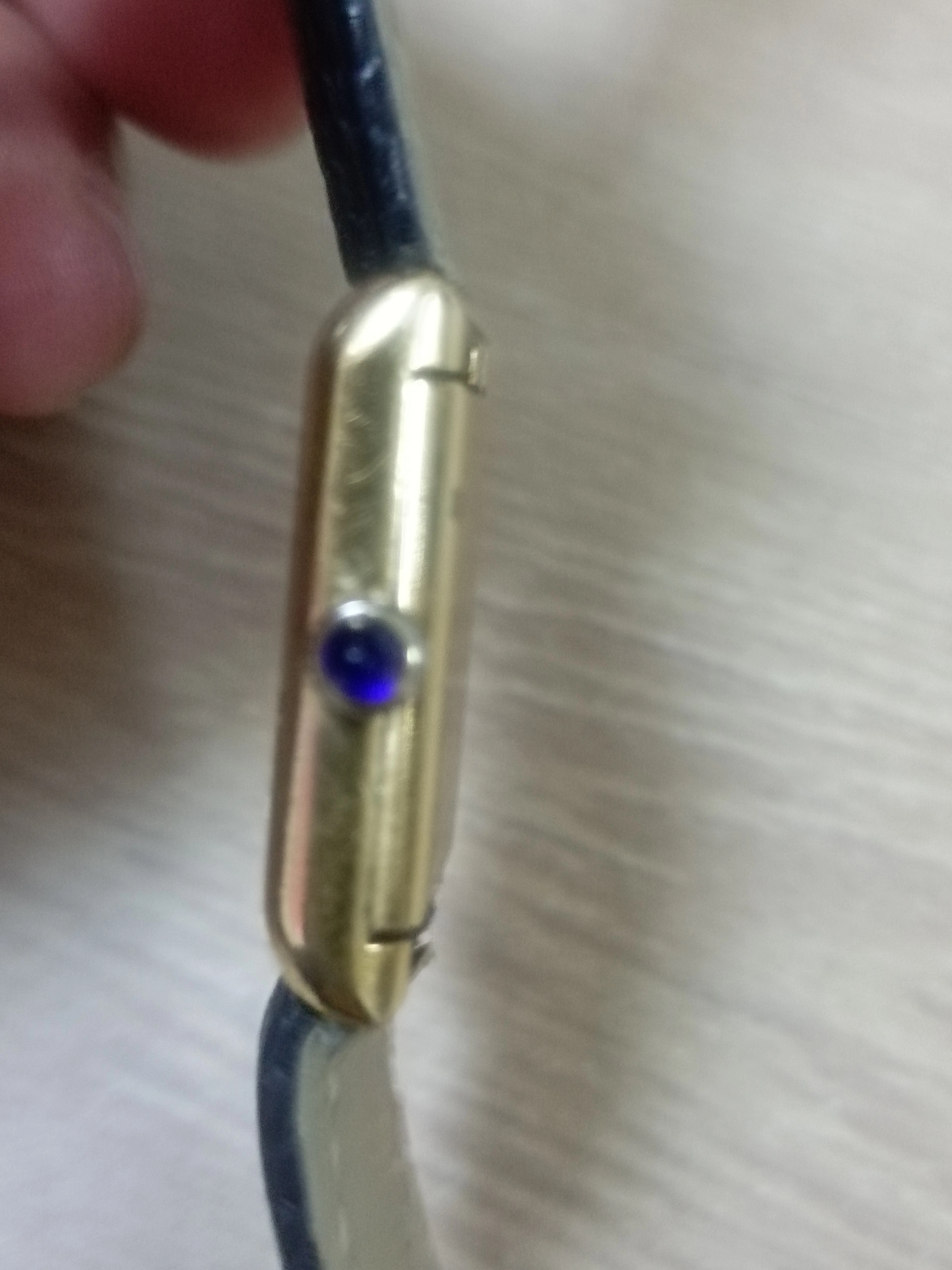

- Elongated blue carbochon crown
- Earlier serial numbers seem to have a thicker crown
- Unlike the Must series, there is no hidden Cartier mark on VII, or on X like other modern pieces

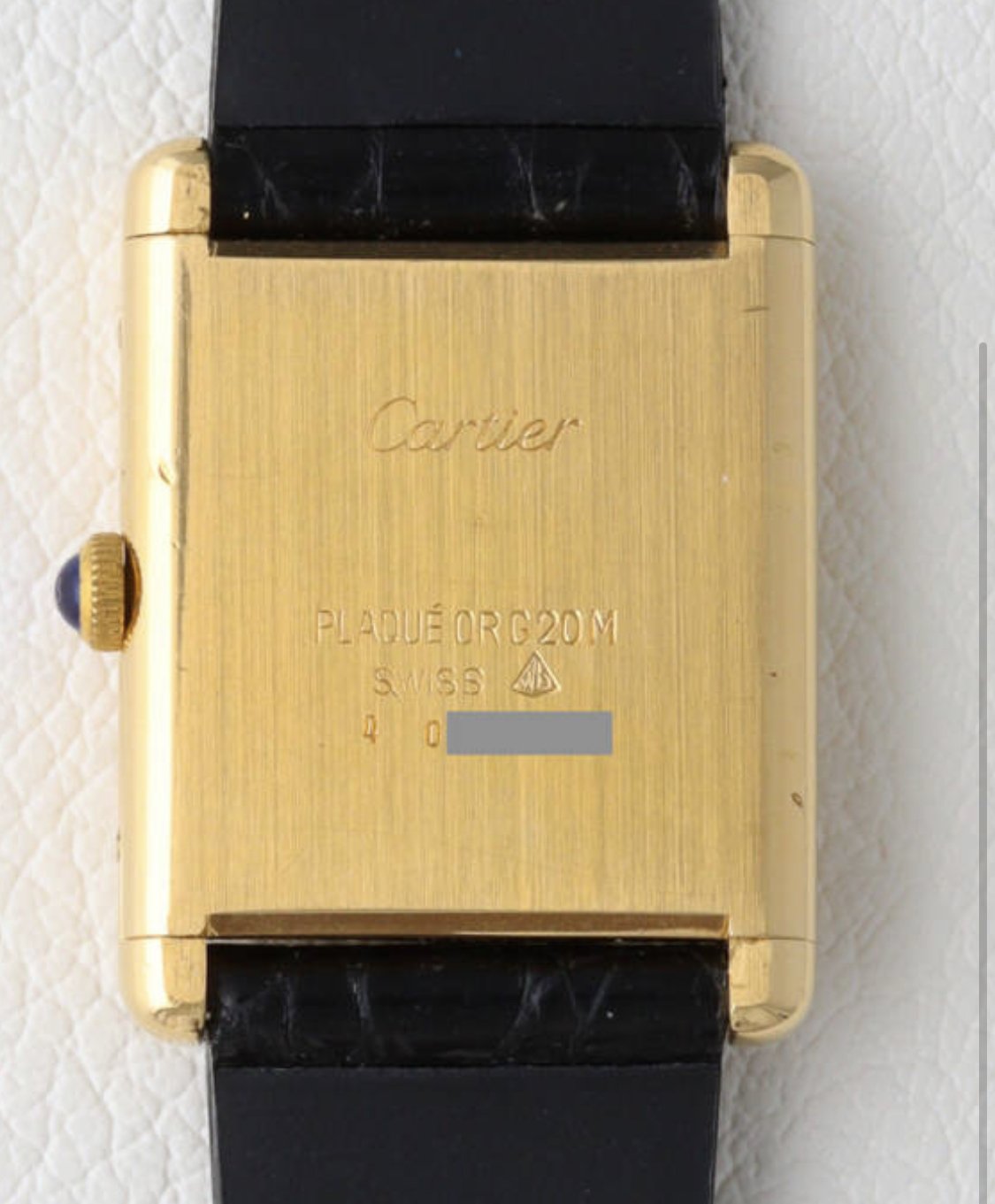

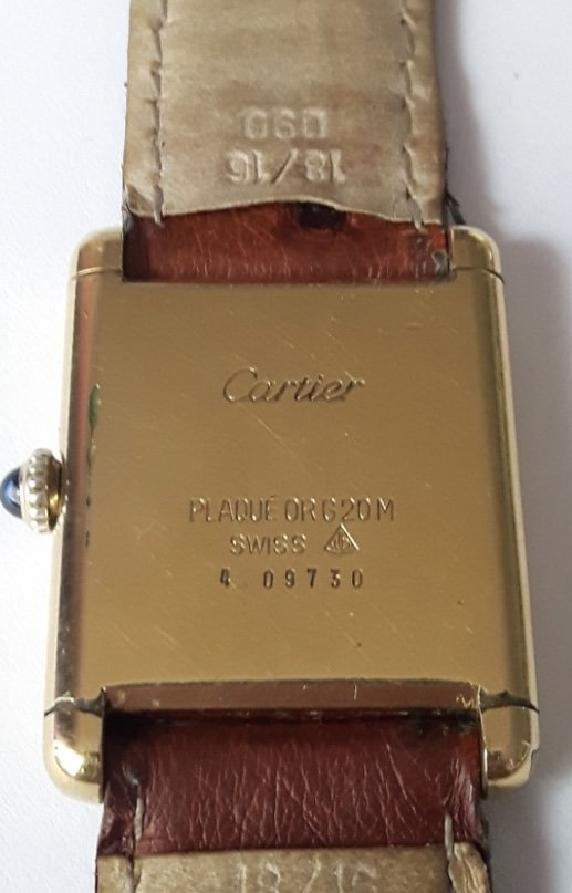

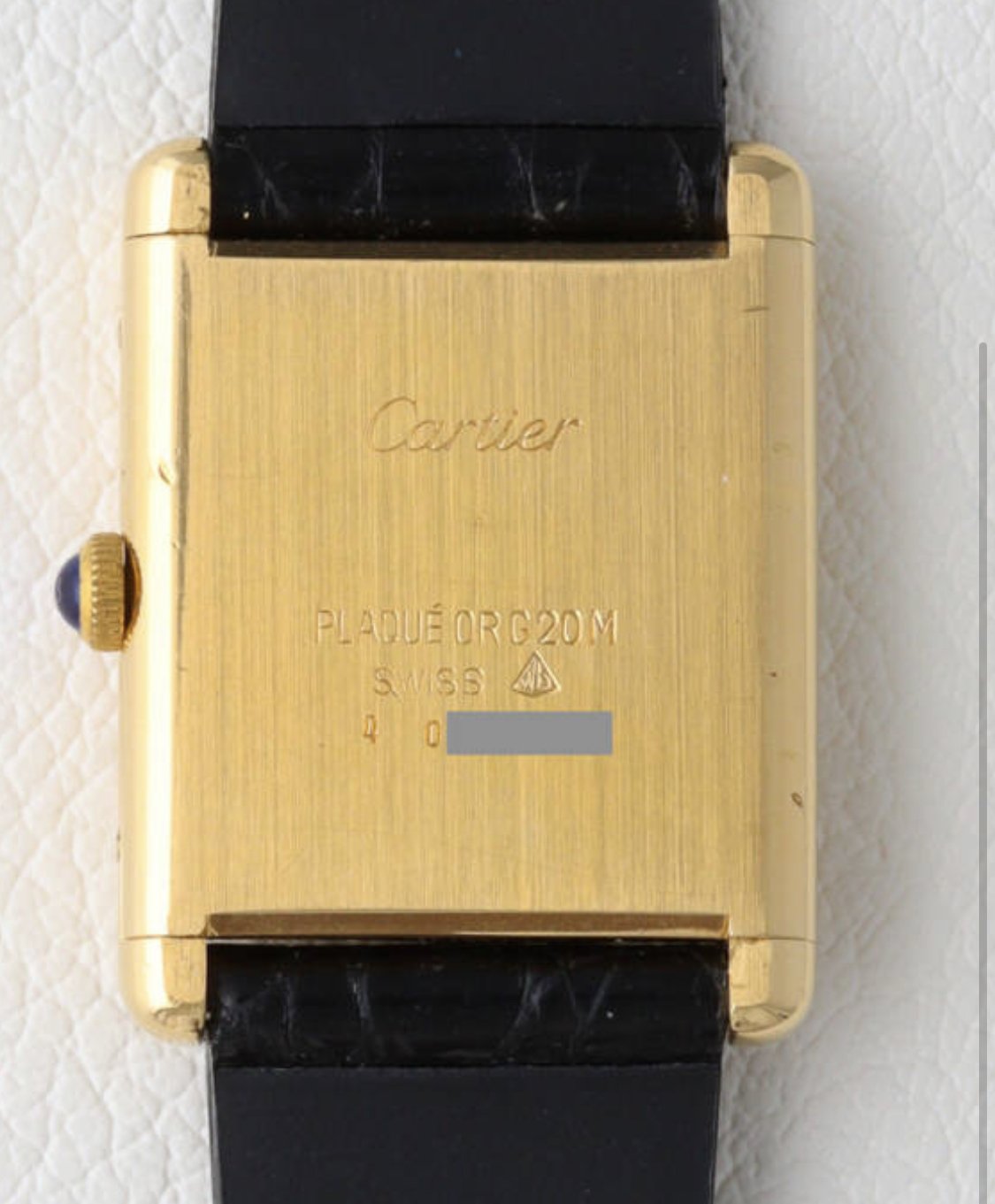

- The first number 4 on the case back seem to indicate that this is for men. The smaller sized pieces with the same case back markings start with a 1

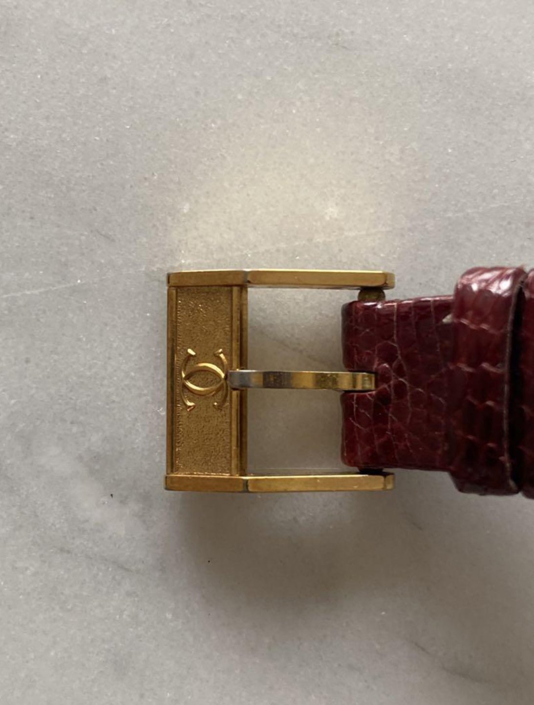

- The original buckle for the strap has a double C logo that looks very similar to Chanel

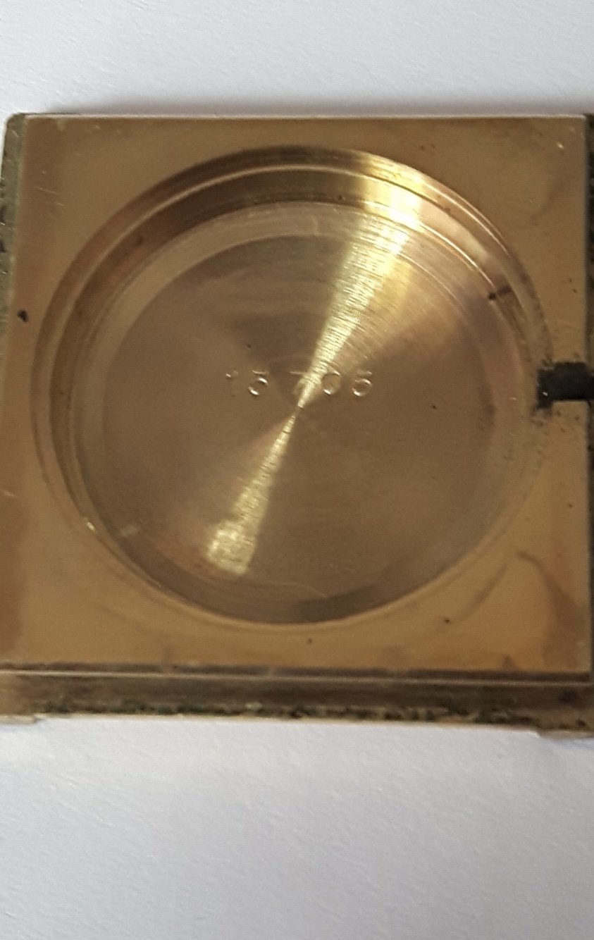

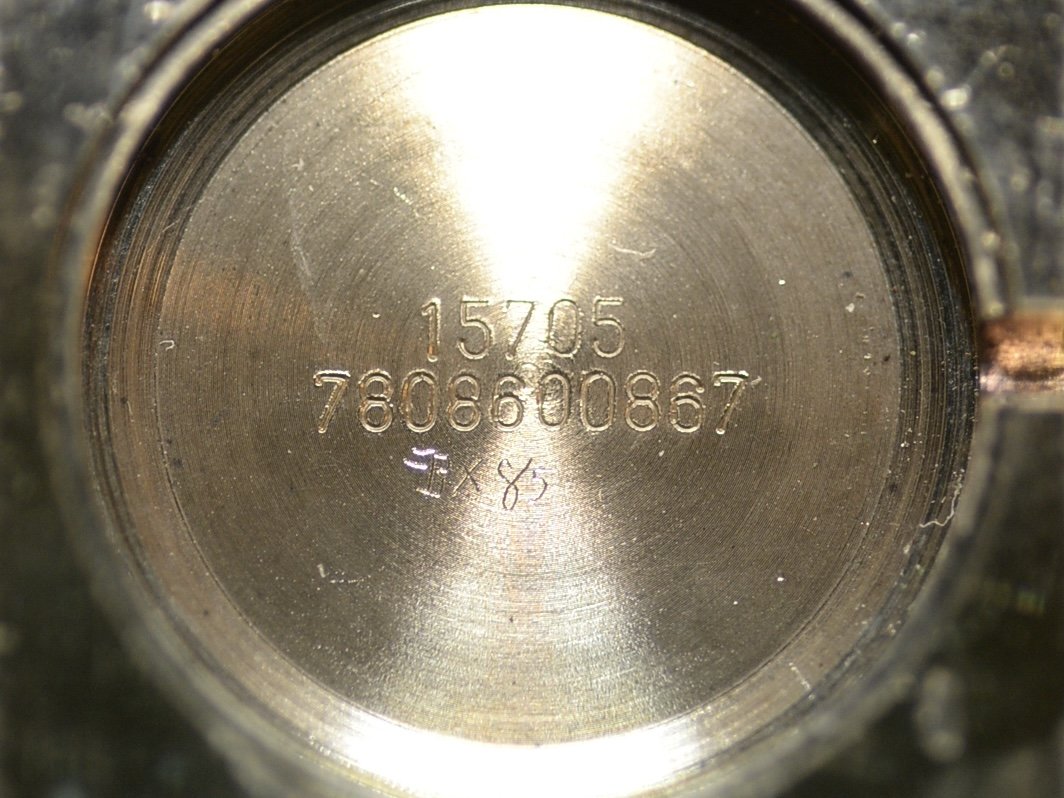

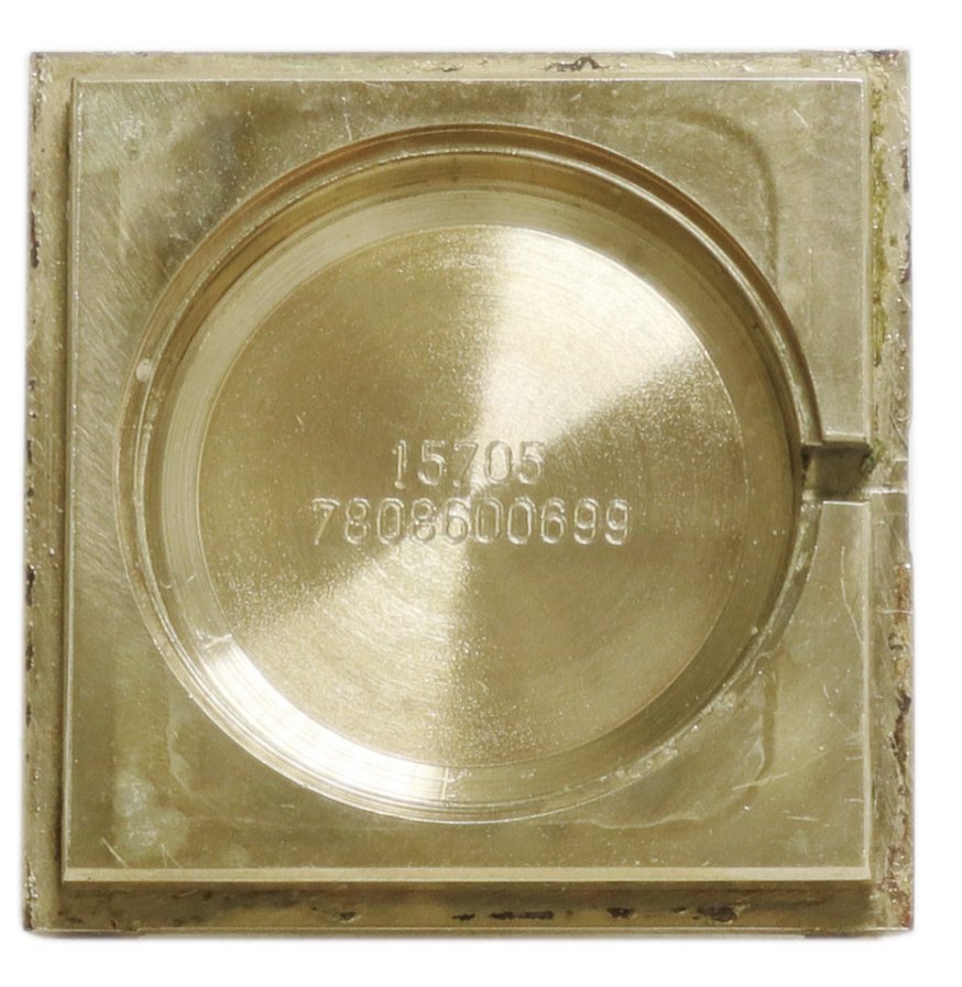

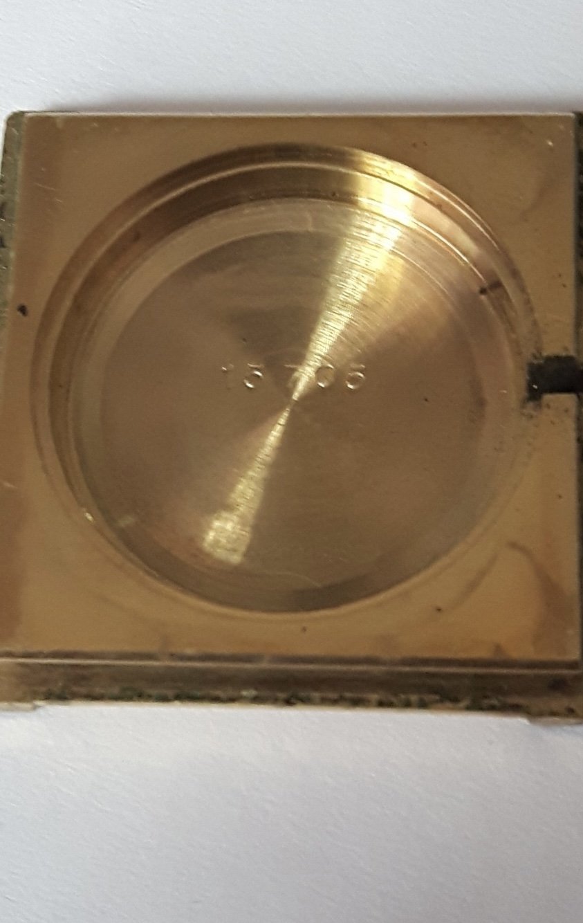

Pictures of this ref. 15705 with smaller serial numbers seem to also have a long 10 digit reference number of some sort engraved on the inner side of the case.
I only own 1 of the watches below. The other pictures were taken off of the internet.

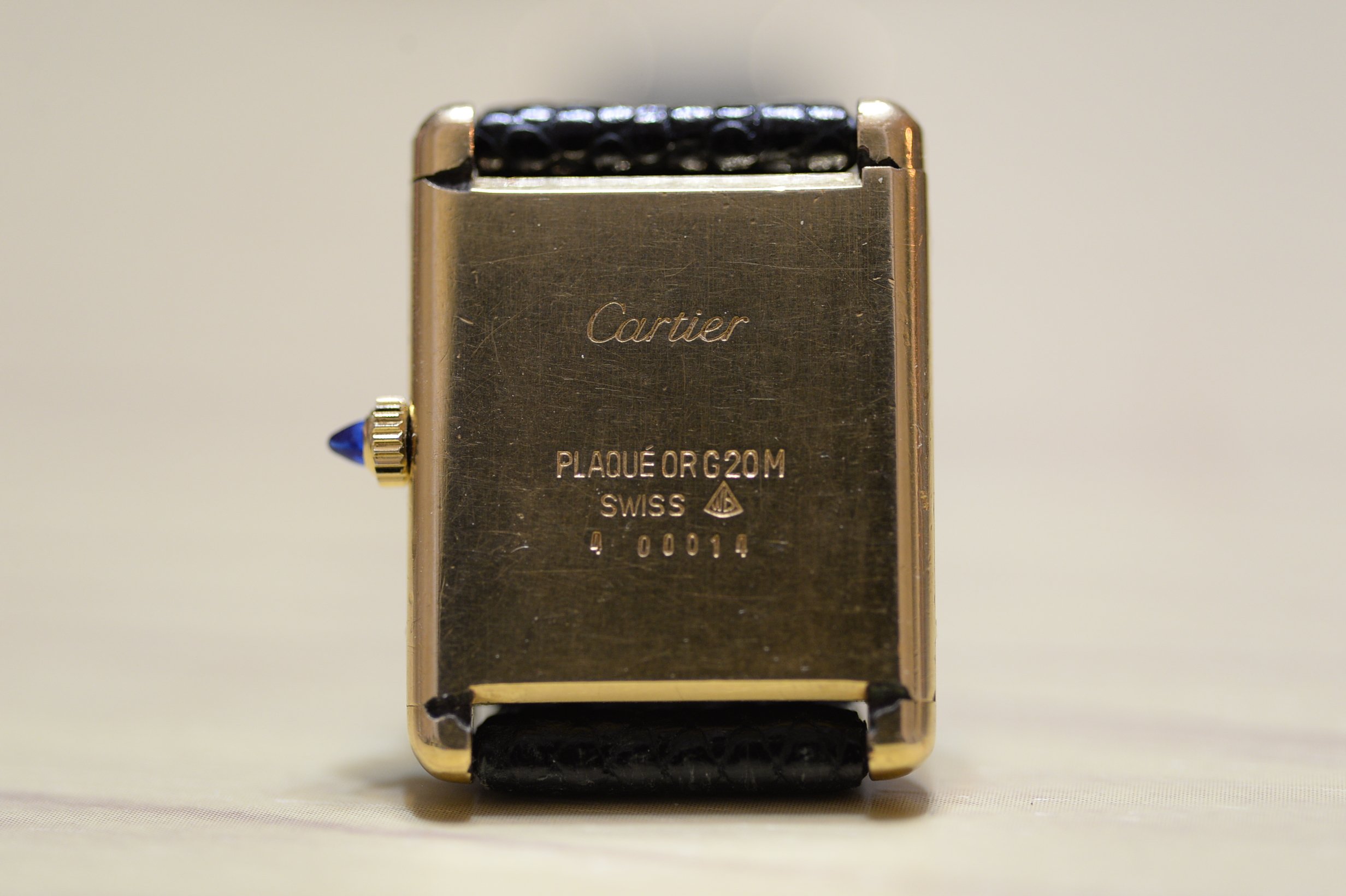

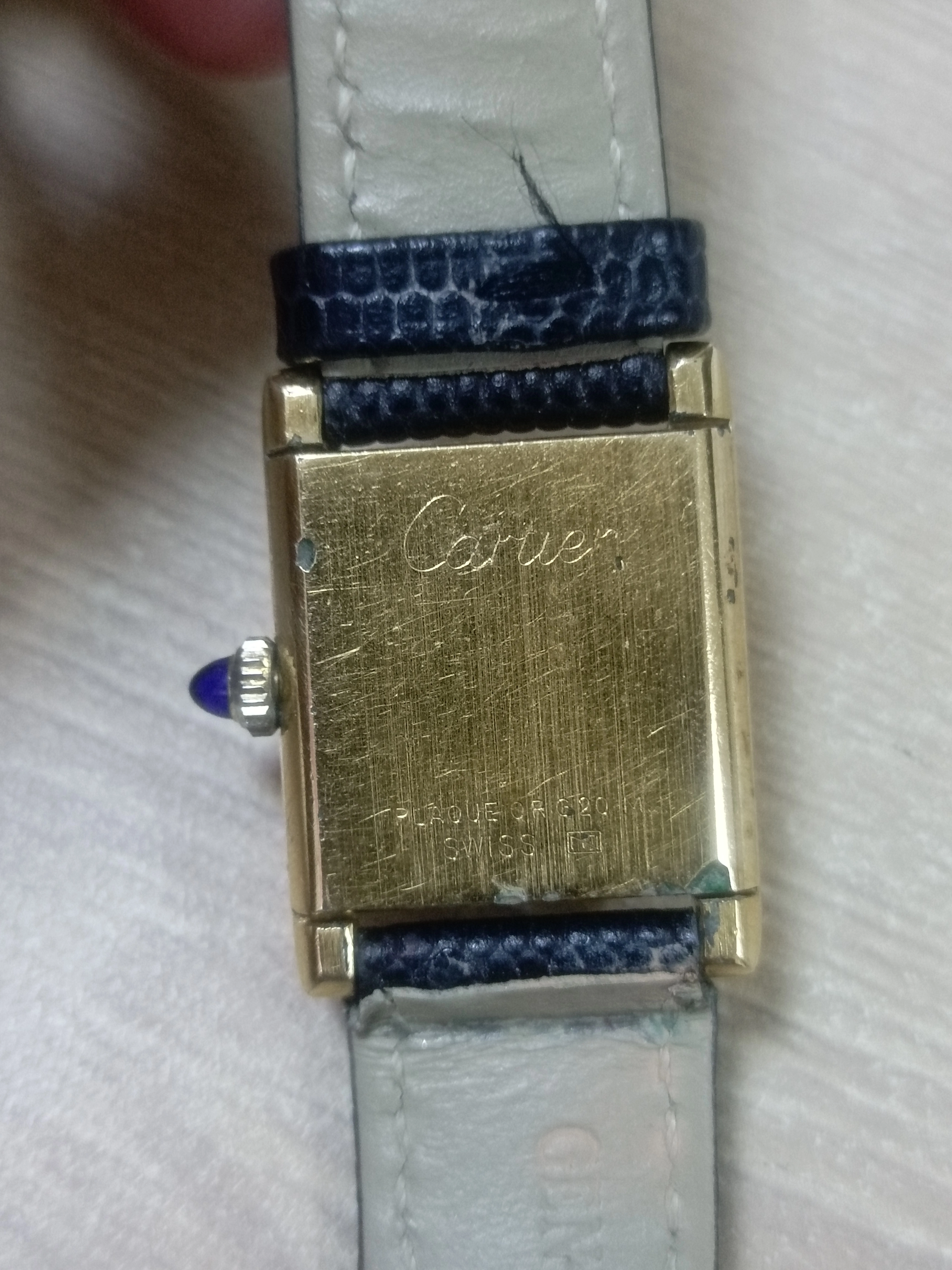

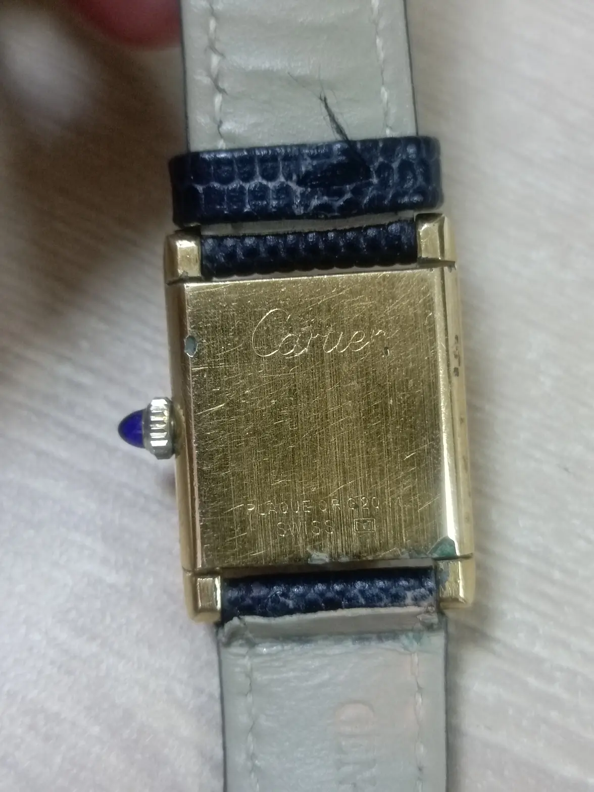

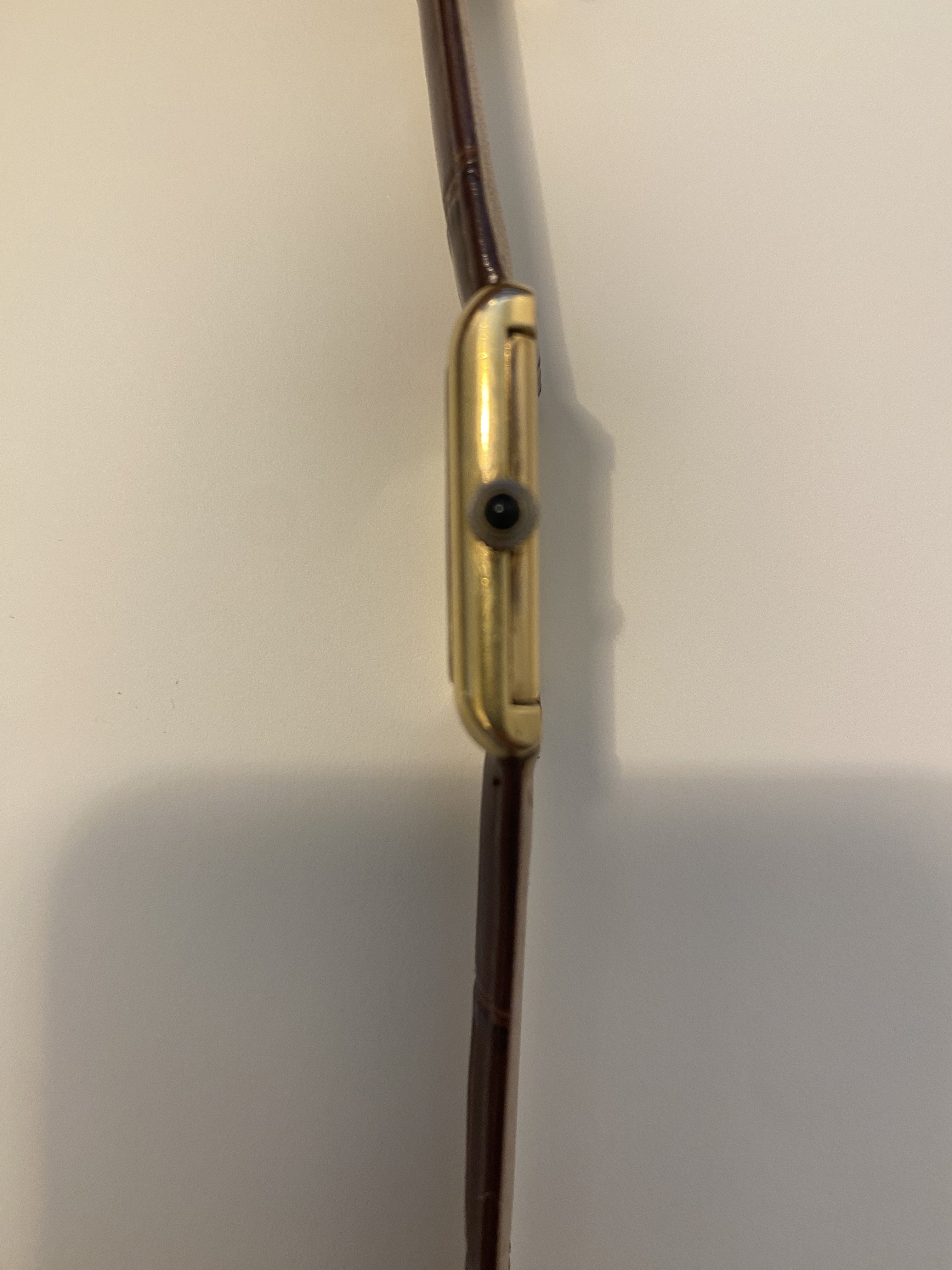

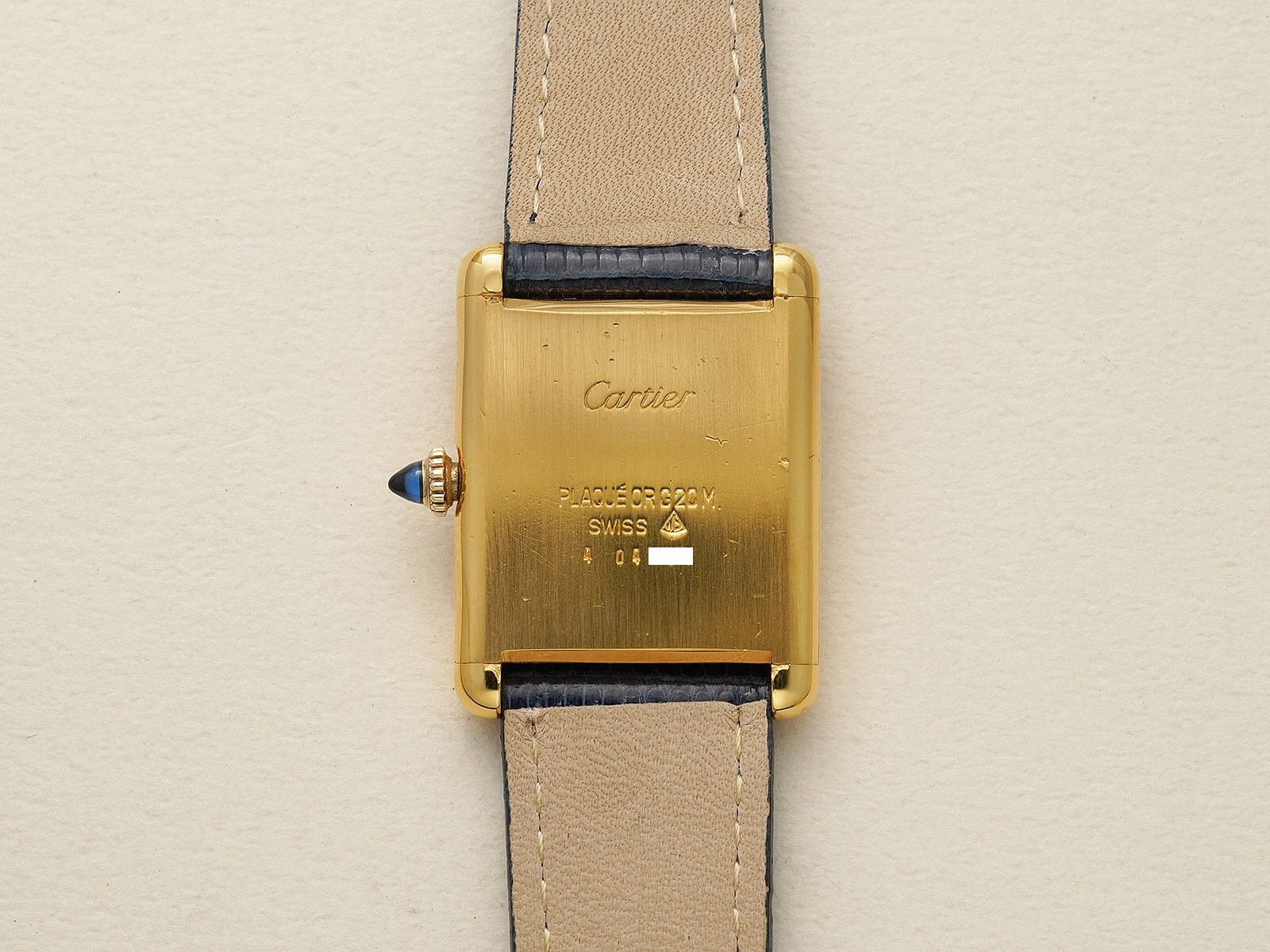

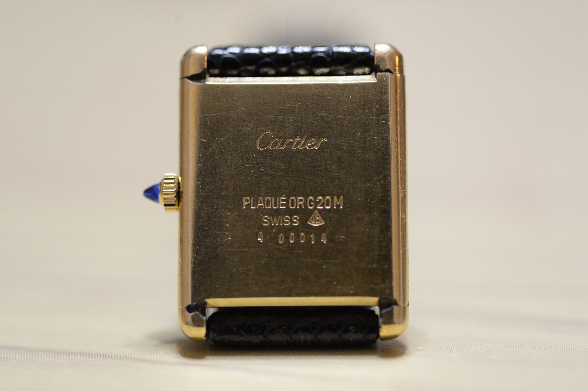

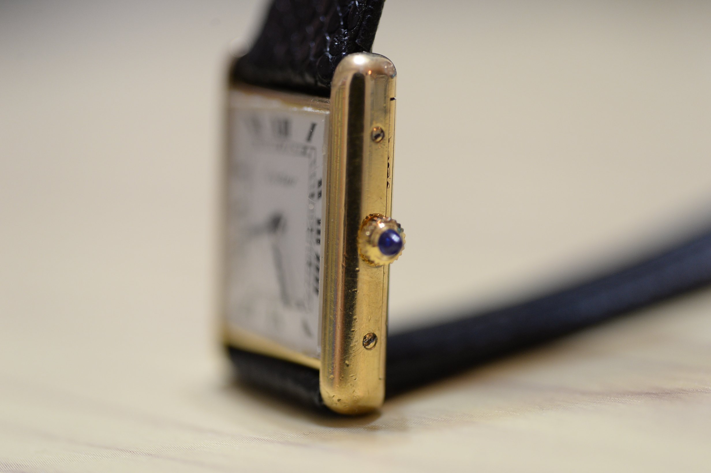

1. This is the copy I own

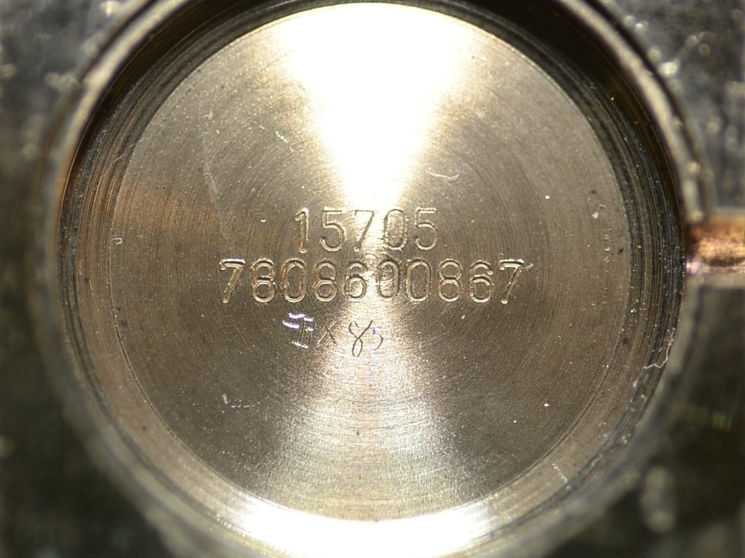

Serial number on case back: 4 00014
Innerside of case back: 15705 7808600867

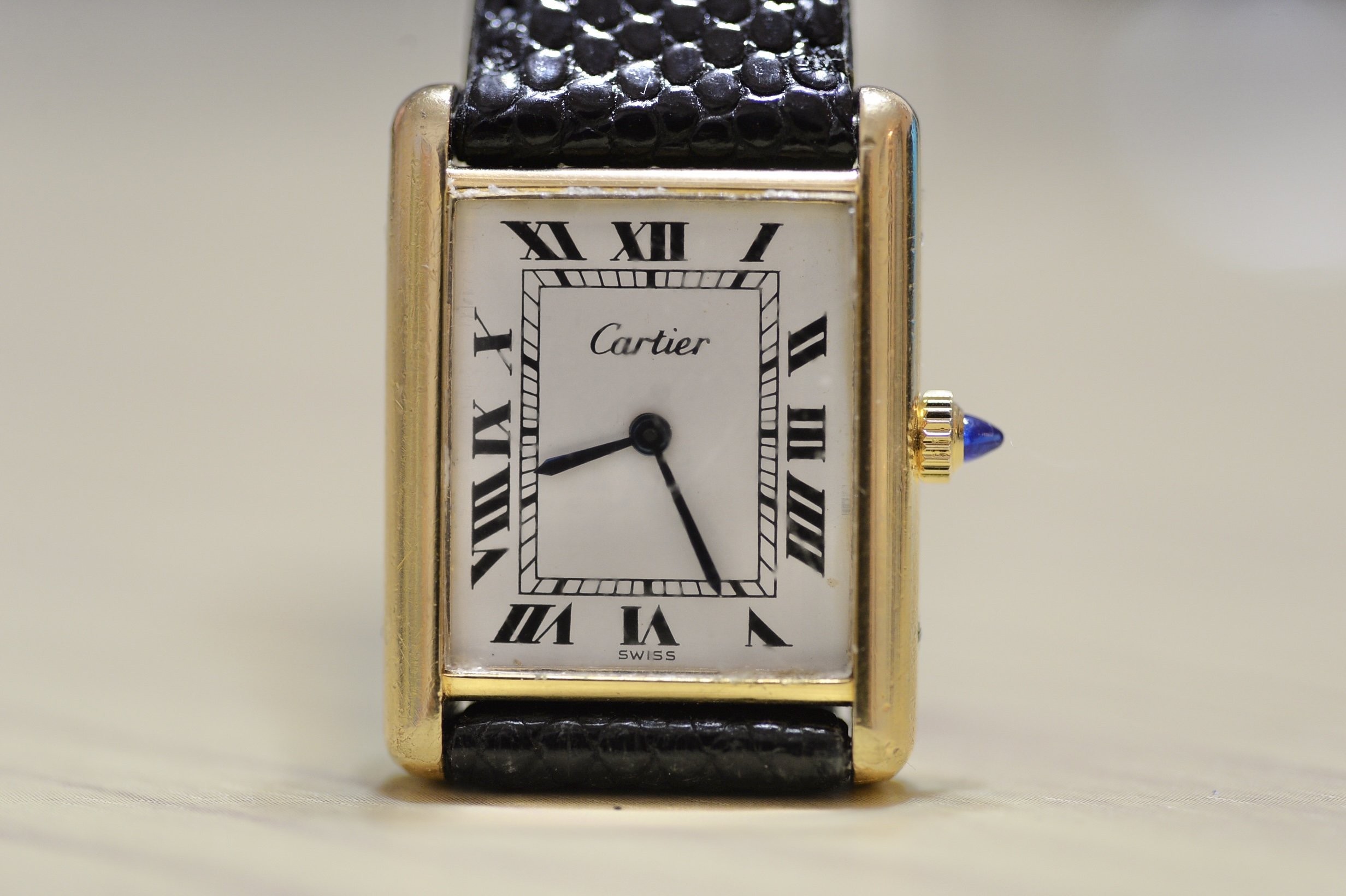

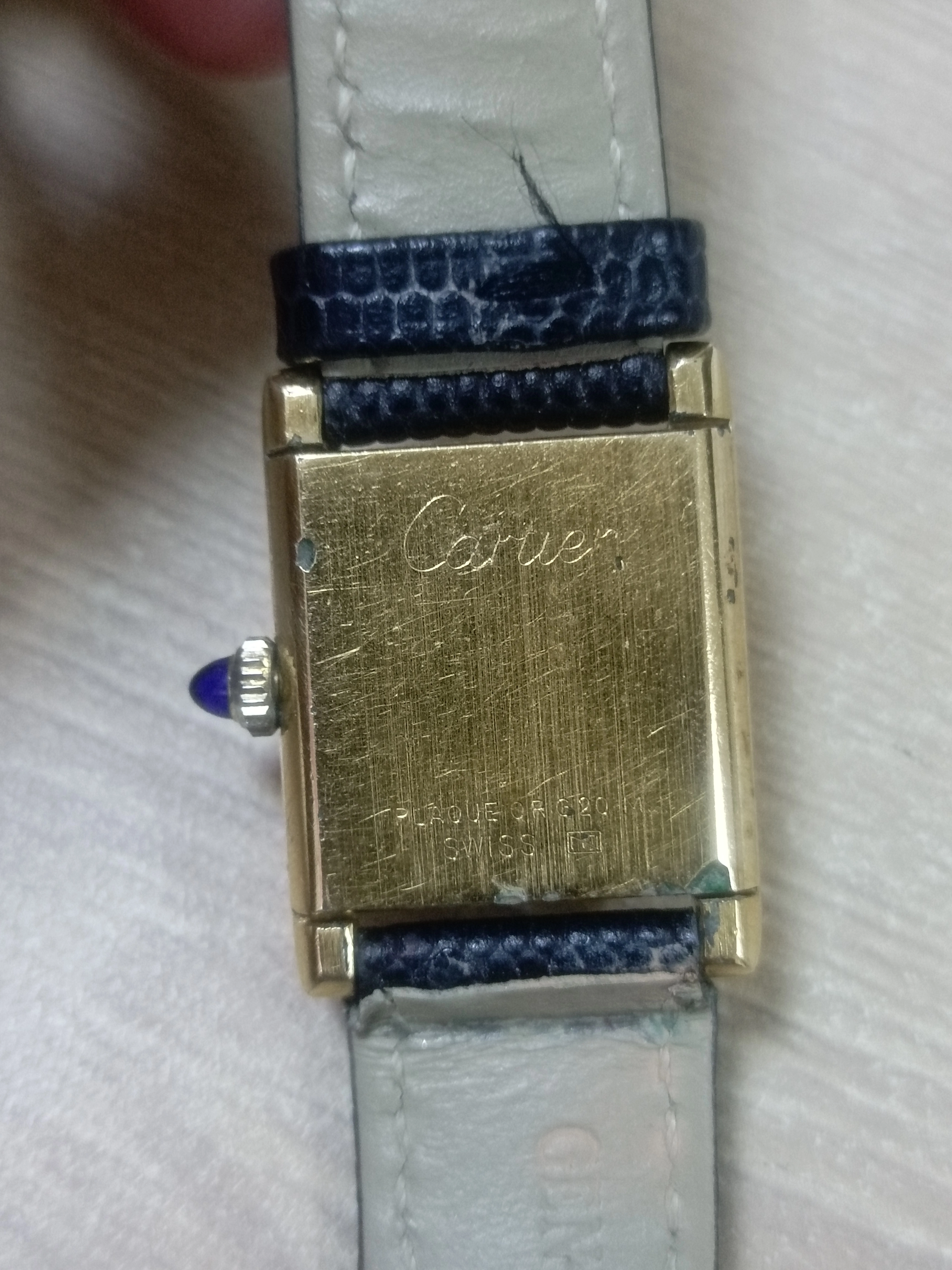

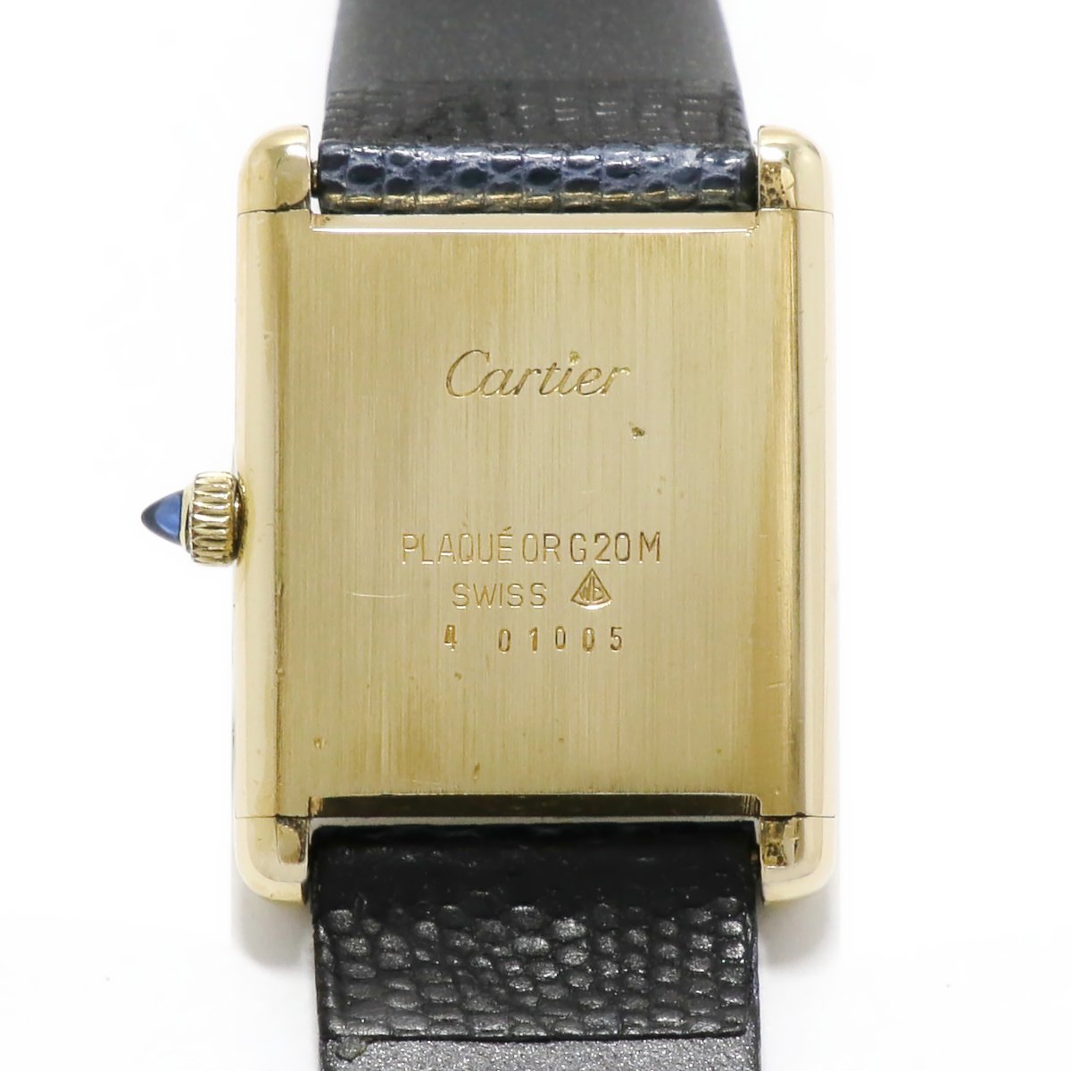

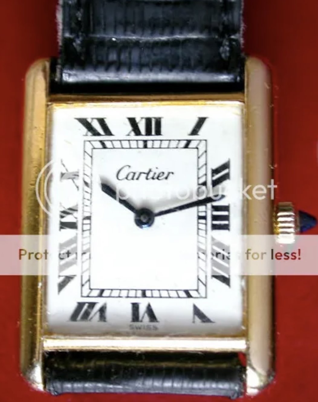

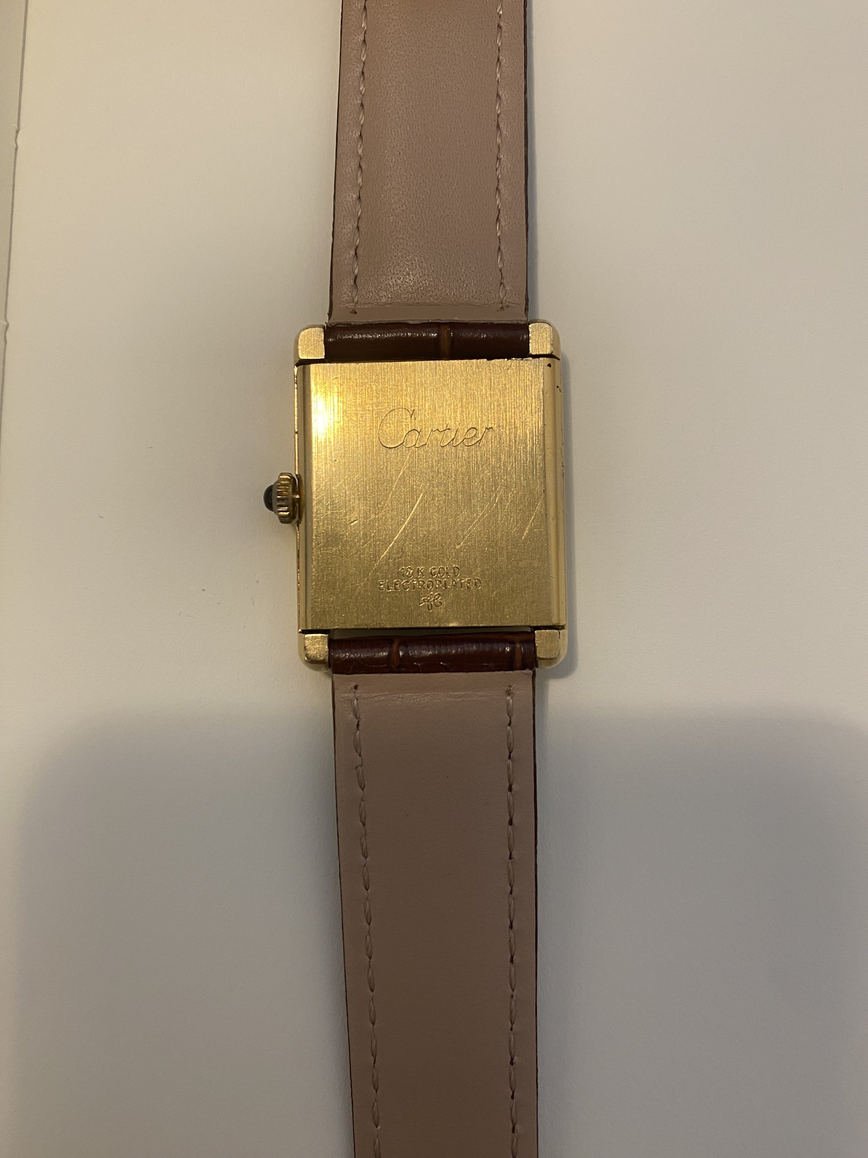

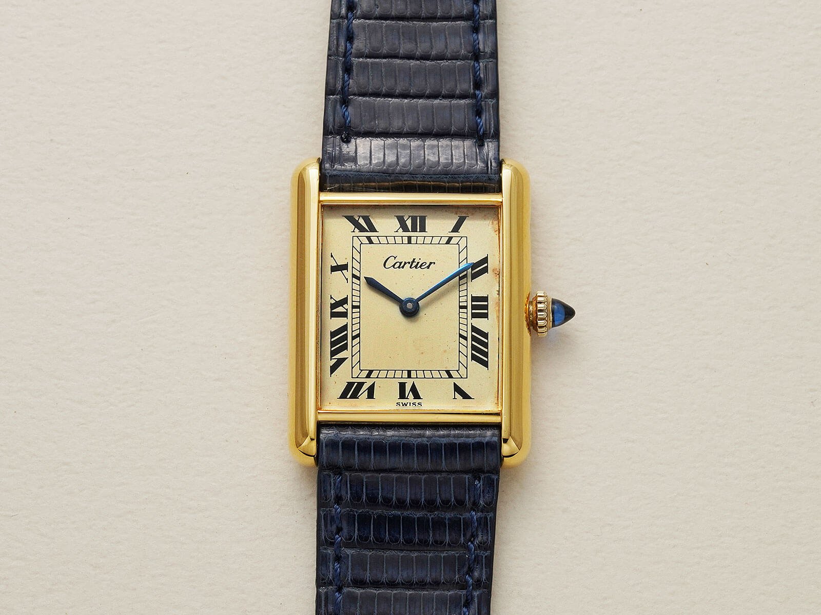

2. Not mine

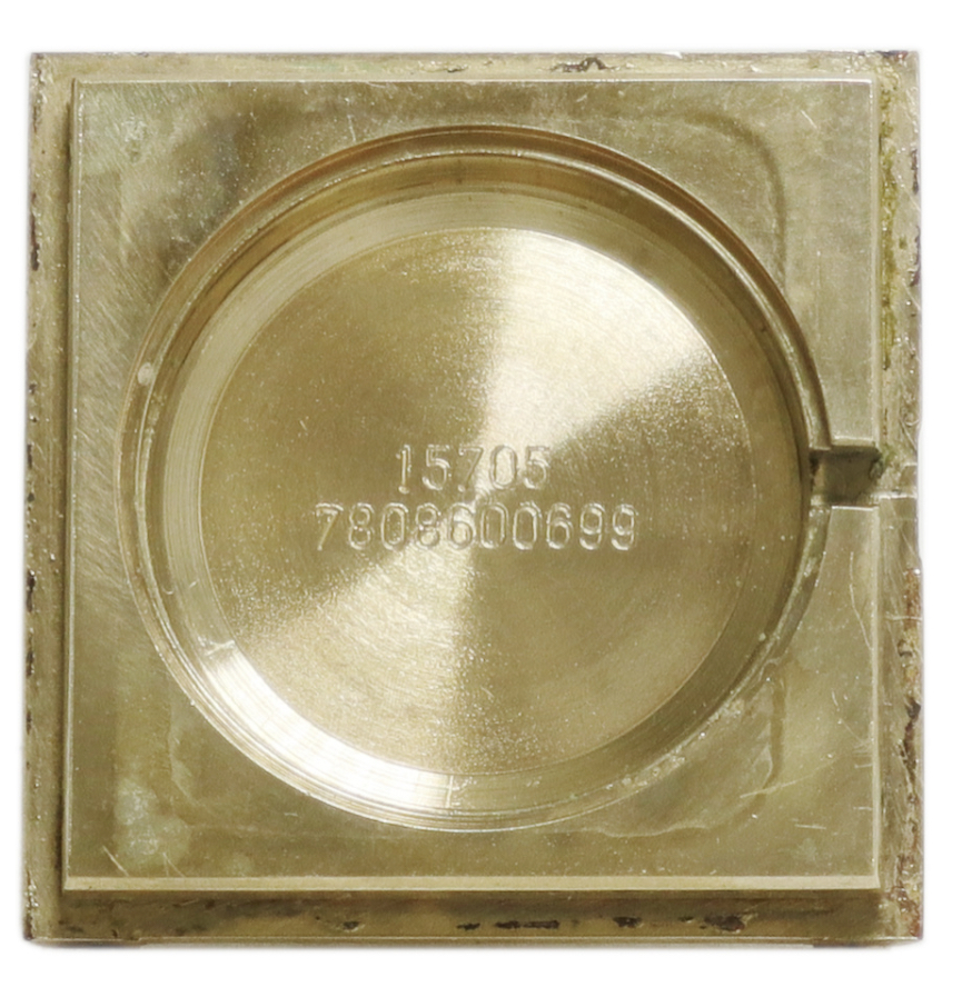

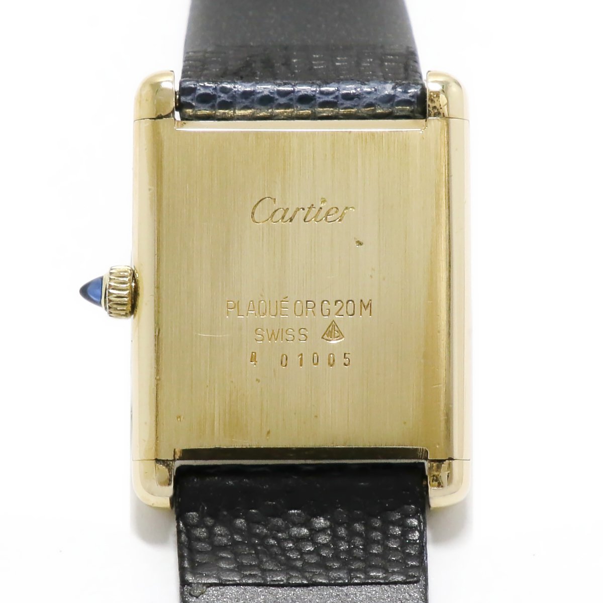

Serial number on case back: 4 01005
Innerside of case back: 15705 7808600699

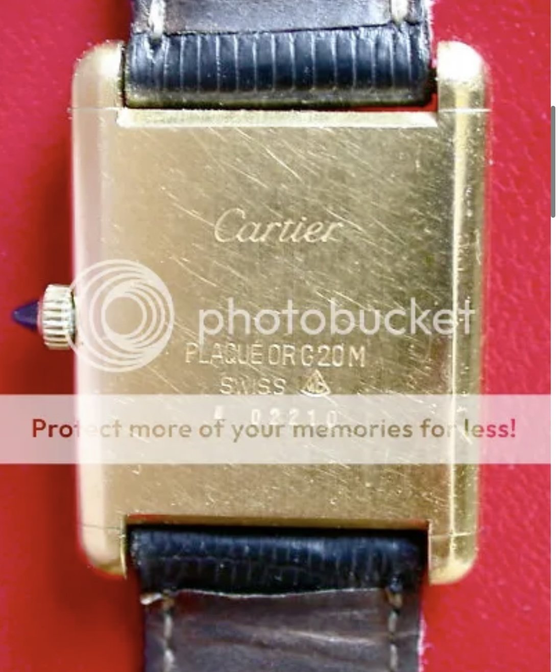

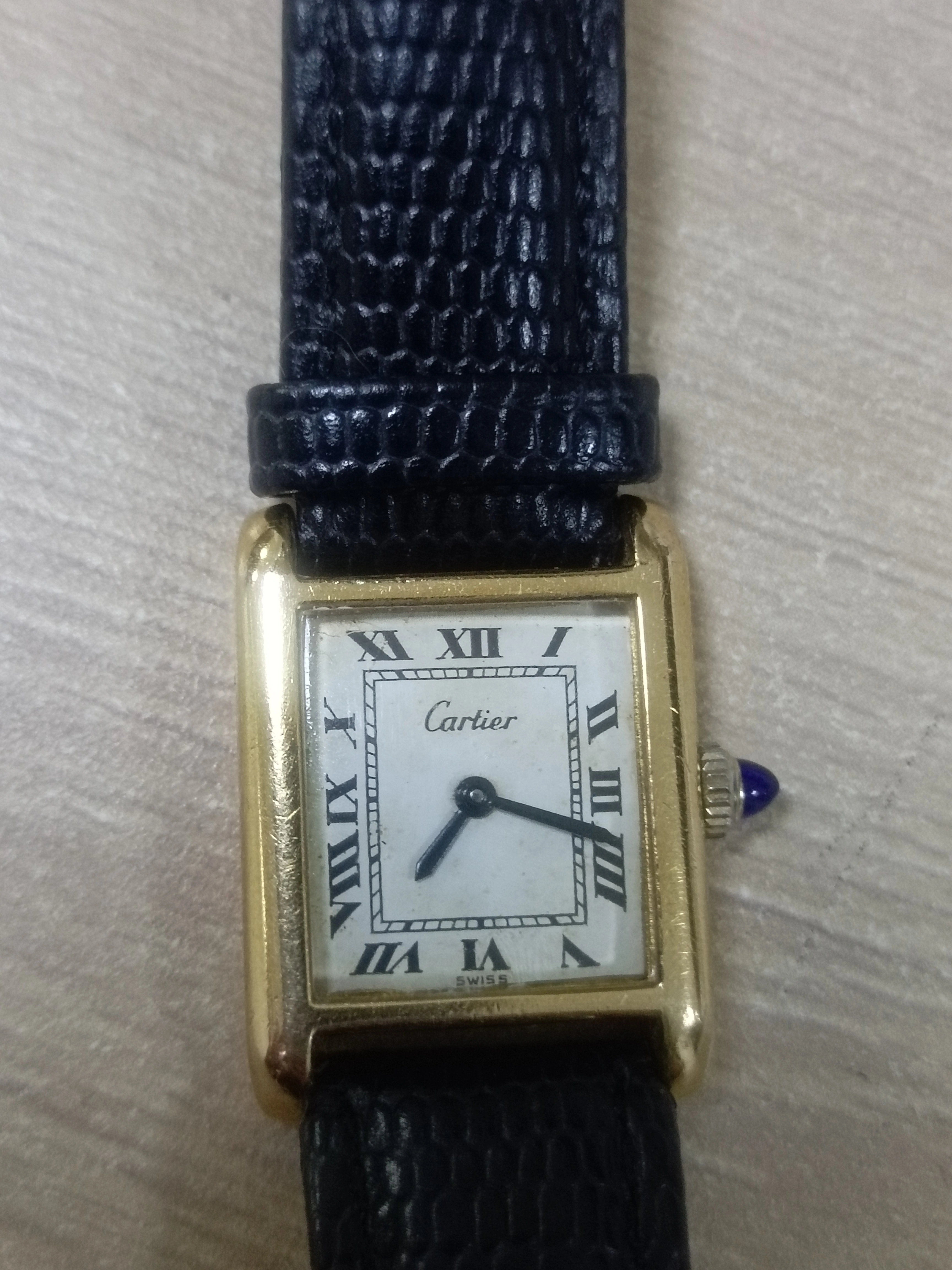

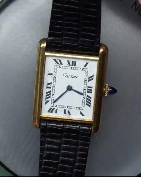

3. Not mine

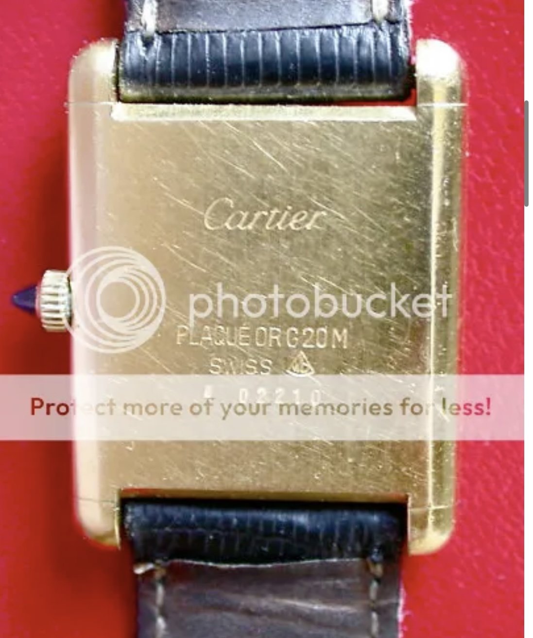

Serial number on case back: 4 02210
Innerside of case back: ?????

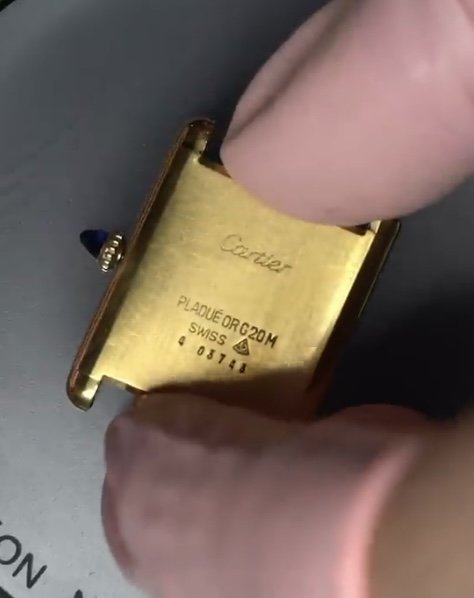

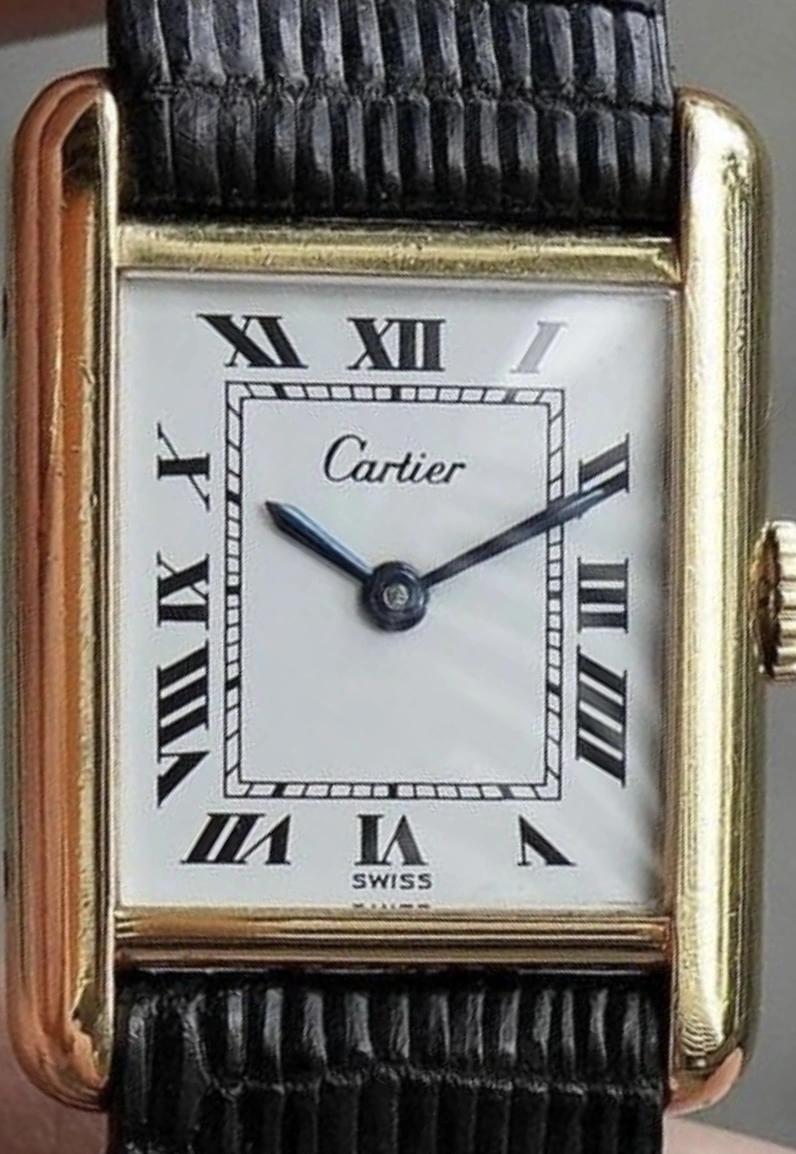

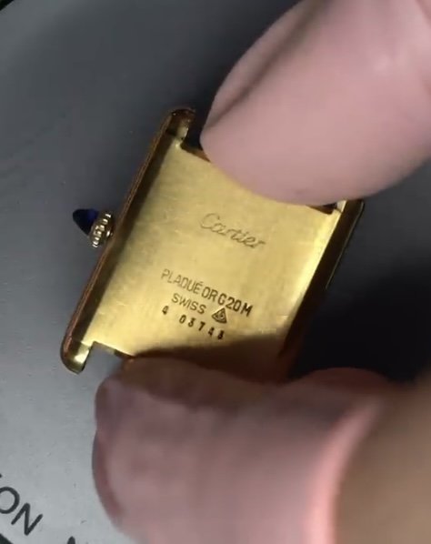

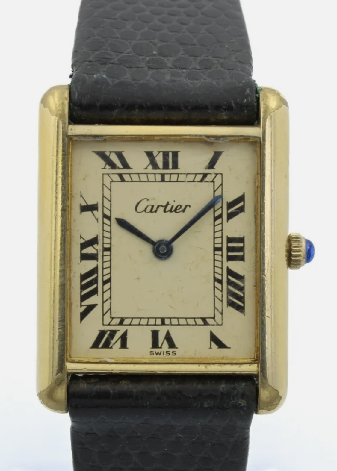

4. Not mine
Serial number on case back: 4 03748

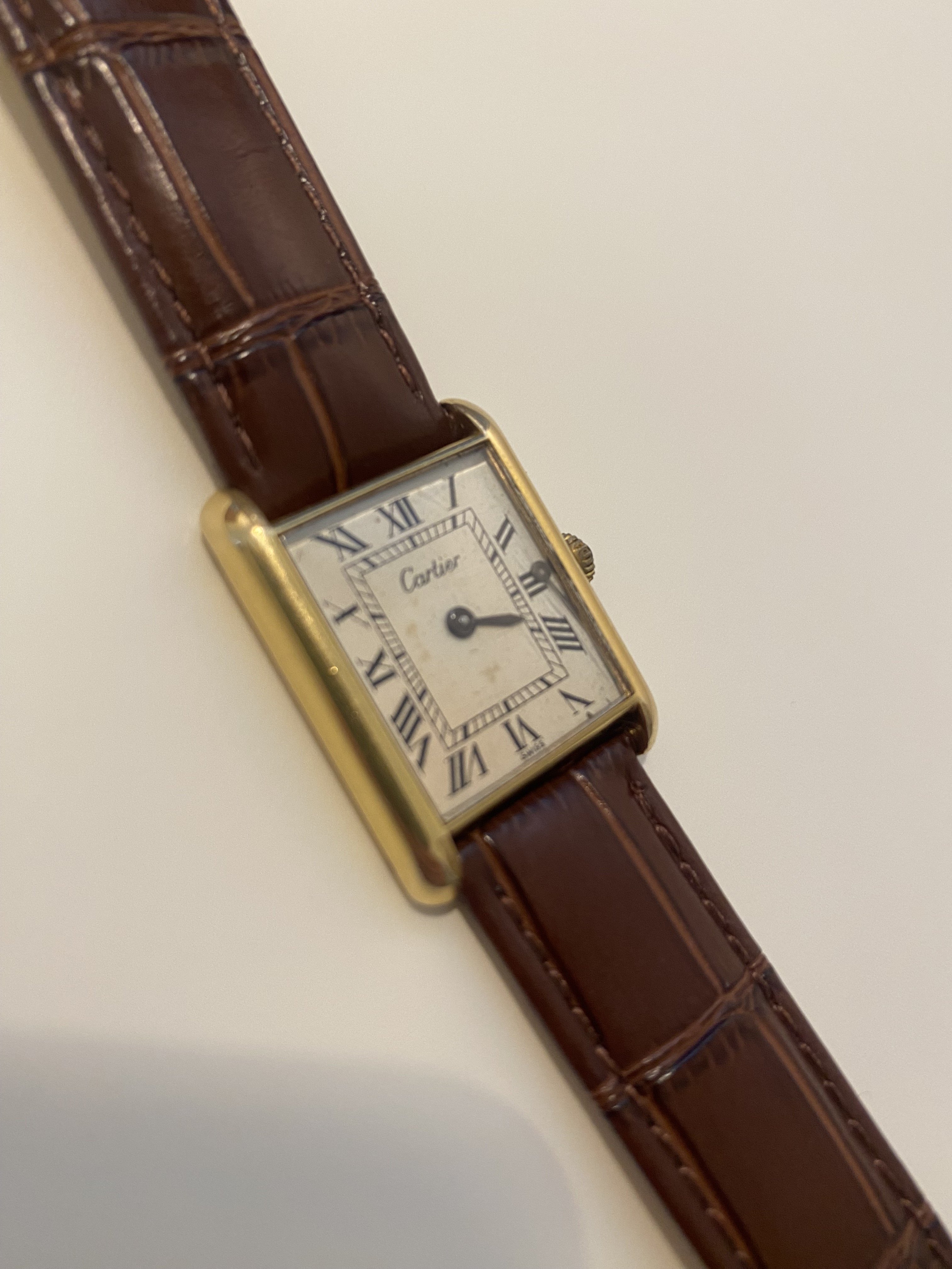

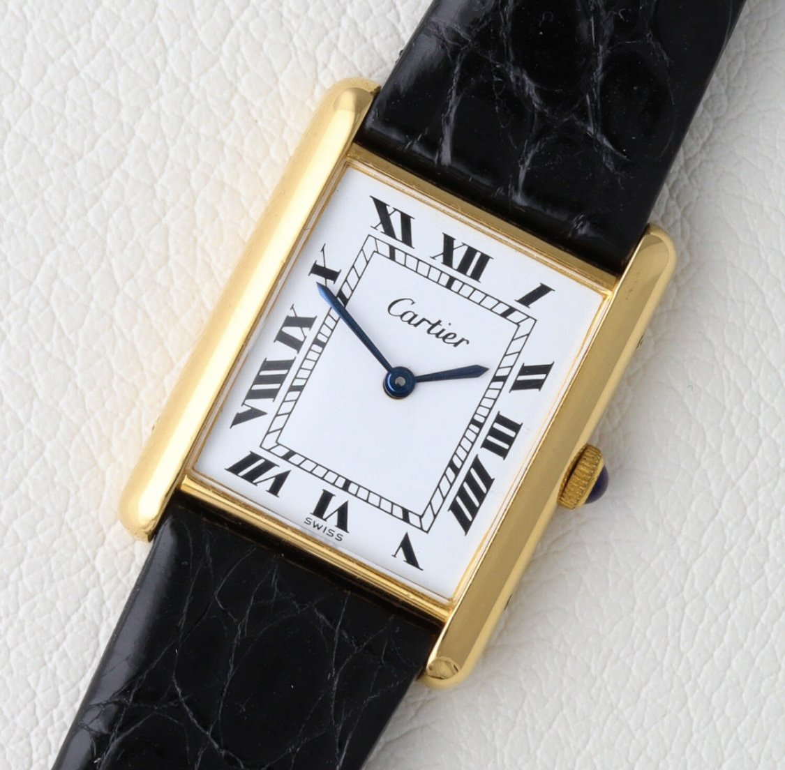

5. Not mine
Serial number on case back: 4 04???

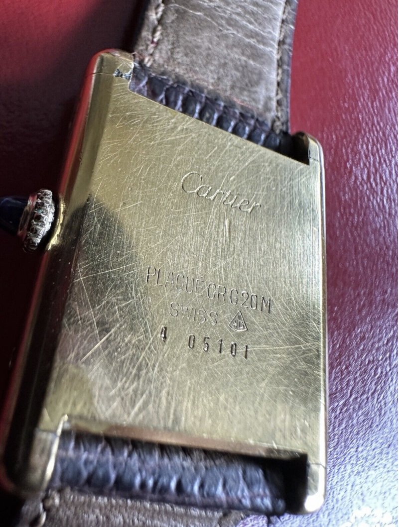

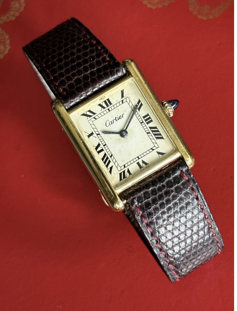

6. Not mine

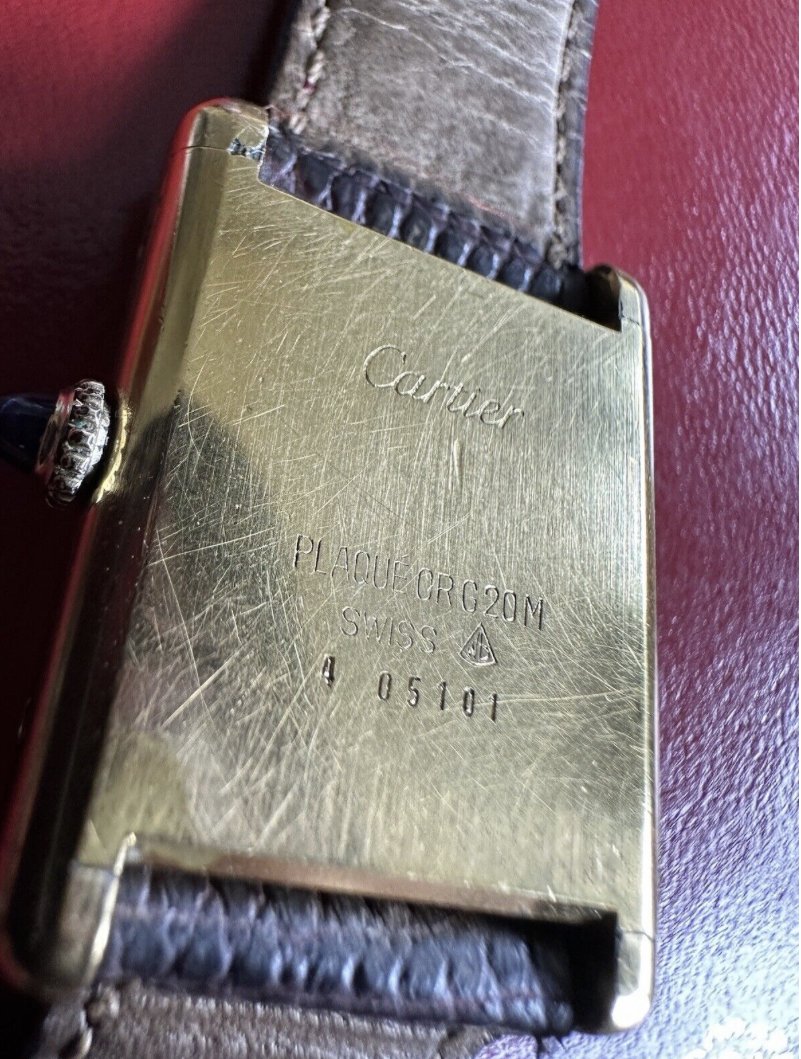

Serial number on case back: 4 05101

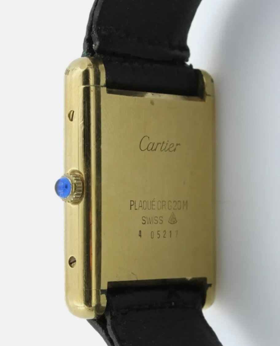

7. Not mine

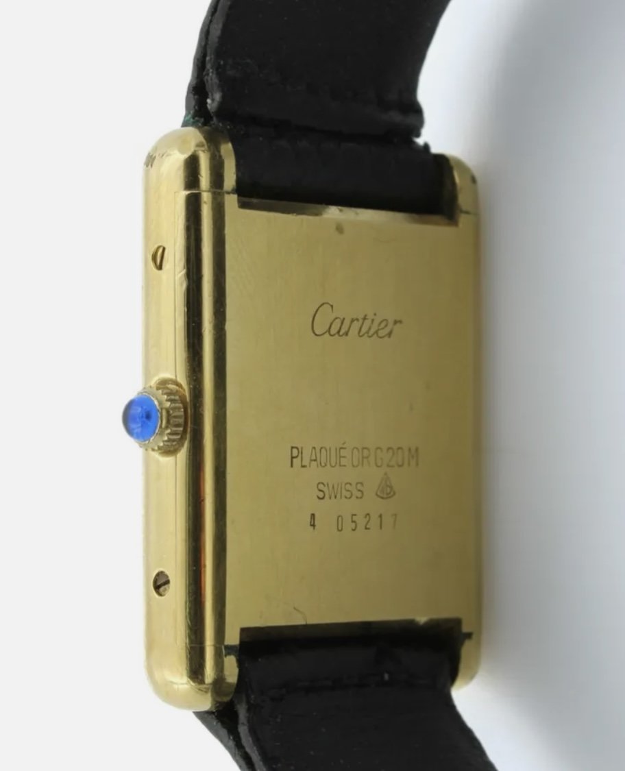

Serial number on case back: 4 05217

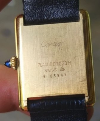

8. Not mine

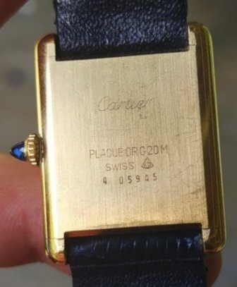

Serial number on case back: 4 05945

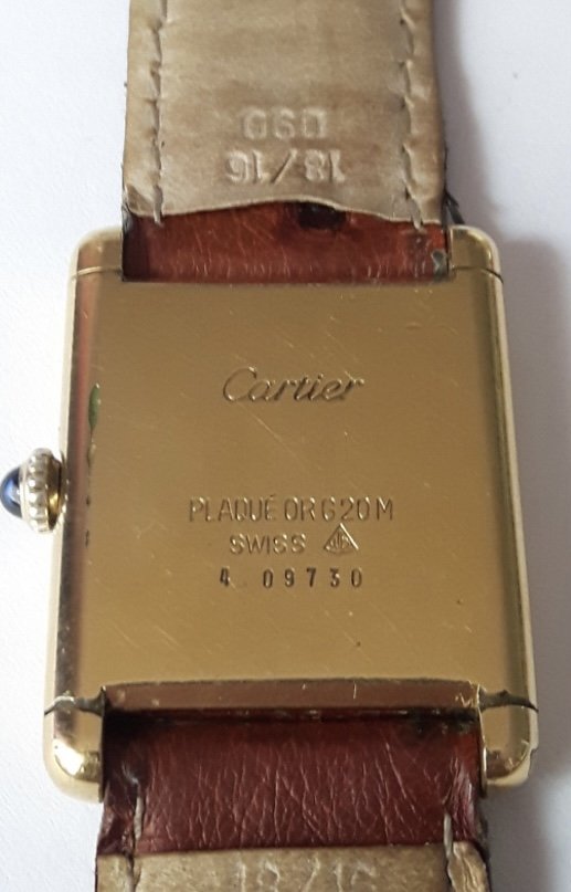

9. Not mine
Serial number on case back: 4 09730
10. Not mine
Serial number on case back: 4 0????

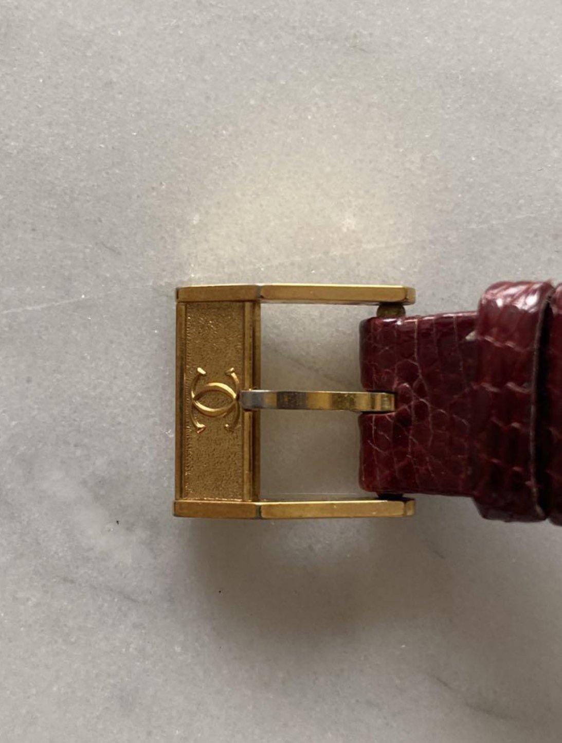

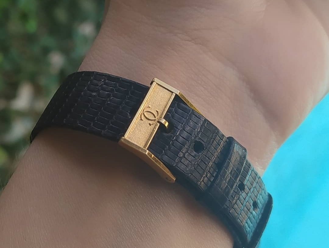

This is the strap buckle for this model. It was more square and had interlocking Cs.

I noticed you also found that Youtube Video of Wristwatch Revival that did an in-depth. Pretty cool watch, are you wearing it or just holding on to it? I want to find the right strap -- Green, Blue, or Grey Suede and make it pop. I originally thought I would just flip it but I dig it and it's a classic.

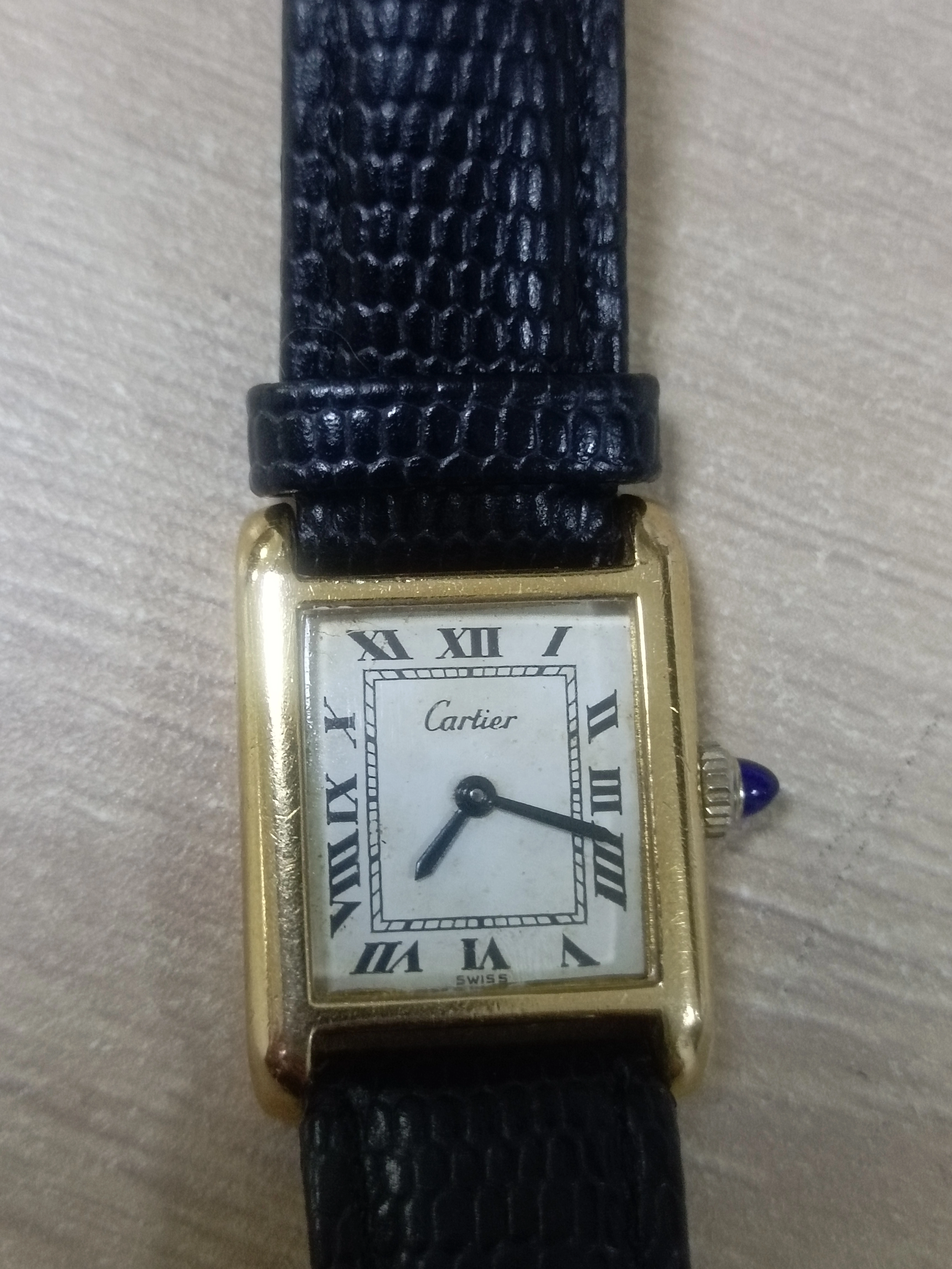

Dear Hensley,
Thank you for the amazing work! Very interesting research!
I just bought one quite similar one but i am not sure it is authentic...Nothing on the back case. What are the thought of the community? Thank you!

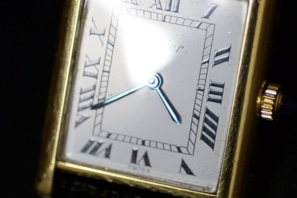

Hi there! The hands on my watch are blue, but the pictures make them look black.
I wear mine almost everyday. 😀 I managed to find an aftermarket crystal on Aliexpress for less than 20usd and did the replacement myself. I can share the link if you’d like so please drop me a pm. I also found 2 period-correct replacement cabochon crowns on *bay and used 1 to repair the piece I have. The crown in the picture is the one I replaced. I am keeping 1 as spare since they are hard to come by!

Dear Hensley,
Hi! I think this might be a redialed Catena watch. The Catena logo is on the case back.

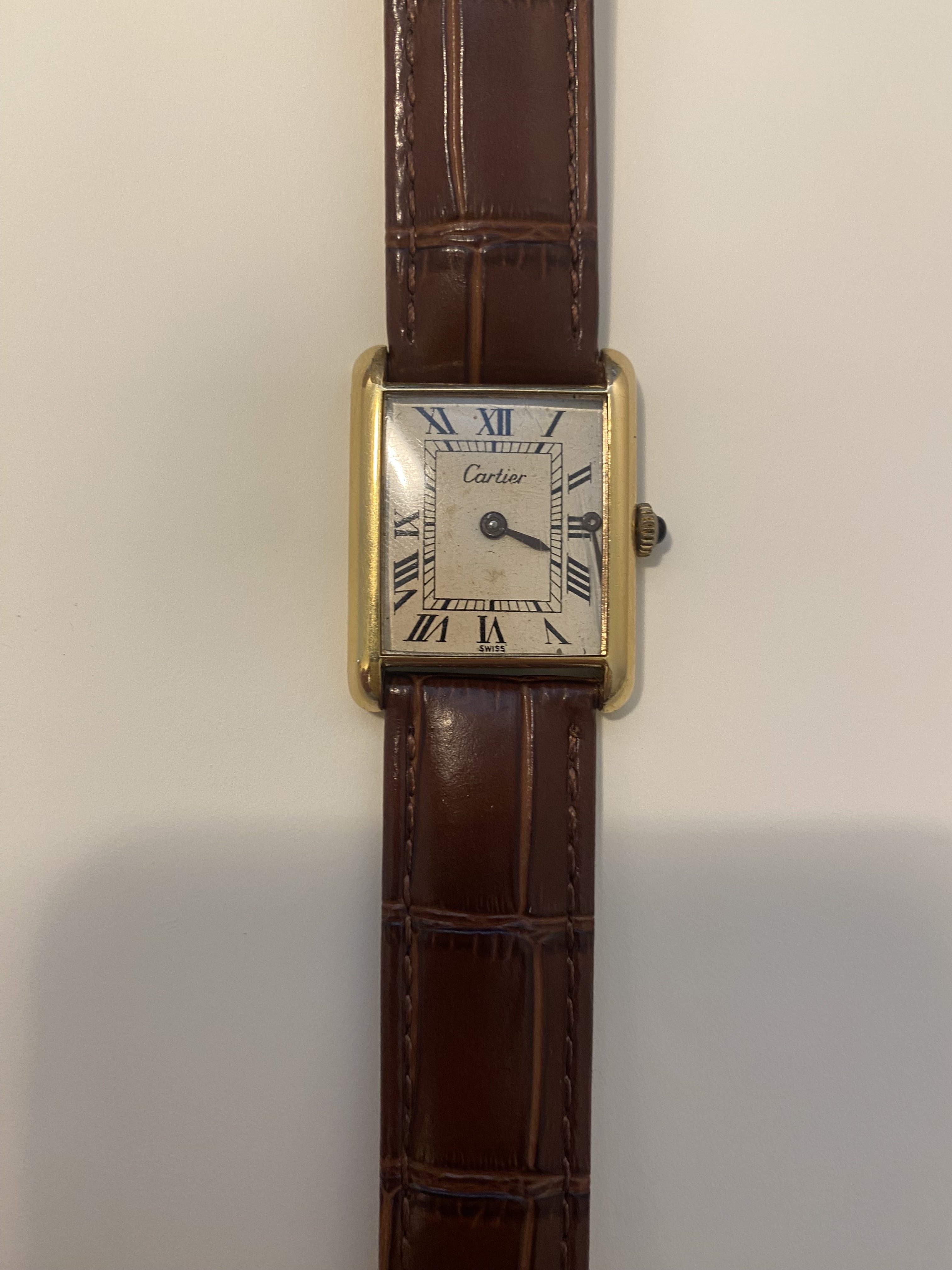

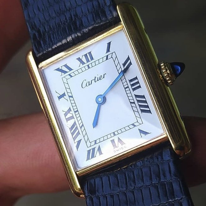

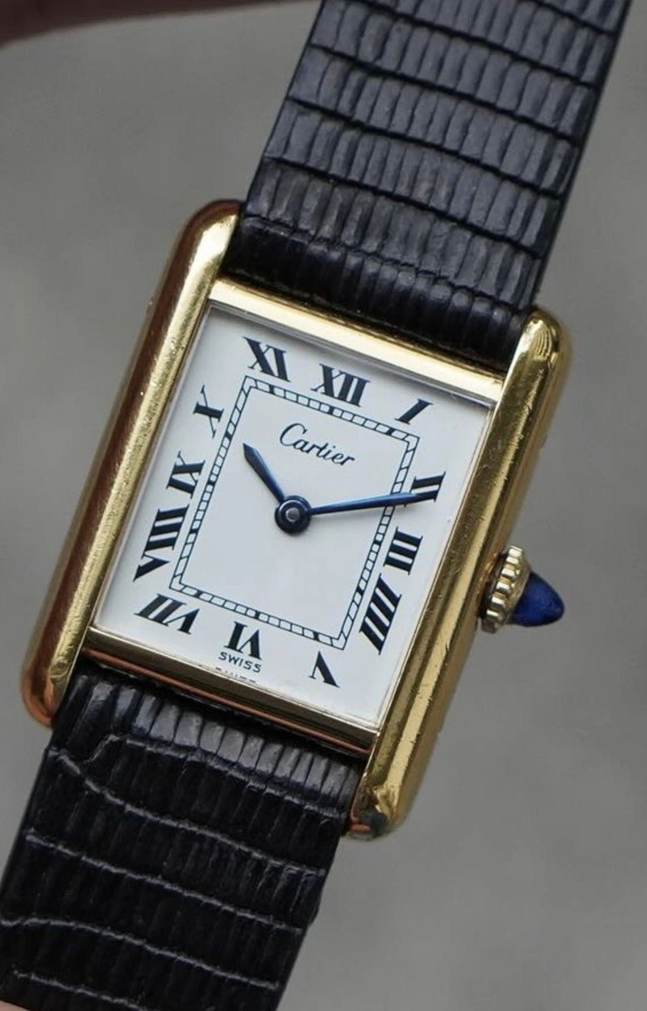

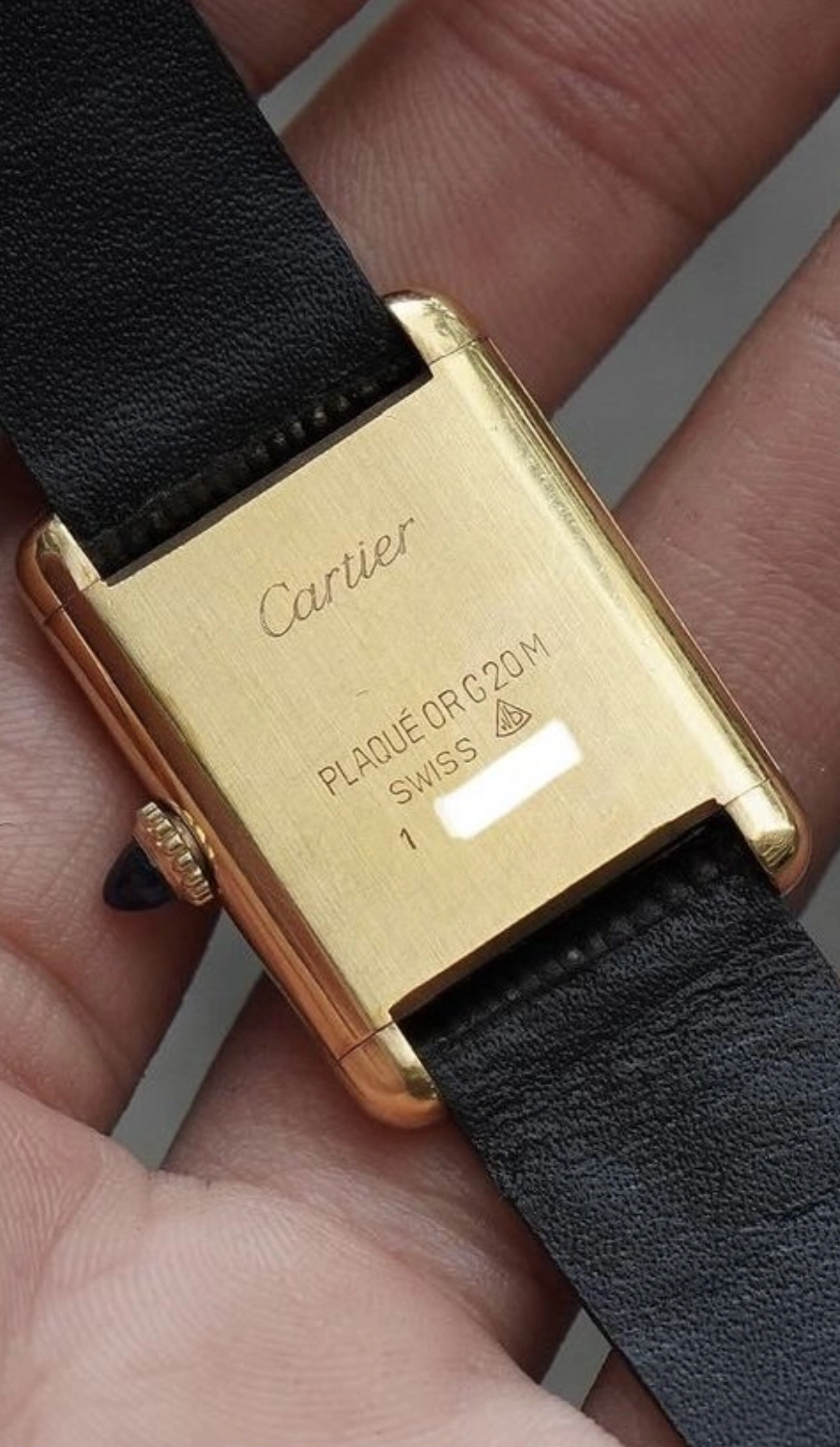

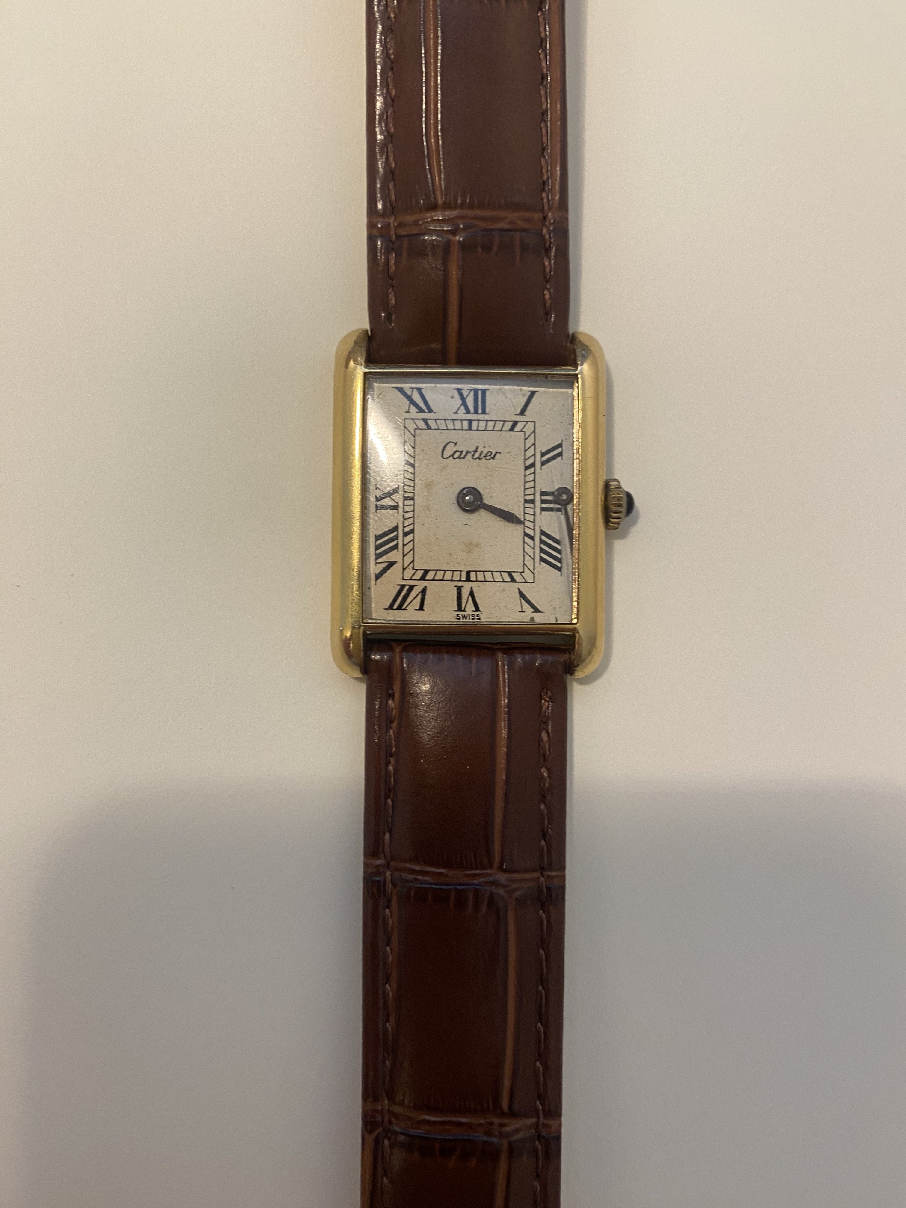

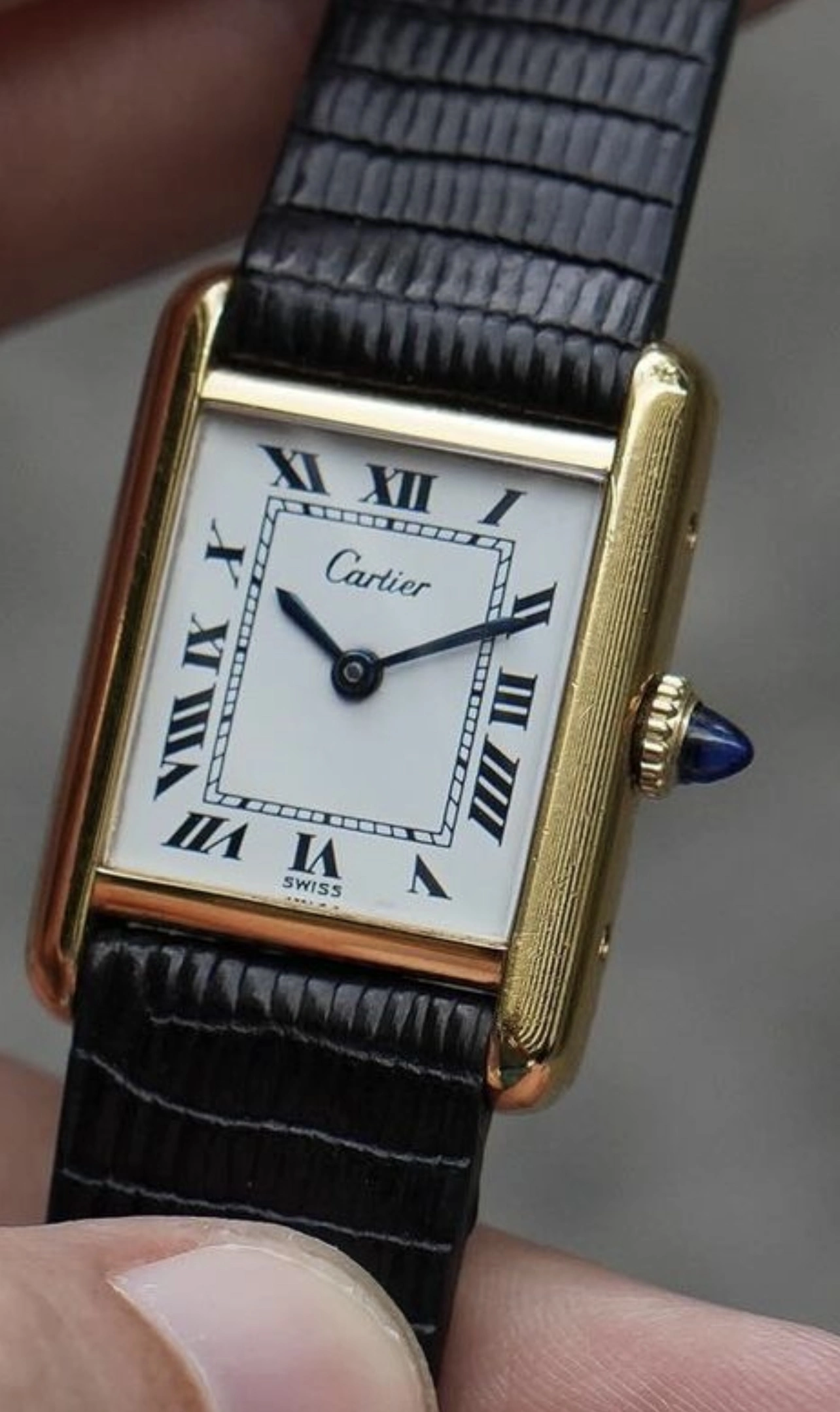

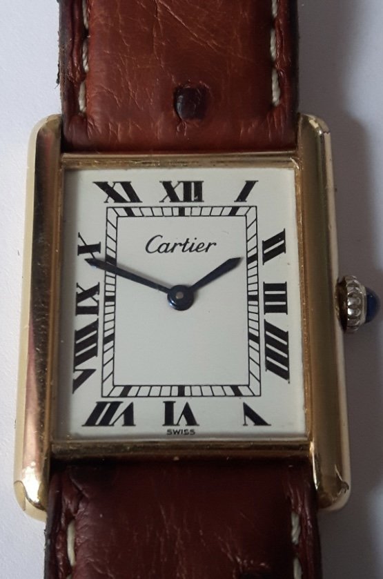

Hi Hensley. Your post is so helpful as I’m currently looking at the example in the pic. However this is the smaller model which has the “1” in front of the serial. I’m struggling to find reference photo for the smaller one. Would you mind taking a lot to see if there are anything glaring? I don’t have good sample for dial and hands.
Hello! I know I am not the originator, but as someone who also owns this which, I just went through the dials of my own as well and do not see any difference in dial, hands, or crown. The only thing that looks slightly different are the minute marker spacing, but if it's a smaller watch, then maybe that's why. The back of mine looks identical, but mine starts with a 4 as well. Out of curiosity, what is the going rate to purchase one these days?
Hey thx for reviewing. I ended up buying the watch in photo. I’ll document addition findings here maybe someone will come across this thread as they are hunting

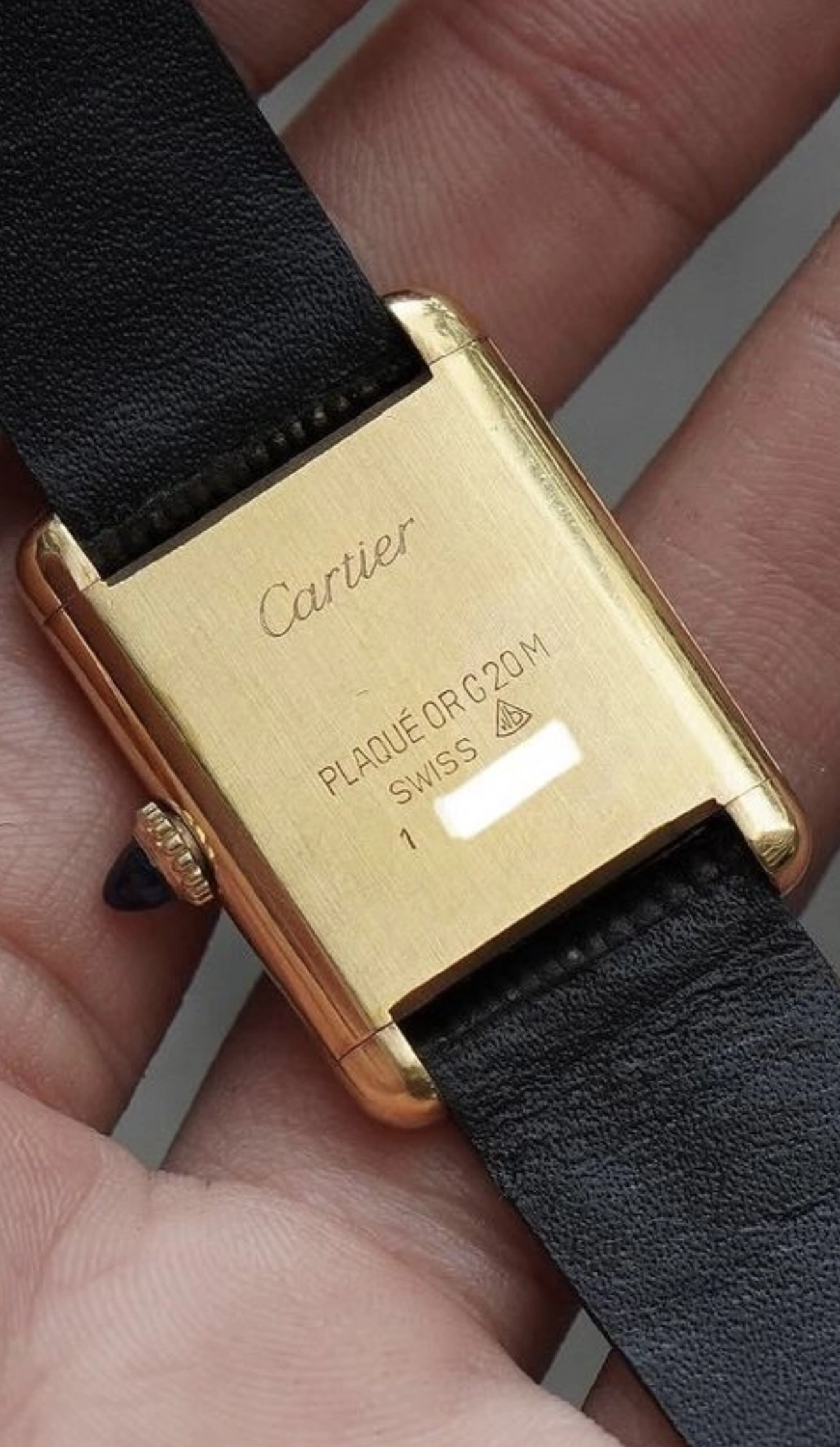

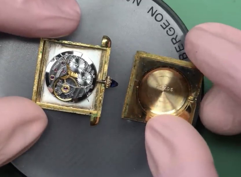

- 1st number on case back before the serial number (4 or 1) - 4 is on the 23mm men’s/unisex which has 15705 on the inside of the case back
while 1 is for the smaller 20mm (some sites will quote it as 21mm) which has 25705 on the inside of the case back. If you google those “reference” number on the inside of case back you will find more samples especially the 25705.
- serial on inside of case - my watch had a matching serial on the inside of the case as the serial on the case back. (Sorry no photo)

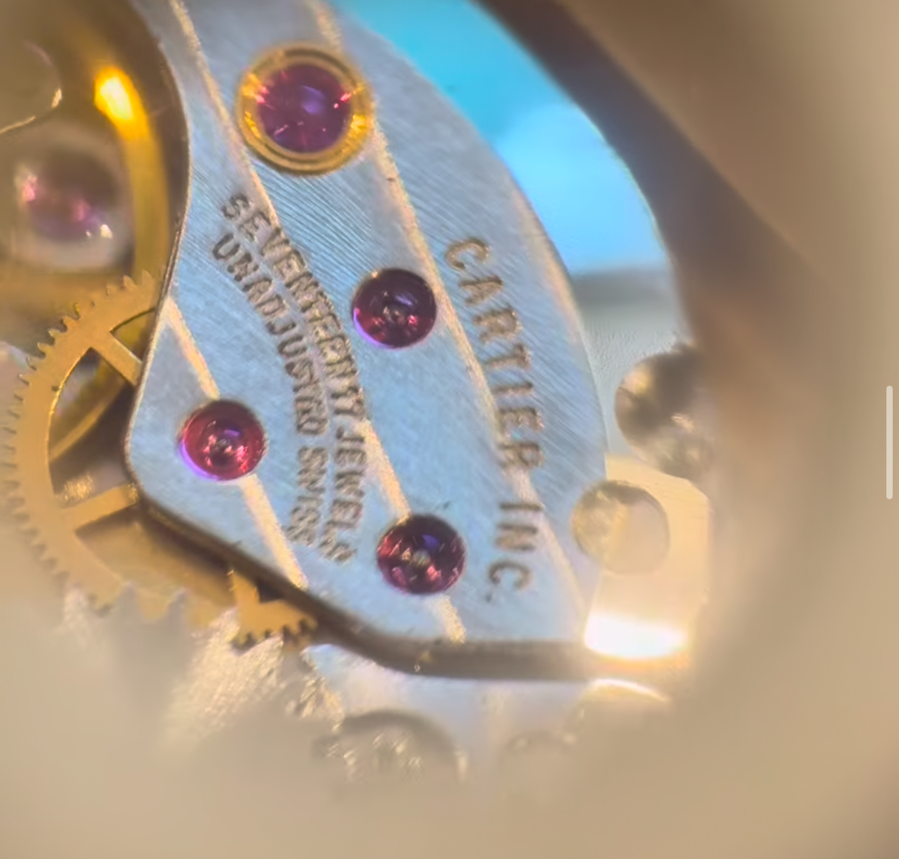

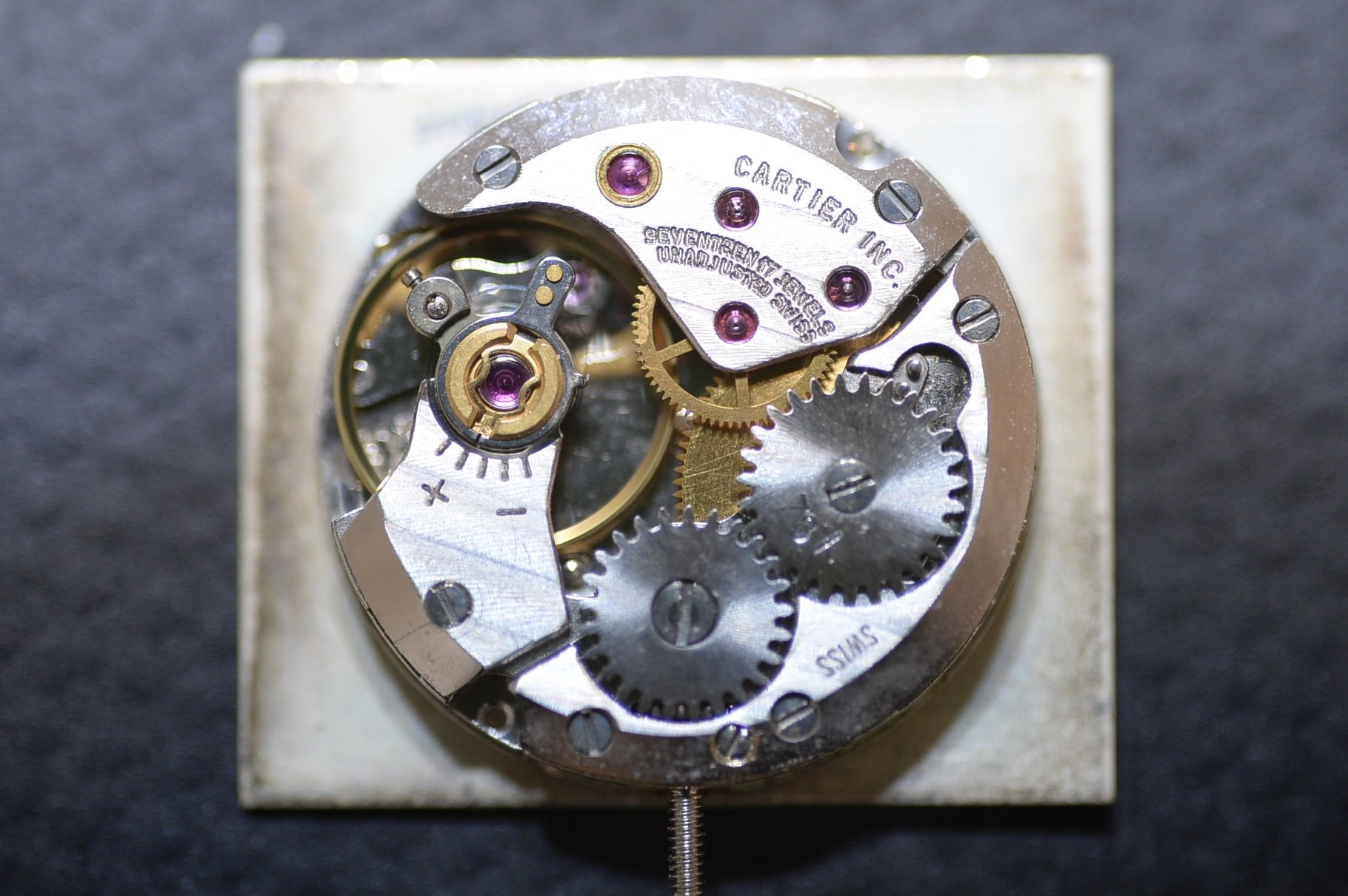

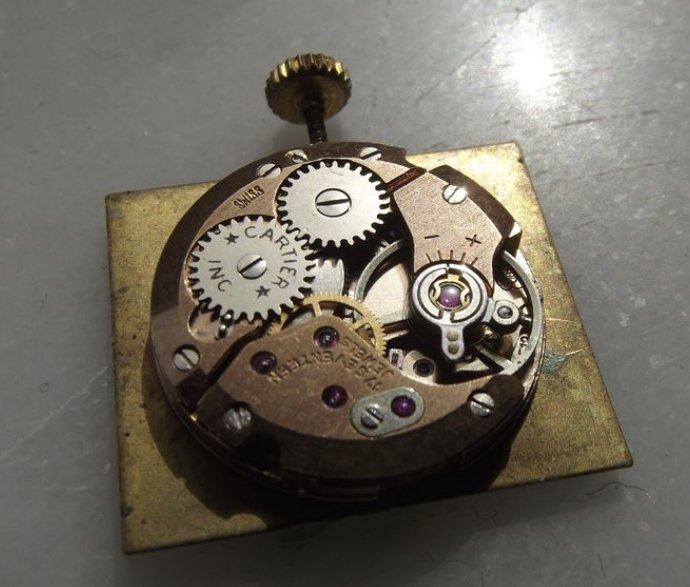

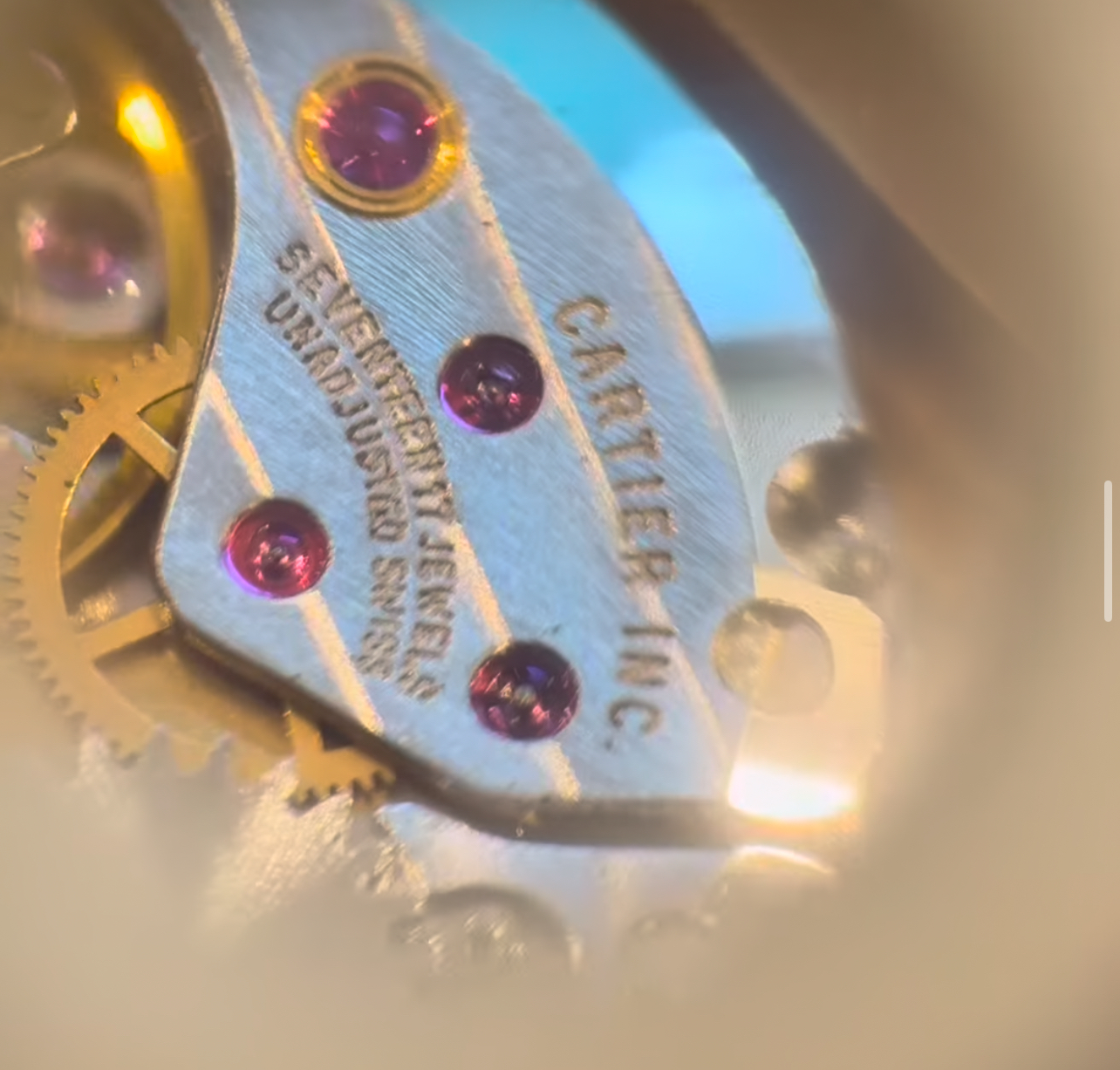

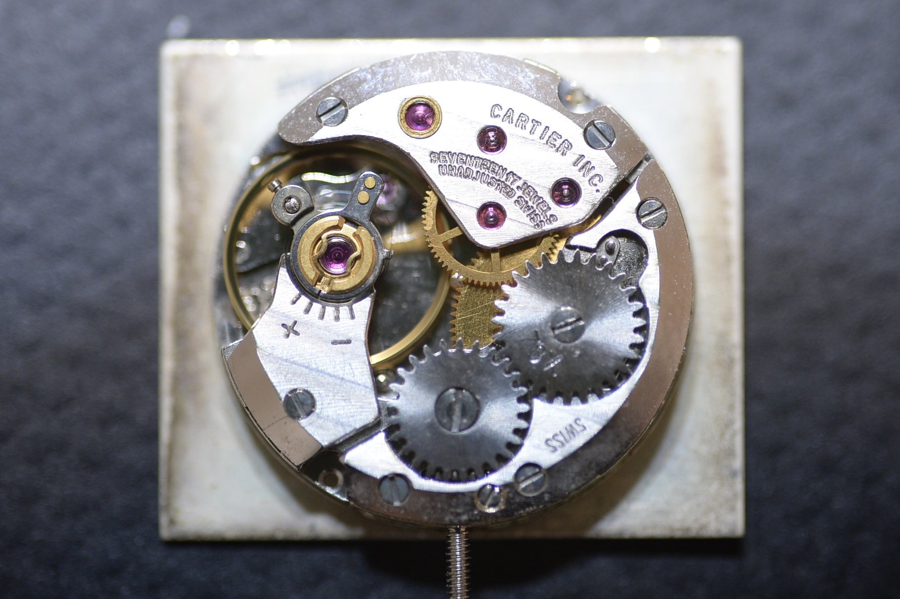

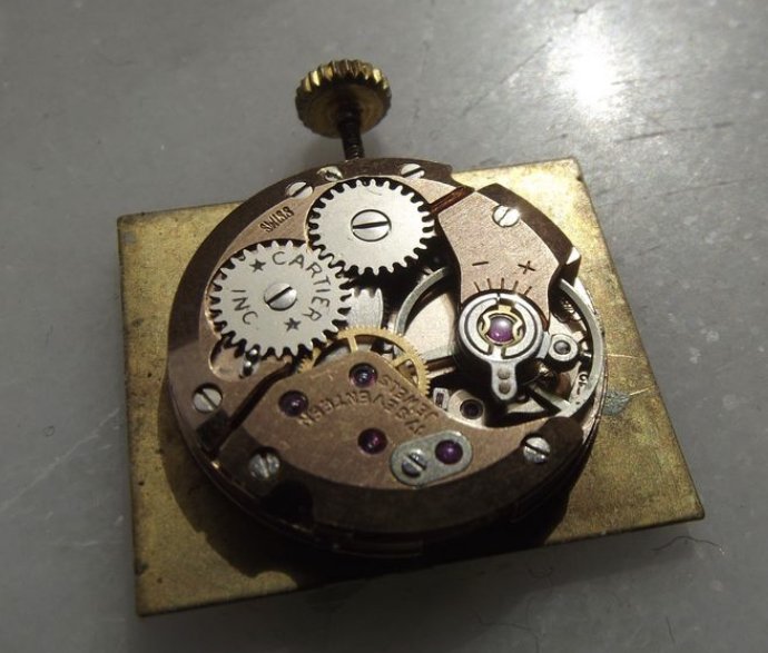

- “Cartier inc” on the movement - according to the dealer that I bought from … the NY pre must has “Cartier inc” on the location shown on the movement pic
