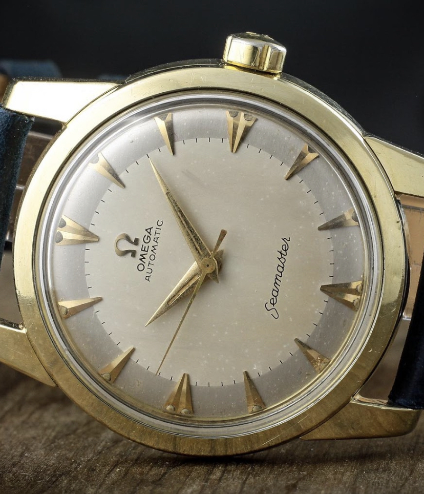

Hi, I own a few vintage watches with different types discoloration to the dial. Can a dial be brought back to life with a clean and a polish or should they be left alone.
Here is an example...

That dial is beautiful. I would try and see that, but certainly leave it the heck alone unless you believe you can live with it potentially never being the same again (aka ruined).
24,843
55,270
If there is loose debris, it can often be removed. Anything else is a risk. I don't see anything on that particular dial that would be worth attempting to remove.
10,134
58,070
That is a perfectly acceptable patinated dial. Many collectors would not be troubled by it and a certain degree of patination, fading, spotting, discoloration, etc. is expected with vintage watches. Although vintage watches with mint or nearly mint original dials can be found, they are the exception and not the rule and this accounts for the plethora of redials that are out there.

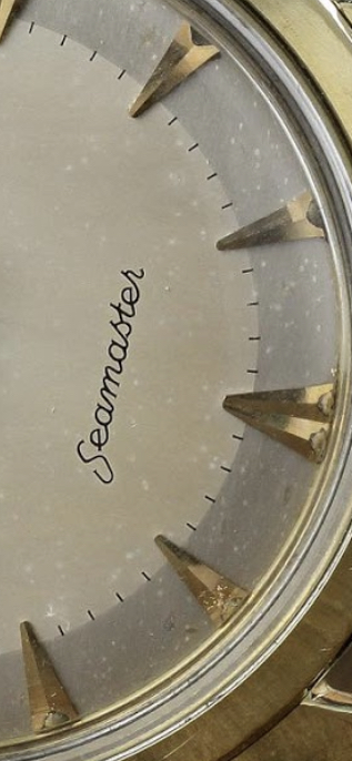

I was looking at the markers for example, thinking they could be slightly carefully polished to get rid if the gunk. Nothing to risky but I guess I'll leave it.
4,593
10,813
Put down the loop and enjoy your watches 😁
24,843
55,270
At the risk of repeating myself, I don't see anything that would be significant enough to the naked eye to risk damaging the dial. But everyone has different standards.
If you're so inclined and not risk-averse, ask your watchmaker to clean off the gunk that you apparently see and post some "after" photos. If it is truly some foreign matter that is attached loosely, he may be able to do it.
Frankly, I feel that there is a bit of a disconnect between your photos and your comments. You show a 60 year old dial that is really nice, and mention gunk and discoloration. If you are really bothered by such minor imperfections, you may want to consider buying vintage-style new watches, or only buy absolutely pristine vintage examples, which are obviously much more expensive and hard to find.
Wouldn't it look odd to have shiny markers on a patinaed dial? In my opinion, it would destroy the character of the timepiece. Not to mention it will be a time consuming job that has its risks.
