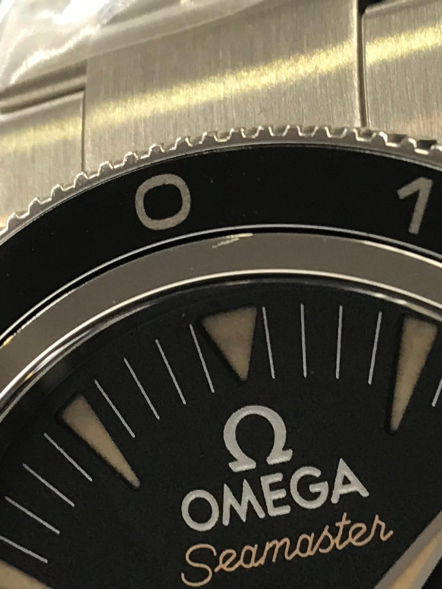

Looking at this watch to possibly buy and was wondering, when I send it in to Omega for service, is this something they will be able to fix? Looks like it’s under the sapphire crystal. Anyone know an estimated cost?

It looks like it needs laser welding + polish.

I don't think Omega does laser welding... you'd have to find a third party. If the case gets too bad, they would do a replacement of the entire case. Otherwise, they would just polish it but it wouldn't 100% be fixed if the scratch is as deep as it looks in the photo.

Can be laser filled, about $300 for stainless steel.

You can ask seller for $300 off, but I’d just leave that dent there. You’ll likely collect another 5-10scars like that first 5 years. Laser correct the entire case is about $500-700 (conservative estimate).

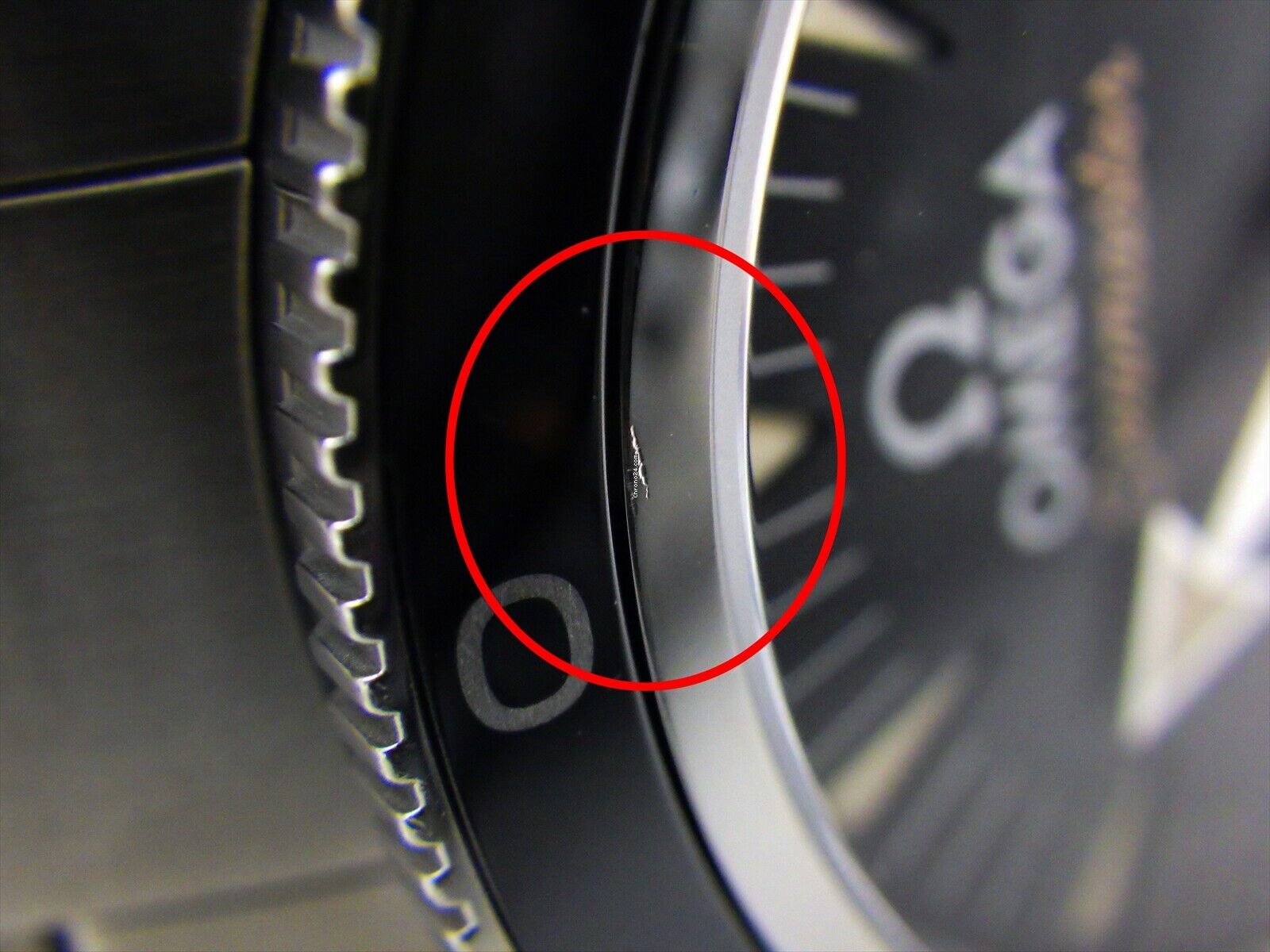

Here’s another photo I got from the dealer, for those who actually have real input on the matter.
43
23
Ah that'll buff right out. How's that for real input?
I appreciate it, the new picture doesn’t make it look as bad as the original one.

I think that your question has been answered, but to rehash it. Yes, it can be fixed. Can it be fixed by Omega? Probably not if laser welding is required. Can it be fixed elsewhere? Yes. What will it cost? $300 to $700+ depending upon how much work is required. Should you buy it? Your call.
