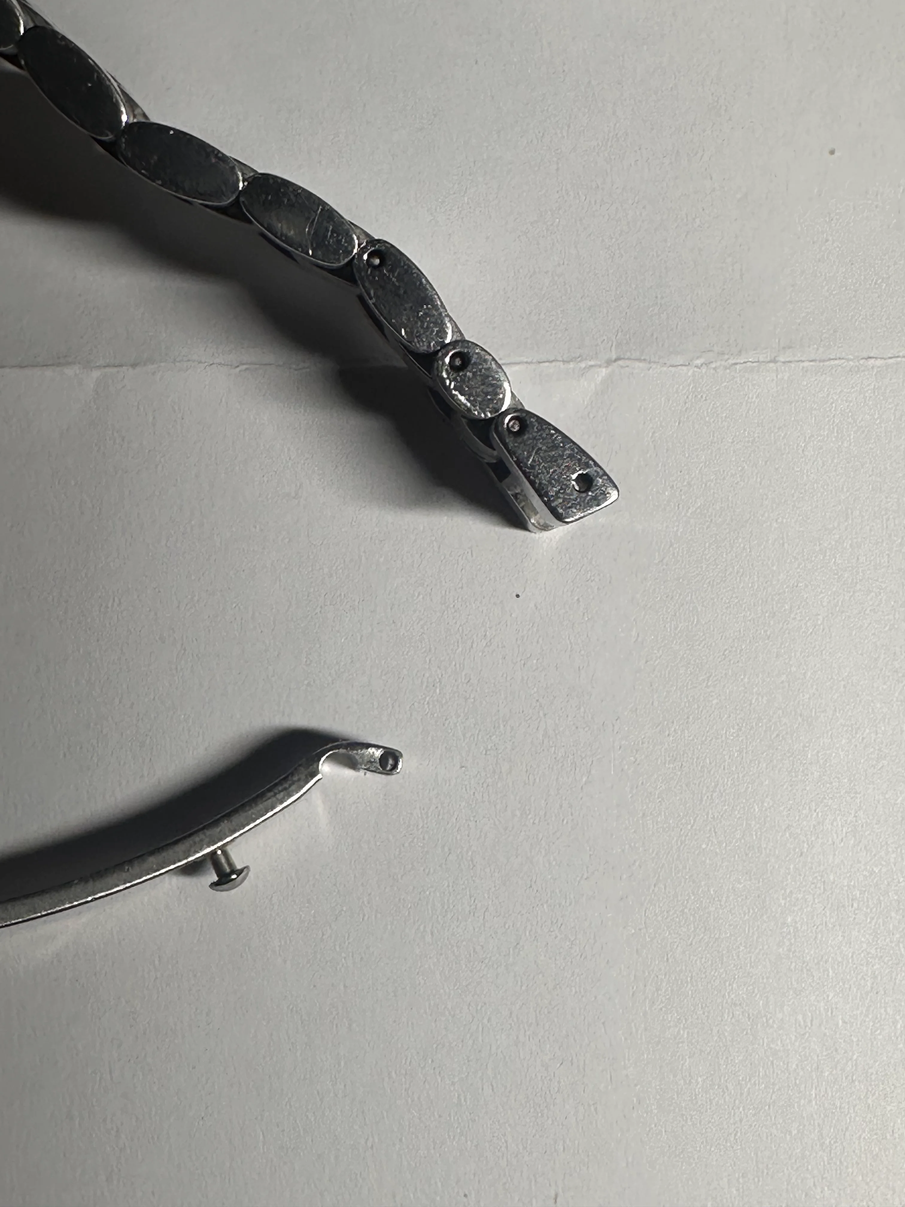

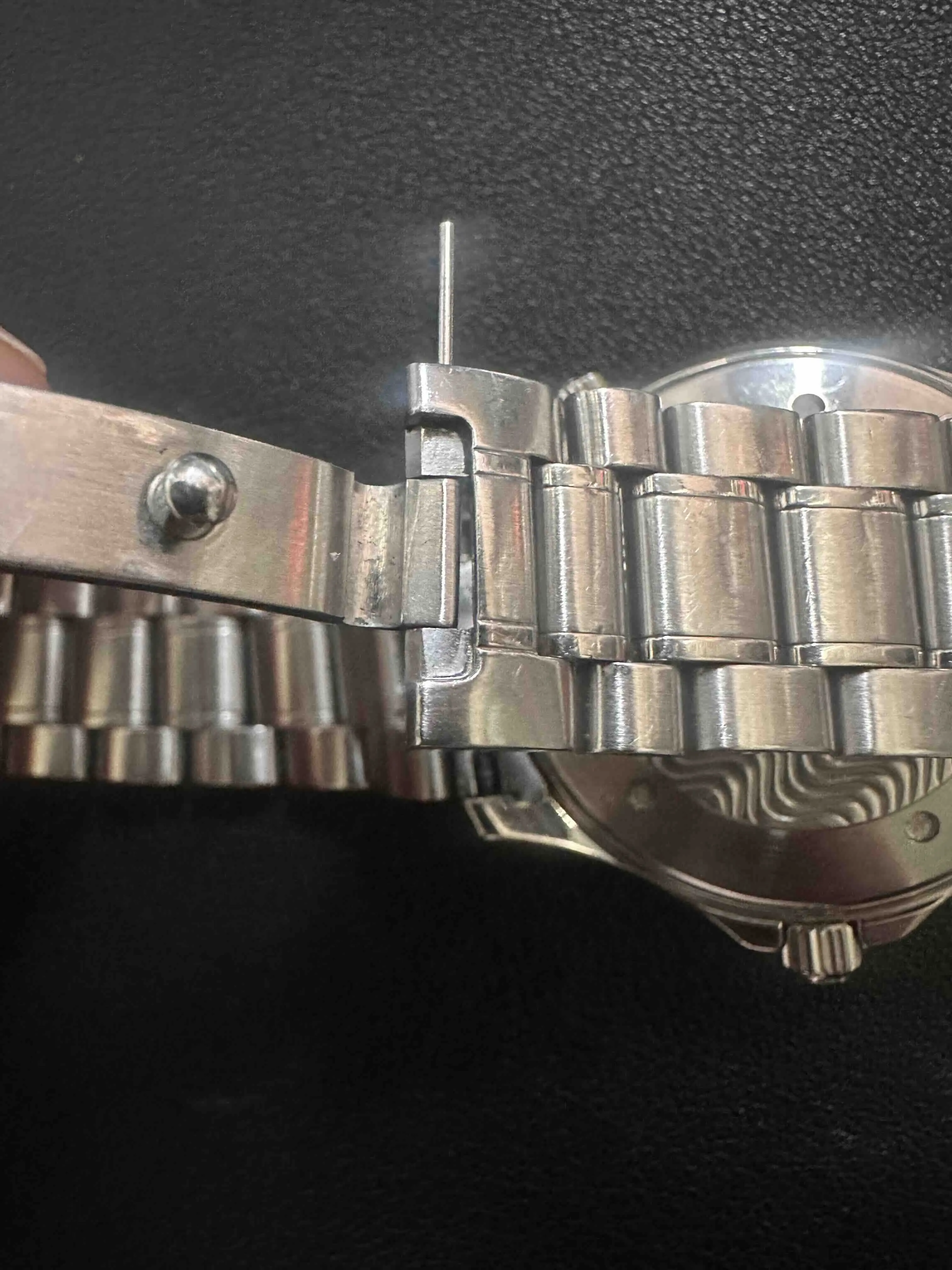

The 1610/930 bracelet on my 2225.80 Seamaster Diver 300M has broken, see the attached photo.

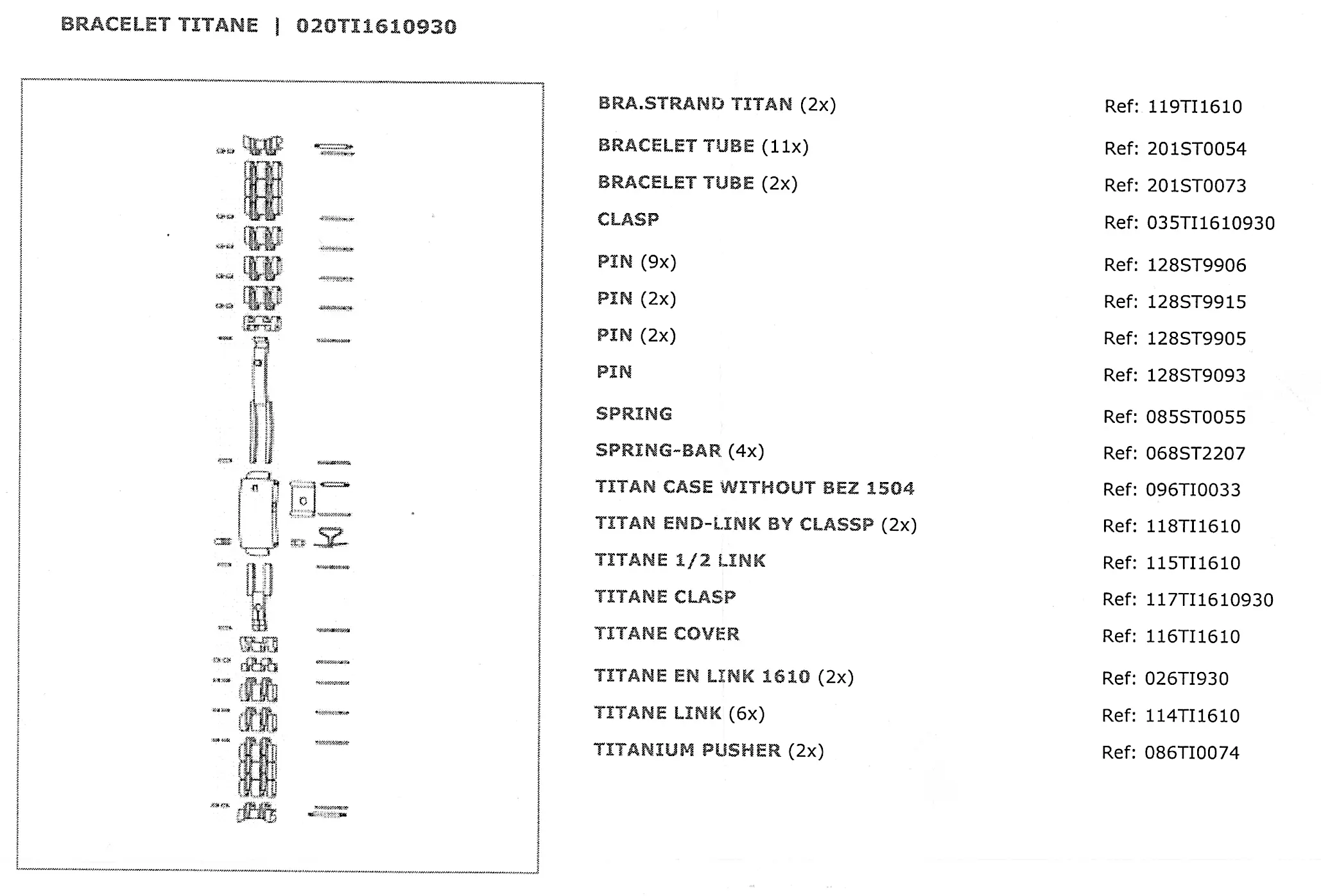

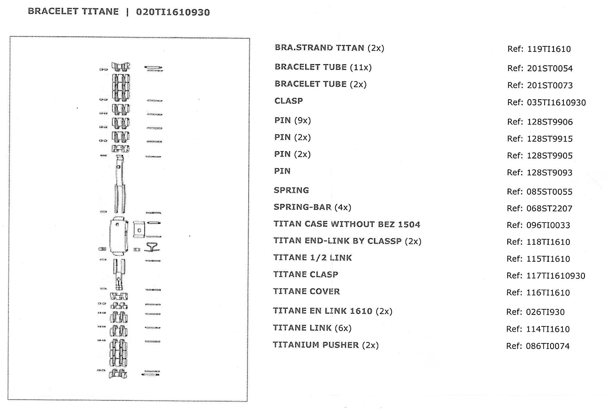

I'd like to fix this myself, and think I need to order a clasp pin and tube on the Cousins website: Bracelet Clasp Pin, Omega 128ST9066 and Bracelet Clasp Tube, James Bond Model 1993 1503-825, Omega 201ST0074. But does anyone know for sure that I need a clasp pin and tube to fix this? It's hard to find any diagrams of the bracelet that show which parts I need. All I found was this one on the Ofrei website, but it's for a 1503/825 bracelet.
Many thanks!

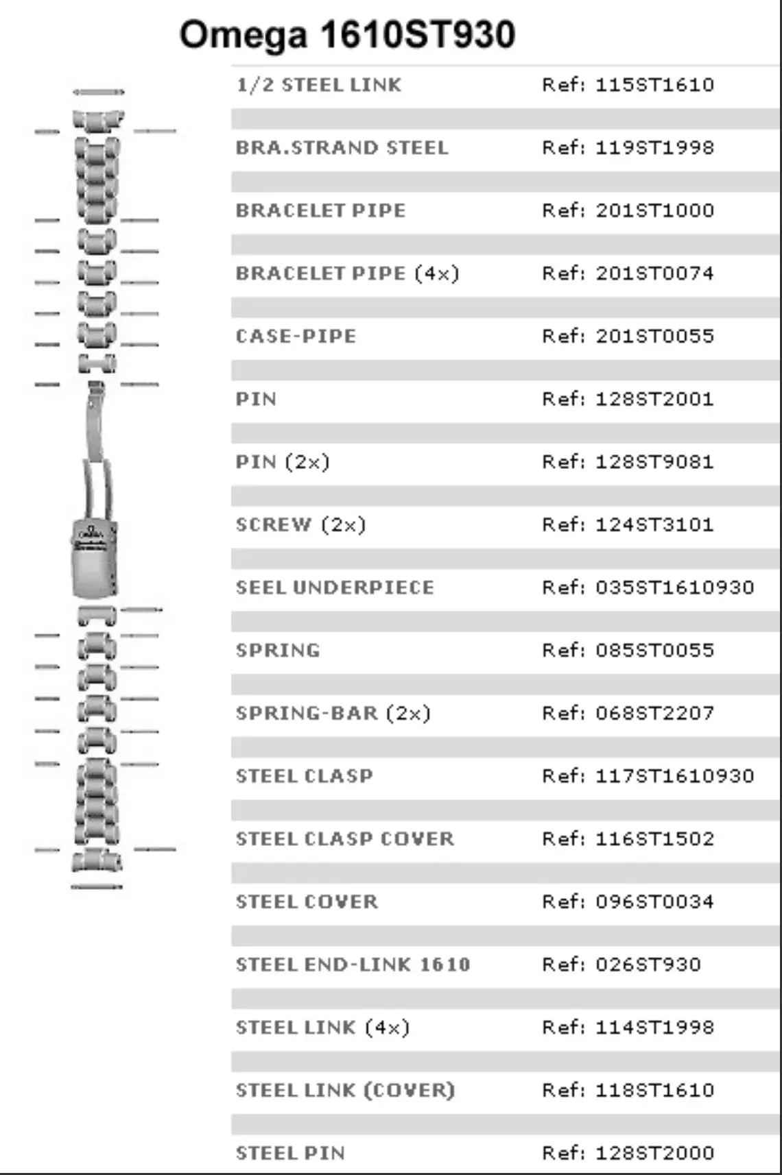

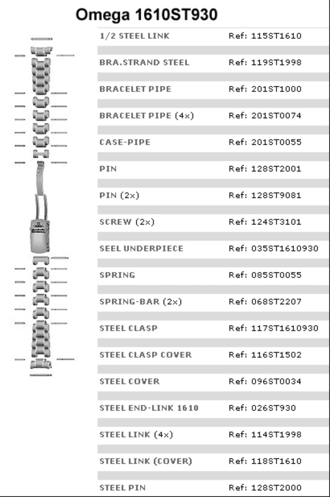

Hold up! Your bracelet is steel, and that diagram Jim posted is for the titanium version, so the numbers you need are a little different. The pin you need is 128ST9081 and the tube is 201ST0074.
Cheers, Al
Cheers, Al
Too late, I already ordered 128ST9081 and 201ST0074 from Cousins and can't amend the order. I'll place another one. Thanks for letting me know!

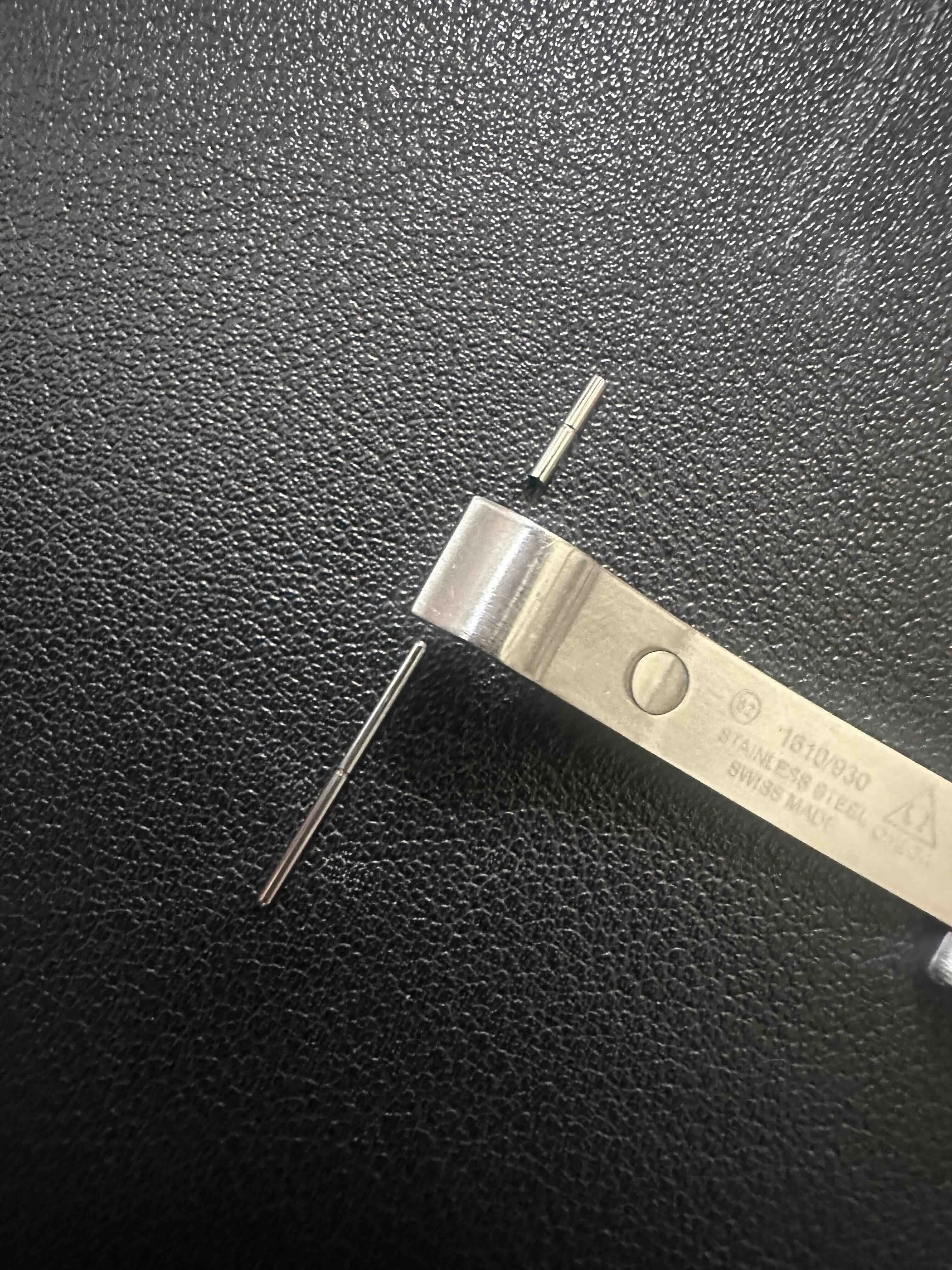

My apologies, must have had a brain fade. For future reference here's the correct one.

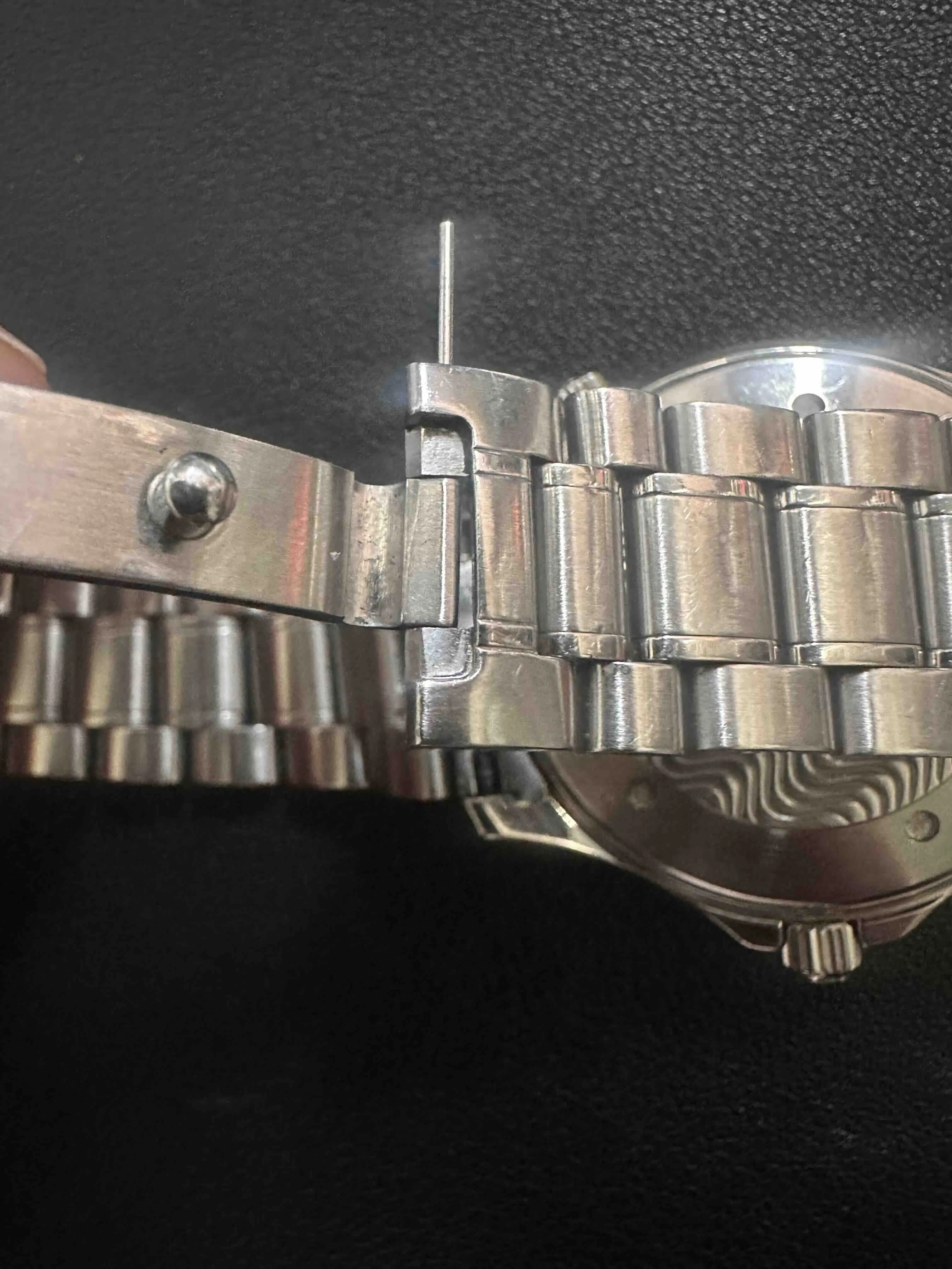

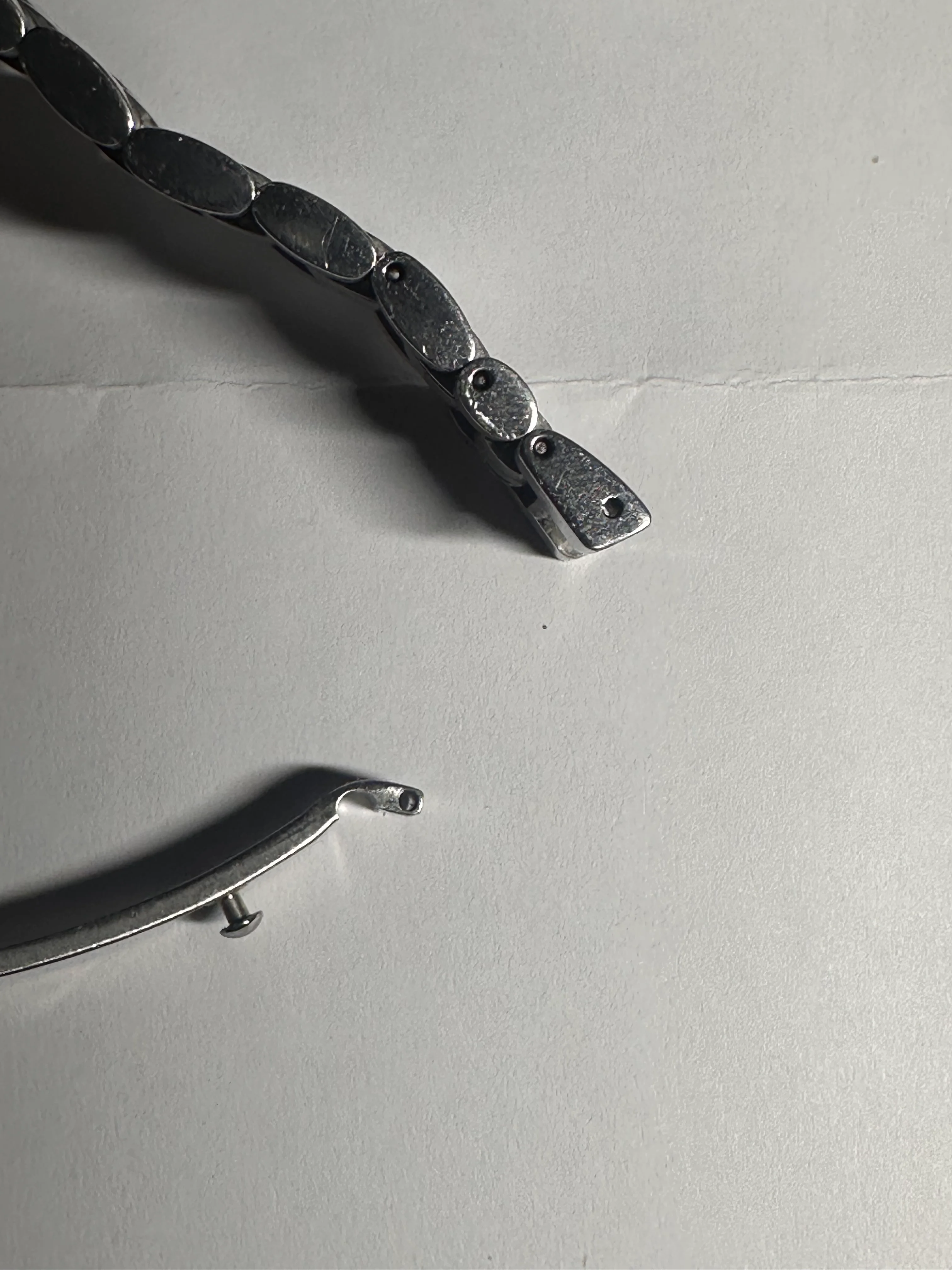

I just received the correct pin and tube for this bracelet, but can someone confirm how to insert the tube and pin?
I know this sounds like a dumb question, but I've inserted the tube into the central section (don't know what that's called, but see image below), then inserted the pin into the link and tube, but the pin gets stuck and won't go right the way through (see image below). What am I doing wrong?

All you need to do is tap the pin all the way in. Just make sure you keep the bracelet parts aligned as you do so.
OK, so the tube is deliberately thicker than the width of the hole in the bracelet part, because that's what keeps it in place?
30,305
78,236
The pin will bind in the tube - that’s how the whole thing is held together. The dimple in the tube is where the pin will stop going in easily, and it will need to be tapped in the rest of the way.

i've got the same bracelet and the part where the bracelet attaches to the end link is a little loose. I want to swap out those pins. are they the same as the pins that you take out to swap out a link? thanks for the help!
No...
Pins are 128ST2001
Tubes are 201ST1000

No...
Pins are 128ST2001
Tubes are 201ST1000
Hey! Thanks so much for the reply. I've found the part on cousins uk for a reasonable price (thankfully)
So, the part number for the pin you shared 128ST2001 is the pin that connects the end link to the whole bracelet? and this will work for the titanium version of the 1610 titanium bracelet?
My other worry is, is that it's not the pins that are worn and it's the titanium links themselves, wich would be a whole different problem all together......ah, the fun of watch making.
Thank you for your help!
30,305
78,236
Yes that pin connects the end link to the bracelet and is different than the pin for the other links in the bracelet.
