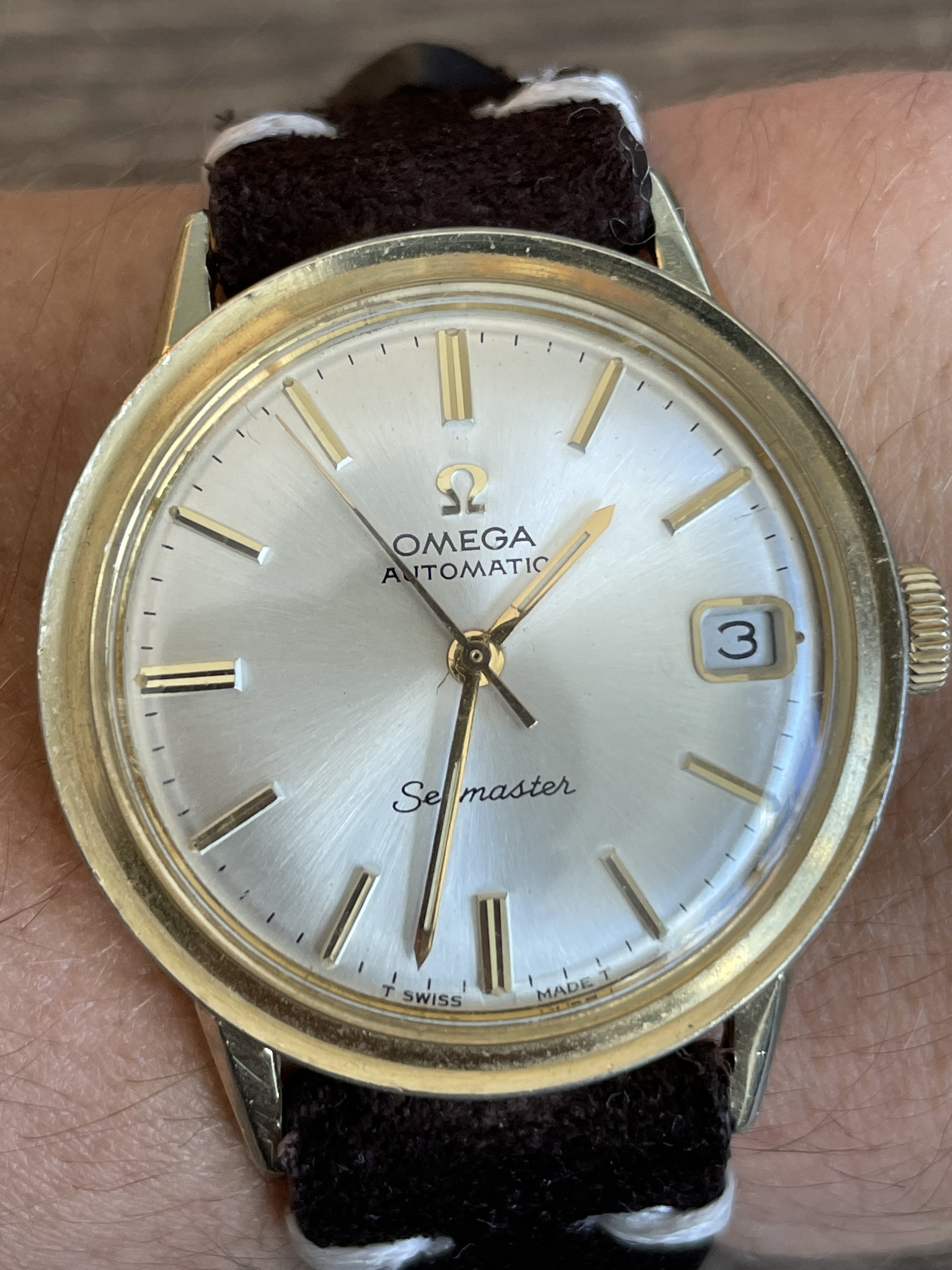

Can someone help verify if this is a redial?

This is really throwing me for a loop. I feel like redials are usually pretty obvious but this one seems to be riding the line of "good condition" and "possible redial". I just want to know if I have good value here.

No I did purchase it after I got some initial feedback that it was good to go.

Bad redials can be seen at 50 paces. Occasionally very good redials need to be seen in the flesh or at the very least multiple, hi res pictures.

If you have it in hand what’s the reference?
Have you searched other examples of the same reference to check font, spacing etc?

Well here is another high resolution shot! This time with my brown suede strap.
Thank you everyone for your help! This is my first time on the forum and this has been really informative. I wish the seller knew more about the watch but they didn’t give me a ton of information. Inside the case back there are some service notes from the 1990s. I really should service it soon if I intent to keep it. I paid about 400 USD

I was told it is a KM6303 with a cal. 563 movement. Not sure if that is helpful.

For that price you did great, it's a fine watch and hopefully this thread has alleviated any concerns you had about dial originality.

looking at other km6303 references, especially those with the rounded S like yours, shows that this unusual wide ‘T Swiss Made T’ is correct for this reference so you’re all good.
