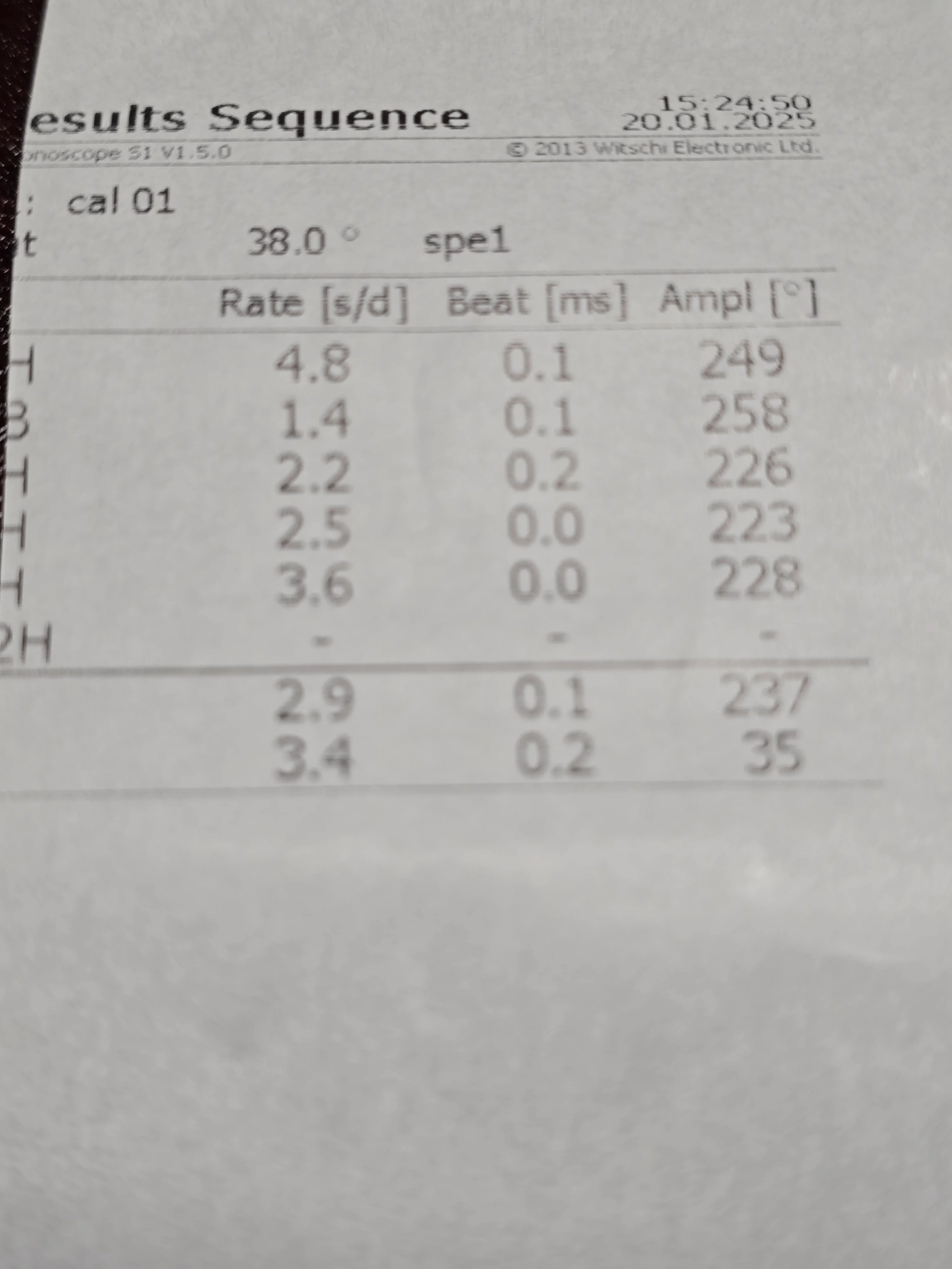

I took my Aqua Terra 8500 to my OB for inspection. Results said amplitude a little low, service recommended but it's up to customer. My SA said I could wear it for a couple more months and send it in for service in the summer. Here's the results I was provided.
I figured between now and summer, if I'm already there I said let's just take care of it now and I authorized the service. However, I'm curious to know more of my watch's current condition and if service was indeed imminent. Not looking to be made to feel good about my decision, I'm interested in the honest truth of the condition. Can someone help me make some sense of it and what is your opinion? Thanks in advance.

There's no way I would have had that watch serviced. Your rate is excellent (average of +2.9 seconds a day). Your delta (difference between the fastest position and slowest) is excellent at 3.4 seconds. Your beat error is excellent.
I don't know what the amplitude standards are for a 8500 but those numbers are not shockingly low.
Are you have power reserve issues? I doubt it but wanted to ask.
Personally, I let on wrist performance determine if I have a watch serviced. If a watch keeps good time and the power reserve is adequate for my needs, no service.

The watch had been running fine, very accurate. I was concerned because I bought it online with no service history. Being the first watch I'm sending for service, perhaps I concluded the amplitude is more concerning than it really is, given that the internet Bible claims less than 270 indicates a need for service.

If it's a watch you want to keep for years and years and figure you'll have it serviced anyway so why not do it now and enjoy a basically "new" watch, I get it. I did that with a Seamaster 2220.80 I bought that was running fine, but was 10 years old and had an unknown service history and I wanted to get it in like new condition. So I sent it in and basically got a new watch back. I was very happy with my decision.
But in terms of current performance, I don't think that watch needs a service right now.
FWIW, the only amplitude standard Rolex has at full wind is that the amplitude not exceed a certain number. Minimum amplitude is measured 24 hours after a full wind (and the watch has not been moved). The minimum standard is 200 after 24 hours.

It is my plan to keep this one long term. I figure that this watch being more than 10 years old has never been serviced, since it came from a reputable seller with no box or papers and unknown service history.
I was more interested in having the crystal replaced because it has a lot of hairline scratches on the AR coating and overall the watch could benefit from a little touch-up. Sending it in for a crystal replacement was going to run $200.
My online research revealed that the amplitude on this movement should be between 270-320 degrees so to the uninitiated like me, it made sense to do a full service, since I was going to do the crystal replacement anyway. However, I'm still ignorant as to what the numbers truly say about my watch.

The only specification from Omega is that 24 hours after full wind, the amplitude should not be below 200 degrees in any position.

Thanks @Archer - would you mind sharing with me your interpretation of the printout?
Sure.

Thanks. Seems like my SA was less than truthful with me about the imminent need for service. On the one hand, I feel like calling to cancel the service, other than the crystal replacement. On the other hand, getting it done and over with and having a fully restored watch is not a half-bad idea.

I have no idea what the state of wind is when they took that test. If it was at full wind, the amplitude isn't great.
Having said that, any parts that might be wearing inside are going to be replaced under the standard charge that they have, so you are not saving any money by having it serviced now compared to a year from now (unless the service cost goes up).
The only thing I would say is, be careful around water, because if it leaks and the dial gets damaged, then that is not covered under a normal service cost.
