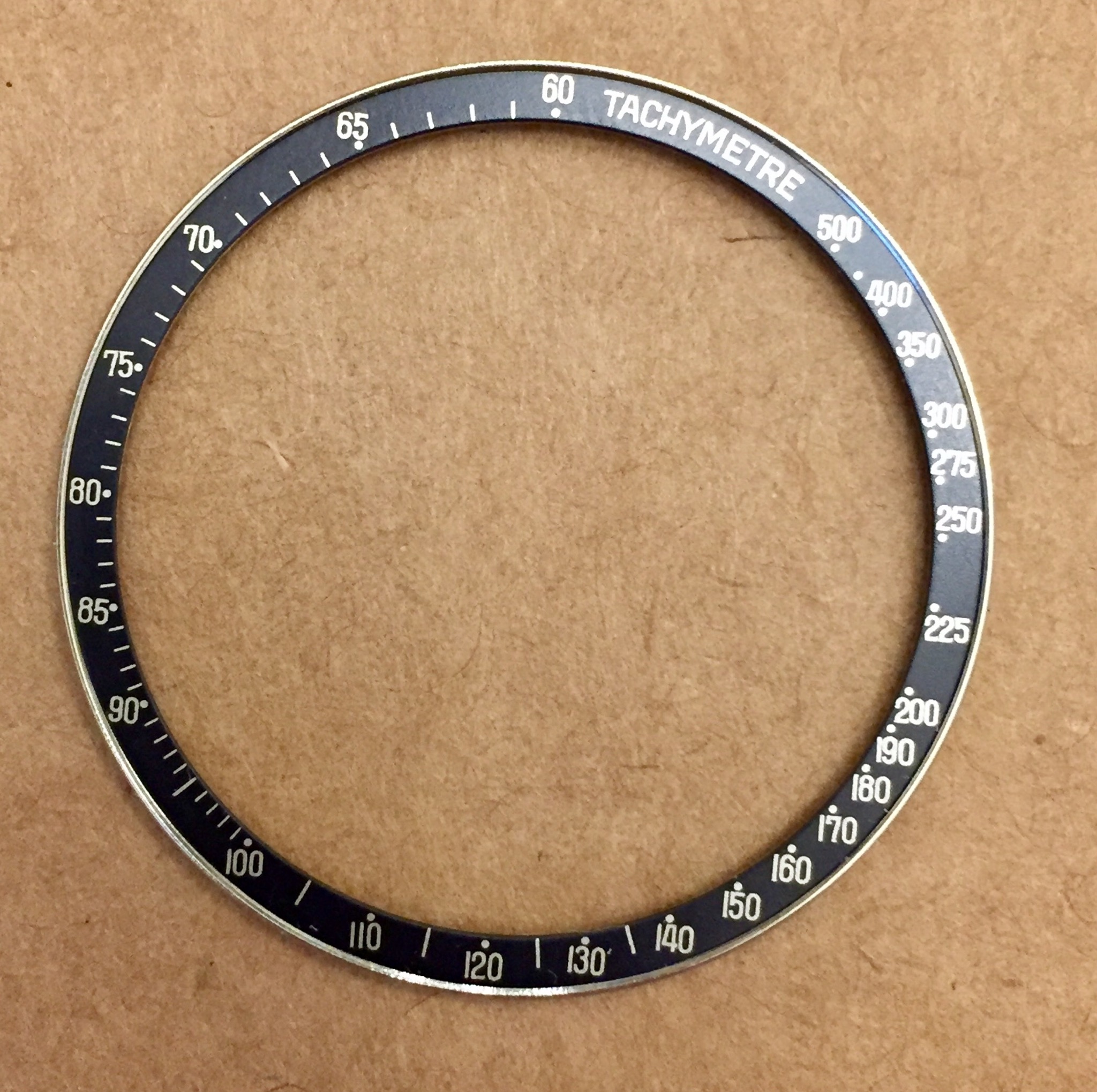

Can someone check Moonwatch Only book to see if there is any mention of variances in the bezel housing itself?
I have what seem to be a DNN bezel with a thicker flange. See this thread.
https://omegaforums.net/threads/thicker-145-022-speedmaster-bezel.71396/#post-899198

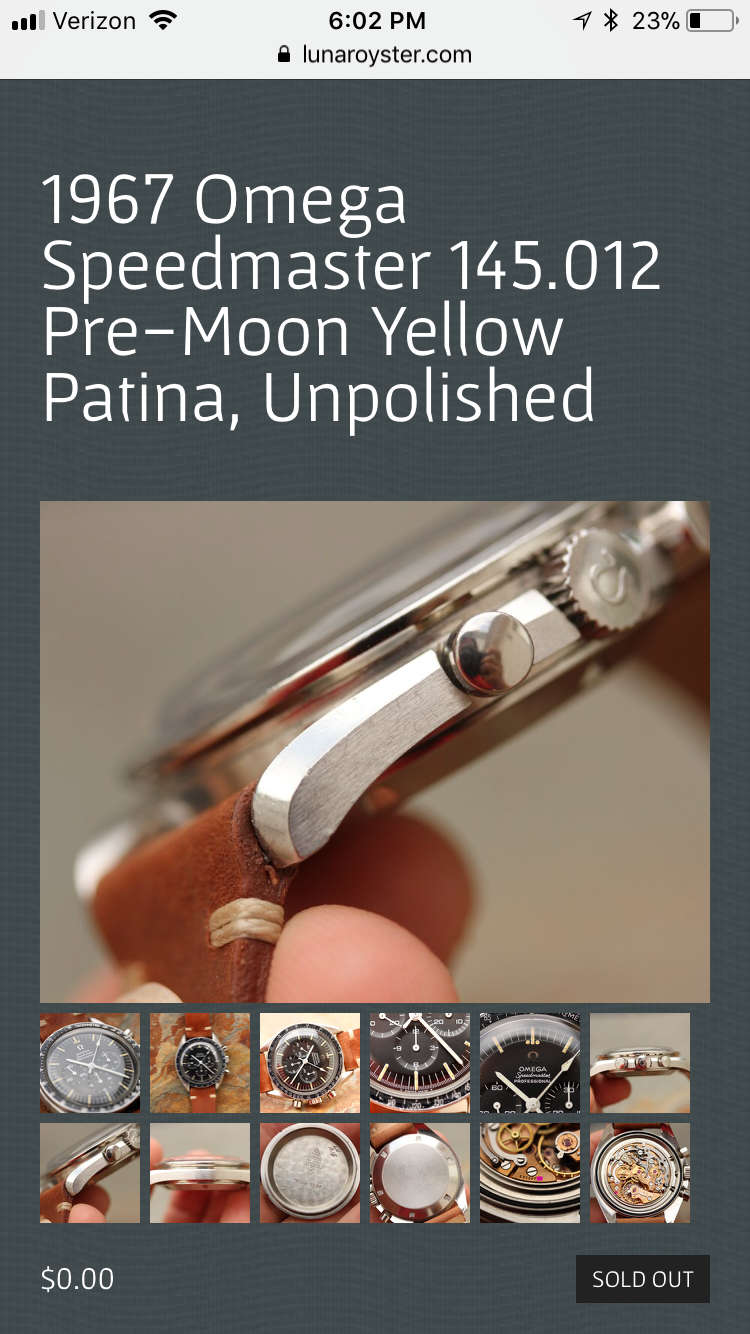

But I also find pics of a what seems to be thicker bezel. Like this one from the archives of Lunaroyster.com.
So....is there a variant on the bezel as there is on the bezel insert (DNN/DON)?

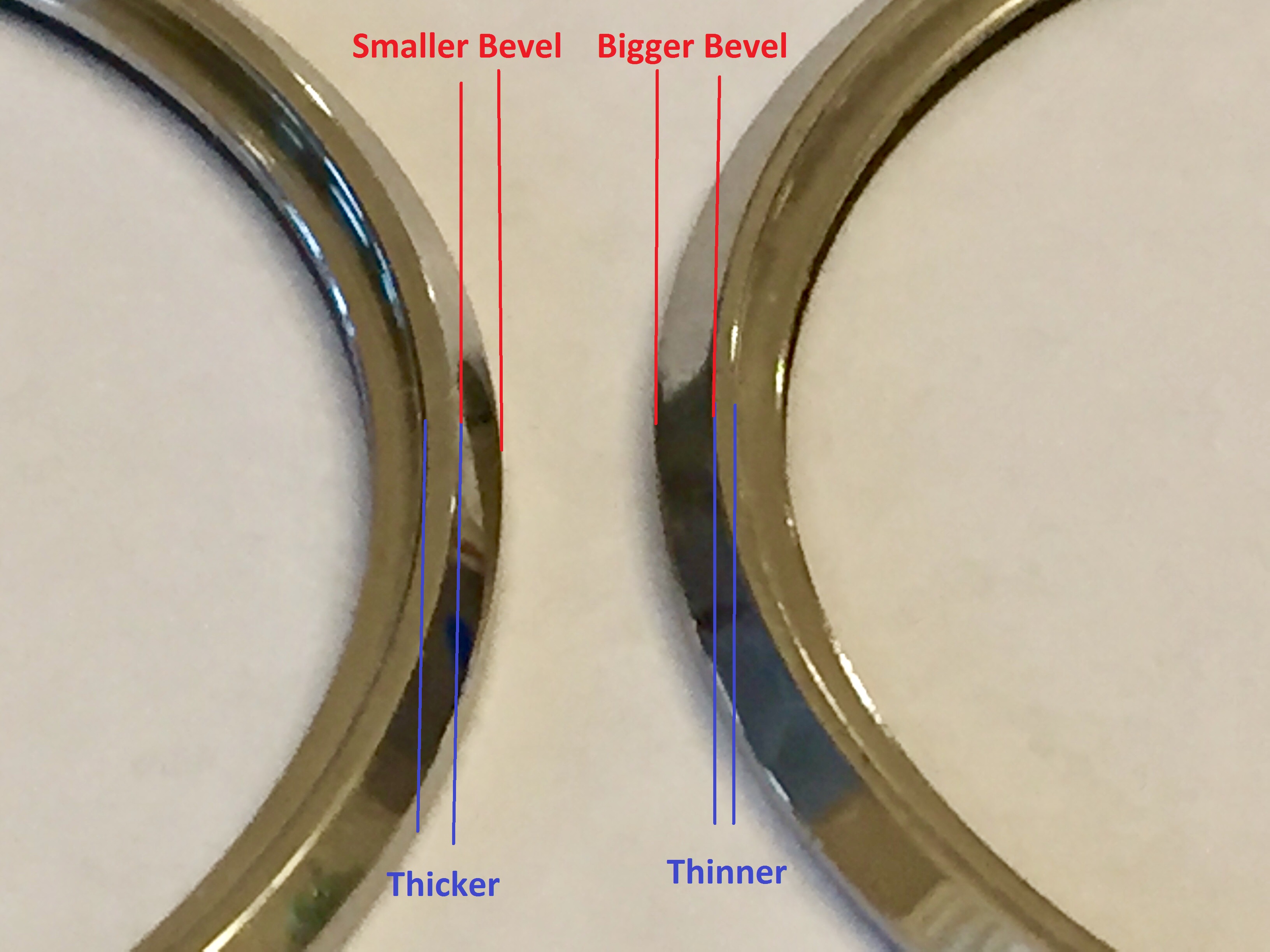

I am talking about the bezel housing itself. The insert looks correct for late 69ST to 71ST.

Thanks. The bezel insert looks correct, but the bezel housing itself is different than what I got on my watch.

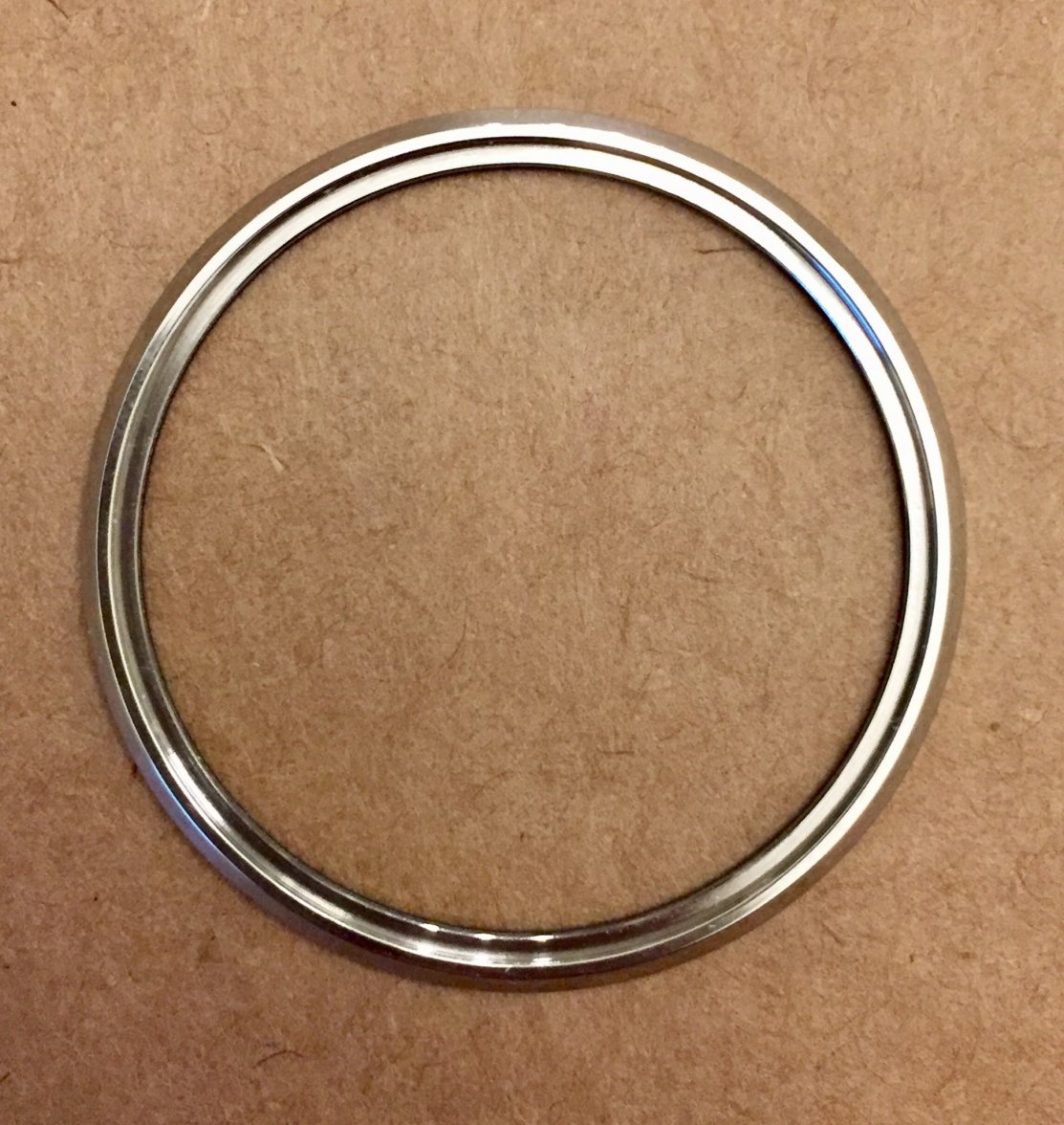

any chance you could take some nice, clear pics of both bezels off the watch?
what's bugging me is that there appears to be a small gap around the outter edge of the insert and the bezel itself, and there doesn't appear to be an inner aluminum edge as there is on the one from MWO.
zooming in on the pics in your other thread, the pics are not very focused, and one bezel (the one on the watch) is partially hidden.
13,590
53,219
as if the insert is smaller OD than Housing ID.

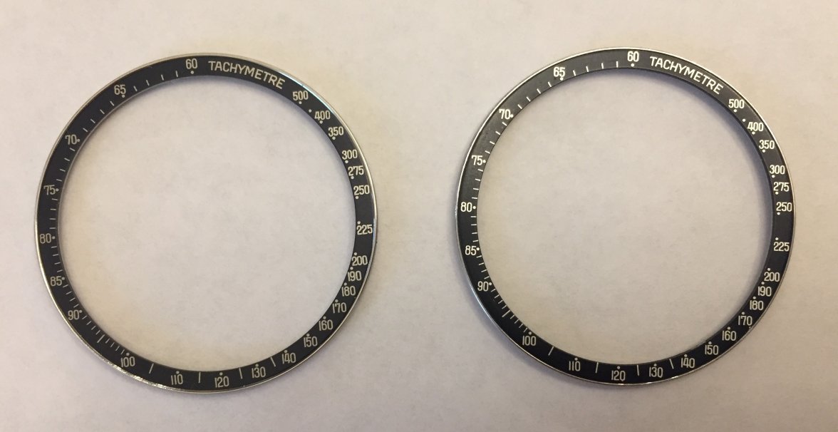

227
327

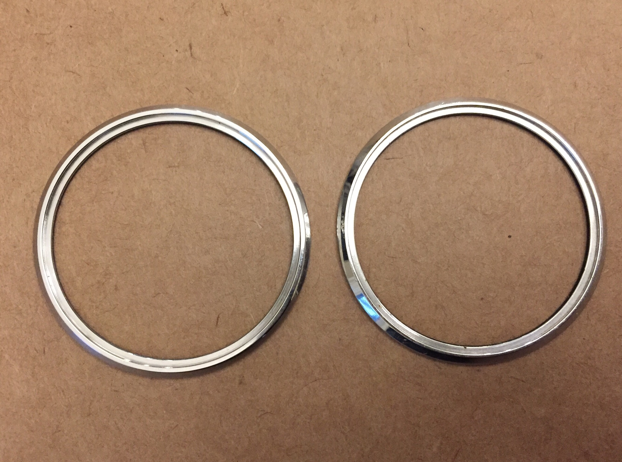

Here are the front and back of the bezel. He left one is the thicker one in question. The right is what is currently on my -69.
BTW, there is no gap on between the bezel insert and the bezel. What you see is a shadow of the edge/lip of the bezel higher than the insert.
13,590
53,219
Getting eye strain here but they look like the same bezel.
227
327
Let me insert pics to show the differences which are on the sides and back of the bezel housing.

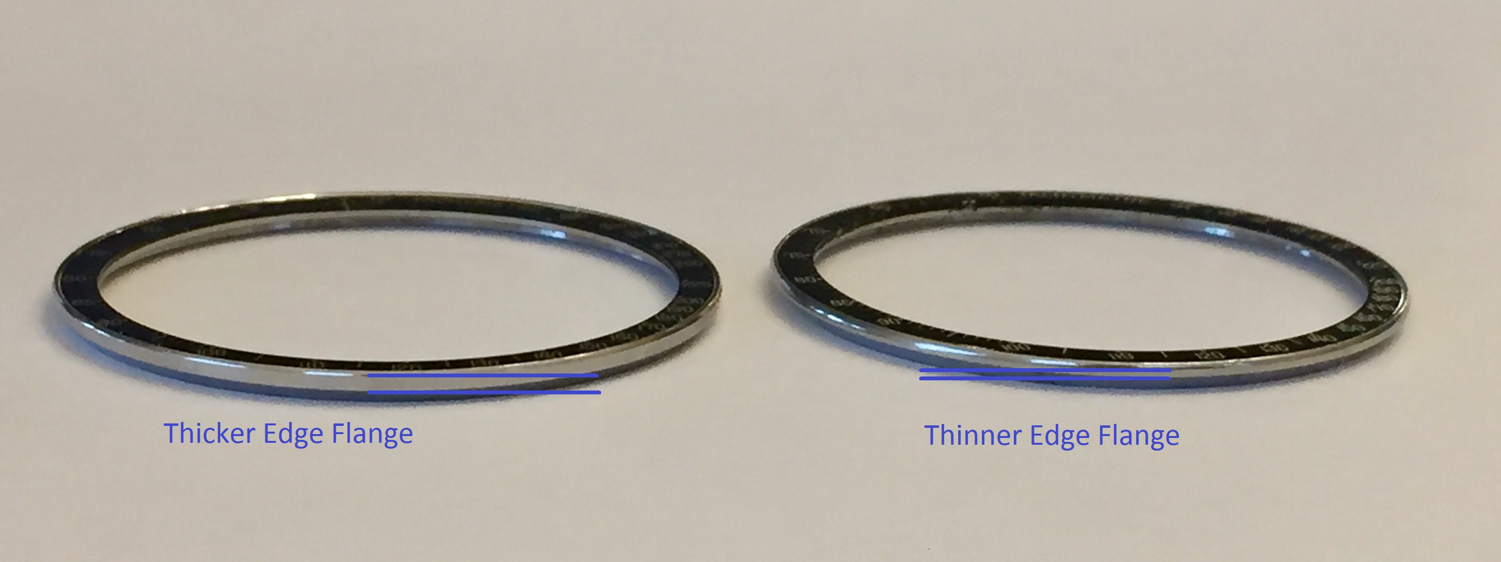

227
327
Let me know if you can see my illustrations.
The thicker bezel question is on the left in both pics below.
29,374
75,999
I've posted this before, but not all the bezels are the same, and they are not all interchangeable.
Same with some case backs.
Cheers, Al
Cheers, Al
Any guess as to why? Different parts manufacturerers? Bezel caseback and case made at same time and hand fitted?
Cheers, Al
Cheers Al,
If there are indeed different bezel variations, how does one determine which bezel fits which case if the inserts are identical?
My watchmaker told me he did encounter bezels that didn't fit and his solution was to turn the bezel on the lathe to remove some metal if too tight, or make 4 notches and glue it if it was loose.
Different case makers.

I spent some time looking through LunarOyster archives of Speedmasters they have sold over the years. (It's a great source of research BTW with the clear pictures.)
https://www.lunaroyster.com/archive-speedmaster/
So far, I can see that the thicker flanged bezel housing lasted up until about 2002 or so onto the 3570.50 series and their DNN with dot-below-70 bezels
except when you want to research unpolished cases 😀
