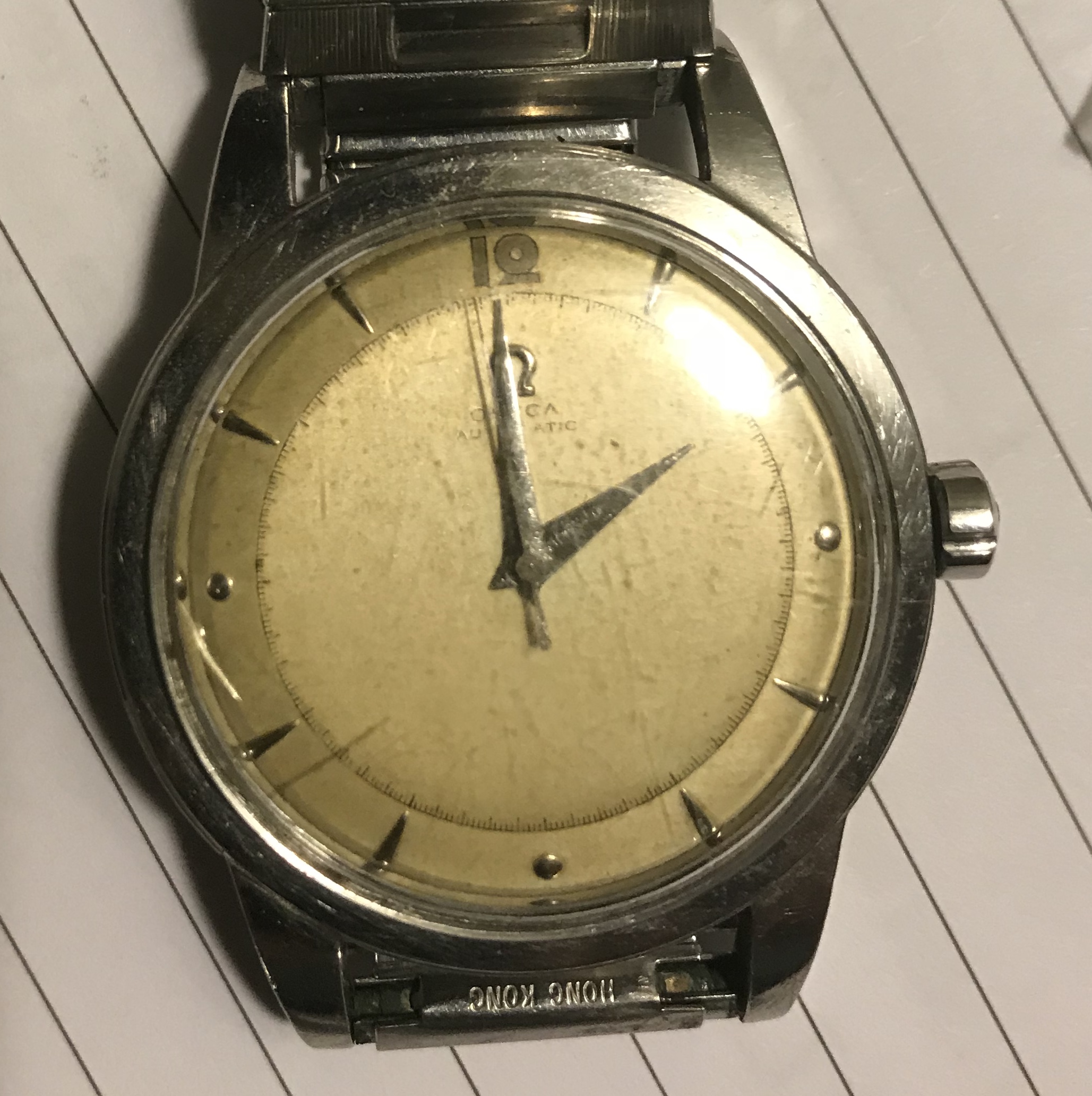

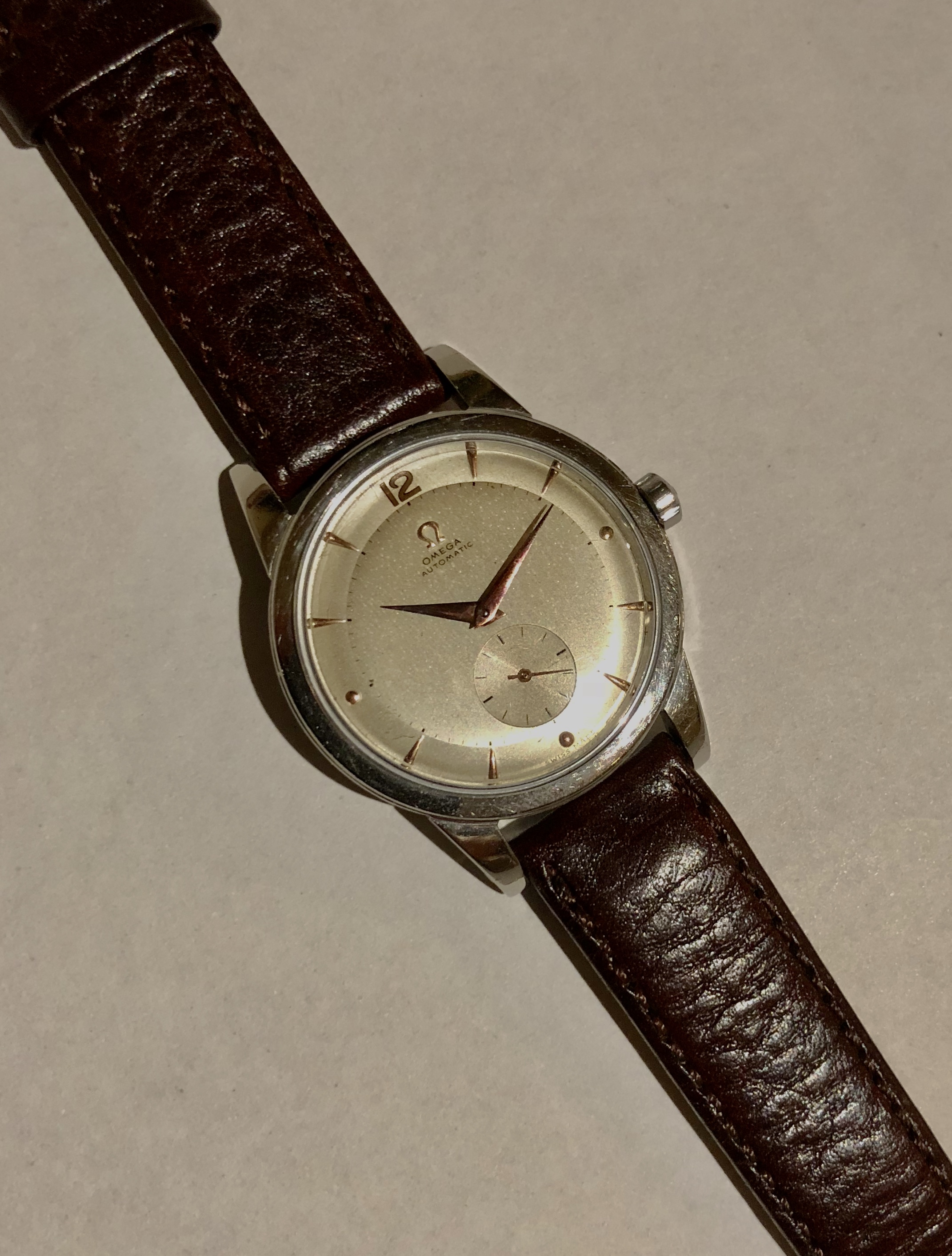

My dad bought this Omega around 1950. My dad passed on, and I cannot find any information about it. Can anyone help? It’s interesting in that the “2” in the number “12” looks like the Omega sign. It has a stainless steel case.
Thank you for any help you can give me.

Sorry about your father - he left you a nice watch to remember him by.

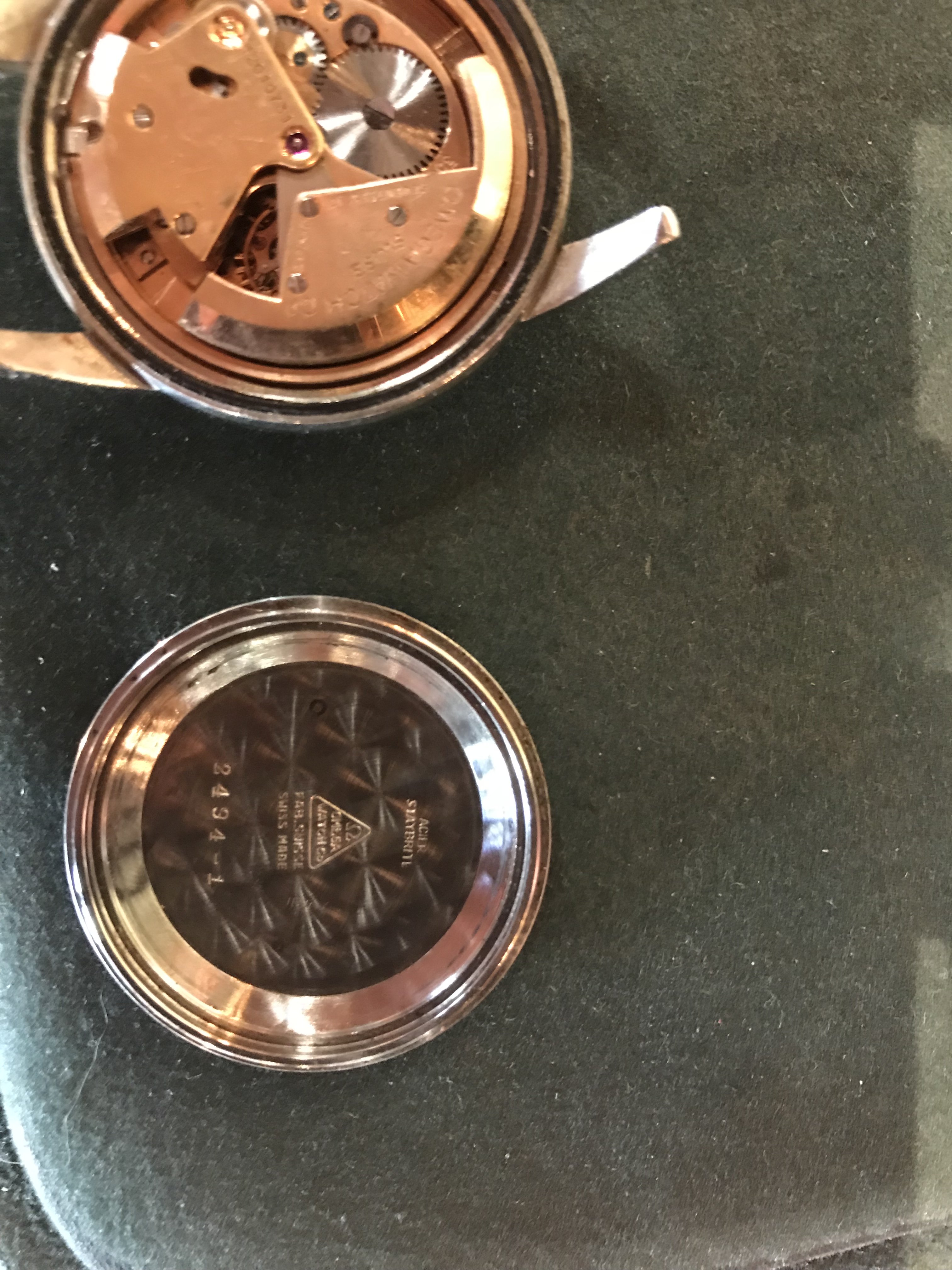

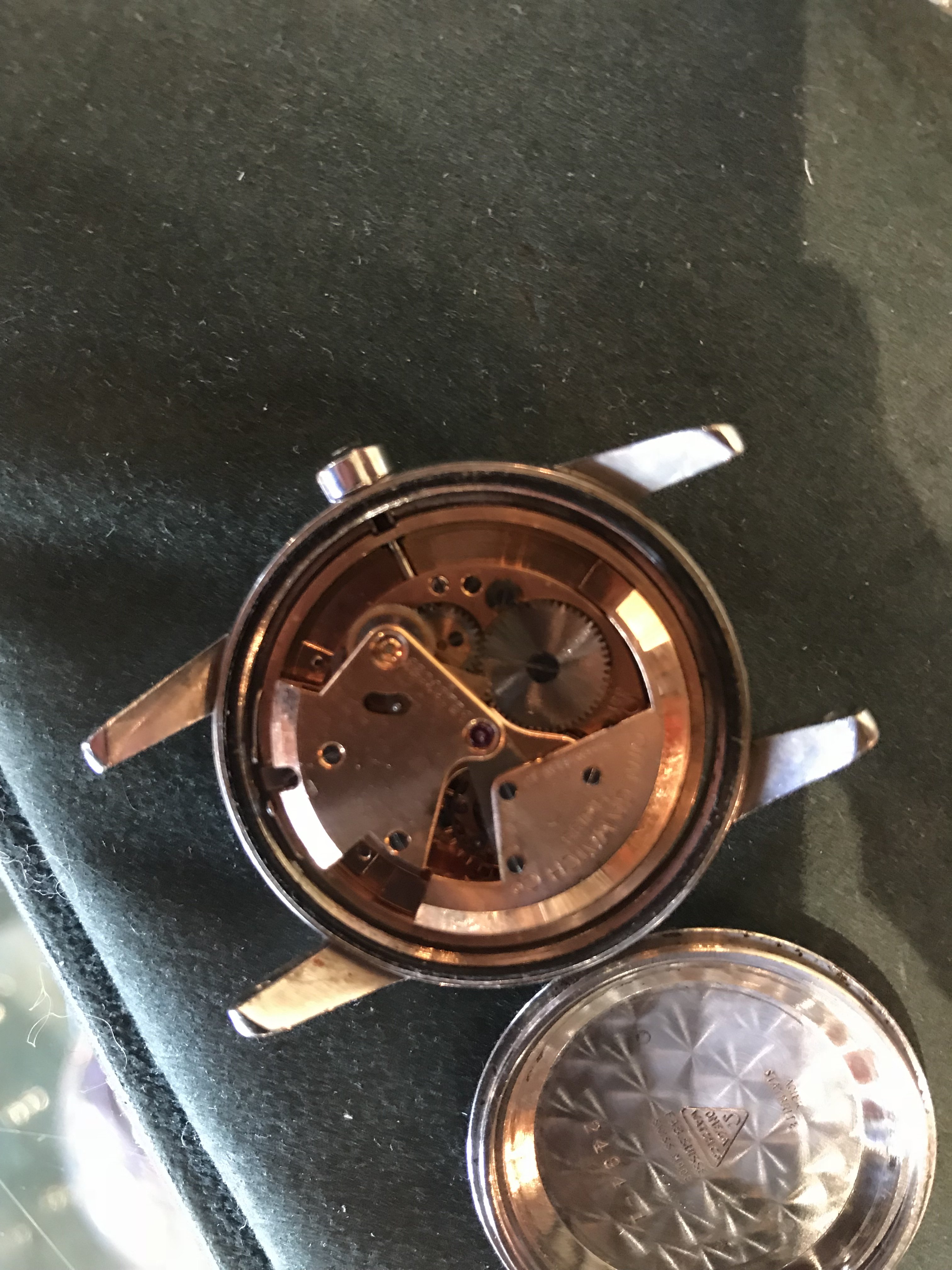

We’ll need photos of the inside of the watch - the movement and the inside of the case back - to give much information. Photos of the back would help as well.
It should have a bumper automatic movement, perhaps a caliber 351. Case reference I’d guess to be 2577. Have a local watchmaker open it up to confirm.

Hmm, how big is the case? Looks like a jumbo version, the 2494 😀
Odd dial, that "12" is usually not the only number on there.

The watch is at the jewelers (the auto wind teeth wore out and a parts need replacing) who is puzzled and is trying to find more information about it. I will stop by his shop, take photos, and post them. I’m sorry to say that I am ignorant about case sizes, but I’ll find out. It’s a stainless steel case is all I can tell you.

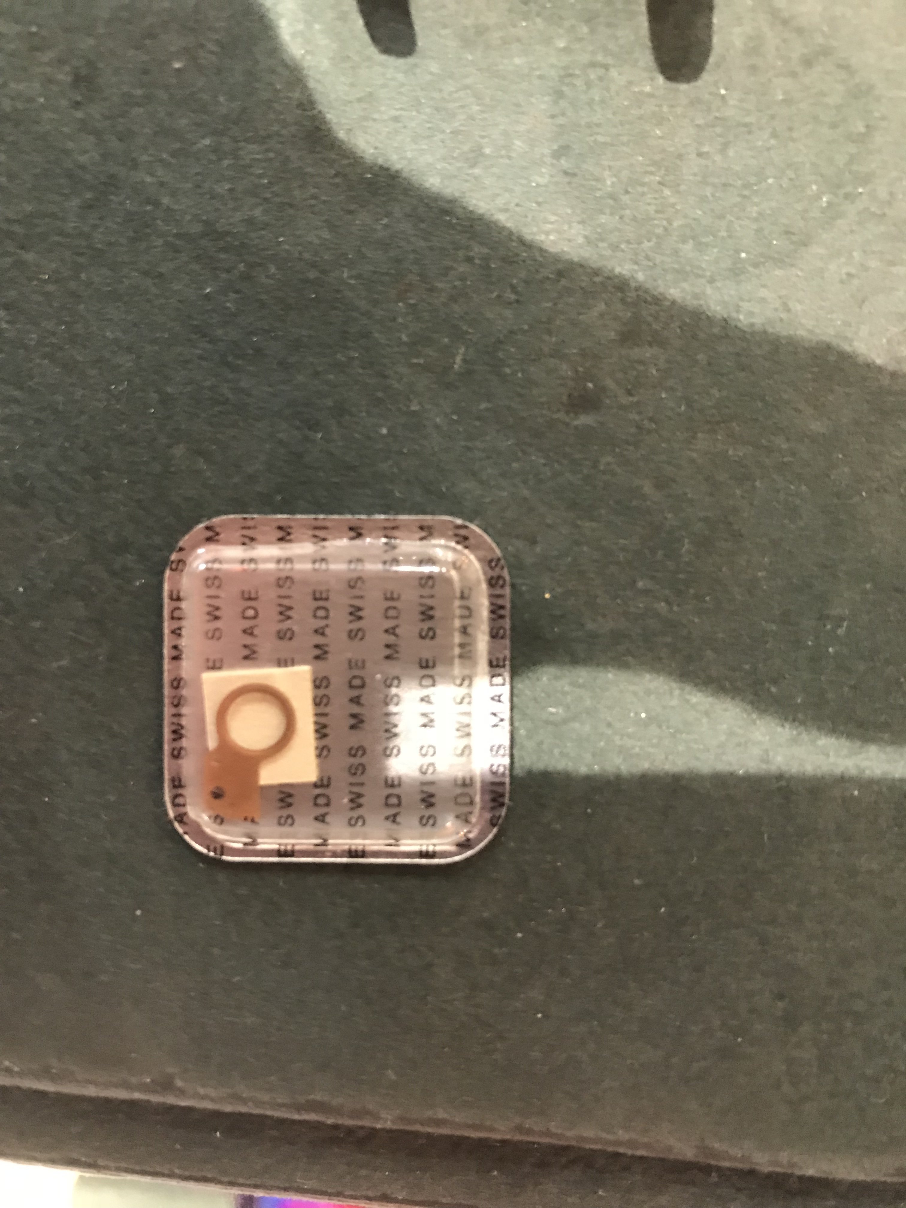

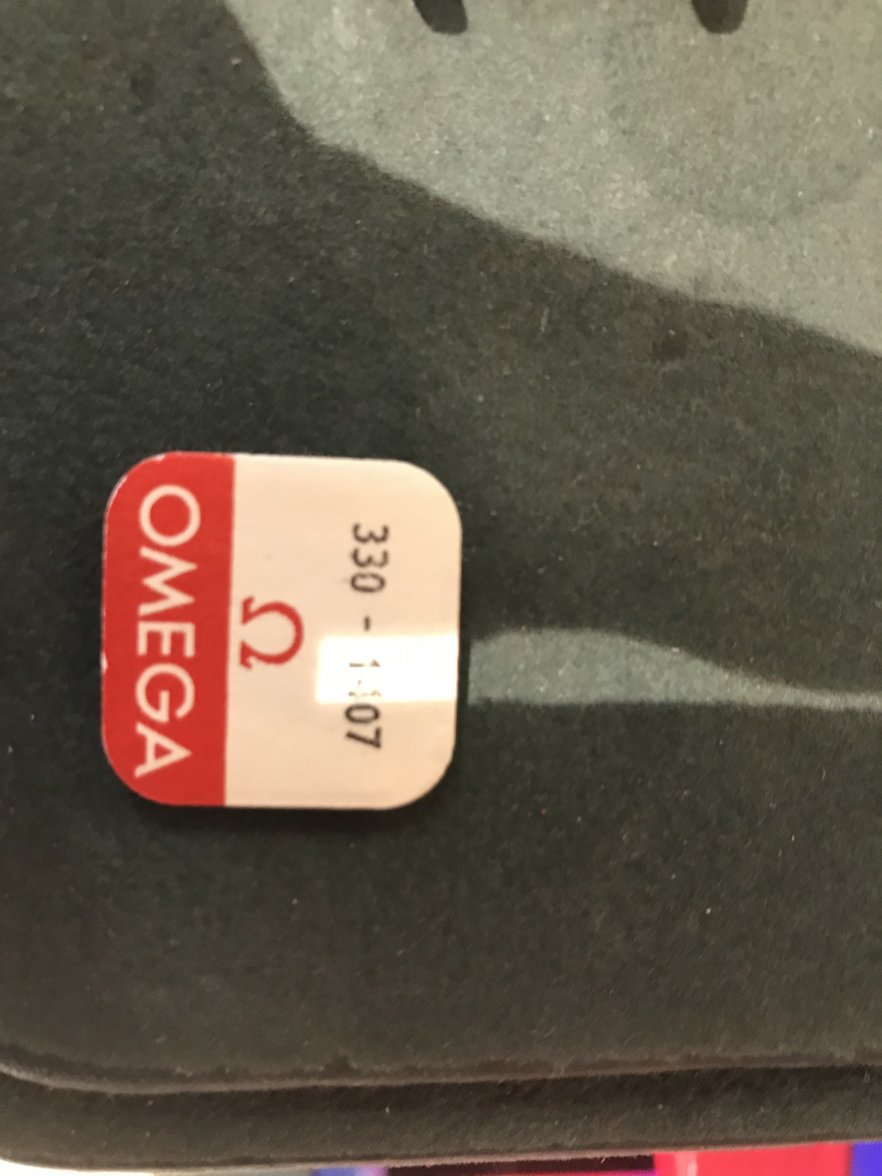

Here are pics of the front (already posted), the inside of the case back, the interior workings, and the replacement part that will be inserted. The part is about 50 years old, and it has never been opened. It is a bumper automatic. I’ll keep searching online. Any guess?

When you take more photos, move the hands so they aren't obscuring the text.

Sorry, it says “Omega Automatic” under the hands

I know what it says, but we need to see the condition of the text.

We know what it says, we need to see a clear shot of the printing so it can be evaluated to confirm if it is original or reprinted.

Here’s a brother with different typeface mirrored “12” and bronzed markers and hands. This case wears very well—- your father had good taste. I think when you clean up your crystal you’ll be happy.
This is a two tone dial like yours but it’s night time here and I can’t get a good shot.

Got it. I’ll get a better pic

My concern is the seconds track and the (apparent) lack of "swiss made" at the bottom. I see this same type of seconds track on a large number of old redials, mostly on early bumpers.
Hey look - it's a reference 2494! 😀

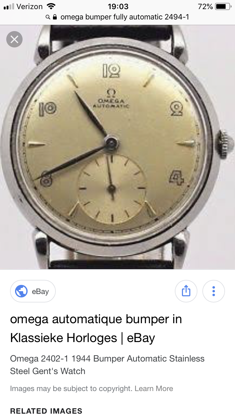

Yes, you called it right at 2494! It does say “Swiss Made” in the inside cover, and I found a pic of another dial with the same Omega symbol in the “12” and in the “2”. Here’s the pic - it’s 1944. I just can’t find another pic of the dial on my dad’s watch.

Good call on the reference. I have also seen many original dials with this type of second track, and the beautiful art deco numeral looks original. Markers align perfectly with the printed track. And pointy A is OK for this era. What I dont like is the chopped tip of the minute hand, other than that I thinks its a nice example.
