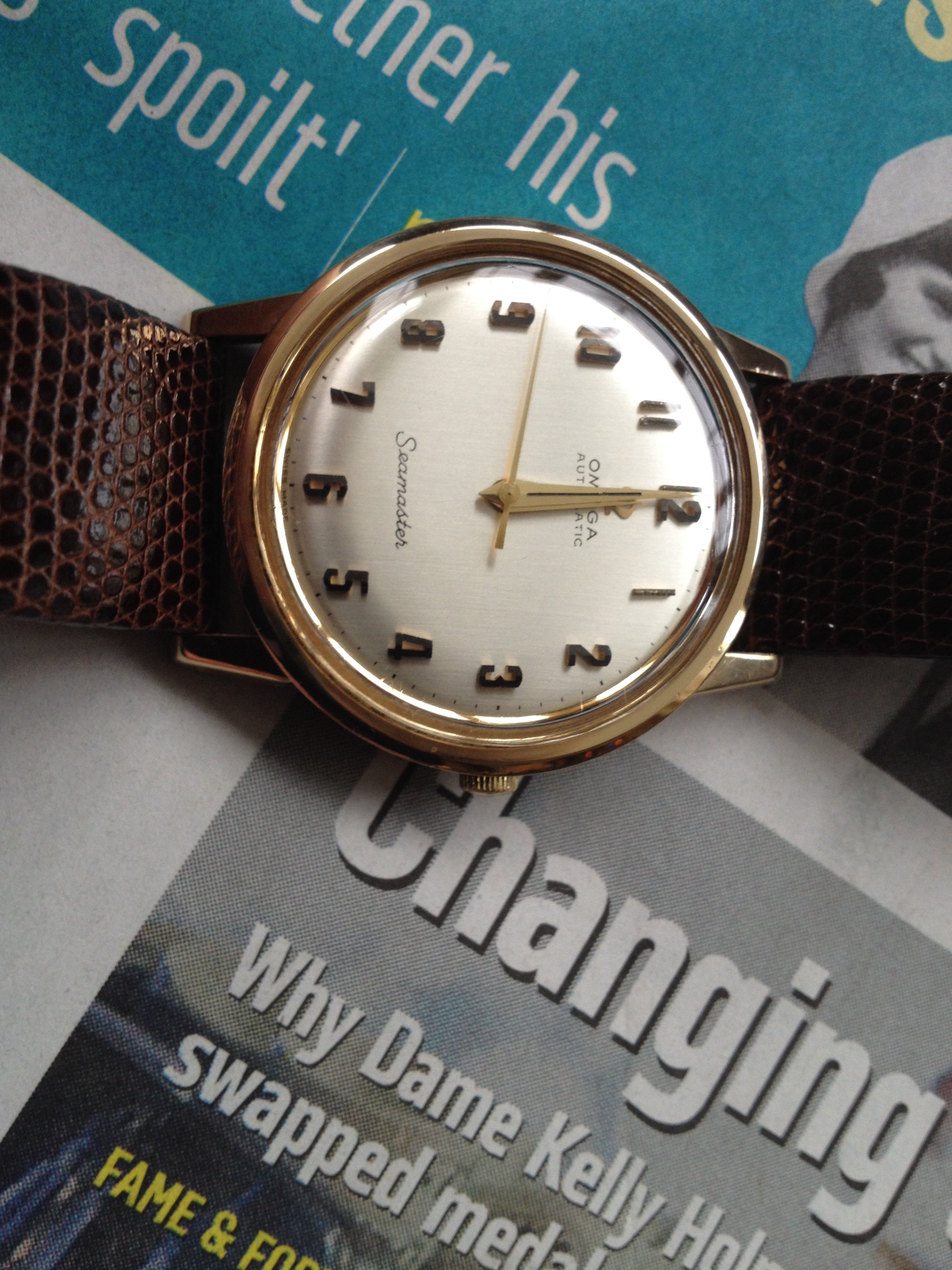

Hi All,
I have just joined this group and was hoping for some feedback on a watch I inherited from my Grandfather just over 30 years ago. I only wear it occasionally and in the time I have owned it it has not been serviced or refurbished. Externally it still looks like new but I'm wondering if I should get the moment serviced? I probably wear it around 6 times a year.
Any help and background about the watch (model etc) would be really appreciated.
Thanks in advance.
Paul

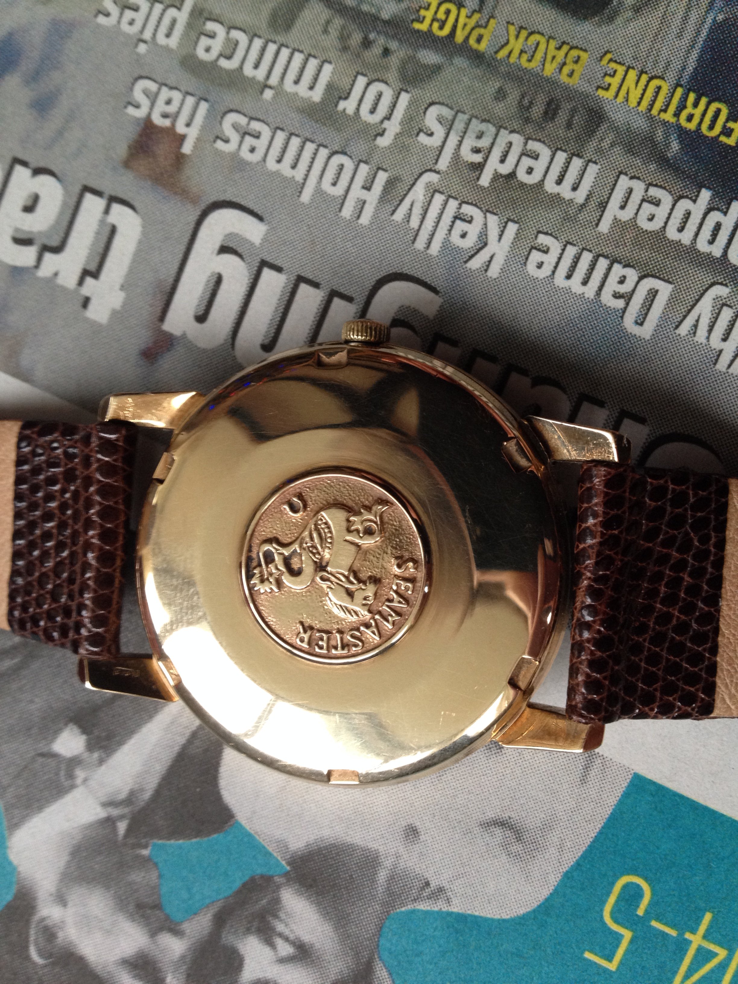

Nice. 1960s Seamaster. The exact model details are on the inside of the caseback. The model number will be of the form 165.XXX, 165.005 maybe? If it is full size, ie 33-34mm it probably uses the 552 movement.
That full Arab dial is seen occasionally on UK market pieces as it was a special order for that market, it is less common elsewhere. It looks solid gold. If as I suspect it is a UK market model it will be 9K or 18K probably, most likely the former. There may be an external hallmark too, maybe on a lug? I think I see one there. That is in excellent condition for its 50+ year age.

Many thanks for that, it's interesting. It is full size and was purchased in the UK. The base is hallmarked 9k on the lug. My grandfather rarely wore it and so it's spent most of its' time in the box. Should I get it serviced or is it best left alone?

Get the watchmaker to take a photo of the movement and inside the case back.
Movement will give us Serial# (for age) and Caliber# (Type of movement you have)
Caseback will give us Model#

Very nice indeed. Search for the Dennison thread on here and post it there. It is one of the nicer ones by far.
The watch was hallmarked for July 1966 to June 1967 in the city of its casing, Birmingham.
The case number is 165.5003. The leading 5 on the second bit also shows it was a UK market local gold piece but unlike earlier cases this one got a full Omega case number.
