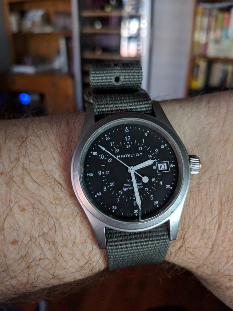

    I'm curious if a watch can eventually, over a period of years, demagnetize itself? Eons ago (8 years at least) I bought a Hamilton Khaki limited edition mechanical watch, but when I got it it ran REALLY fast - like 10 minutes a day. So I never ended up wearing it, and since I didn't want to pay more for servicing the watch than I had paid for it, it's just sat in my watch box. I always thought it might be magnetized since it was so far out of whack, but I didn't ever do anything about correcting it. In the last couple days I decided to see if it still had an issue. I wound and set the watch, and then put my Casio Oceanus radio sync'd watch in next to it to see how well it did. Surprisingly it's actually kept time pretty well. I mean it's off by about 22 seconds (fast) after 24 hours which isn't great, but is a darn sight better than it used to be.
    I'm going try wearing it for a day or two to see if there are any wilder swings, or if maybe 8 years in the watch box was enough for it to degauss itself.

  6. rcs914 Sep 11, 2018
    2,502
    3,593
    Well as I feared it was not so simple. After wearing it from yesterday afternoon till this morning it has now gained about 7 minutes. Just for fun yesterday I tried one of those timegrapher apps that listens to the watch to determine beat error etc. And it was ugly... ranged from -7s to +16.5 minutes depending on position. Basically all over the map, and not even consistent based on position. So it definitely needs to be serviced.
    This particular model is the limited edition mechanical that came out at the same time as the Pearl Harbor movie (2004?). The face is loosely based on the Hamilton GCT pocket watch (why???) and was "limited" to 3333 pieces. I got this for a good price, but a service would still be significantly more than what I paid for it, so likely back into the watch box it goes.
