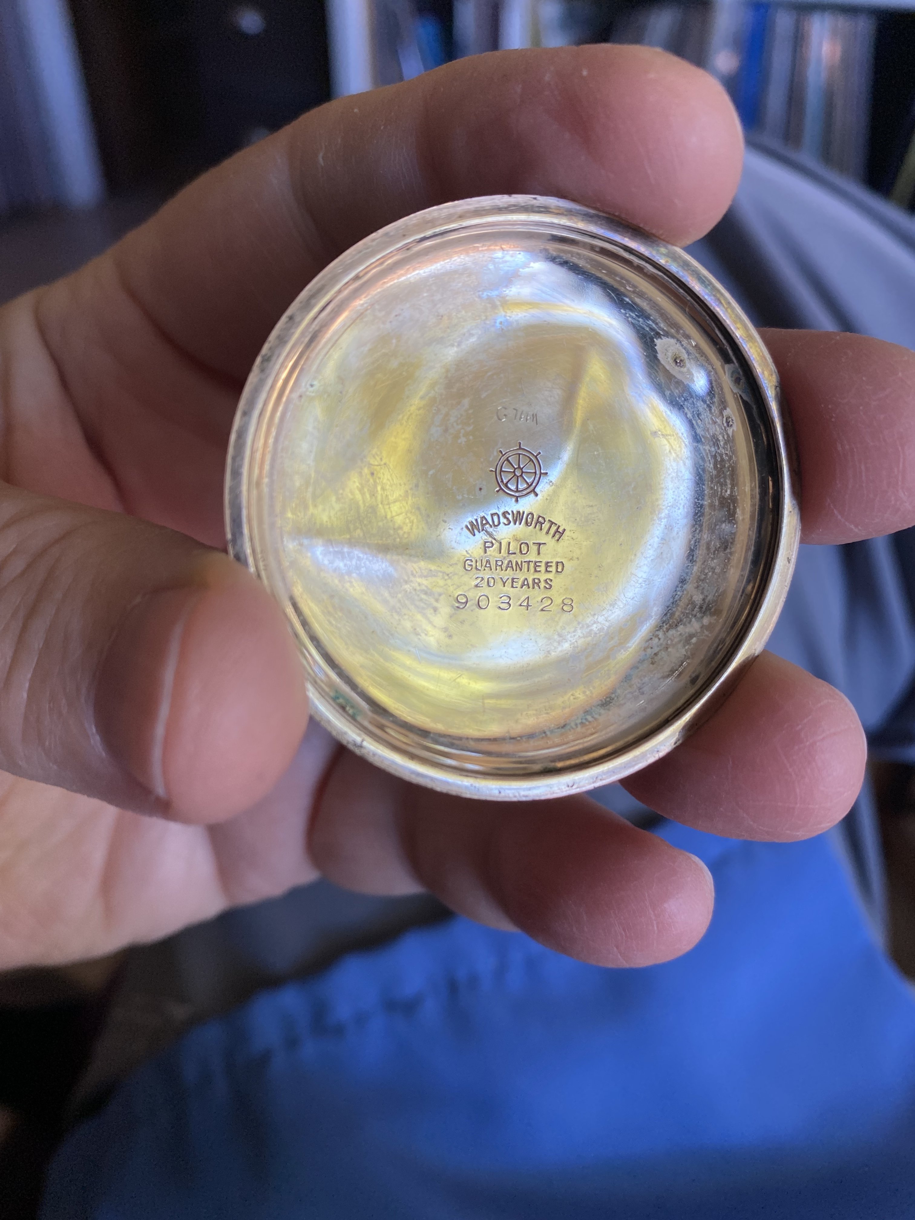

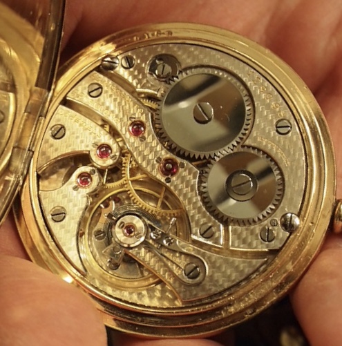

Love the case, and love the dial. White gold filled is a bonus. The bow is still stiff, and the case shows little to no wear. They are still out there to be found, but you have to keep your eyes peeled.

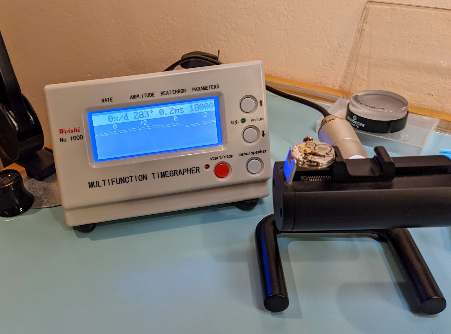

The microphone pick-up usually disinegrates, like puffs up on these units.
Haven't figured out a replacement for the clip on microphone for clocks yet.
Austrian salts crystals? I think.
I put a piezo crystal on mine in the closet. It does work, but I don't like the noise that it makes. Witsche is quiet.....
The Griener is a good unit if you can find one, more quiet than the B200
For what it is worth!
Ciao! Mike
My B200 came with a plug-in cable with an alligator clip on the end, for timing things that don’t fit the pick up. I had one when I decommissioned the machine, but I have no idea where it is now. It may turn up, and I hope it does. I have two marine chronometers I could use the remote pick up on.

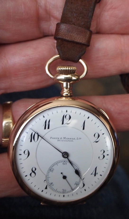

I realize you didn’t ask, but here it is, anyway. Wearing it again today.
I have a manual on the shef, some where for it also.
Also, a book with print outs for diagnostics on the ticker print outs.
Chips in pallets, bad tooth, so many & haven't looked at it in years!
Fewer, I expect, than 20-25 years ago when I bought this one.

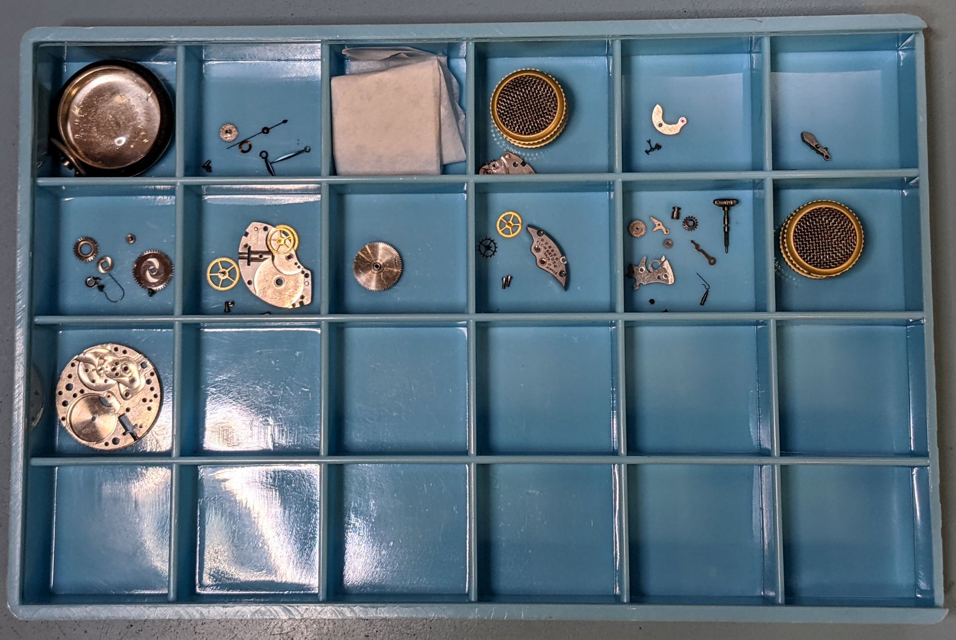

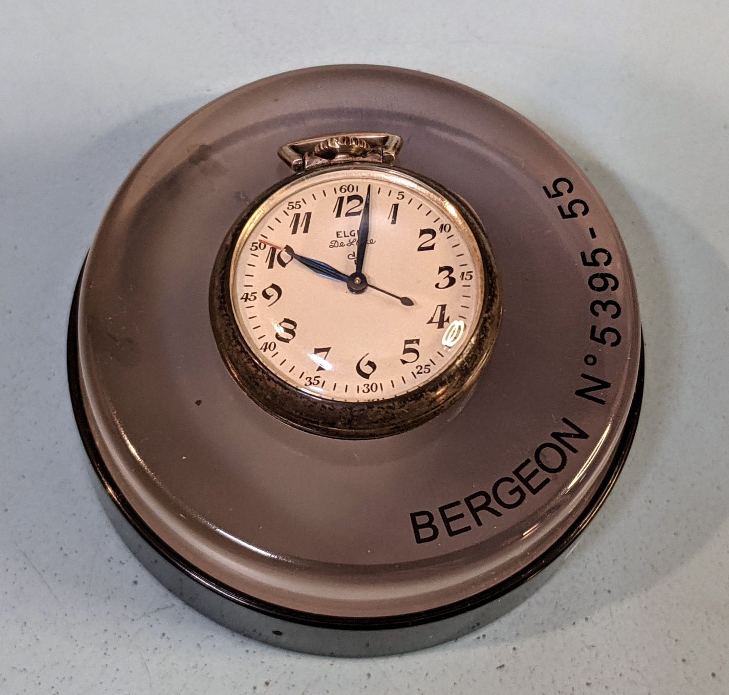

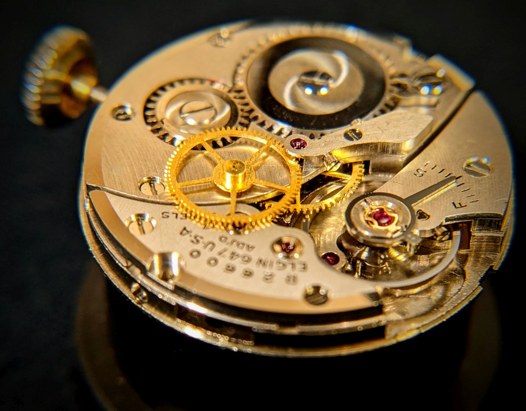

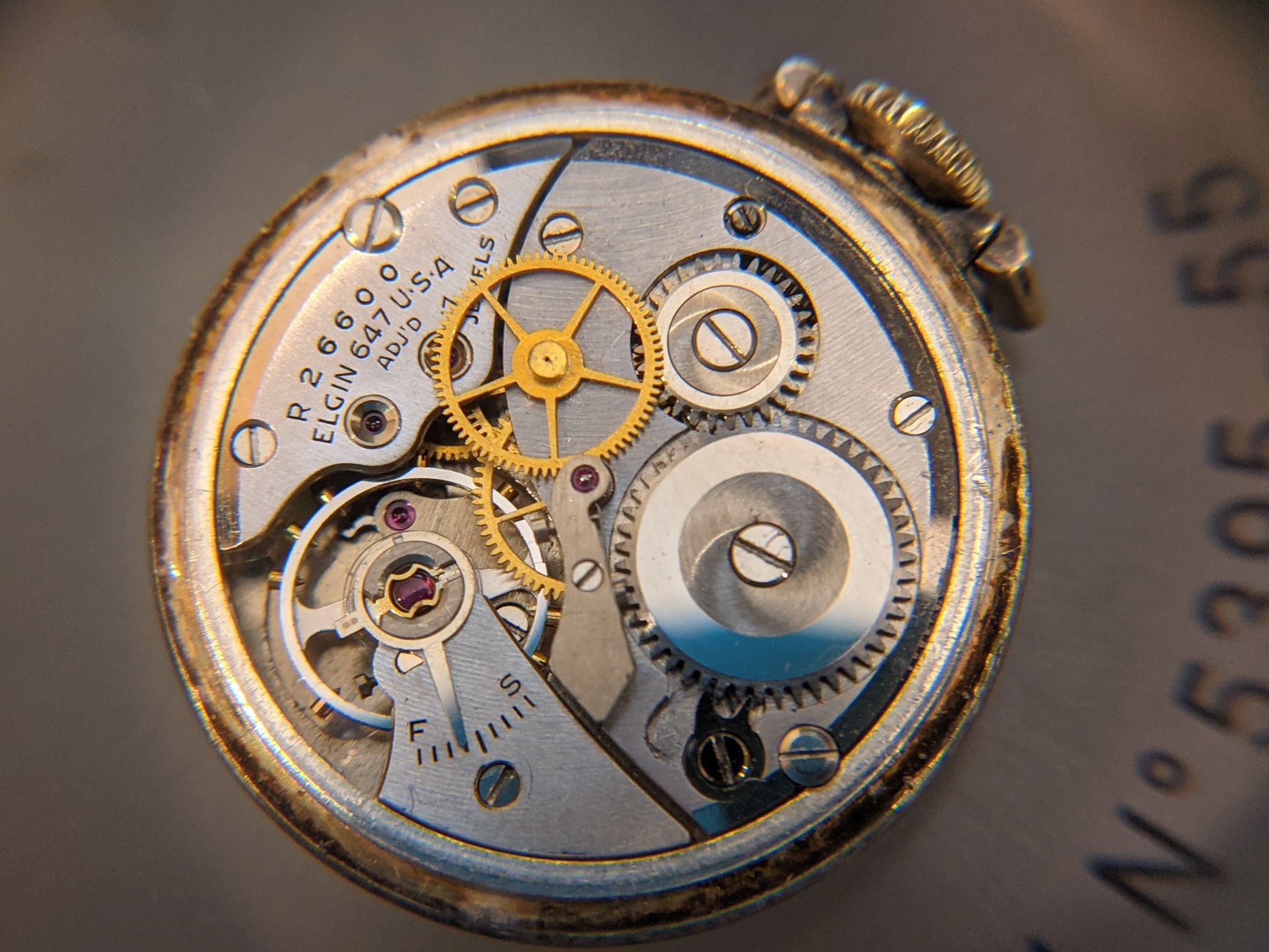

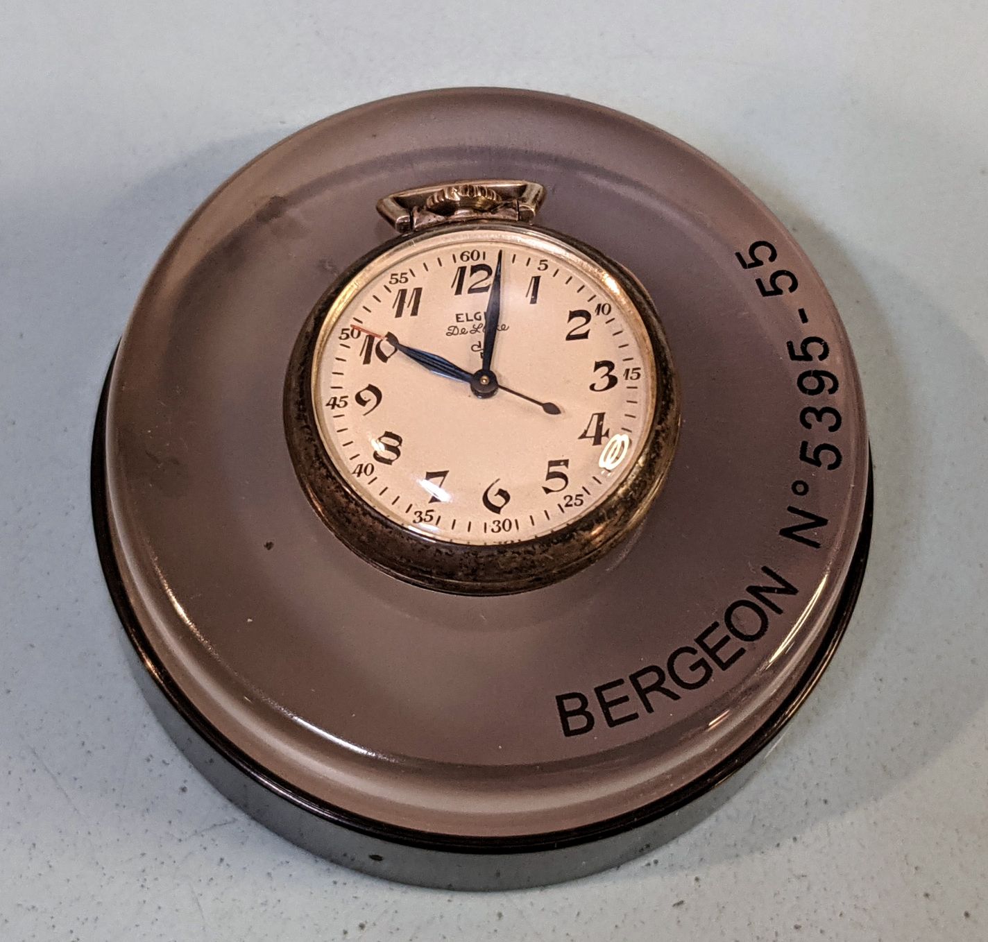

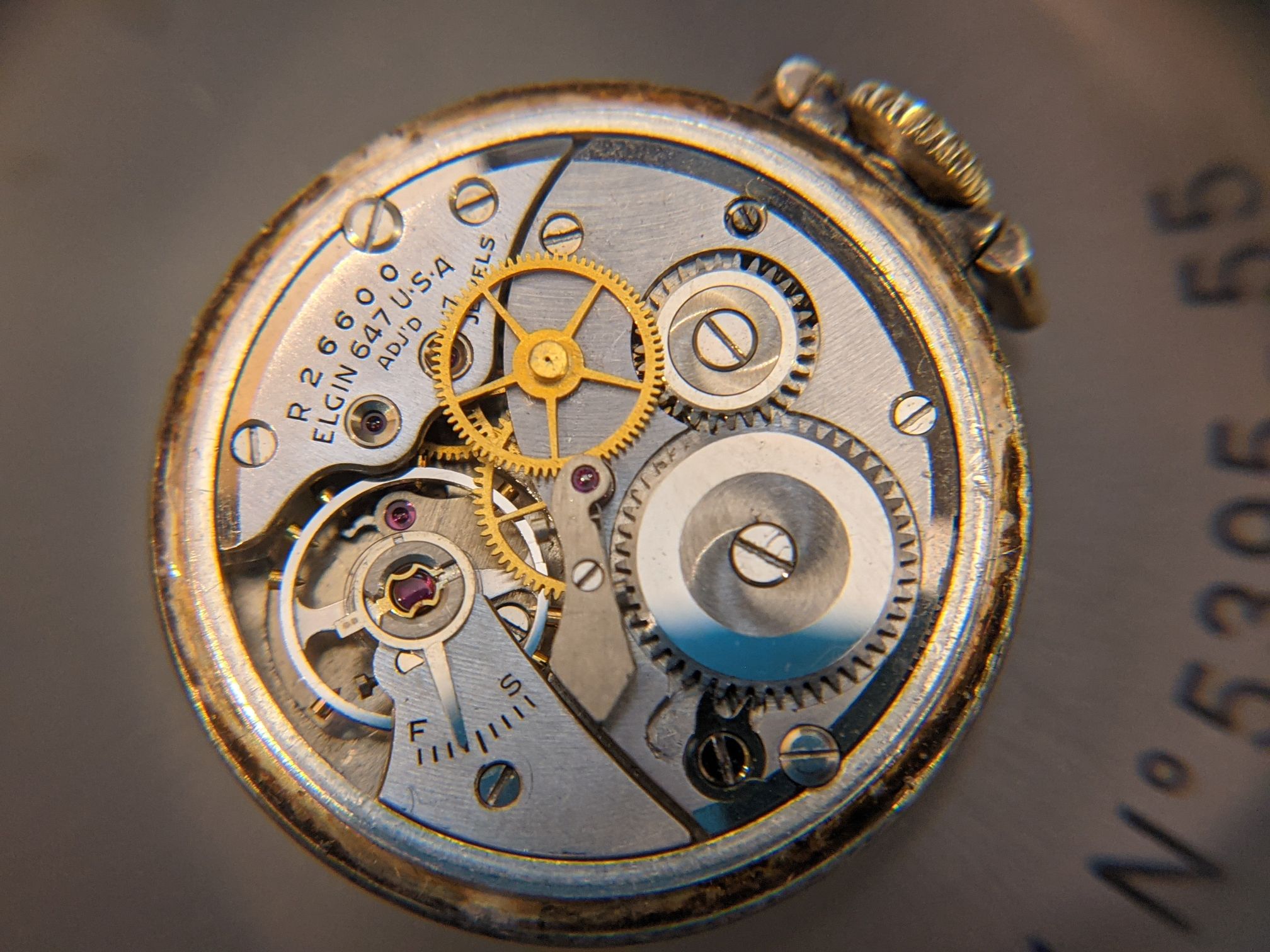

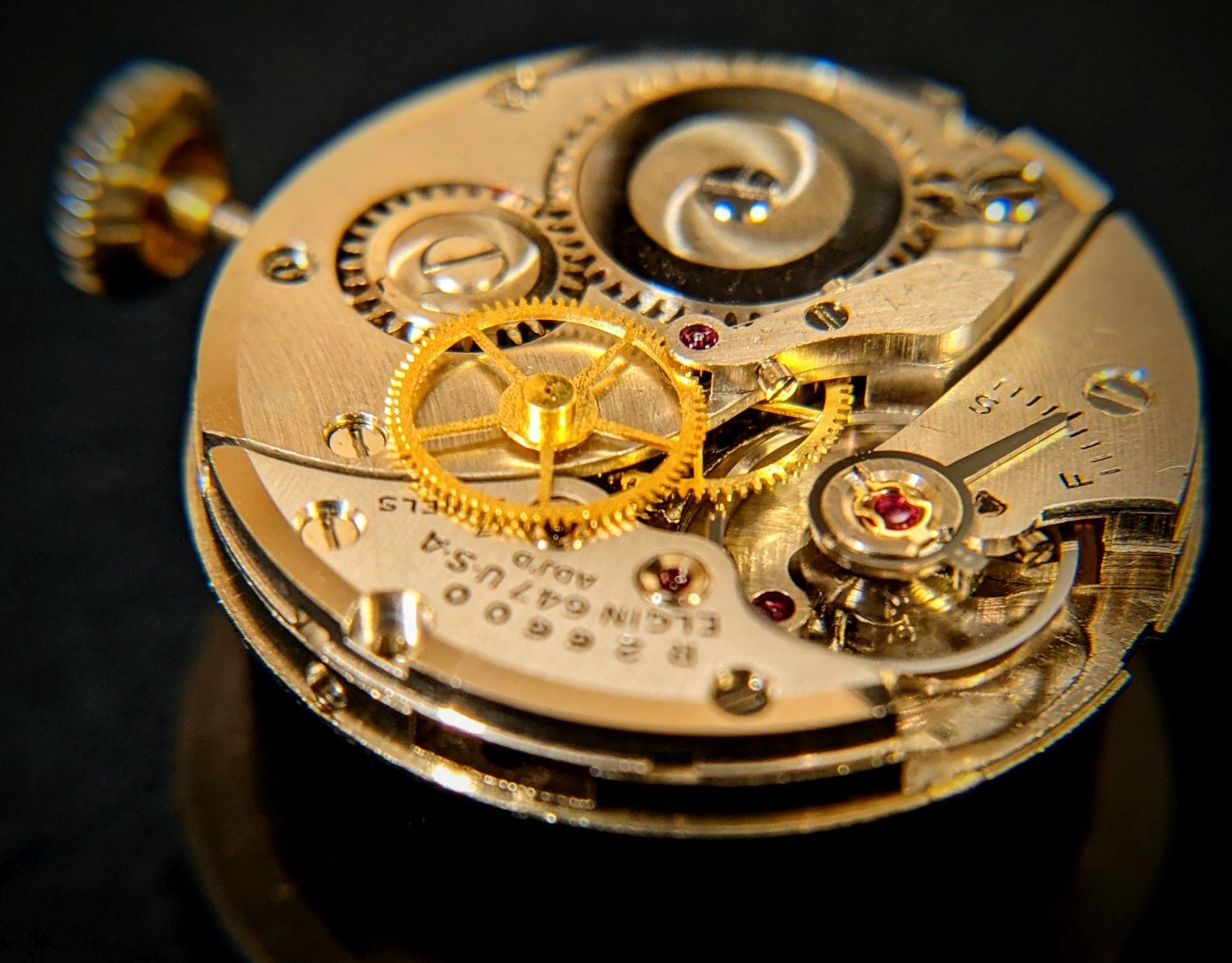

Elgin 'De Luxe' gr647, s8/0, c1950
Elgin also used the 647 as a wristwatch movement, cased here as a mini pocket watch.
I like the calligraphy for the numerals.

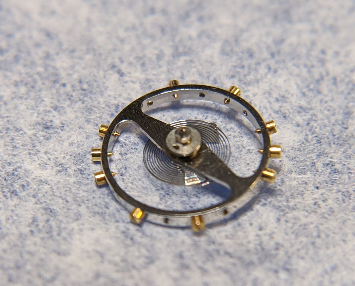

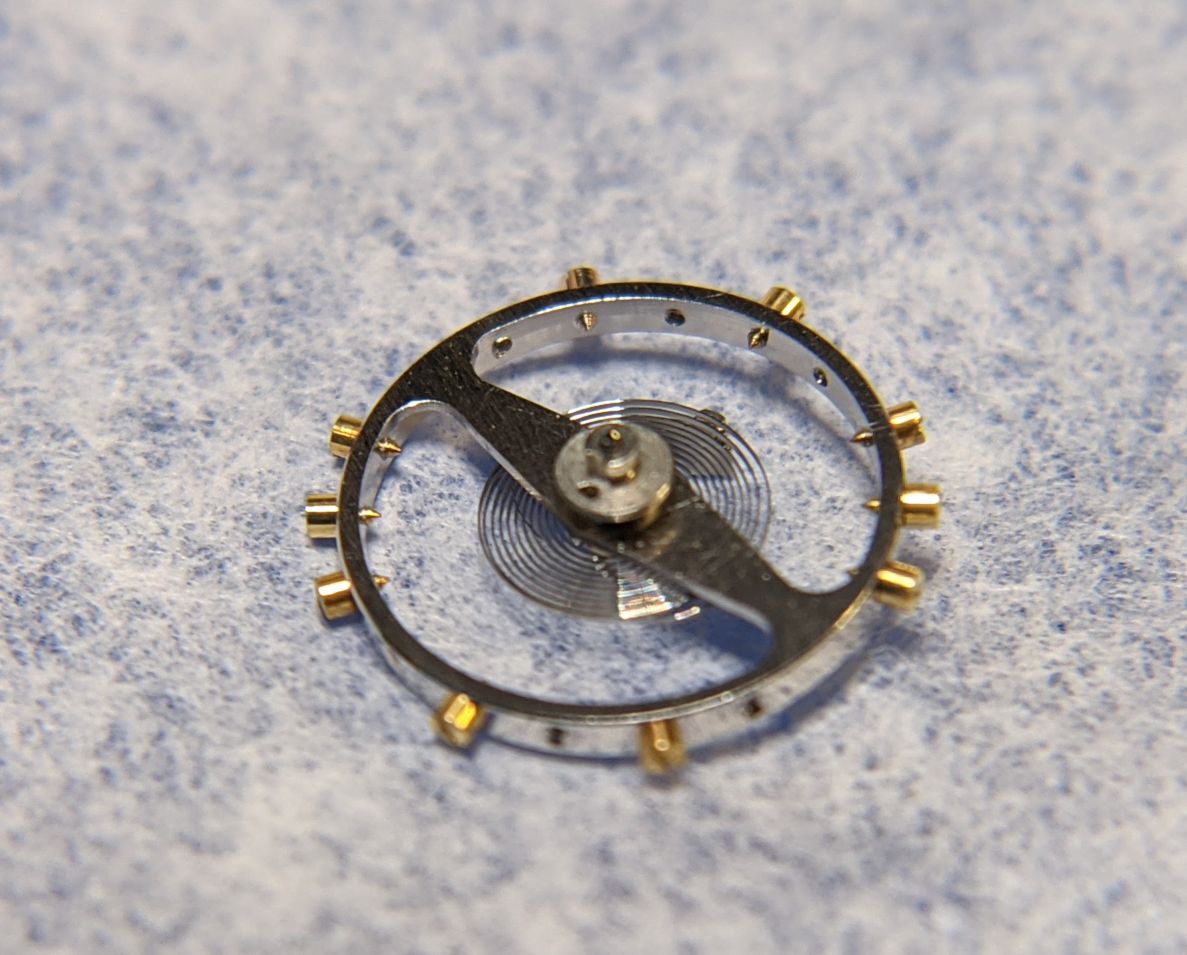

Judging but the well worn case & the rich payload of pocket grime, this was someone's everyday timepiece for many years, not just some mini-sized novelty. Balance staff is good & balance turns freely, but going train does not advance.
Well, that would be why...
(no impulse jewel)
The 647 is not a rare or expensive movement, donor balance complete off of eBay for less than $20US & back in business.

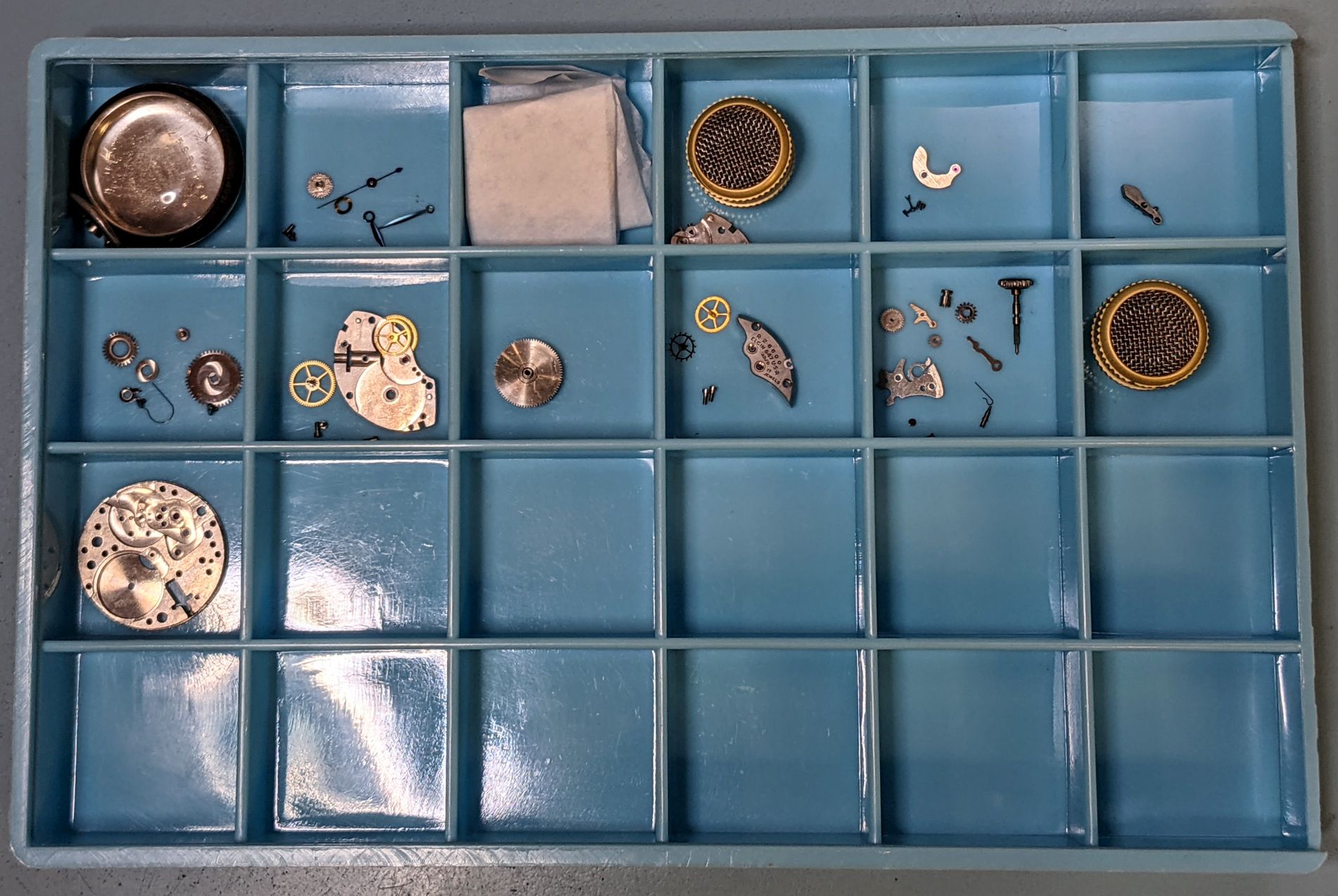

Broken down & ready for the cleaner.
Back together.
We all do love these infernal little machines...

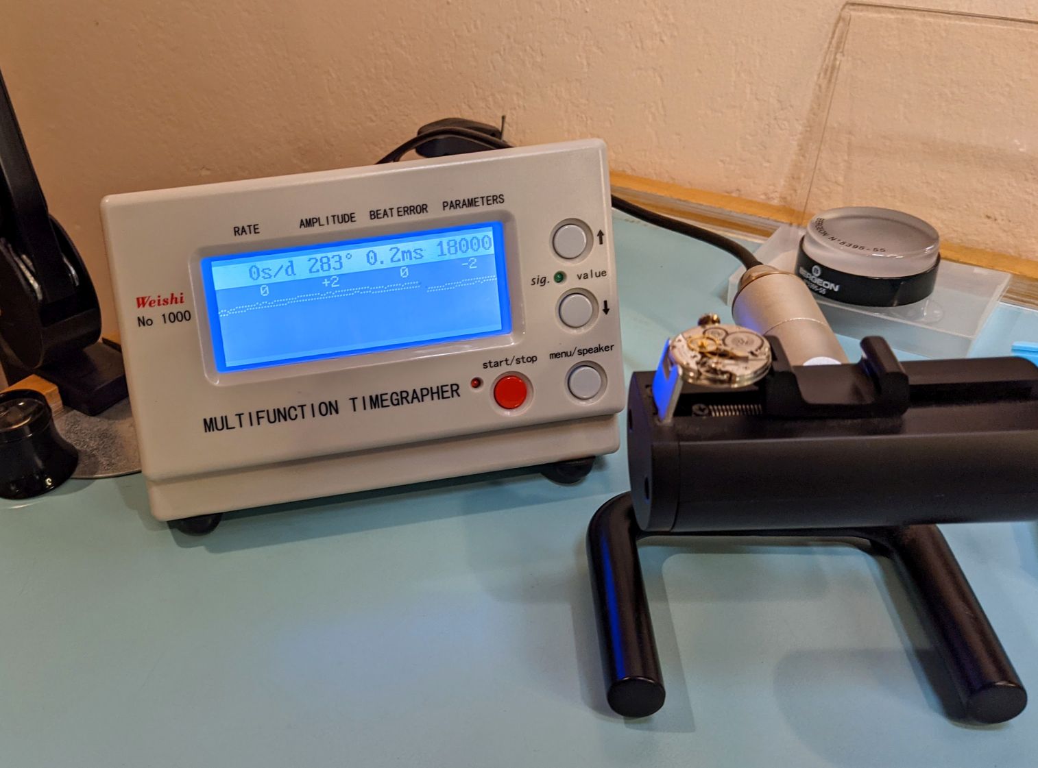

I'll take that.

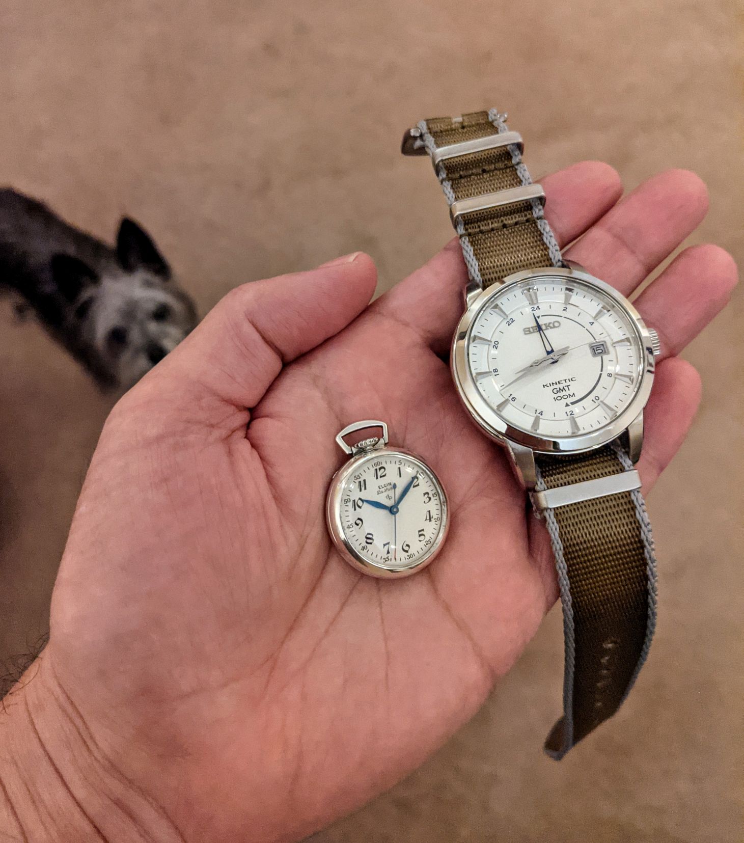

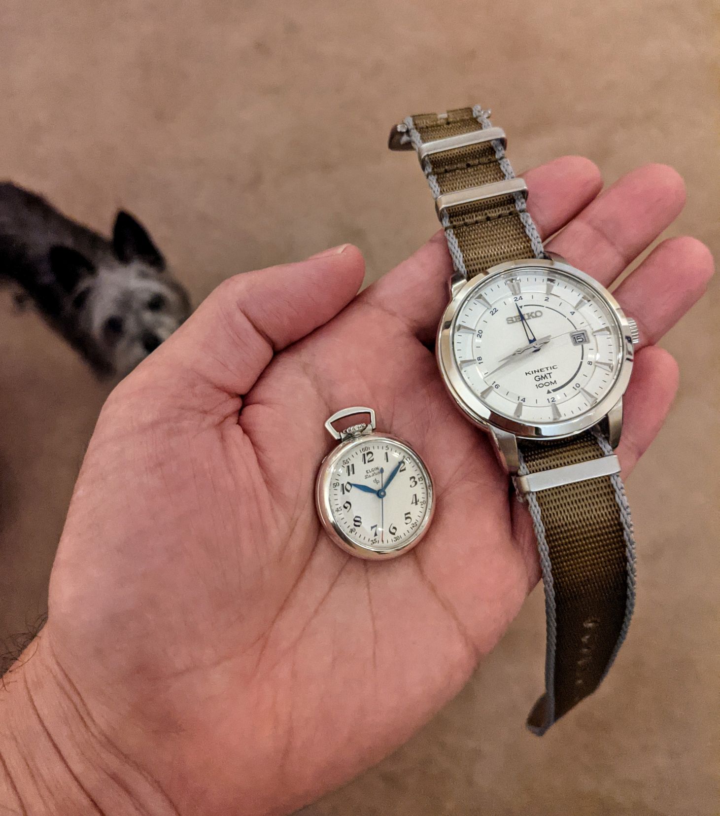

Yes it's a pocket watch, but still dwarfed by a modern wristwatch.
Hope everyone is safe & healthy.
15,997
48,115
An interesting watch, equipped with Swiss Incabloc shock protection on the balance wheel. The little “squiggle” on the dial indicates the copyrighted symbol of the Elgin unbreakable mainspring. That basic movement was around for a long time. I have an “opera” pocket watch from the 1920s (no sweep hand) that used the basic movement.

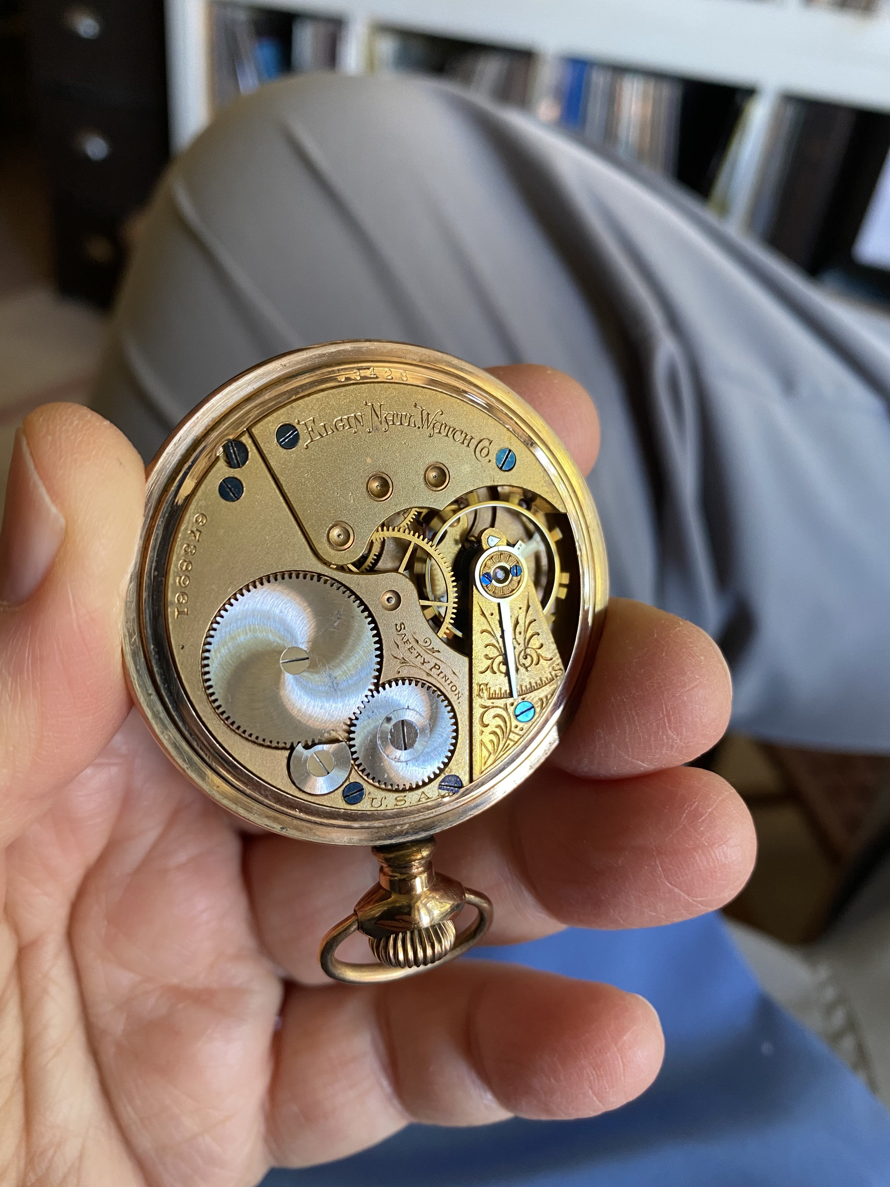

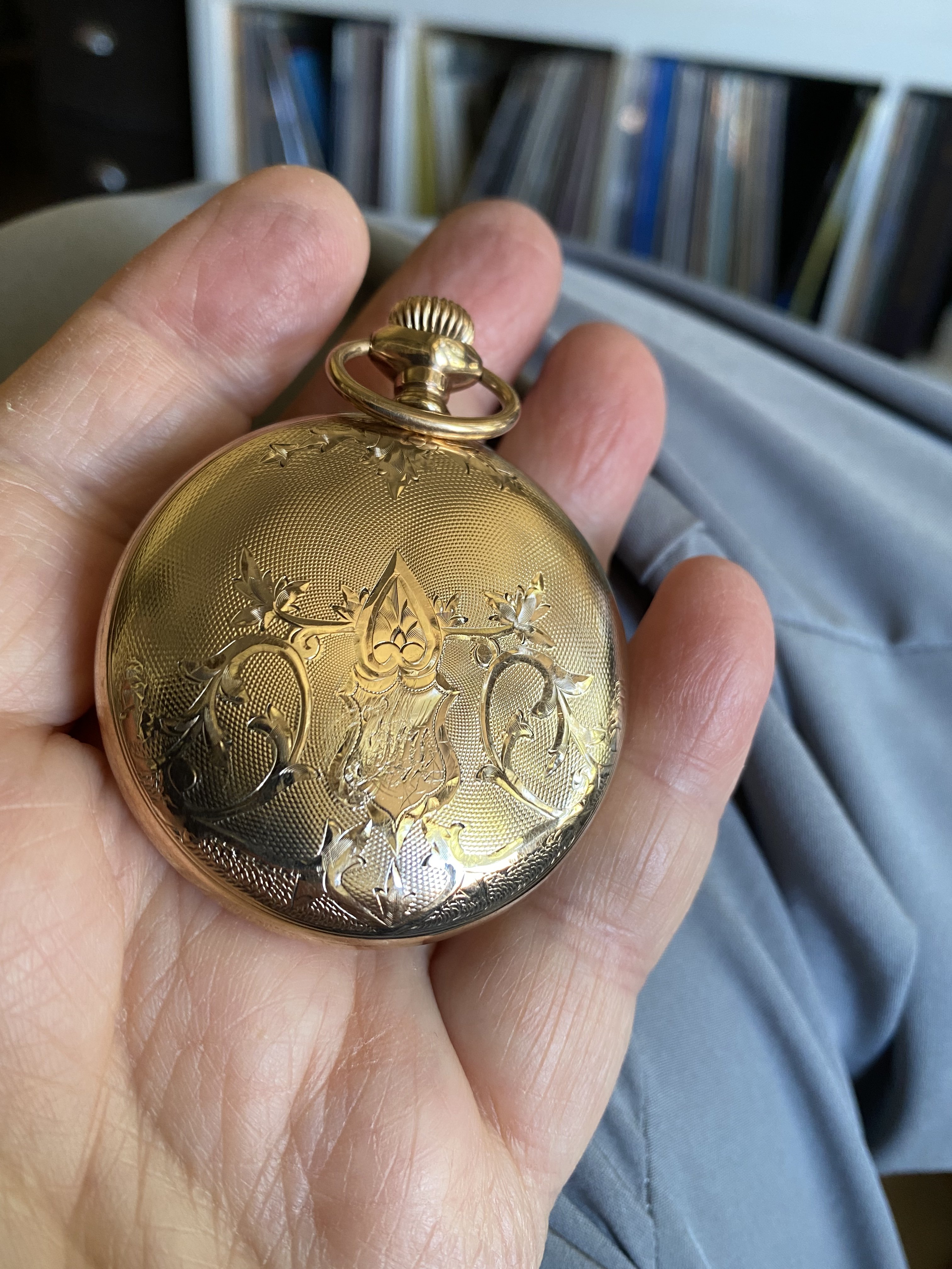

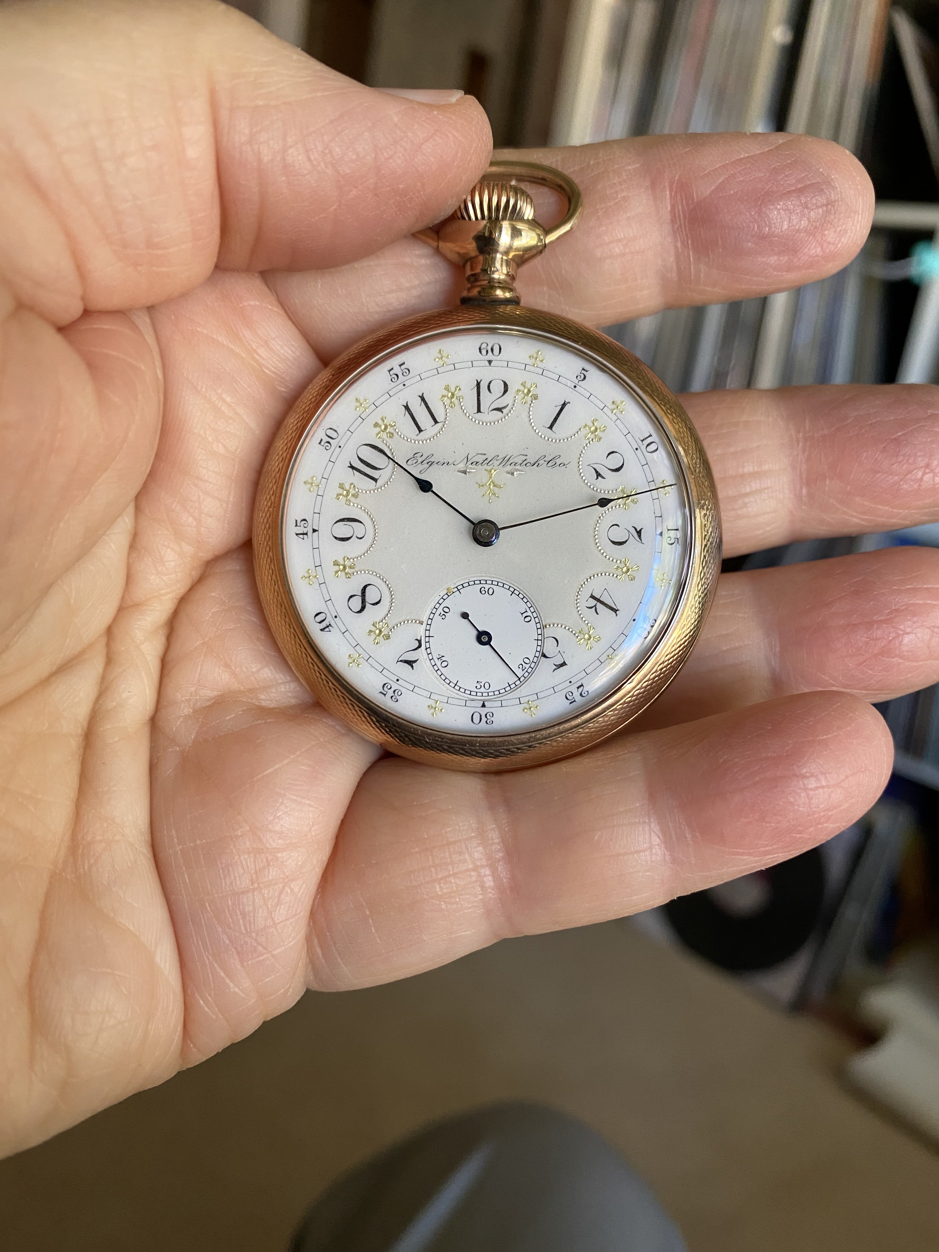

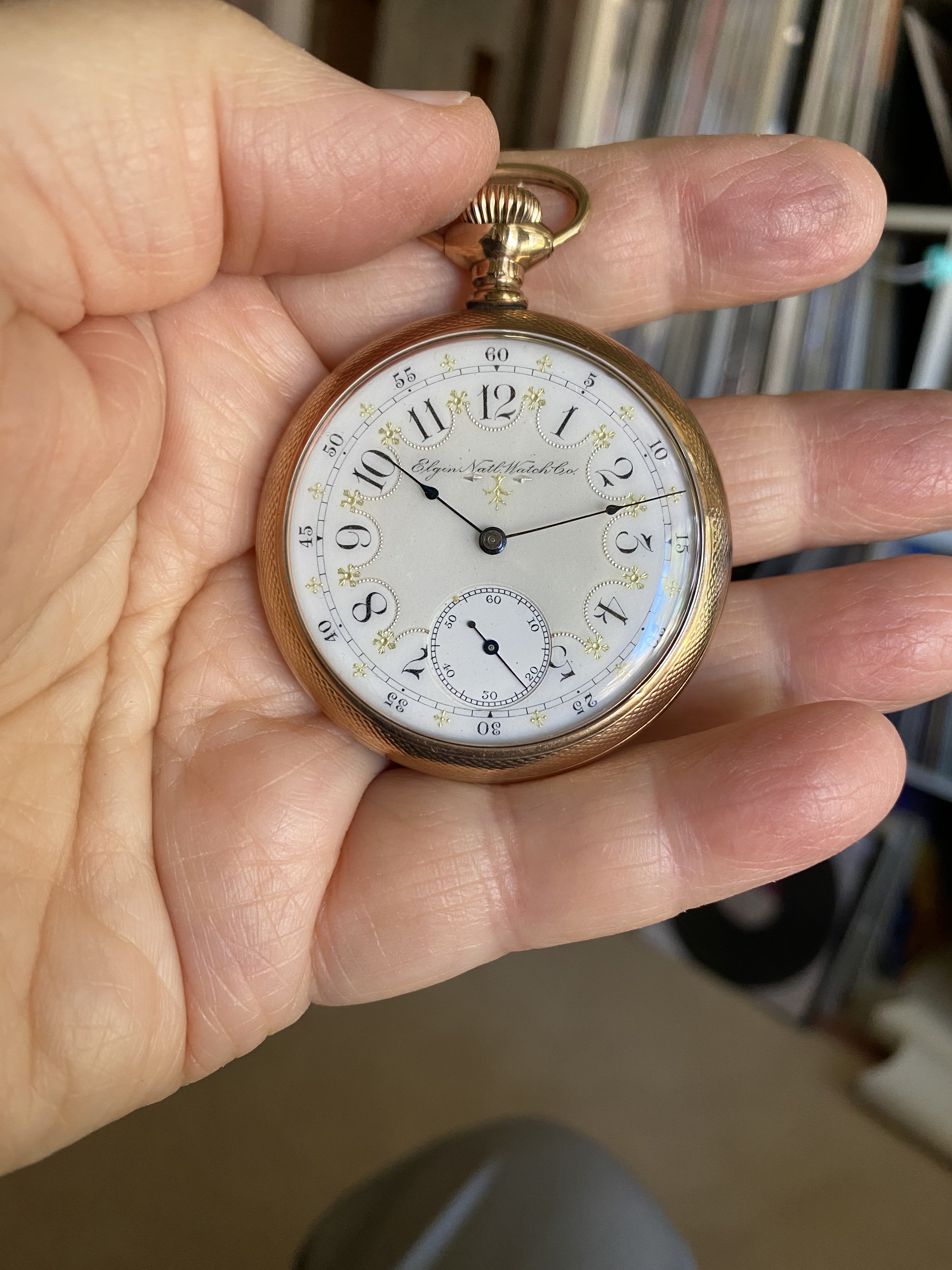

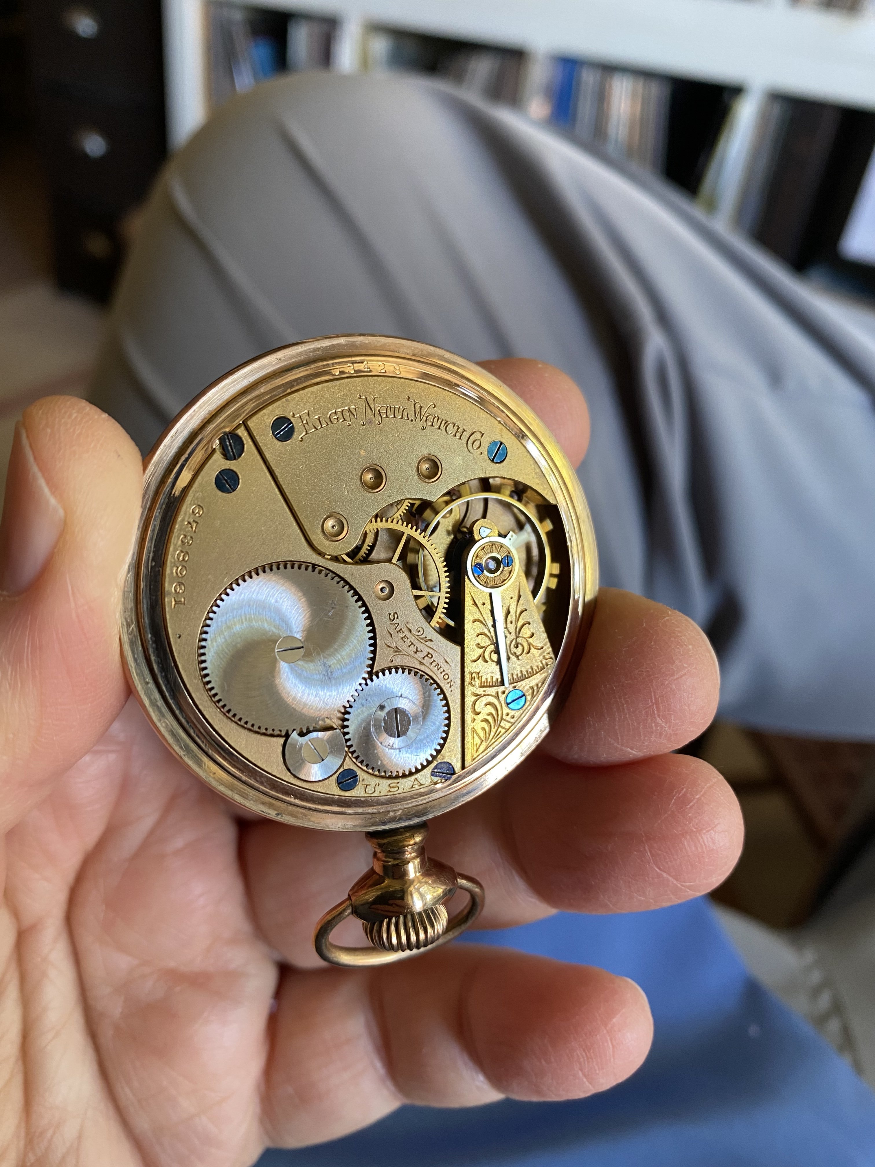

Elgin National Watch Co
16s 7j grade 157 Model 1
Circa 1896
Fancy Dial
When you think about what most folks had to entertain themselves with in 1896, that dial must have been a real conversation starter

Elgin 'De Luxe' gr647, s8/0, c1950...
...Yes it's a pocket watch, but still dwarfed by a modern wristwatch.
Thanks for sharing.
That Elgin would be an excellent candidate to go onto a wrist strap
15,997
48,115
I think these little “pocket” watches were intended for use by nurses, worn clipped to a uniform apron of blouse. They have also been used by nuns, to be worn on the front of a habit. Or of course, either pocket or pendant watches.
Same reason cowboys took art and color with them on their cattle drives.

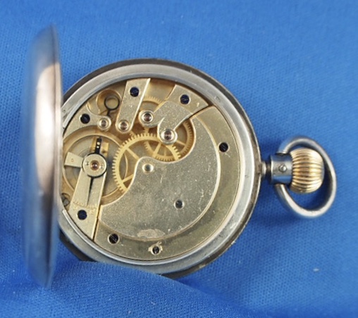

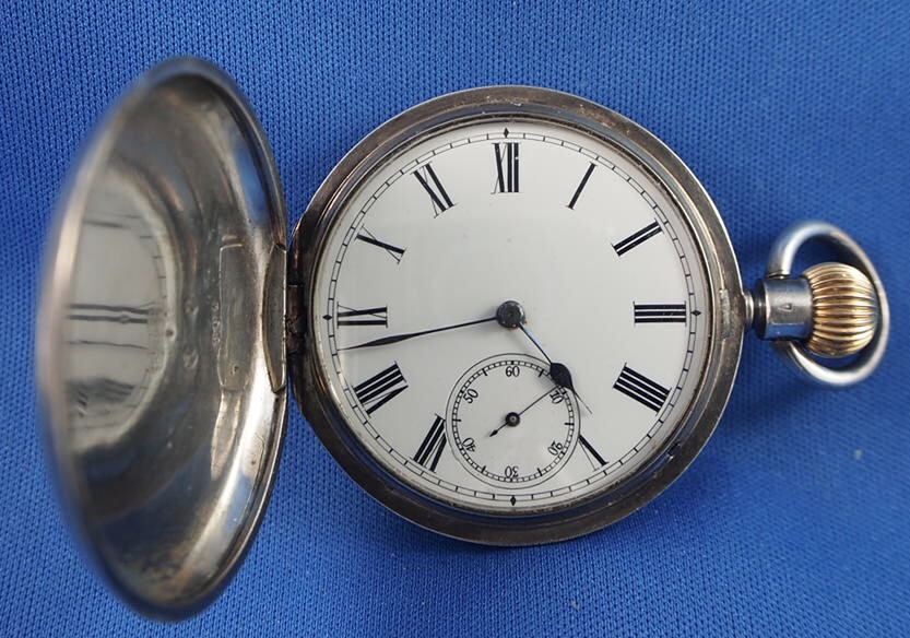

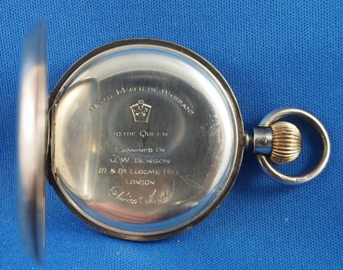

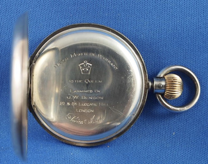

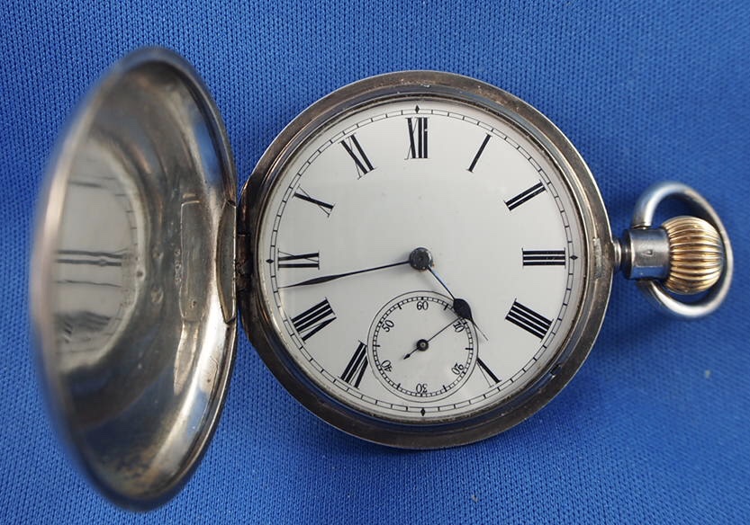

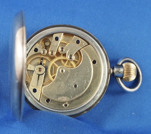

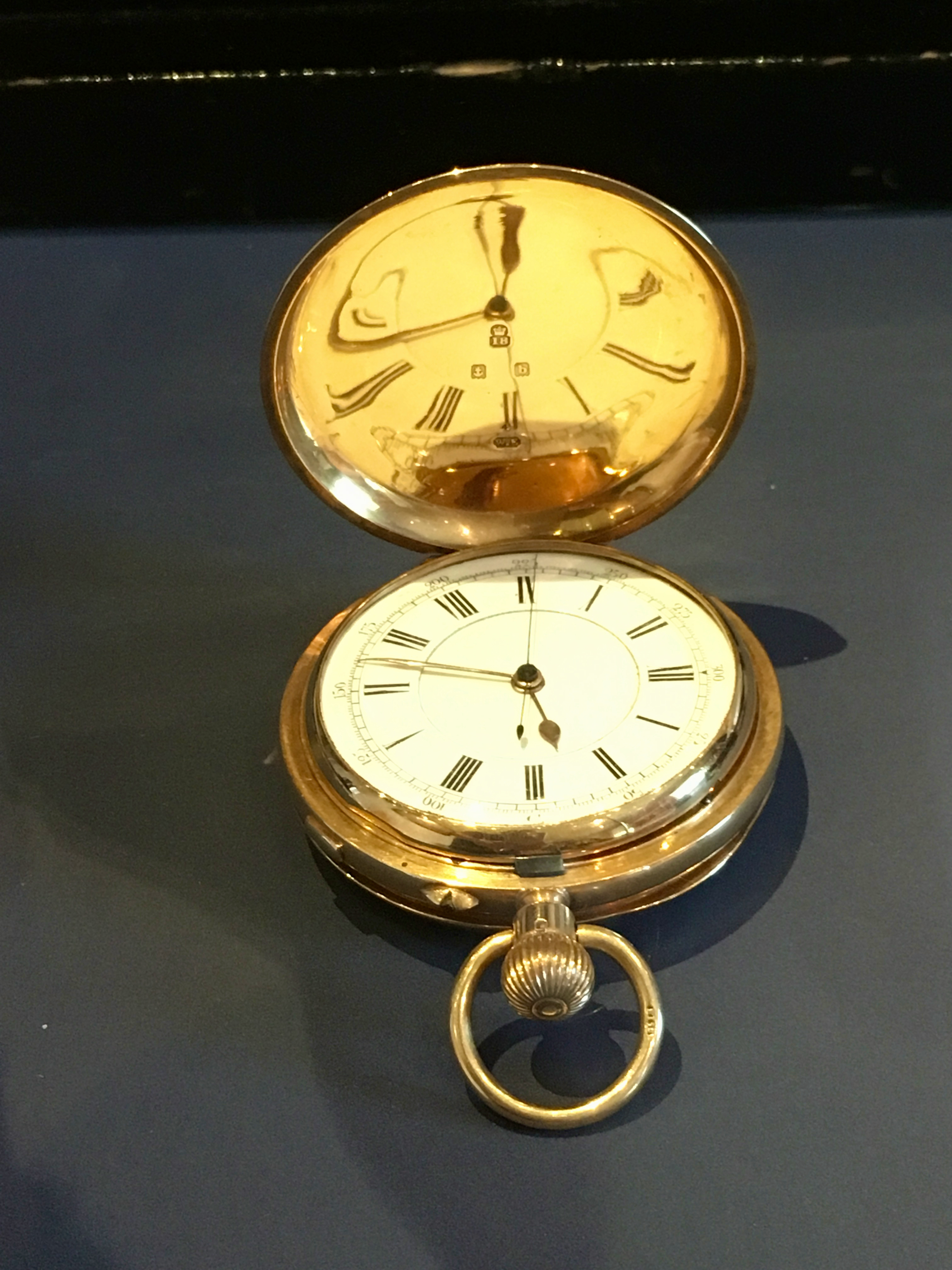

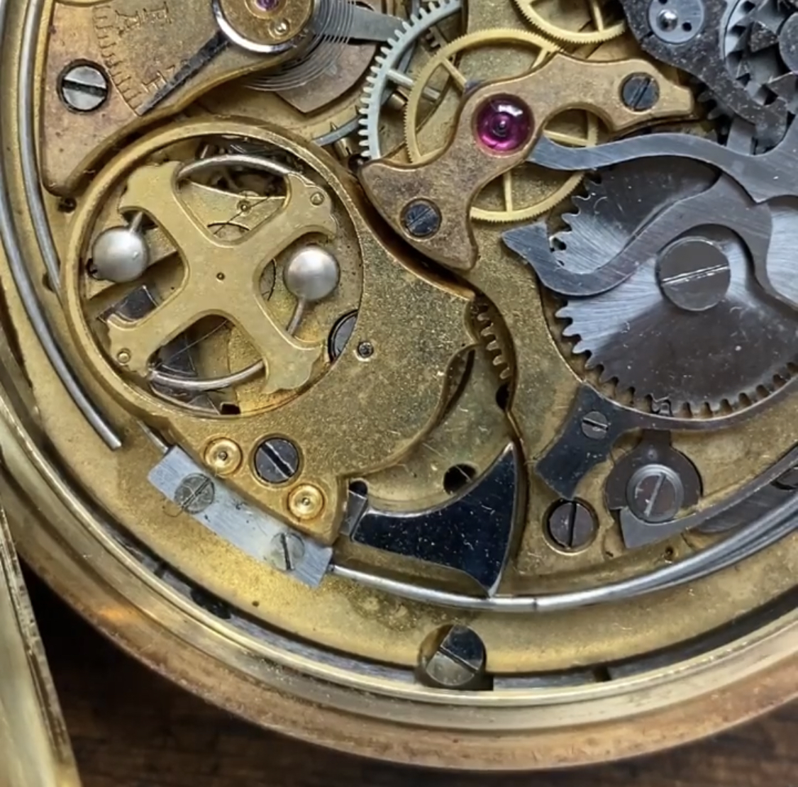

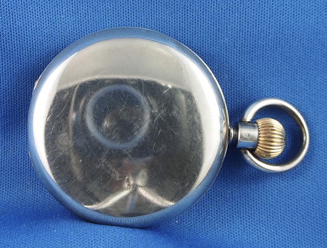

This one landed here, earlier this week, for repair. I thought it might be of interest, so here it is. The dial is not marked, but the inner cuvette is marked, Watchmaker by Warrant to the Queen, Examined by J W Benson, 62 & 64 Ludgate Hill, London- Swiss Made. Case and movement both Swiss made, but interestingly, there are no hallmarks, date letters, or British standard marks inside the case. The Swiss standard mark (0.935) is there. J W Benson was in business at Ludgate Hill until 1937. The name was sold to Garrards in 1967. While the watch can’t be dated, it is useful to consider the “Queen” mentioned on the inner cuvette would be Queen Victoria. Is it is reasonable to assume the watch is from the late 19th century. The movement is stem wound and lever set, and has 15 ruby jewels, and is not identified. But I have a strong suspicion it might be either Agassiz or Longines. Bi-metallic, temperature compensated balance wheel, blued steel hairspring, nicely made, nicely finished, and for a Swiss pocket watch of the era, well made. A strong runner.
This case was Swiss made, and marked 0.935 (fine) silver, a standard that was not accepted in Switzerland. The Swiss produced 0.935 fine silver cases specifically for the English market. In 1887, the Swiss approved a standard mark showing two large standing bears, and one small standing bear for 0.935 fine silver watch cases. This case is marked in that manner. So it would have been produced after 1887, but before Queen Victoria’s death.
