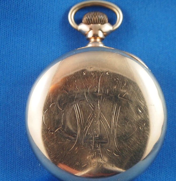

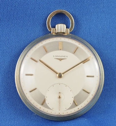

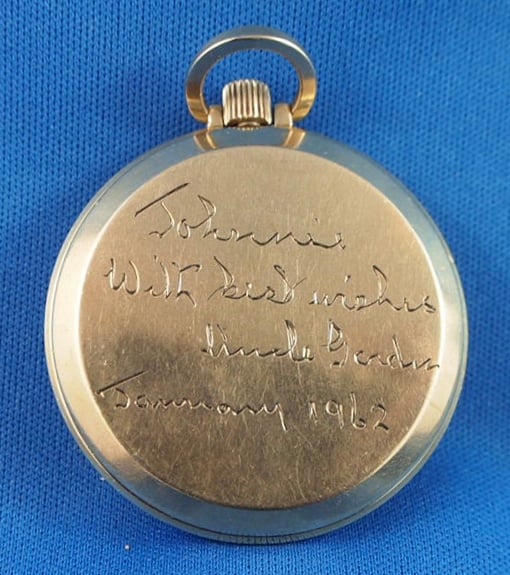

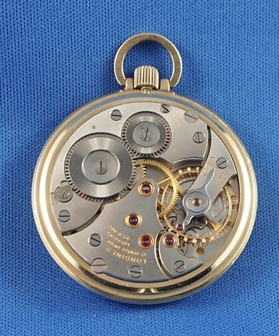

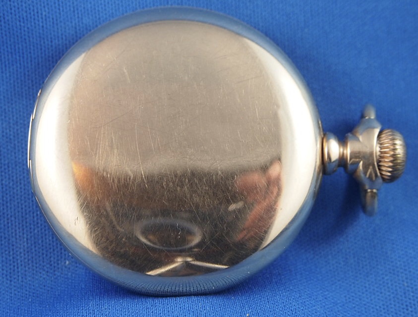

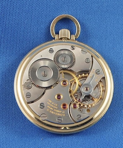

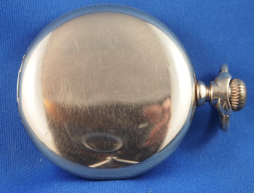

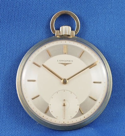

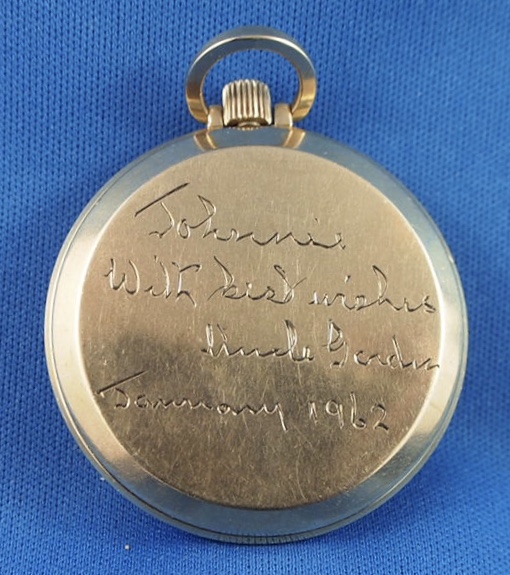

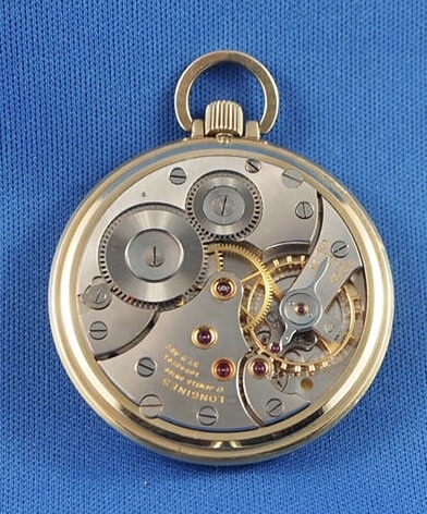

I don’t collect 12-size watches generally. I have two…..one being an 83 year old Waltham Colonial in a 14-karat case, which I have shown here, before. The other being an Art Deco Omega from about 90 years ago, that I have shown, here. It was sold at a Saskatoon jewellery store, approximately 1930, where my late father worked at the time. The one I have pictured, came to me for repair. It needed a balance staff, which is done. But since it is owned by an antique dealer, he doesn’t want anything else done to it. There is a unique salutation on the case back. It looks to me as though it was engraved to copy the giver’s handwriting, and it was presented 59 years ago. The watch is a Longines, golf-filled case, calibre 37.9 movement. Decent little watch, but the case back defaced the way it is, may prove to be a difficult sell for my friend, the antique dealer.
15,997
48,115

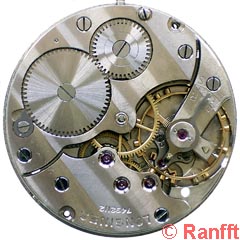

Oddly, the Ranfft listing for Longines 37.9 shows what appears to be a different movement.
Yet the movement is this watch resembles the Ranff listing for Longines 17.6. This movement is marked 37.9, however. Might the Ranfft information be incorrect? I guess we’ll never know. The following image is the subject watch, and it definitely marked calibre 37.9.

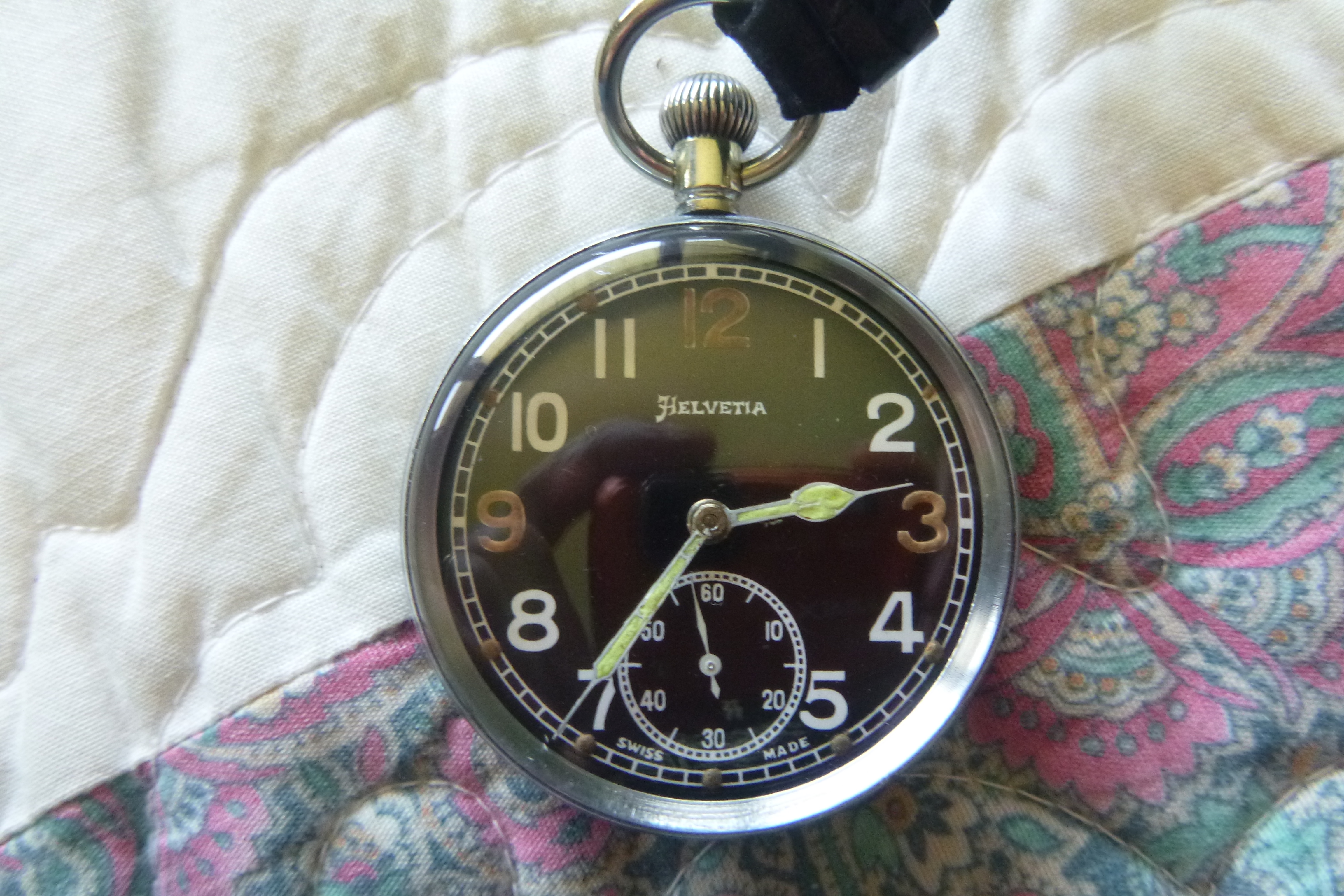

Many weeks ago I called dibs on a nice GSTP pocket watch that @TexOmega had shown on this very thread.
much to my delight I received a note from him stating it was for sale but was in need of a minor case repair. after weeks of painful deliberation the deal was done and my new watch was on its way. THIS IS WHERE THE TROUBLE STARTS!
first, USPS routes the this from Texas to LA... then to San Fran... then back to LA and then finally to Detroit, this little wander took several weeks and by the time it showed up on tracking again both TexOmega and I figured it was lost.
then, miracle of miracles it suddenly starts tracking in the wrong end of Canada and then finally makes its way slowly across Canada to my place (I figure this part was @DaveK 's doing)
finally, it arrives at my house and I eagerly open the box to find myself screwed by Canada Post AGAIN...
it least it came with its original box...

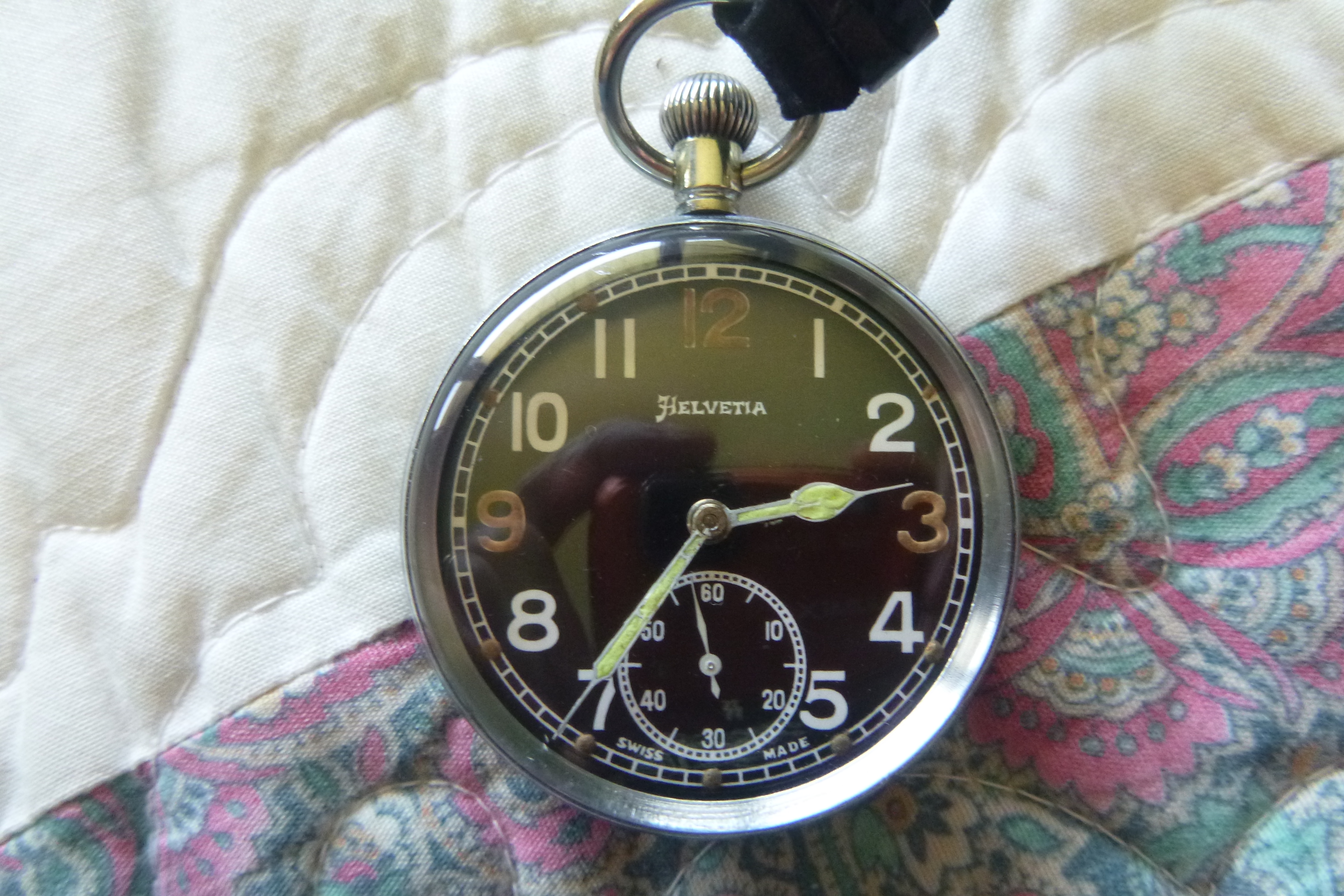

So THAT’S where my Speedmaster ended up!!😁::rimshot::
glad you are happy with the Helvetia.
Return my Speedmaster at your convenience…….. but soon!!
you left a bunch of papers in the box.
who's Buzz?
and why is this watch so damn dirty?

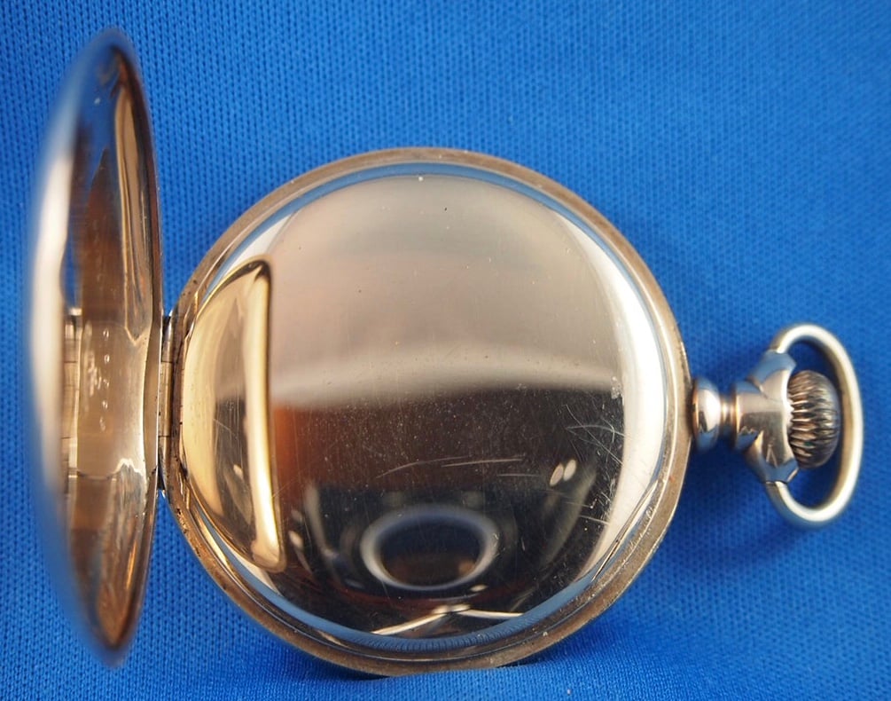

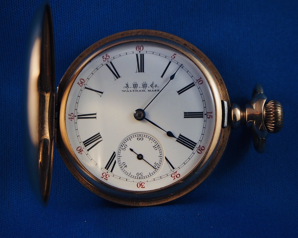

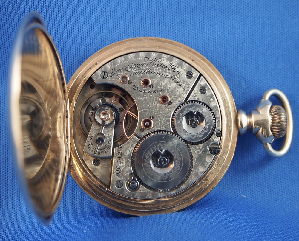

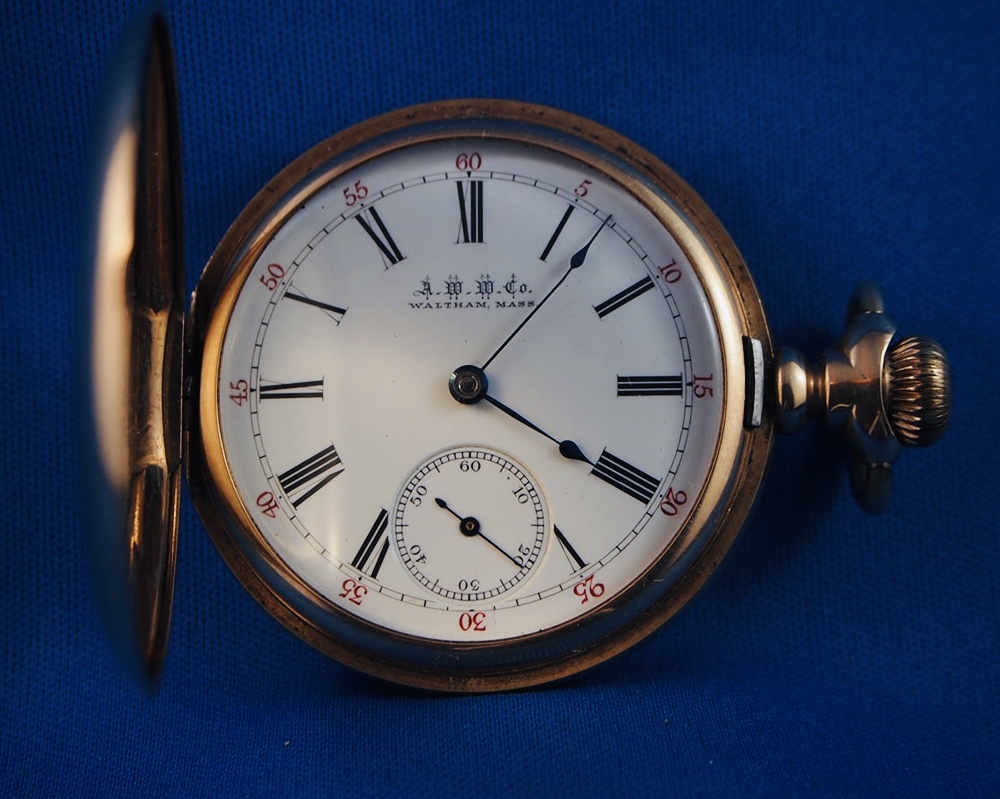

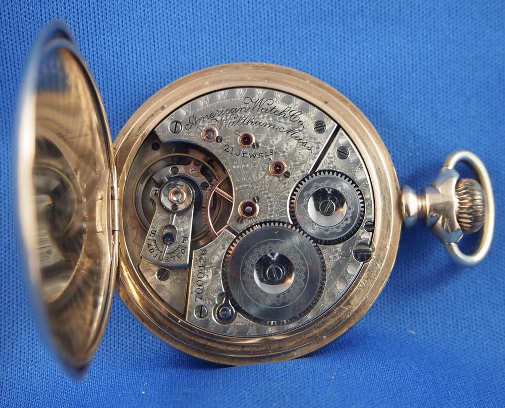

Here is a delectable to awaken your salivary glands! This one came to me for attention that I am not at liberty to disclose on the MB. It is a 14-karat, hunter cased, 21-jewel, 1888 model Waltham, with a perfect 12-hour vitreous enamel dial, gold train wheels (may include the first wheel), safety barrel, and three diamond end stones. Two on the balance staff, and one on the escape wheel upper pivot. The movement is in exceptional condition, it runs beautifully, but it does have a problem in the winding and setting mechanism which I have yet to diagnose. If you have a copy of the Shugart, Engel, and Gilbert “bible”, look it up. A 21-jewel, 1888, nickel, 3/4 plate model is quite a rare bird. Especially in a karat gold hunter case. By the way, the 1888 model Waltham is not interchangeable into any other 16-size case. It is an odd size, and the cases were made specifically for these movements.
Here’s the skinny on it.
https://pocketwatchdatabase.com/search/result/waltham/7000426
