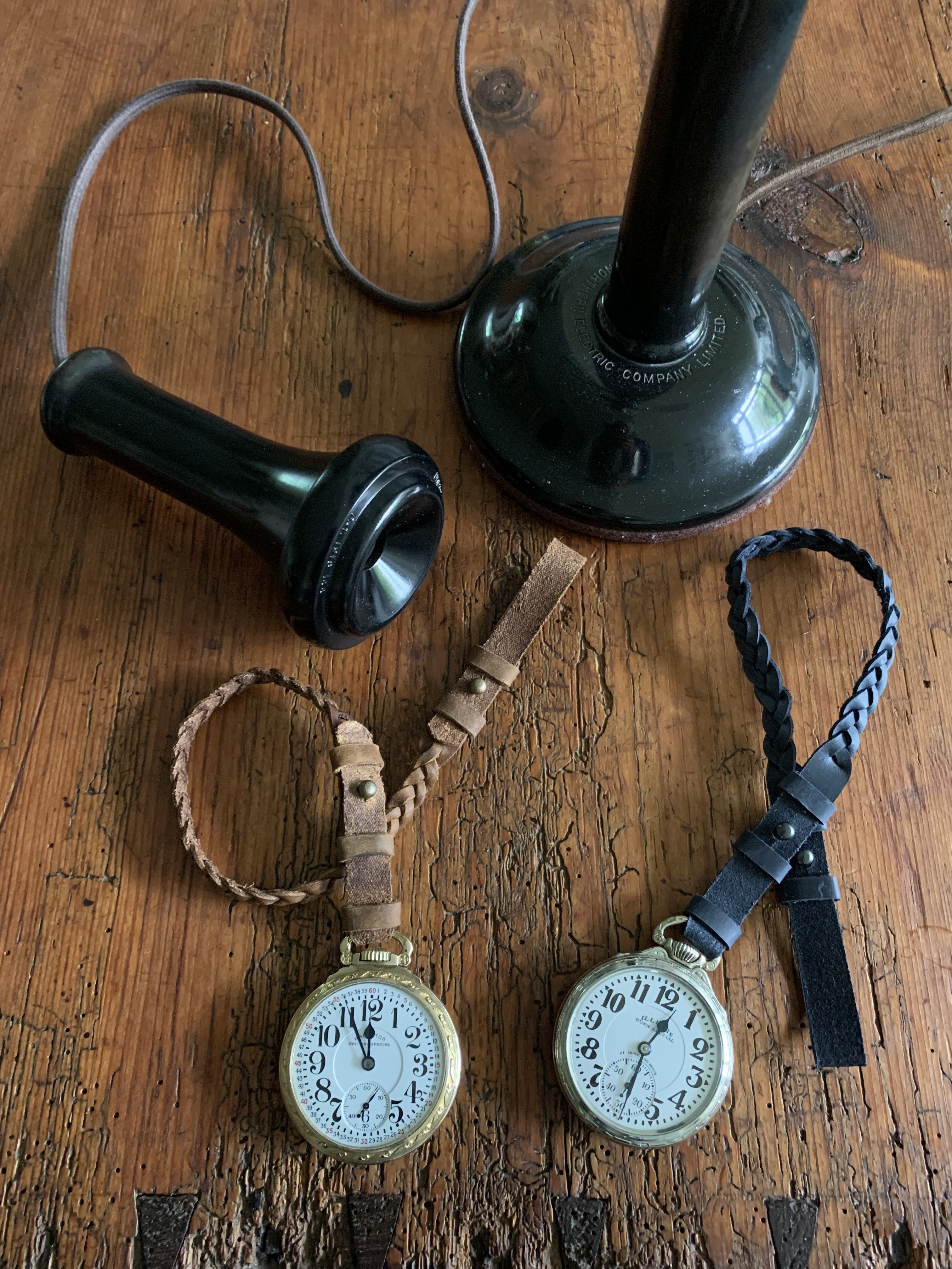

…about now somebody usually chimes in with a shameless plug for @DaveK ’s amazing patented watch straps... cue the music!
Shameless indeed. But, truth be told, I am extremely pleased with how nice the new midnight blue and distressed brown lanyards have turned out 🙄

Yes, there are those DaveK (I got each style from DaveK - Now I just need the watches to go on them).

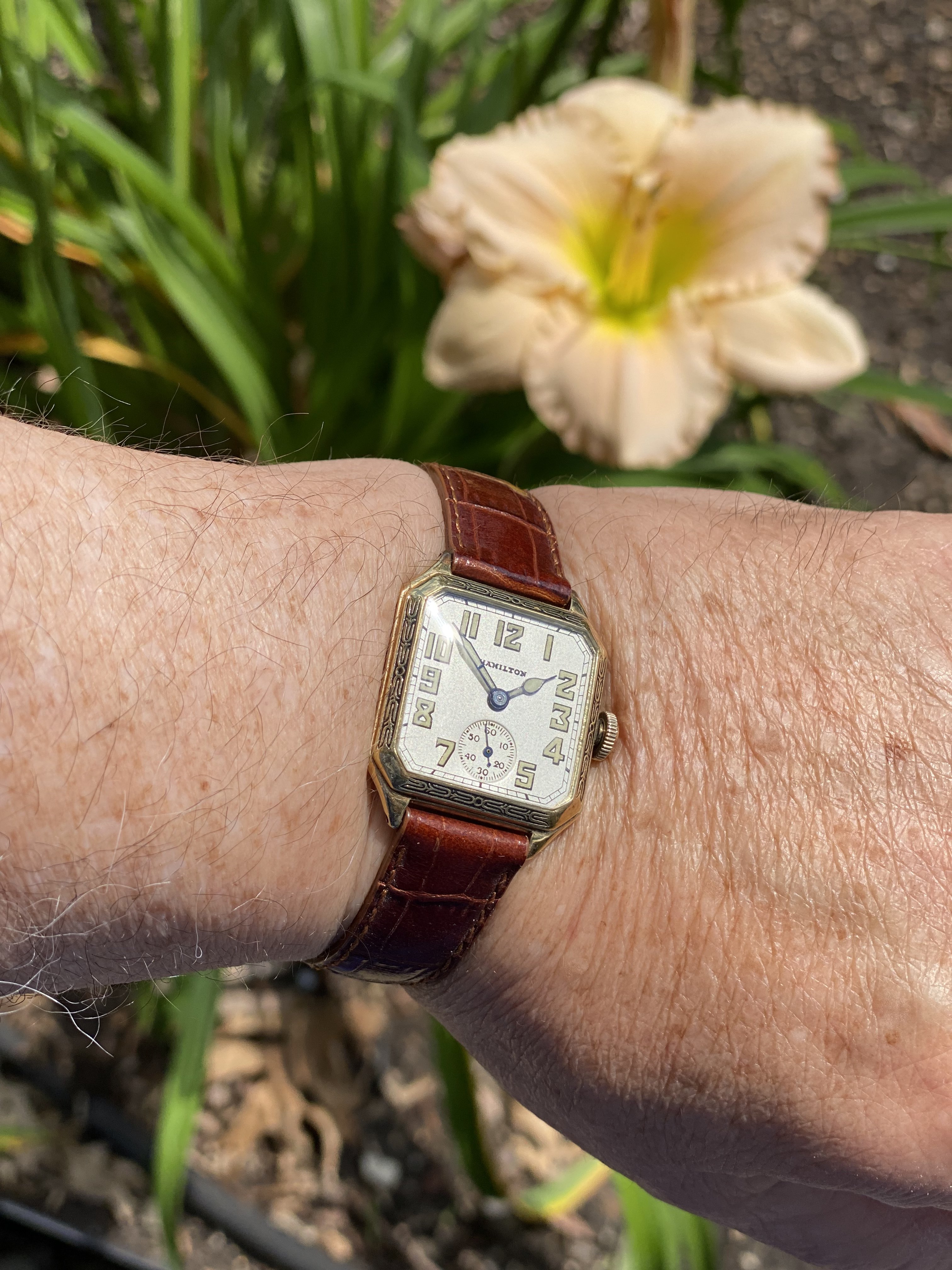

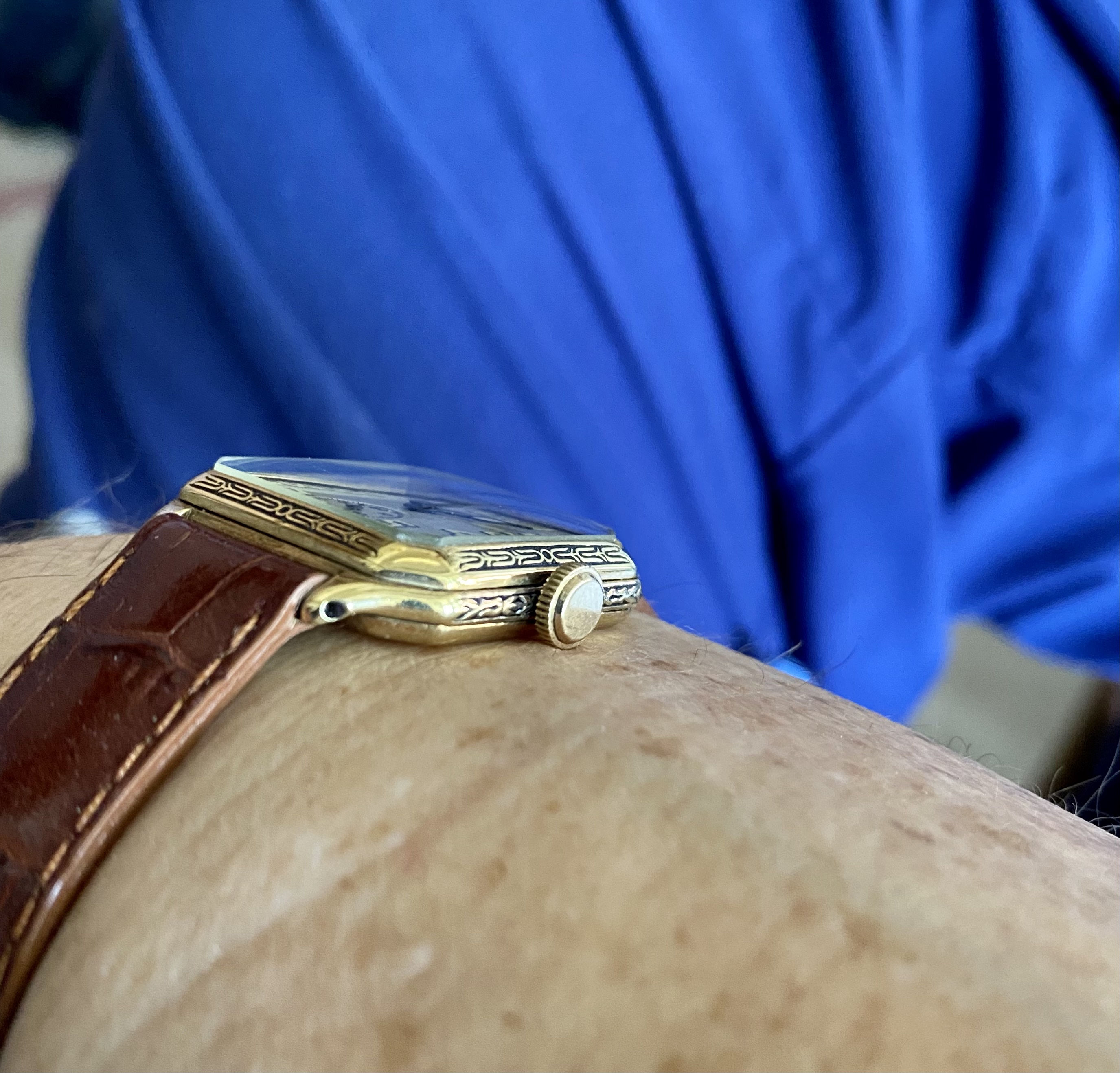

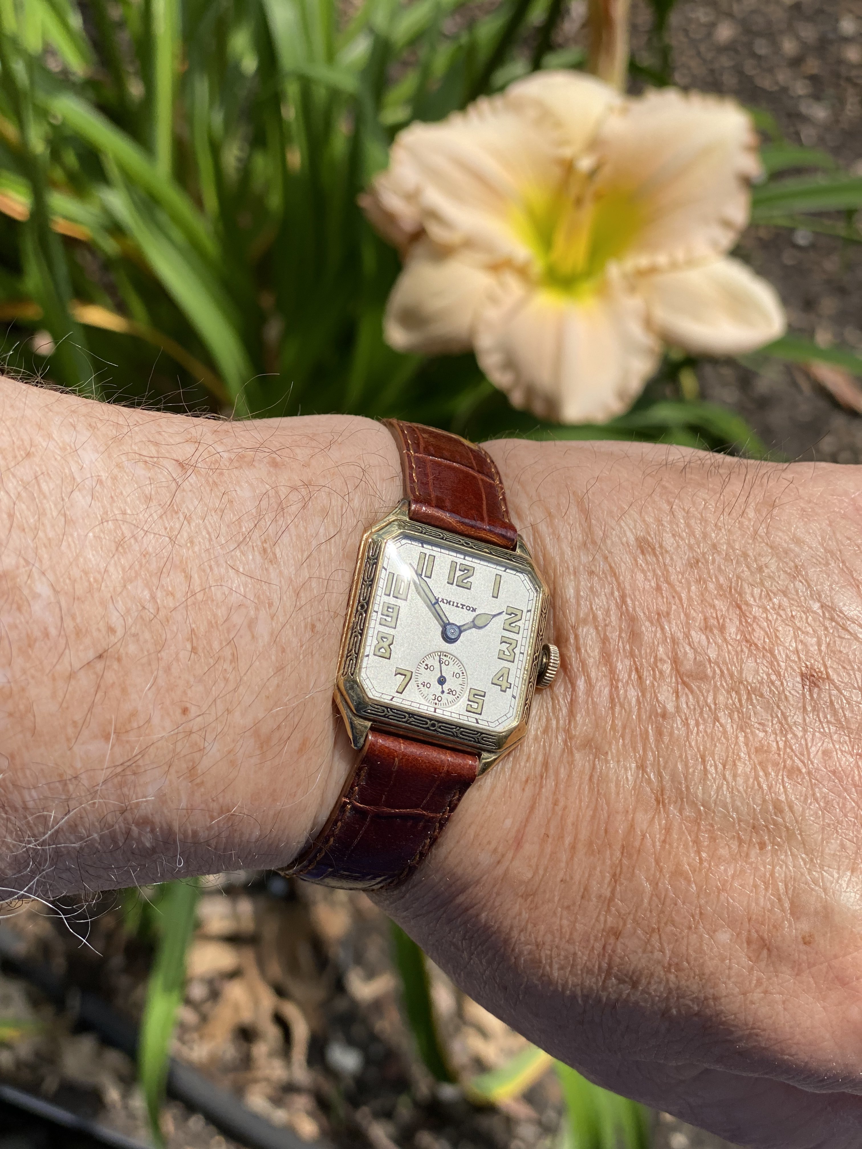

14kt gold Hamilton "Square" for this PW thread!

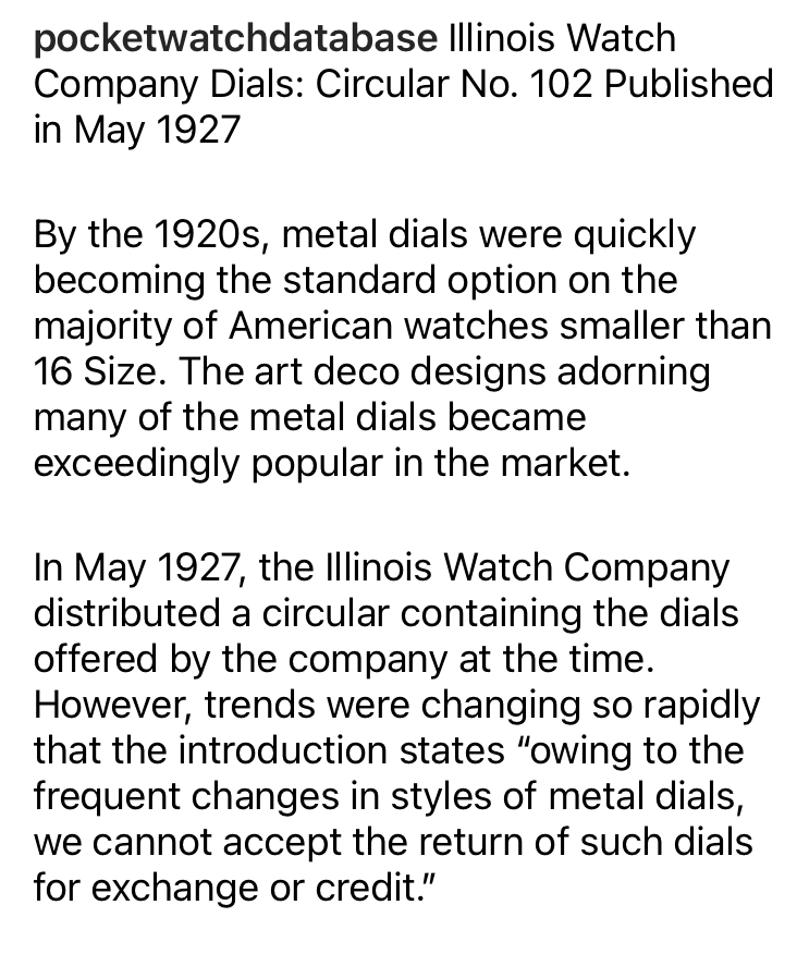

@Duracuir1, Thank you for posting these vintage advertisements.
Gorgeous watch and I call dibs. I had a square Hamilton in a fairly worn white rgp case once and let it go.

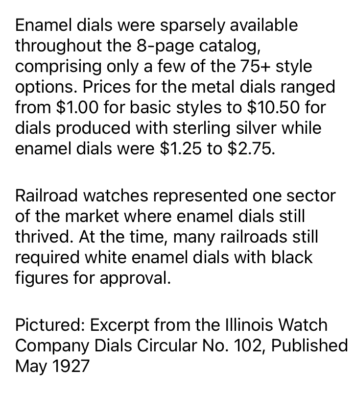

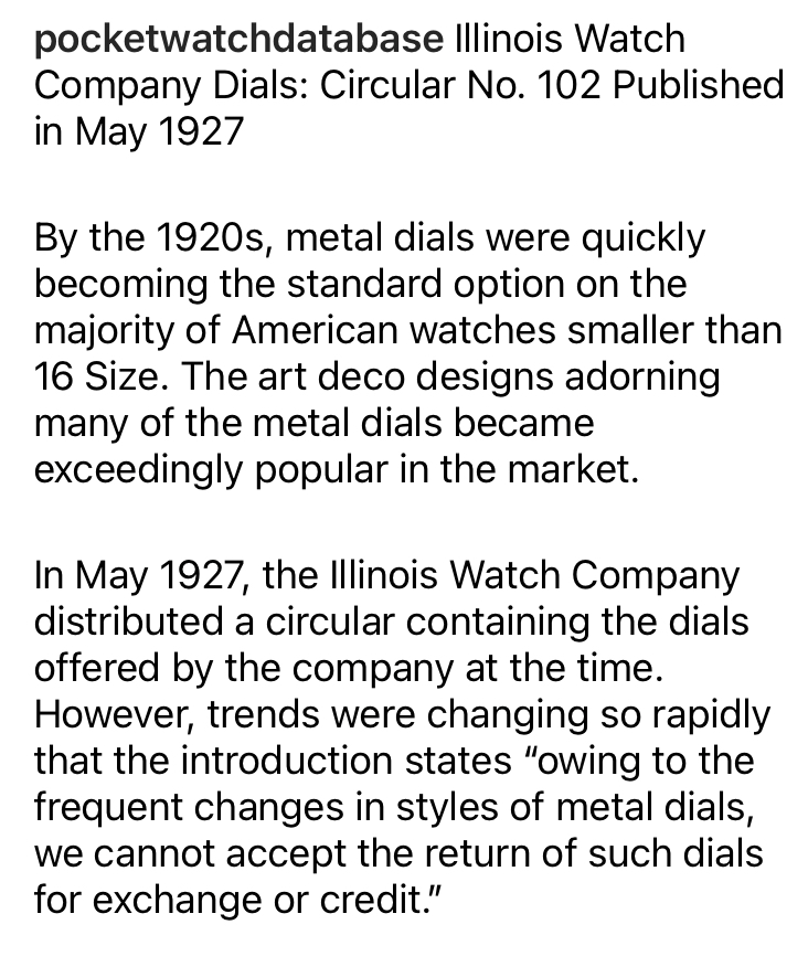

By the time that the above catalog was published, the larger 16-size watch was pretty much out of the picture, except for the demand for railroad standard pocket watches which were 16-size models. So the above makes a lot of sense. Once in a long while we run into 16-size watches being sold at this time, with metal dials. Railroad standard watches were available for anyone who was prepared to pay the premium price.

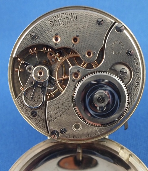

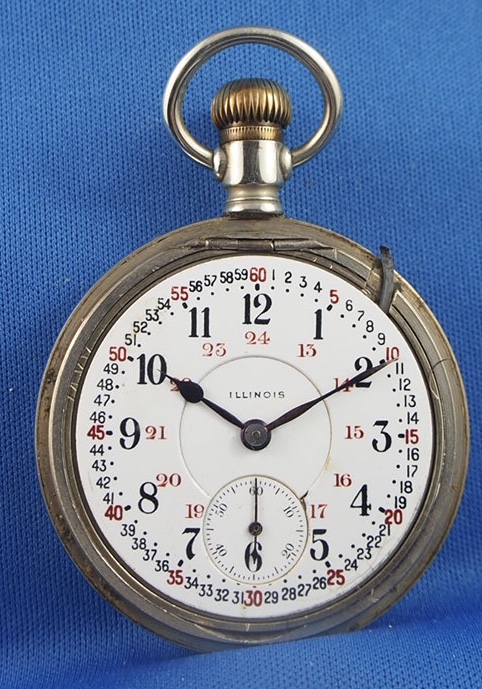

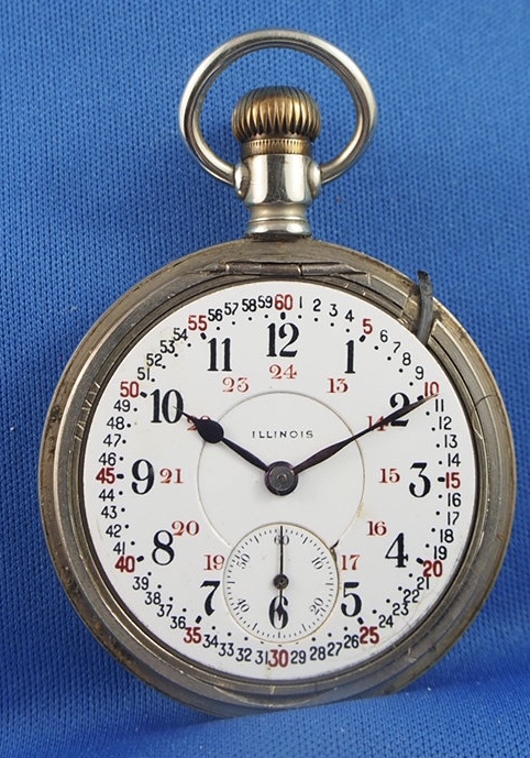

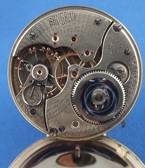

I had an interesting watch come my way for an opinion, recently. I don’t see many of these, and I thought i’d show it here.
It’s a 16-size, Illinois, 21-jewel, Sangamo grade railroad standard watch with an unusual dial. The dial is a 24-hour, double-sunk, vitreous enamel, Montgomery style dial showing marginal minutes. Some might say this is a very “busy” dial, and I guess they’re right. The dial shows damage at the sub-dial, and a hairline or two, but it is reasonably good for a 110-year old watch. Adjusted to 6-positions, temperature, isochronism, polished train wheel with oval spokes, ruby jewels in gold jewel settings, patent regulator, double roller, and “rayed” pattern damascene finish. I have always liked the look of these movements. Shown with the heavily worn glass crystal removed.
Here’s the skinny on it:
https://pocketwatchdatabase.com/search/result/illinois/2349045
It’s a 16-size, Illinois, 21-jewel, Sangamo grade railroad standard watch with an unusual dial. The dial is a 24-hour, double-sunk, vitreous enamel, Montgomery style dial showing marginal minutes. Some might say this is a very “busy” dial, and I guess they’re right. The dial shows damage at the sub-dial, and a hairline or two, but it is reasonably good for a 110-year old watch…
Dang that is a good looking dial 😎

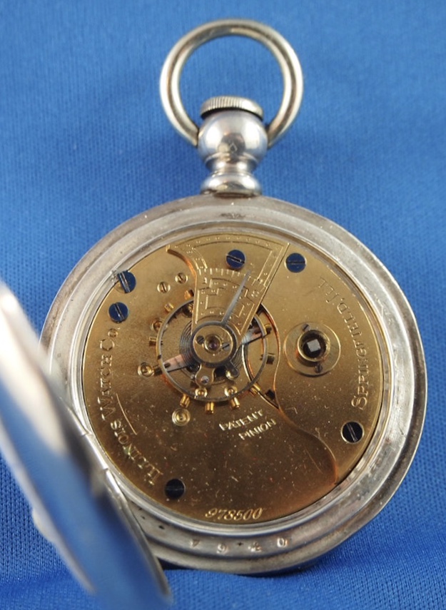

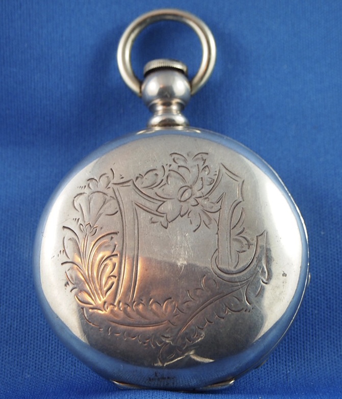

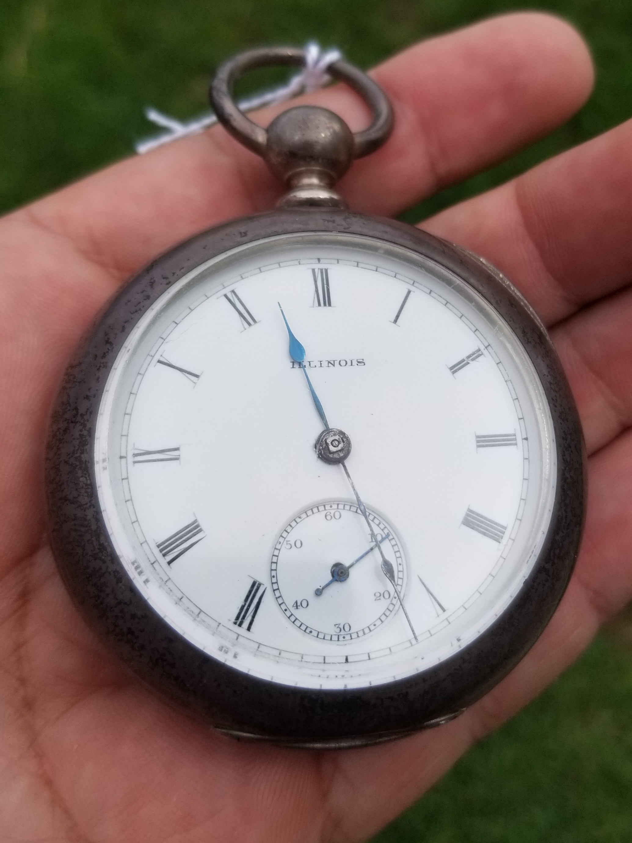

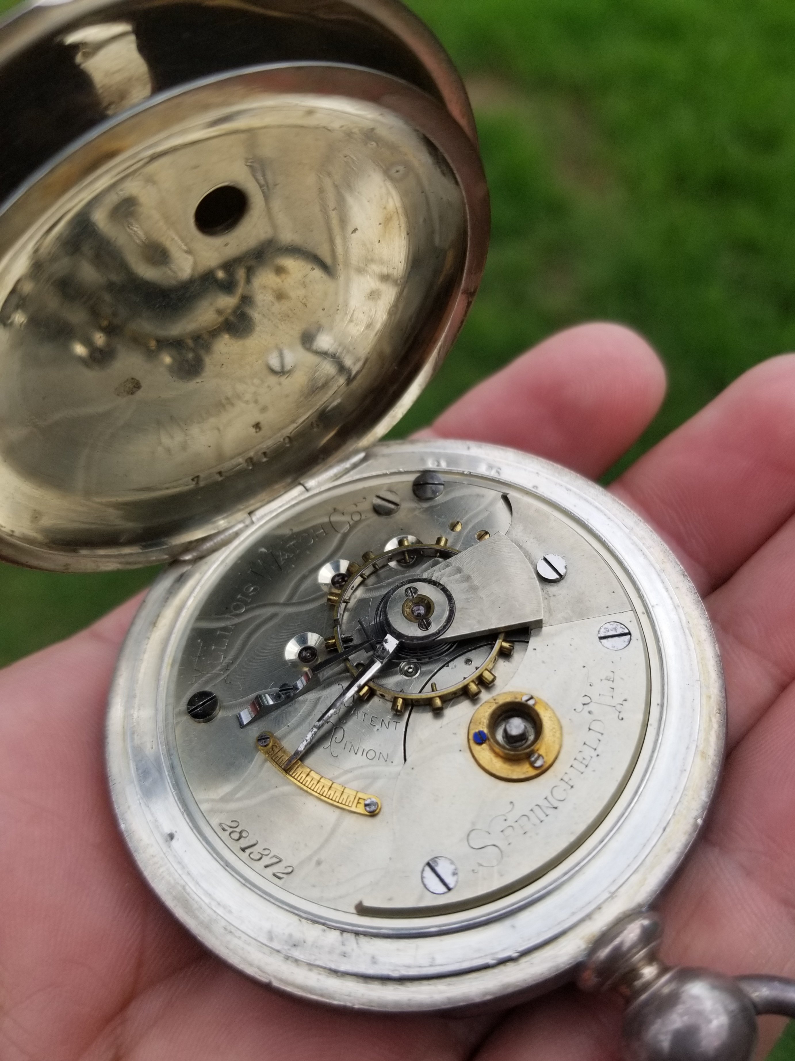

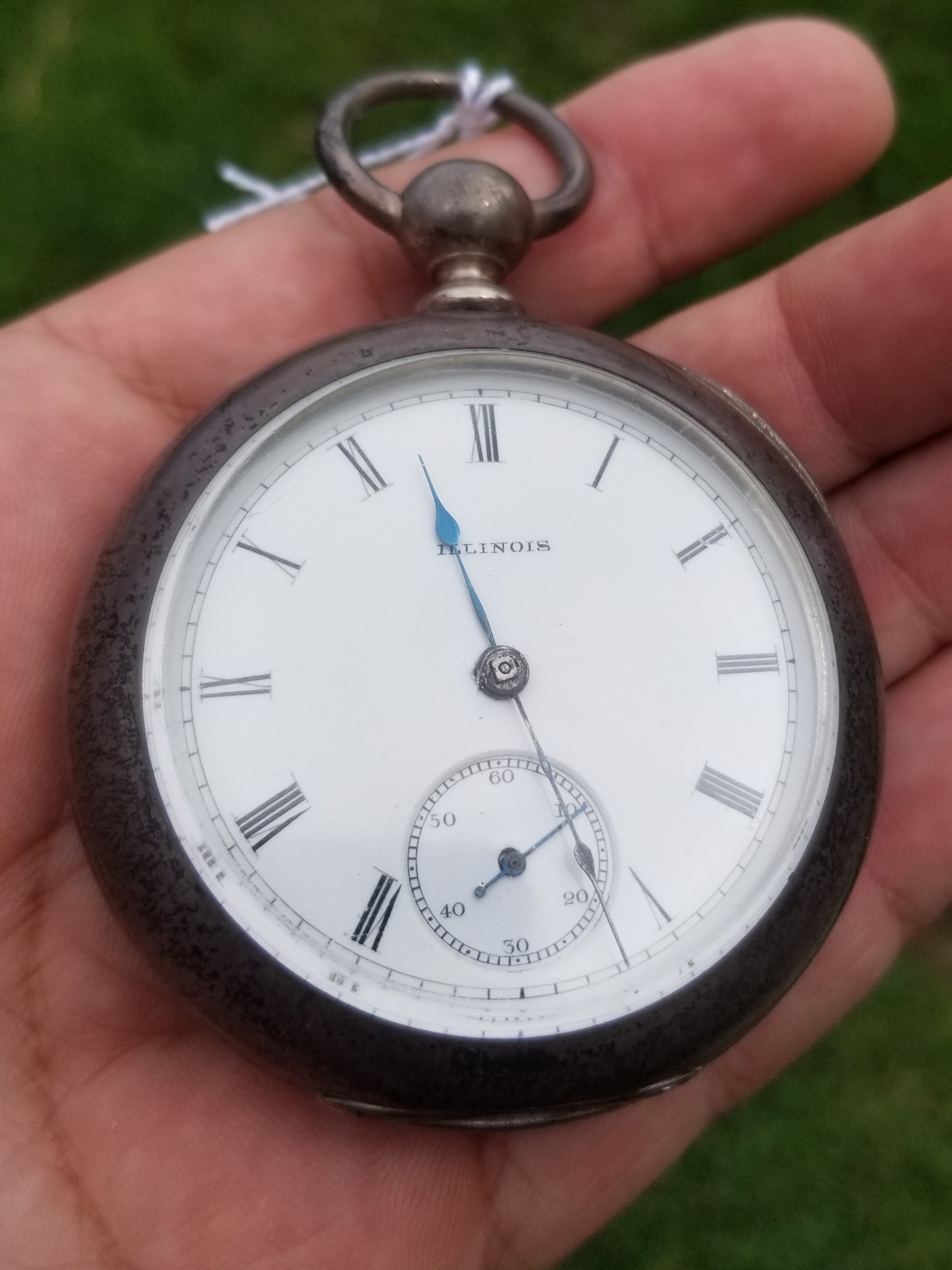

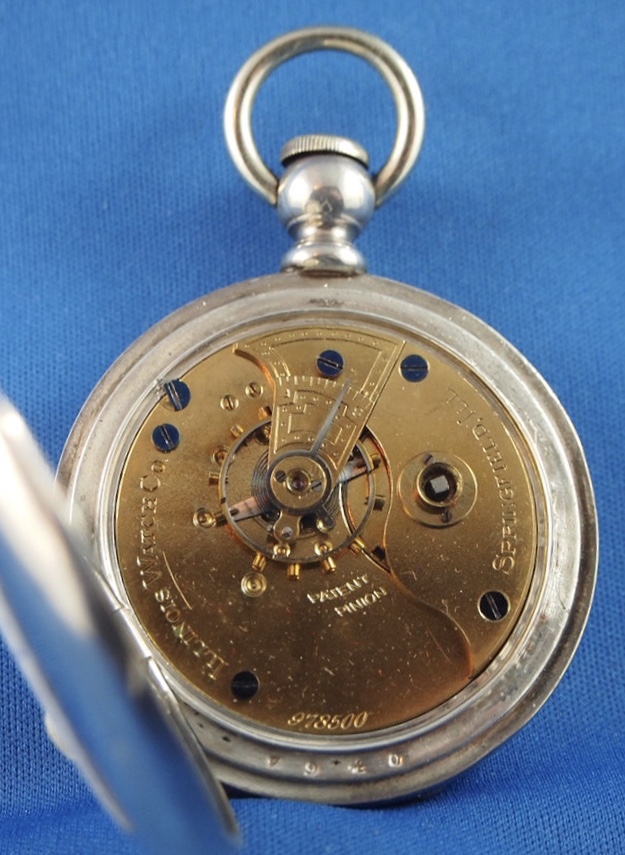

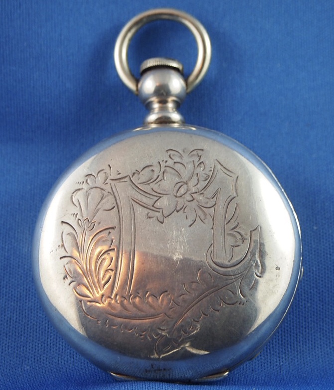

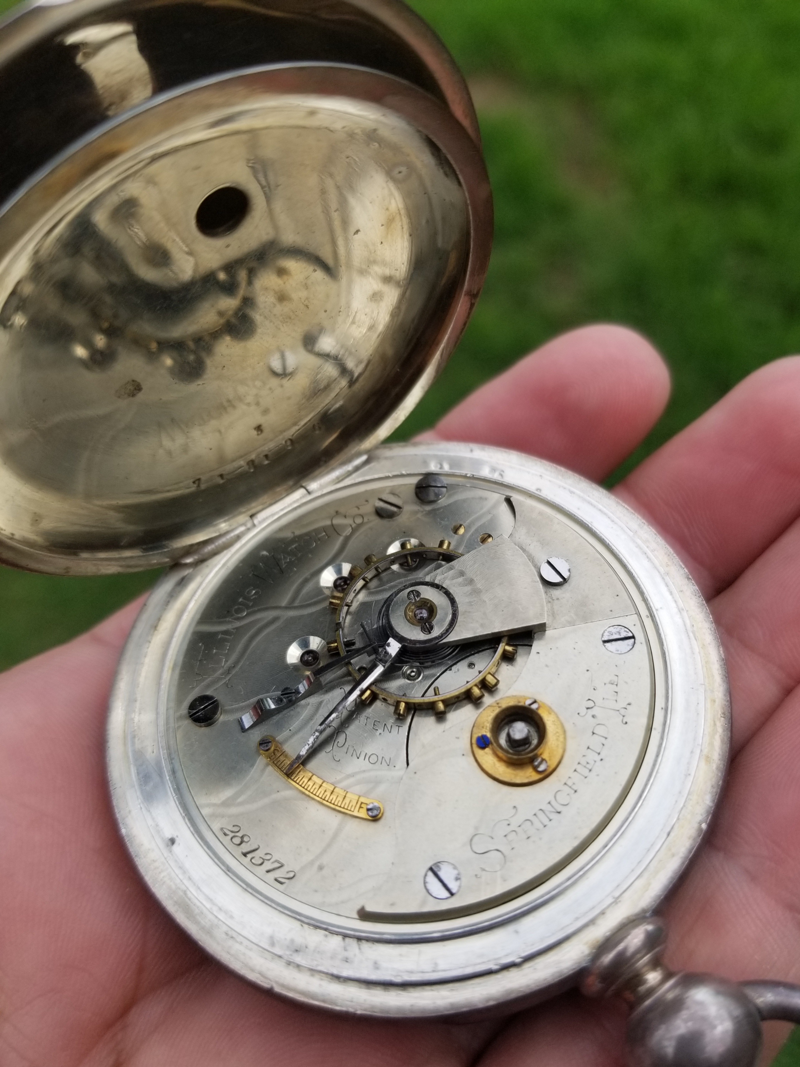

I wanted to give @TexOmega a shout out. After seeing his Hamilton square on this thread we started talking about watches and I made an offer on one of the pocket watches that he had shown off here previously. We came to an agreeable deal for it and today the postman delivered it. I wound it and it started ticking like a champ. Here it is for the second time but the first time belonging me, an 1883 Illinois Model 1 grade 101 in a coin silver case. Thank you for the excellent watch Tex.
15,997
48,115
The model 1 Illinois was available as both open-faced, or Hunter models. Being key would rather than stem wound, it was easy to use it for both applications. Mine is also a model 1, but in a coin silver, hunter case.

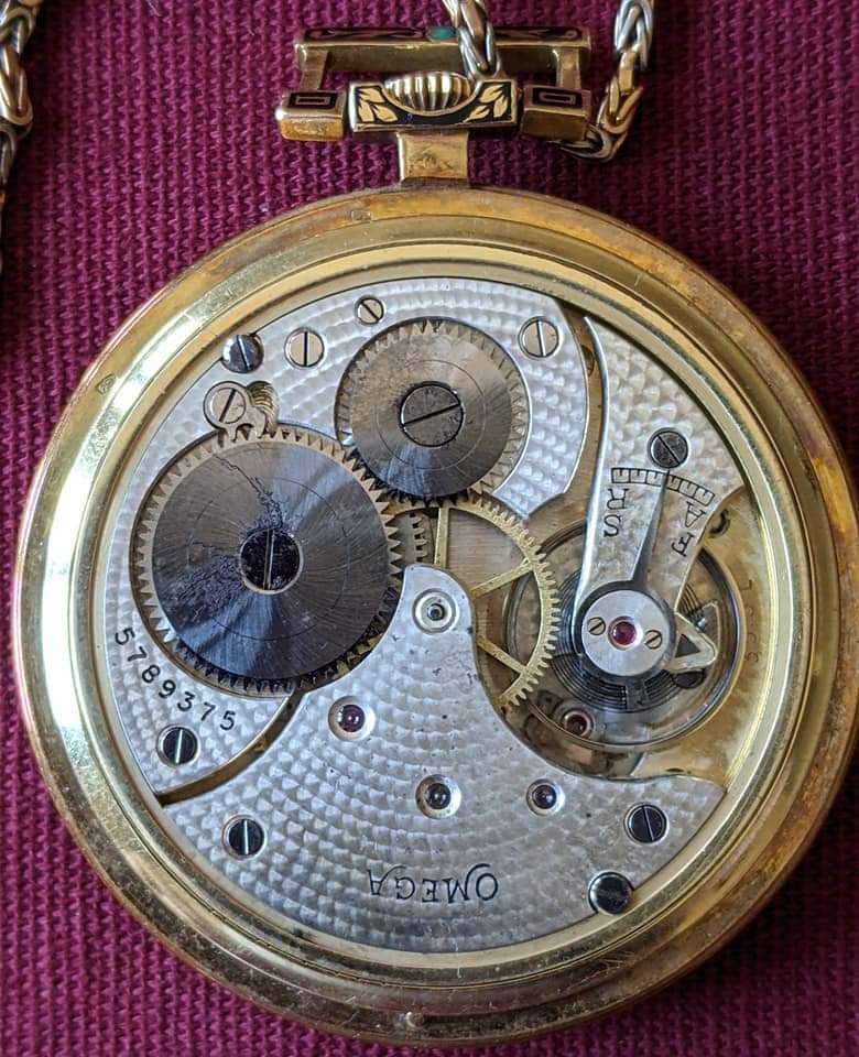

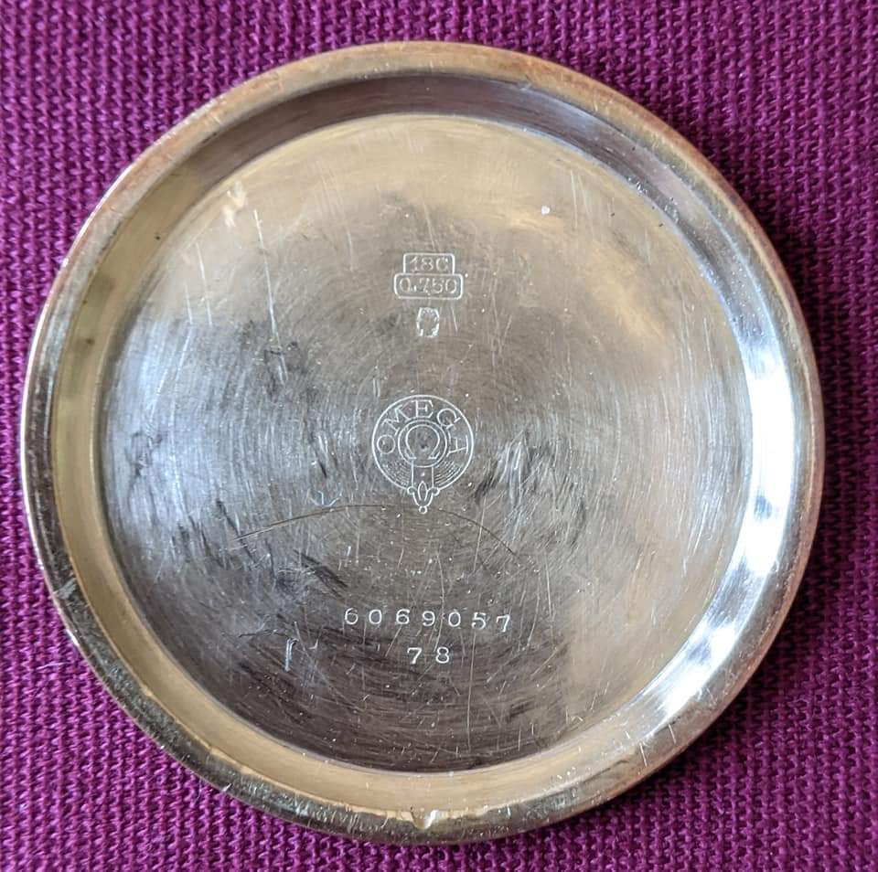

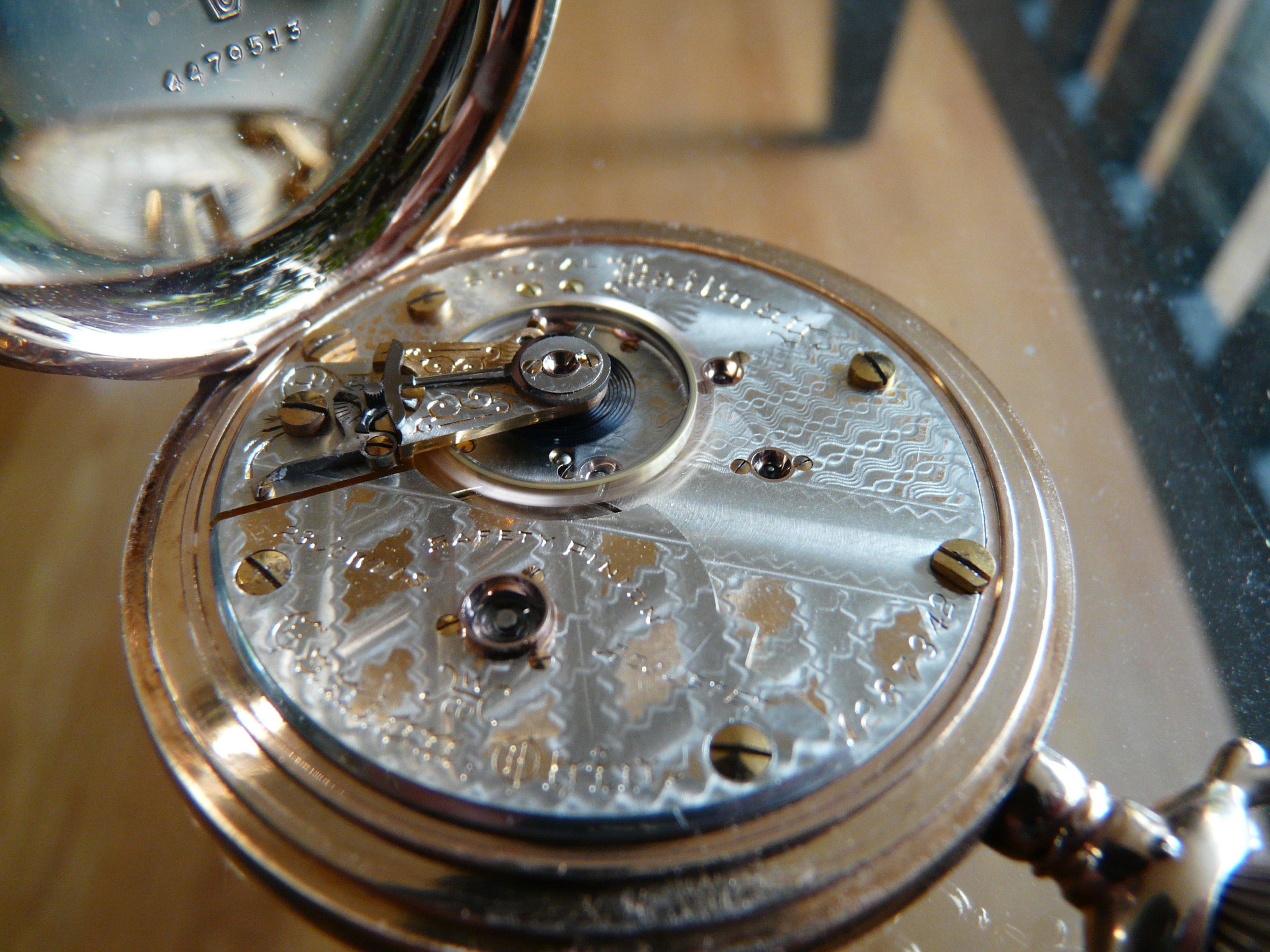

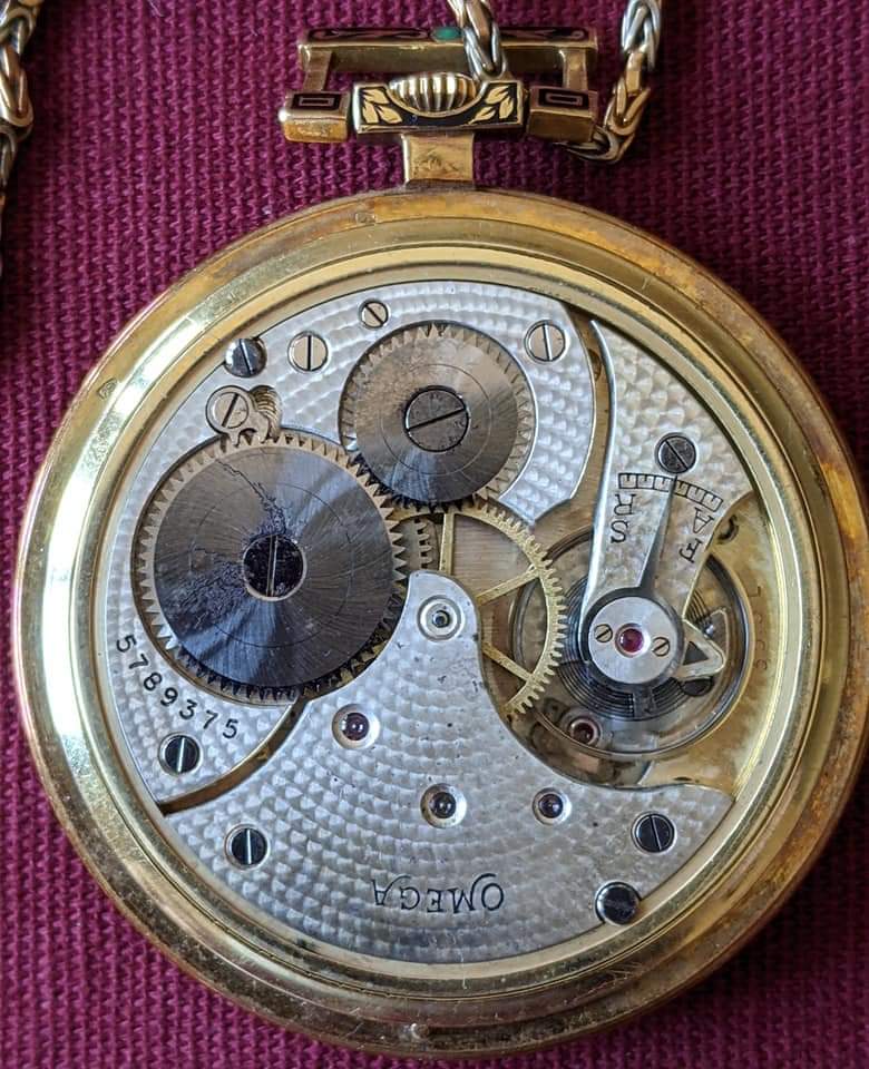

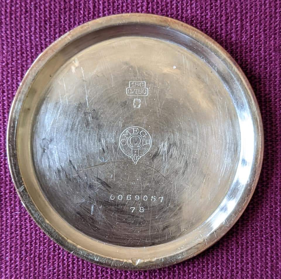

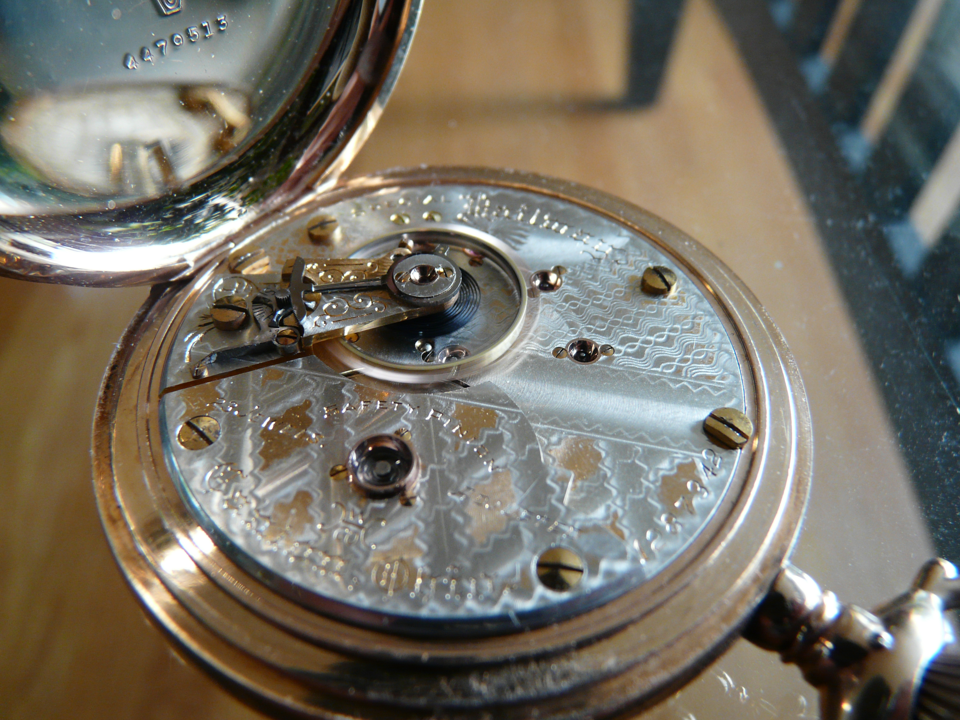

Here is movement and caseback photo of that Art Deco Omega. Hope it helps. 😀
15,997
48,115
I think I said that Omega was meant for someone with good taste and deep pockets, when you first showed it. I was correct! The .750 stamped inside the case back indicates that the case is 18-karat gold! What surprises me is that the movement is just a standard Omega movement, with only 15-jewels! I was expecting a movement as spectacular as the enamelled case! Still, it is a spectacular watch!

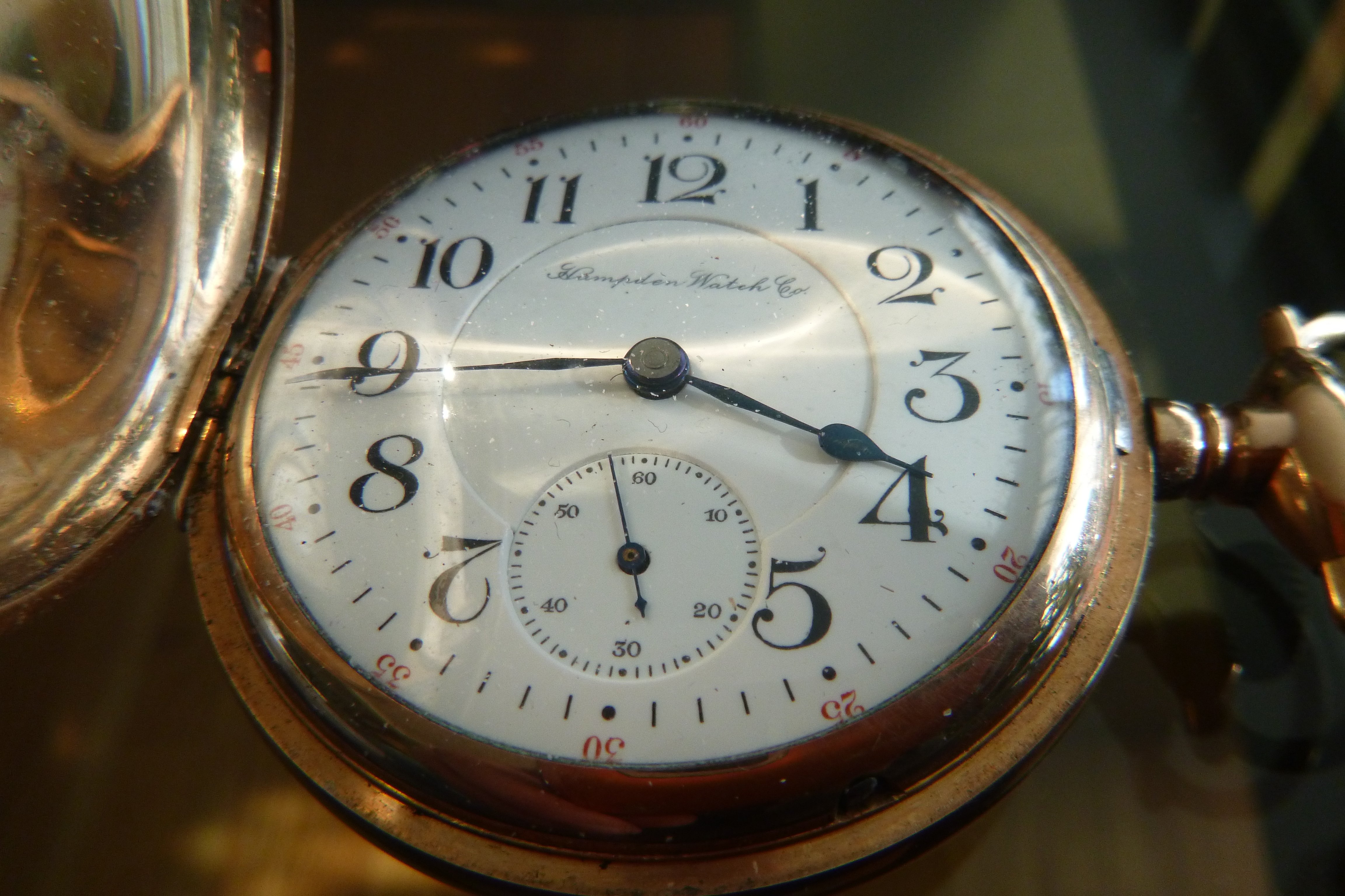

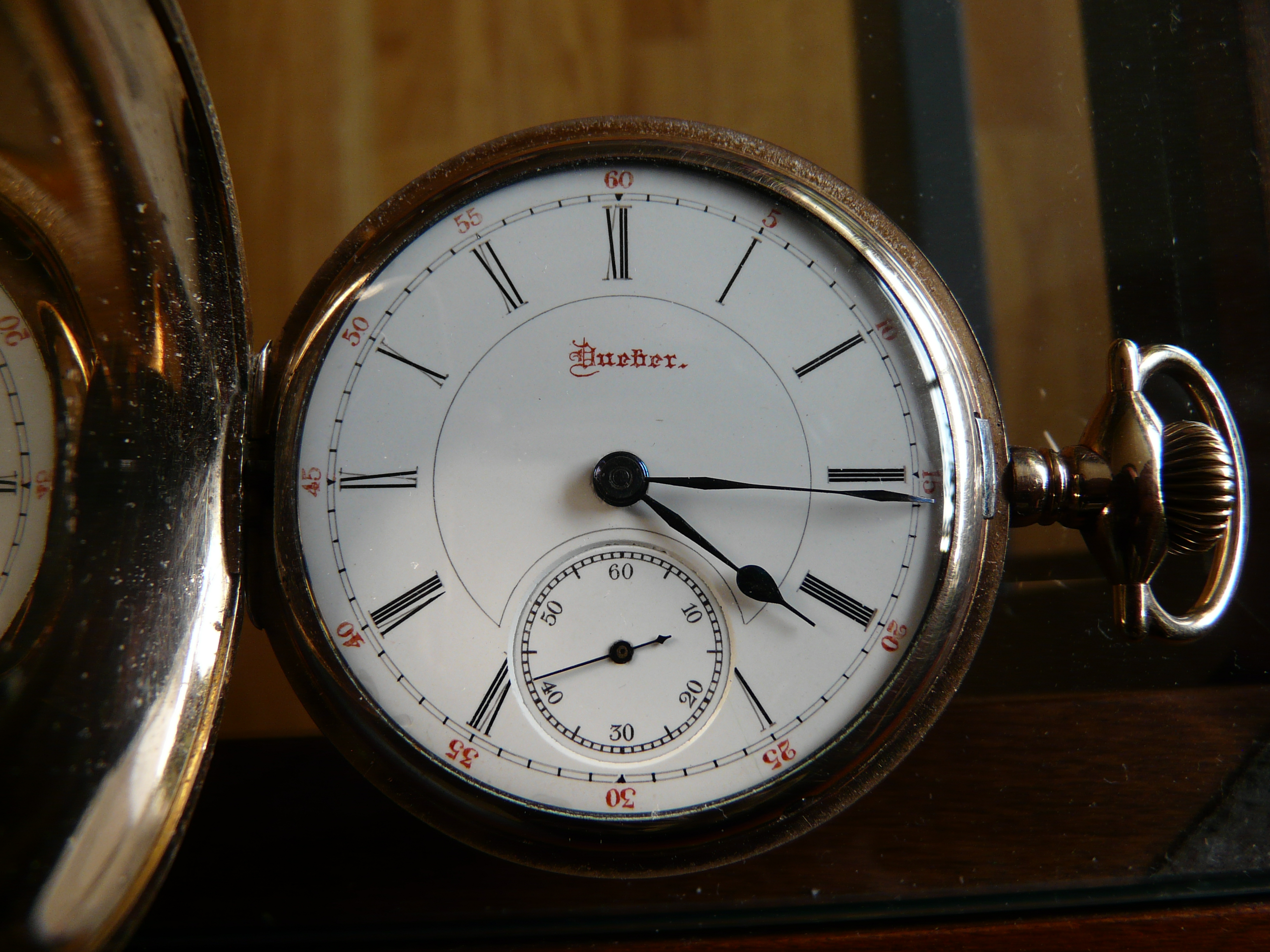

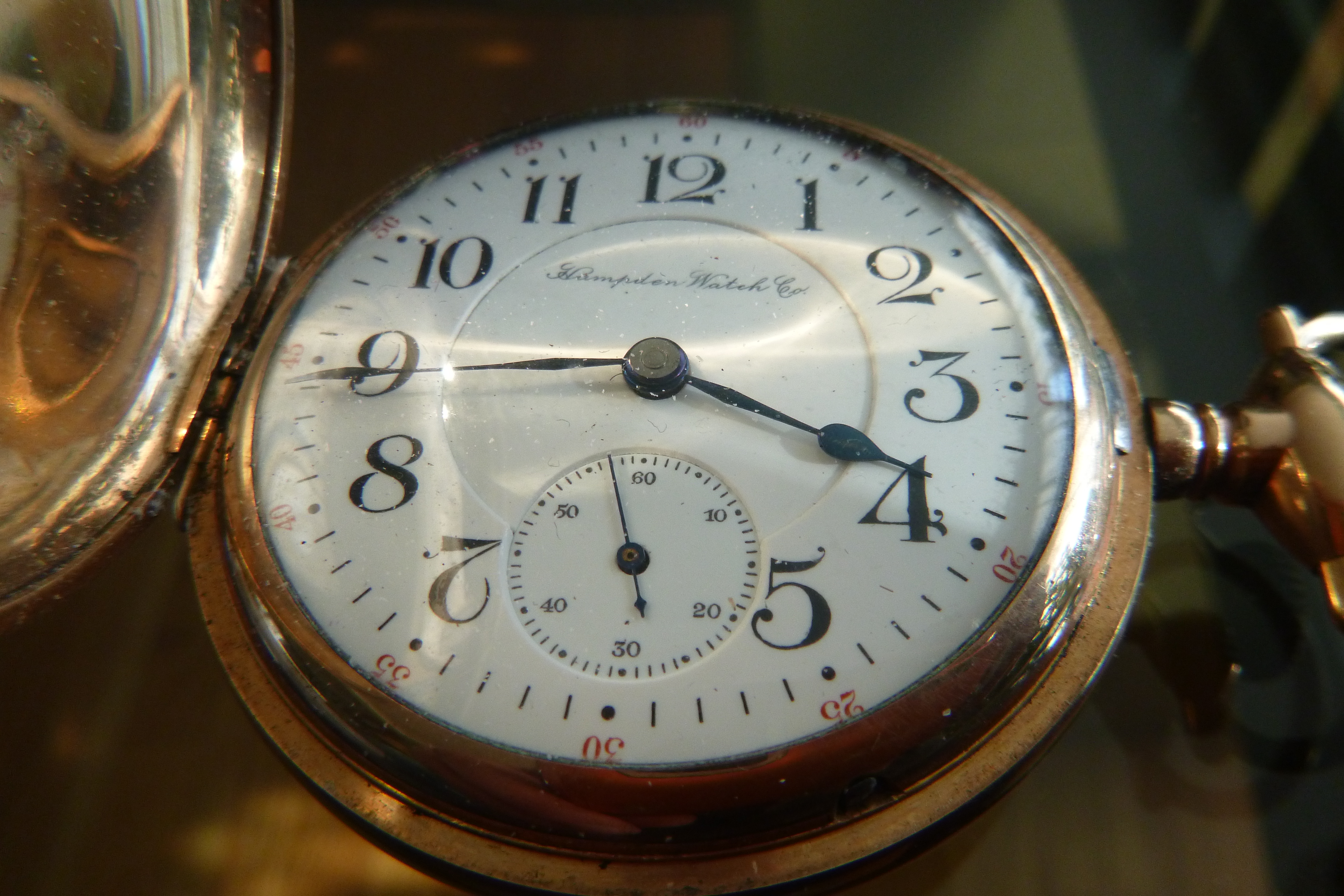

Hampden Special Railway from about 1899
@Fritz,
Is the movement in your railway Special marked Hampden, or Dueber? Indeed, there aren’t many of this model floating around. Peculiar that it is a railroad grade movement, but by the time this one was made, Roman numerals and hunter cases where no longer railroad standard. This one was likely for a non-railroader who was prepared to pay for a watch of exceptional quality. It looks to be in superb condition. A recent acquisition?
3,819
16,171
@Fritz,

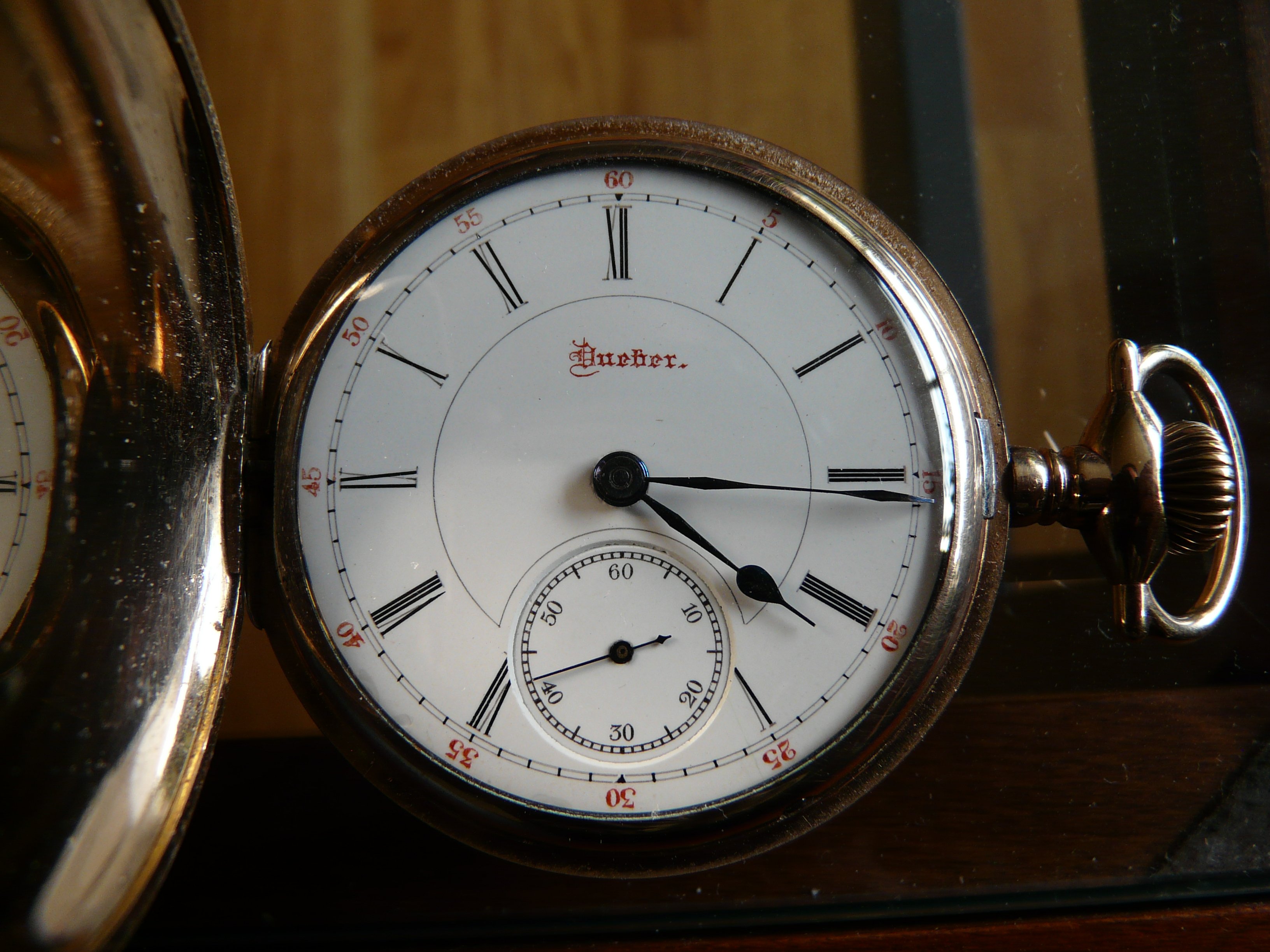

You could still get a hunter case past the inspectors eye about the time this one was made, but the days of the hunter case were indeed numbered. The movement is clearly labeled Hampden as is the original Arabic dial. Said dial is in perfect condition, not a nick or hairline, and is carefully stored in my stash of important goodies. The watch wears a Deuber dial because it was available, cheap and really really gorgeous, especially with the red logo! I just couldn't resist a quick "redial" in this case and I can always swap it back, besides, I really am not that fond of the original dial's font. I got it a few months back. had my tame German go through it and it now keeps excellent time.
looking at the case I think it had an easy life.
the original dial:
