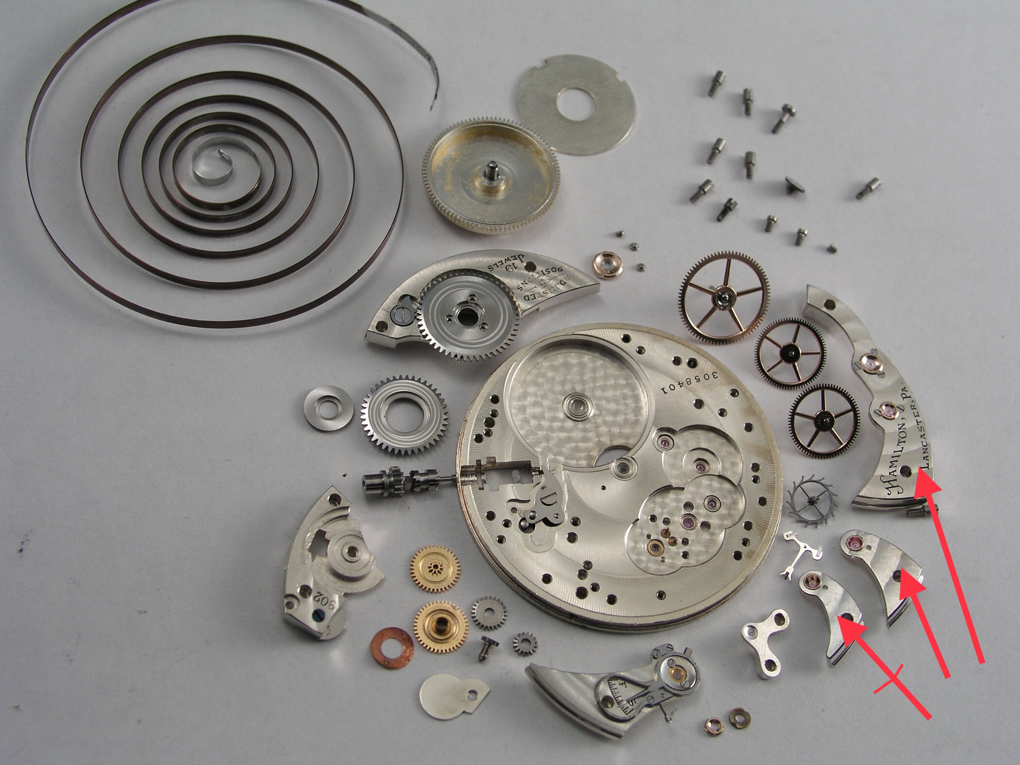

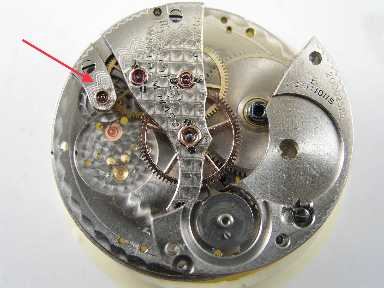

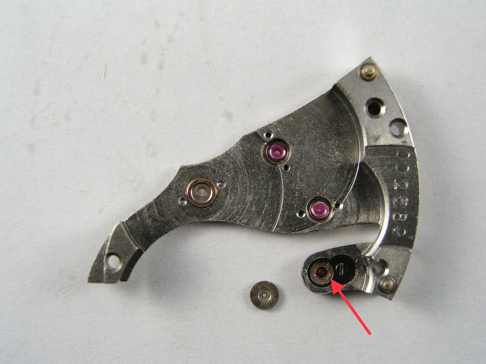

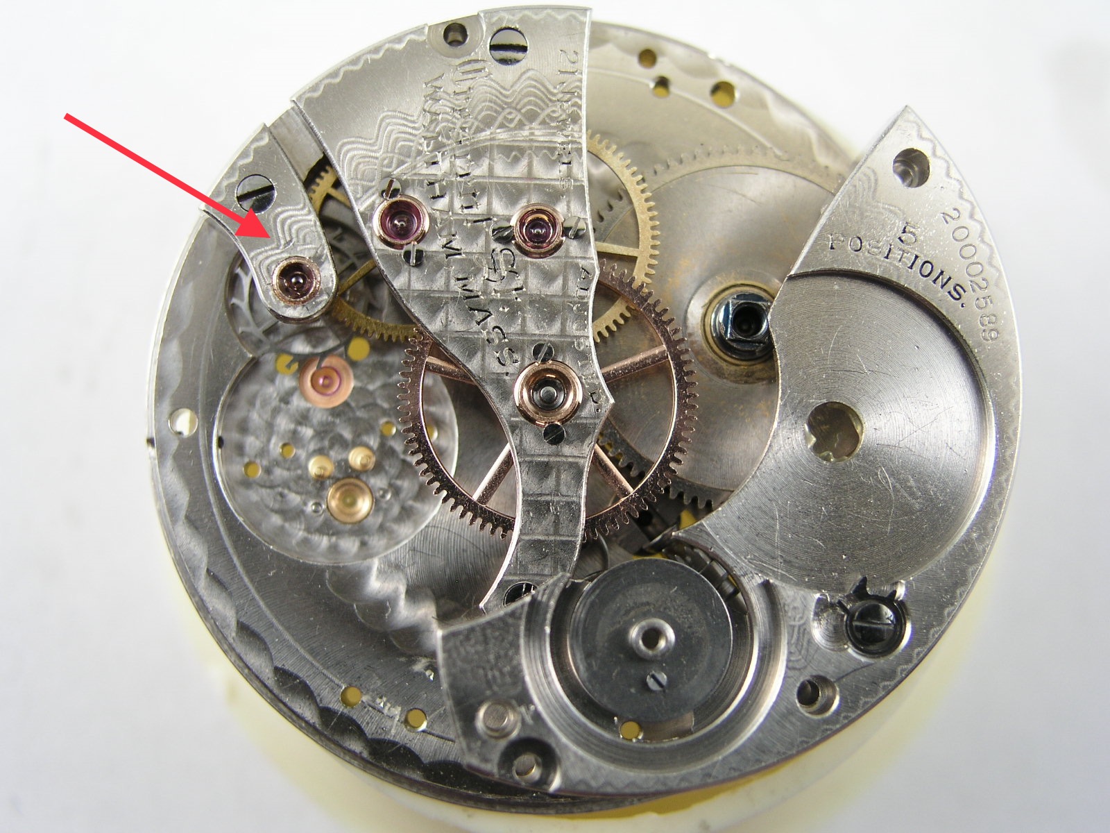

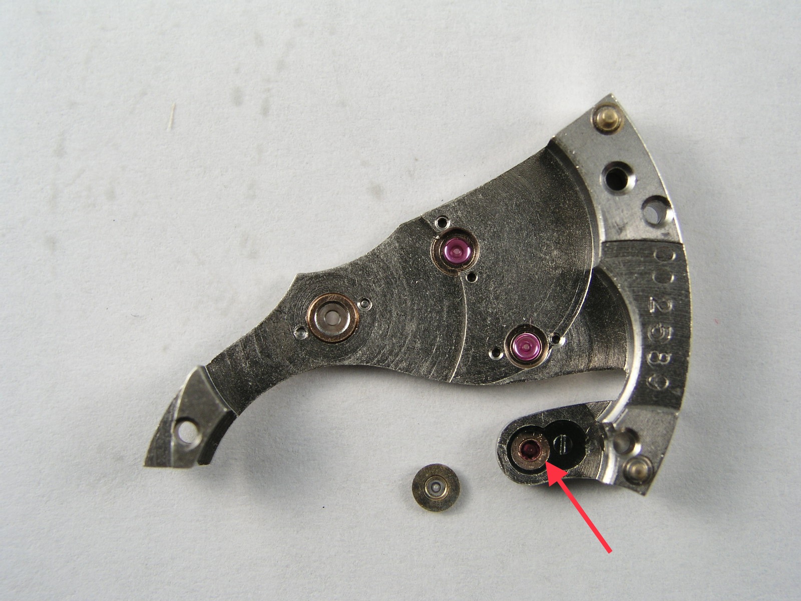

Excellent questions. First, I’ll show you a 16-size Waltham Crescent Street, assembled, and dimantlled. The arrow points at the FALSE bridge over the escape wheel in both pictures. In the second picture, you will see the escape wheel bridge is attached to the larger bridge. That is called a false bridge.

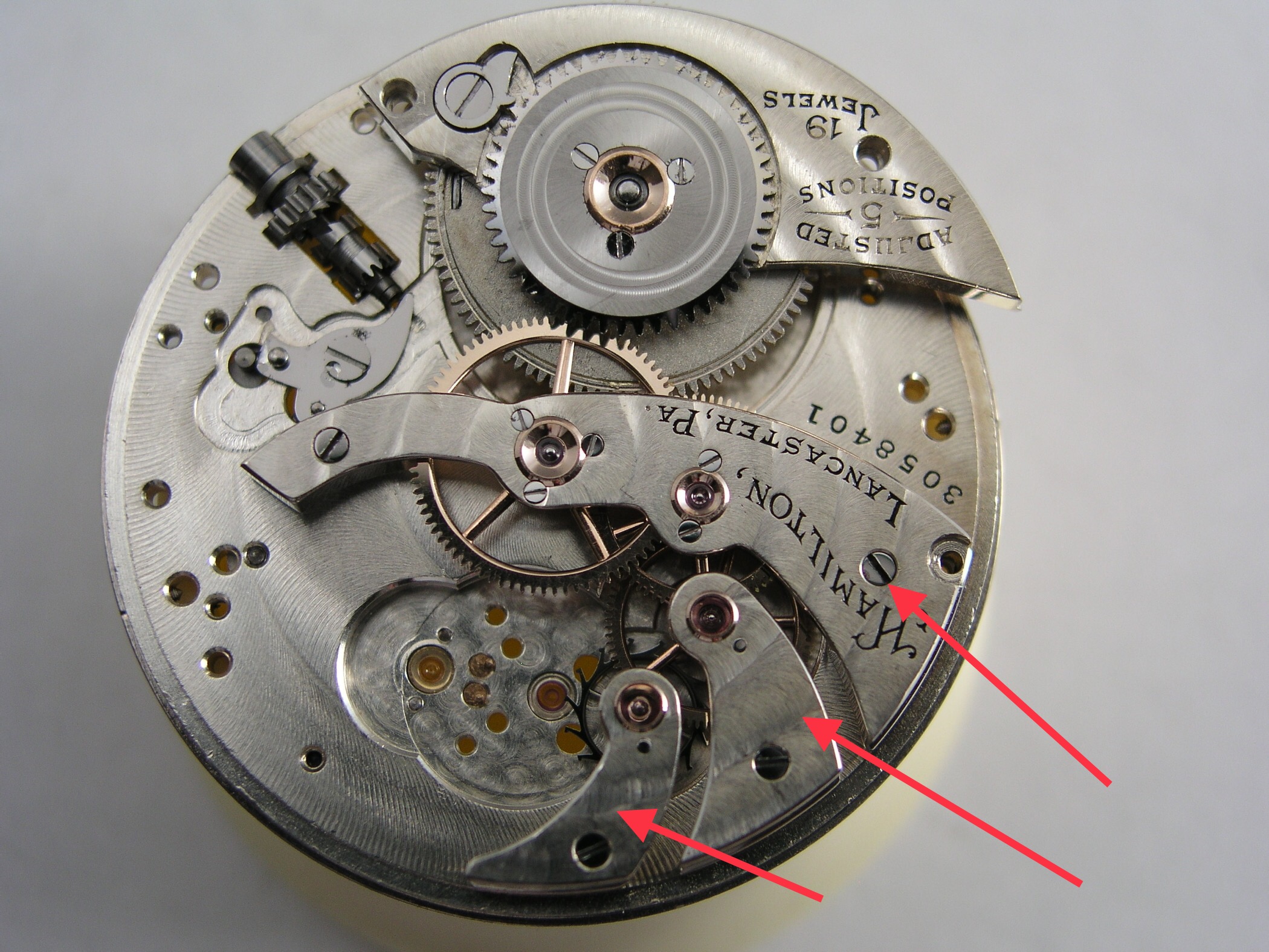

Next, a Hamilton 902, 12-size. Likewise the watch shown assembled and dismantled. In both pictures, the arrows point at 3 bridges. In the one of the watch dismantled, you will find the two small bridges are NOT attached. These are bridges, not false bridges.

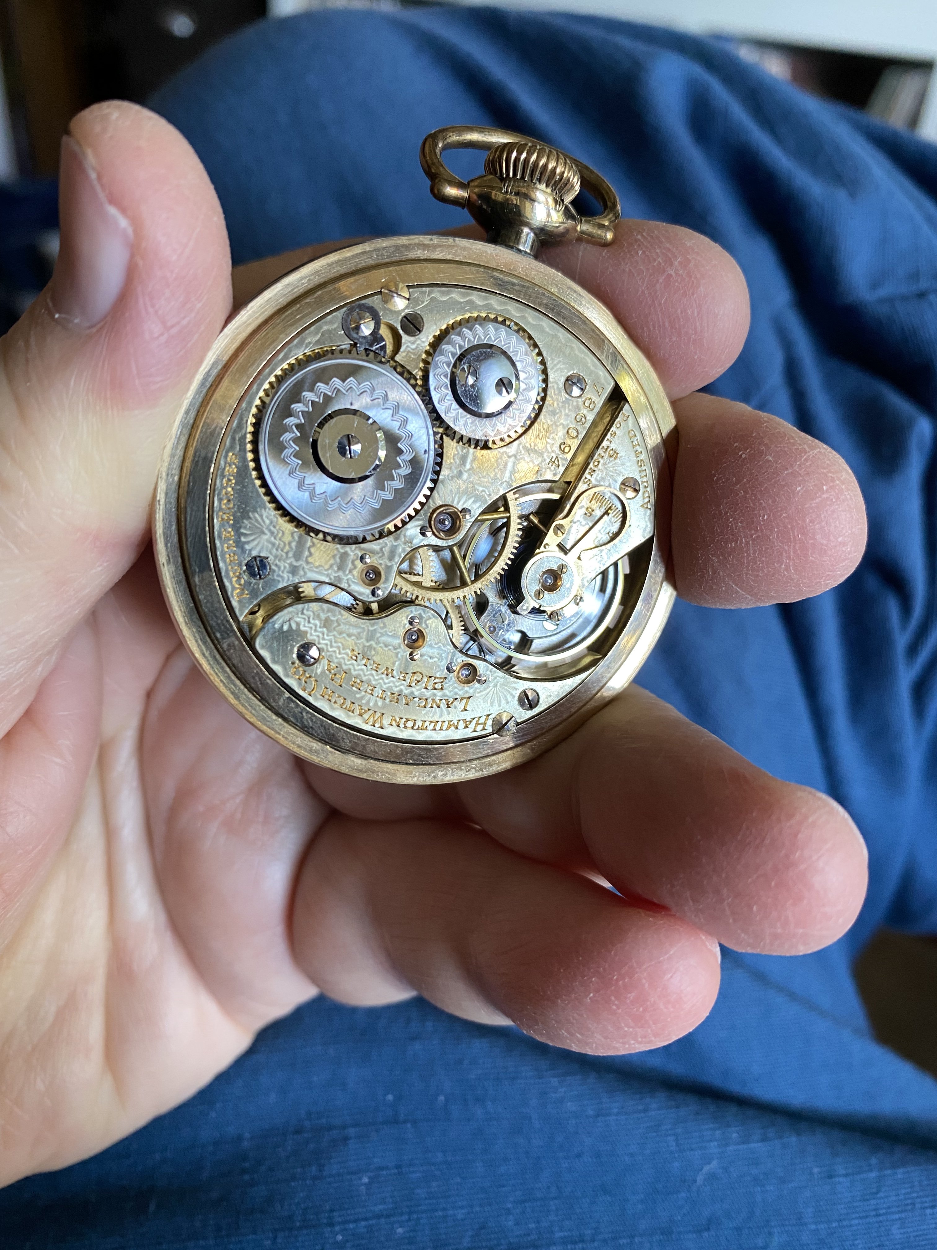

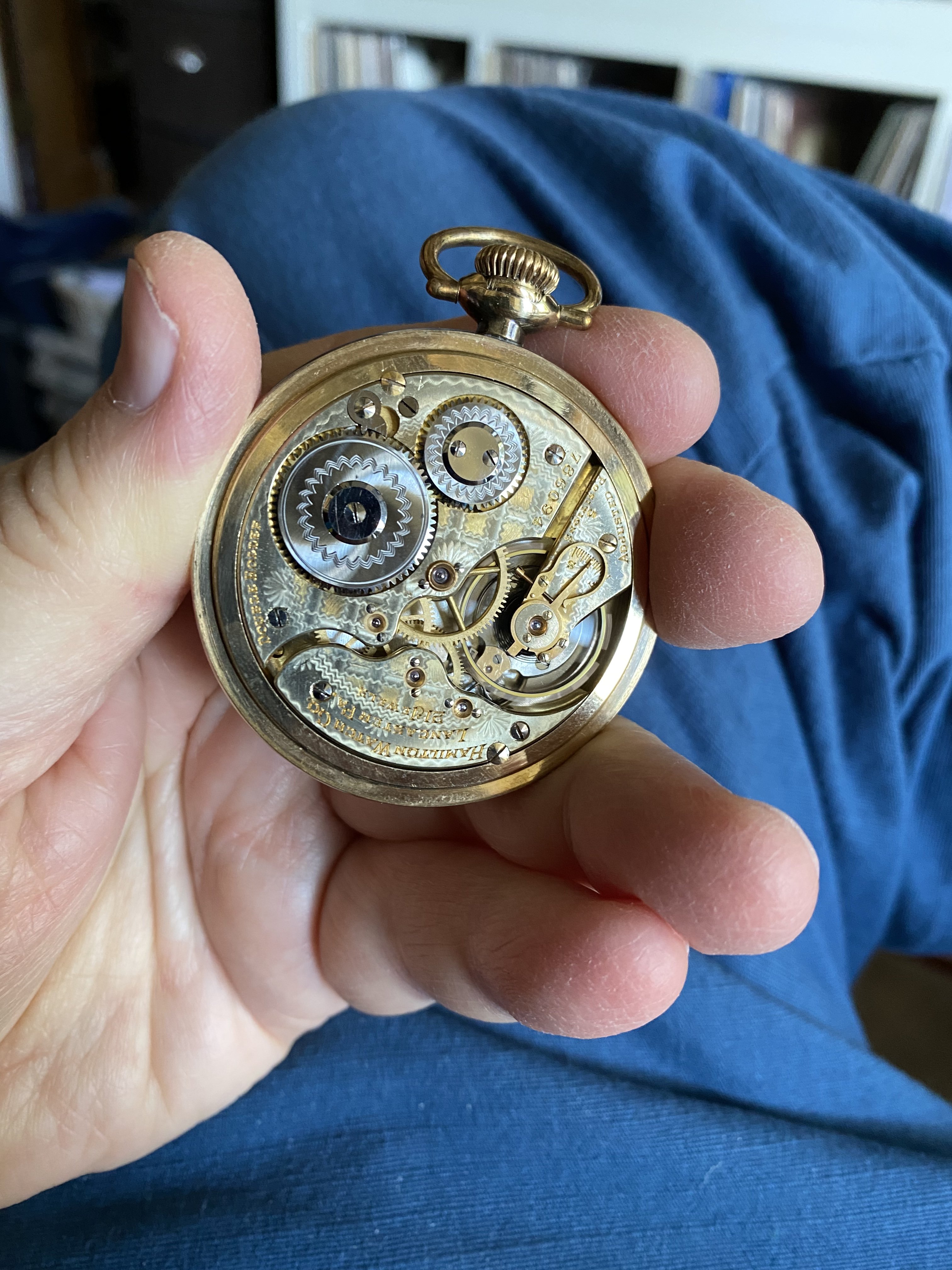

Hamilton 992
Circa 1910
Absolutely gorgeous movement esthetics

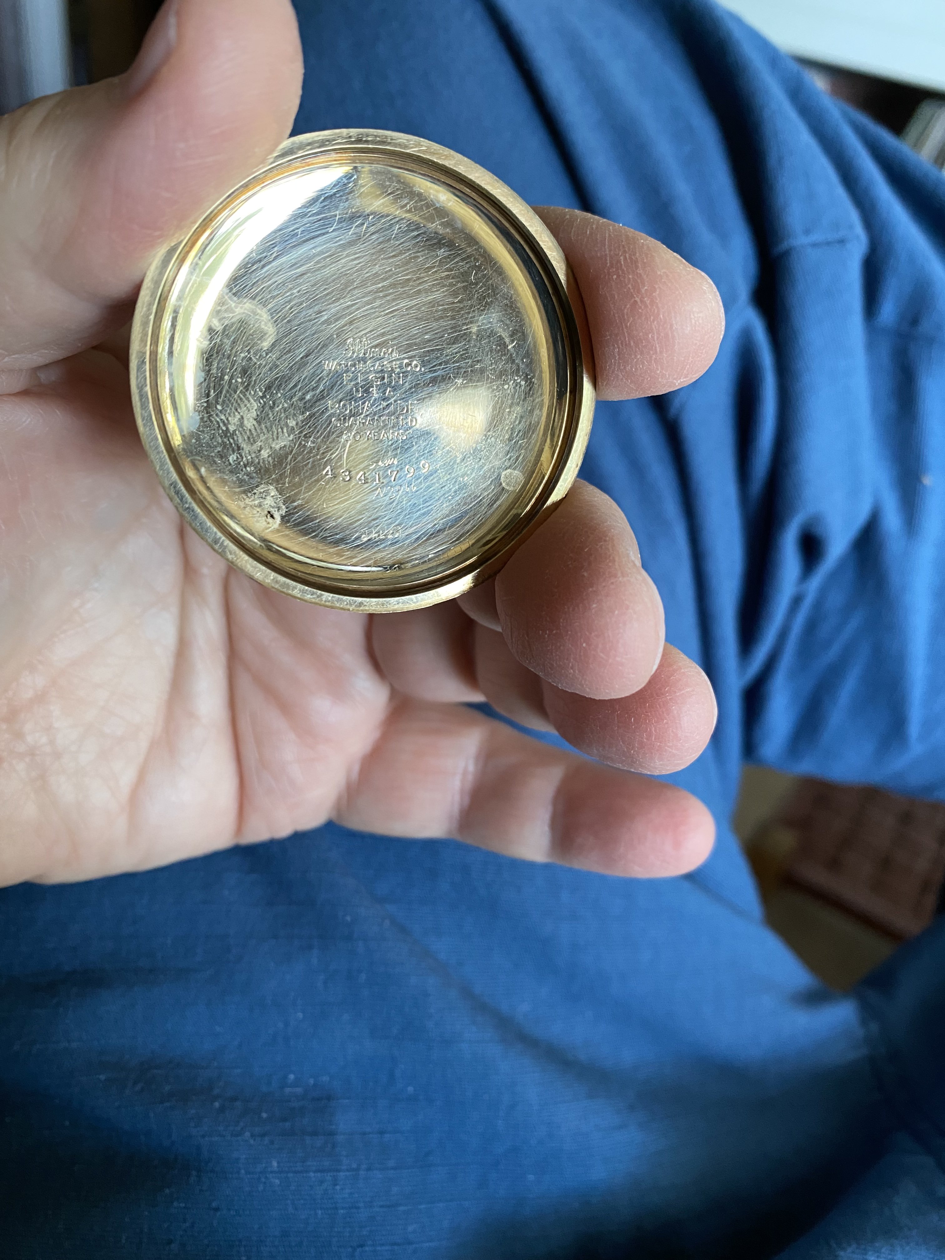

Illinois Watch case Company
And a not often seen double sunk dial is the capstone

Would that Hamilton be in a competitor's case TexOmega?
The Illinois Watch Case Co. was not affiliated with the Illinois Watch Co. It was part of the Elgin Giant Watch Case Co. The IWCCo. Trade mark was registered in 1894. The company was located in Elgin, Ill. This information from Warren Neibling’s book History of the American Watch Case.
I don’t see any extraneous case screw marks on the case flange around the movement, so it would seem it was original to the movement.
My 992 (it seems), is newer than @TexOmega ‘s. It is in a Wadsworth case that doesn’t show up in the Shugart book. as a “Hamilton” case. My 992E does show up in a recognized Hamilton case. I also checked my two 992Bs, and my 950B, and they are in Hamilton cases. These last three are in Wadsworth cases. So it would seem that, as of the 992E (replaced the 992), these watches might have been shipped, cased.
I’ve never seen a two-tone 992. The markings on the dial are unlike anything I have seen.
