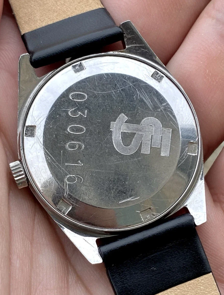

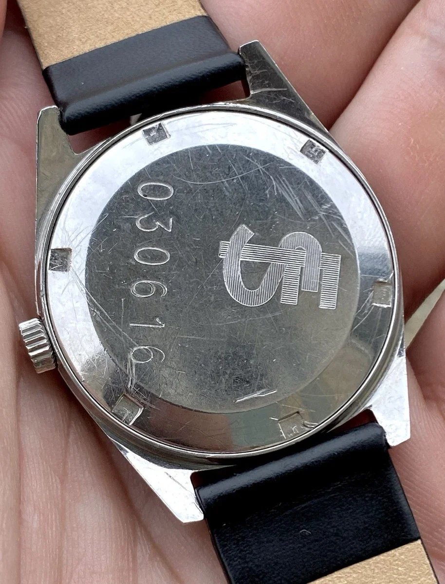

One of the most well-known watches issued to Italian railway workers didn’t have any images of trains, tracks, or anything else - just an acronym FS for "Ferrovie dello Stato" 👍👍

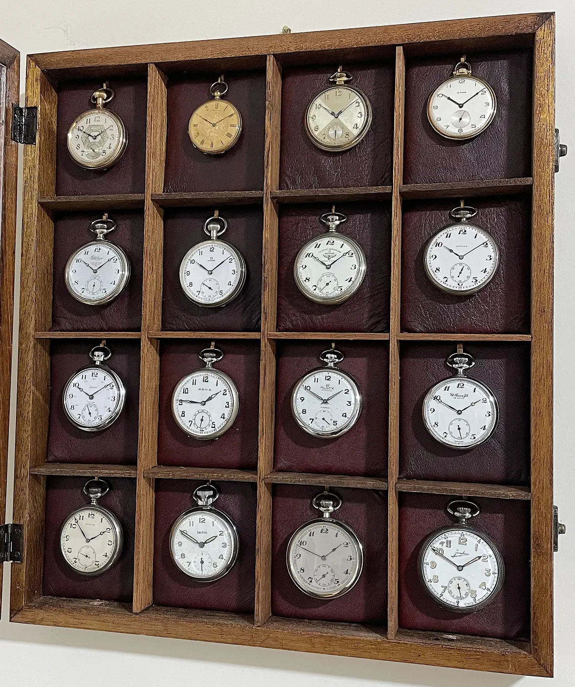

It would seem the more images of trains and railway stuff a watch has the less likely it is to be of railway standard!

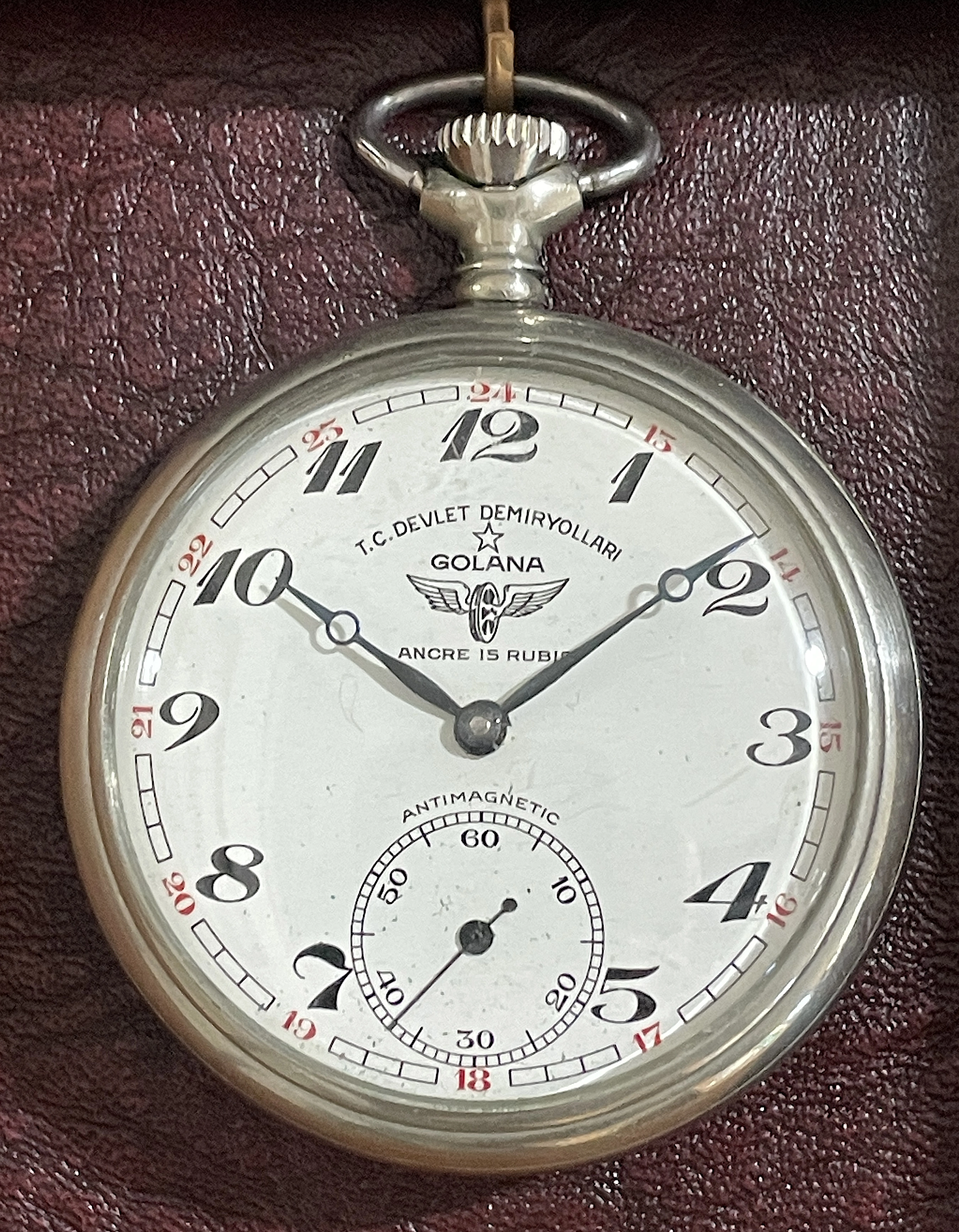

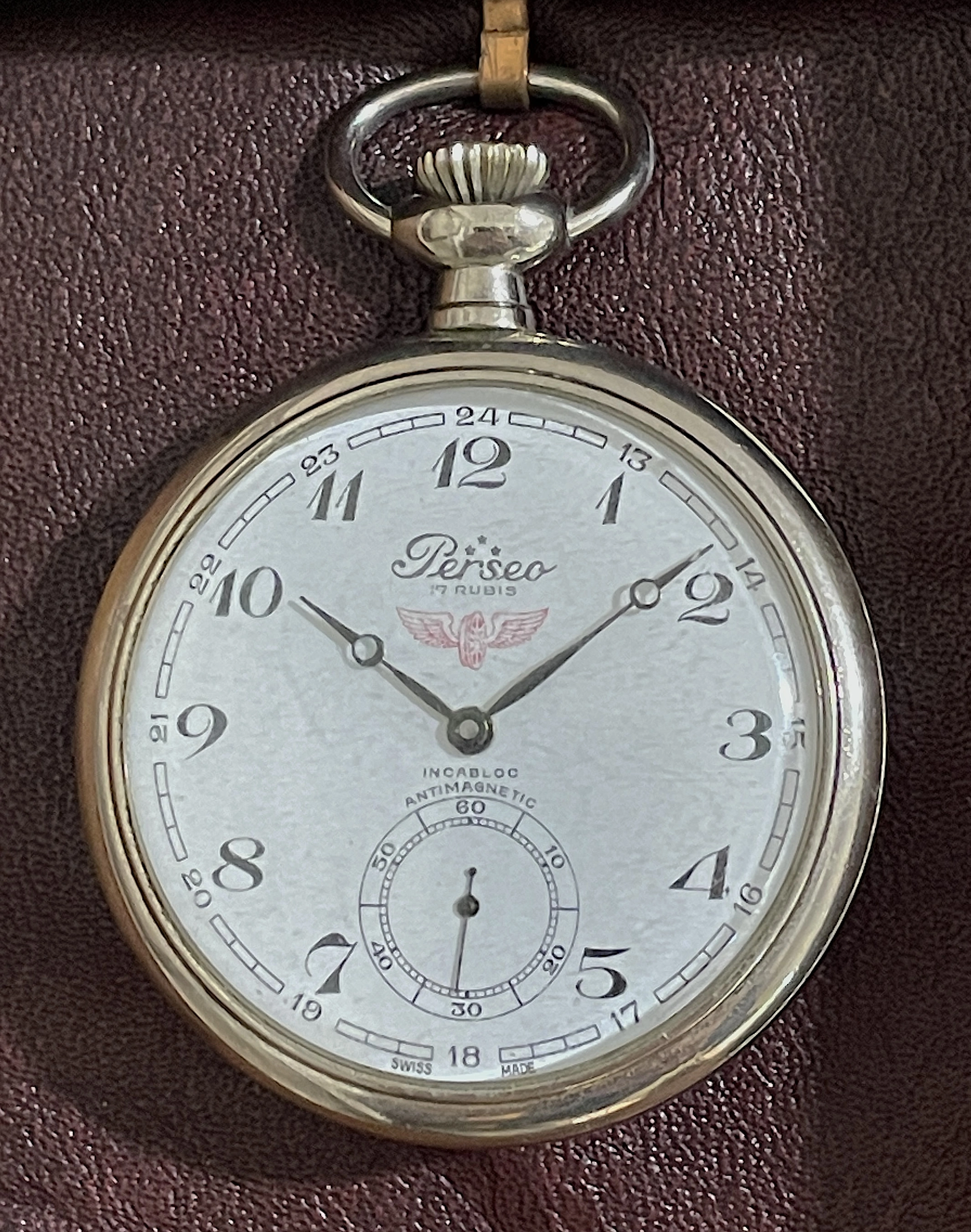

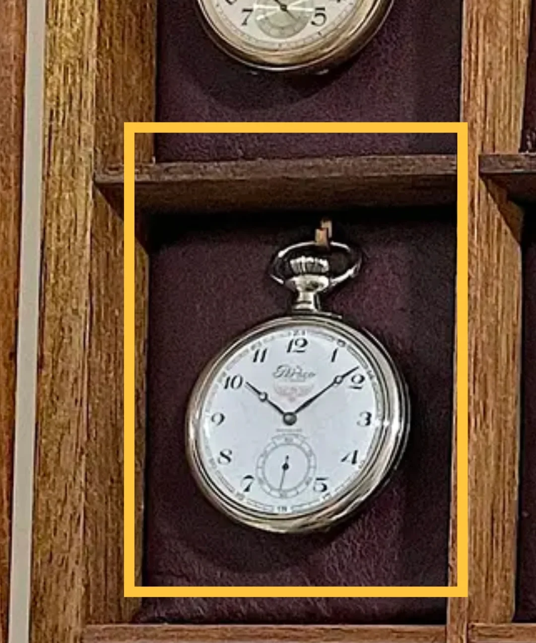

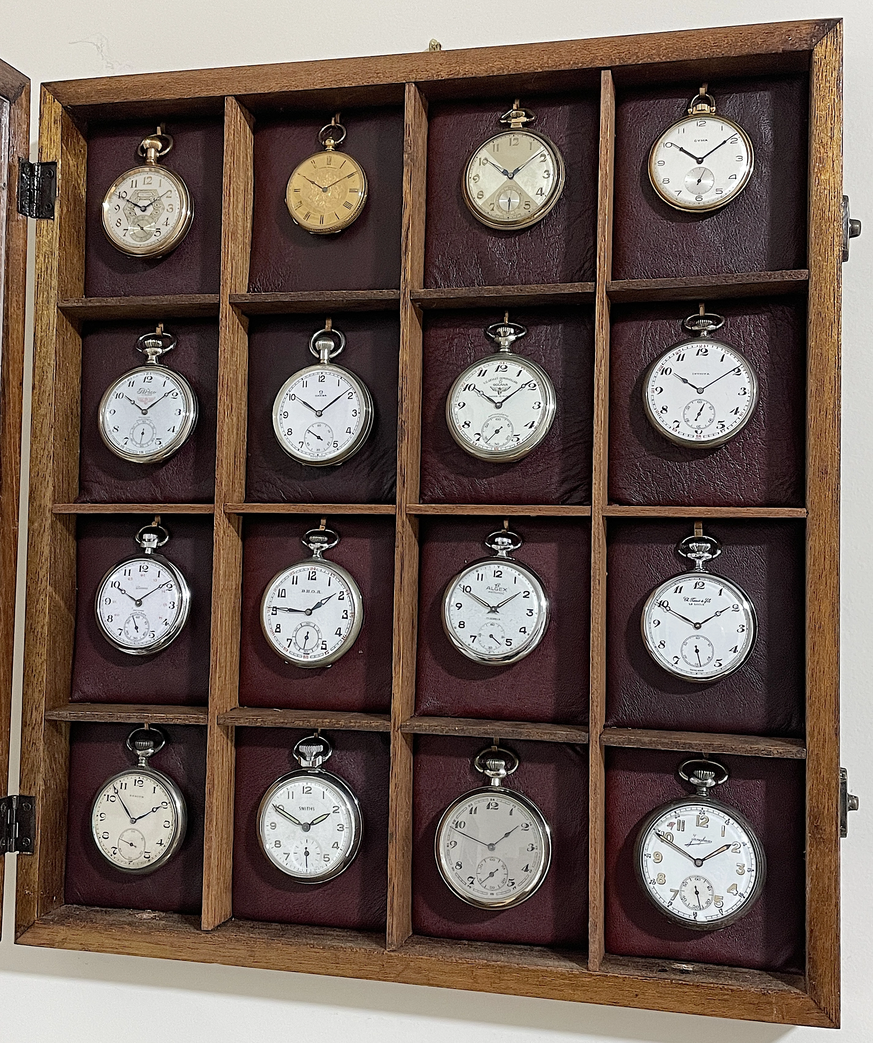

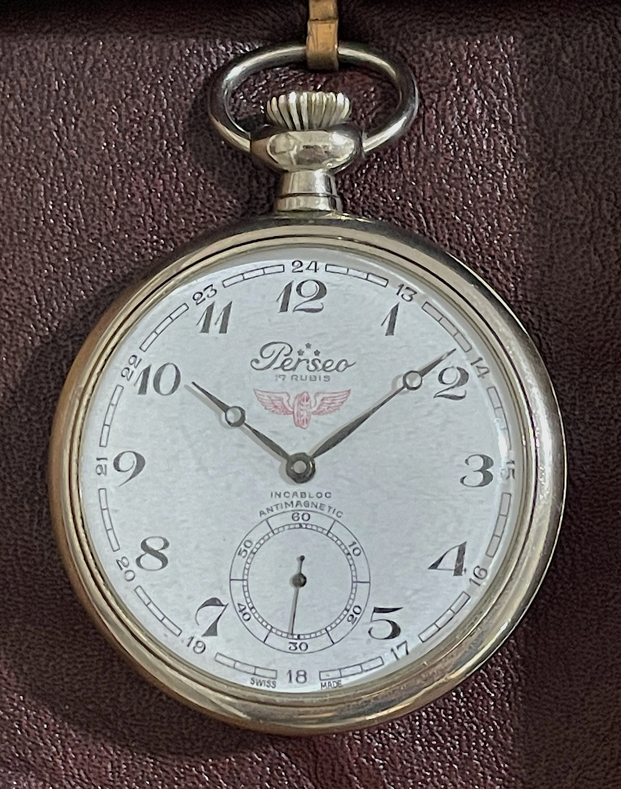

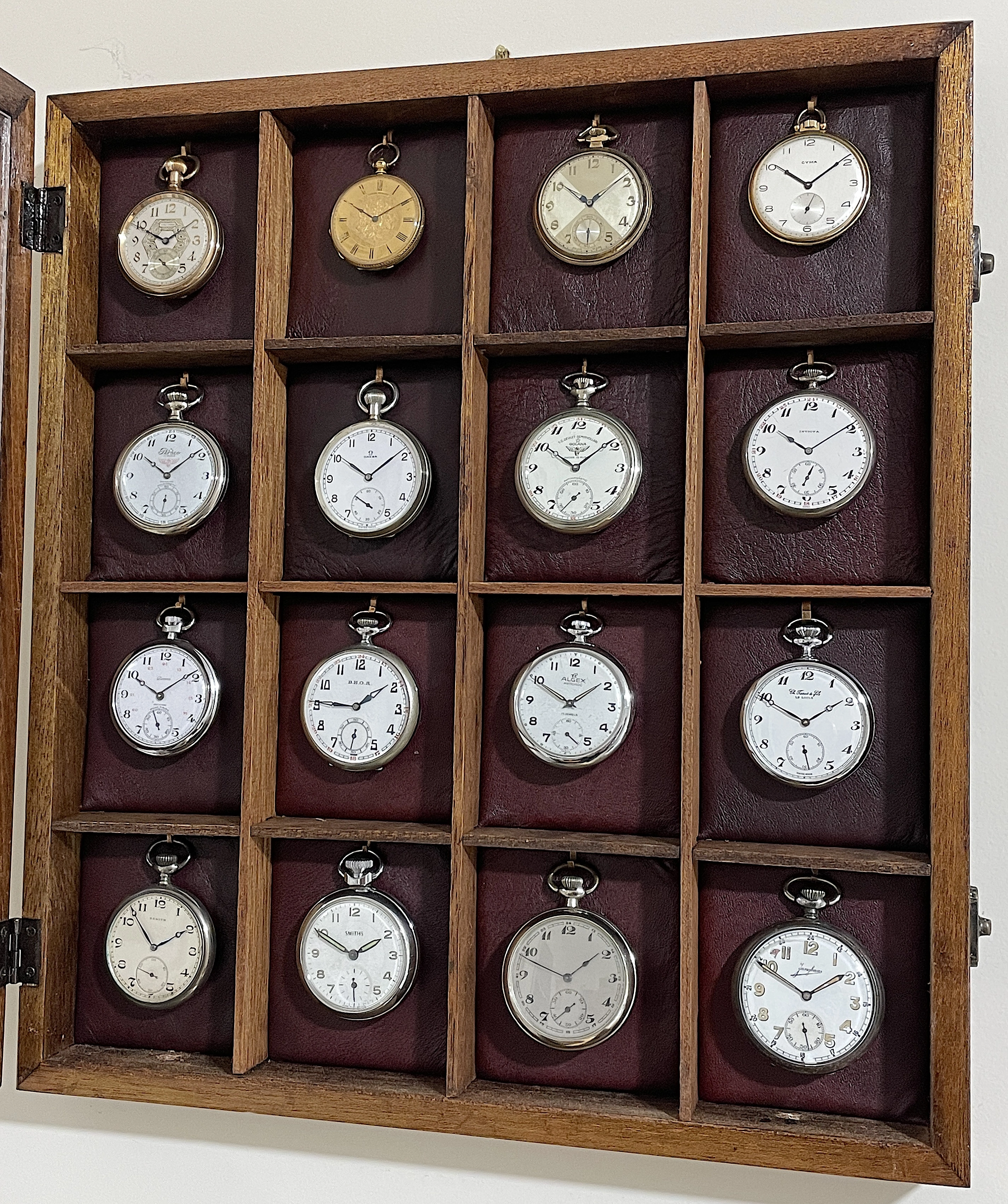

Yes, but there are exceptions. Row 2, column 3.
Close-up for you.
and who can spot the other real railway watch?

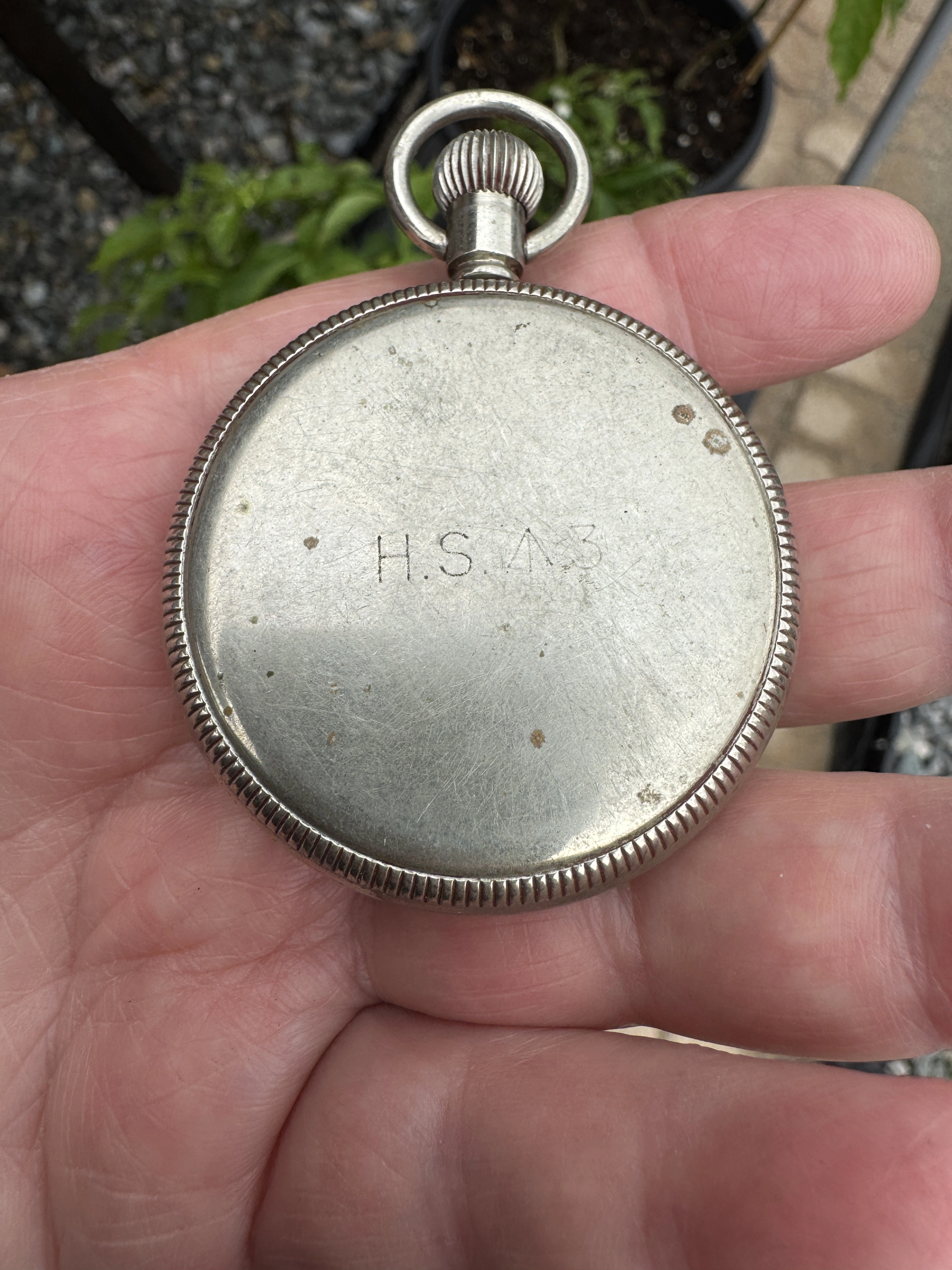

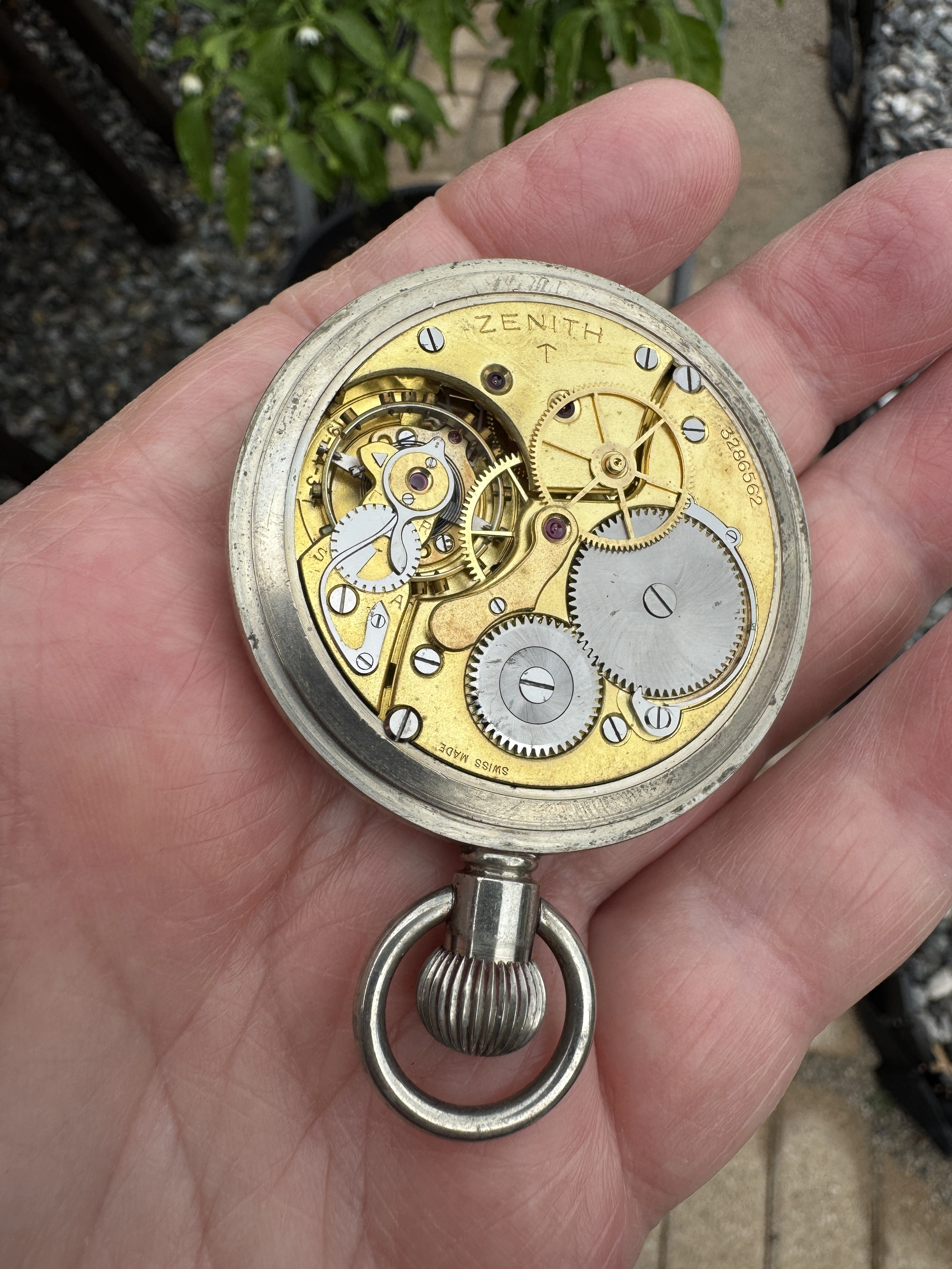

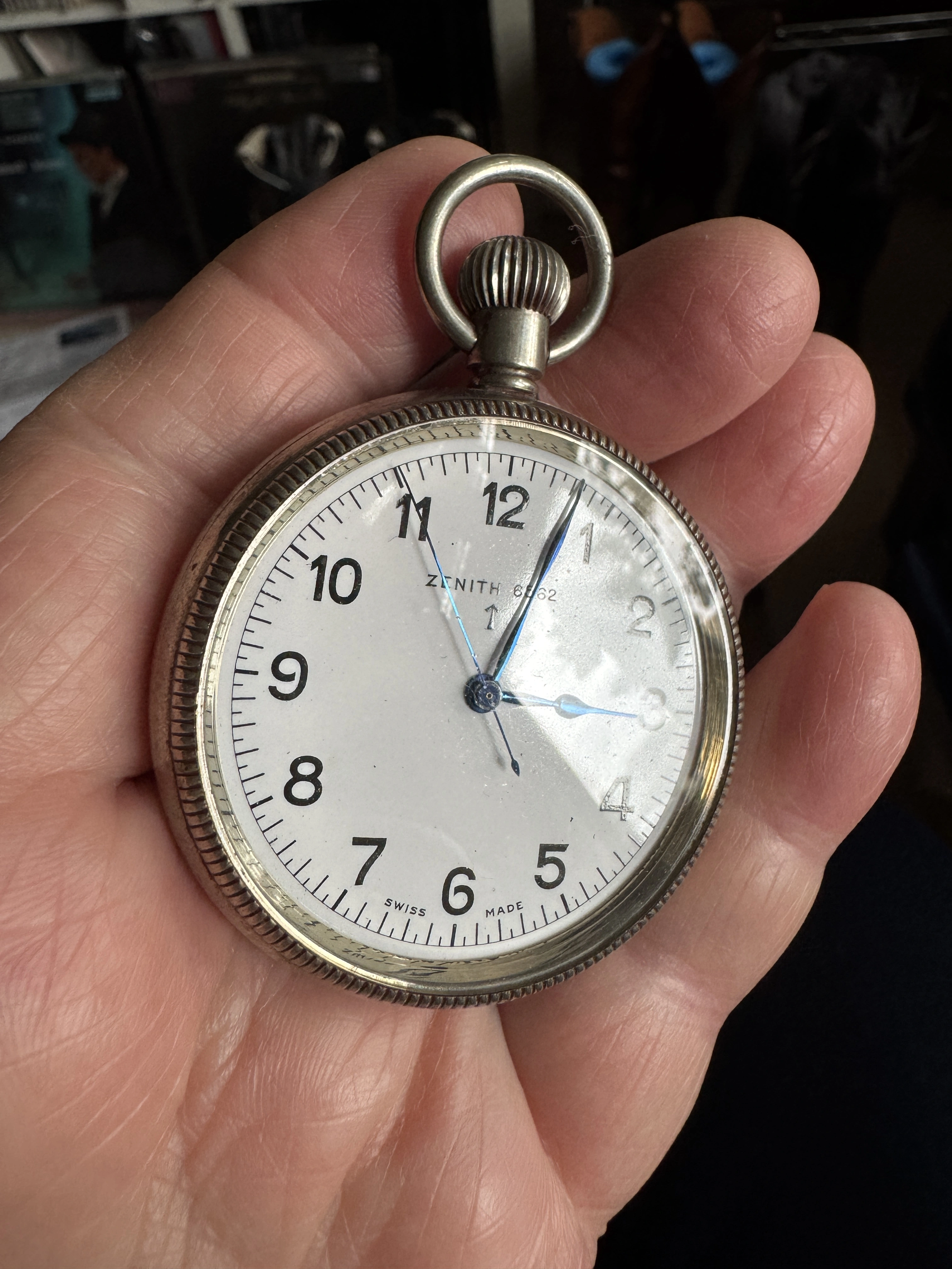

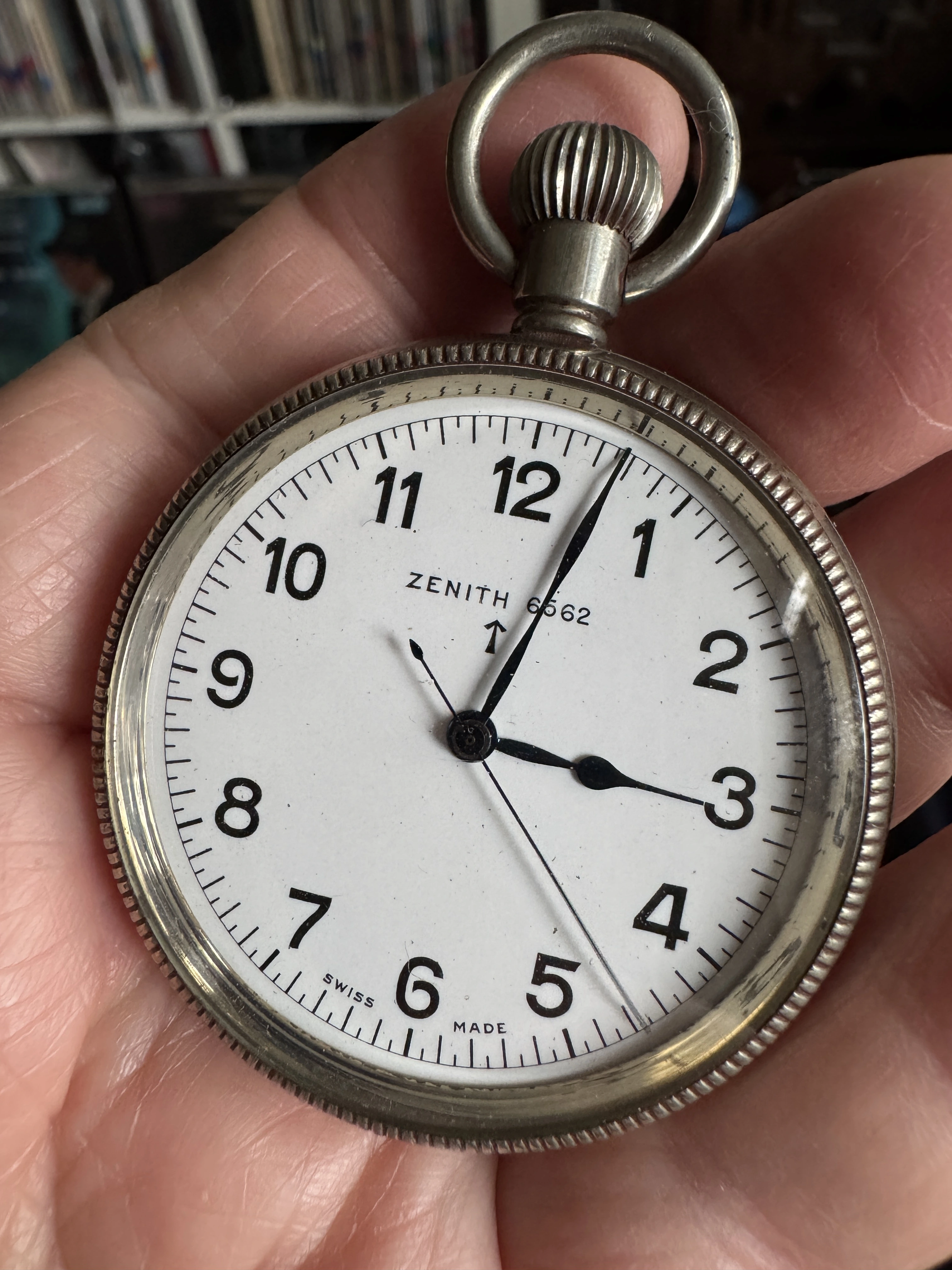

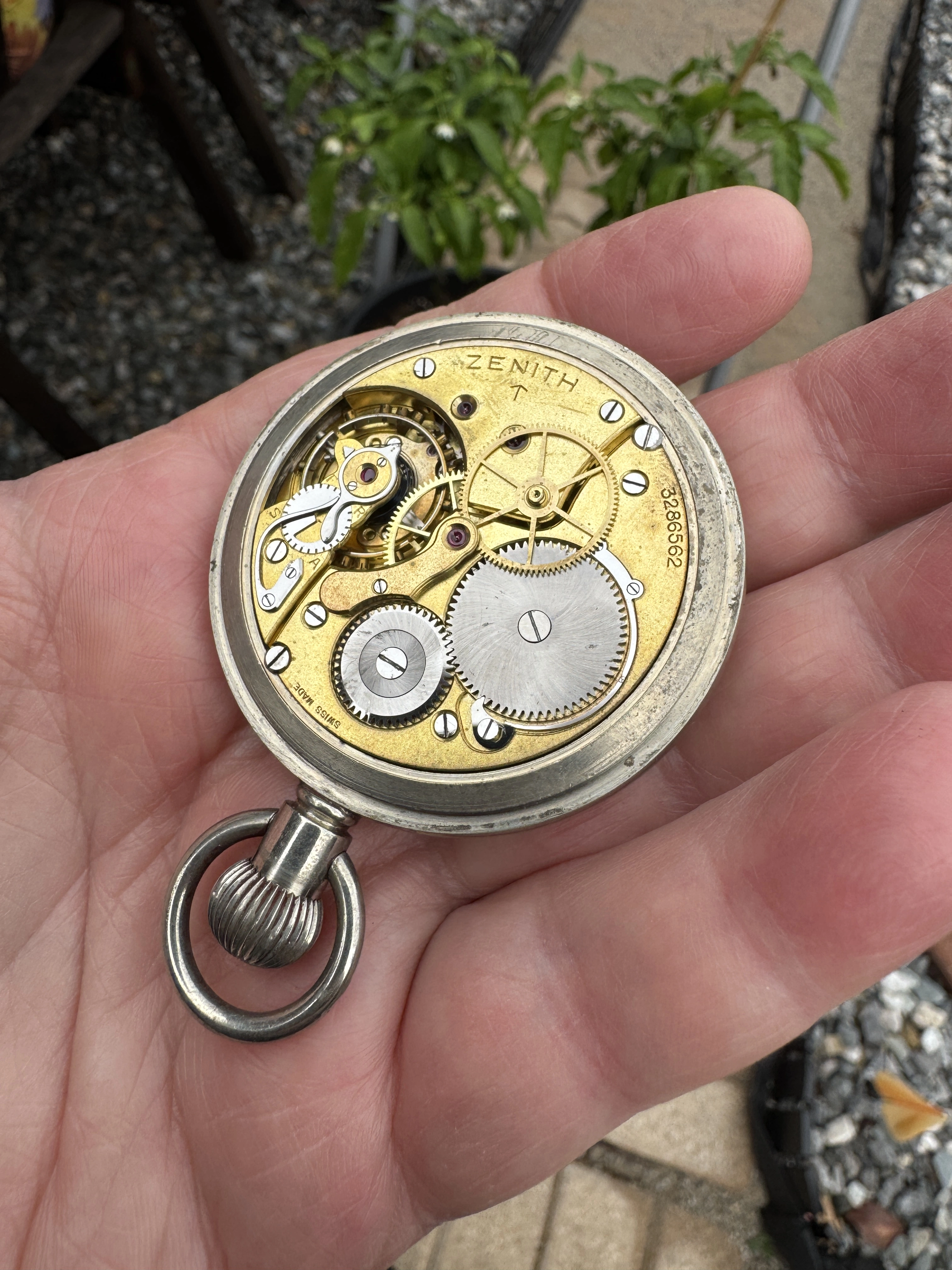

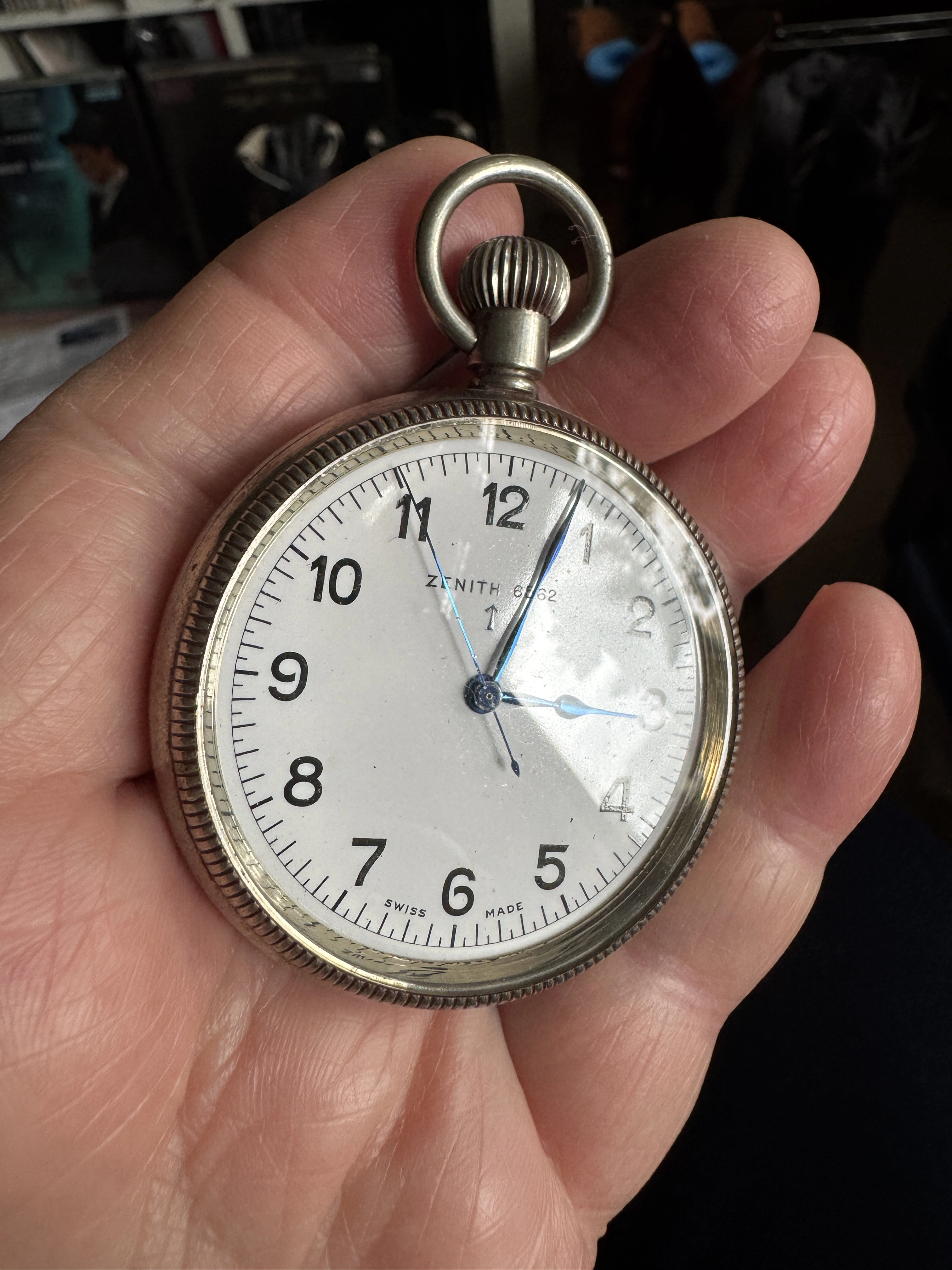

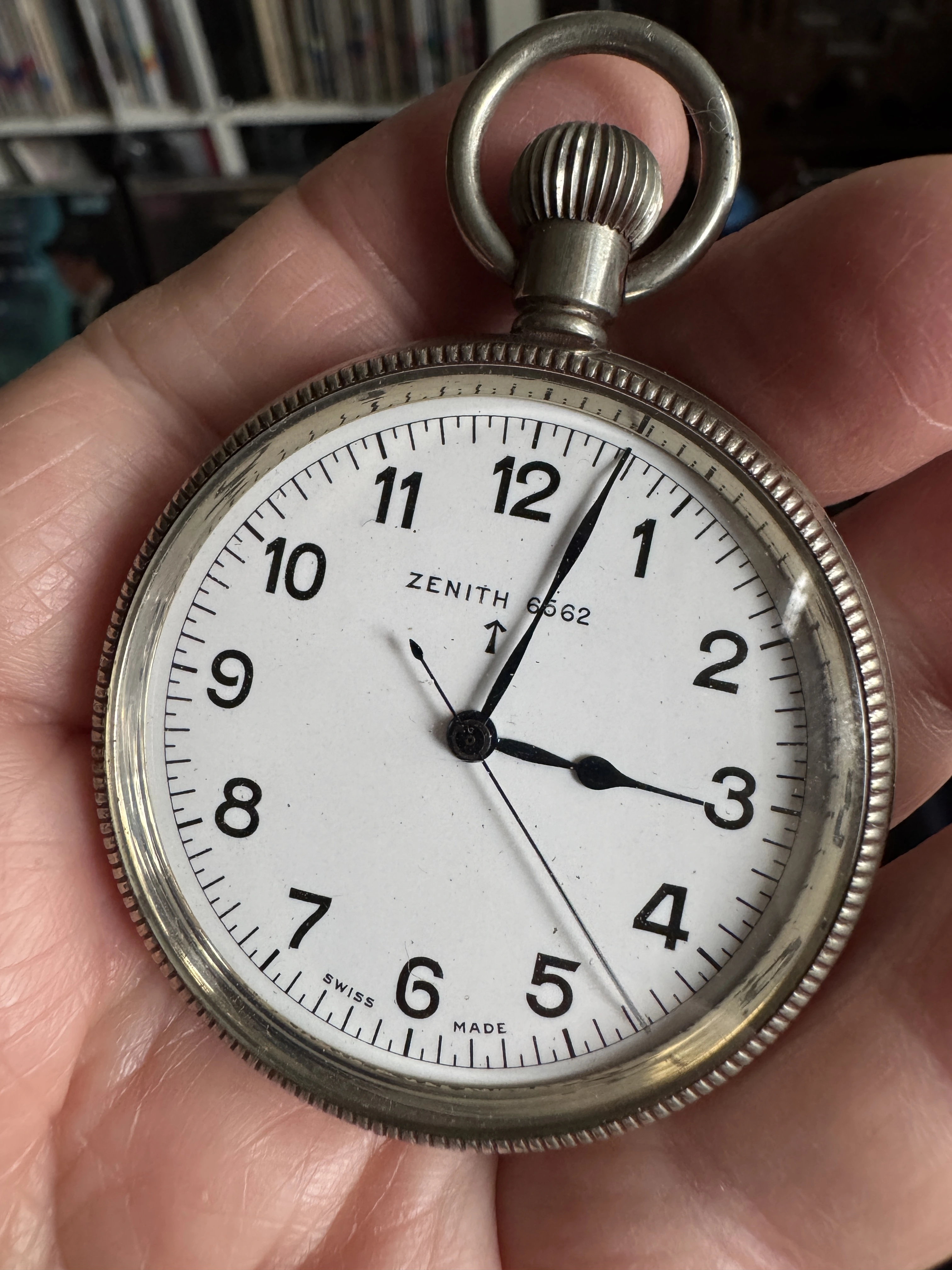

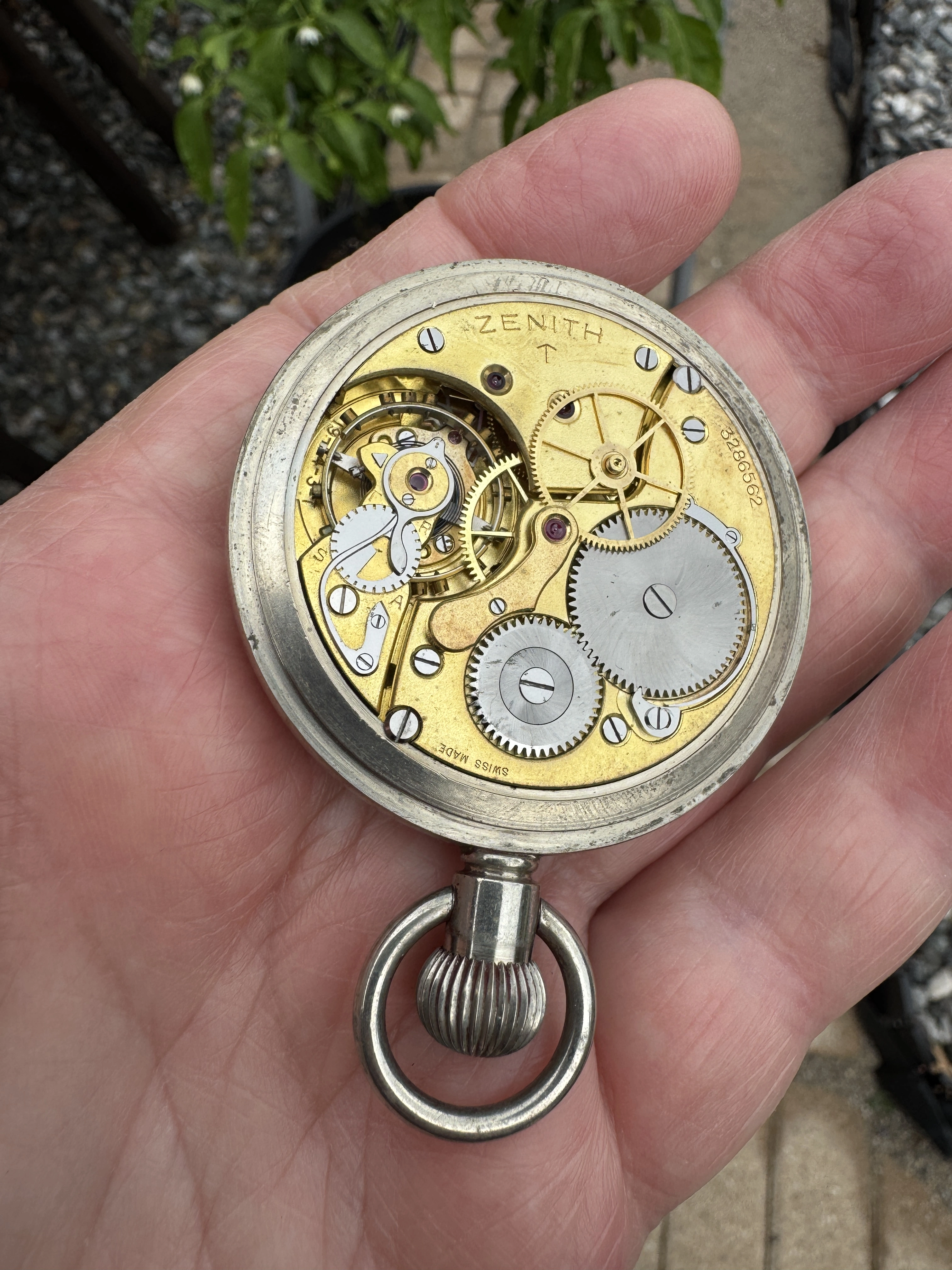

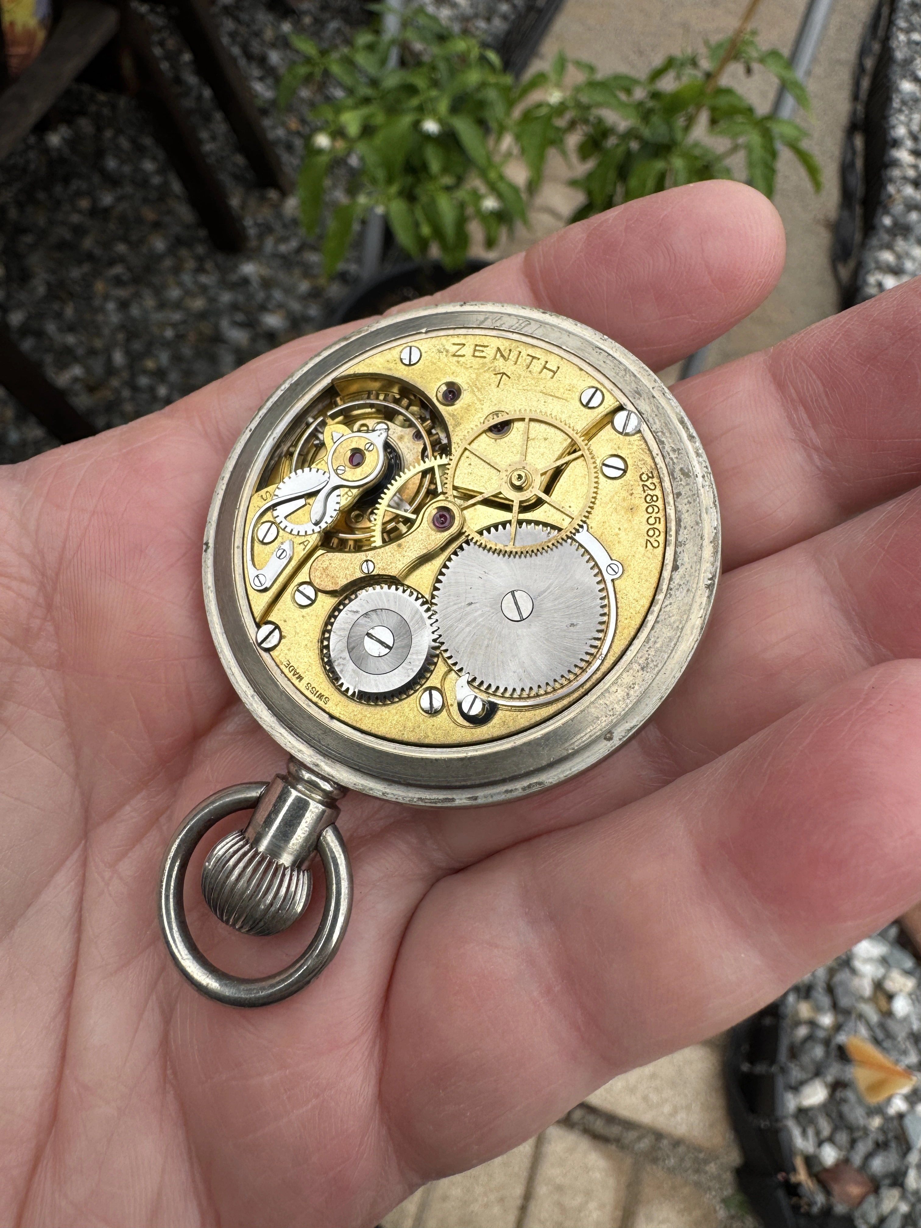

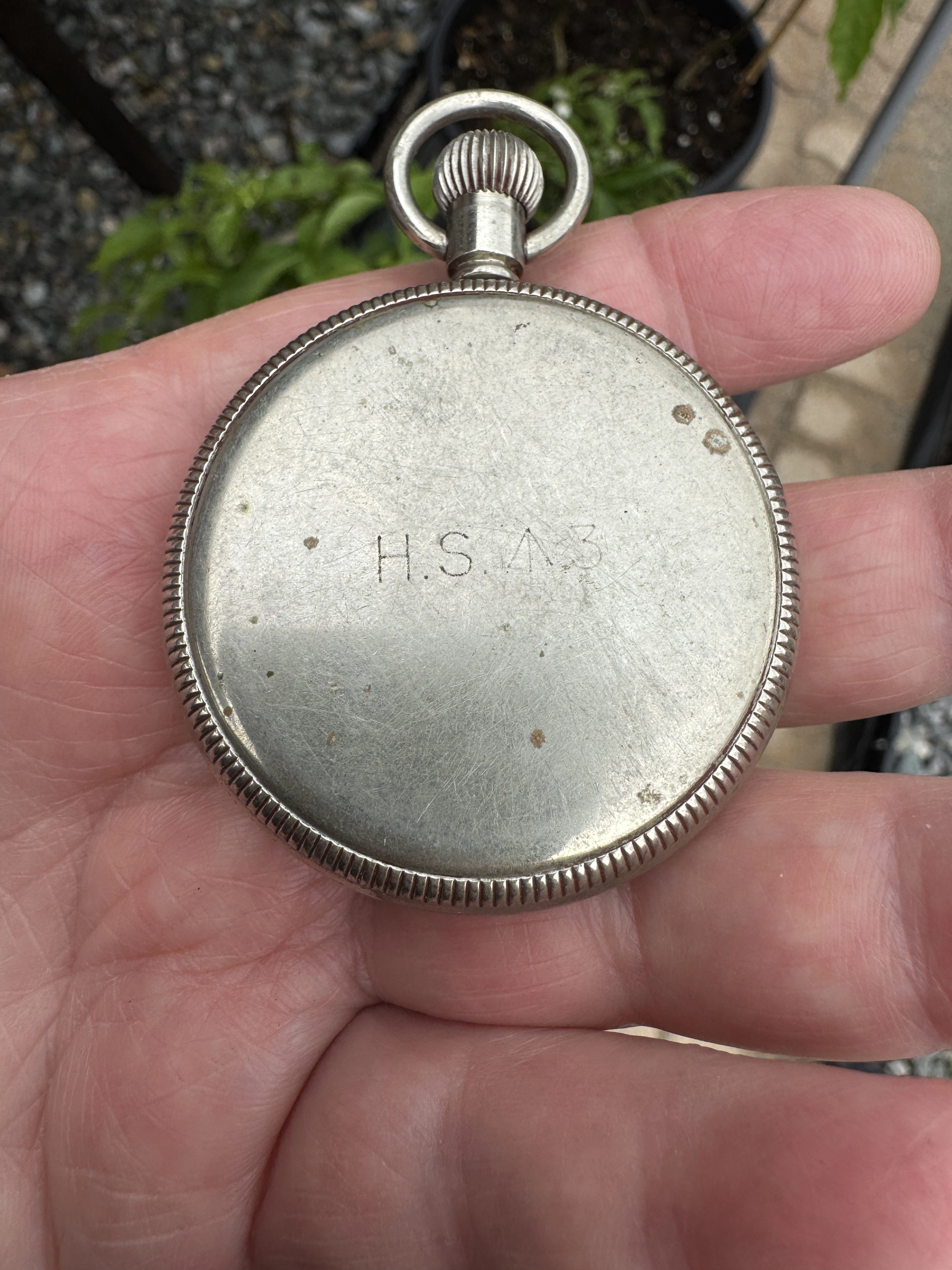

Zenith WWII circa 1940, issued by the British to their Hydrographic Service which supported the Royal Navy amongst other branches.
Nifty set of blued hands.
15,981
48,047

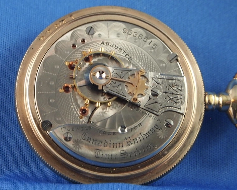

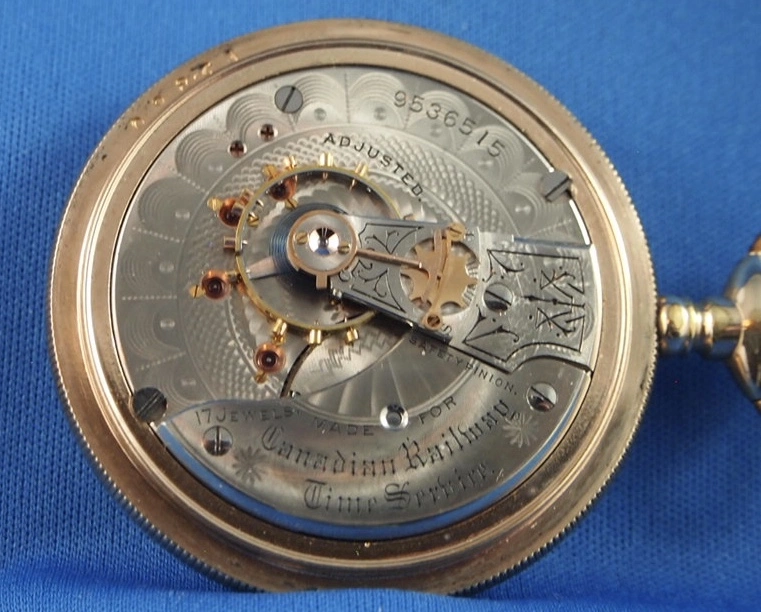

That would match the Hamilton 3992B. The 16-size Zenith calibre 5 was approved for use on Canadian railroads. I am unaware if sweep seconds hands were ever approved for use on Canadian railroads. The Hamilton 3992B (like the subject Zenith) was primarily aimed at the navy. The only Swiss made pocket watch approved for use on U S railroads was the Ball grade 435 (B & C).

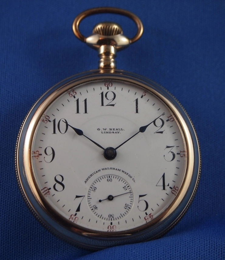

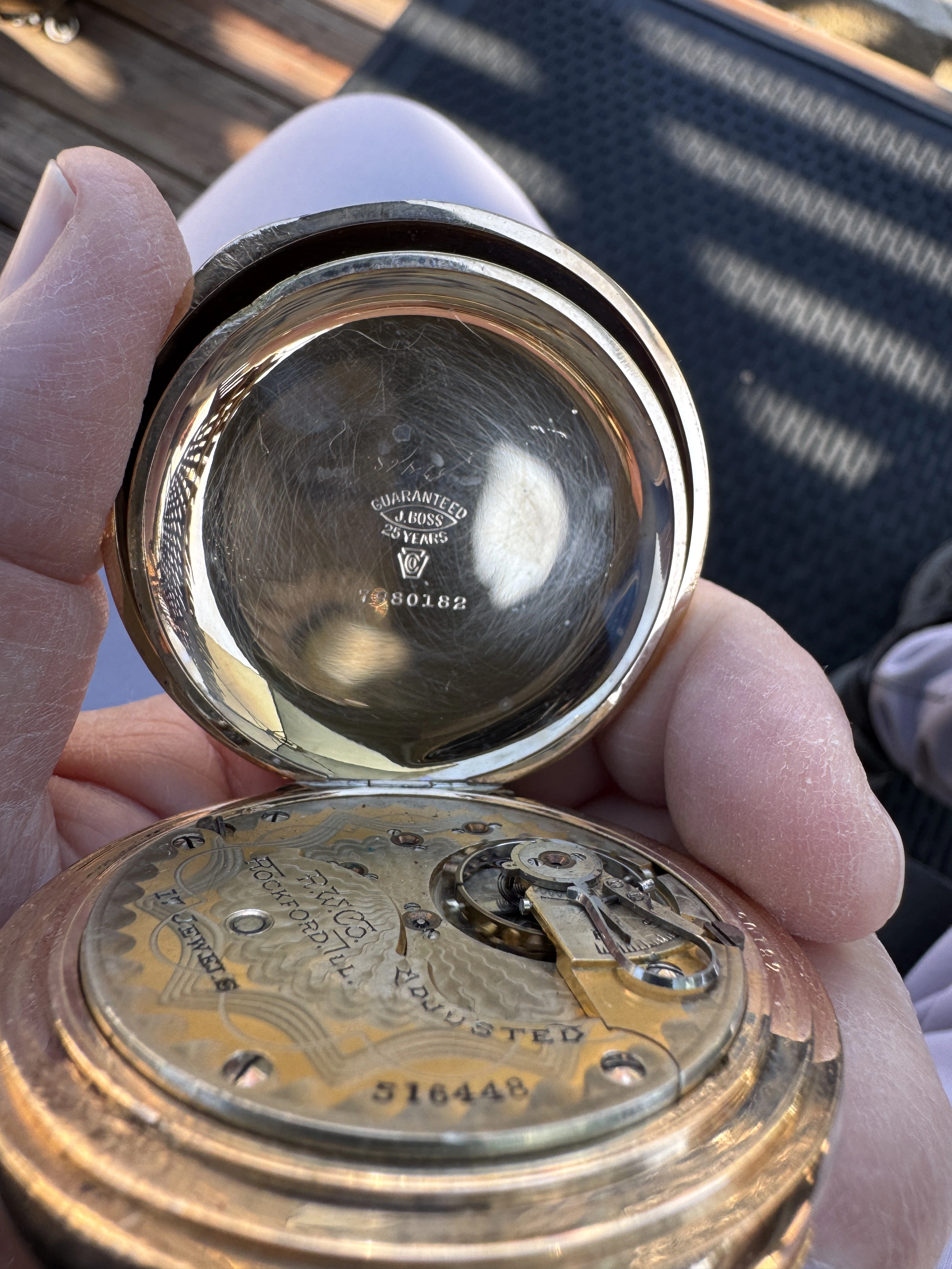

It might have been Ball who stipulated that railroad standards specified that railroad standard watches with “private label” dials were disallowed. The name on the dial was to be the actual manufacturer. Hinged bezels and case backs were likewise, disallowed. Yet a Swiss made movement behind a Ball ORRS dial were allowed. That, plus I have a railroad approved Hamilton grade 952 in its original case, with hinged bezel and back! Not every railroad observed Ball’s standards to the letter.

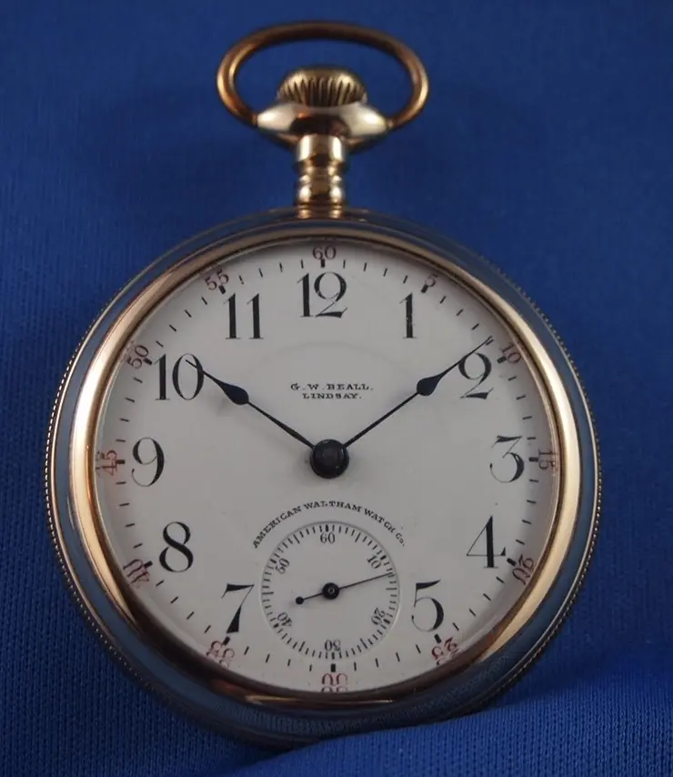

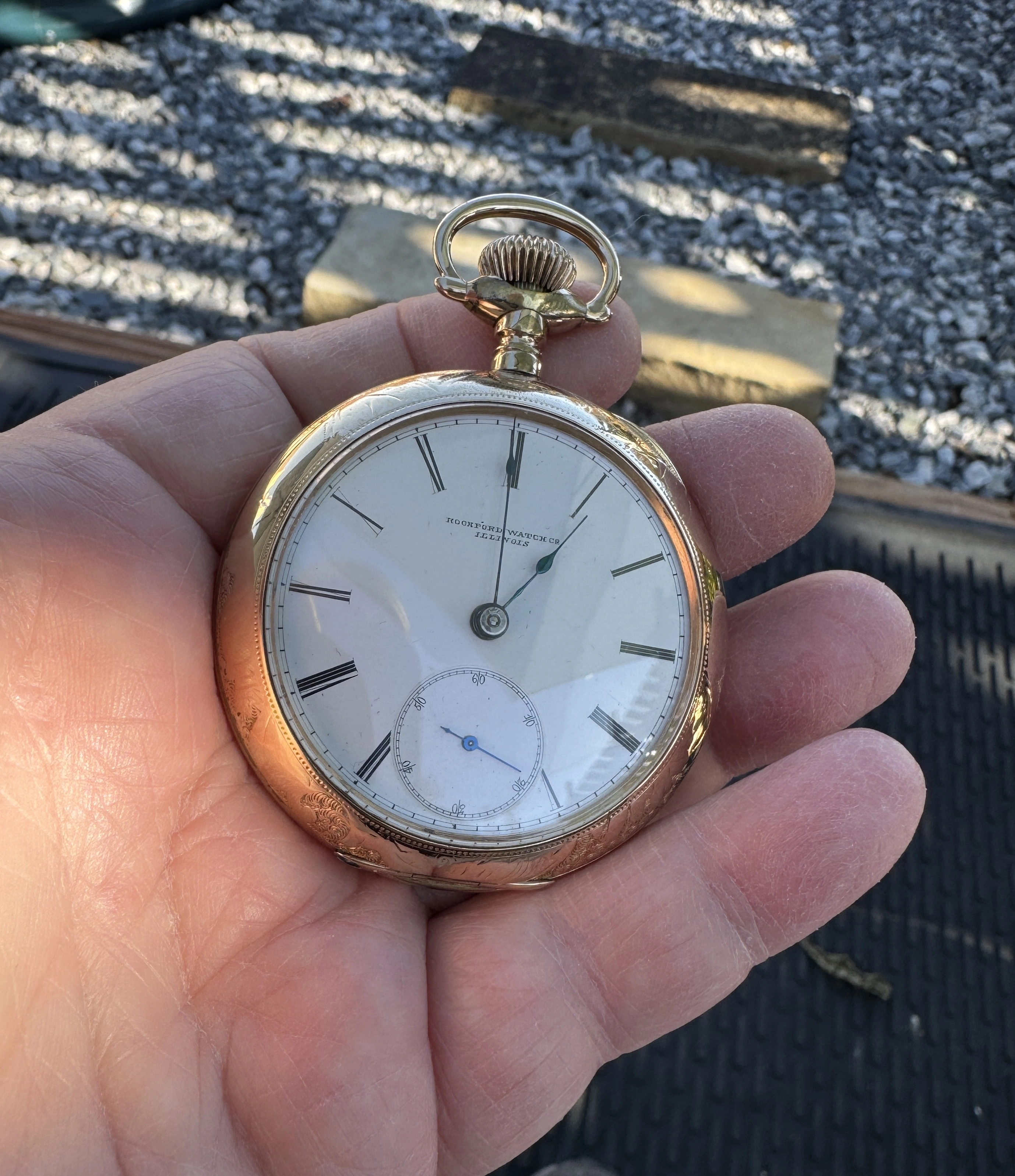

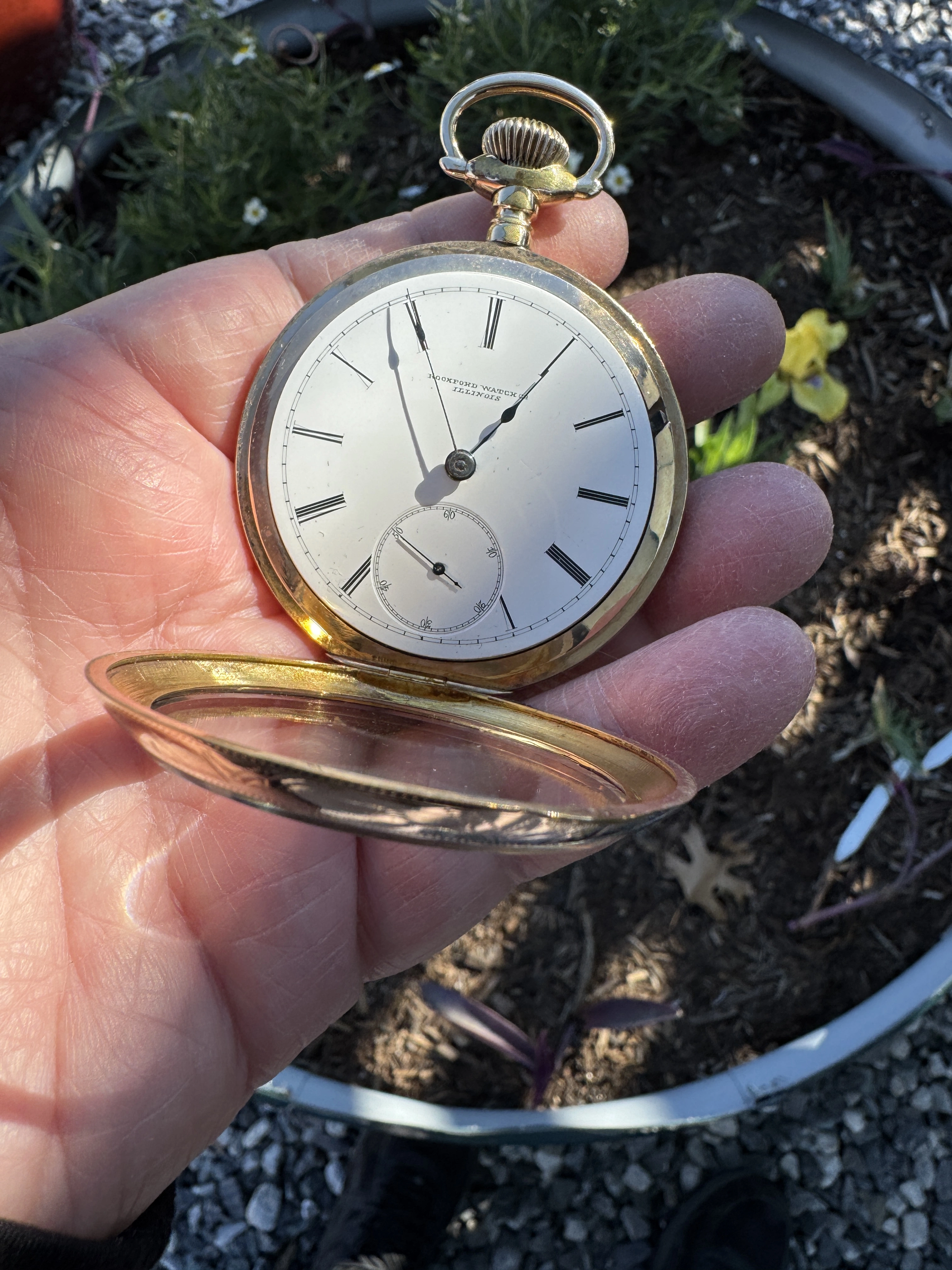

There was a way around private label dials on railroad standard watches. I show a picture of my 1883 Waltham GW Beall pocket watch. Notice the American Waltham Watch Co. marking around the seconds bit.

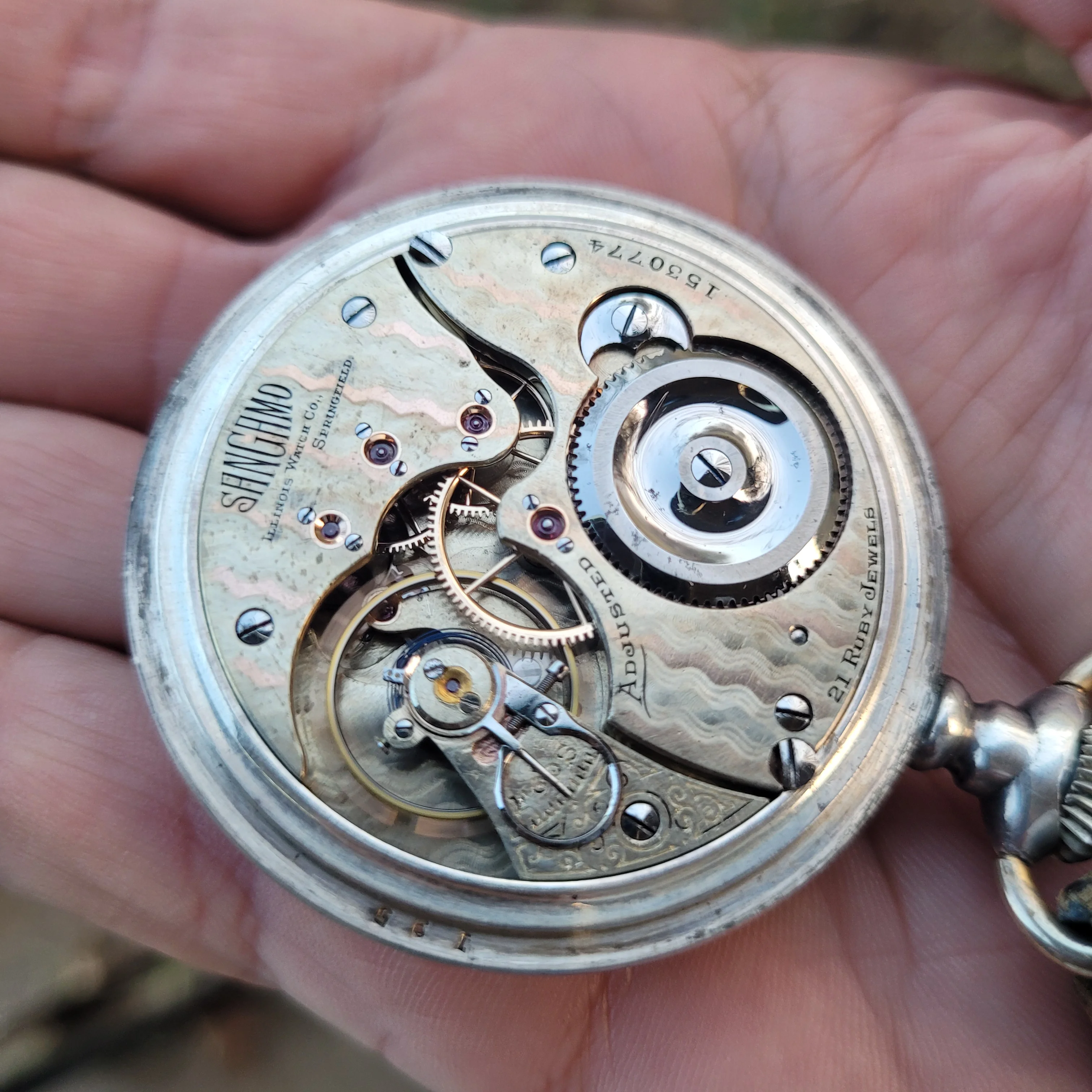

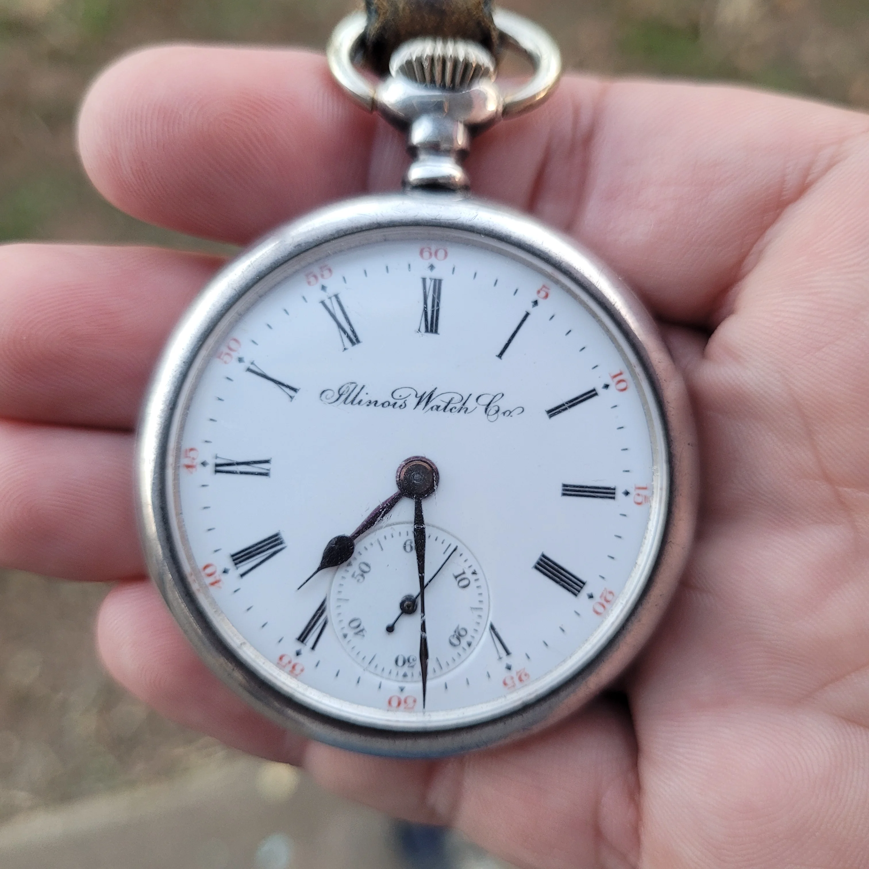

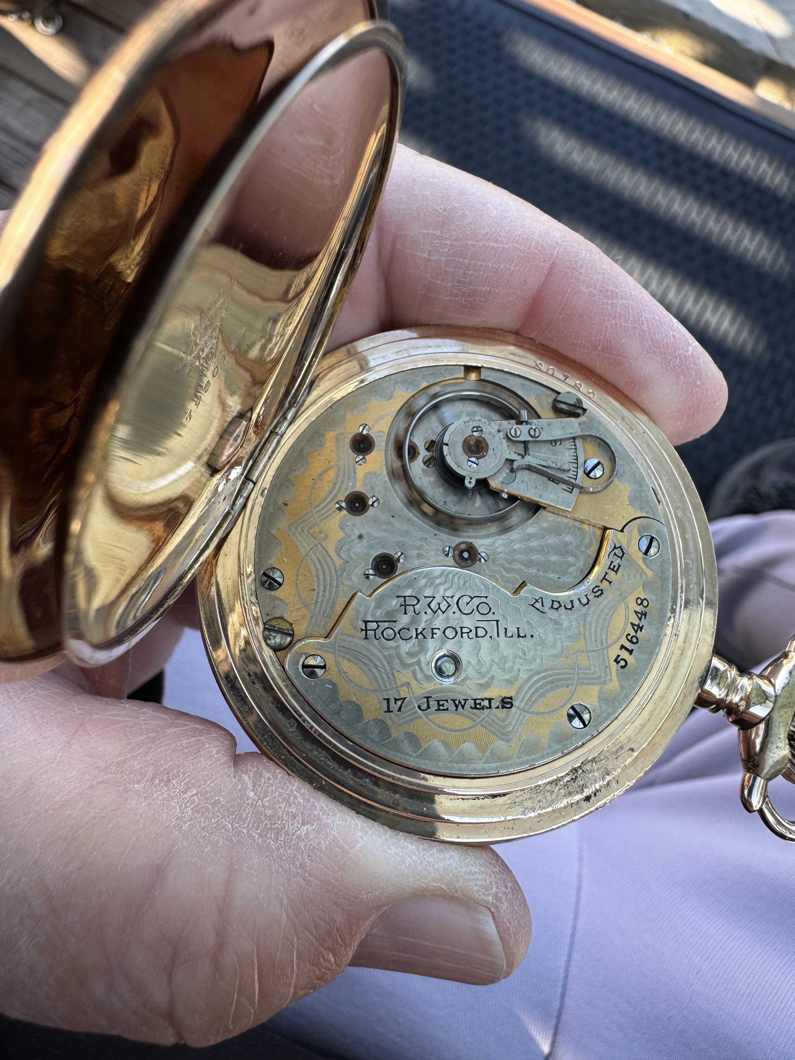

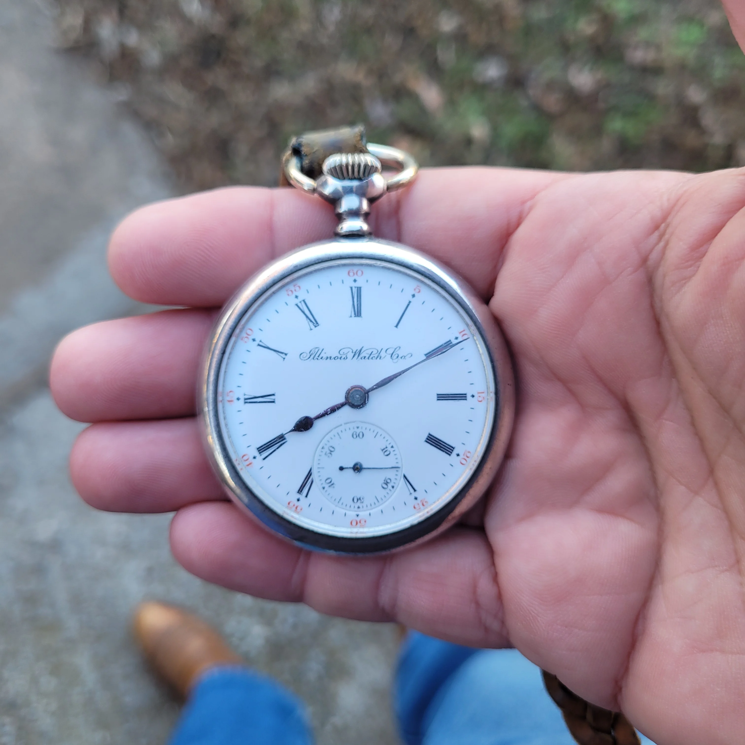

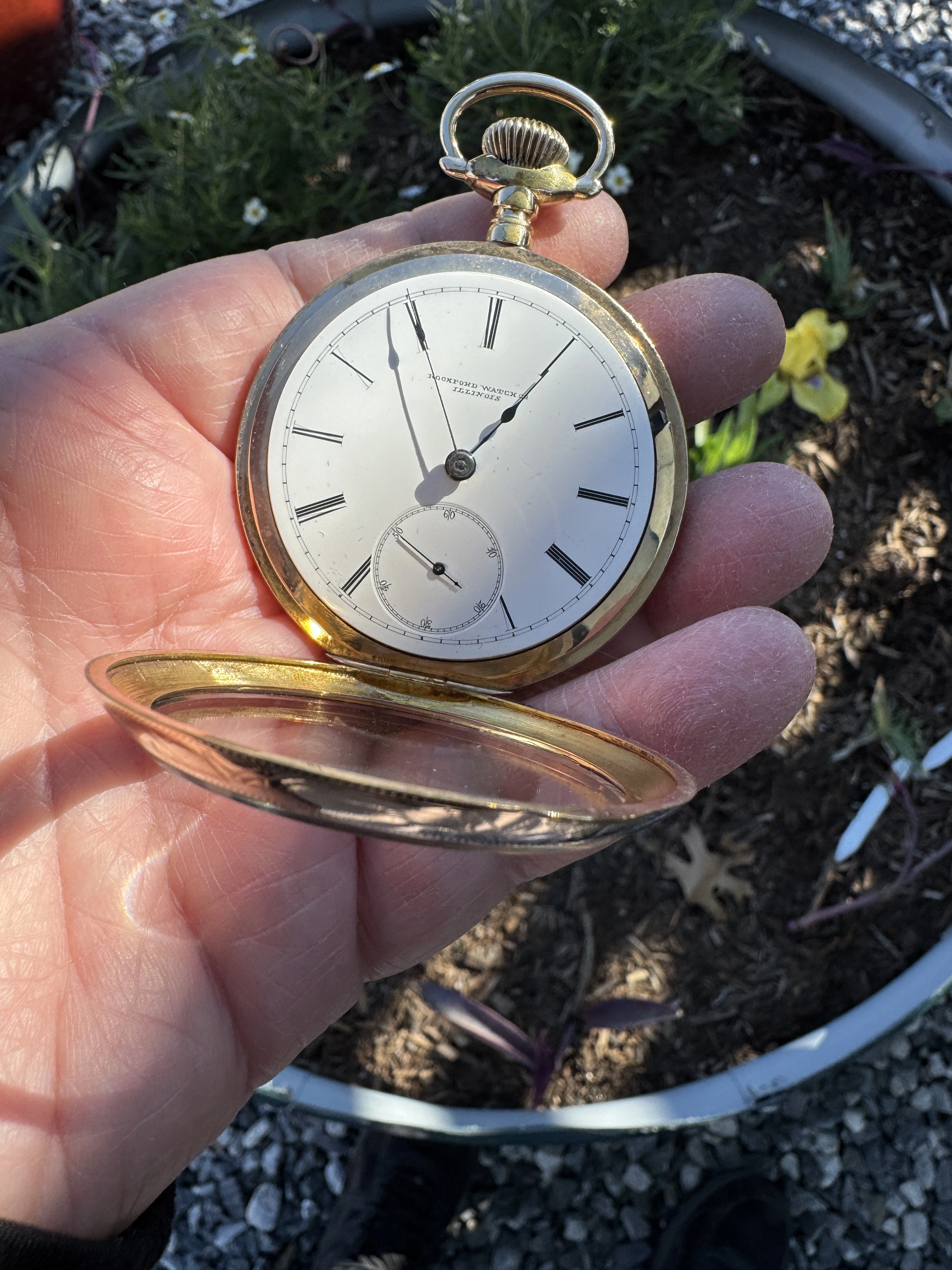

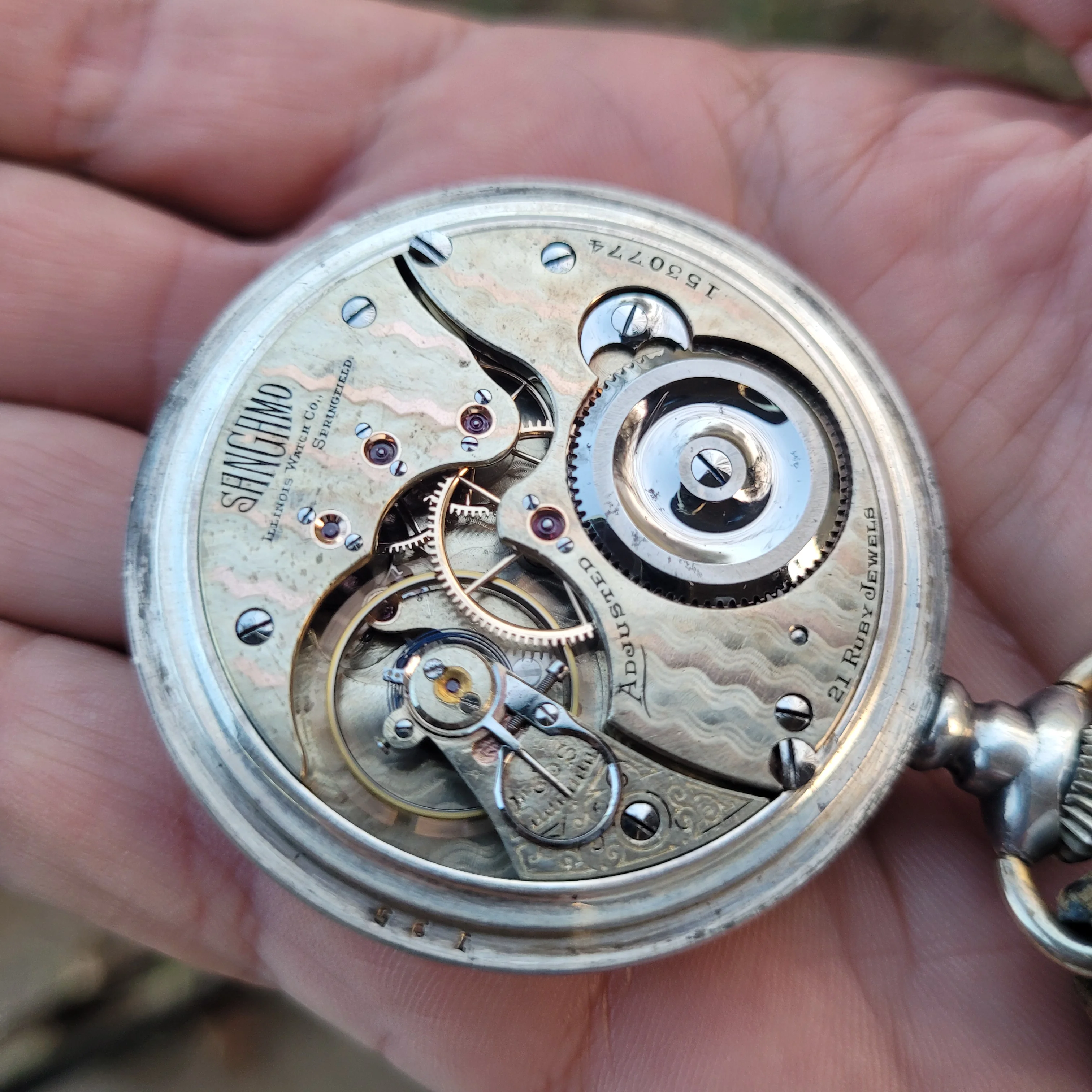

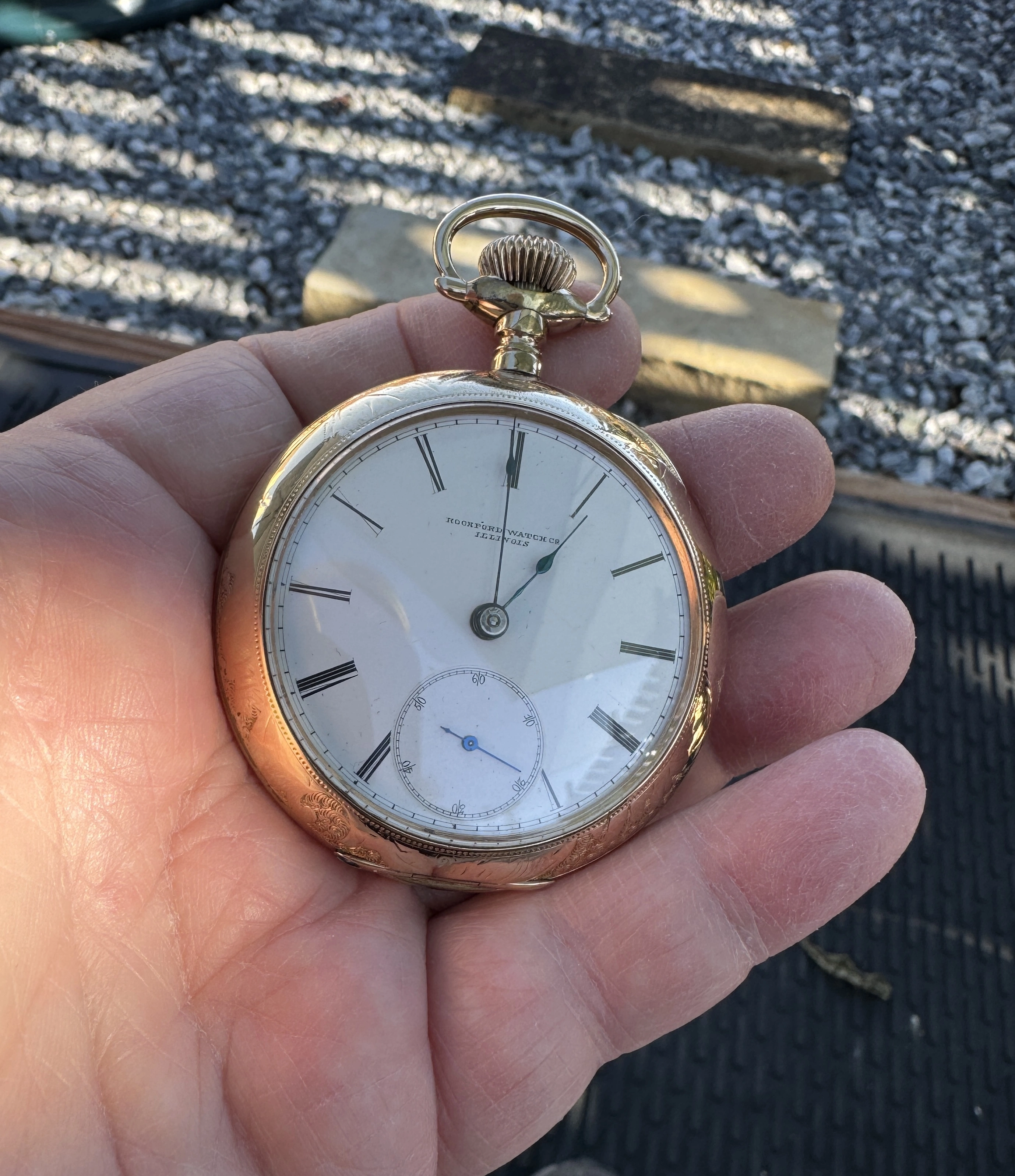

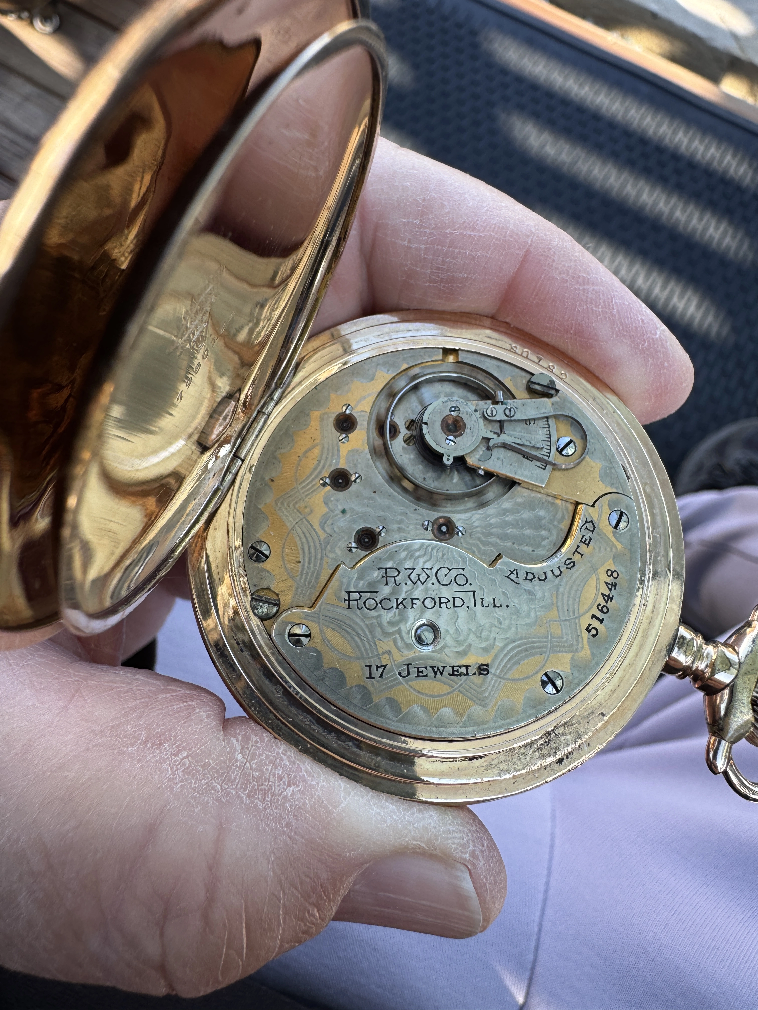

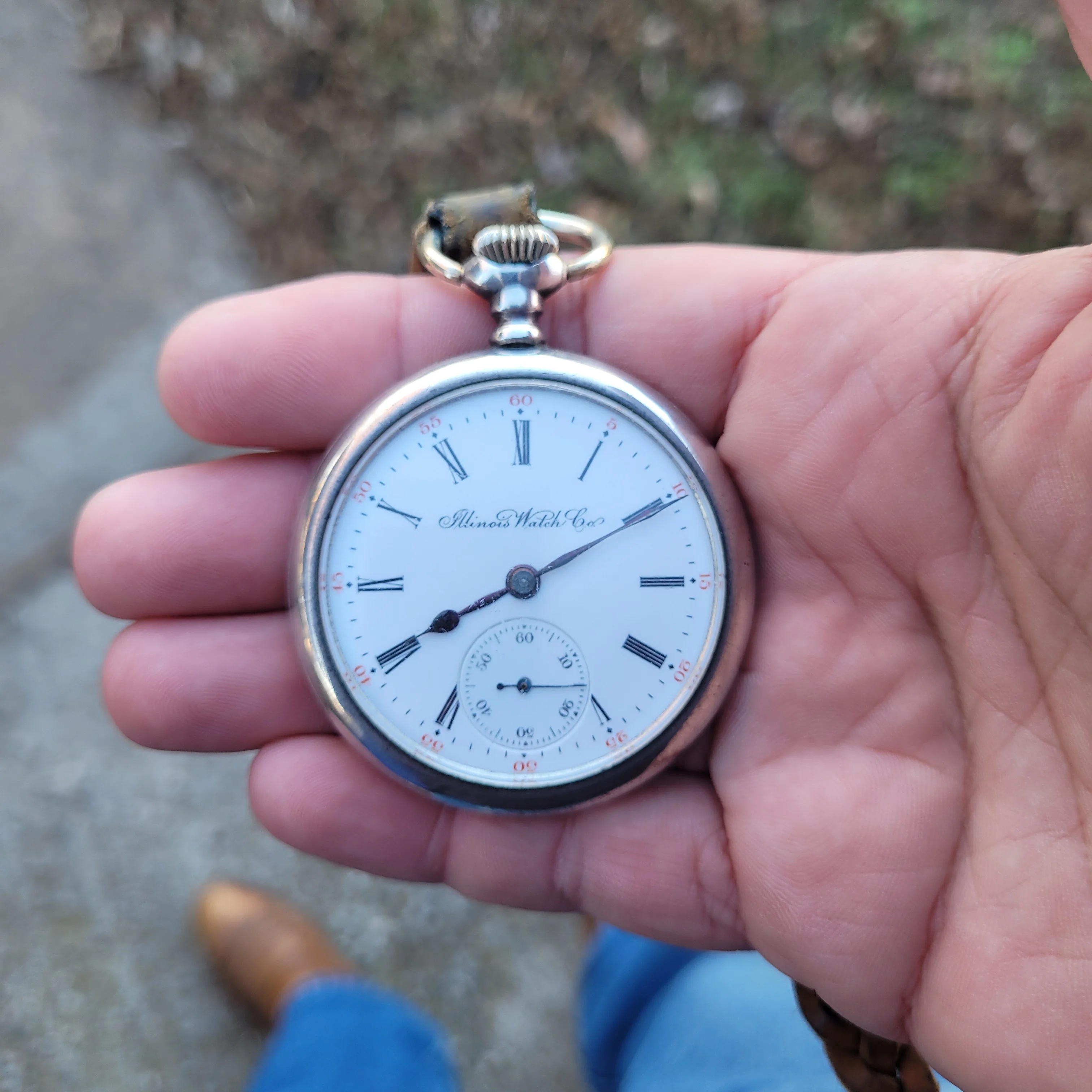

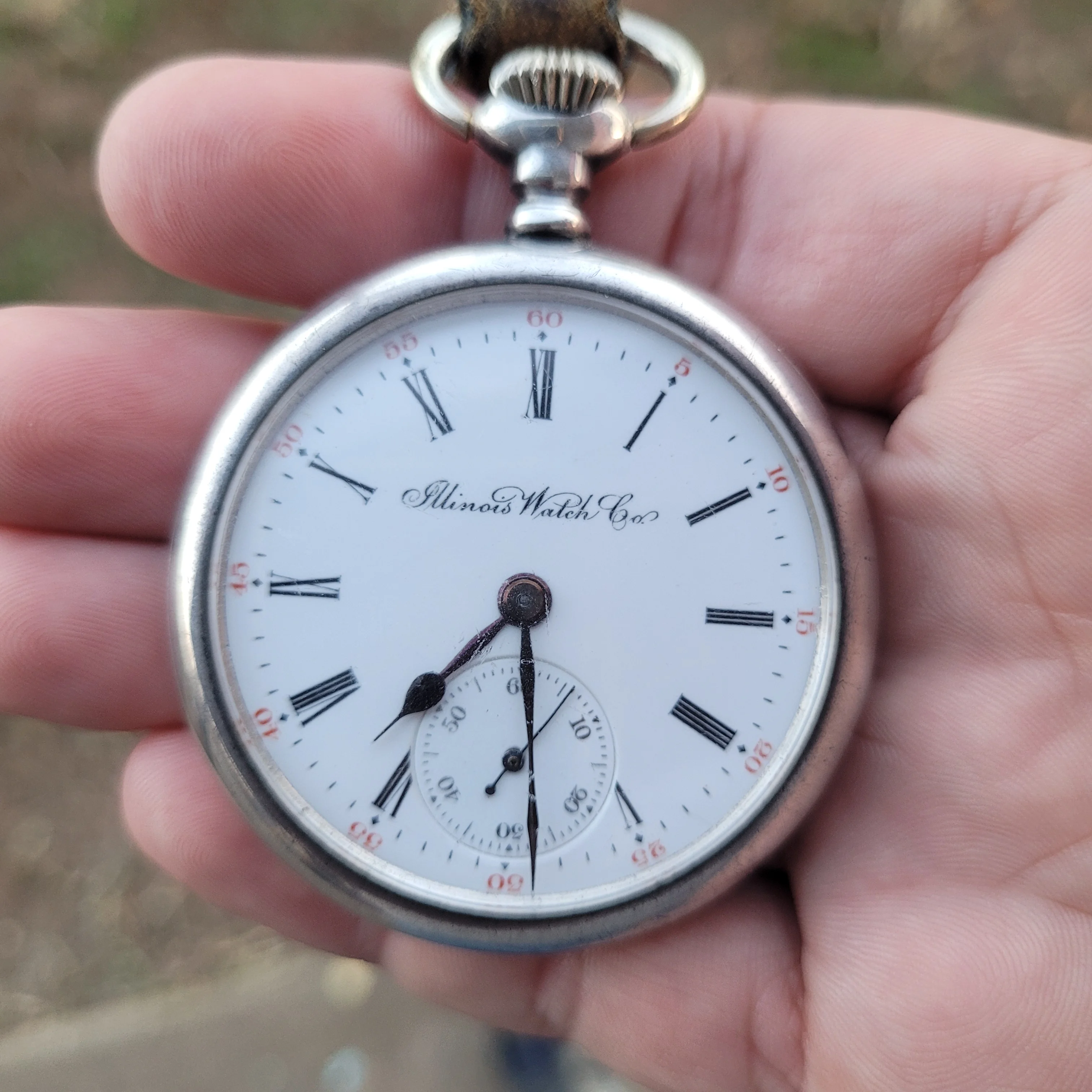

I'm wearing this circa 1900 Illinois Sangamo in a sterling case today. My favorite thing about this one is the two tone ribbon dameskeening.
5,375
54,937
I'm still wearing this Sangamo. After five days in my pocket it's lost 14 seconds.
You must have a hole in your pocket for all those seconds to be slipping away! 😀
4,375
12,981
I mean that is a lot, almost -3 sec/day. I should have saved up and bought a Rolex.
