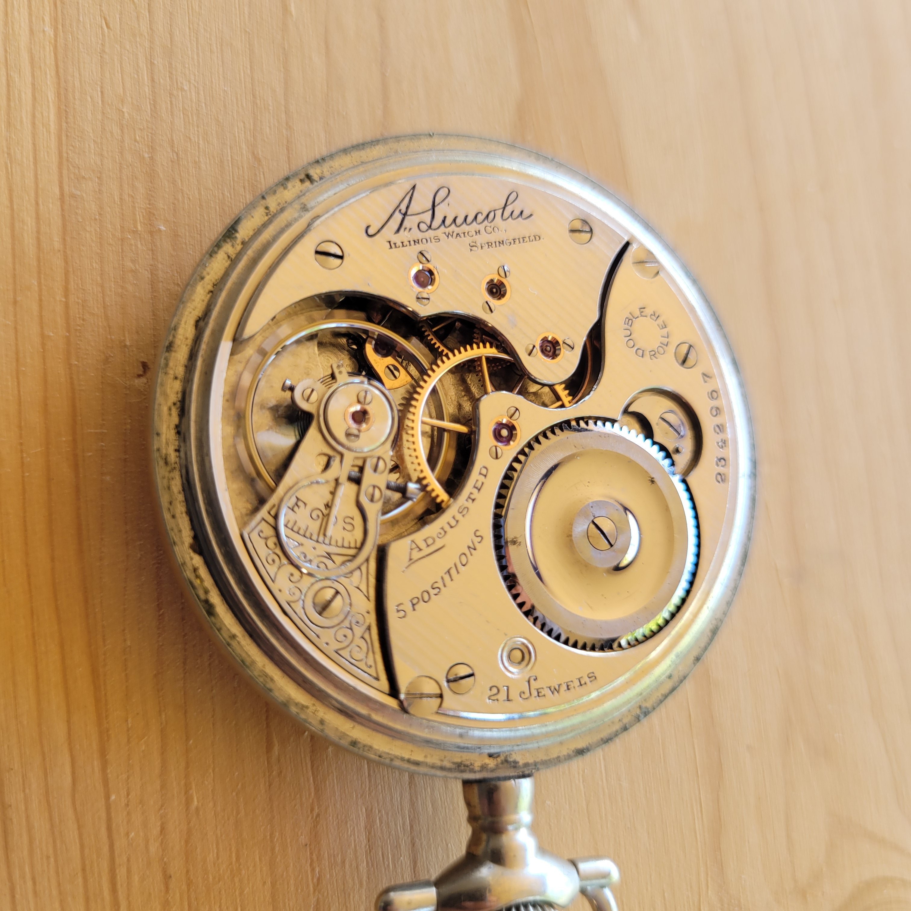

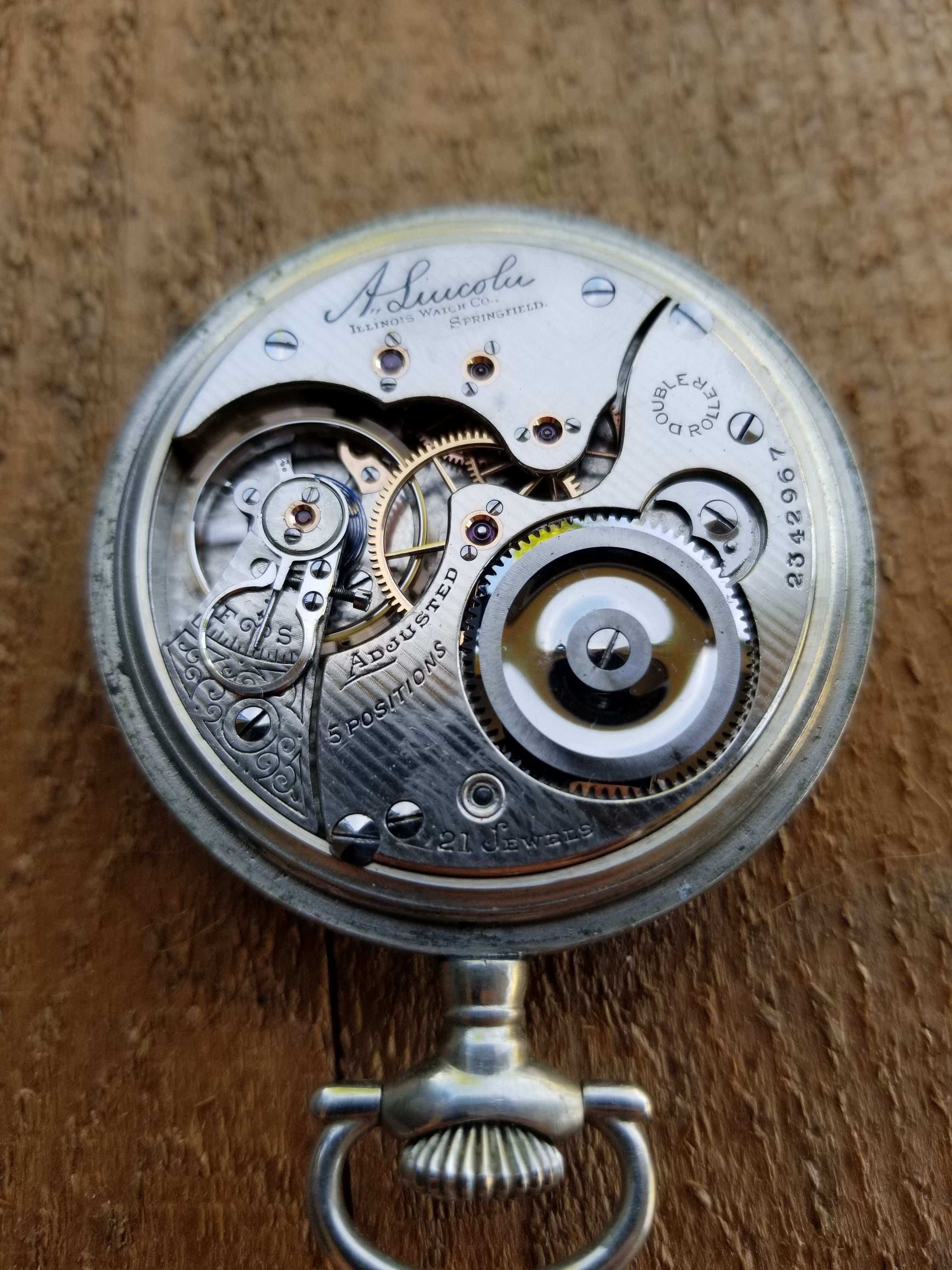

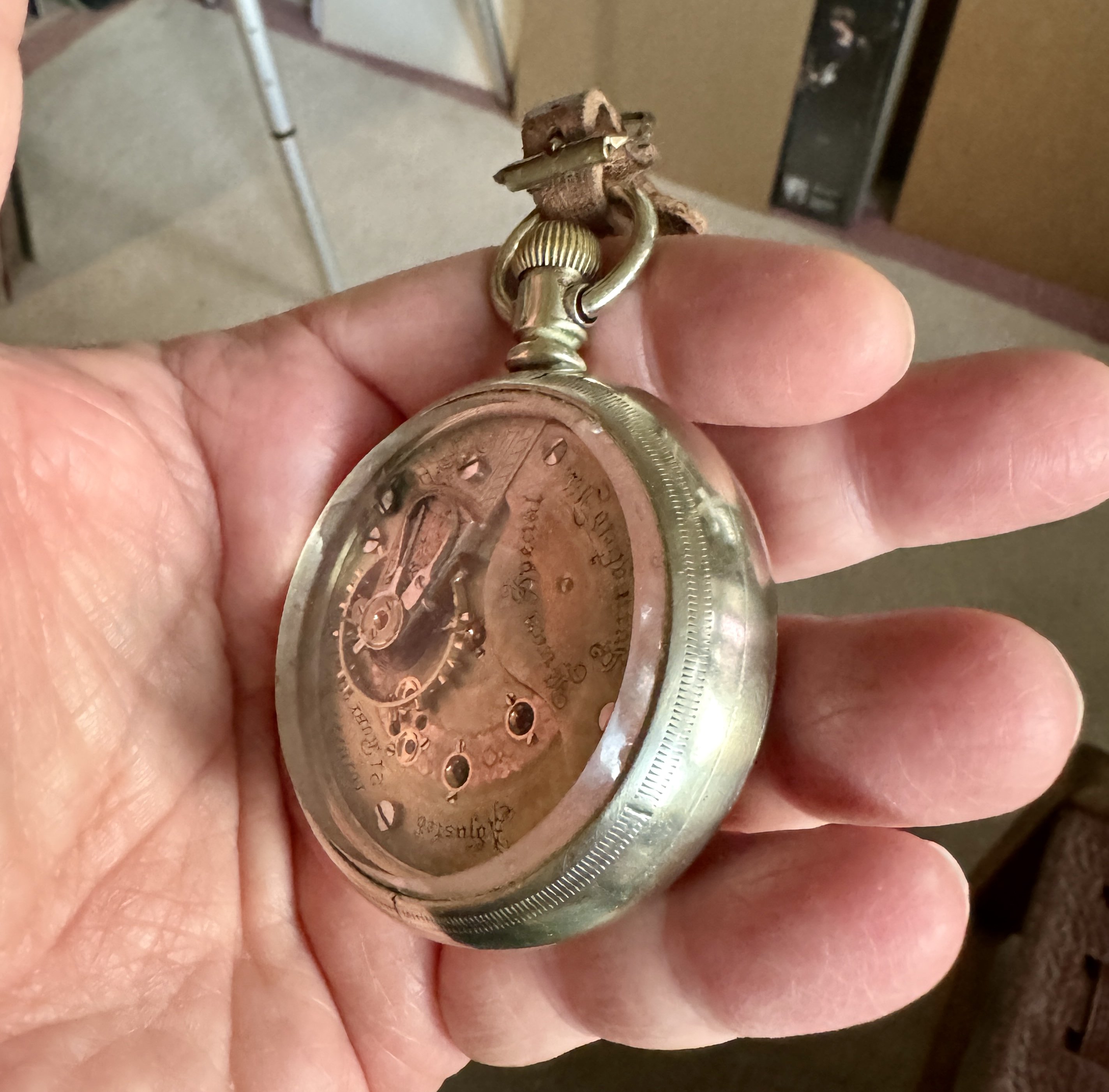

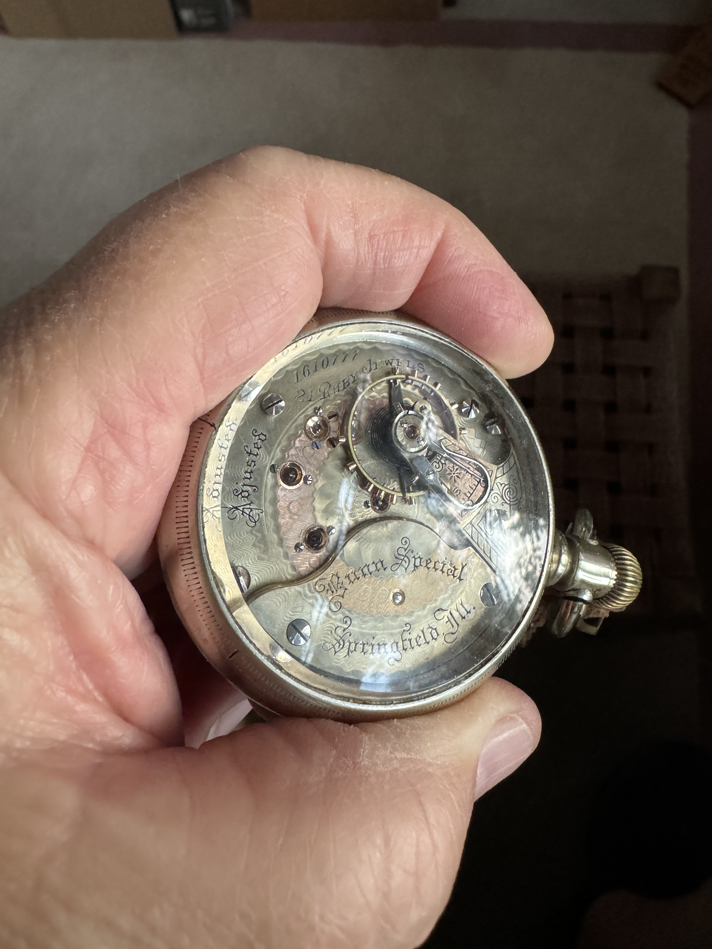

I saw that description in the NAWCC, and if that is the only qualifier, then my Model 5, A. Lincoln is also a Getty. It does fall well outside of the mentioned serial number range, however.
Thanks for introducing me to a new rabbit hole to explore.
Here is what the “Blue Book” says about the s# group that yours belongs to:
“Many of the 19 and 21 jewel movements in this grade are private label marked and some of these have the three finger train bridge. Also some have different adjustment markings than shown in part one above and a few are gold in laid damasked nickel. Early movements may be marked safety pinion. Grade 175 appears to have been somewhat of a steppingstone between the low quality and the railroad quality 16 size grades.”
So! It would appear that the A Lincoln name is not an Illinois name, but a private label name.

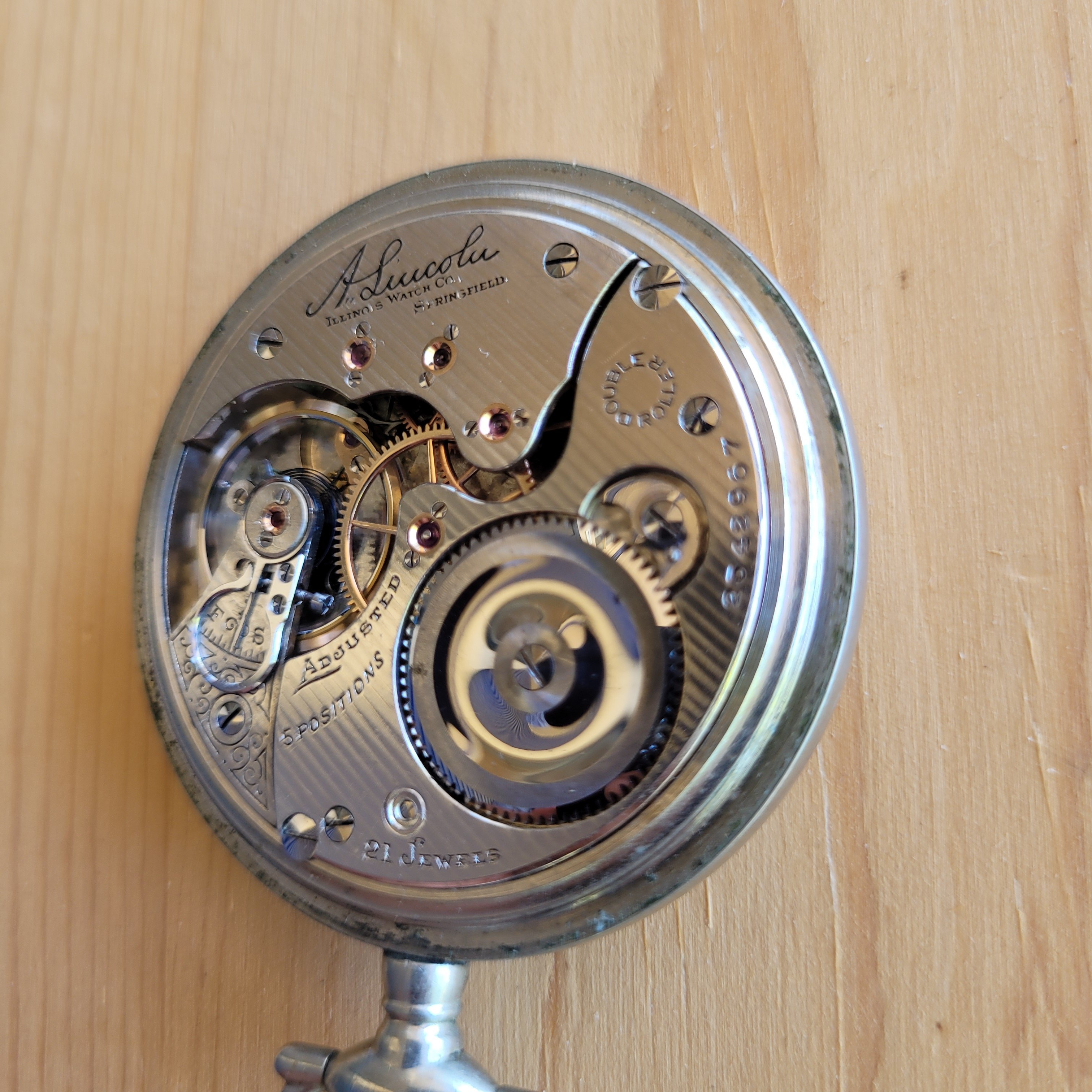

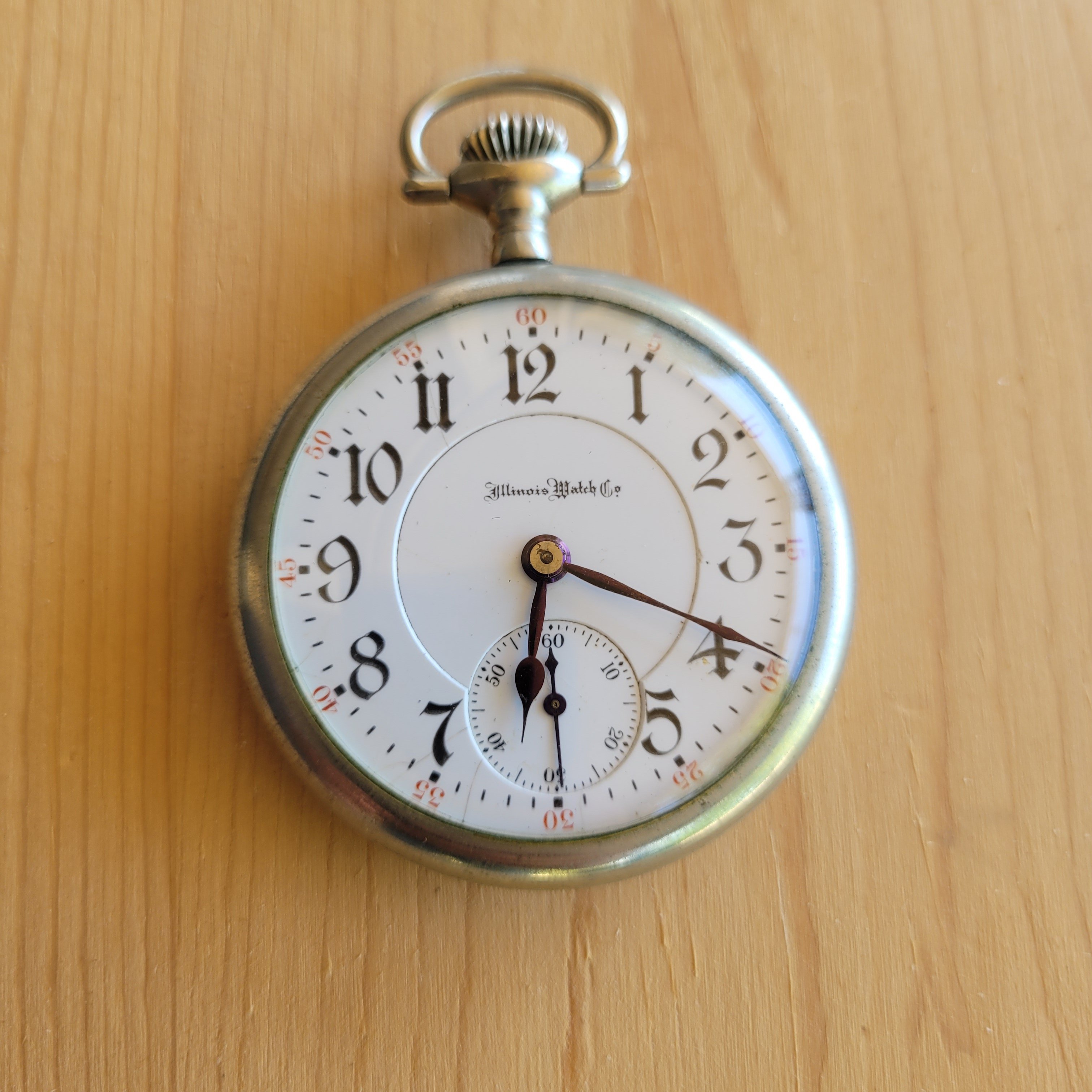

That is interesting, I've seen many A.Lincoln marked movements, all marked Illinois as well, and they have all had Illinois marked dials. So, I've always thought of A.Lincoln as being a grade. I wonder if it was anything like Santa Fe Specials, made for a specific retailer that wanted that Illinois Watch Co. connection.

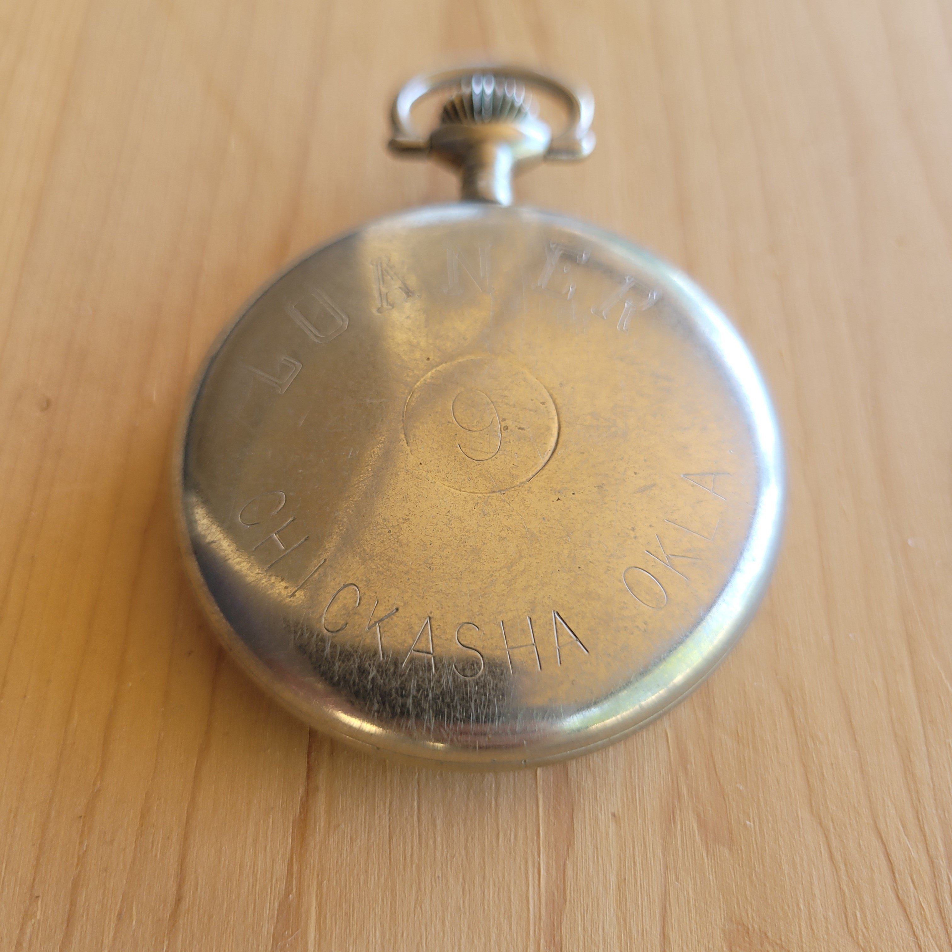

My Model 5, A. Lincoln, made in 1911, is the only railroad watch in my collection that I can positively say was owned by a railroad. The back is marked "Loaner - 9 - Chickasha, Okla." I bought this watch because I did not yet own an A. Lincoln, but also because I used to teach history at Chickasha High. One thing I really like about this watch, and many other Illinois, is the plum color of the hand bluing.

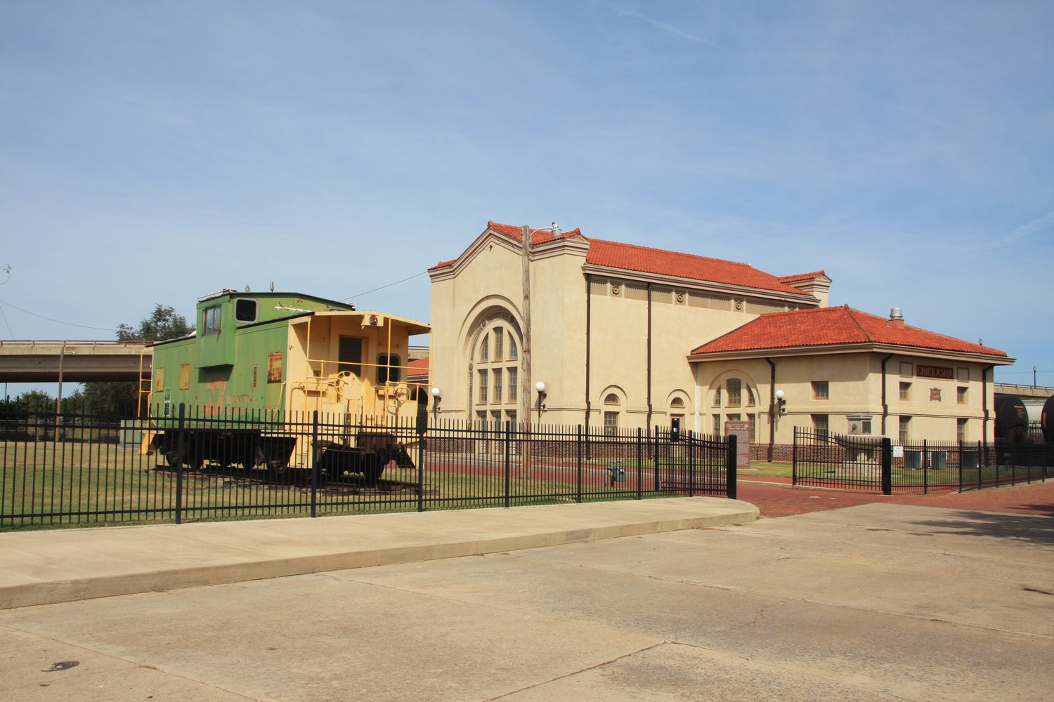

The Rock Island line built a spur to Chickasha in 1892, and by 1911 Chickasha had a beautiful depot, a four track yard, a locomotive repair shop, a roundhouse, and more than 300 Rock Island employees.

The “blue book” is the best reference that I know of for Illinois watches. The book is organized (for example only) numbered grades and named grades, by watch size (18, 16, 14, size, etc.) Under 16-size named grades, A. Lincoln grade does not appear, nor does the serial number range for @Waltesefalcon ’s A Lincoln, show up. That being the case, I went to the section on numbered grades, and found that s# range, there. Illinois called it a grade 175. In addition, the “blue book” described grade 175 as I quoted, in my recent post. It indicated that there were numerous private label Illinois watches in that serial number range. One must conclude that the A Lincoln designation was not an Illinois designation, but a private label.
I think Illinois did more private label watches than the other U S based watch manufacturers.
(I keep saying ad nauseum that pocket watches are MUCH more interesting than wrist watches!)
Both A Lincoln models owned by @Waltesefalcon are in the same s# range in the “blue book”. So the quote I included in my post re: the earlier s#, applies also to the later s#. Both grade 175, according to Illinois.

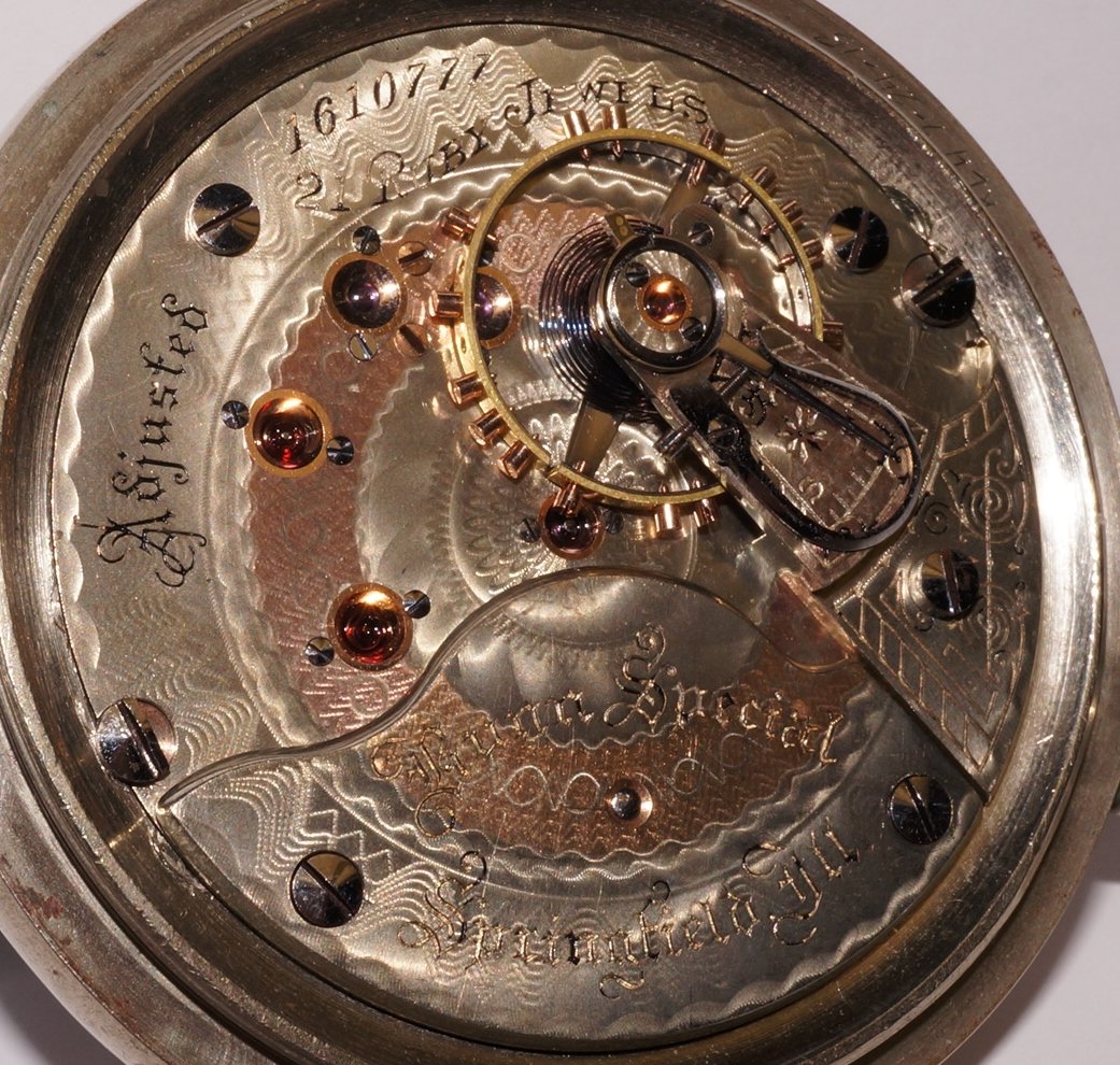

I only own the one A. Lincoln, my other Model 5 is a Sangamo Special.

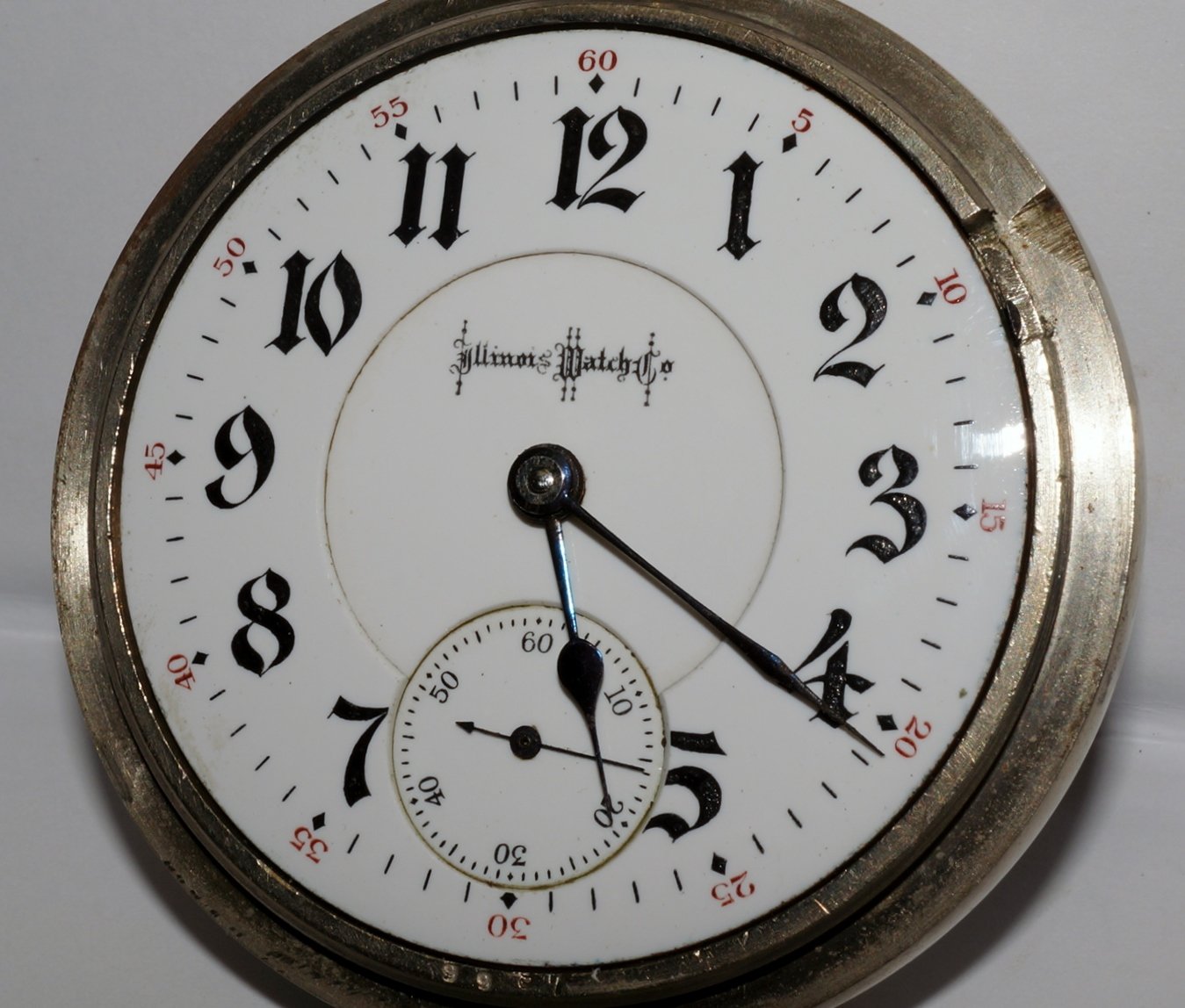

Love the Gothic print of this era of Illinois watches👍
This one is from 1902.......pink gold was added to the yellow inlaid circle only from 1900-1902, and I had to find a way to display the movement.

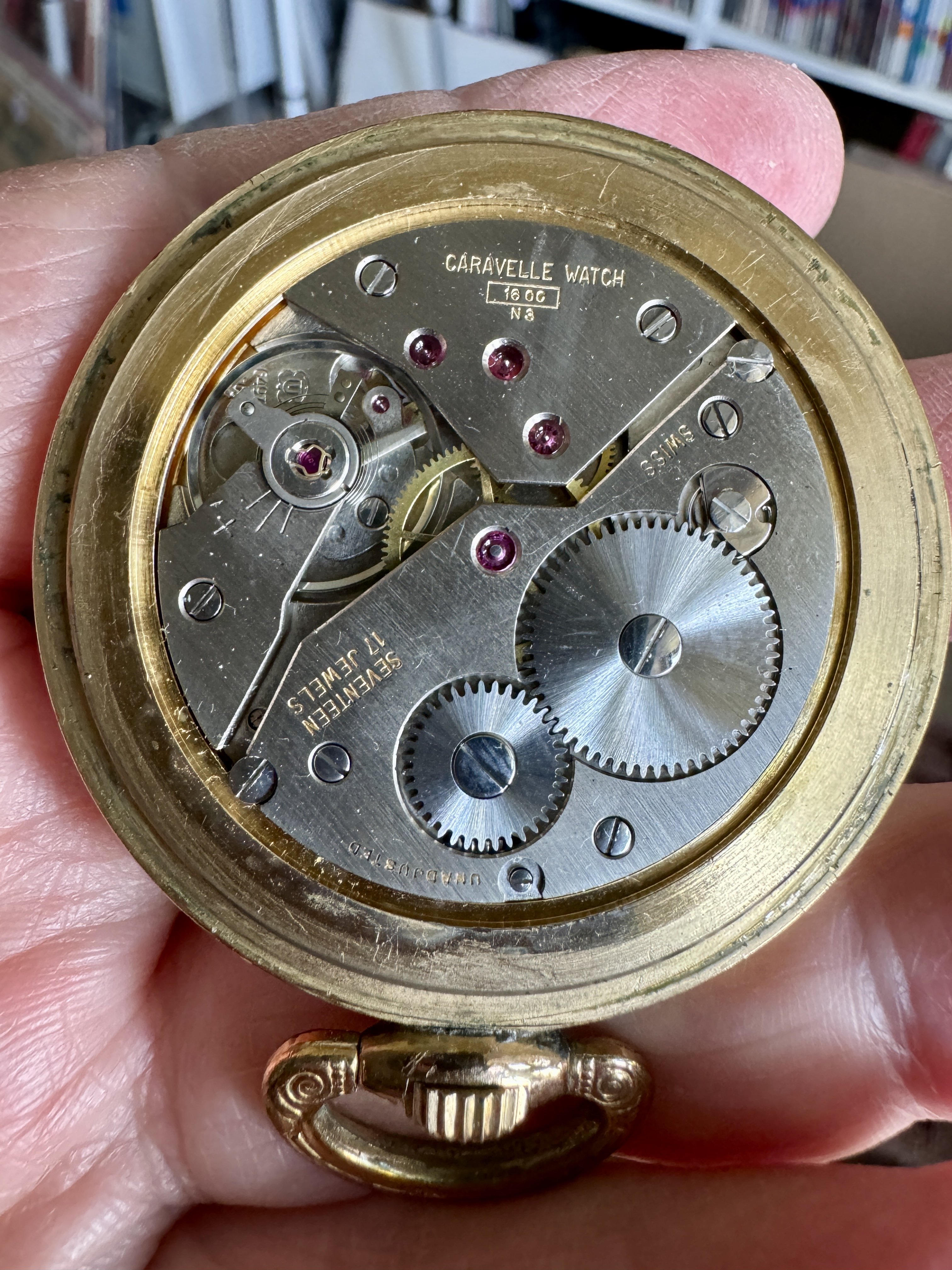

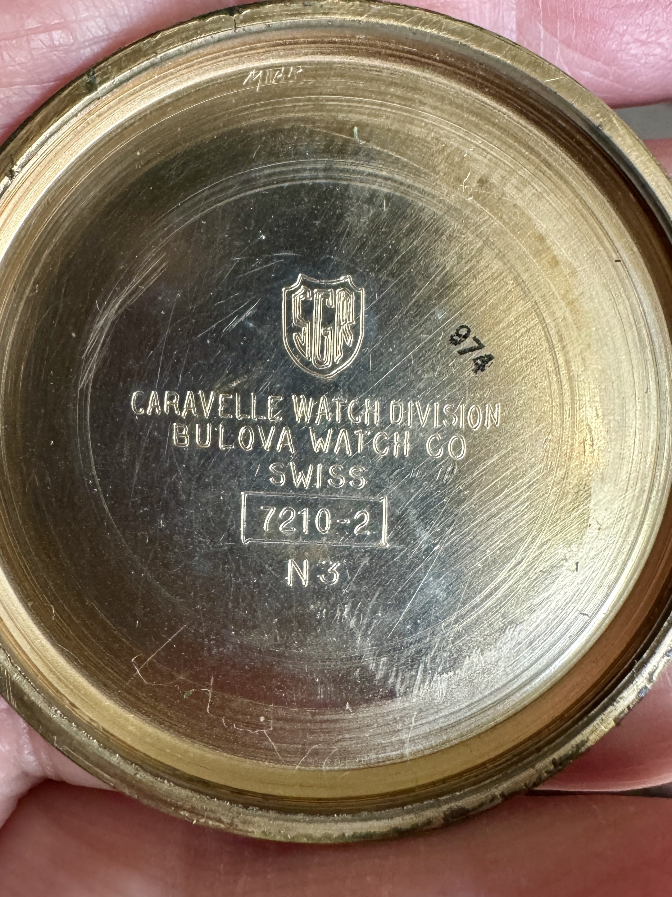

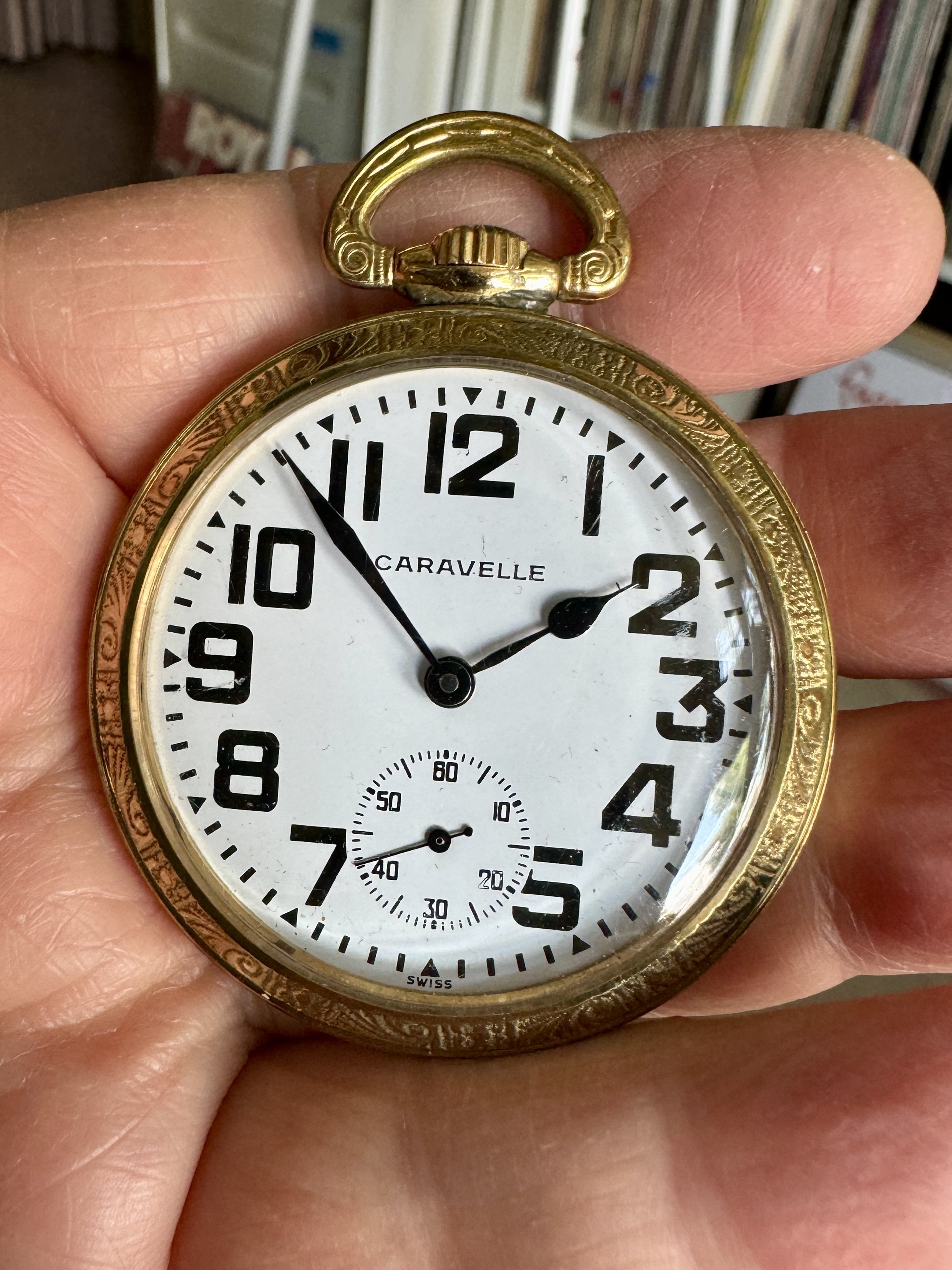

Unitas made movt for Bulova’s entry level Caravelle sub-brand.
Nice economical pocket watch for 1973.
Pendant set, so not RR grade😁 but very legible.

The N3 signifying 1973. Over 50 years old, and in nice shape. Movement still made. Known by a lot of different calibres, but notedly, ETA 6497.

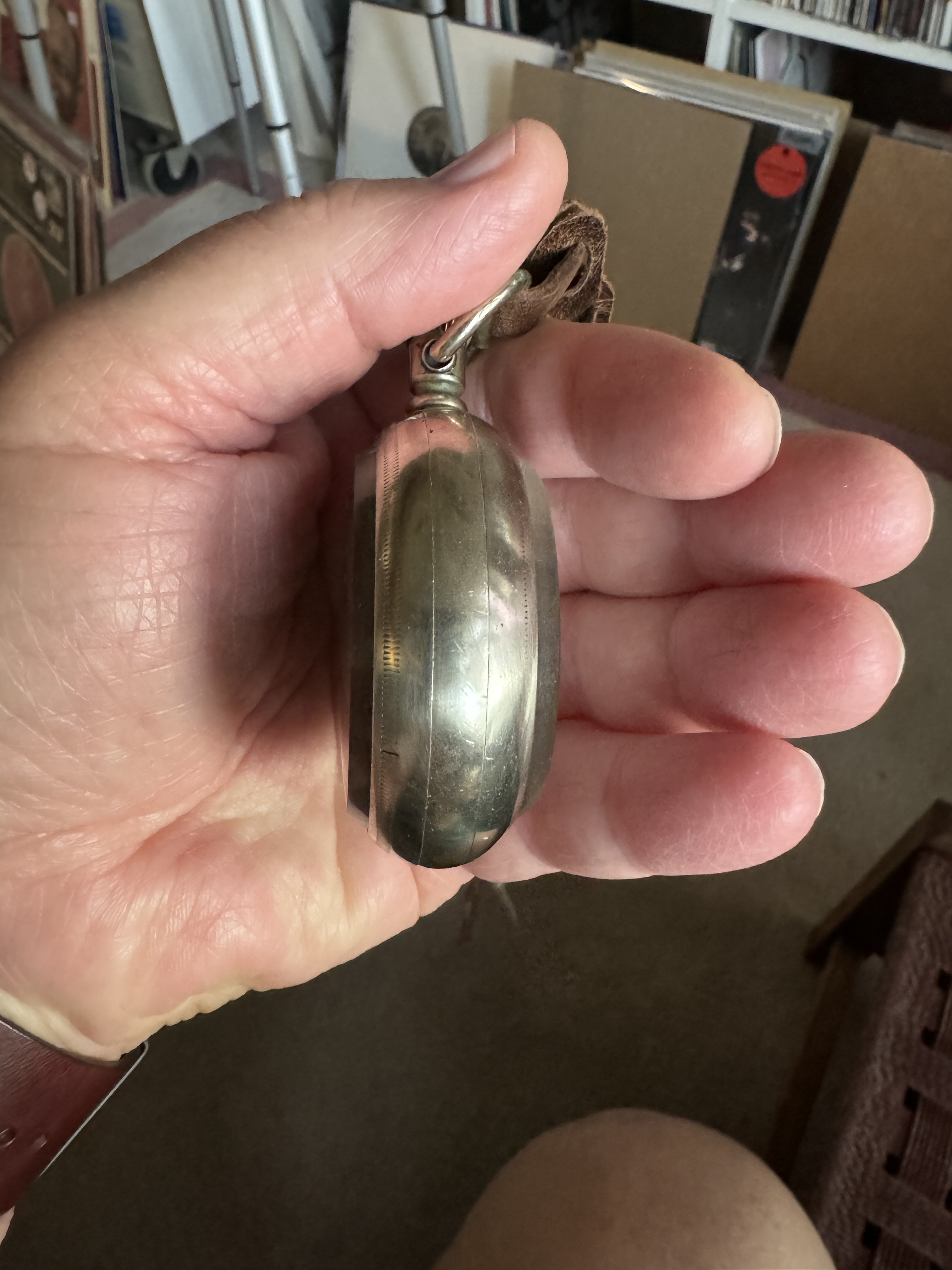

I carried a pocket watch today. A Keystone Howard series V. I wore it on my @DaveK miracle braid lanyard. This one is 113 years old! This one will no doubt be in someone’s collection in the year 2050, when Apple Watches will be 12 feet down in a landfill, somewhere! I won’t wear a watch of any description on Saturday as I have a bunch of scut work to do on our holiday trailer in preparation for camping in ten days. That people seldom wear pocket watches any more can only please those of us who collect pocket watches. The steam train club? Exactly! There are two train shows annually where I live. We exhibit about 100 railroad standard pocket watches at these shows.

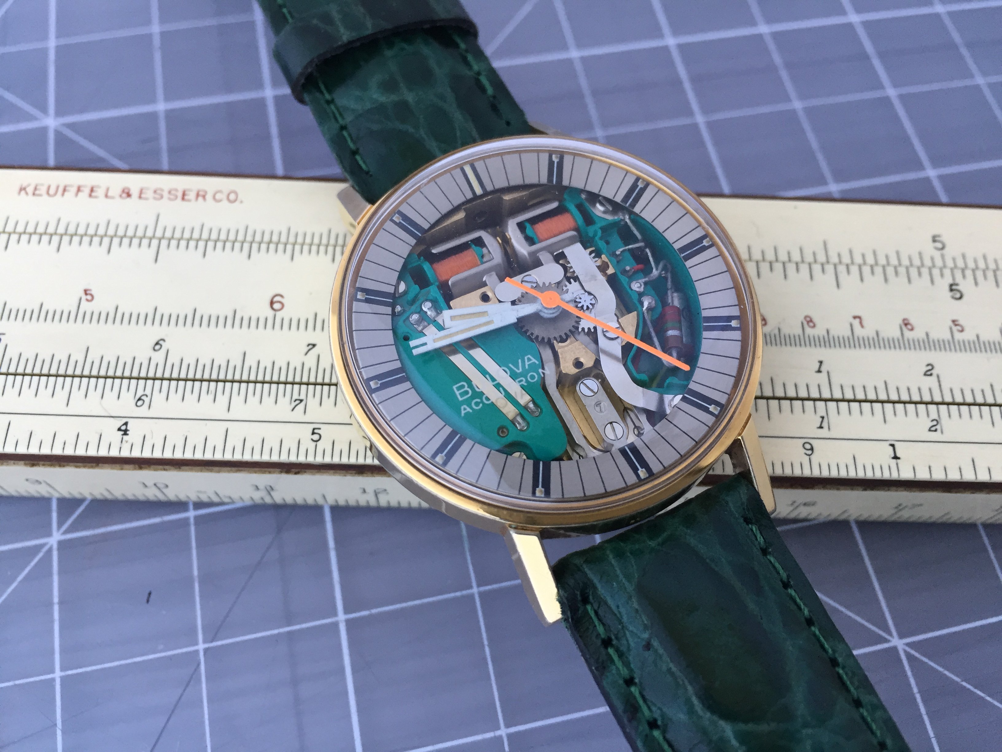

My Bulova, also from ‘73, for comparison on what customers were choosing from
