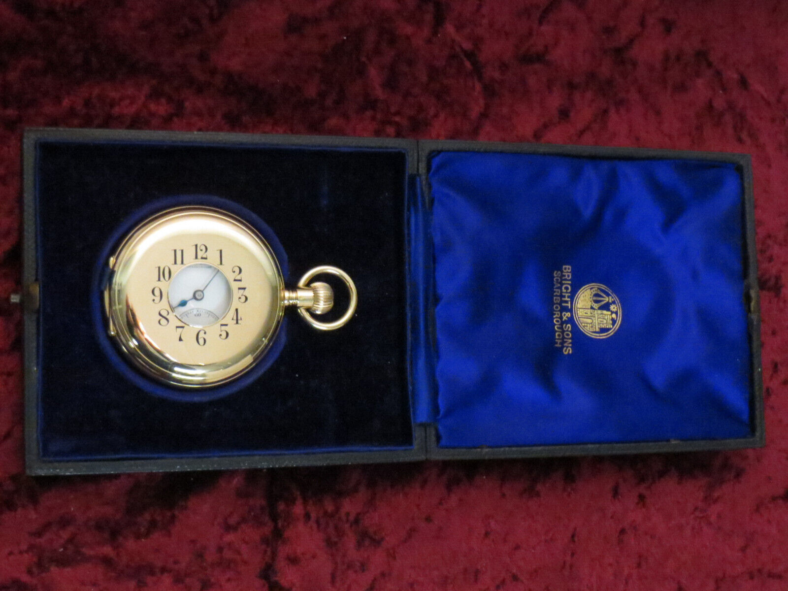

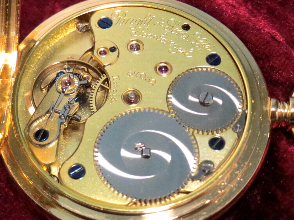

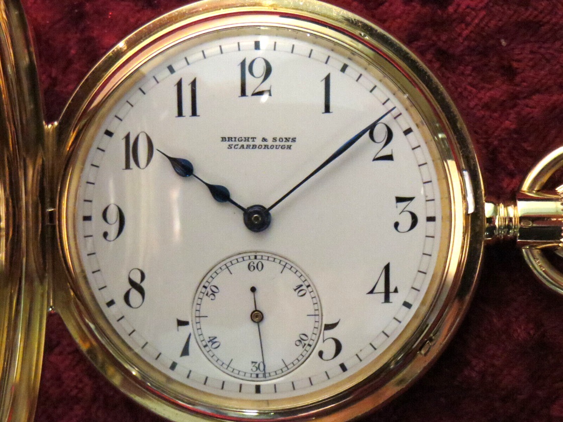

Bought this year, with the original box. The watch (movement and case) was made by A. Lange, Glashütte, although signed for Bright & Sons. Bright & Sons were one of two major distributors for Lange watches in the UK.

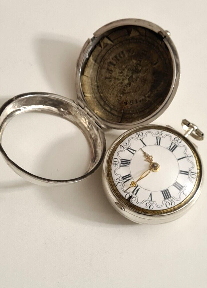

This one does not have a box and is a recase, but has a brilliant provenance. Family owned from new and until I acquired it. I even have a photo of the first owner and his wife.

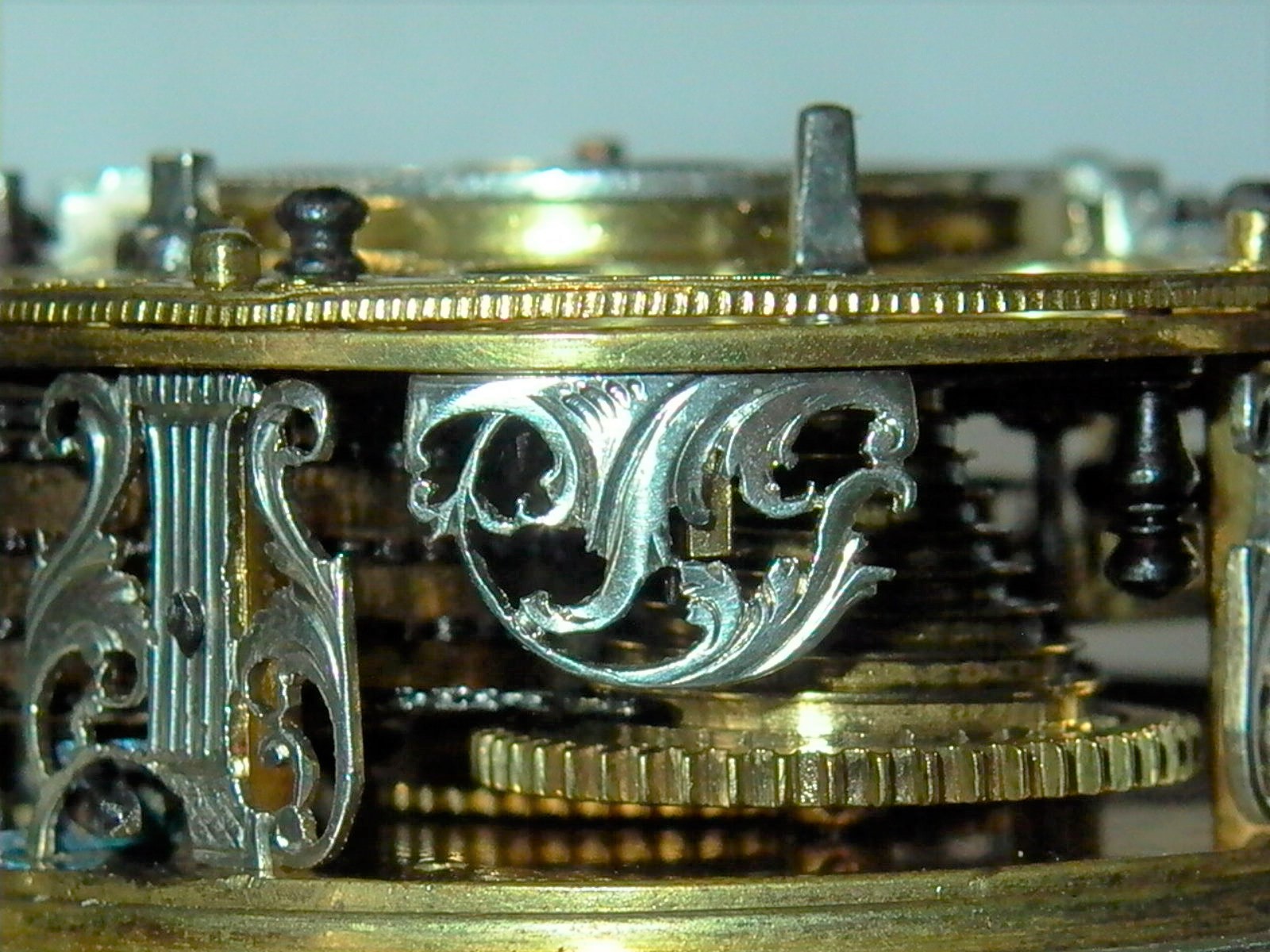

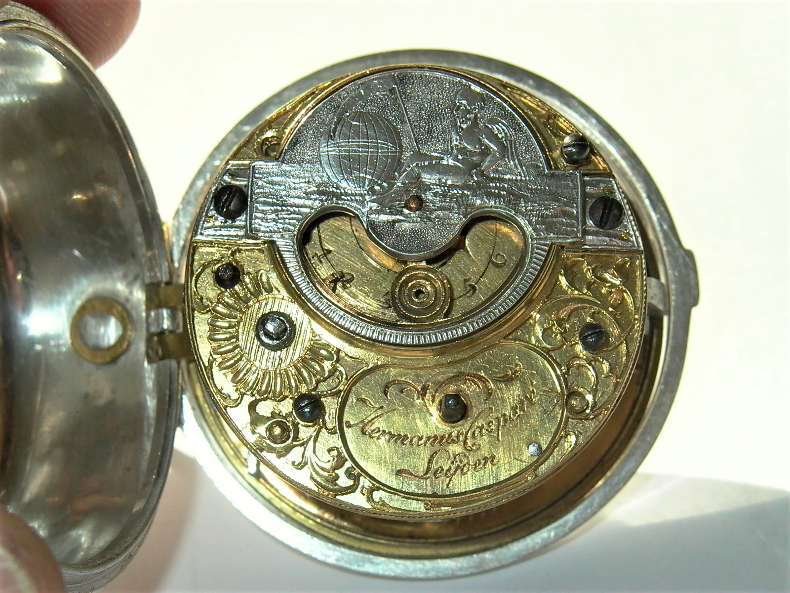

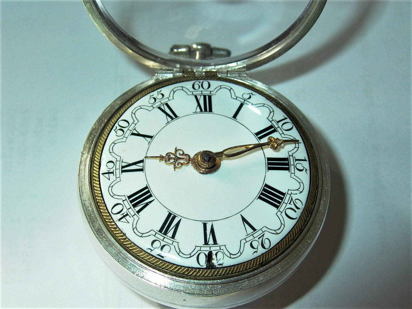

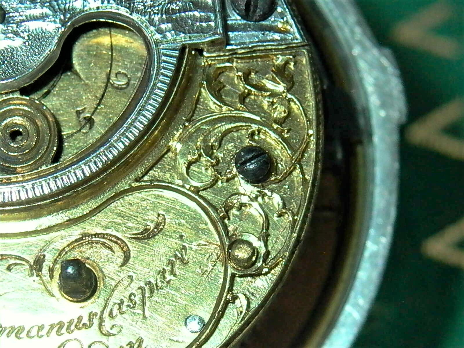

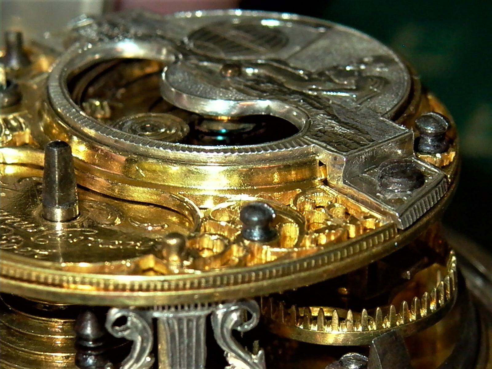

OK, how about this one? 😟
This is NOT one of these so called "Dutch Forgeries", but a real Dutch one, made about 1770.

That one will likely be a verge, and of course, equipped with a fusee. Considering that the watch is 252 years old, it is in exquisite condition. Particularly the vitreous enamel dial. From an era when watchmakers actually made watches. I suspect there is some fine silver appliqué. The fusee chain is let out all the way. As in, run down. I’ll bet that this fine example even runs! The rendering of Father Time is coincidental with the Elgin Veritas you showed. Elgin also produced a Father Time grade, as well as (of course) your Elgin Veritas.

Yes, a verge with fusee. The condition is indeed exceptional and it runs nicely, the complete chain down, and with an accuracy typical for verges (+10 minutes per day).
This particular watch was apparently disregarded by potential buyers, because at a first look it appears to be a "Dutch forgery", when looking at the arcaded minute ring on the dial and the form of the balance bridge. "Dutch forgeries" are Swiss watches made around 1800, which were produced in high numbers, signed with famous or fantasy names and often "London" as the location. They were distributed into many countries and at very competitive prices, making them attractive to the less knowledgable consumers. In most cases in Dutch style, and from this this phrase has established. The quality of the work generally was less than good (friendly spoken) and therefore "serious" collectors typically disregard them (including myselfe) as soon as they notice the arcaded dial design (i.e. instantly). Luckily nobody took a closer look in this case or bothered to research the maker. I immediately recognized that the quality of workmanship of the movement is outstanding (thus untypical for a Dutch forgery) and got it for a little above what is typically paid for a "Dutch forgery". Presumably the seller did not know either.
"Watchmakers made watches", well, that was not really true even in the 18th century, if it is meant in the sense that the watchmakers makes all or most of the components themselves. Even back then most watchmakers rather bought-in various components from the cottage industry with specialists for various components and "assembled" these to the final product. But generally this "assembling" was a bit more than just putting together, but often involved one or the other modifcation to the ebauches and in particular decoration work. And in rarer case really a lot of work was put into the making, this being an example. The maker Hermanus Caspari likely did not make the ebauche hinself (or e.g. the hairspring, chain, train wheels) but nevertheless made giant efforts for making of the escapement, the balance bridge, the pierced plates on the top plate, the applications to the pillars and other components (each being individually cast, not one being the same as the other), and other detailing.

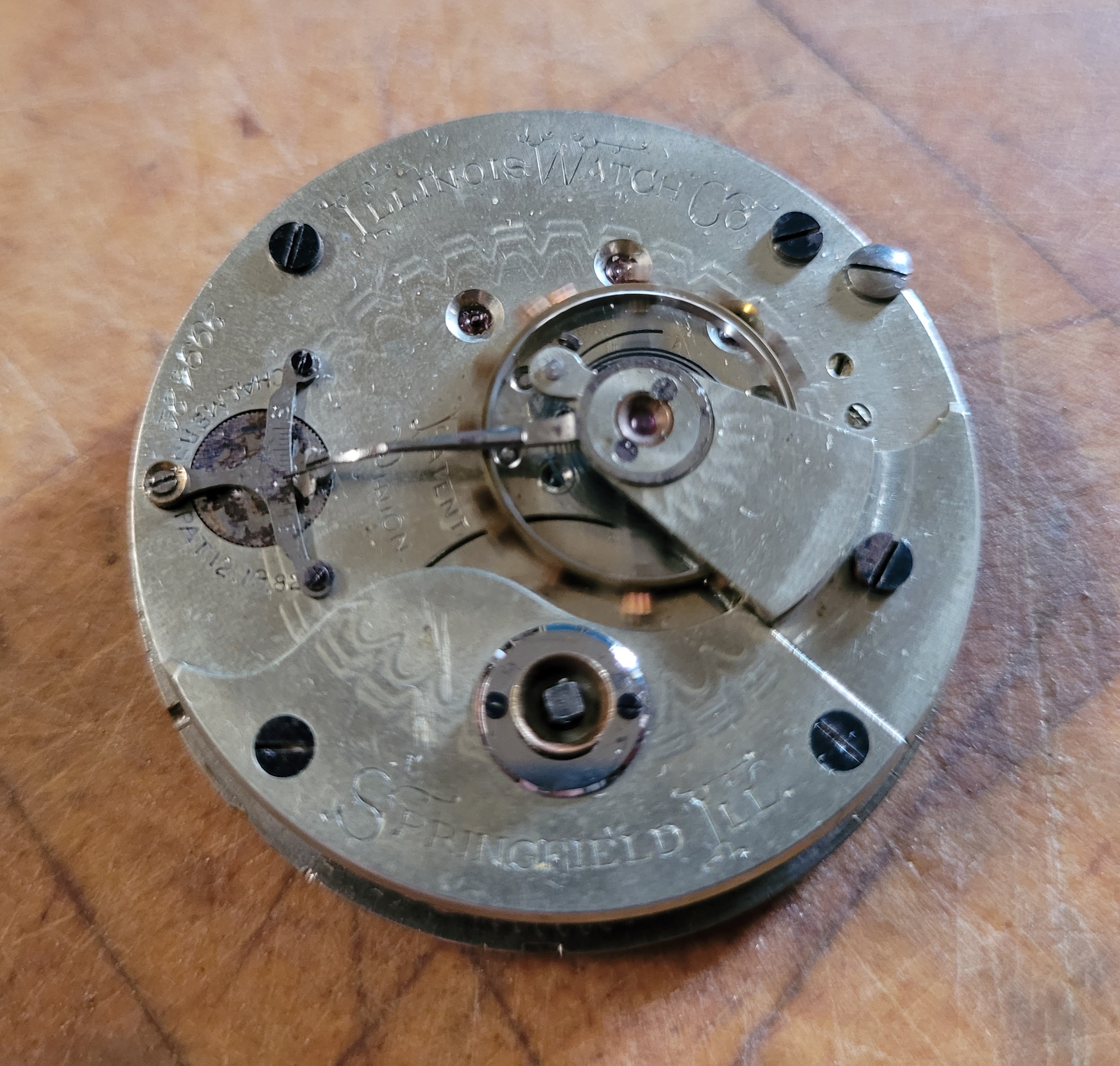

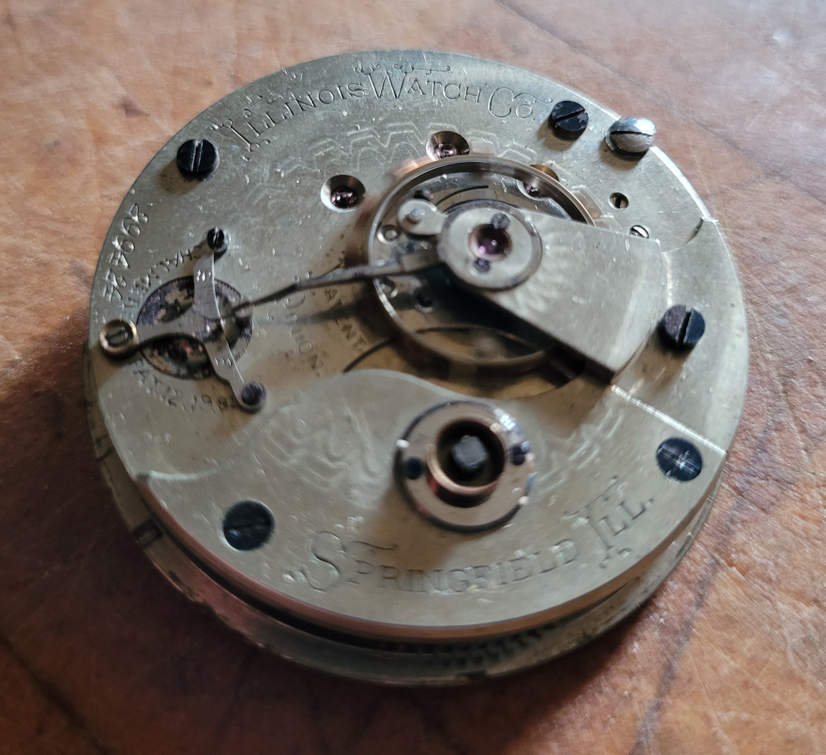

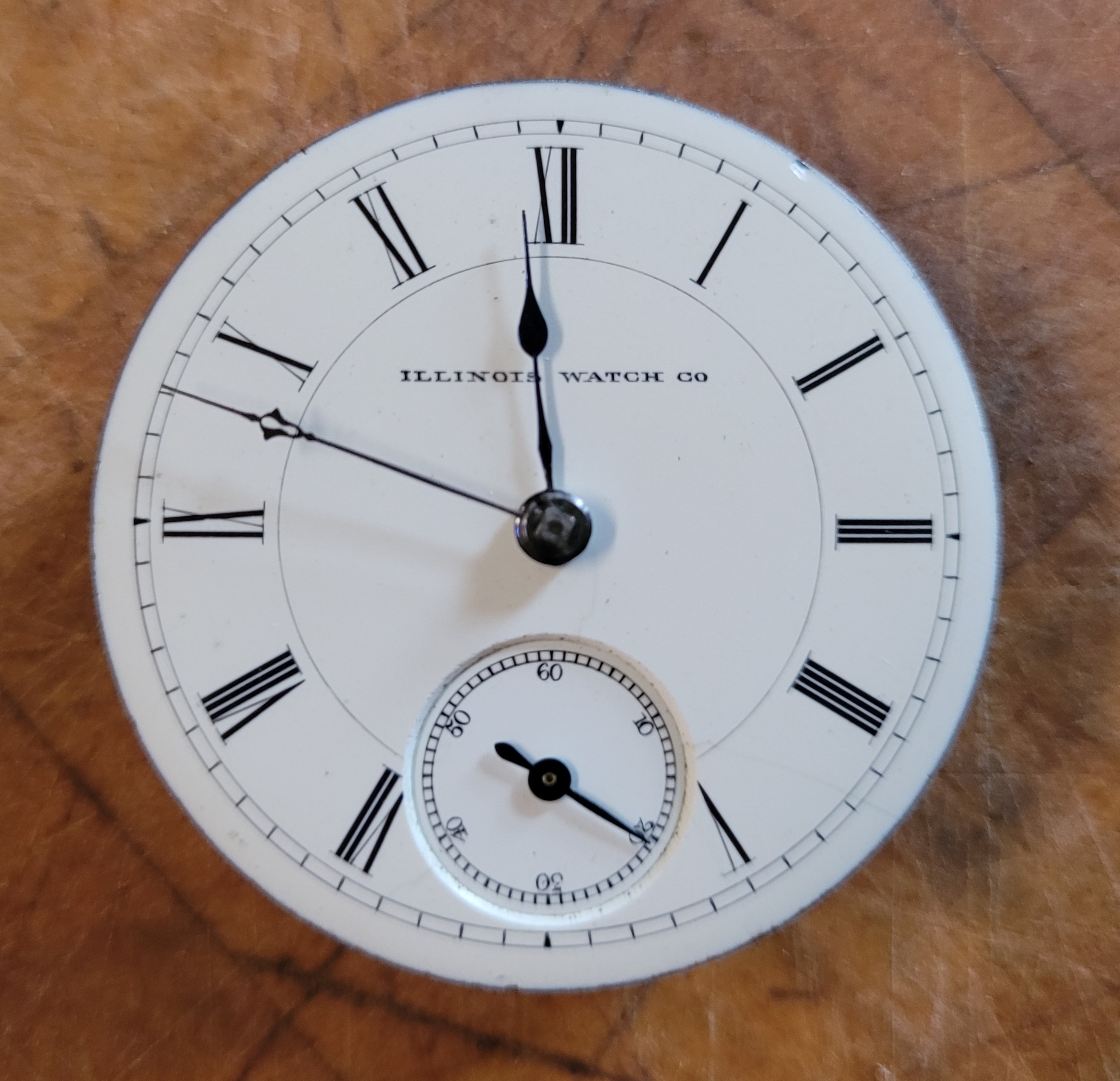

The mail man brought me a treat today, an 1887 eleven jewel, Illinois Model 1, grade 99. It is dirty but it wants to run, when I took the movement out of the tin it started ticking away for the entire time I took photos. It should be an easy service. I will need to sort the hands but that shouldn't be too challenging. I believe I will look for a coin silver hunting case for this one, because I don't have any in hunting cases at the moment.

The pocketwatchdatabase info on your Illinois. You will notice the listing says “adaptable” in the description. Meaning (of course) that it can be fitted to an open faced or a hunter case.
Perhaps the first watch I bought when I started collecting is an Illinois model 1 in a coin silver hunter case. I bought it with a tooth broken out of the cannon pinion. I was so pleased with my purchase that day, that after supper that evening, I was in my workshop until 1:30 am putting together a new cannon pinion for it. Still have it.

@Waltesefalcon : Lovely, in particular because of the apparently mint dial. As a European I have always wondered about the "jewel run" in the USA and would never disregard a "low" jewel number. Concerning spare parts, in particular hands, you US fellows are lucky with the American watches. In English watches a wrong hand often results in that one has to have a correct one made by hand. You, in contrast just need to order one for little money 😁.

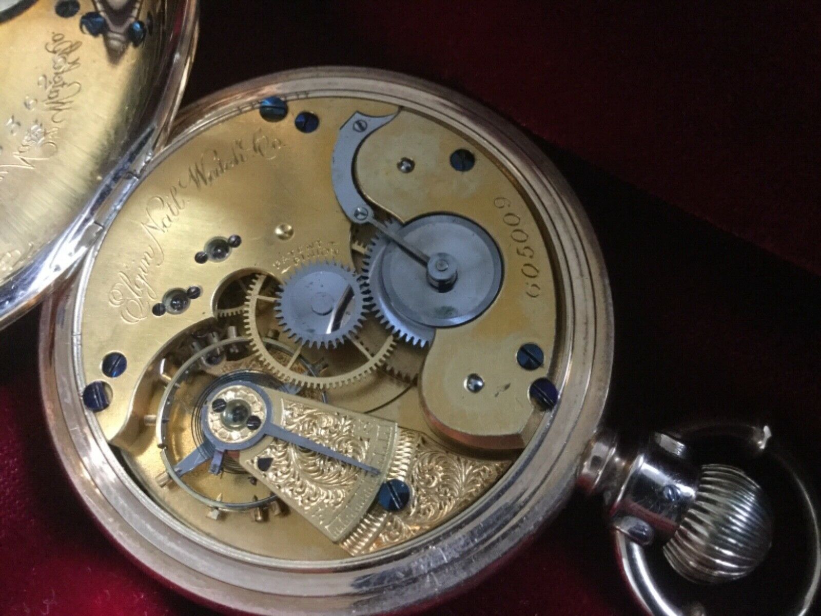

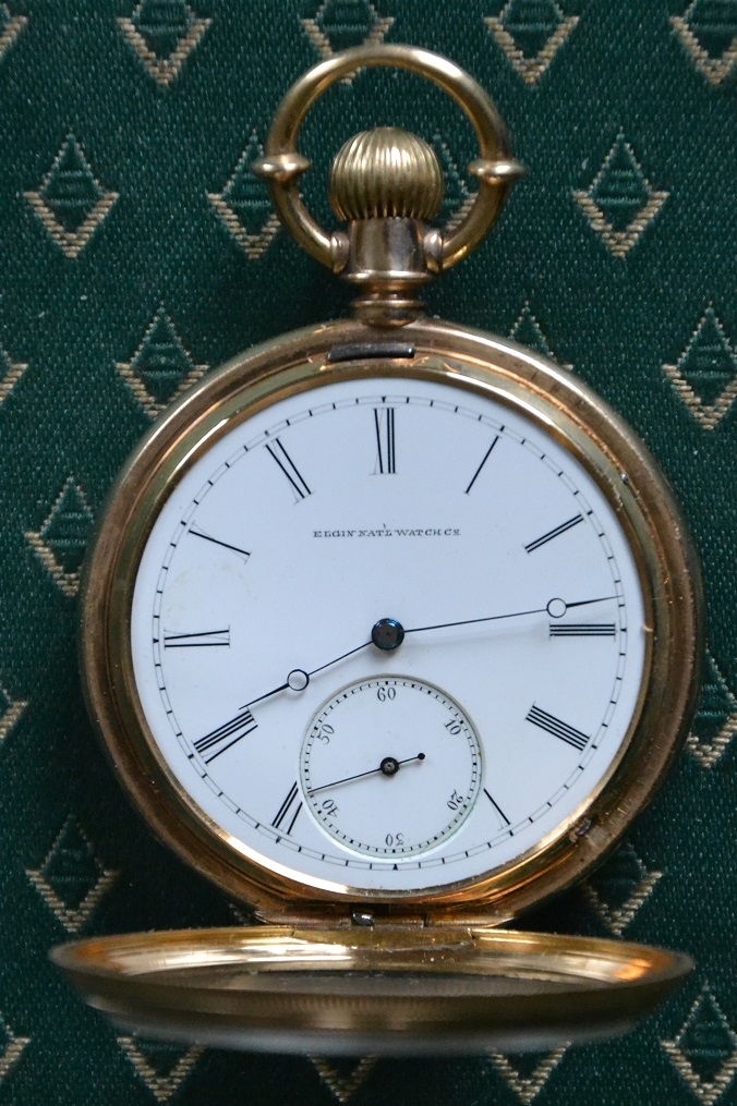

How is this achieved? I have an Elgin Interchangable, wherein a quite sophisticated design allows adaptation to both case types, maintaining the "correct" position of the "12", see below. I love this watch. although it also has a "low" jewel count.

Your Elgin is often called a “convertible”. I apologize, but I have had no experience with these, regarding the orientation of the numeral 12, or the location of the seconds hand, if the watch was to be re-oriented in a different case.

Ohh, exciting, an Elgin convertible. So to change it from hunting to open face or vice versa you would remove the barrel bridge. With it off you could move the crown wheel and stem from one arbor to the other. You can see the ends of the two crown wheel arbors on either side of the barrel.
Yes, and the front side is also quite unusual, at least for us Europeans. Upon pushing the winding crown the bezel with the crystal swings open, allowing access to the lever for setting. Thereby the dial edge is protected by another snap-on "bezel", which is, however, not designed to have a (second) crystal. The case is apparantly original and solid gold.

Very interesting case, I've never seen one like it. Granted I'm not the most experienced collector in the world.

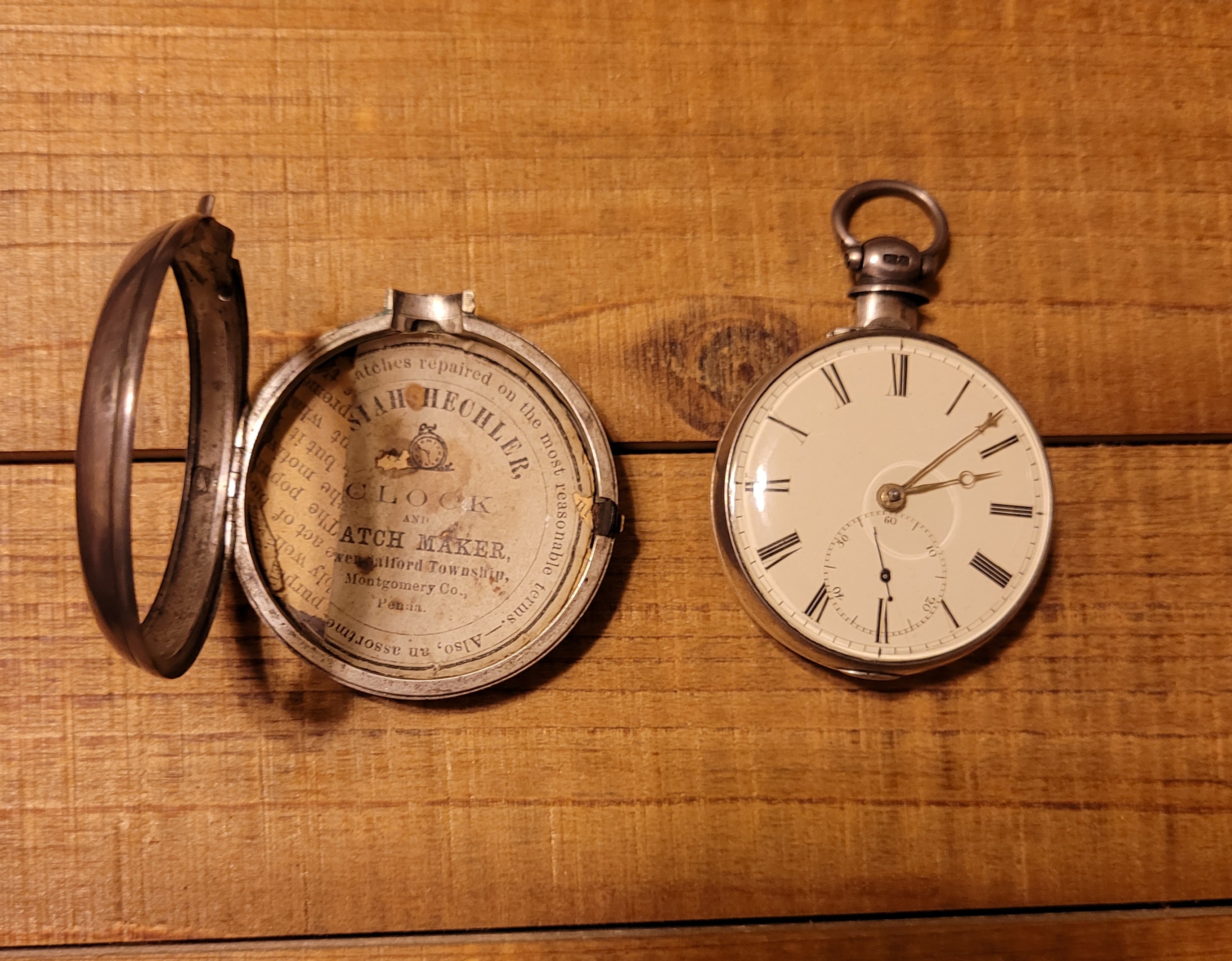

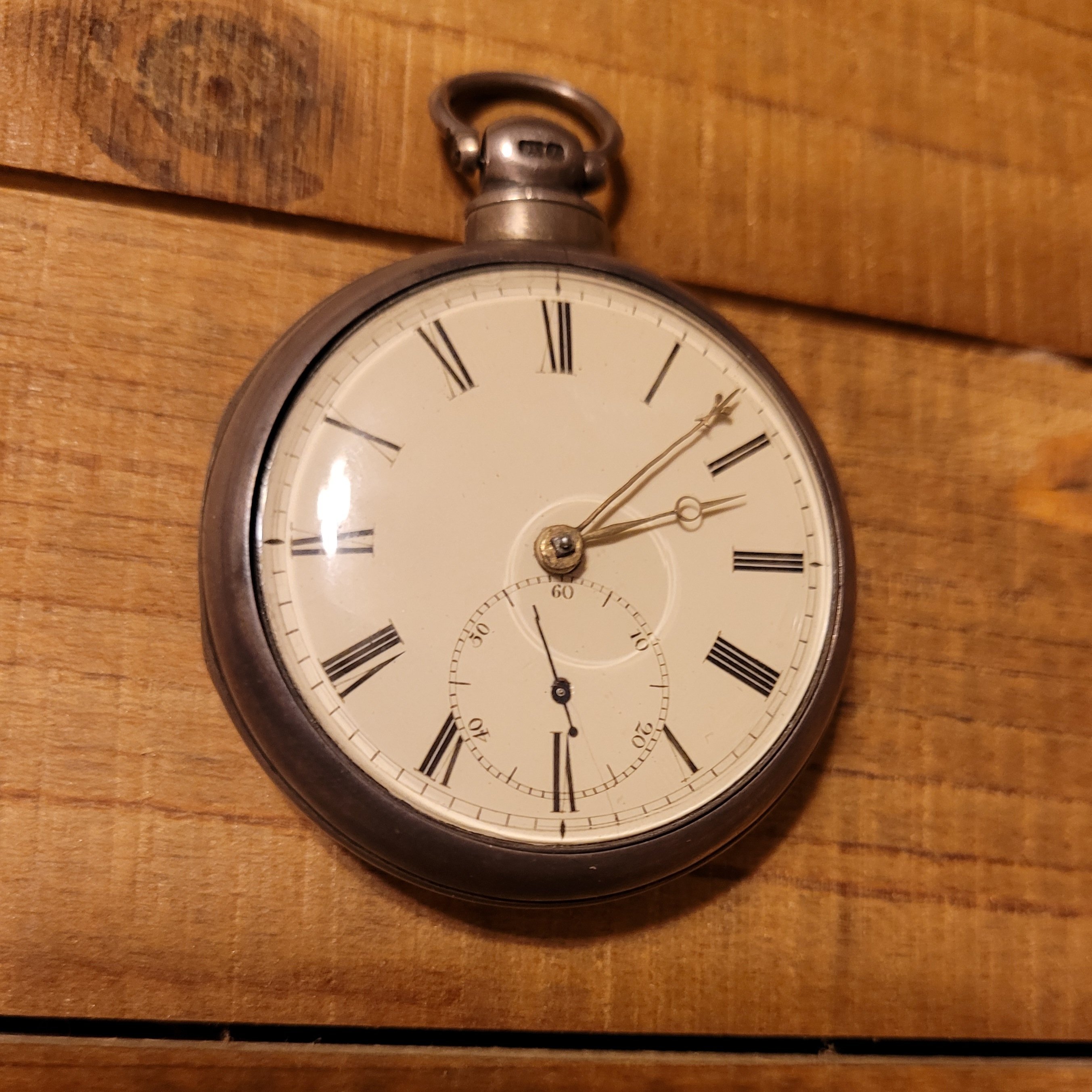

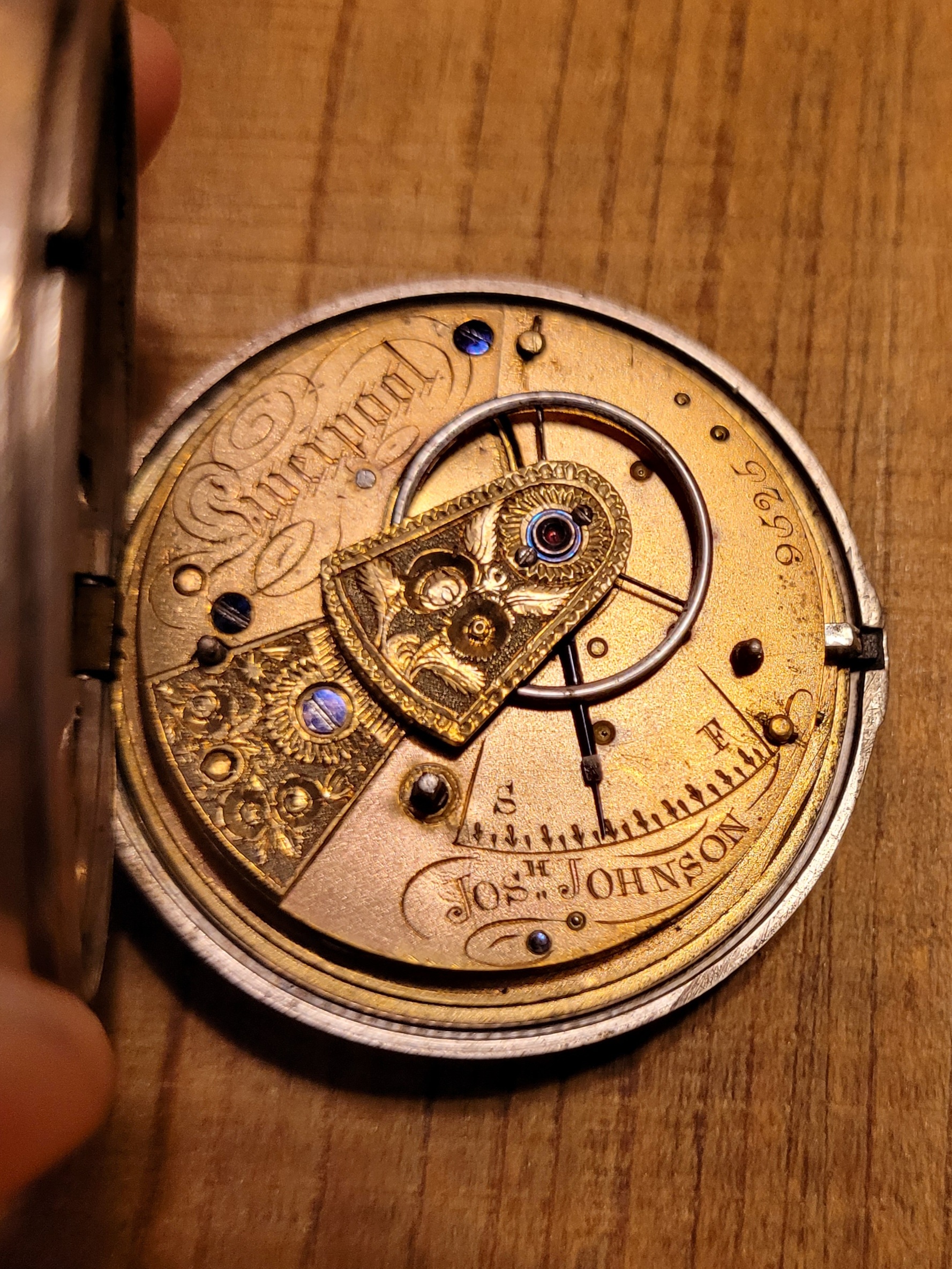

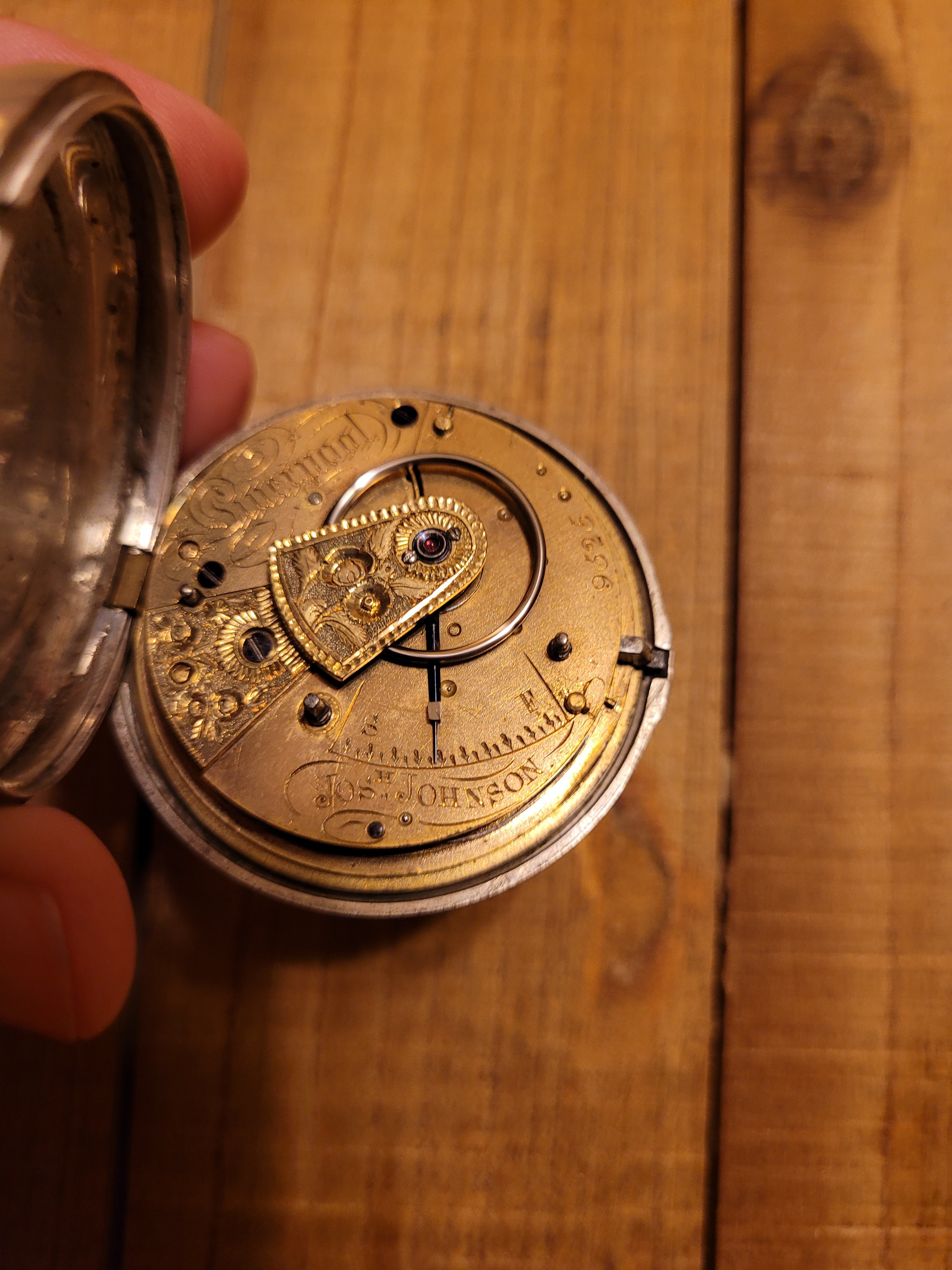

Because I have nothing better to do I decided to take a couple of photos of my 1849, (if I'm reading the hallmarks correctly) Jos. Johnson. You can see that the hour and minute hands don't match and the second hand appears to be a much later blued hand. It's in a decent pair case (if I'd been a case maker I would have made my pair cases I the shape of pears). It does run (it is loud) but needs a service, but I probably won't because I don't wear it often as it has a tendency to lose about seven minutes a day, (even when serviced) and that bugs me. I shook it and it started ticking so I got a quick "action" shot of the movement (last photo). Without balance screws, the only way you can really tell it's moving is by the apparent lack of spokes on the balance wheel.
I apologize for the terrible light, the sun is not quite up yet so I took the photos in my room under and overhead light.

Great to see that paper insert retained 👍

Since you don’t show the hallmark and date letter, it is difficult to comment on the year. But Loomes shows a Joseph Johnson who was in business in Liverpool from 1814 to 1851. I notice that the watch appears to have what might be an original “bullseye” glass crystal. The fact that it runs is quite remarkable, let alone that it isn’t a great timekeeper. Is it a verge or lever escapement? My guess is that it has a lever escapement.

It is a lever escapement. The amplitude will give you a hint as to whether a service is urgently needed. The regulator is on the "slow" side and perhaps moving it right into the middle position lets it loose less. These movements should manage less than a minute per day.
Looking at the cases, I would have dated the watch a bit earlier. A look at the hall marks will definitely clarify this. Typically the case(s) have the same numbers stamped in as the movement ("matching numbers", but exceptions exist).
