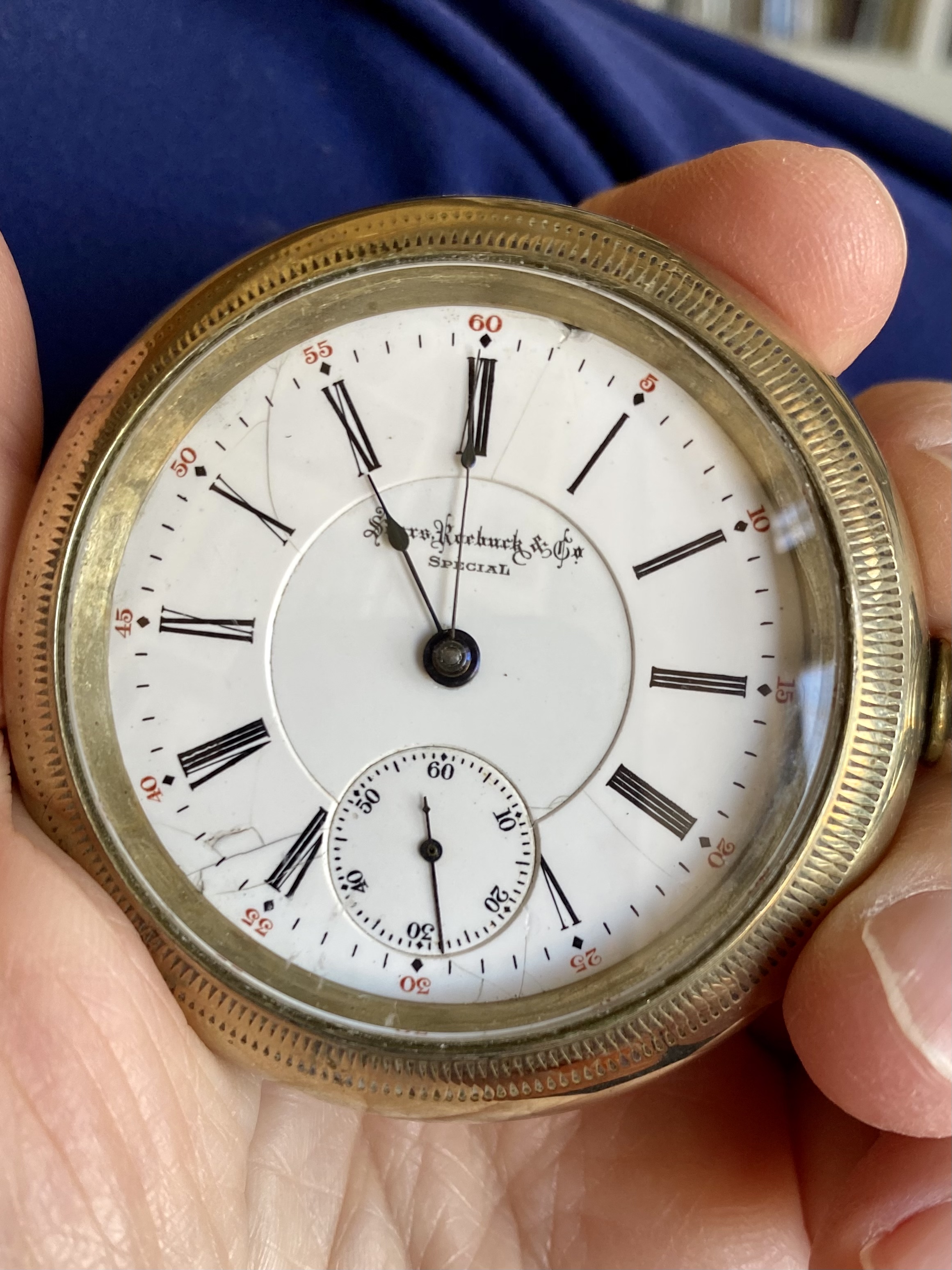

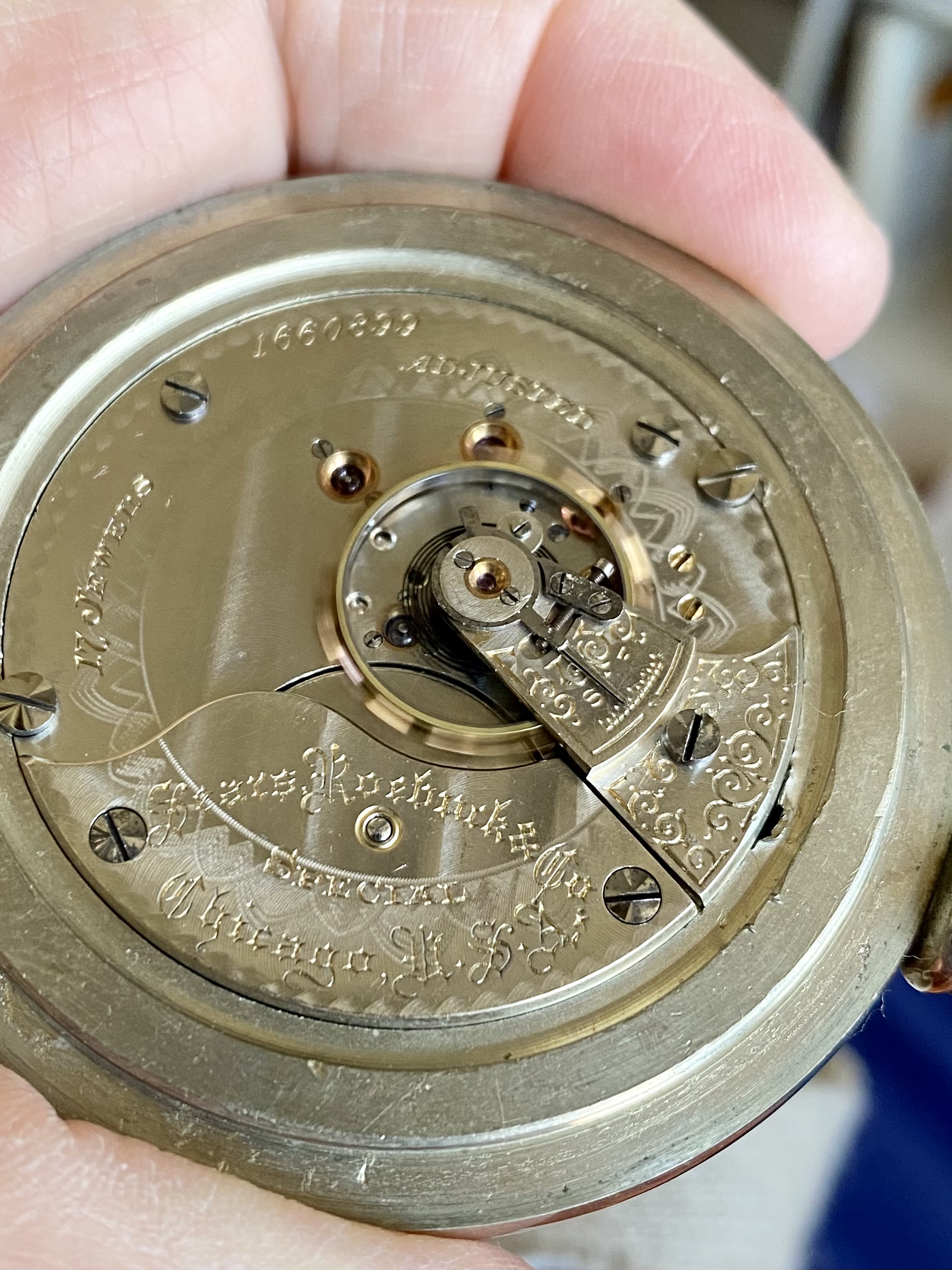

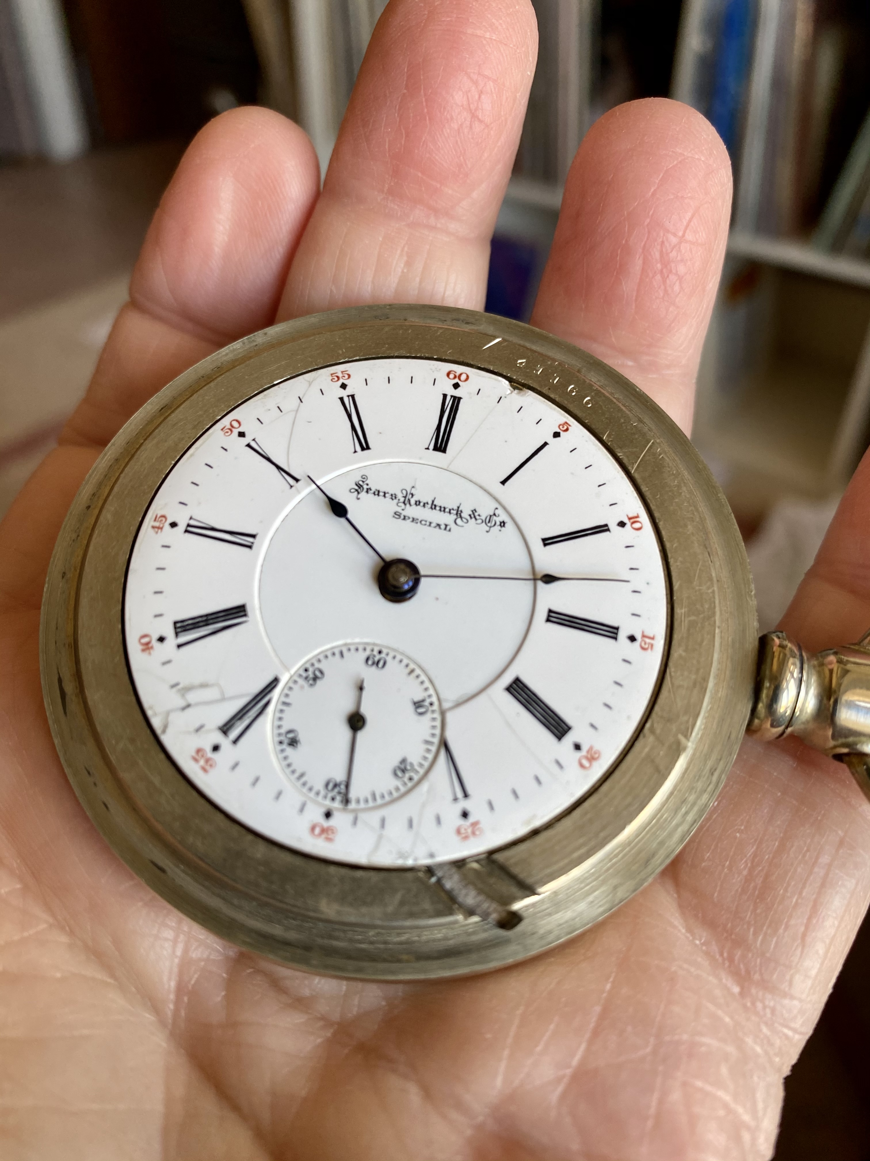

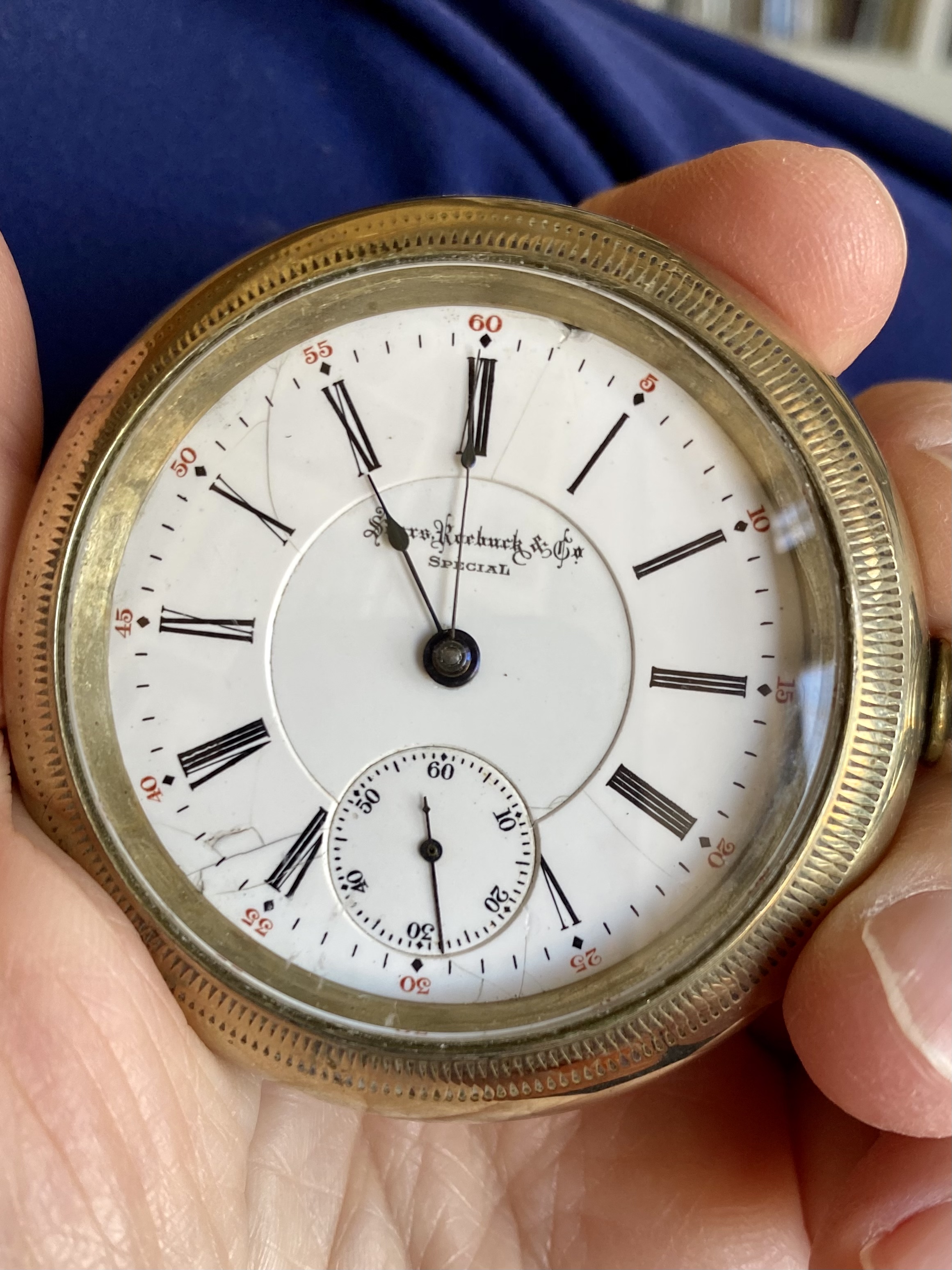

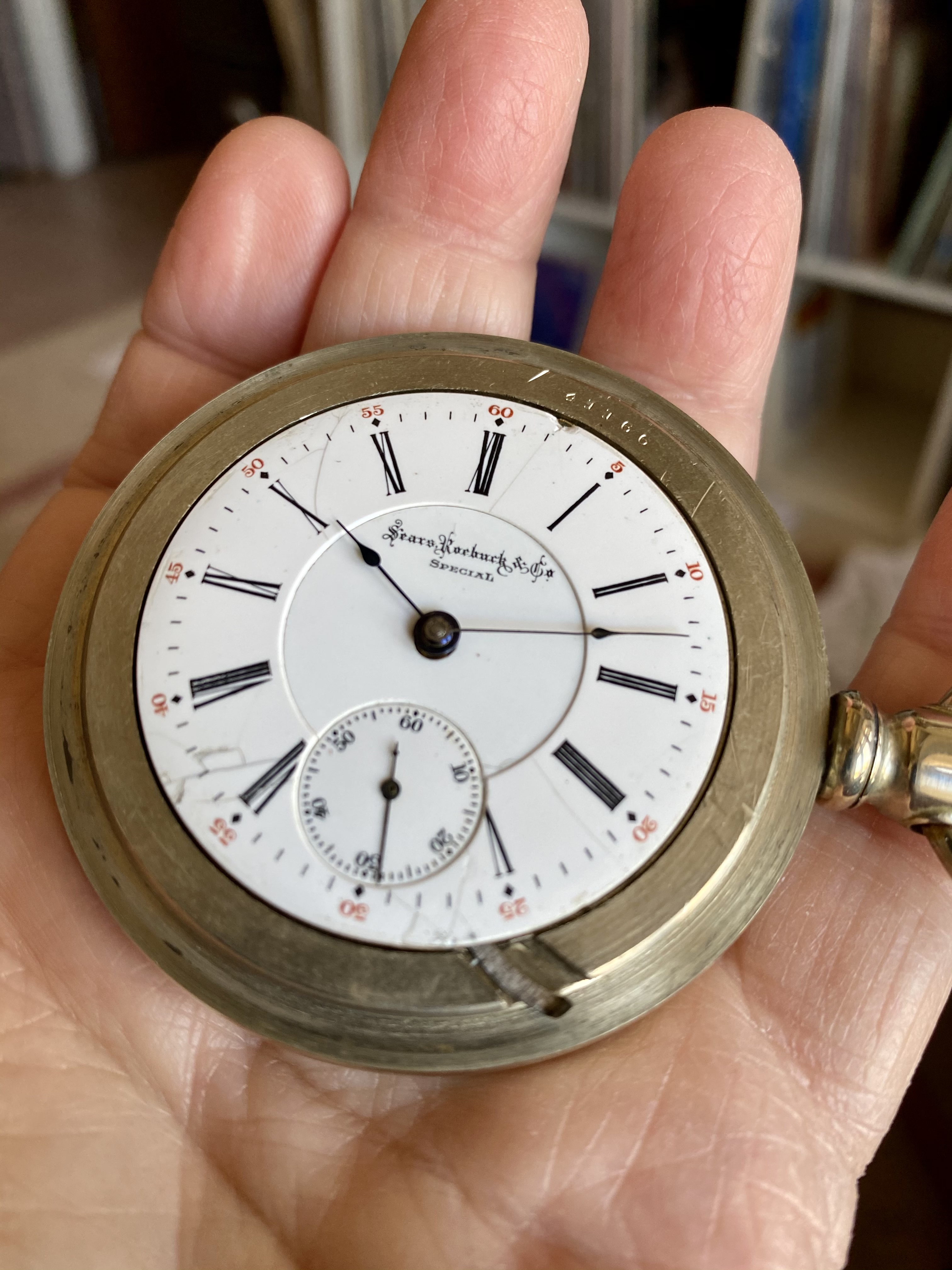

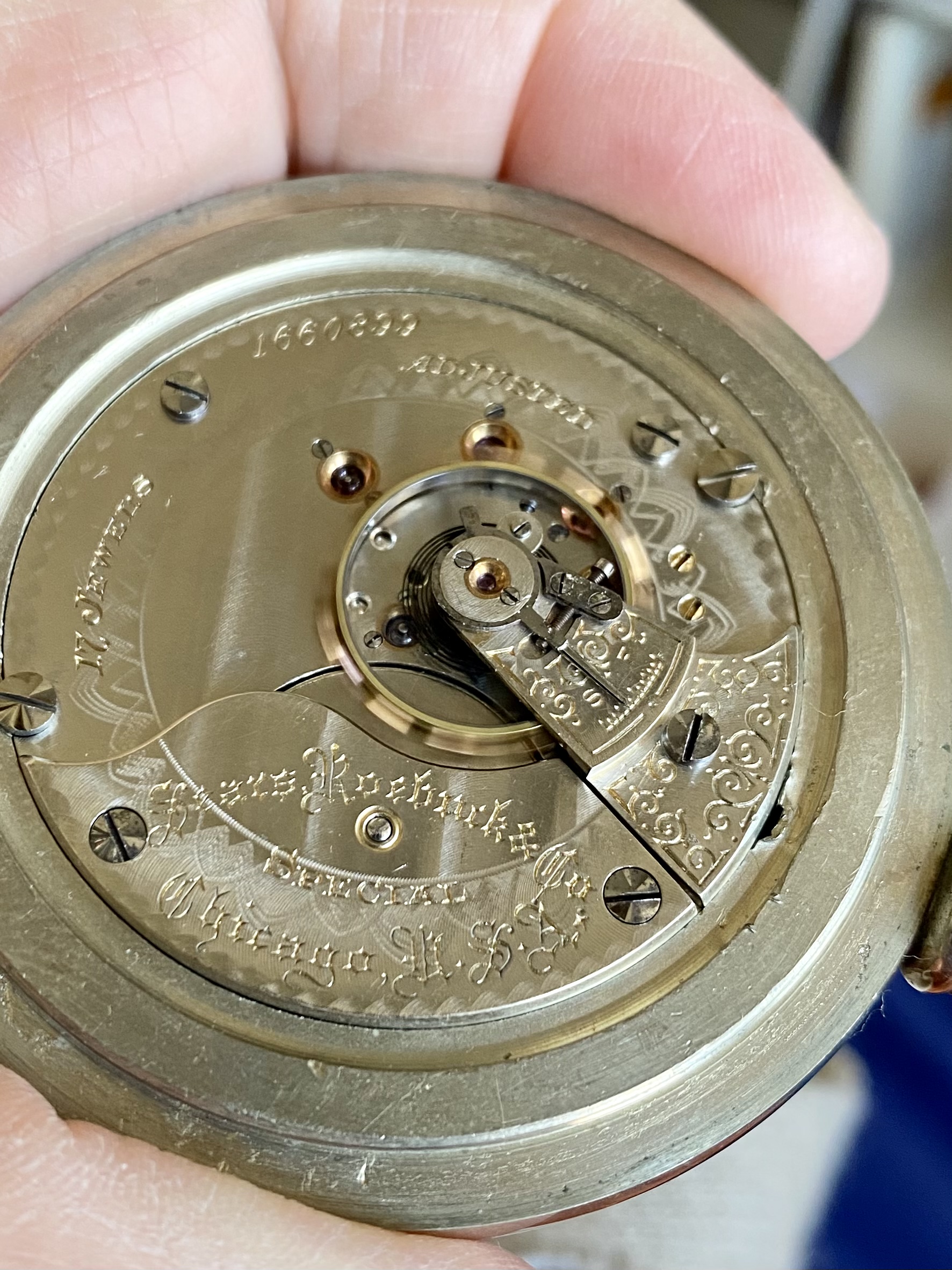

How they started.... Sears as seller, Roebuck as WM
Sears Roebuck & Co. "Special"
18s 17j Adjusted
Illinois Grade 64........... Love the Old English script for which Illinois was famous.
RR grade and approved
Y:1903
16,002
48,157
At one point, Sears sold out to Roebuck, but always came back. After a time, Roebuck tired of Sears aggressive practises, and sold out to Sears, remaining as a watchmaker. Sears re-capitalized and took on new partners. One of those partners sold his shares in 1901 for 1.5 million. Meanwhile, Roebuck was still at his bench, fixing watches! He died, penniless. Once a watchmaker, always a watchmaker, I guess. Sears went on to prosper, but we all know where that ended!
By 1920, private label watches such as this one, had to have the actual maker of the watch named on the dial. Private labels were out. But some railroads accepted some Burlington railroad grade watches which were private label. Burlington was made for a catalog merchandiser, by Illinois.

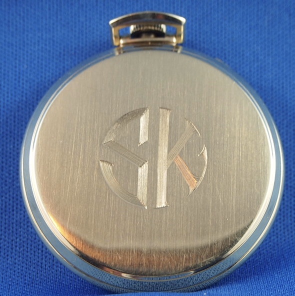

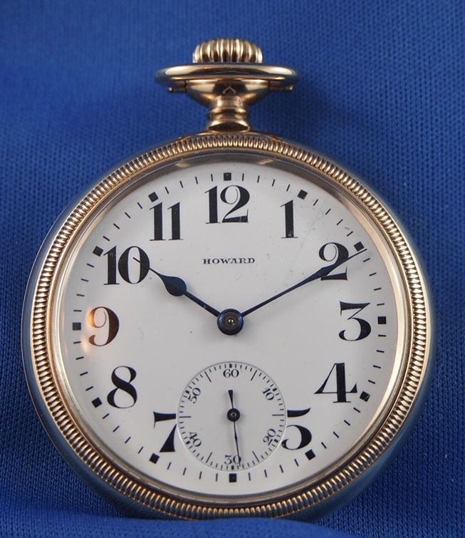

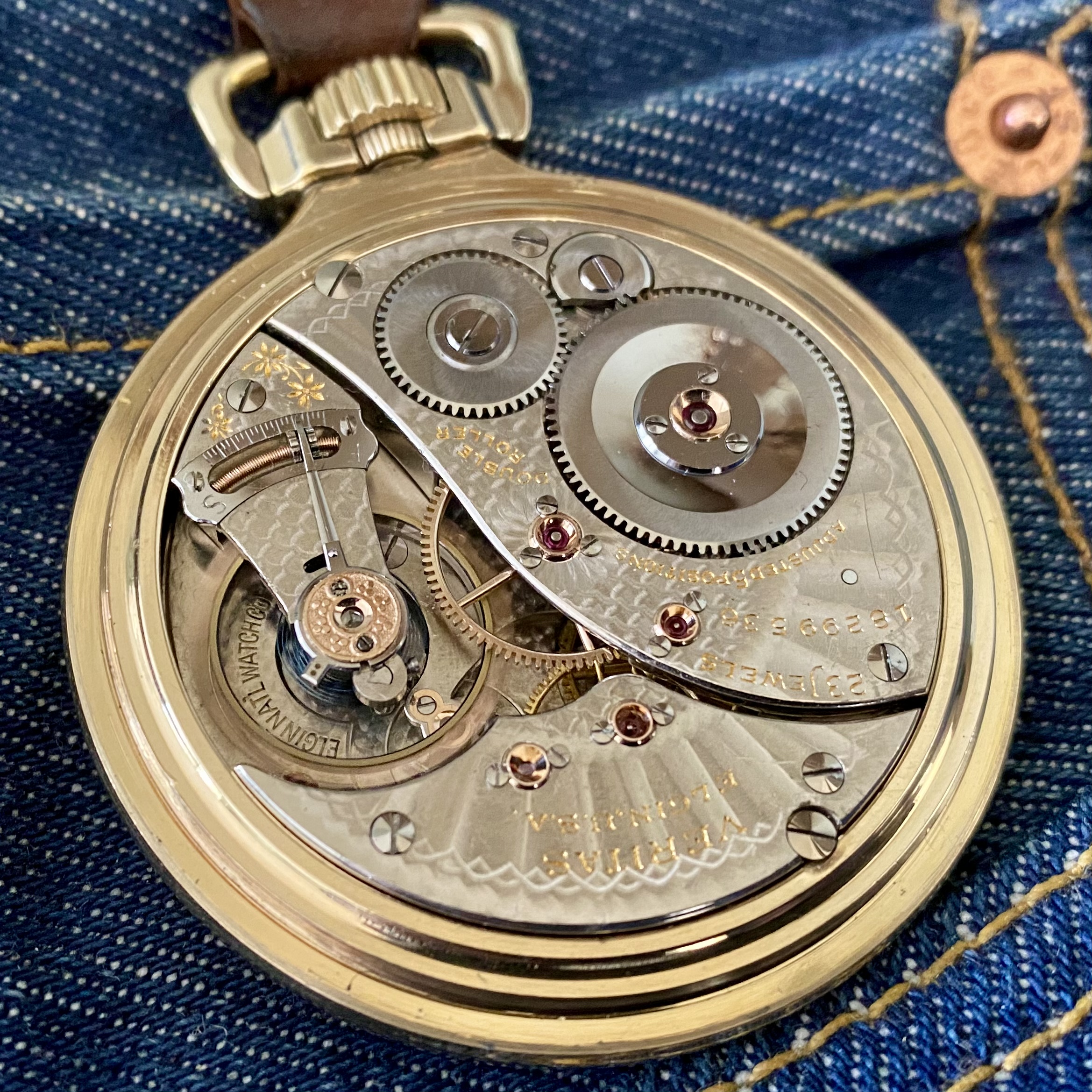

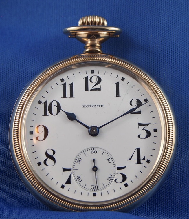

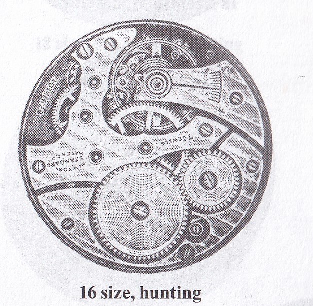

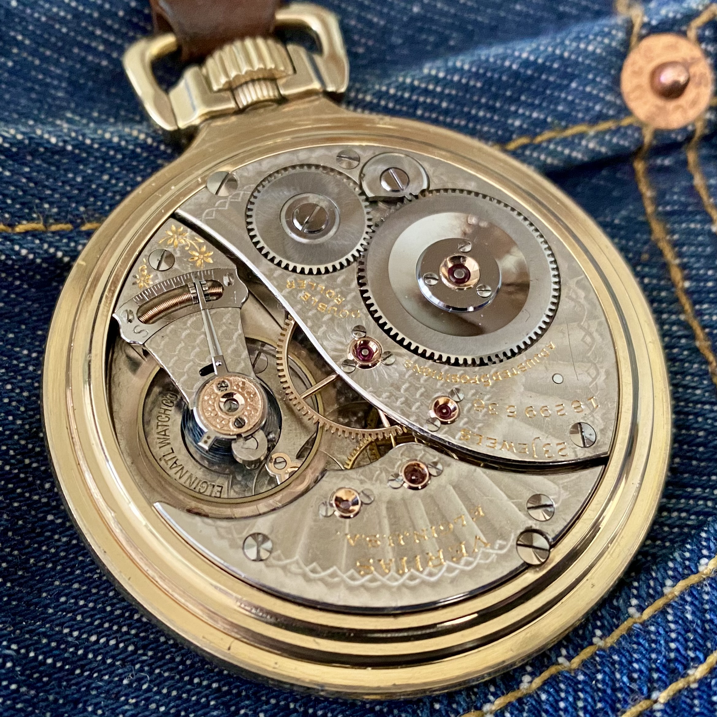

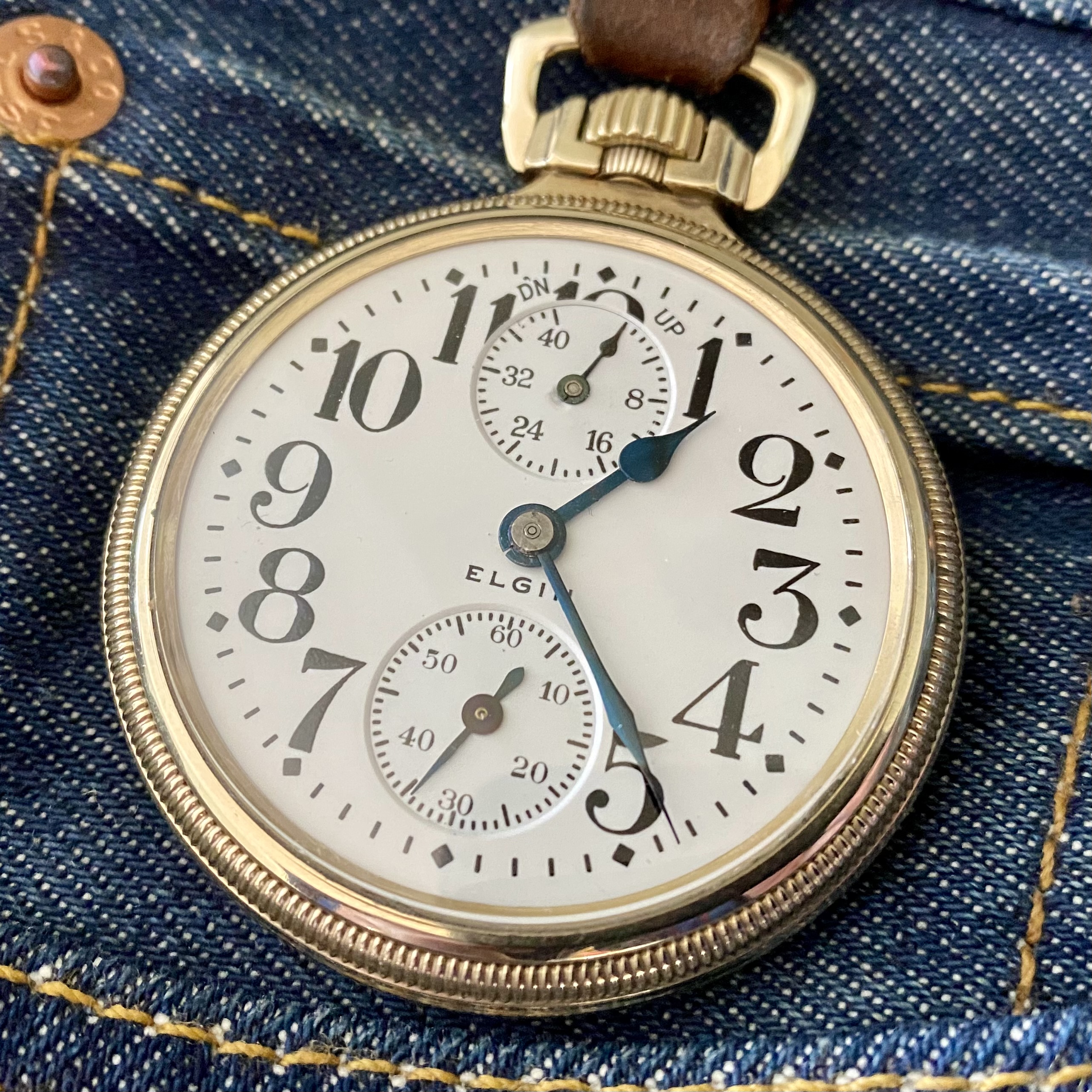

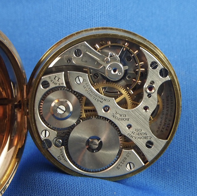

So many stories! Here’s another watch with a story. This story begins with the New York Standard Watch Co., maker and purveyors of what might be called “popular priced” watches. When the Keystone Watch Case Co. acquired the rights to market watches under the name E Howard Watch Co., they also acquired the New York Standard Watch Co., and the U S Watch Co. of Waltham. Among the models of 16-size movements produced by the New York Standard Watch Co. is this 16-size model shown herein. You may notice that this movement is marked “7 jewels”, thereby indicating it was meant ans an inexpensive (read “cheap”) watch.
For a time after the Keystone Watch Case Co. acquired the Howard name, they weren’t equipped to manufacture movements. So they started out buying movements from the Waltham Watch Co. Early Keystone Howard’s were actually made for them by Waltham. Once Keystone was set up to manufacture their own movements, they got down to business. I have four Keystone Howards, and one Edward Howard. Among my Keystone Howards is a model XI railroad chronometer. I really like this watch. It is not a model of Keystone Howard that is a grail watch among Howard collectors. Compare the picture of the movement in my Keystone Howard series XI with the New York Standard movement I showed above. After Keystone acquired NYS, it is clear (to me at least) that they based their series XI movement on a watch that had been produced by a company that made inexpensive watches (NYS). I think there must be a stigma attached to the much higher quality Keystone series XI version of this movement.
This watch was offered to me by an elderly fellow who was downsizing. This was his fathers railroad watch, and he desperately did not want to leave it to his grandson who would liquidate it to buy drugs. He didn’t know anything about the watch, so I told him what he had, and made him an offer. He was glad to see it go where it would be appreciated. It has 21-jewels, 16-size, lever set, patent micrometer regulator, 5 positions, heat, cold, isochronism, (eight adjustments), and is in its original Keystone “swing ring” case. Look closely and you will see it is clearly marked “Railroad Chronometer”. It was railroad approved in its day. It has one of my favourite dials. Another watch, another story!

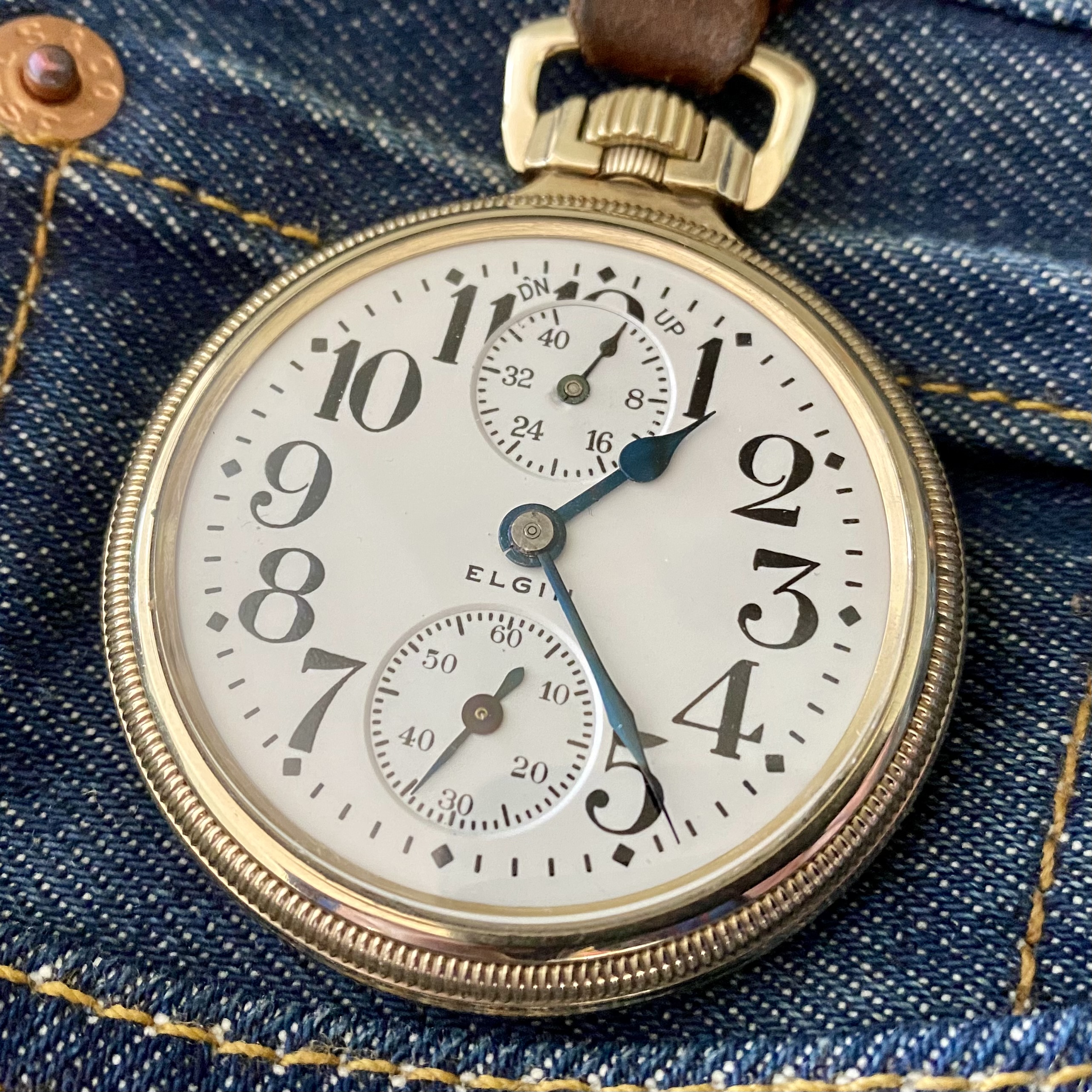

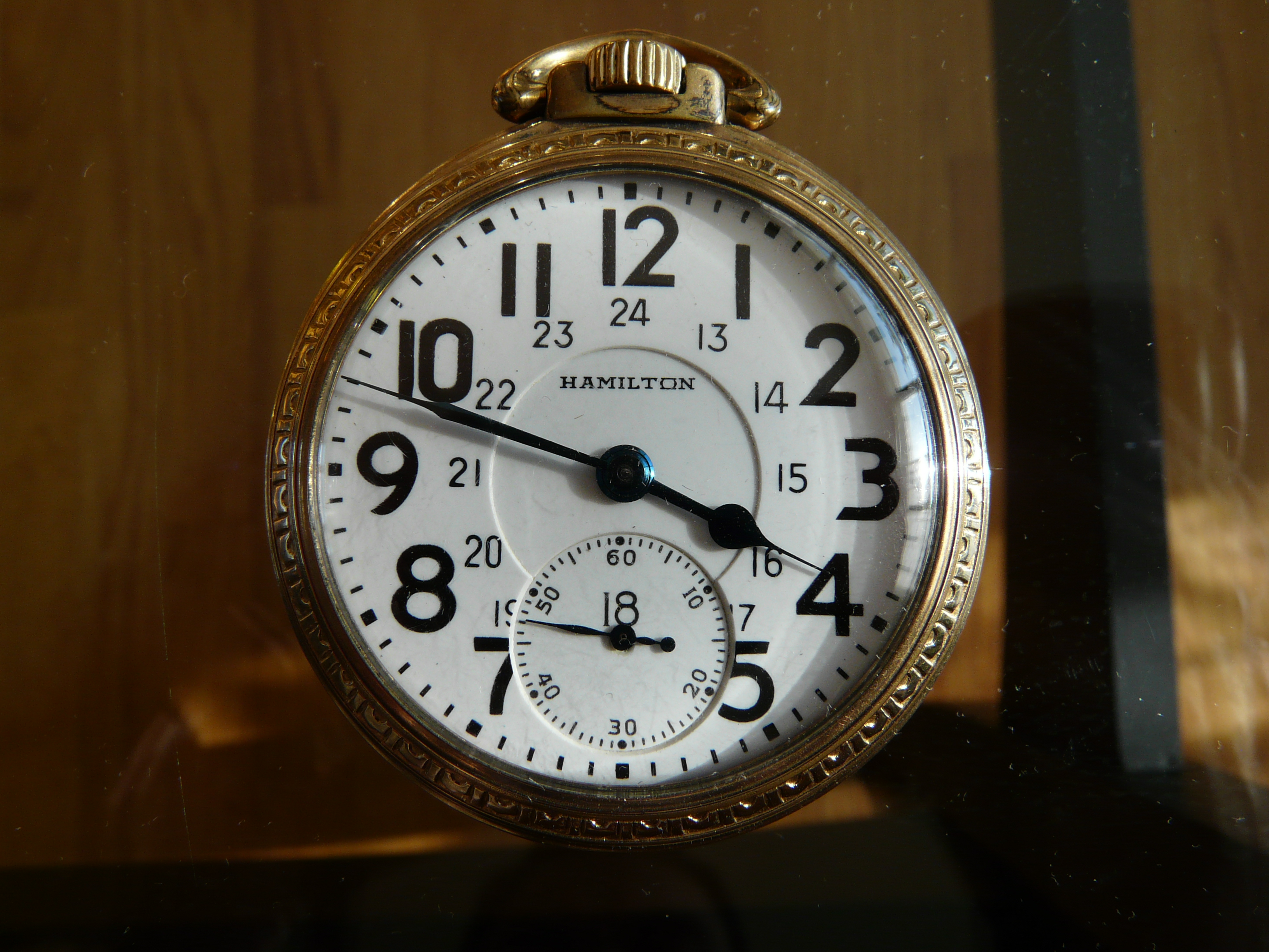

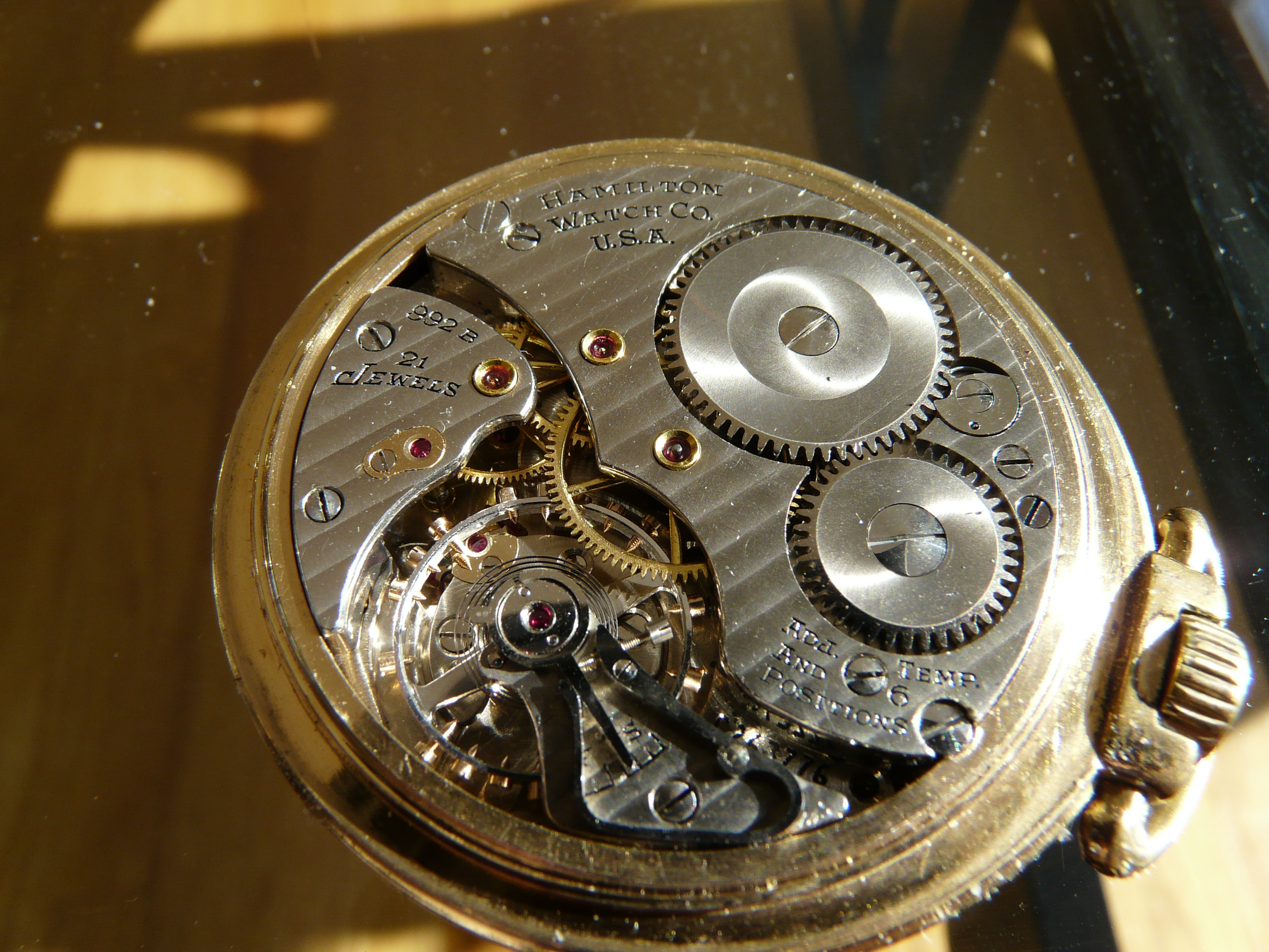

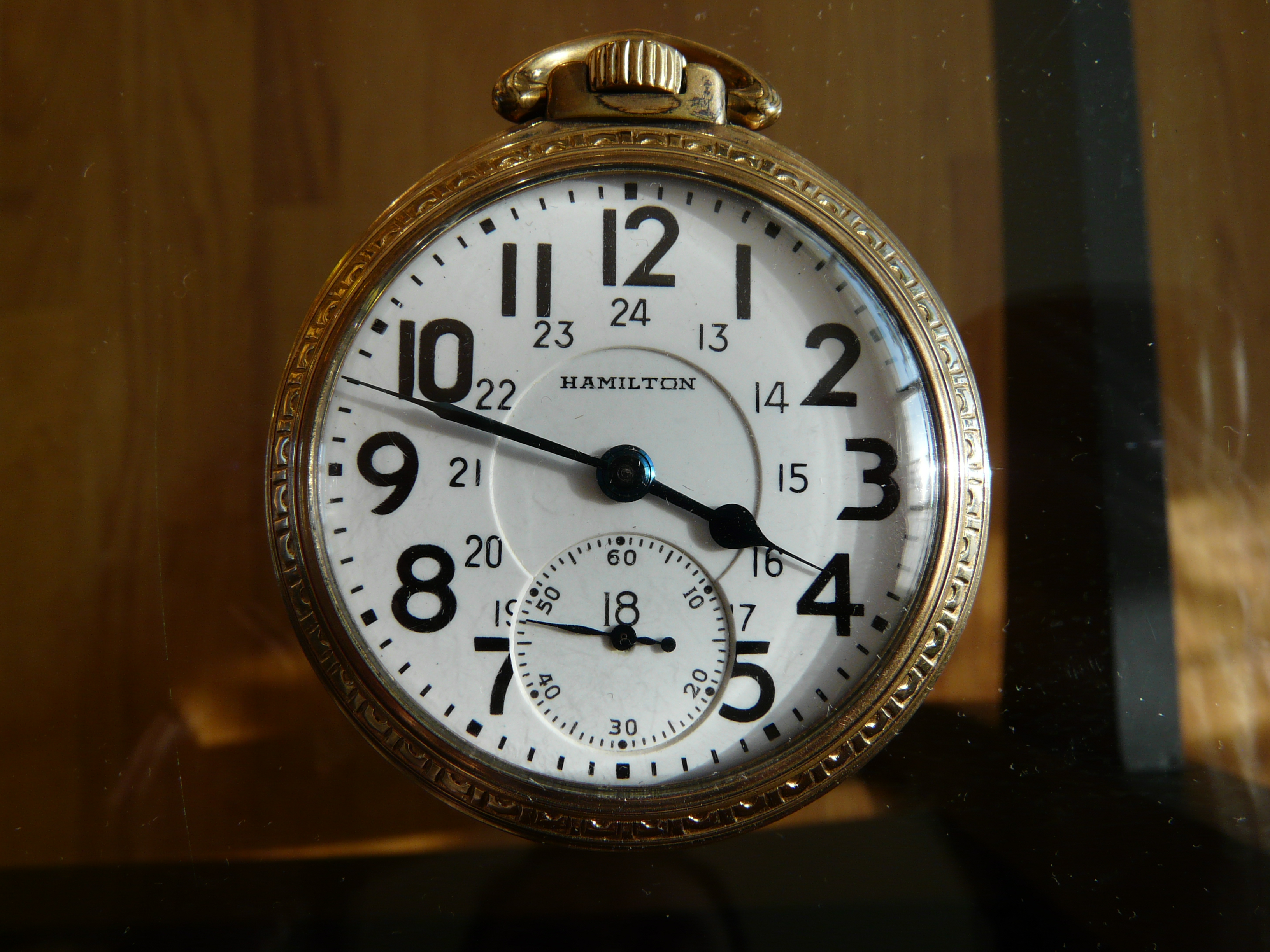

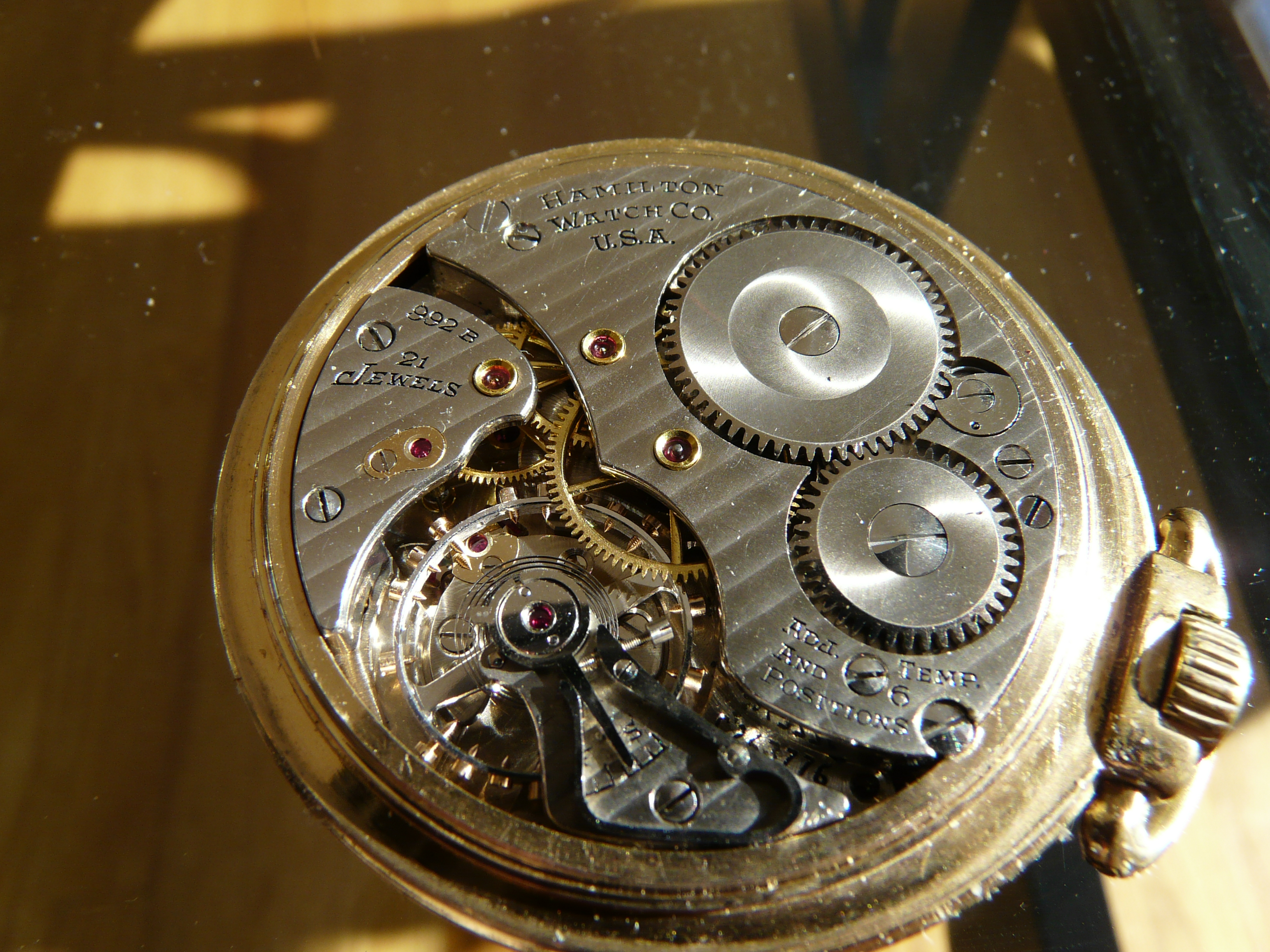

The railroaders watches:
My older brother got Dad's actual Hamilton, mine is a twin I manage to track down, identical except Dad's had the inner numbers in red.

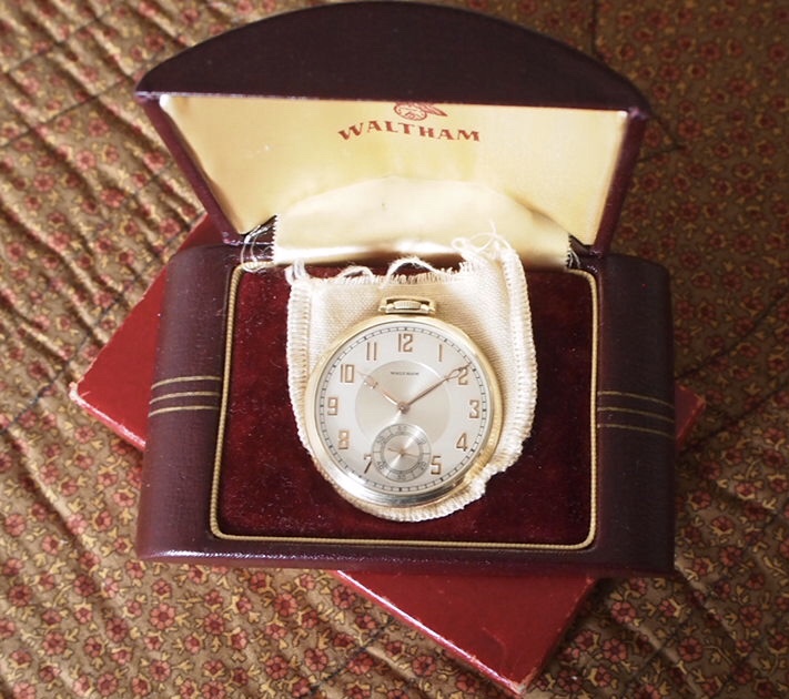

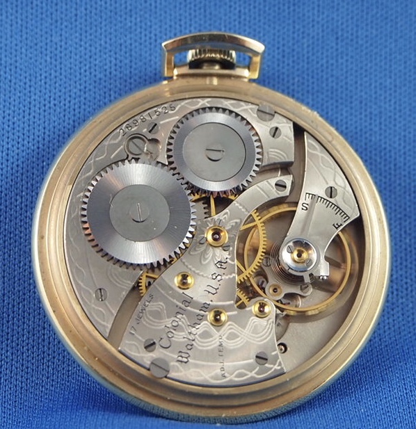

Time for a “bump”, and another watch with a story.

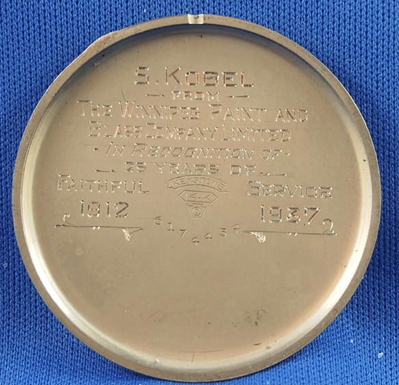

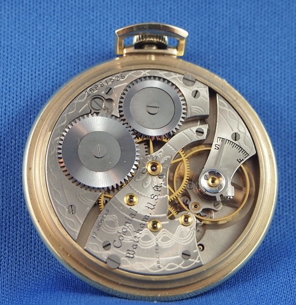

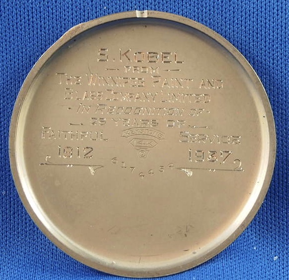

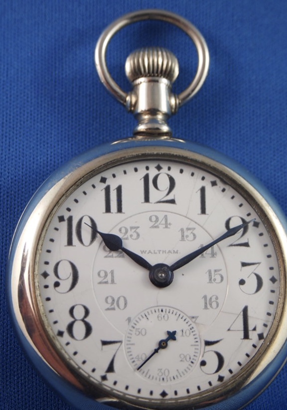

Several years ago, Mrs C. Was perusing an on-line auction catalog, and spied an item she thought might interest me. I looked at the ad, and then went to the preview. This is what I saw! It is a Waltham Colonial, 12-size, 17-jewel watch, 14-karat gold case, in its original leatherette case, with linen sachet marked for the case manufacturer (Keystone), and outer cardboard shell. AND, it had the appearance to me as though it had never been used! It was presented to a fellow on the 25th anniversary (1912-1937) of his employment with the Winnipeg Paint & Glass Co.
The story doesn’t end there! The company was founded in 1902, and suffered a massive fire in 1907 which destroyed their building. It survived until yet another fire in 1959, at which time the Winnipeg branch folded, continuing on in its Saskatoon branch for several years. The firm no longer exists. Here is a picture taken at the time of the 1907 fire.
Every watch collection consists of, well, watches! But to me, the most interesting watches we come by, are the watches with a background story. I might just put my @DaveK lanyard on this one today as I will be out and about. I don’t normally collect many watches of this size, but I think I’m gonna enjoy this one, today.

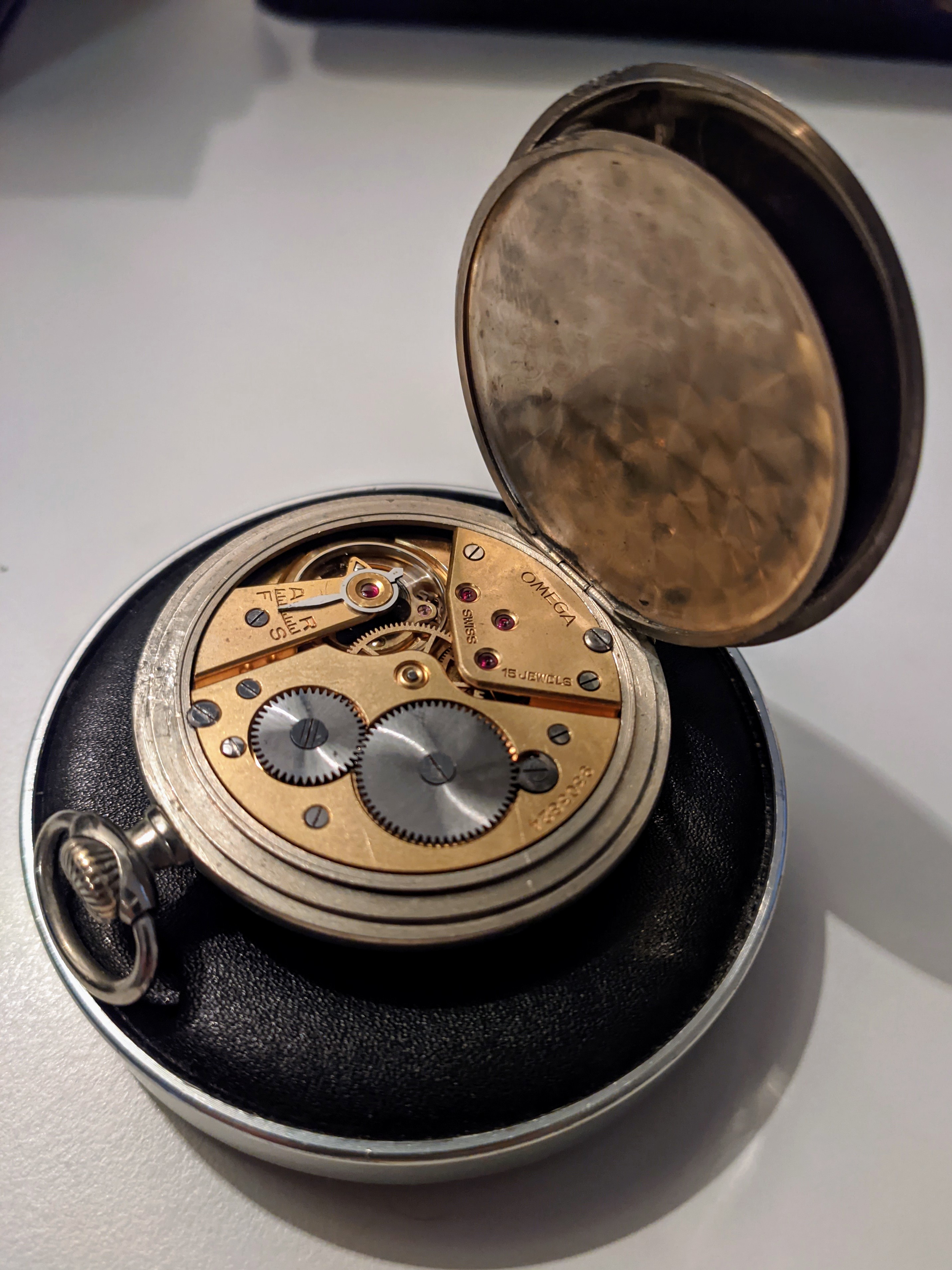

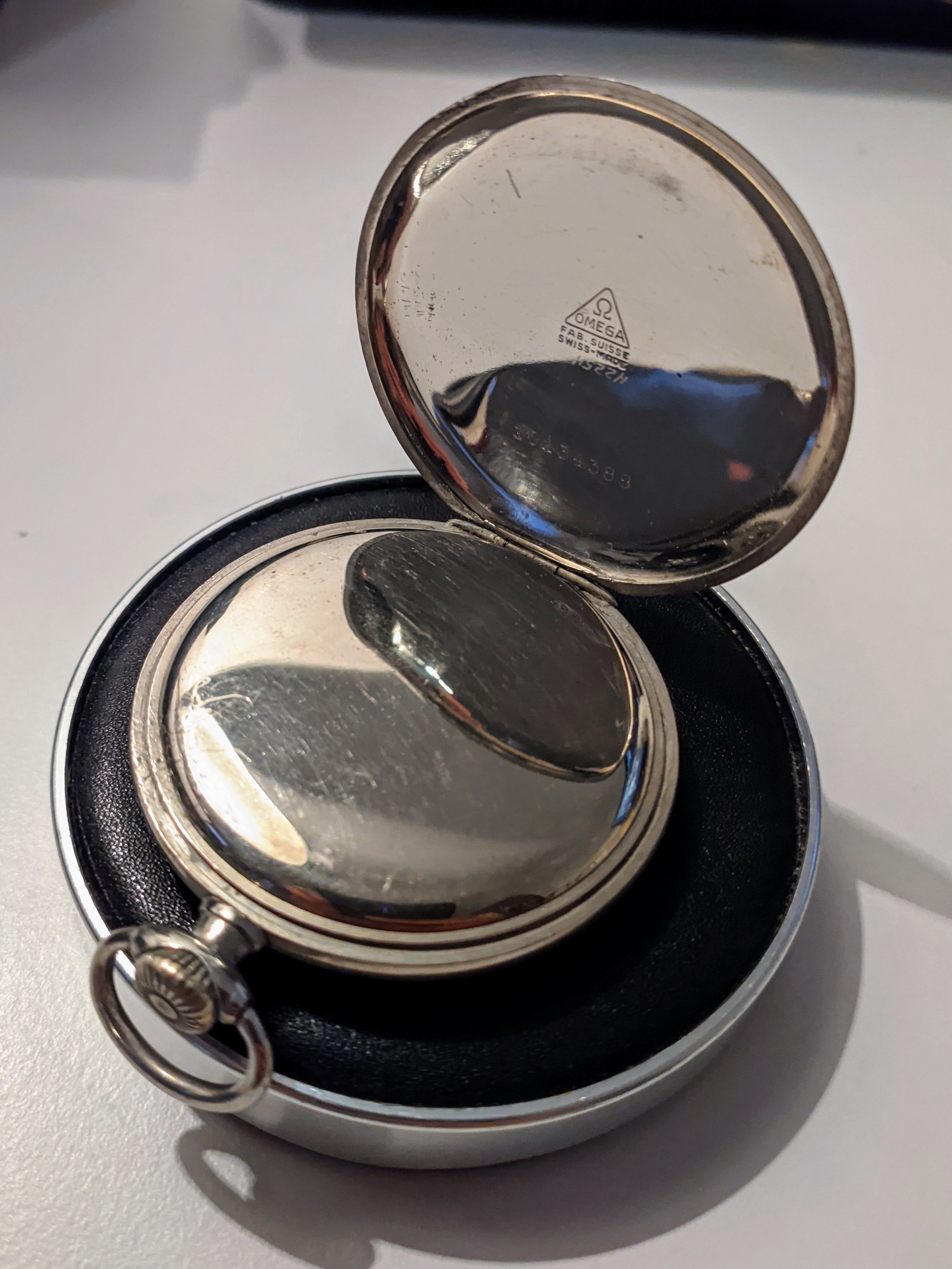

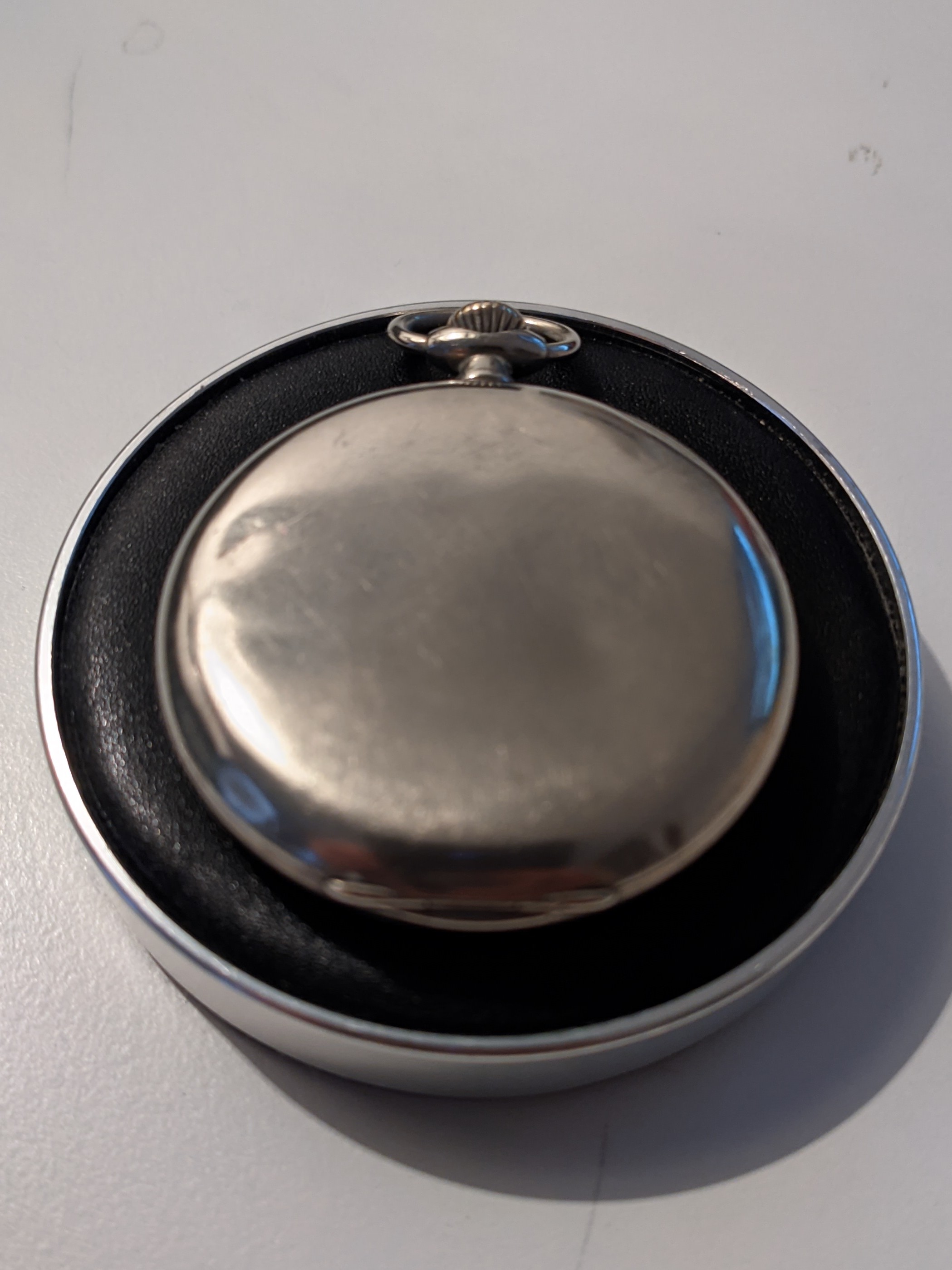

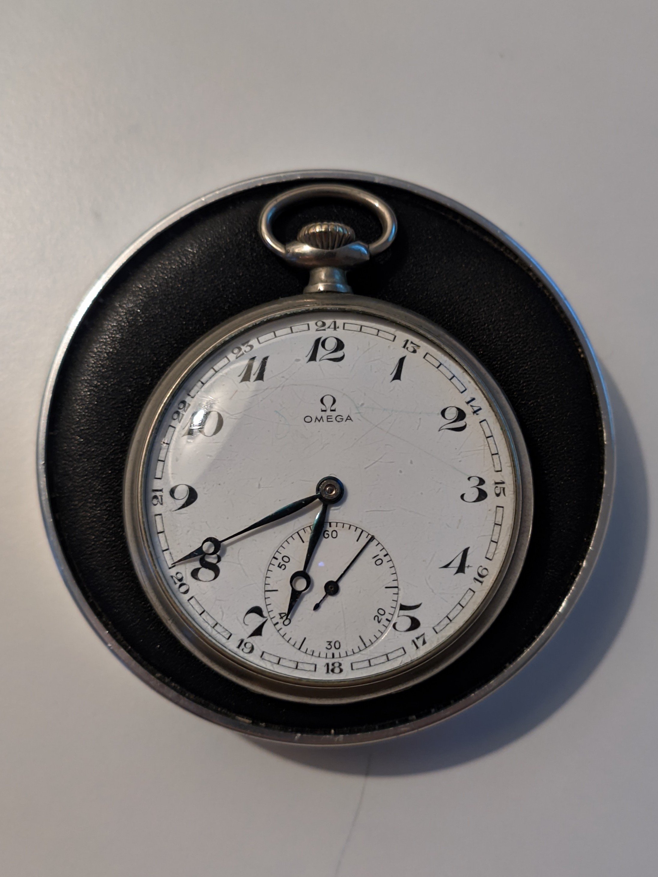

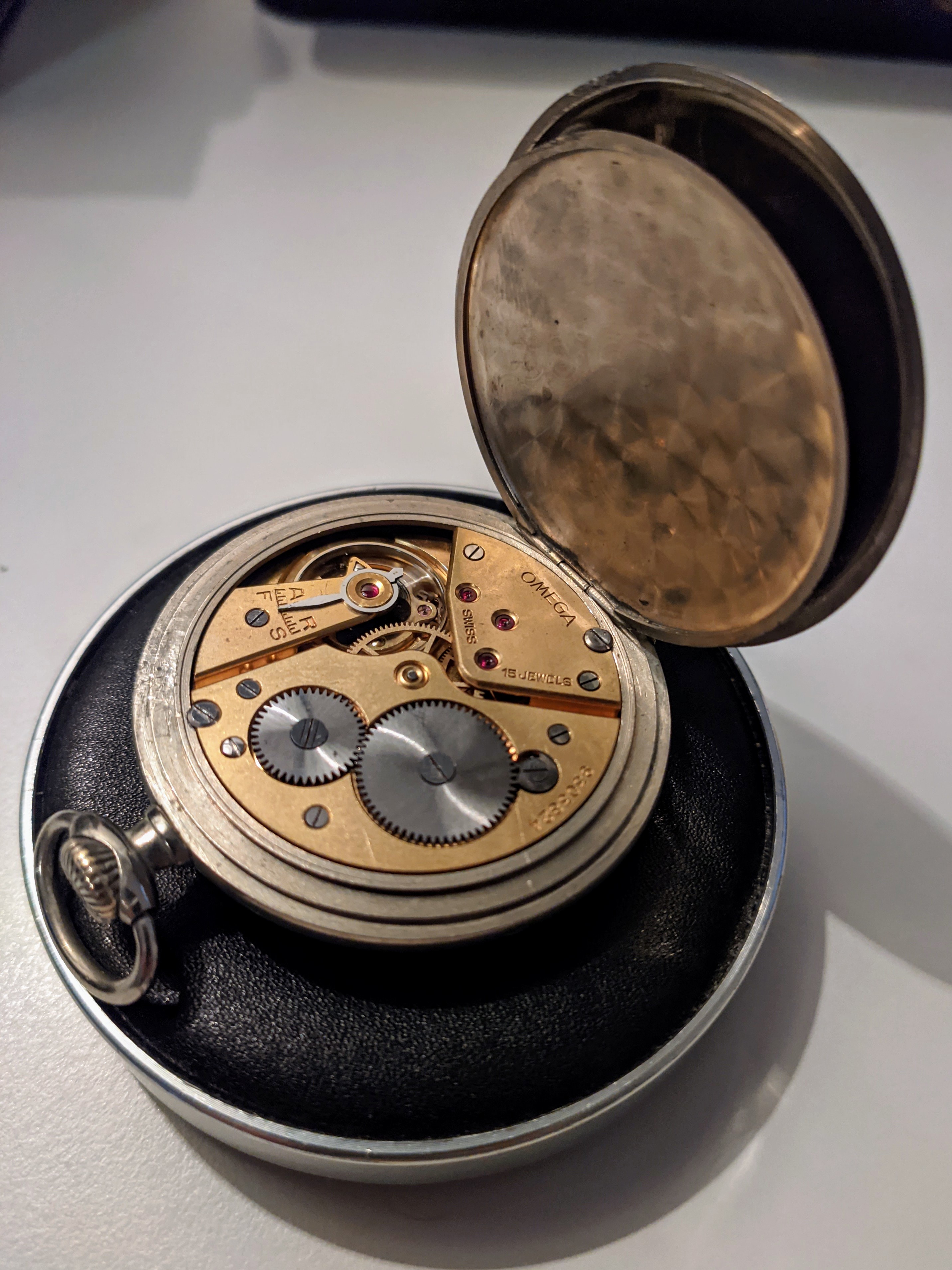

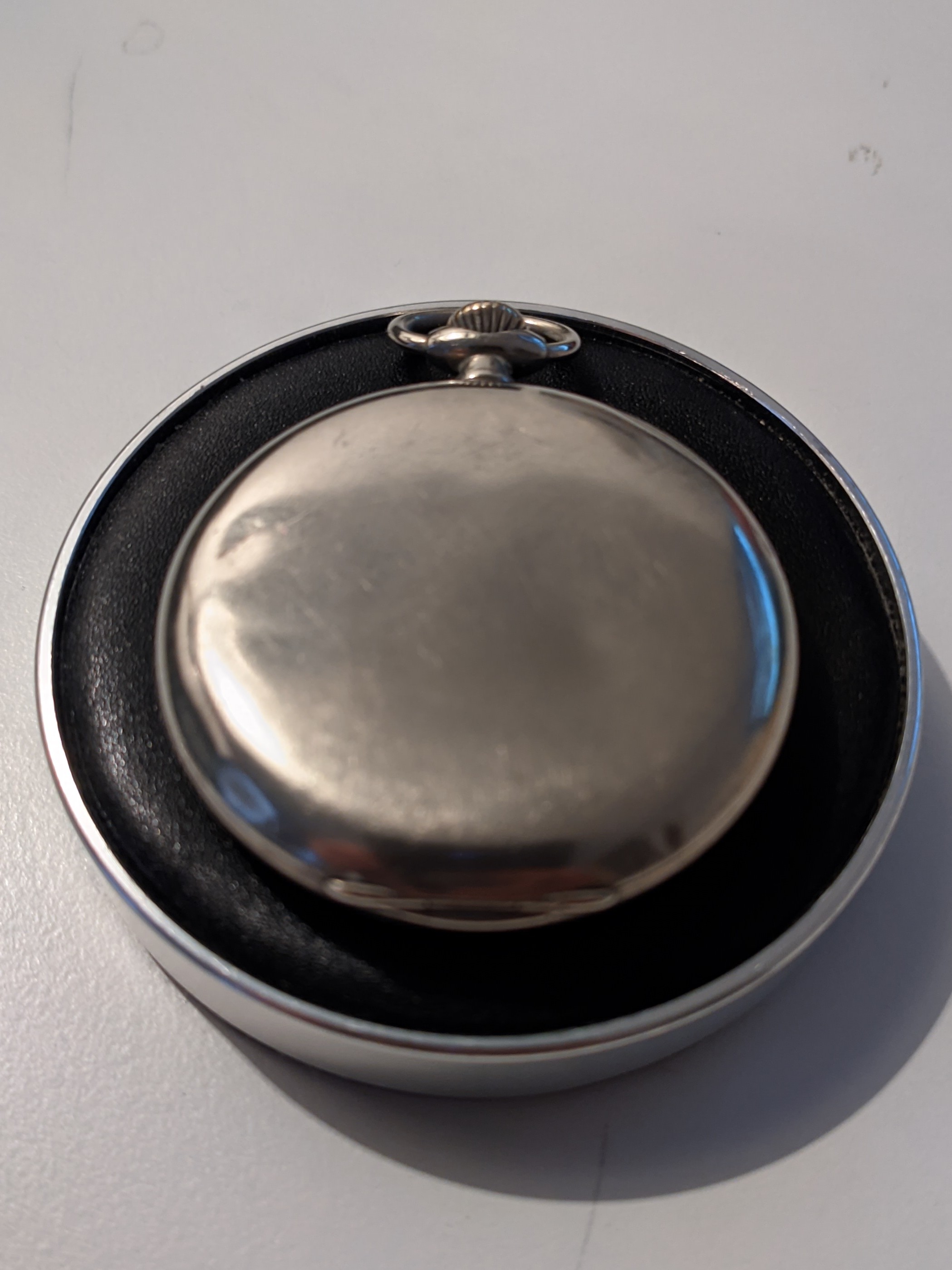

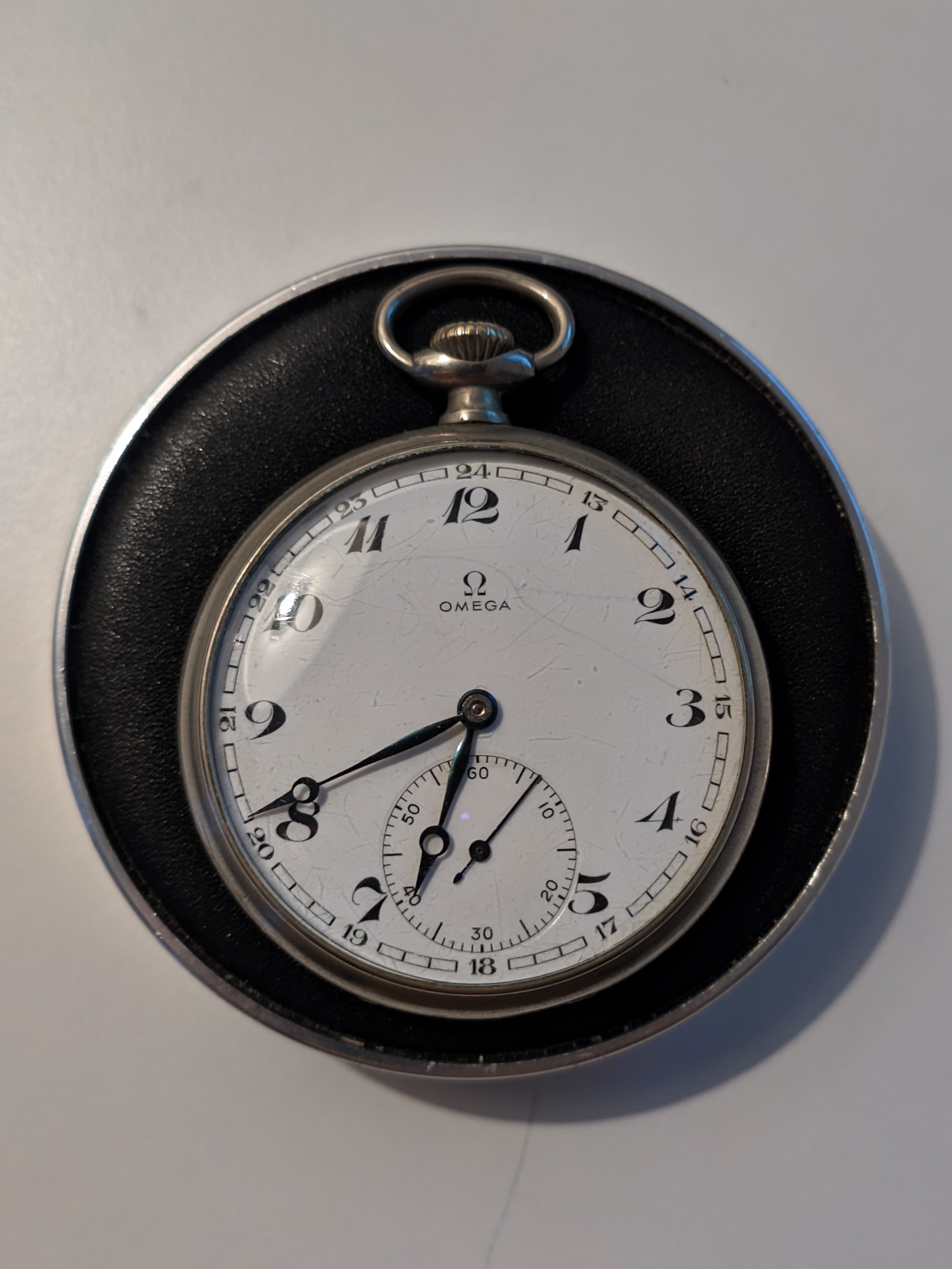

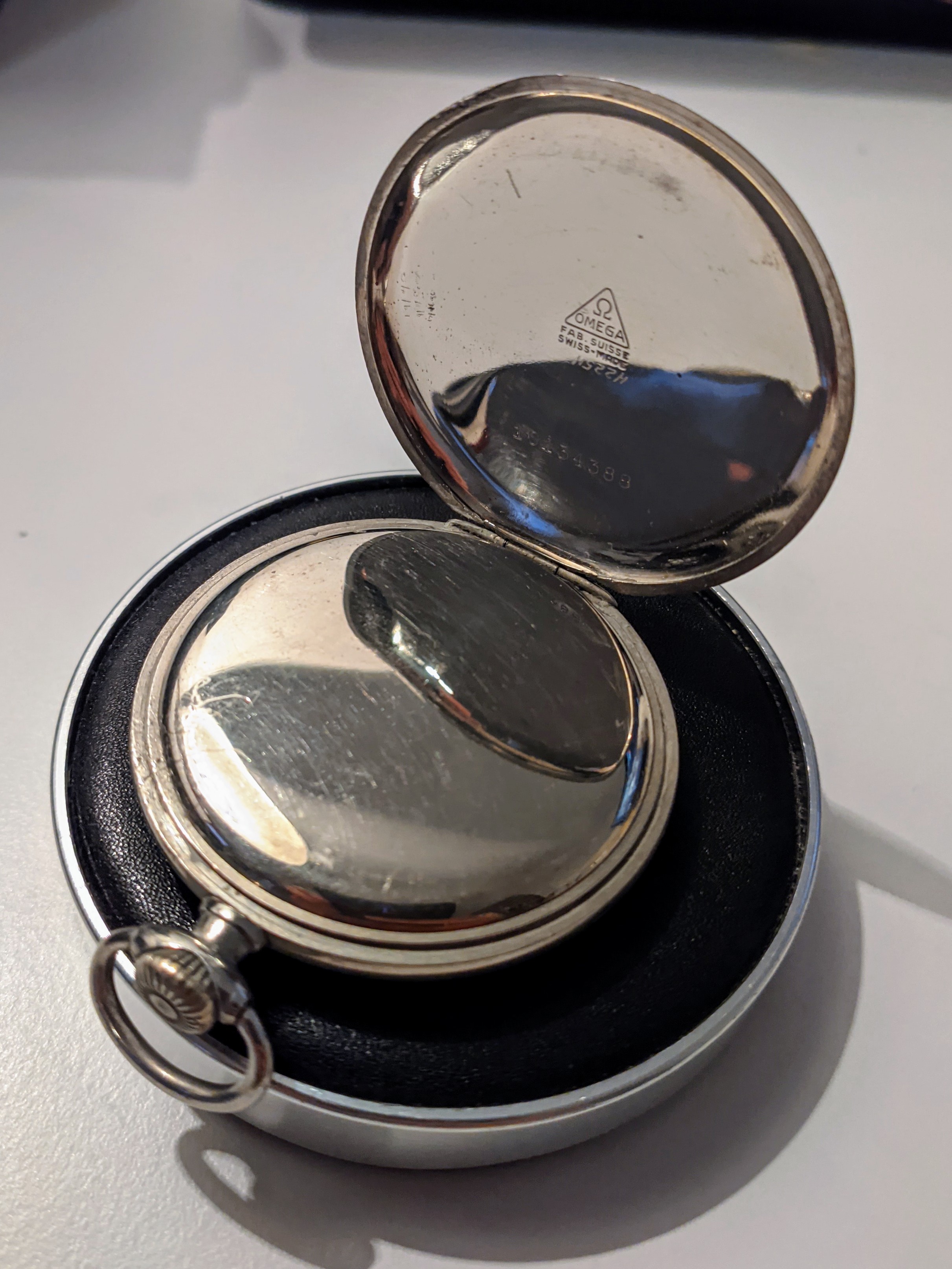

My first one arrived this morning... I'm very happy with my first step into the pocket watch universe. I believe it won't be the last one.
Omega cal 38.5 L.T1 from around 1939 (as from serial number), small hairs on the dial (I understand for some it is a no-go), blue hands, and so far keeping good time.
Mr JimlnOZ did a nice thread on the movement

@LesXL ,
A high percentage of watches of the vintage of your Omega had vitreous enamel dials on them. Basically, opaque glass powder sifted onto a copper substrate, and fired in a kiln at about 1200° F for about an hour. The glass particles melted into a molten state, ad flowed smoothly over the copper surface, leaving what is called a “vitreous lustre”.The dial was allowed to cool, then the numerals, minutes chapter ring, and name were either stencilled, silk screened, or pad printed using finely powdered black glass, and the dial fired again. Then the dial was mounted off centre in a lathe, and using a diamond cutter, a hole was cut for the seconds bit. It was produced just like the dial was. Then, the seconds bit was placed behind the dial, in the opening, and soldered in with bismuth solder which has a low melting point. In several hundred years, a vitreous enamel dial won’t change..........unless the watch is dropped! The enamel is brittle, and can crack. No shame in having hairlines in the enamel dial. If the watch was a car, it could have several hundred thousand miles on it. Stuff happens! If anybody ever pooh poohs you’re Omega, tell ‘em to write their opinions on paper, and put it where the sun don’t shine! No shame! Many of us have watches with hairlines in the dials, and we cherish the watches, anyway. (I have a 104 year old Waltham Crescent Street that is far worse than your Omega, and I cherish it for the story it tells.)
4,046
45,750
@lex
@LesXL ,
A high percentage of watches of the vintage of your Omega had vitreous enamel dials on them. Basically, opaque glass power sifted onto a copper substrate, and fired in a kiln at about 1200° F for about an hour. The glass particles melted into a molten state, ad flowed smoothly over the copper surface, leaving what is called a “vitreous lustre”.The dial was allowed to cool, then the numerals, minutes chapter ring, and name were either stencilled, silk screened, or pad printed using finely powdered black glass, and the dial fired again. Then the dial was mounted off centre in a lathe, and using a diamond cutter, a hole was cut for the seconds bit. It was produced just like the dial was. Then, the seconds bit was placed behind the dial, in the opening, and soldered in with bismuth solder which has a low melting point. In several hundred years, a vitreous enamel dial won’t change..........unless the watch is dropped! The enamel is brittle, and can crack. No shame in having hairlines in the enamel dial. If the watch was a car, it could have several hundred thousand miles on it. Stuff happens! If anybody ever pooh poohs you’re Omega, tell ‘em to write their opinions on paper, and put it where the sun don’t shine! No shame! Many of us have watches with hairlines in the dials, and we cherish the watches, anyway. (I have a 104 year old Waltham Crescent Street that is far worse than your Omega, and I cherish it for the story it tells.)
Thanks so much for the very interesting explanation on the dial fabrication and encouragement on my invitation to the Dark Side! This thread should actually be pinned *hint hint*
I actually do like the hairlines, it reminds me of faïence tiles with cracks that is something I really like.
Obviously, I wouldn't say not to a totally clean dial 😀
I, now, need to find a nice lanyard... I wonder who could help with that? (@DaveK )
I shall continue my reading of the thread to get better knowledge on any potential future acquisition.

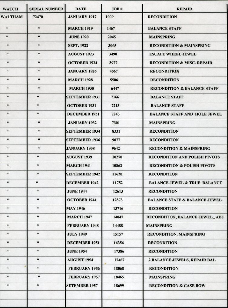

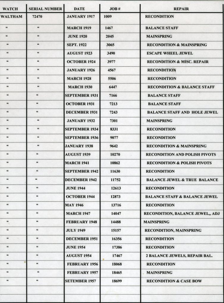

Here is the heavily hairlined dial on my Waltham Crescent Street. This watch began its service in 1918, as the only watch used by its original owner who retired as a locomotive engineer with the CPR, after working for them for 45 years. I have shown the watch, and also a printout showing 32 repairs the watch had over those 45 years. Over those years, the record shows that the watch had about 5 new balance staffs, and numerous occasions where pivots were repaired, and the balance wheel trued. The hairlines on this dial are a badge of honour, and mute evidence of the job this watch did for the owner, over all those years! He dropped his watch LOTS! Who fixes anything 32 times, now-a-days? This isn’t just a watch, it is a symbol! I love it, and it is now mine!
Notice, four balance staffs between March of 1930, and December of 1931! Whew! See what I mean about the stories pocket watches can tell?
Great watch and quite astonishing to have all the details of its (hospital) life.
