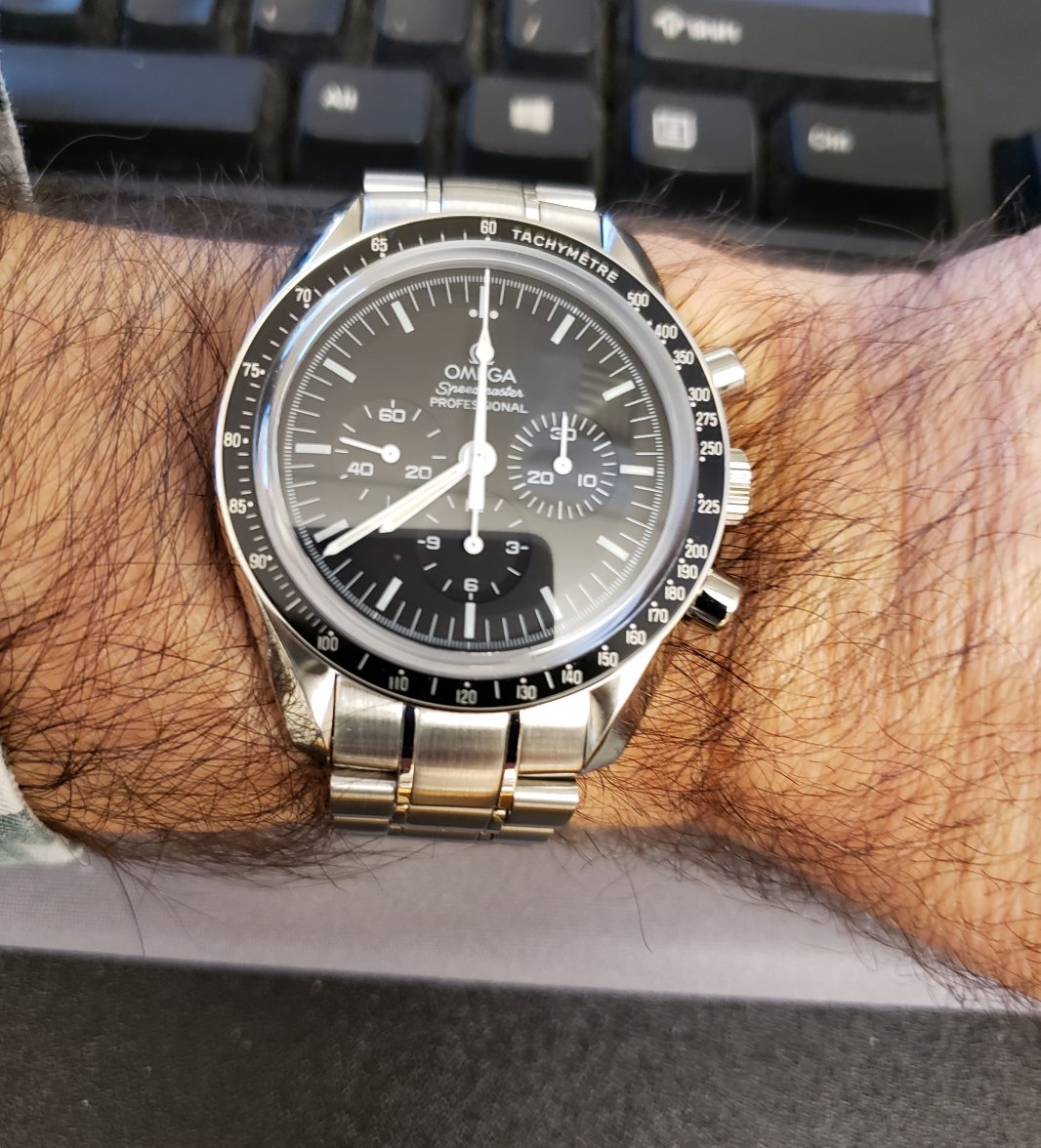

I was sizing my new speedy last night, and boogered up several of the screws trying to get them out. I also boogered up my inexpensive screwdrivers (OK, they're cheap) and had to take a file to one of them to try and save it.
Of course, every time I do this, I think "I don't need to buy new screwdrivers, as this will be my last xxxxx watch" which of course, never holds true.
The screwdriver that worked almost perfectly, but just a smidgen too wide, was marked with "5/64" which is, I'm guessing, equivalent to a 1.9mm but I wonder if that may be too fat or if it's even available. It would not be a bad investment for me to get a properly sized, well made screwdriver (like a Bergeon) as the Rolex guys rave about them. I believe 1.6mm is the Rolex size, can anyone direct me as to the correct size for the modern Omega bracelets? And any recommendations as well, please, as I don't want to be buying some cheap Chinese knock-off.
Thanks!

Thanks @PhilF and everyone else... I did order the correct size from Esslinger (along with a 1.6 in case I ever buy another Rolex) and moved the clasp around on the bracelet... soooooo much easier with the correct tool, no buggering-up (LOL @Evitzee thanks to you too) of the screws either.
