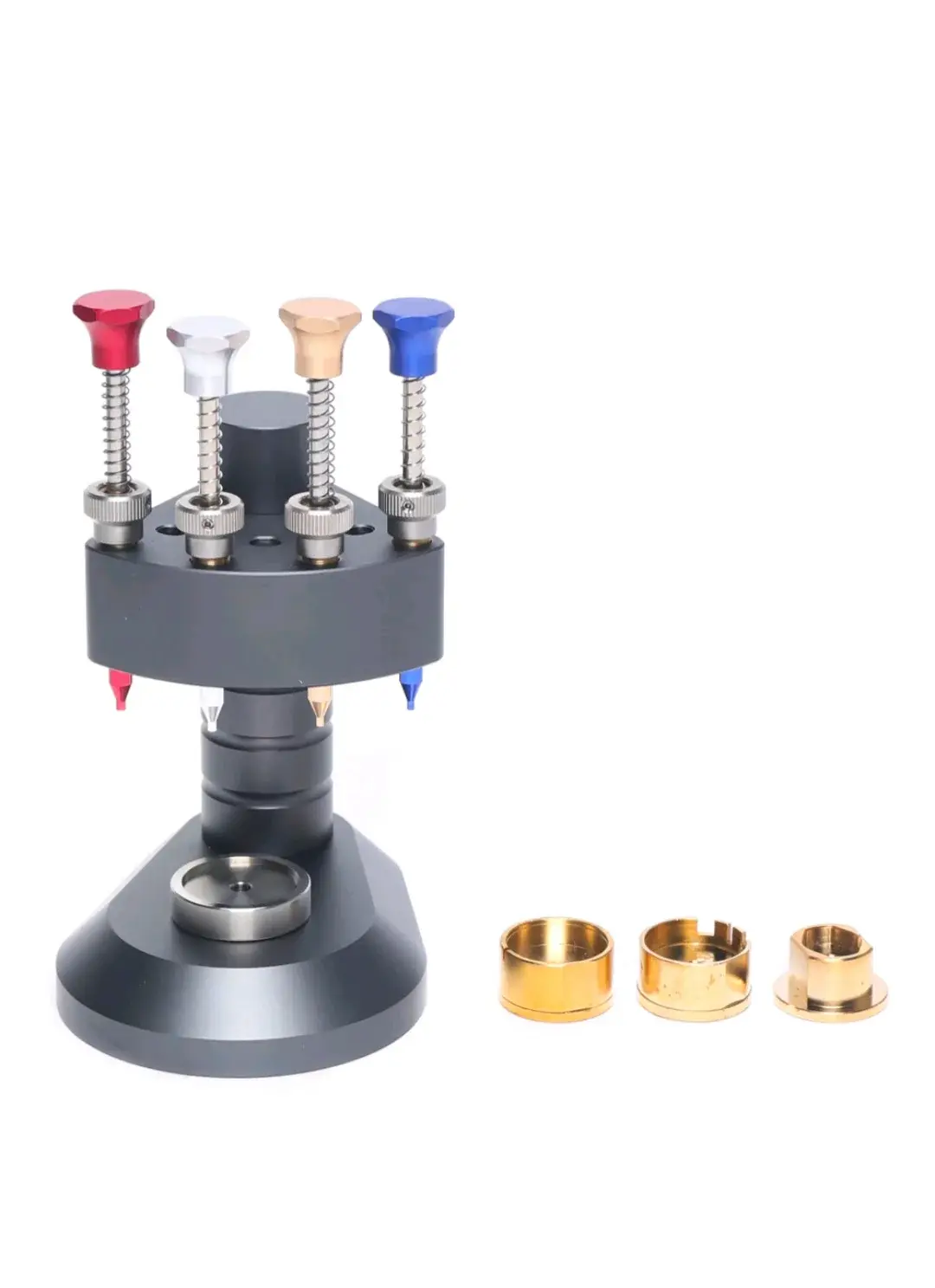

For anyone who comes along next time: The 'chinese' hand setting tools that come with the 1996-style movement holders for hand setting, the one sold as "3135" works perfect for the 1035 movement (and thus the 1030/etc). it fits perfectly around a spot on the movement and holds the movement in place, and the little support works perfectly! Fortunately, the 3135 comes with a lot of the 'basic' kits, so you might already have it!
I figured I'd post to let folks know 😀
Thats good info, I was wondering as well if that 3135 would fit. In the end I just got myself the Bergeon 12 1/2 which I can confirm to be working perfectly. Since I work on a lot of cal. 1000-1030 that is definitely a game changer and a necessity.

Any pics or links?
I don't recall where I got it, but I picked up one of these (in about this configuration) and get good use out of it:
https://ebay.us/m/DDnVnm
You can get them cheaper of course, but it does a good job, though I usually just use a 4040 when using it.
However, the 3 movement holders mine came with (about $20 each separately?) come in handy sometimes. Mine came with a 3135 that was perfect here.
