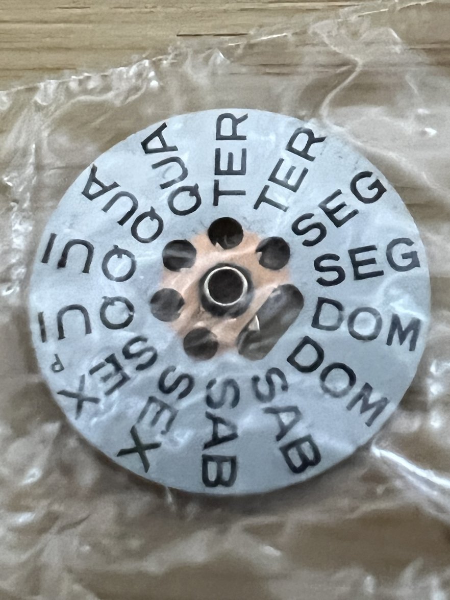

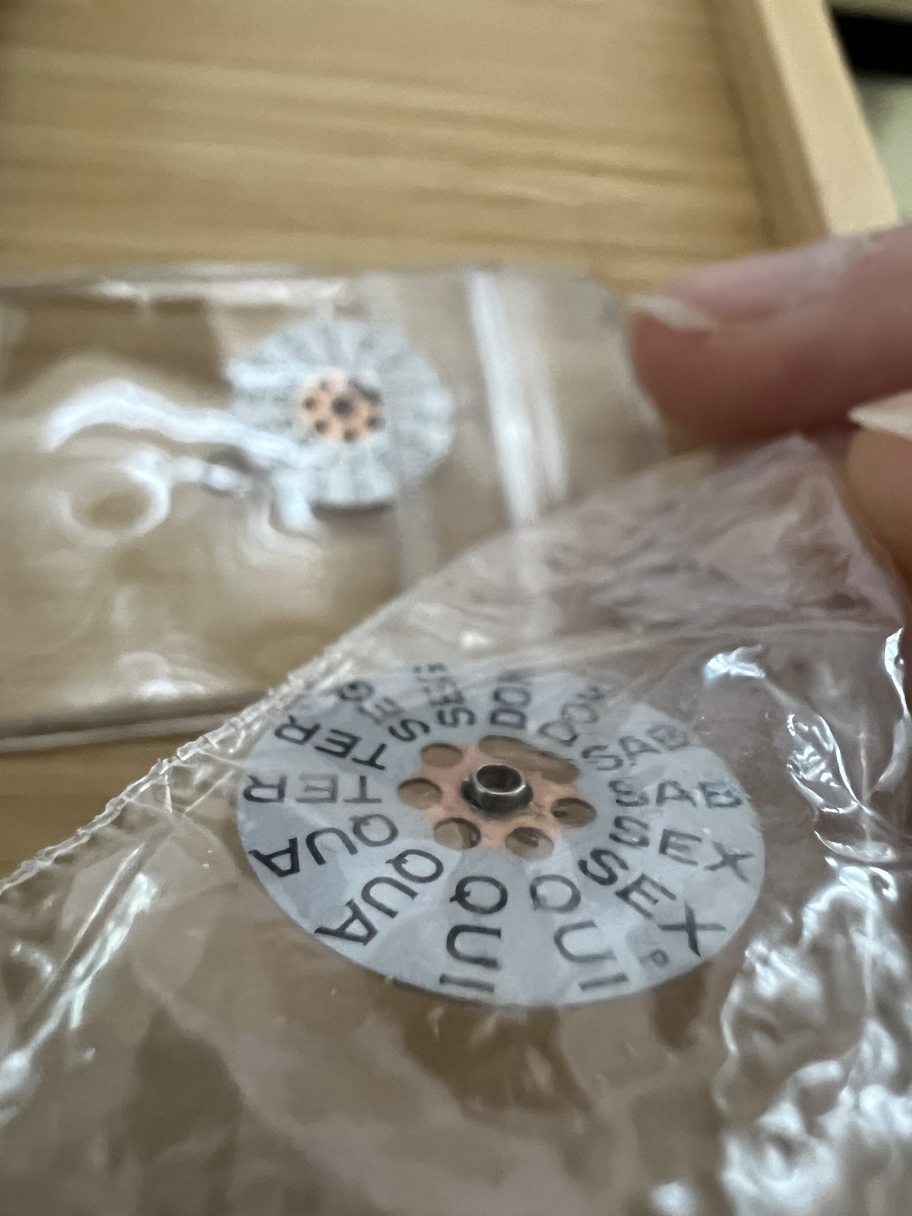

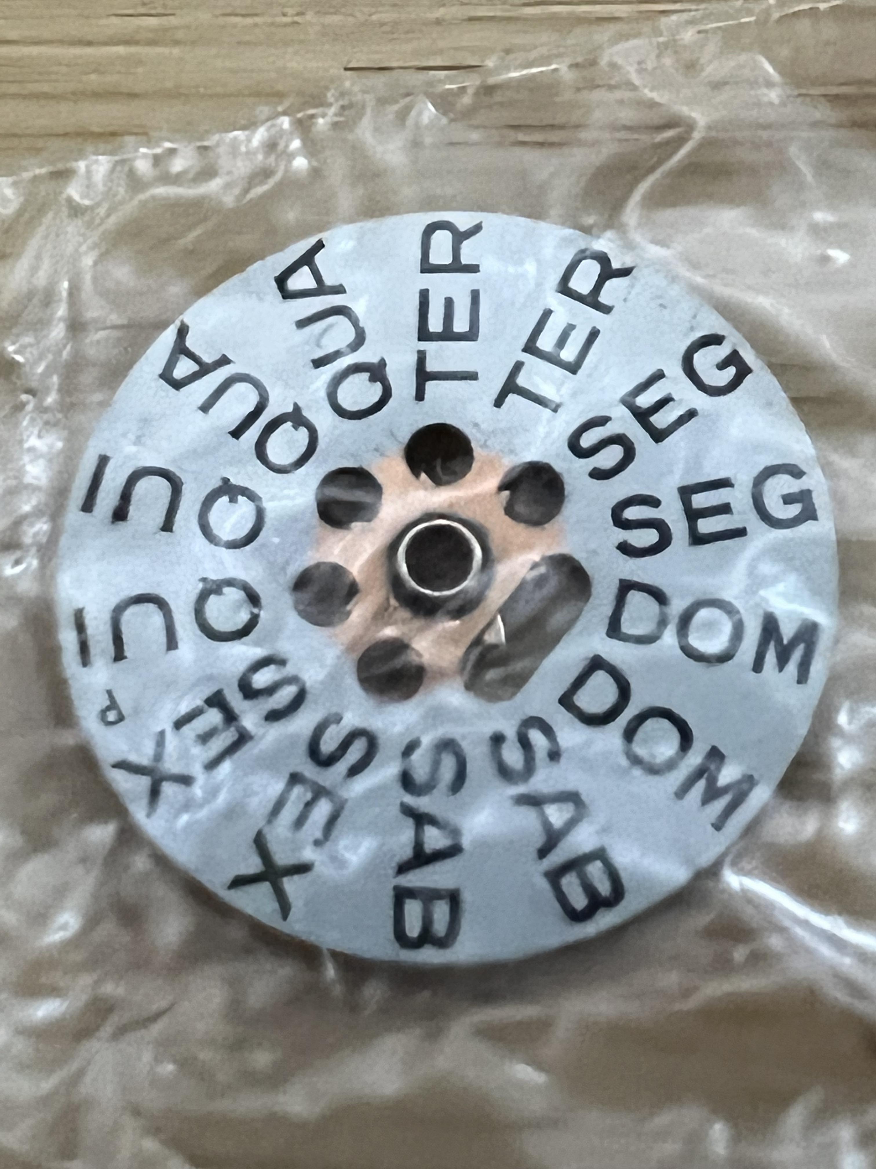

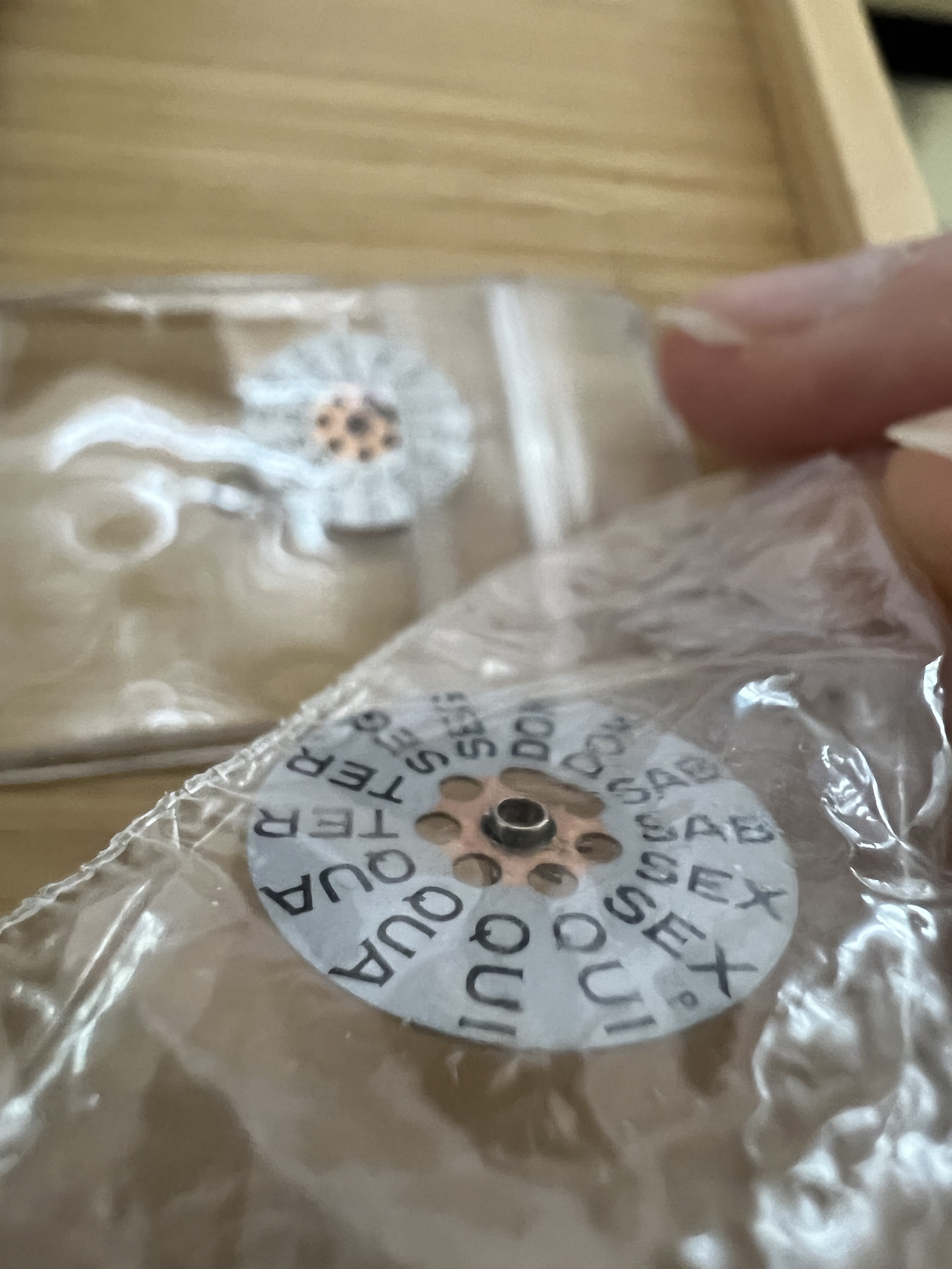

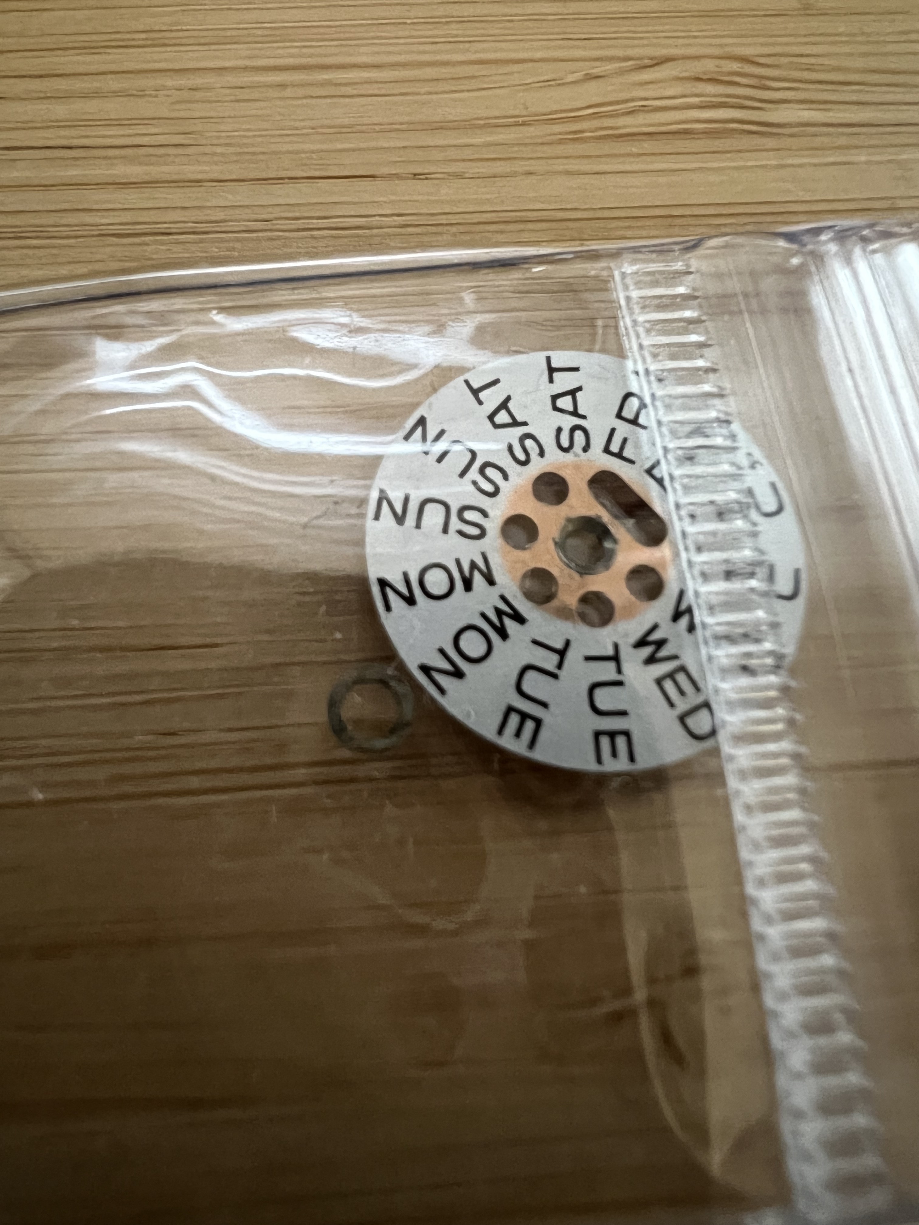

Correct me if I'm wrong but here's my theory, I believe there are 2 models for these, flat/older design that needs a washer and a newer design with a spacer
This is the flat one and the washer:
This one is I believe similar to the one in the video:
With the spacer protecting it:
It was my theory that the spacerless older design could be more prone to cog slips as well
Edit: Or could it be a 752 vs. 751 thing with the 751's getting the better designed part? I didn't pay attention to where the parts came from, the serial years etc.

I think you might be onto something @kaplan looking at both of my day dials they are these ones with the raised inner lip/flange, I had been thinking that a dial washer here would really introduce a lot of power drain at midnight when all of these indicators need power to change, so perhaps the older design with the dial washer was changed because of this?
After learning that there are 4 revisions of the date indicator driving wheel, I take a bit longer to investigate instead of just going with what a photo copy of a print from 1967 says.
I can’t see clearly what the “washer” is in your first photo, but as I said these don’t use a dial washer.
The day indicator was redesigned to extend the pipe as your second photo shows, and this was deemed a mandatory replacement part in 2015. So this is a relatively new change that applies to all versions of the movement.
