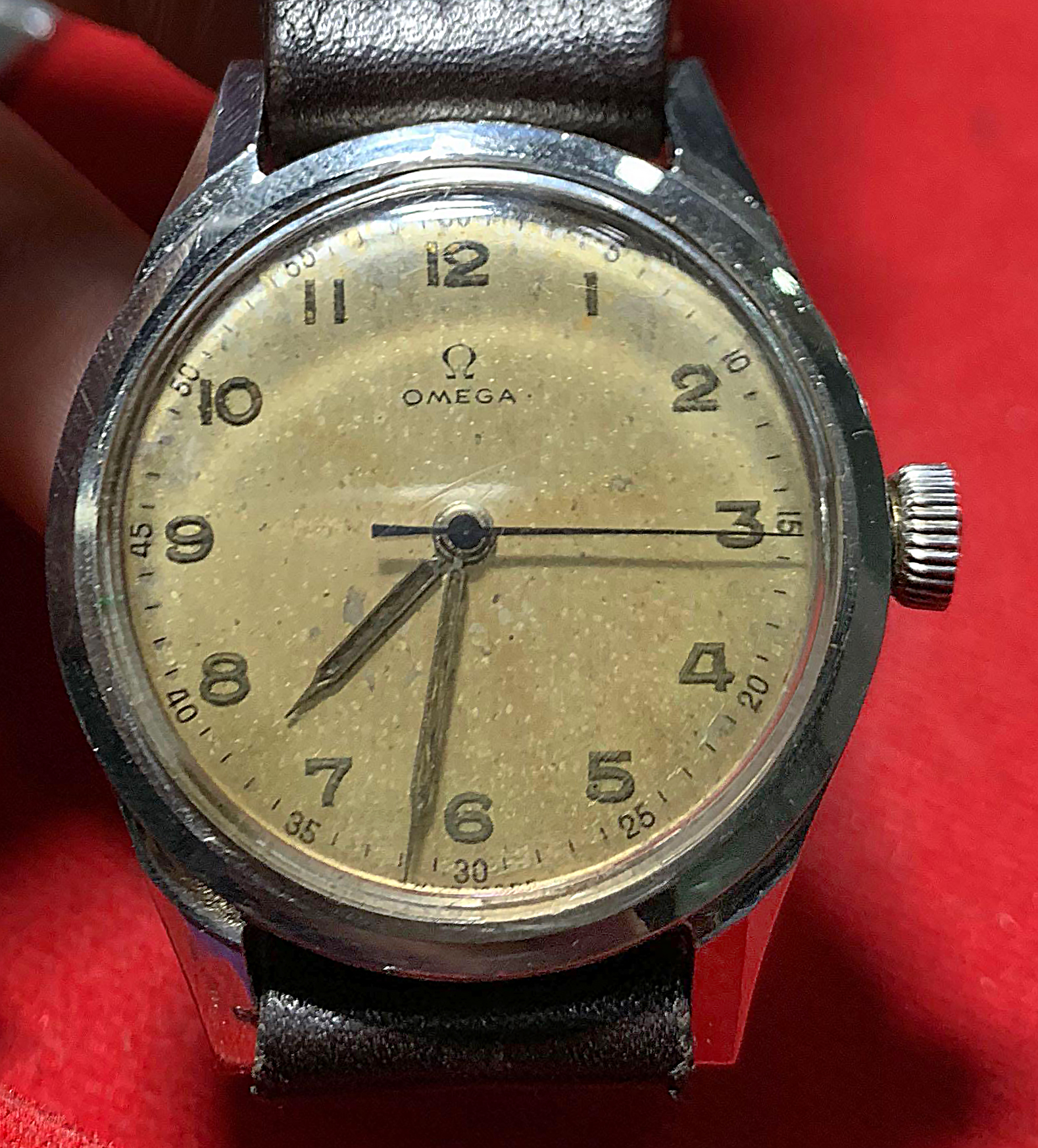

What are your thoughts on this piece? Thinking of getting myself my first vintage for my birthday.
I know the photos aren't the best but hope that I could get some input on whether this checks out as authentic.
Any input would be much appreciated.

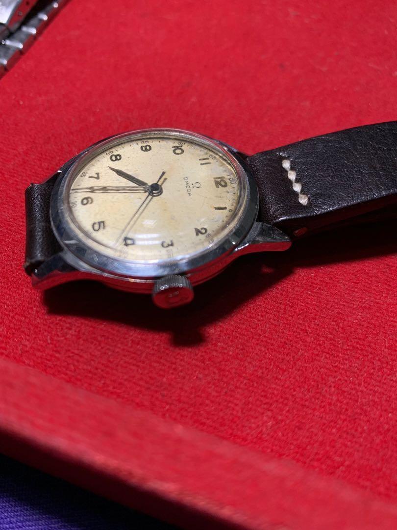

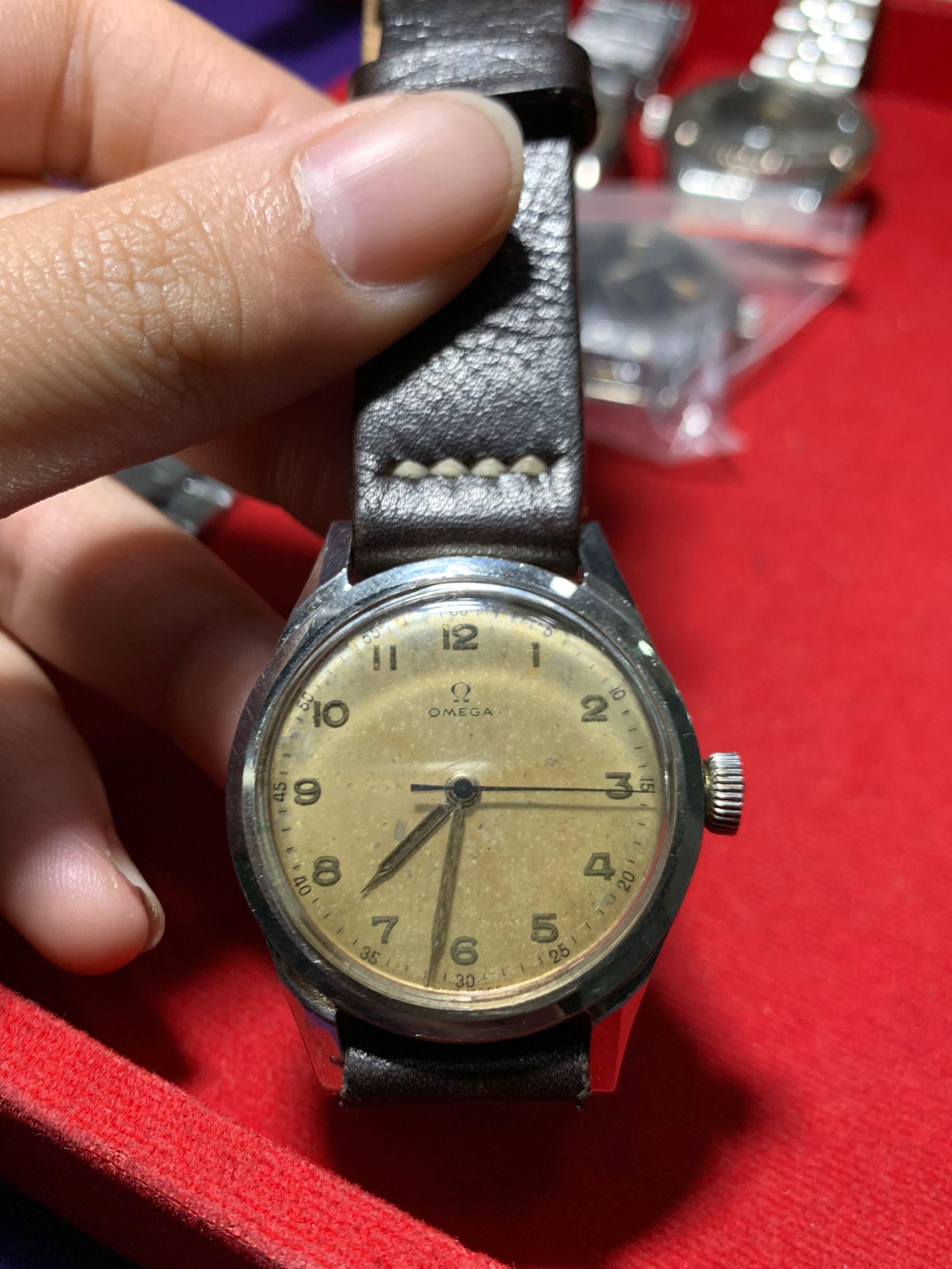

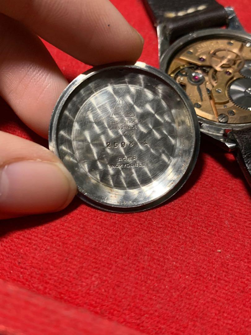

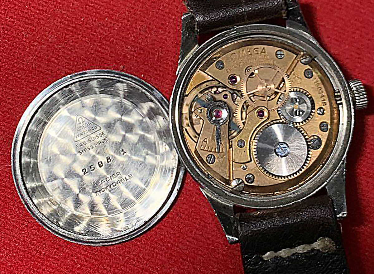

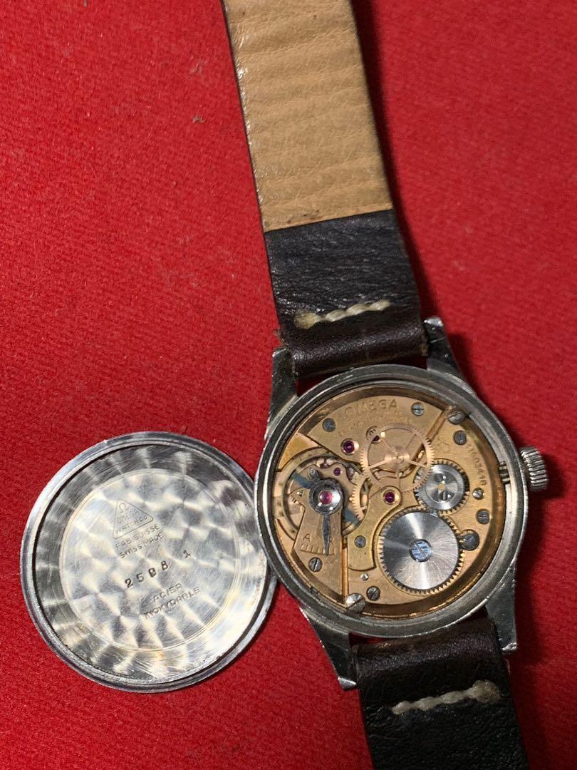

I dont remember having seen one in real life. But I asses it as all genuine. The dial with hands and the radium numerals looks correct and it has the overall apperance of a genuine vintage watch. The case is rather graceful and unusual. I think it´s about 33 mm excluding the crown. The dial is rather deteriorated but I find it acceptable. Lovely minute markers by the way! Crown is signed and I think it is correct. Movement looks correct as well, with a serial from about 1947 (116.....) No shock protection.
I enhanced a couple of the pics and notice the size as mentioned. It is a small watch.
