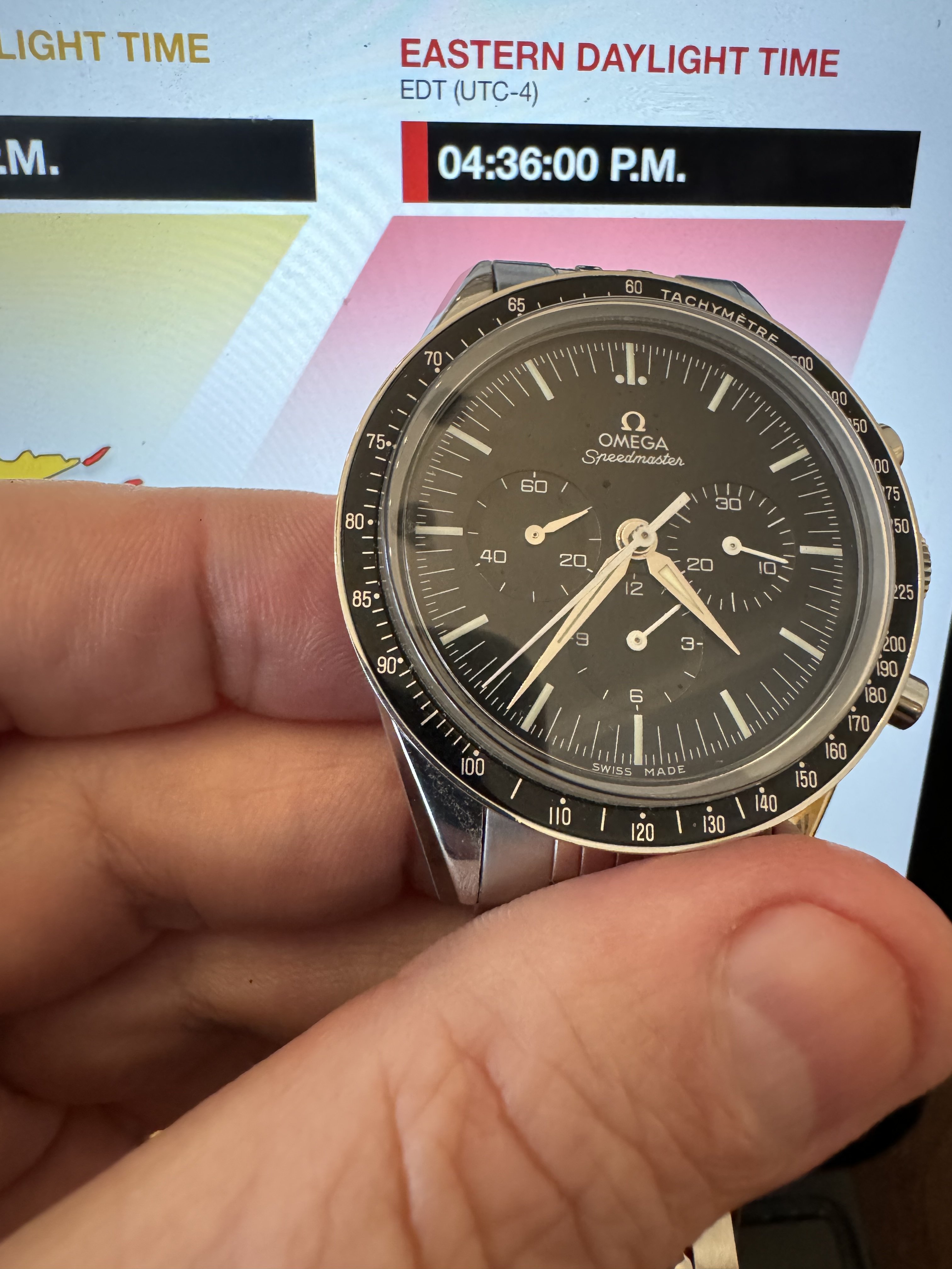

Whenever I see a post saying their watches timing is off, I always wonder how they calculated this, what time standard they used, etc. Unless you have a good timegrapher with the proper settings, you have to look at the time on your watch compared to a time source. And on the 1861, it’s even harder because you can’t hack the movement.
I take a pic of my watch in front of my browser on the time.gov page, like this:
So here, my Speedmaster is a little over 10 seconds fast. I do this occasionally, then look at the time difference between pics and calculate the deviation. I rarely do this, though.
To the question of the potential accuracy of the 1861, I got this back from my watchmaker 6 days ago, a set it as best I could to “0” (really, probably a second or two off). Thus, it has gained about 2 sec/day, which I’m perfectly happy with.
6,487
31,960

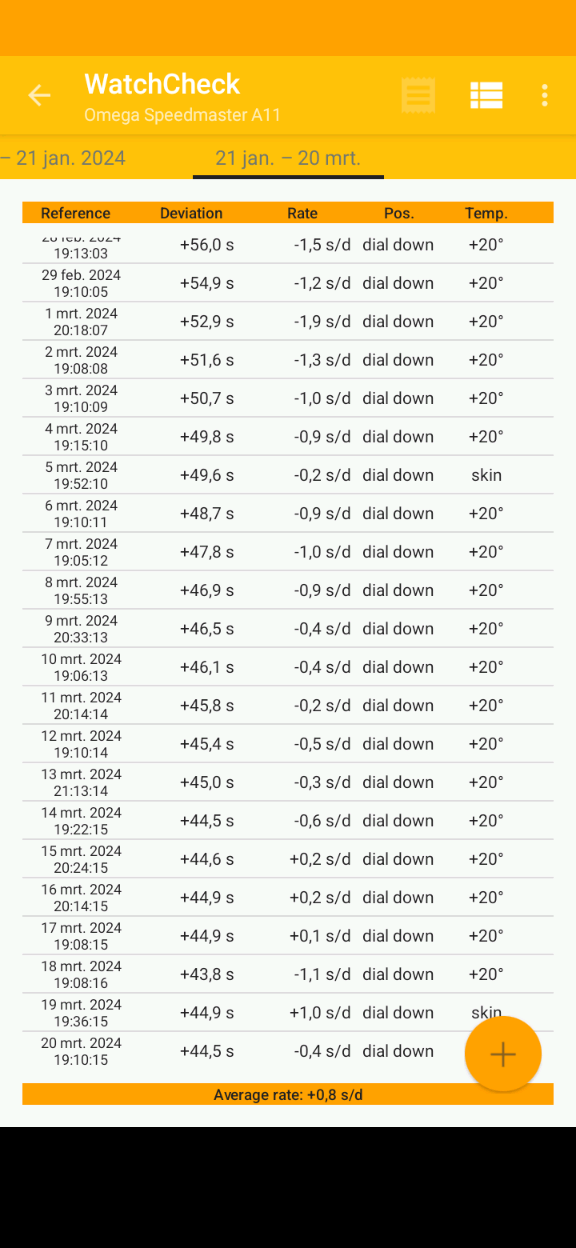

For Android there's the watchcheck app which records the deviation;
2,816
3,747
But the WatchCheck app simply determines a time standard (either from the internet or GPS) and keeps track of the time difference, but you still have to manually insert the time offset by visual inspection. And that’s why I use a photo, because it’s easier to tell the exact offset.
