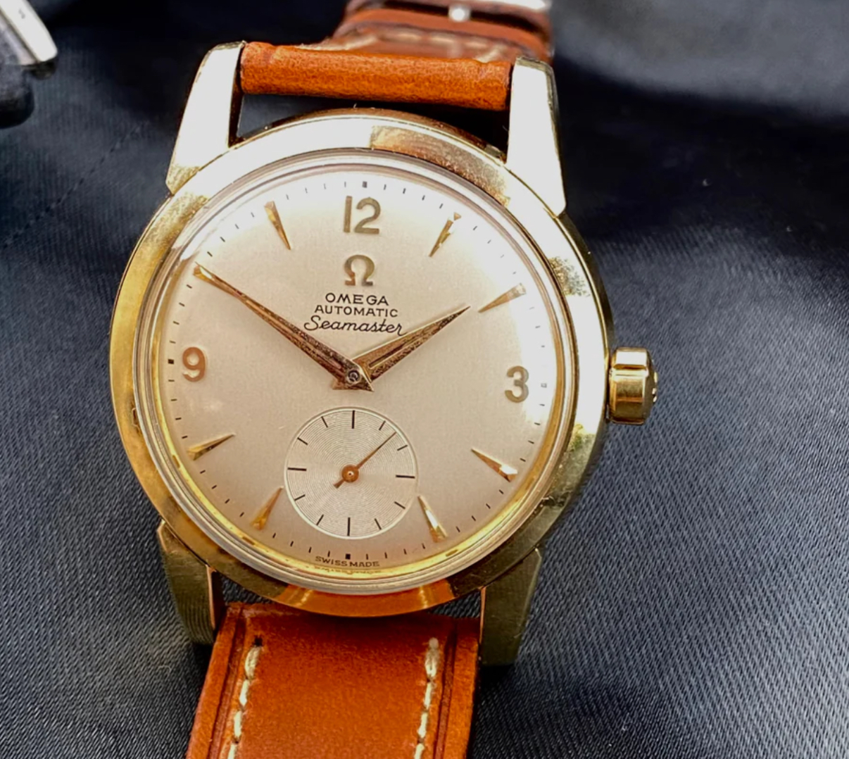

I inherited my grandfather’s vintage Seamaster, sadly it was stolen from my home in West London in the 1990’s.

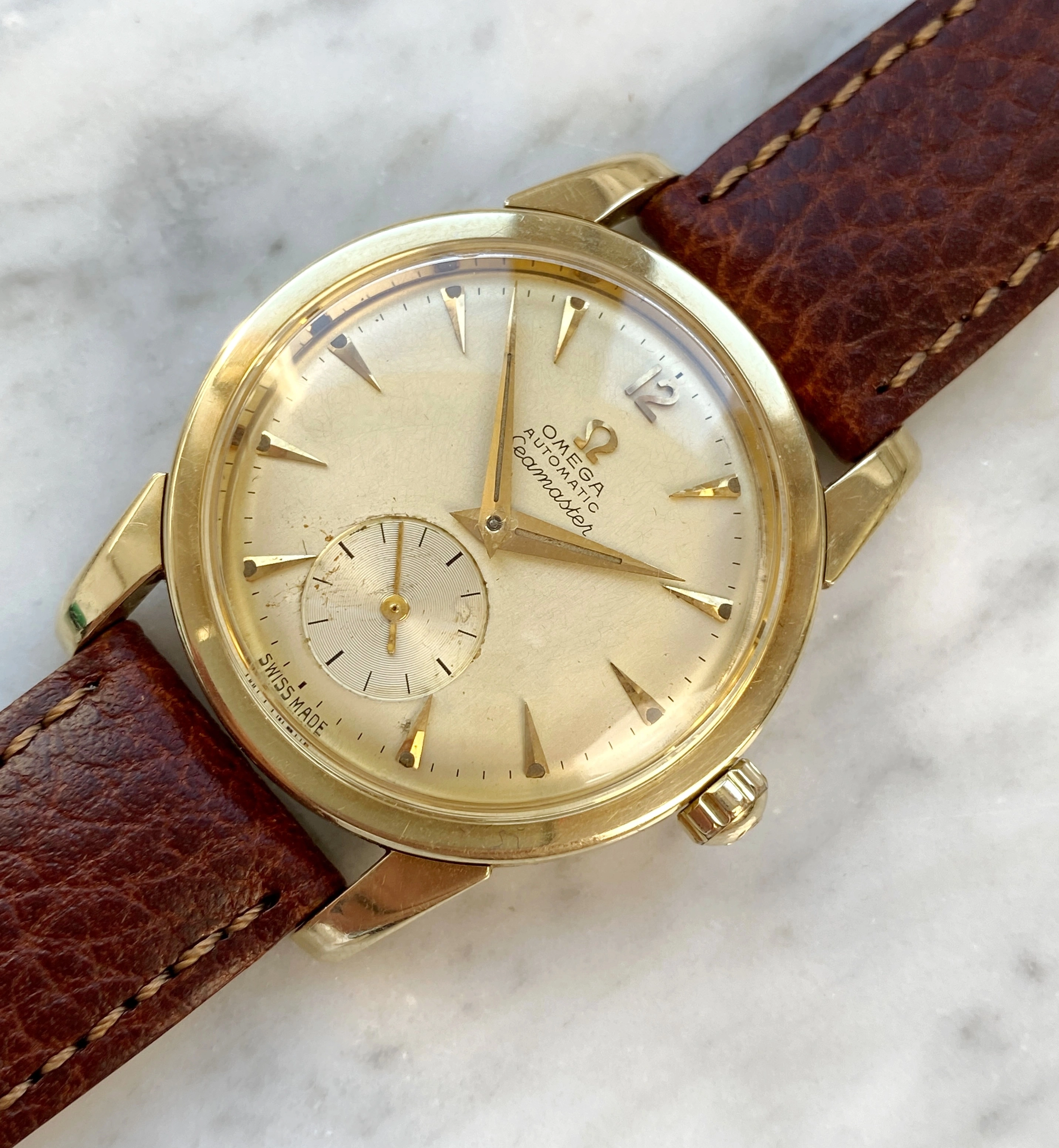

From memory it was similar to:
but in a gold finish, my grandmother told me that it was purchased in Singapore around 1945 - 1950.

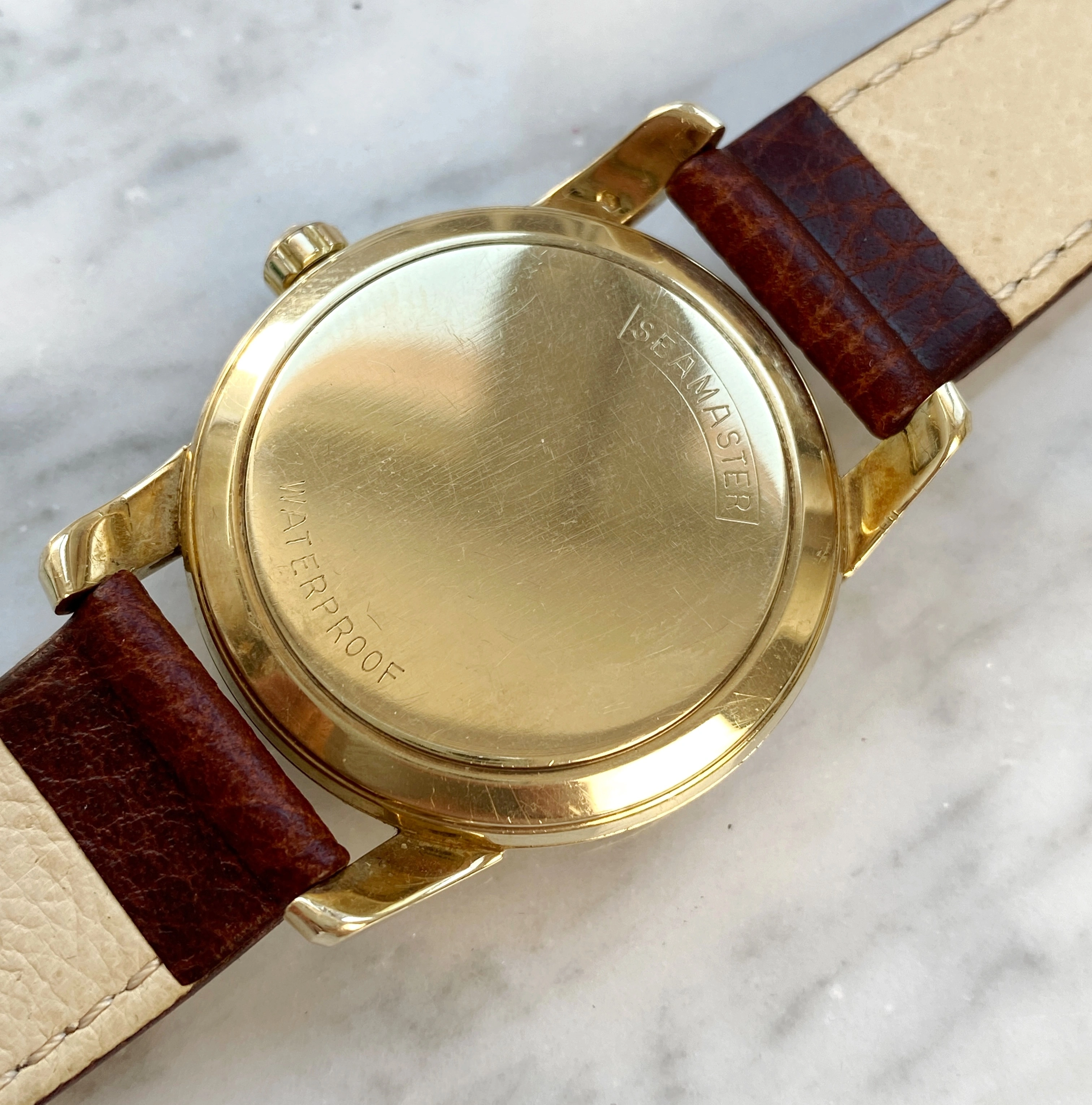

Recently I found the attached, this is a small note that I made of all the watch inscriptions front & back.
I think this text was inscribed on the back: “SEAMASTER WATERPROOF 54696”
Can anyone tell me if this is a serial number?

No, not a serial number.
A 1950 Seamaster would have had a serial number something like 12,123,456.
3,653
7,770
For a movement serial# yes, for a case serial# no
The OP mentioned it to be a case serial. On solid gold SM there are sometimes peculiar case serial#, 6 digit or sometimes 5 digit.
So the case serial the OP mentioned may be OK

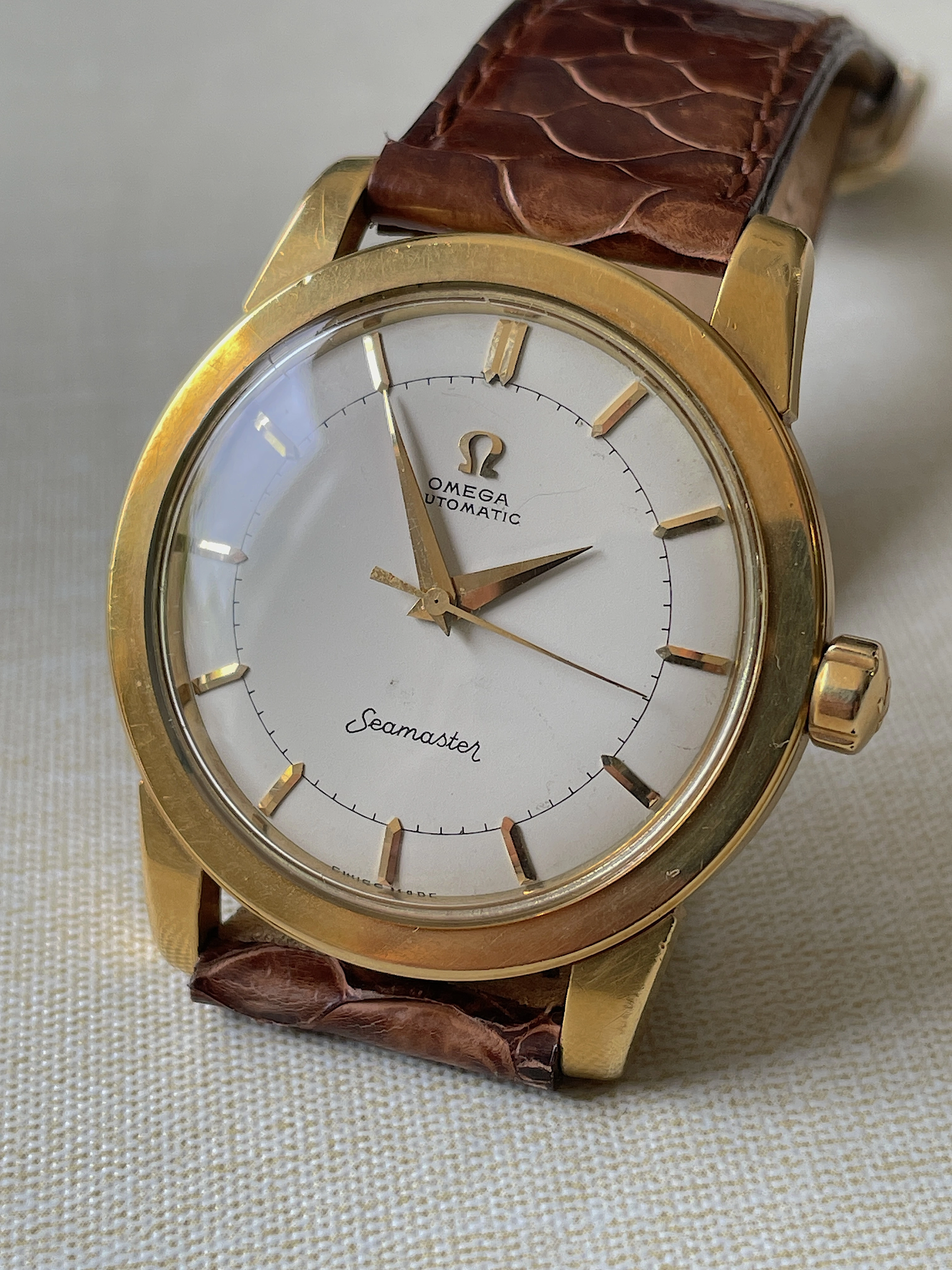

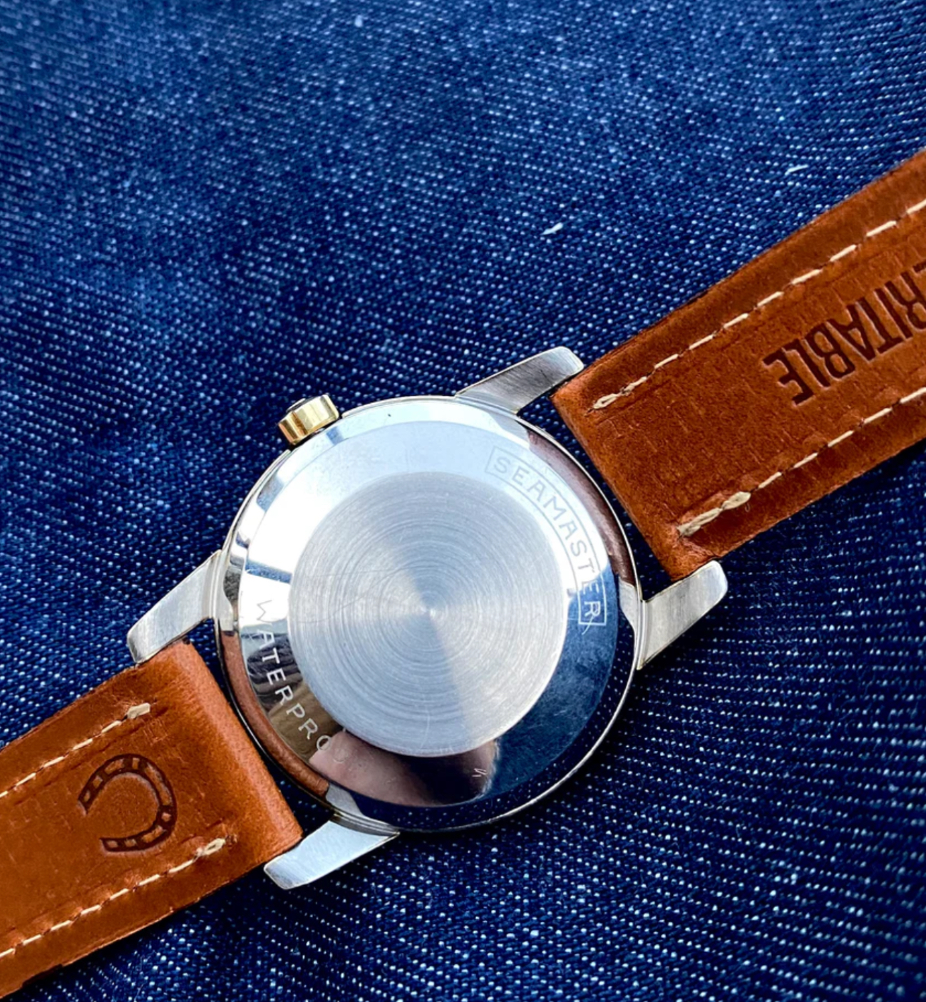

Does it seem right that a vintage Seamaster would have SEAMASTER WATERPROOF inscribed on the back?
Yes, it would be normal.
My centre second example for instance:

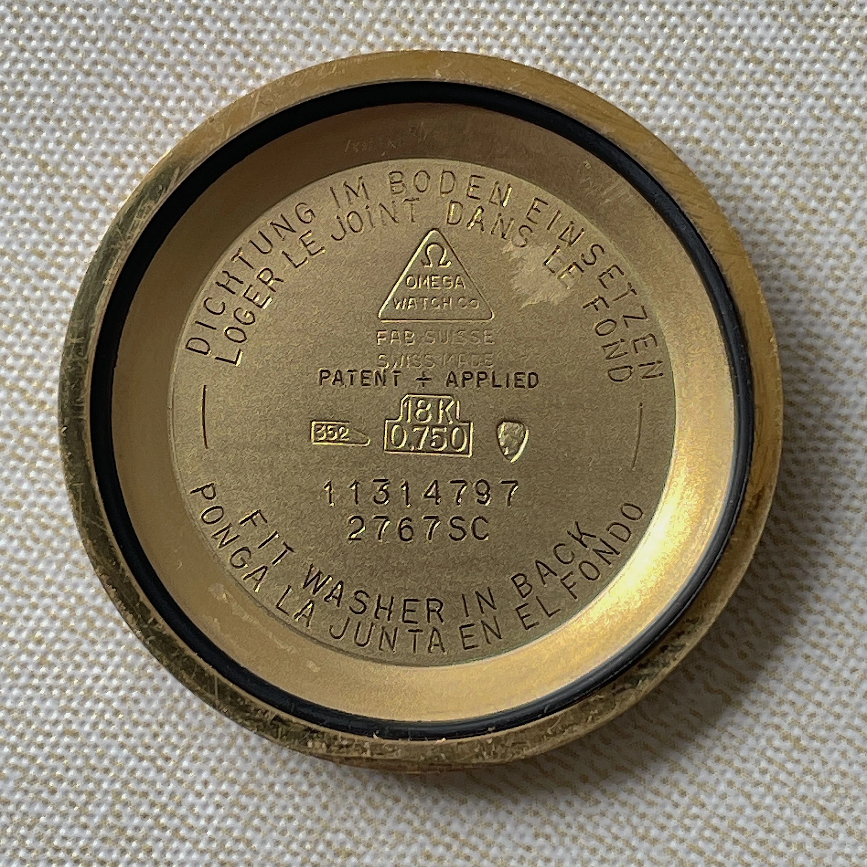

Does anyone have any examples of what a rear case serial number might look like from this period?

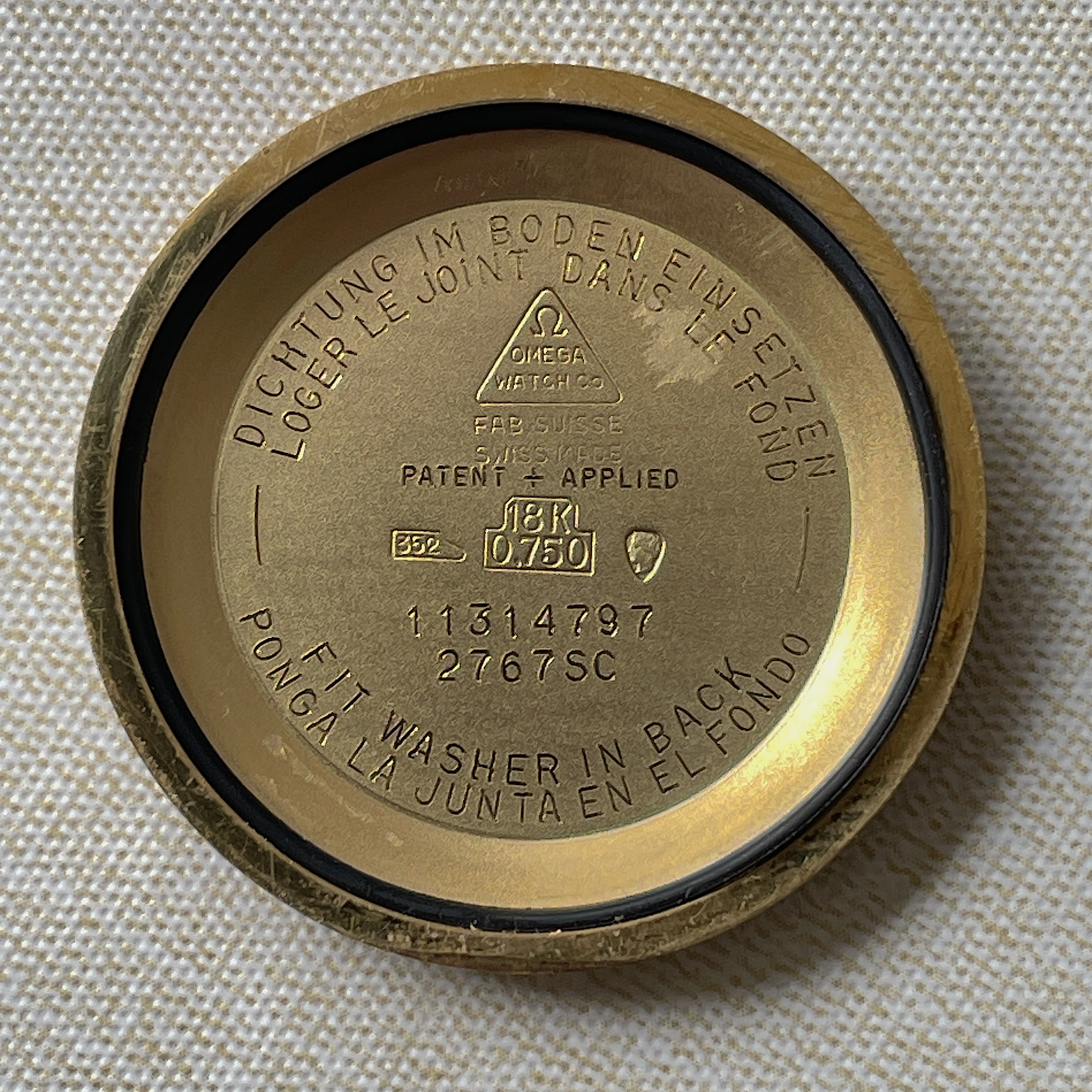

If the 54696 number was on the outside of the caseback I suspect it was added by someone at a later time.
If it was on the inside of the caseback, it could be a casemaker's serial number (Omega did not make the cases at that time).
Here is a photo of the inside caseback of my reference OT2767SC from June 25th 1955.
The number 352 inside the "Poinçon de Maître" indicates that the case was made for Omega by Serva SA of La Chaux-de-Fonds, Switzerland.
The serial number is in the usual case number format (11,314,797) but other case manufactiurers could have used other number formats as mentioned by @mac_omega.

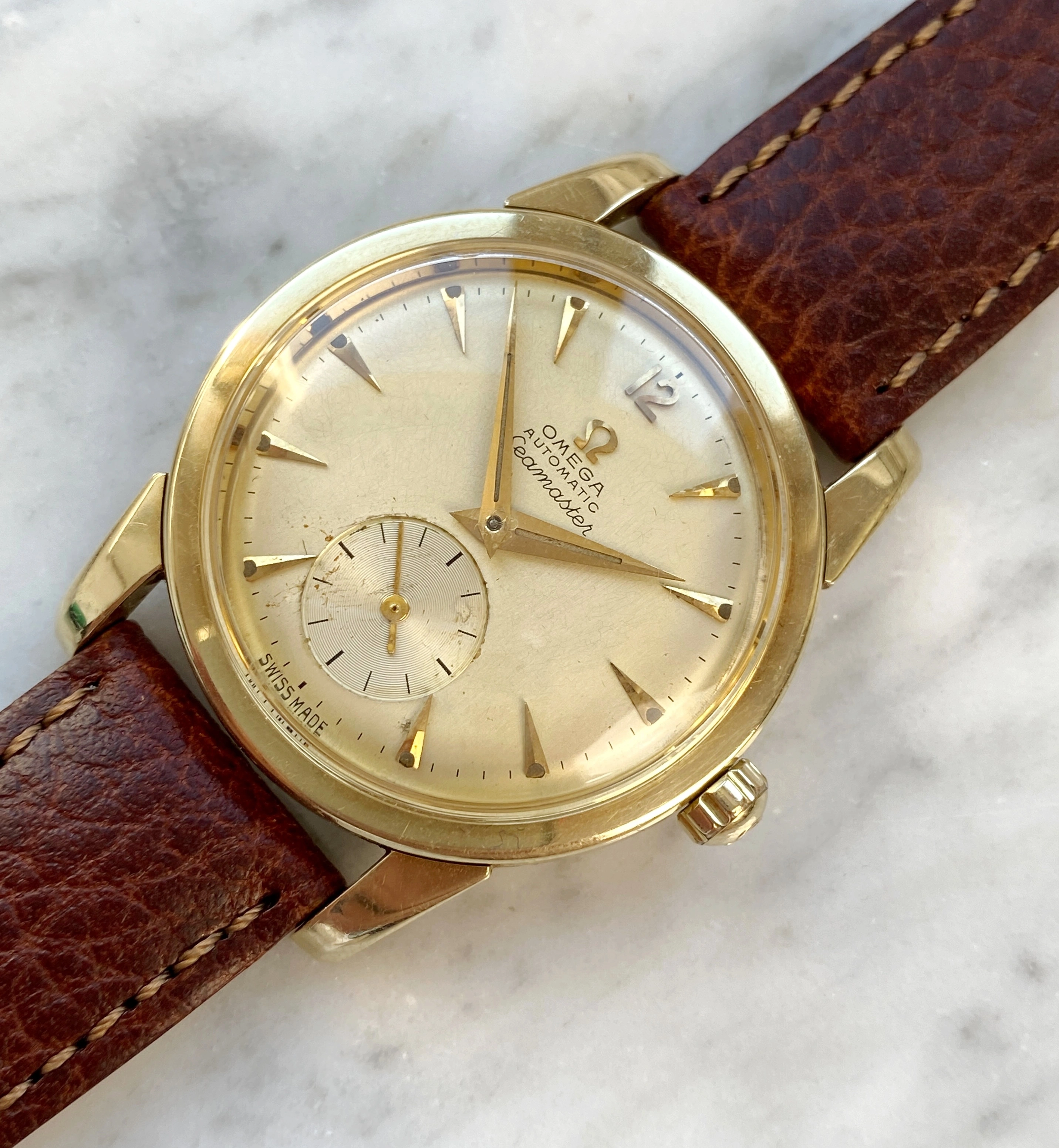

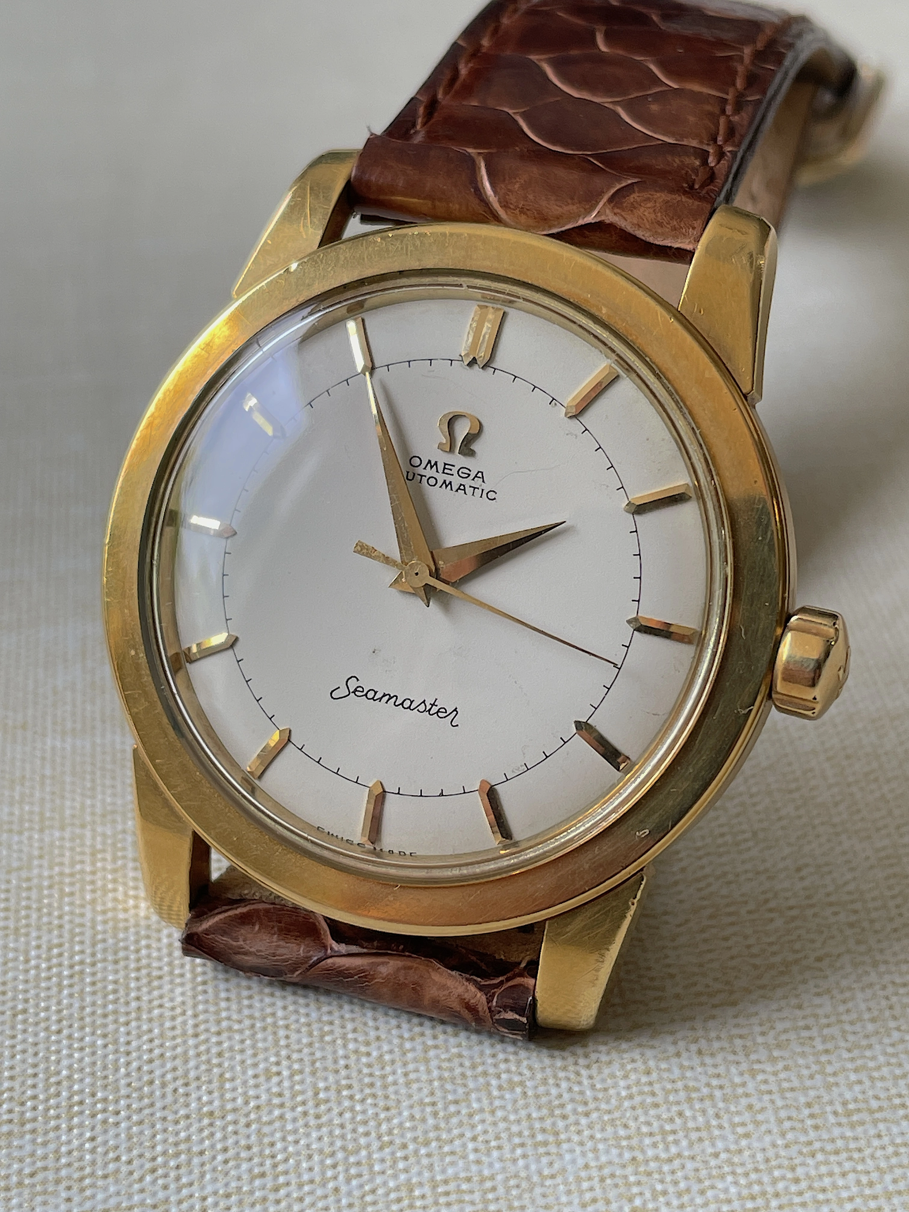

And here's what my beefy lug centre seconds looks like.

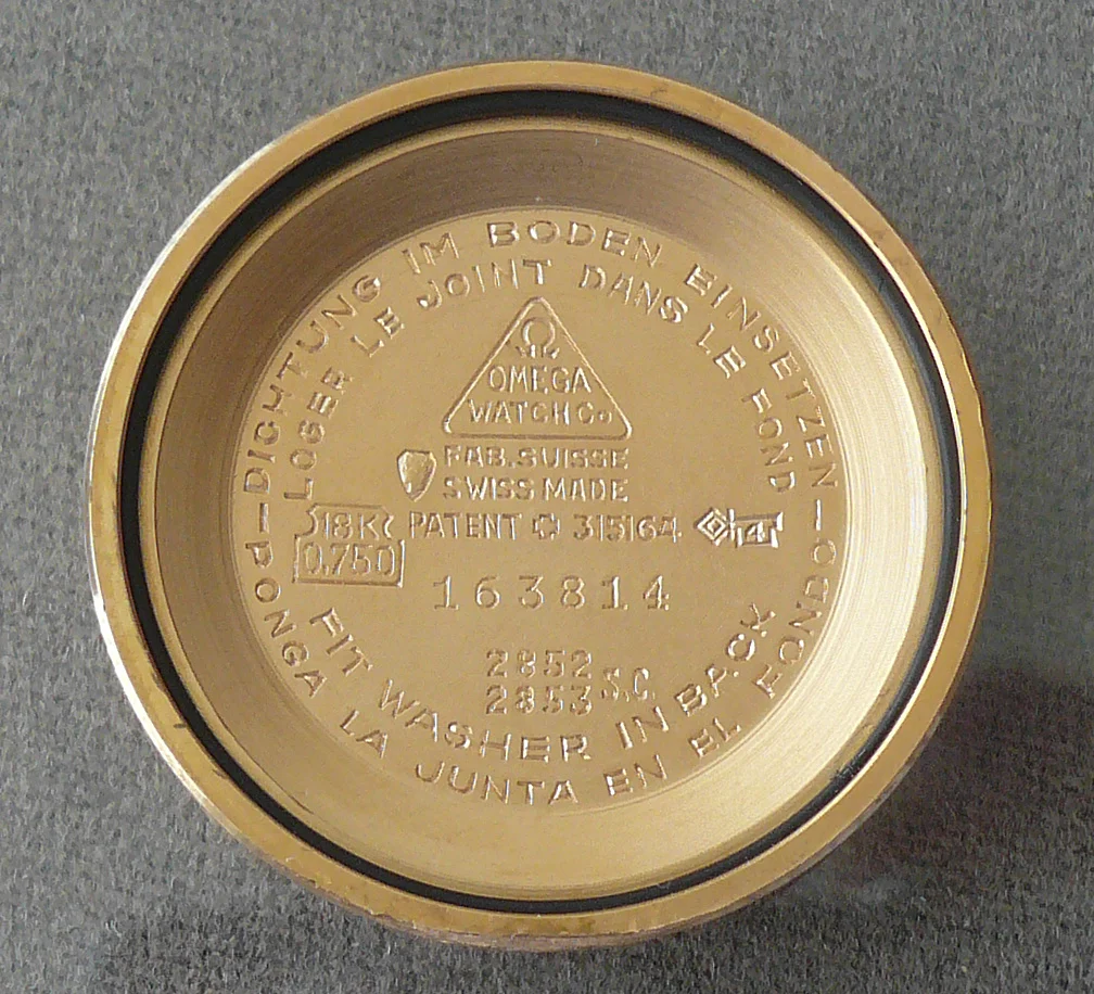

Usually the case serial## are 8 digit as shown by @JimInOz above.
But there are shorter serials on some gold watches.
I have a Constellation with a 6 digit serial# and I would not be surprised to find a 5 digit number
