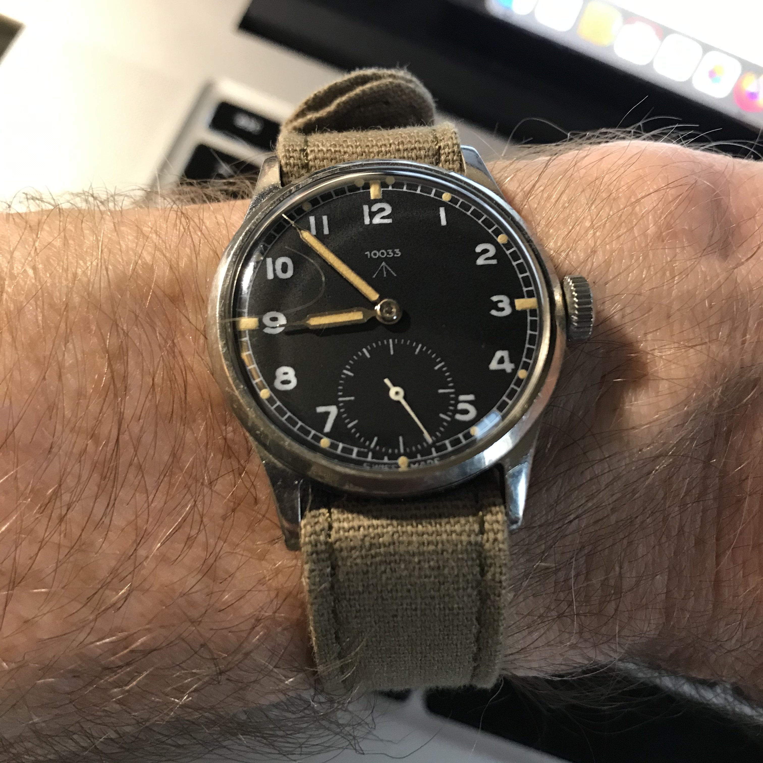

Hi All

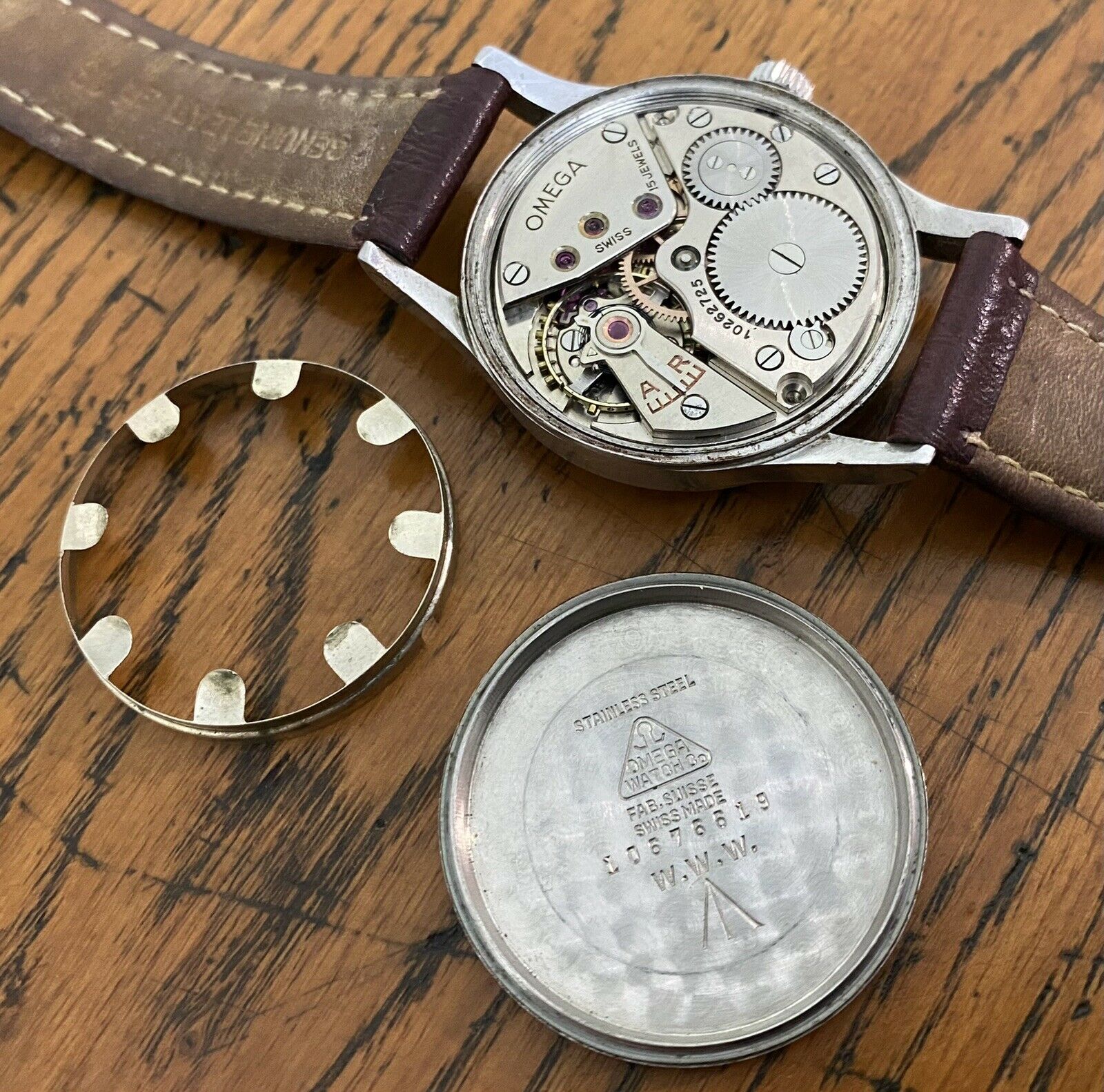

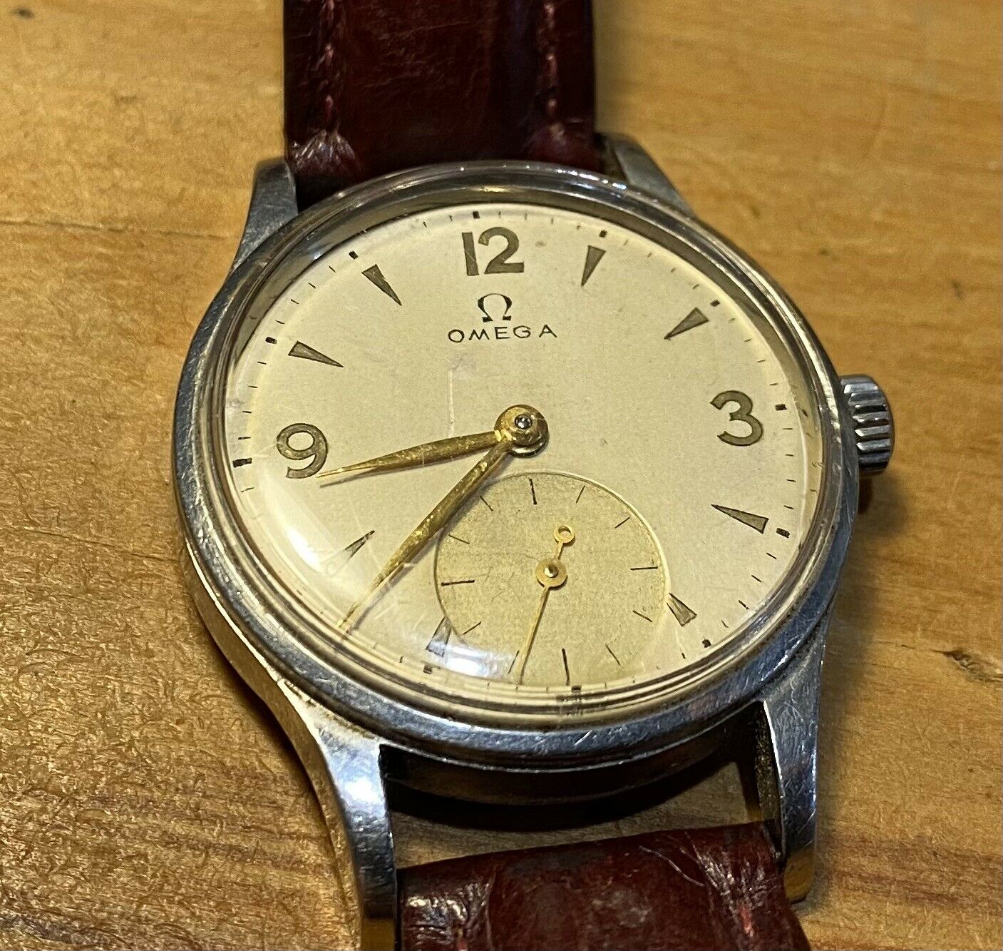

Recently I bought this watch on EBay - allegedly an "Estate Find" - not too dear so to me worth taking a punt. What do the experts on thsi Forum opine on the authenticity of it? Many thanks in advance. Andrew

Definitely not an original dial; all WWW models had similar black dials with white numbers and minute tracks. And those hands are from a dress watch, not a mil-spec piece. The movement looks from the era, and the caseback has the correct model code, but I would think this is a franken from harvested parts. Great for movement parts, but nothing else I am afraid

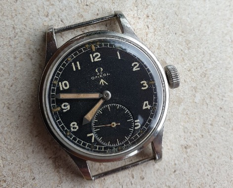

This is the typical Omega WWW dial:
This is an MoD replacement dial; NATO coded dials also can be seen on some of these

Maybe an original owner "liberated" it and decided to civilianise it for a dress watch?

Possibly, but I don't think the case has fixed lugs, which was a requirement of the WWW request. Maybe it was a watch the Dirty Dozen saved from the trash bin!

As noted above, it is put together from pieces of at least a couple of watches. But it has a lot of authentic Omega parts from the same era and it's not bad looking.

Thanks for your learned responses! The case DOES have fixed lugs incidentally.

Fixed lugs or fixed bars?
The strap on it doesn't look like the style used for fixed bars.

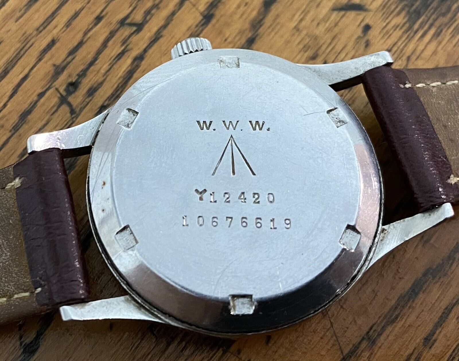

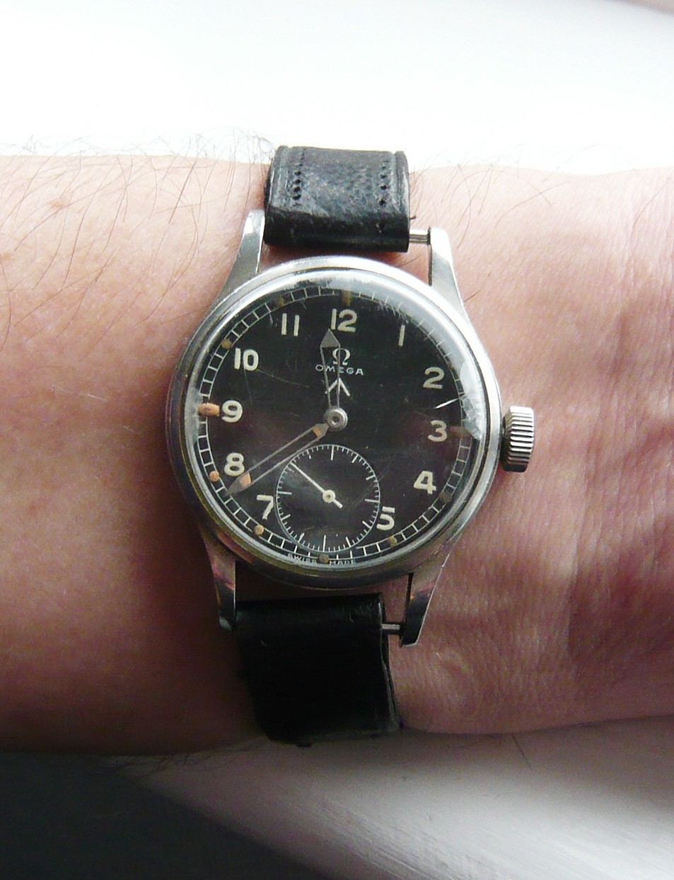

Hi.
Mine say's hello.
It's also a 44.
Joe.

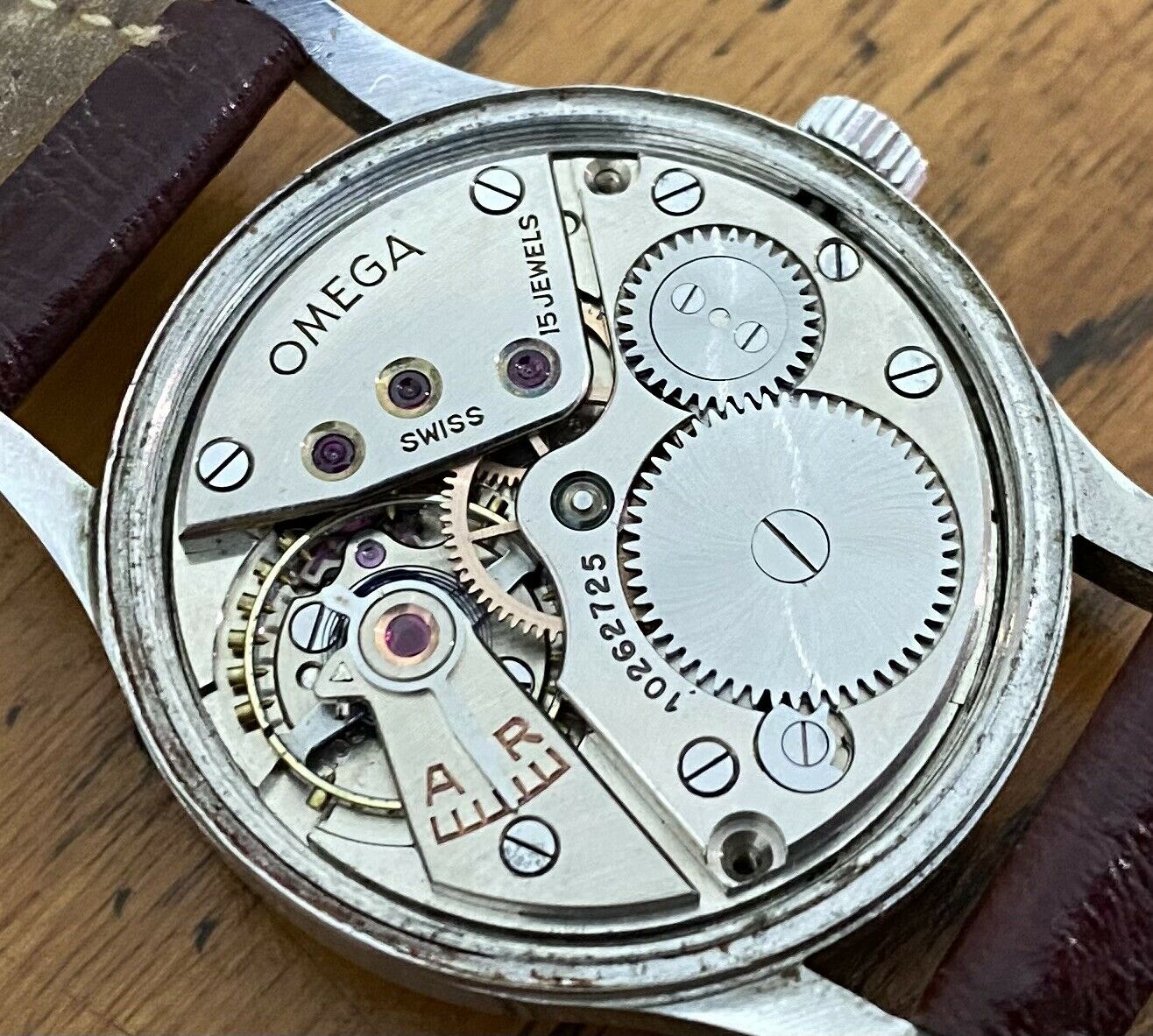

The case looks sharp. The movement number fits a WWW too. Indeed, must be civilianized in the 50s.
Change the dial and hands and you have a WWW again.

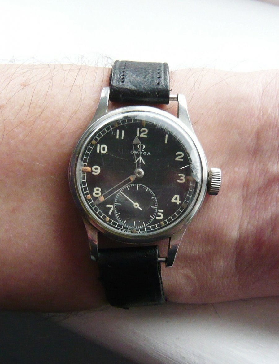

This has just reminded me of my mis-cased "WWW" - goodness knows how a 6B/159 ended up in a WWW. Wonder if the watchmaker got the case mixed up with a '56?:

Or he just didn’t care? So long as it keeps time…
Nice looking watch at any rate.
