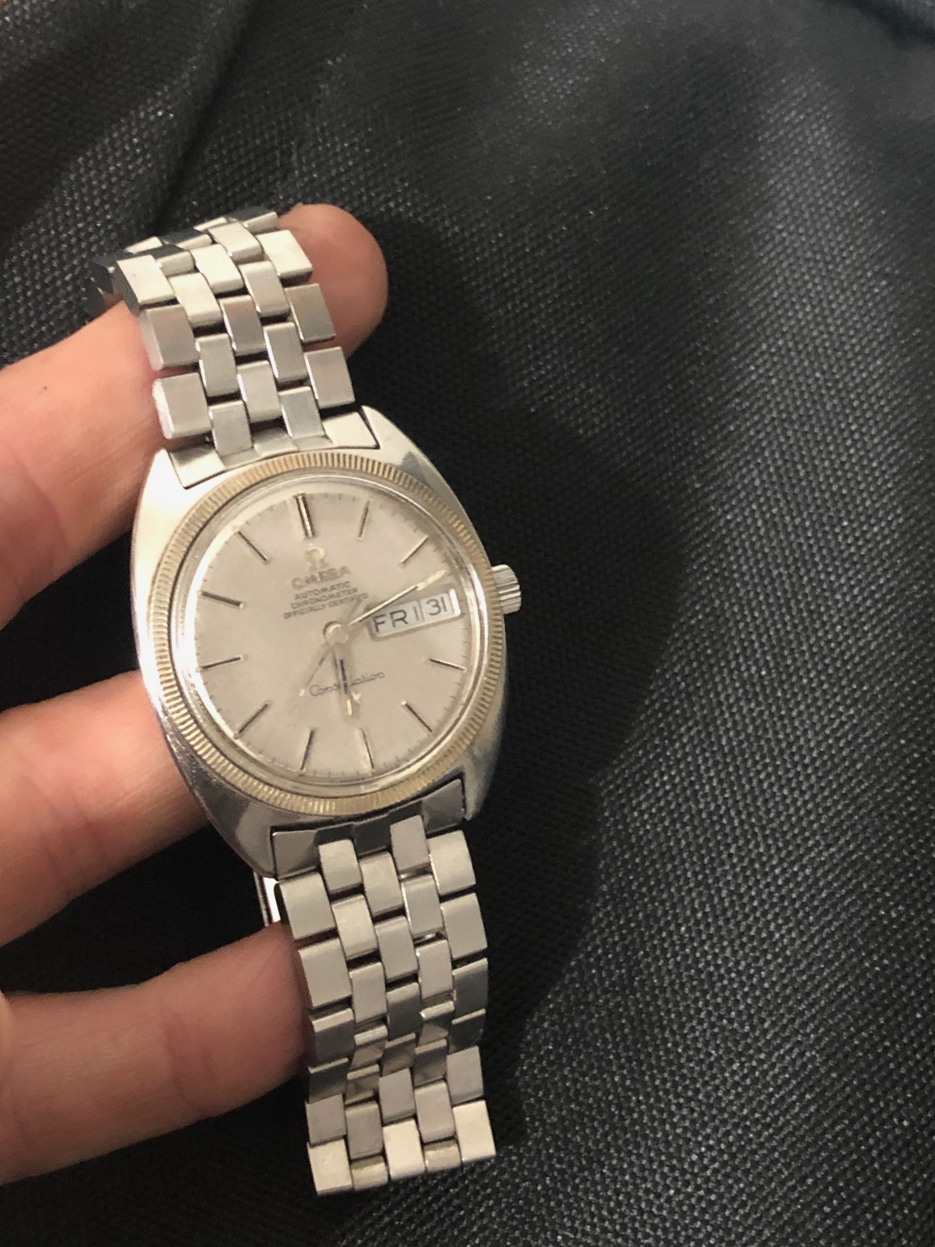

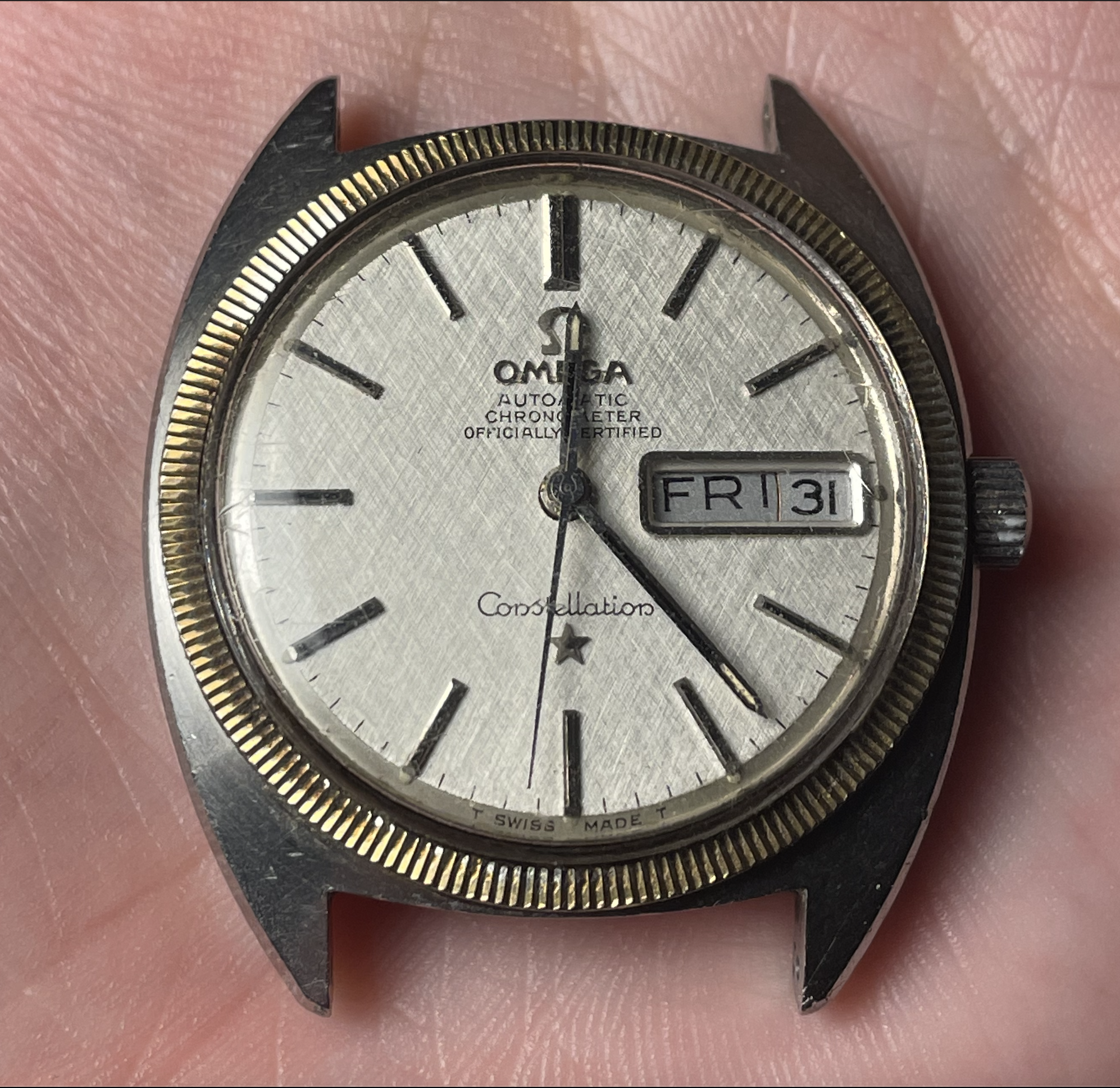

Hello friends, I'd love some guidance on this recent purchase. I have been searching for a nice linen dialed C-case constellation with white gold bezel for quite a while and finally had the opportunity to buy this one which seems to have a relatively untouched dial. However, the bezel is noticeably yellow. At first I thought it may have been an odd two toned example, but I've been trying to clean some of the gunk and when I remove small bits of dirt on the bezel, I seem to find noticeably white metal underneath. (See the area between 10 & 11 on the bezel)
I was reading online that older Rolex bezels as well as a lot of WG jewelry are rhodium plated. Could this be the case with this bezel? Does anybody have any experience with similar types of yellow discoloration? Is there any way to clean it? Its definitely not all dirt and the bezel has noticeably yellowed all around.
Thank you so much for your time and help!

I don't believe that the Omega bezels were rhodium plated. The article in the link is designed to promote the idea that people should take patinated white gold jewellery to a jeweller for rhodium plating - just touting for business.
I have seen this natural patination on the bezels of many of this model over the years, and have found that it is simply removed (if that is what you want) with a gentle rub with silver cloth.
I actually like the colour contrast of the bezel with the stainless steel case.

I appreciate the insight! It definitely wouldn't be all that bad if it wasn't so uneven imho. I really wasn't sure how common it was for watches to be rhodium plated, but I do hope it will clean up....would save me a headache to deal with. Any specific brand/type of silver cloth that you recommend I try out?

Nice watch - I see the yellowing as normal tbh, some of mine are yellowed as well, didn't think much on it - but I wonder now if they become yellow when they are worn too

My honest opinion, I like the case of yours, apart from the crooked day wheel, it looks perfect - worn is always better I guess, since you don't have to worry about ruining something pristine

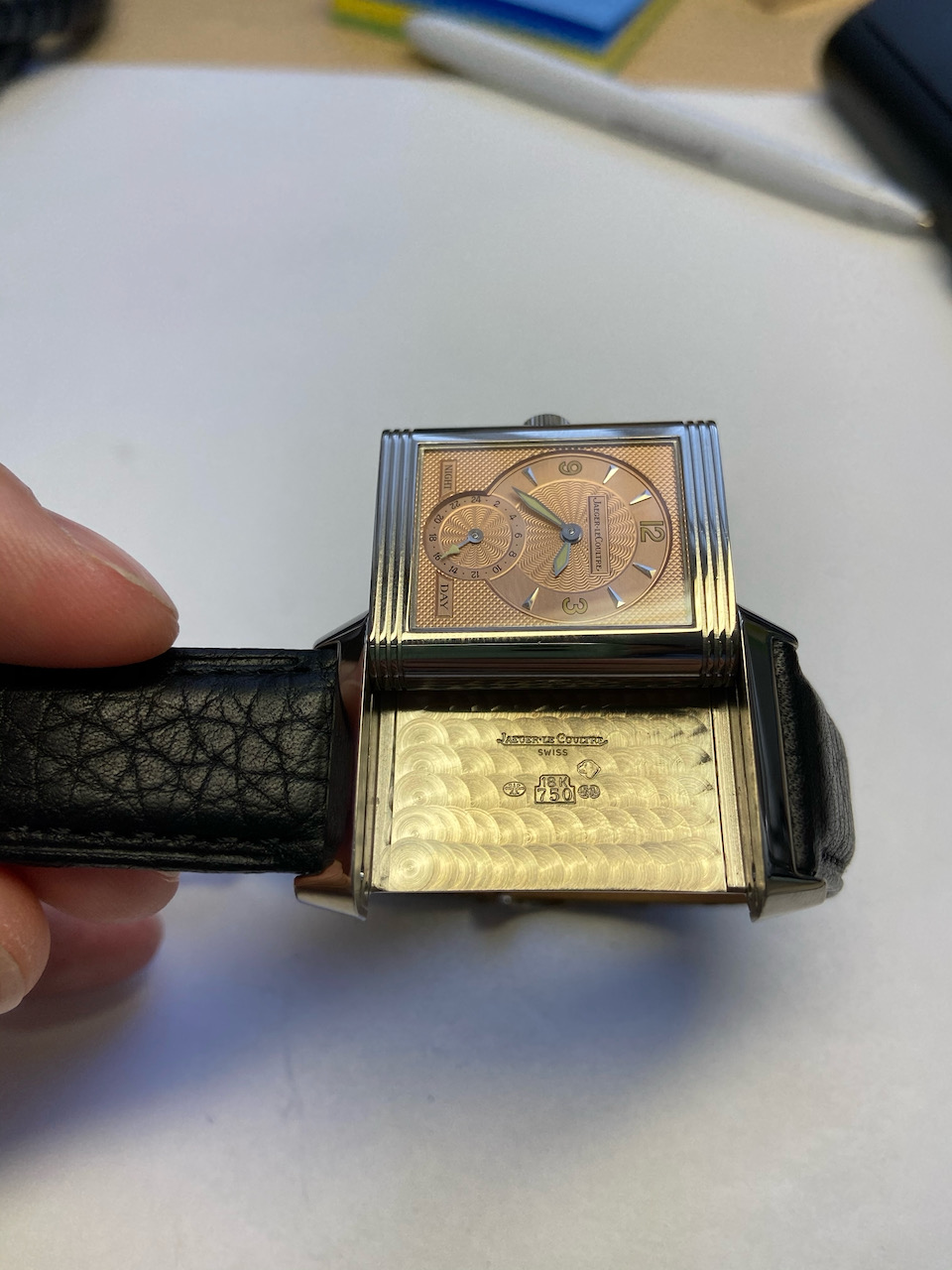

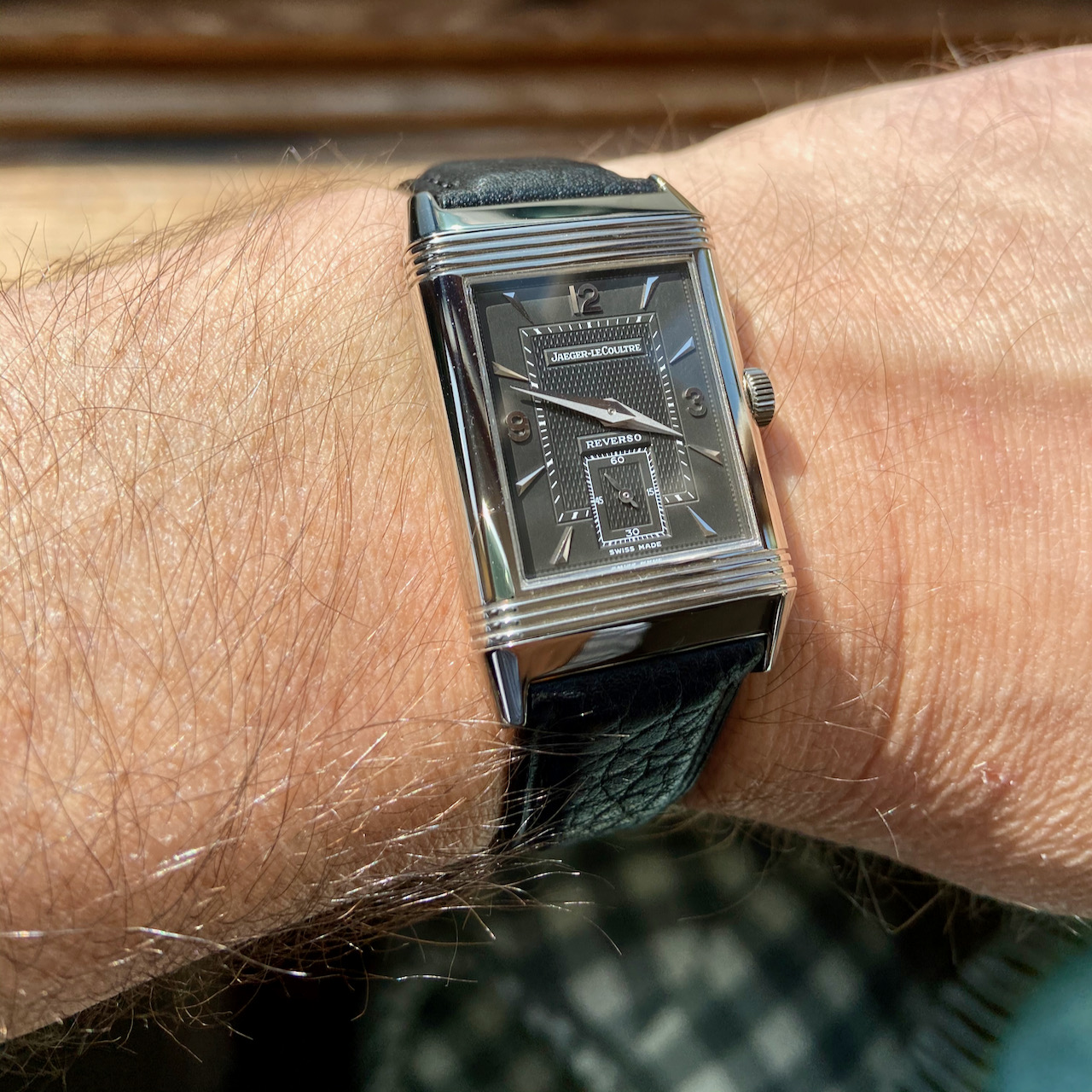

Not all white gold needs Rh plating. If there is a high enough proportion of Palladium it will maintain a silver hue without plating. Here is an example of a solid WG JLC which has no plate the alloy used here has over 15% Pd. This is a good thing since it is more tolerant of scuffs or dare I say it refinishing if necessary. The second photo looks a little yellow, but that is just the cast of the incandescent lights.

Good catch with the date wheel. It keeps great time, but I noticed that the day/date changes over much earlier than midnight. I'll be getting both issues sorted out soon.

Thank you for the insight and that definitely makes sense. I had read that Rolex currently uses a similar alloy. I guess it will be interesting to figure this one out.

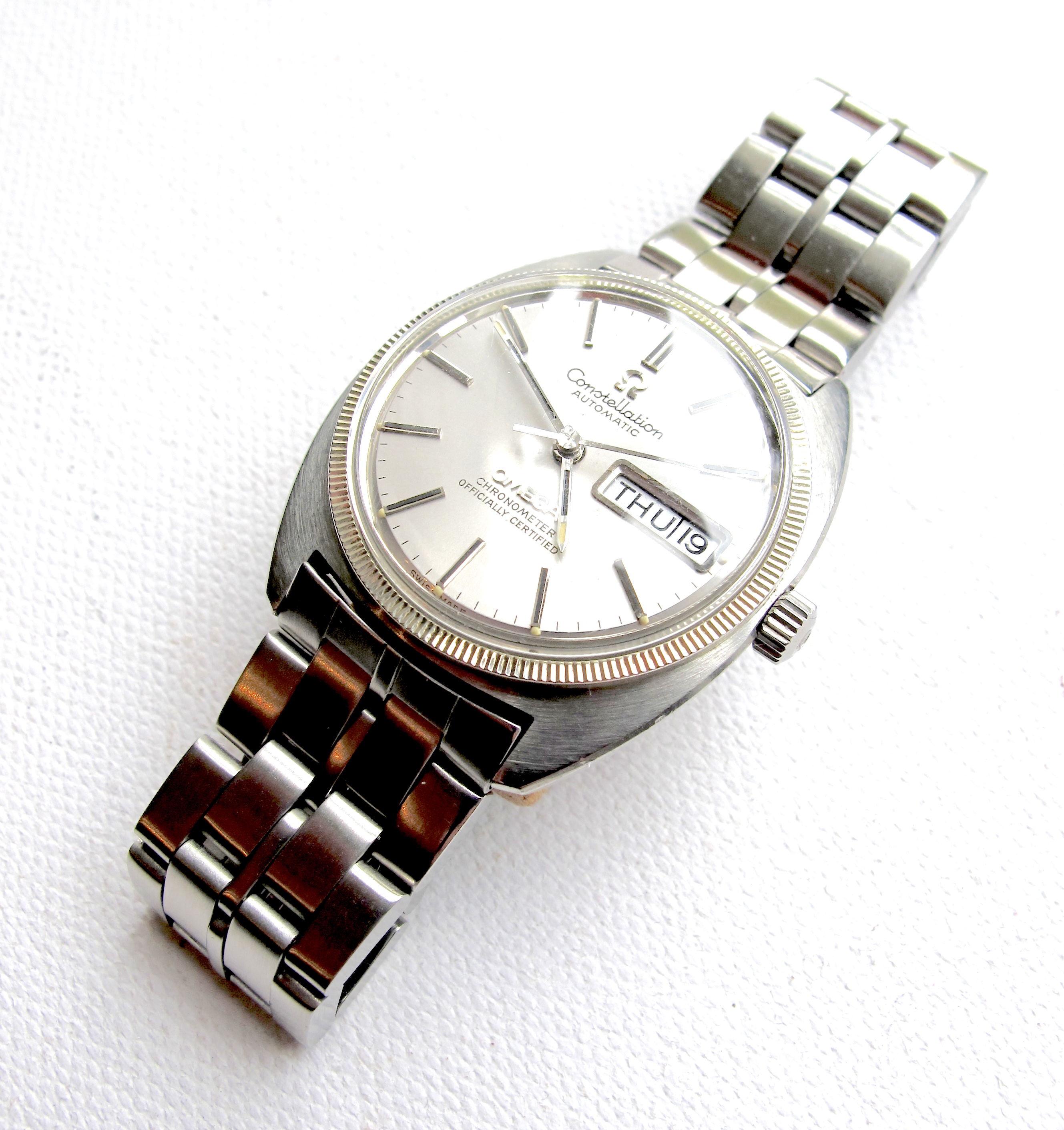

An out of focus photo of my .029 with the yellow bezel
- I like the gold color of the bezel (look at it this way, at least you know it's gold now, otherwise one could think it's steel =)
- Maybe the case becomes polished-like with excessive use, because as far as I understand, professional sellers do an actually good job of re-finishing the case - I wish I knew someone that does it, I'd love to get this one re-finished

Fair enough. Yours looks really good though. I wish I could give you advice on where to go, but I haven't found anybody good, affordable, and cognizant of the needs of vintage watch collectors. I will say, the only "issue" that I see from your photo is the loss of the brushing on top. The bezel also looks good...I've seen some filled with gouges and gents. I don't believe that top brushing is too difficult to fix. I had one a few months back that had lost some of the angles on the side and that really bugged me and needed substantial intervention.
