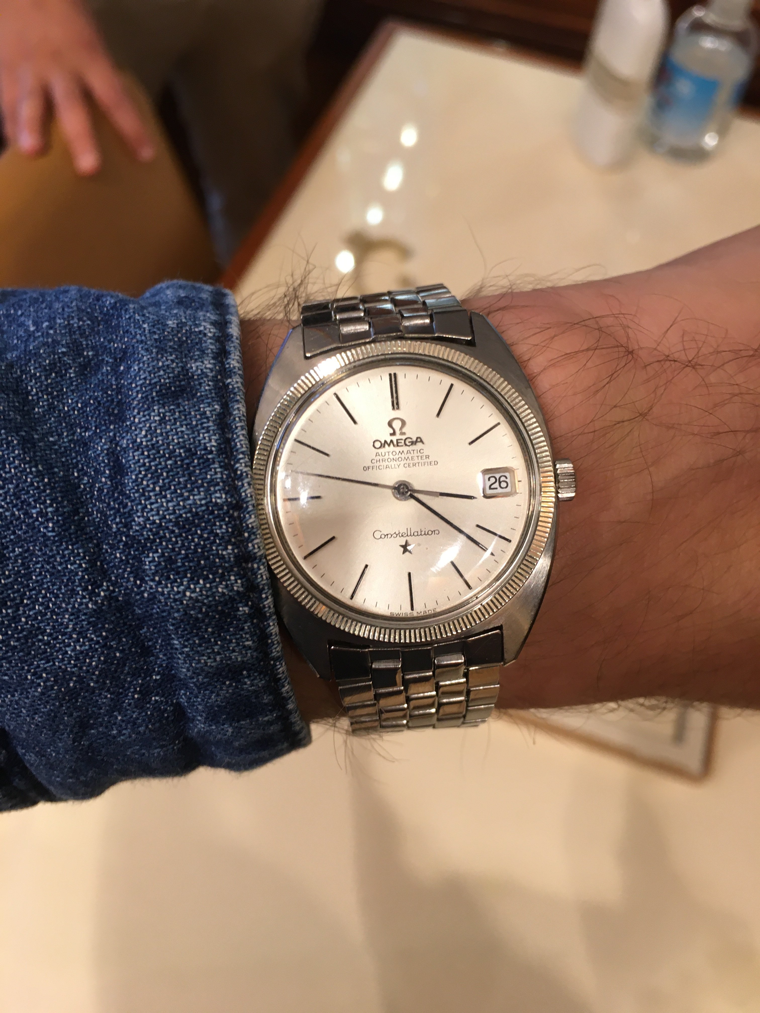

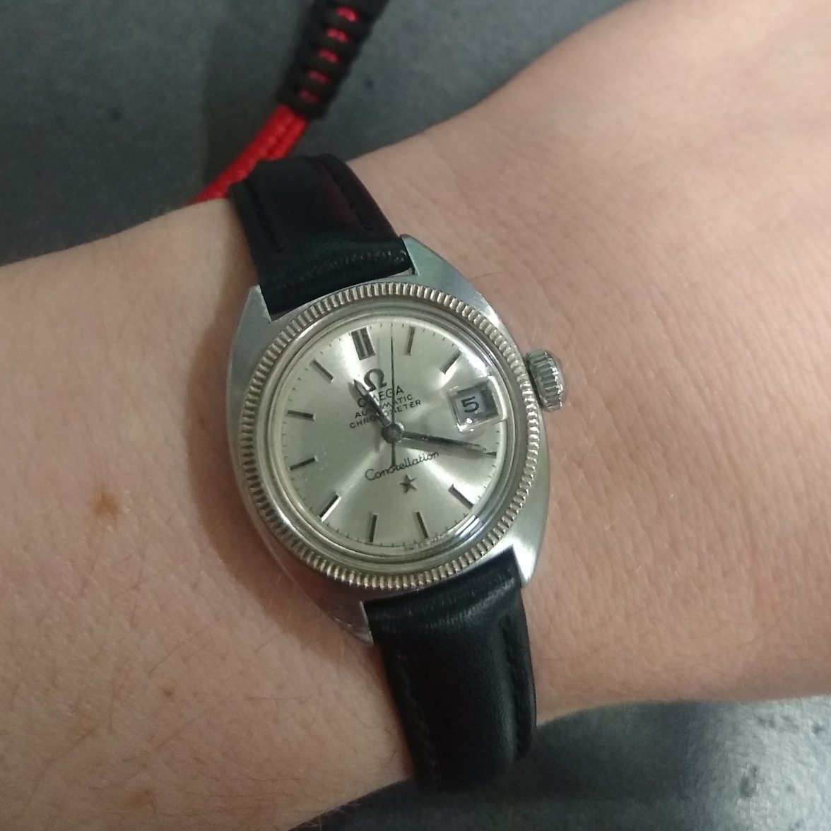

My 568.0011 from 1969 that I'm wearing today. WG coin edge bezel on a stainless case and Omega NOS L crystal (date magnifier was an option you could ask for at the store back then and they'd switch it out for you).

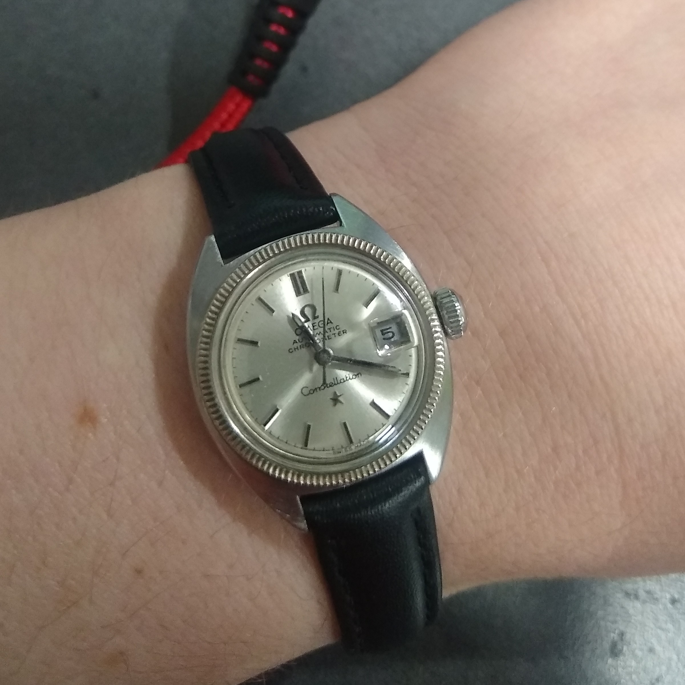

Out of interest, how do ladies C case constellations Compare in availability/desirability and price, compared to the gents equivalent?
The ladies models will be less expensive but also harder to find than the men's models. Ladies models have been tracking in the $400-$800 range for the past couple of years, depending on case material and whether it's on a bracelet.

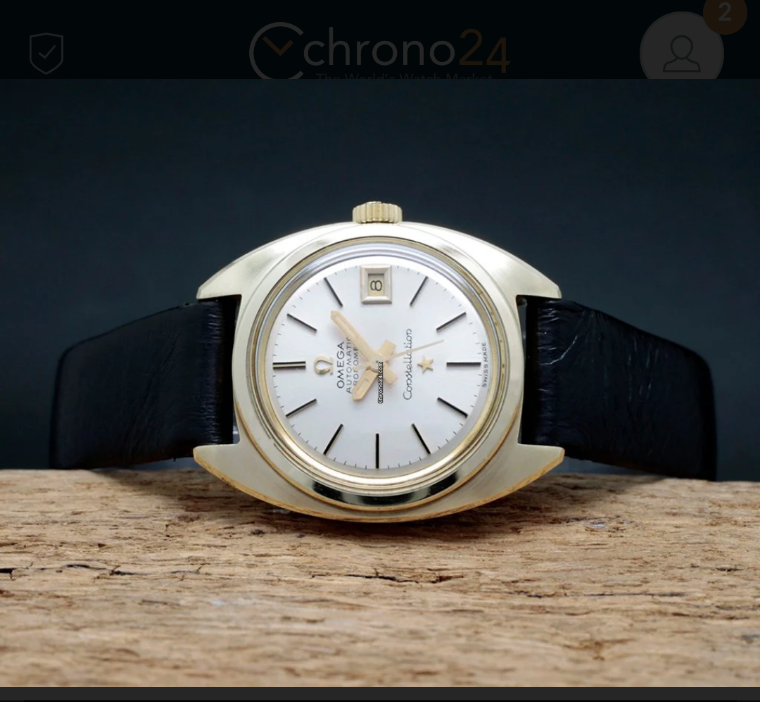

Shot from the Chrono24 listing for posterity.
The hands appear to be too short compared to the reference images from AJTT. Neither the minute or seconds hand reach the minute track.
@SeaMSTR some patience and leg work should net you a good example of that watch for half the price.
61
47
Oh dear. I was worried about those hands, and even asked the dealer about them. I also showed the listing to a Constellation expert, who said the watch was “true NOS” and “special.” Well, I still think she’s beautiful, even if there’s a little plastic surgery there … .
Not sure who the expert was, but I can confirm those are certainly not the right hands. They should be stick hands with black paint on them, much narrower and longer than what is on there now.
Looks like part number 065TX1069 are the correct hour and minute hands.
I saw that watch on Chrono. The hands are too short in my novice opinion, plus they have lume, and the dial markers do not. As a general rule, both the markers and hands should have lume, or vice versa. Also the ‘Swiss made’ Would usually have a ‘T’ either side, which would indicate tritium lume (this is purely from what I have learned on here). It is a lovely looking watch though!

Classic novice blunder, I guess. To be fair, the expert said it was the pristine finish on the case that was special—he didn’t mention the hands. So now my problem is: do I return it or not? I was so thrilled at the idea of having a perfect little artifact from 1971, as my first good watch. Bitter tears…
30
20
If I were you, I would see if you can cancel the sale. You can get a lovely original piece for what you paid if you're patient.
Cancel it. Chrono24 makes it easy to do so and you'll be able to find something for half of what you paid with a bit of patience and research.
