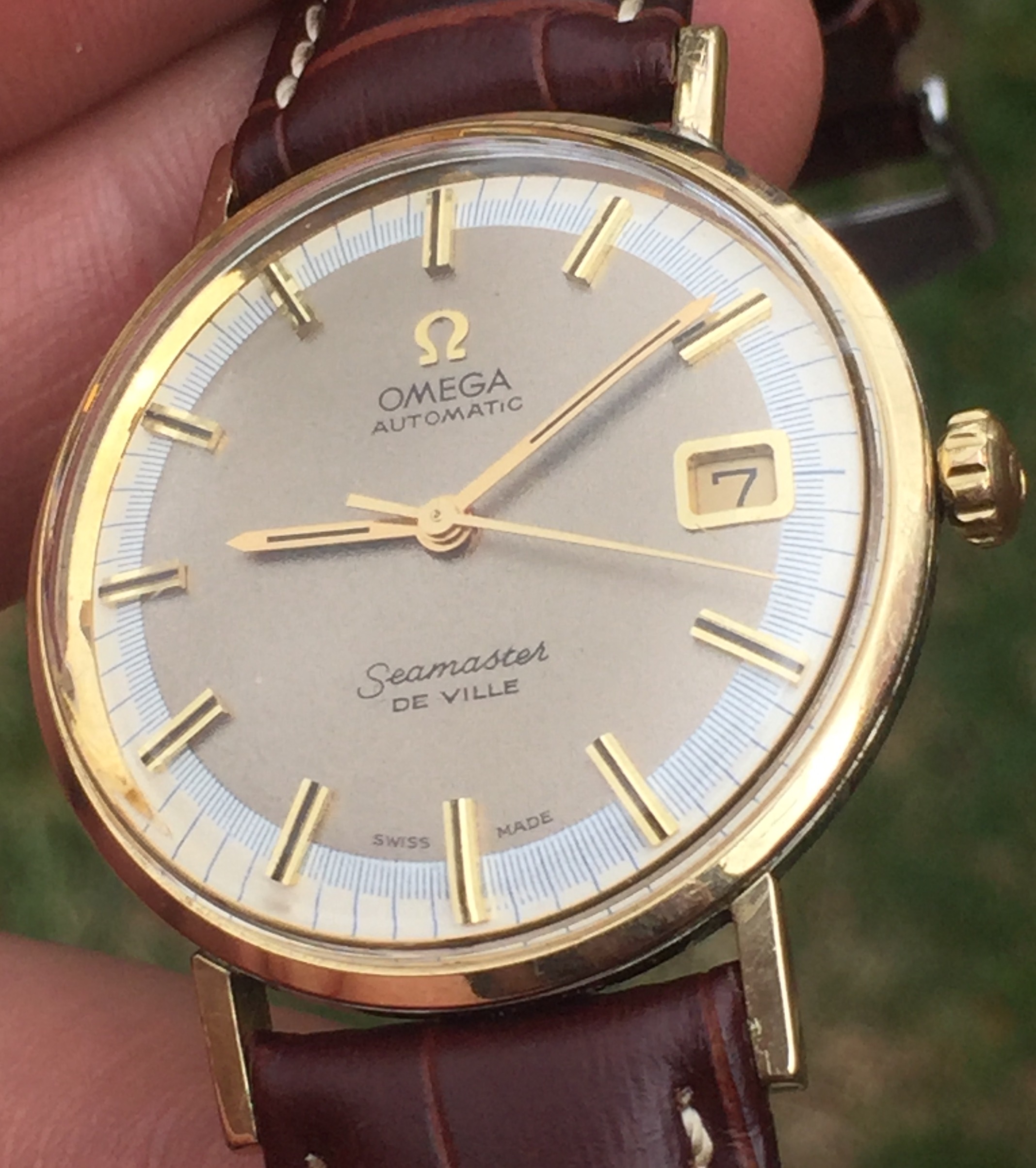

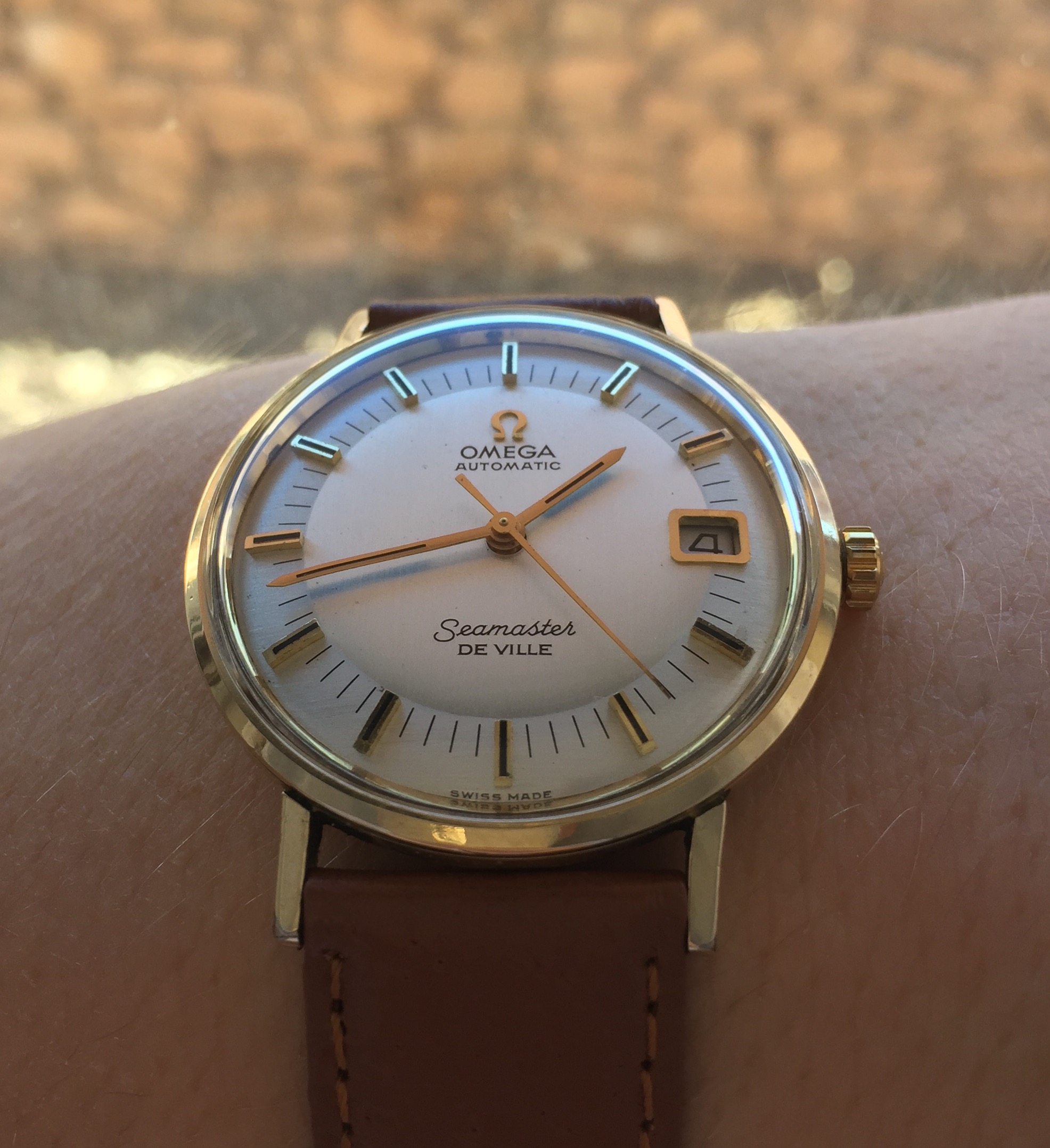

I am a bit of a hypocrite, but don't be afraid to take some more time when shopping.
My first Omega buys were... not the best. But after a bit of research and time on this forum I was able to narrow down what I really wanted. For me and many others, the hunt is the fun part. GLWTH

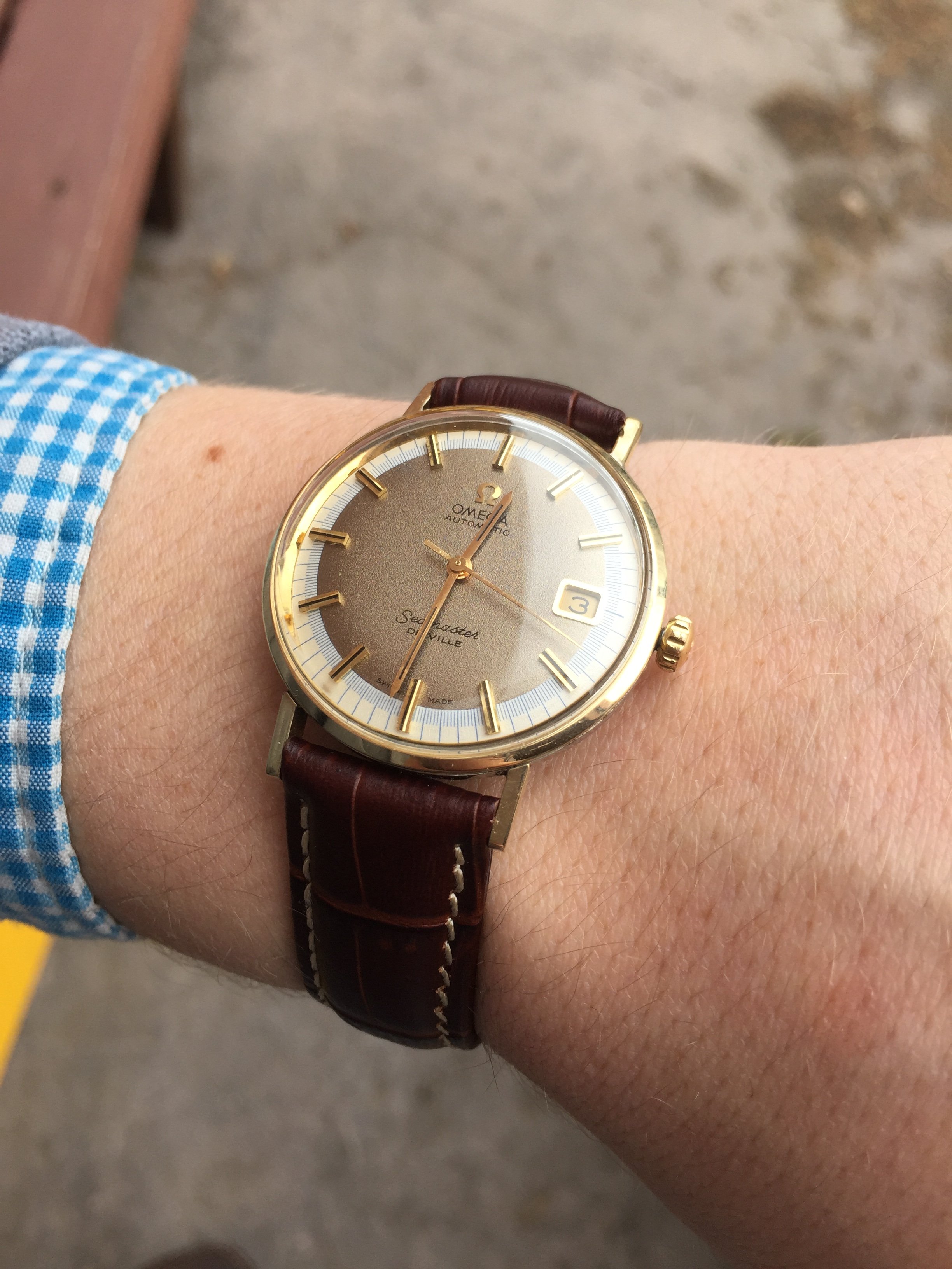

That second one is an absolute beauty!
1,245
3,876
Thanks! I better post a better shot 👍
Hoping to get new bands for my small collection soon. If you make the cut you get a some new cowhide. I am thinking a dark brown with blue stitching to pull through the blue lined markers.

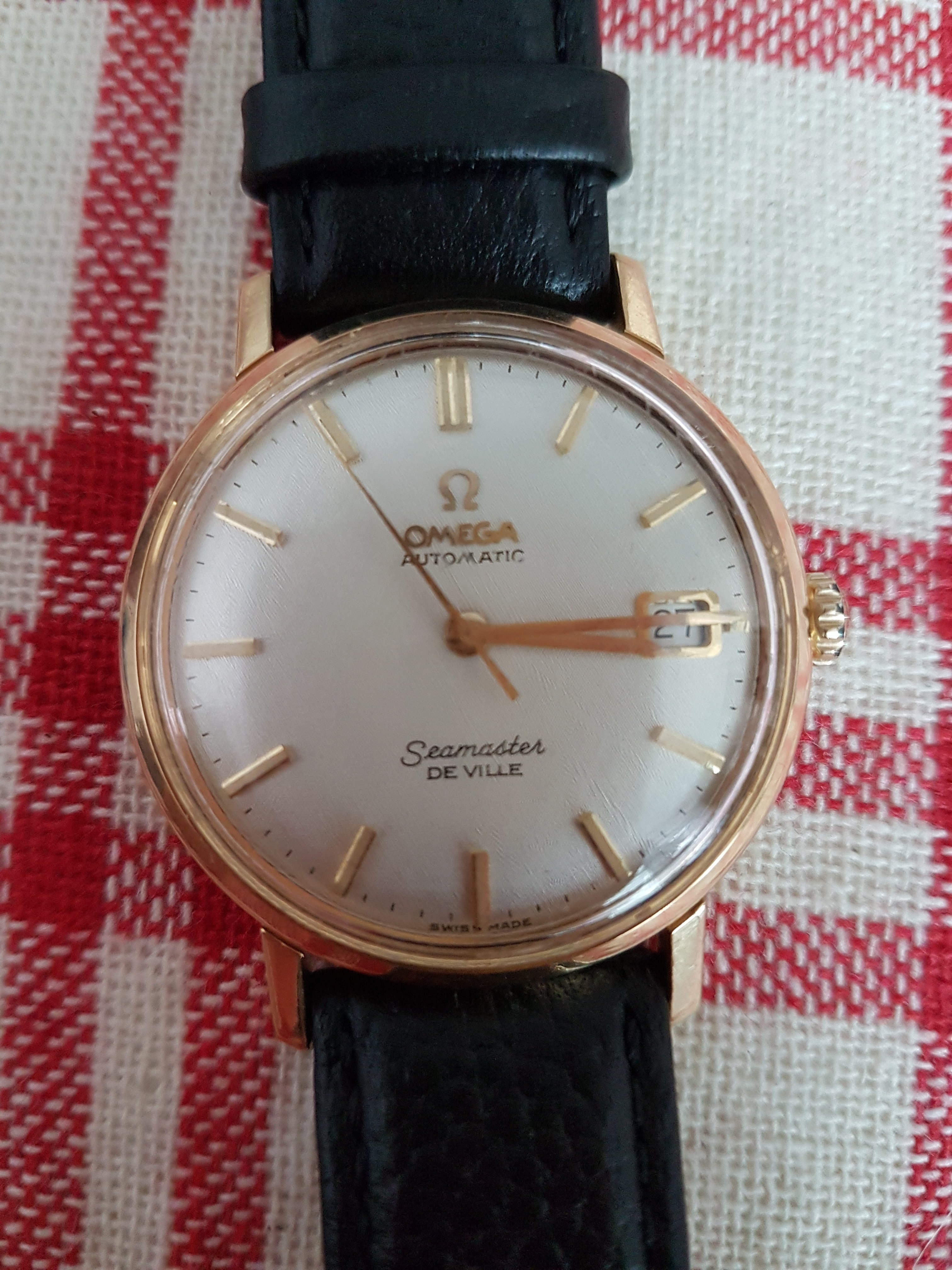

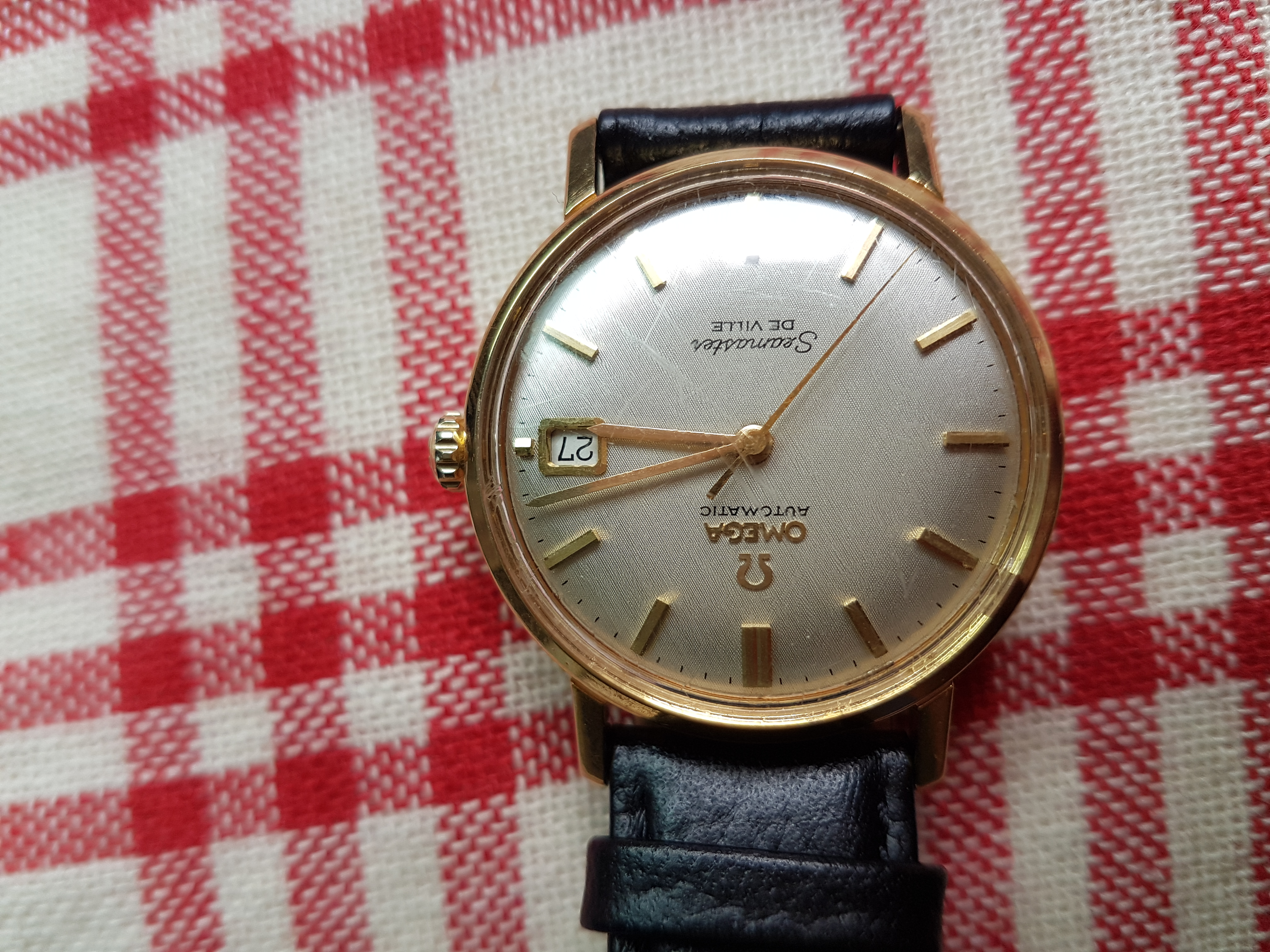

Hi,
I have finally bought my first vintage omega and it's from Ebay!
It looks original and beautiful in person, even the glass has the omega signature, however it's quite scratchy. I was told the movement is 562 with 24 Jewels. I don't know the case/movement reference numbers.

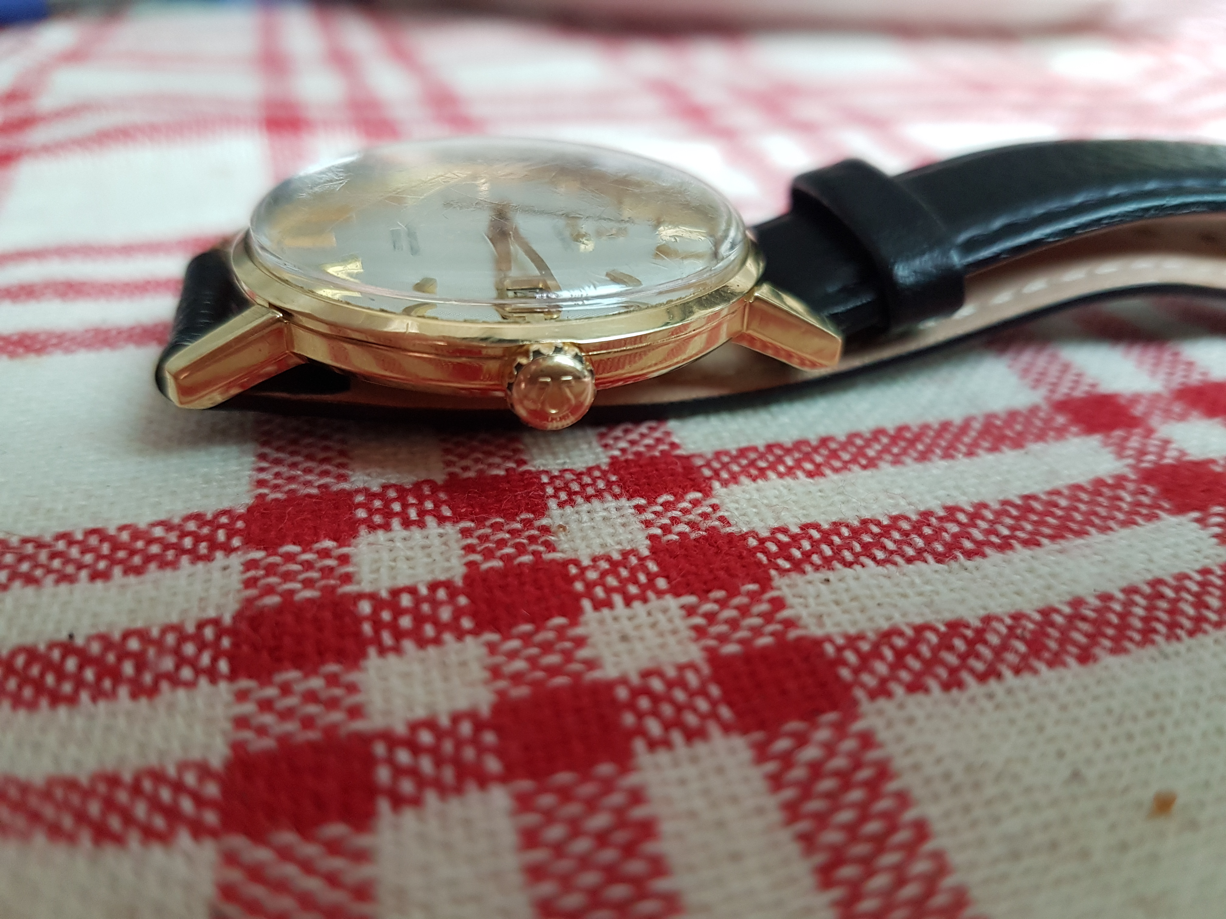

It's running 4min slow per day, so took it to a watch repair shop and they said the glass might break if they open the case as it looks like it has not been serviced for a long time. I have a few questions:
1) Does the dial/crown look original?
2) Where can I find an original glass replacement?
27
14
Beautiful original dial and crown, congratulations!
Thanks Edward, how would you identify the dial to be original? would you know how to get a genuine omega replacement glass for it, please?

Hi Kian
I can see from the first dial photo (the second is not so clear, despite being larger) that the dial has a nice linen finish, the text is all the right size, spacing, font and is in the right places, the minute markers are correctly positioned and it all looks generally "right". The crown and hands are correct for the watch and everything is in similar nice condition except the scratchy crystal. You probably do not need to replace that as those marks can almost certainly be polished out and you can then keep the original crystal, which I would do even if it left a couple of marks. Anything you have done to it needs doing by a proper watchmaker and not a watch repair shop. Clearly the movement needs attention and you would be best off not wearing it till it has been serviced. If you post your location, someone will be able to recommend a watchmaker. I would not worry too much about the four minutes as the movement is probably basically ok and fixable, given the overall good condition.

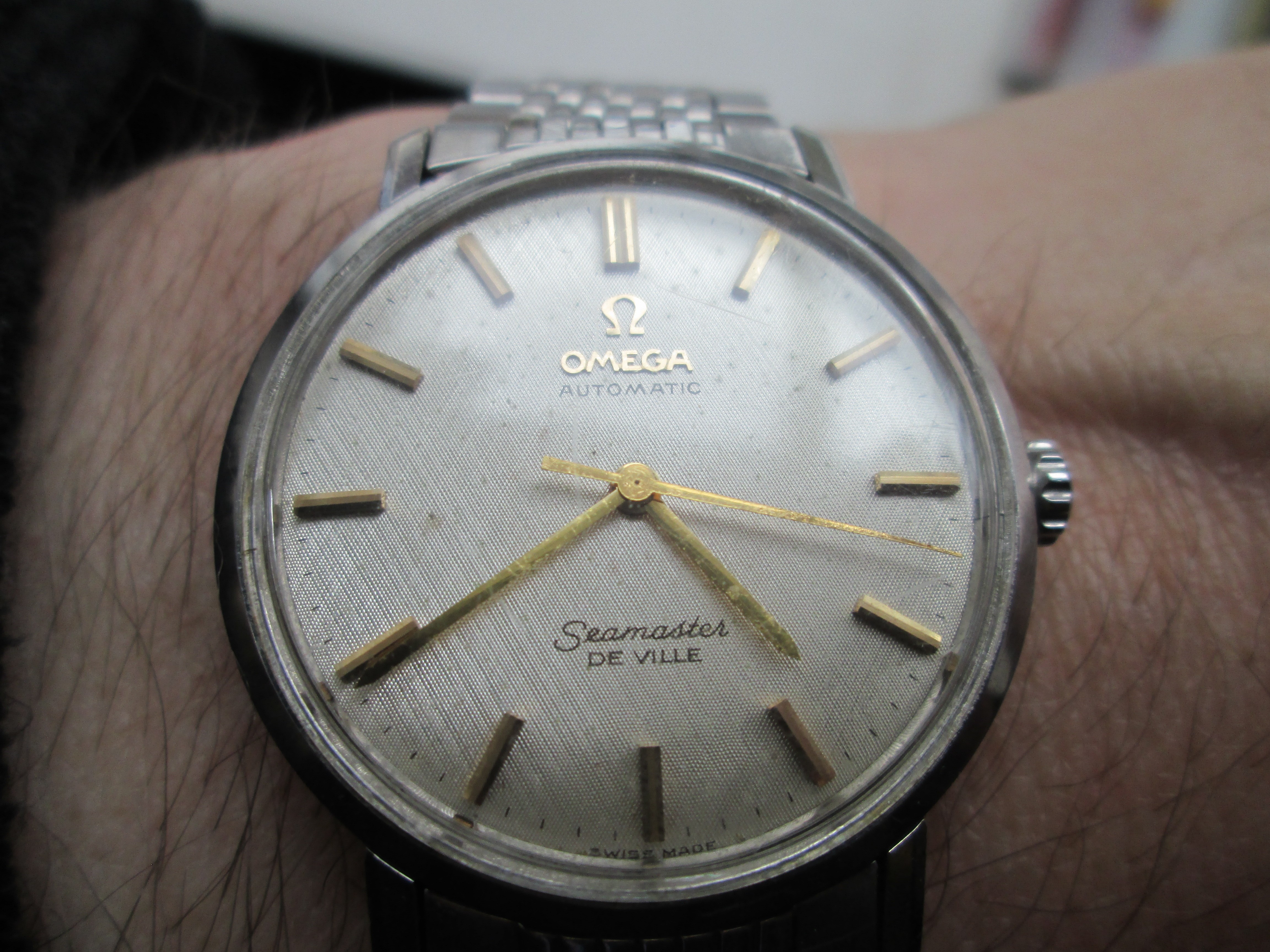

My first vintage was a Seamaster De Ville with a linen dial. The dial is not as perfect as yours but it's still my favourite watch. It also keeps the best time of any of mine. I once wore it for a month and it was 20 seconds out. They may not have the wrist presence of a diver or chrono but are a great start to a collection and still undervalued IMO.

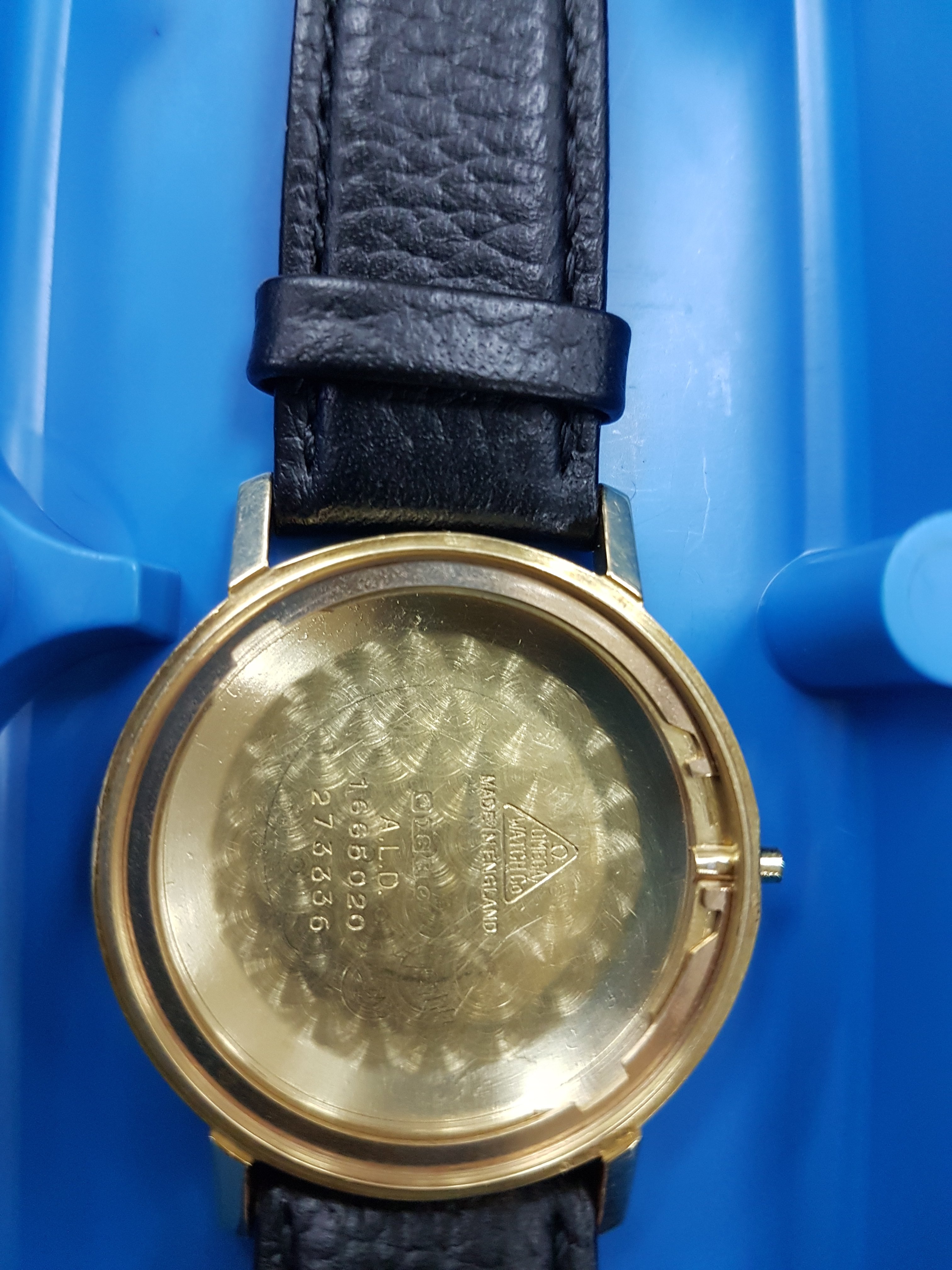

I think this is a monocoque case. It's not easy to open. Make sure you ask they know how to open such cases.

thanks a lot Edward. It's my first vintage watch too and it looks great in person, specially as it's solid 18ct gold. The dial is beautiful in linen.

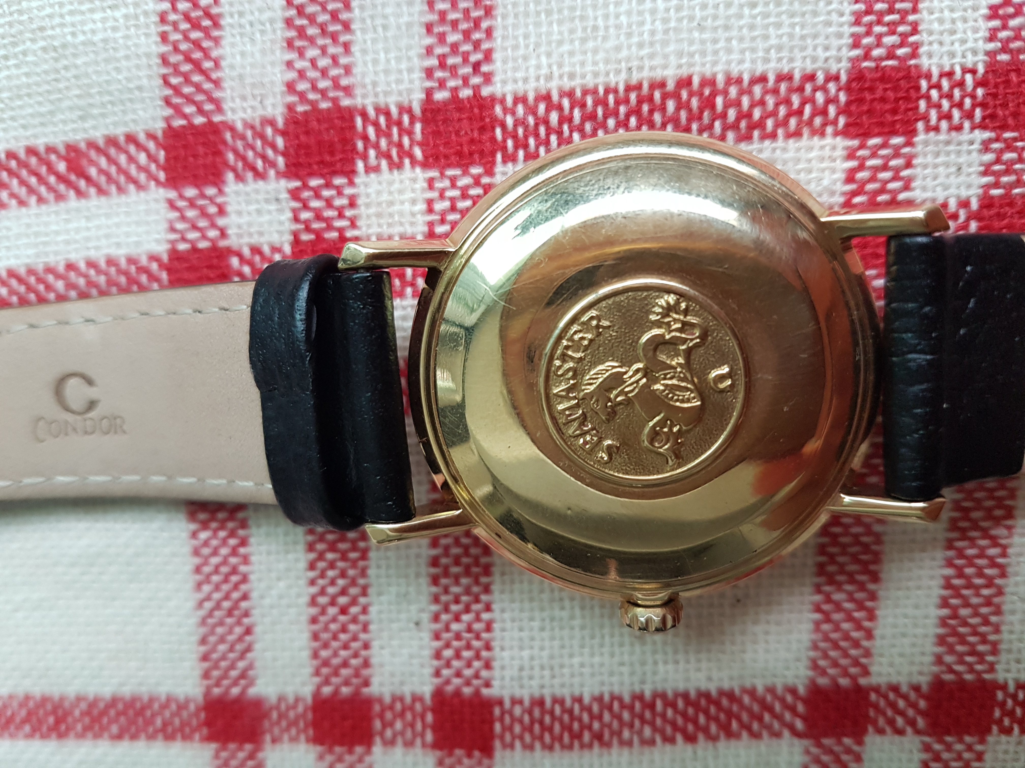

I was told by my local watch service centre that the glass may break if they open the case as they do not know if it's stuck to the case since it looks like it has not been serviced for a long time.
I live in Singapore but can get it done in London too.
Many thanks again
27
14
thanks, I think so, that's why the watch service centre said the glass might crack. Would you by any chance know the case reference number (the case material is 18ct yellow gold).

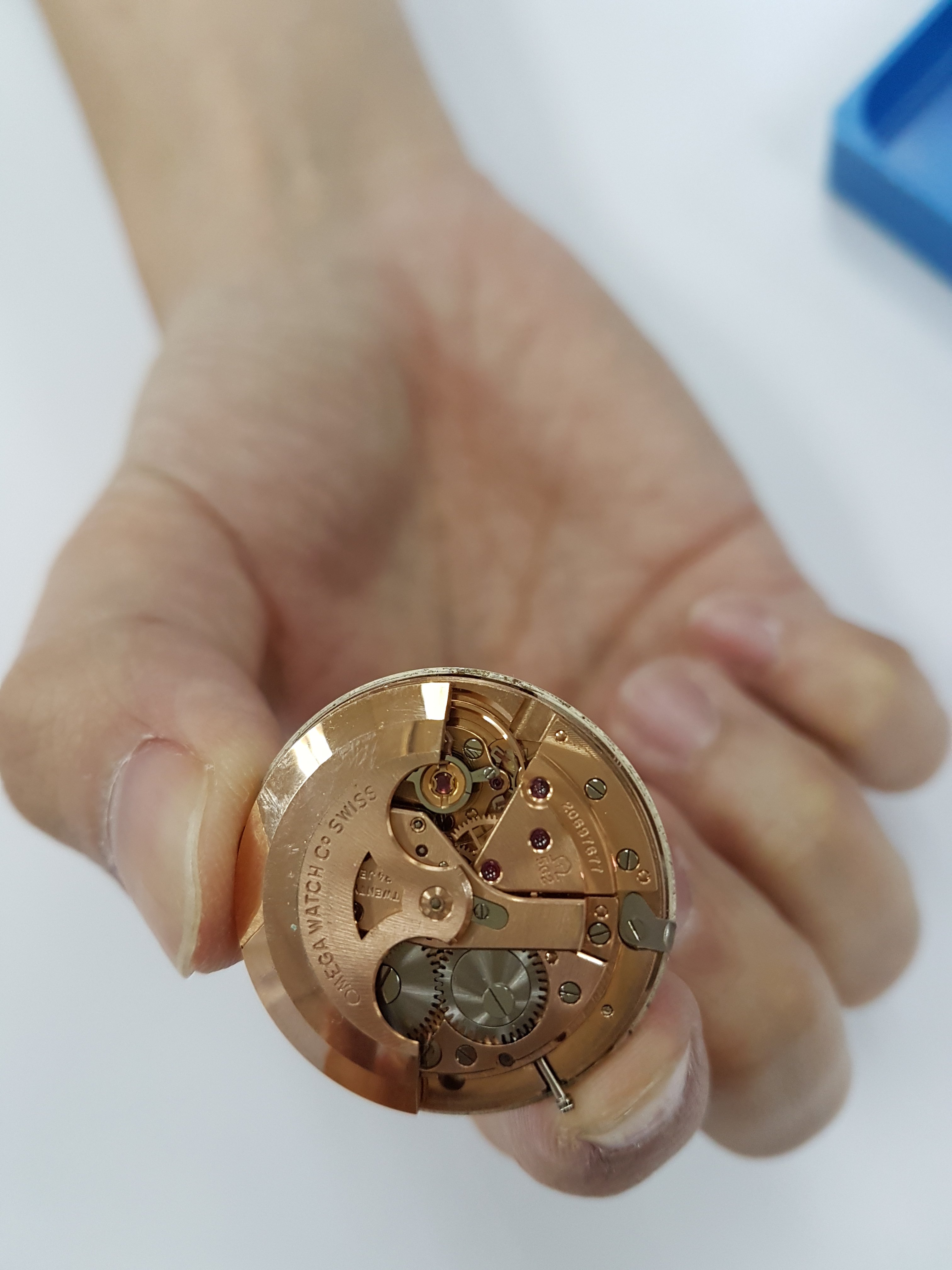

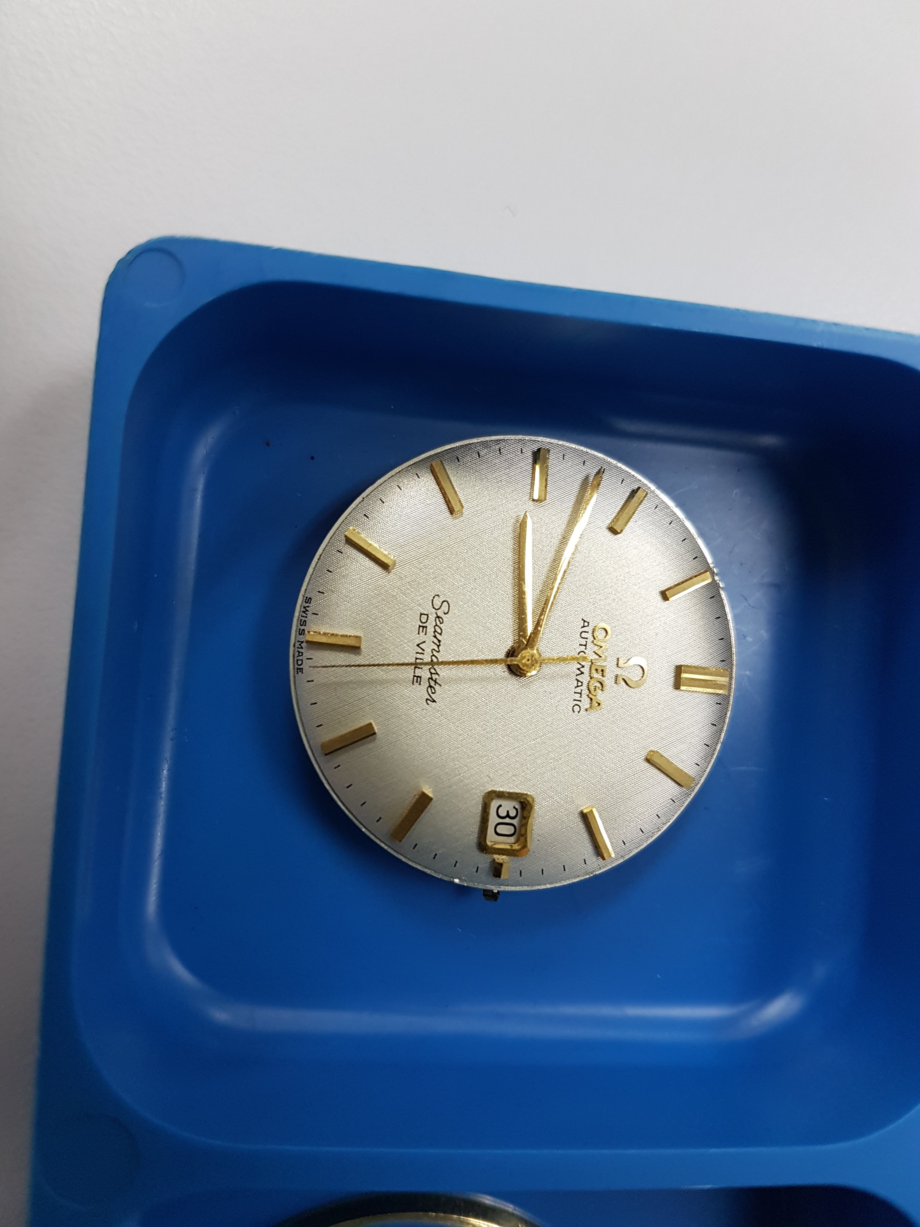

finally got an expert to service, they are called Horolab, a bit expensive at SGD 850 but they seem reliable. Some more photos of my watch 😀
