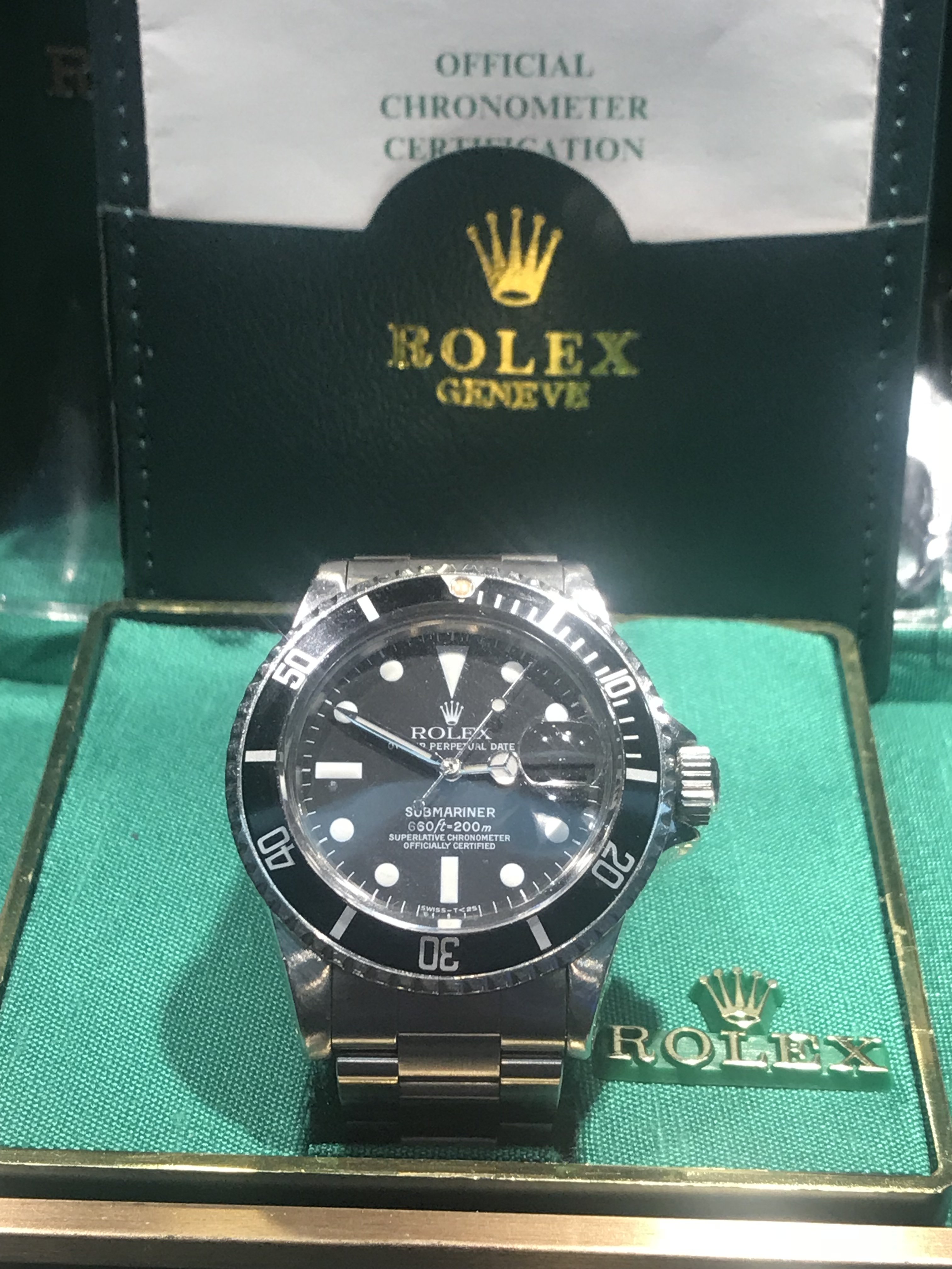

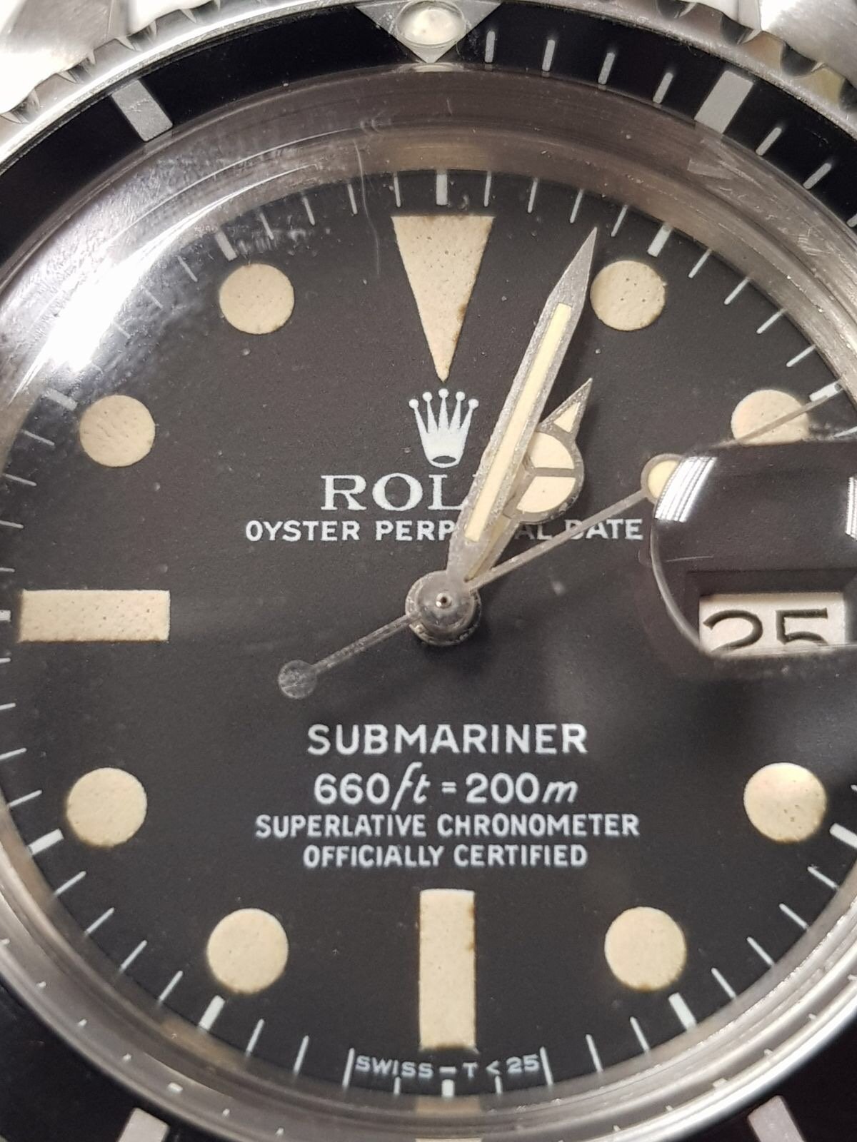

I’m offer to purchase this 1680 for 12.3k usd. With outer box and inner box as well as the anchor and punch cert. This piece also come with the AD receipt from 1977. Showing that the first owner bought it for 530 usd. I am aware that the dial is a type B service dial, the hands looks like service hands too. One thing strange is that he bezel insert belongs to 16800/16610 rather than the 1680 bezel insert. The seller promise to change to a period correct one before sales. Base on the pictures, is there any other warning signs that I should missed out. Is it safe to proceed with the purchase after the insert being changed? Is it worth the money? Is the lug way over polished? Hope some season collectors can give some tips as this is gg to be my very first vintage sub. Many thanks in advance!

Hello, you seem to be pretty well researched into the intricacies of these vintage Subs. I don’t know where you live, but I see a few large compromises here with this watch while paying a very high price it seems. Unless this specific watch is perfect for you I personally would pass and wait for another one. Even though the Sub is very popular, there are lots of them around everywhere. Just a thought, good luck.
1,306
1,463
this should not be your first vintage Sub.
12k for a service dial and hands and only a period correct bezel not the original bezel.
your call...

I'd pass, service dial & hands are absolute deal breakers for me. Why then buy vintage? Might as well go and buy a glossy dial (newer model) for a lot less.

Lumi service dial and hands=no fυcking way would I ever spend a penny on it.
Take your time and find a killer 5513.
$12k will get a nice example.
The white 1680 is the most ho-hum VR out there imo.

For that kind of money, i would wait and continue to hunt a better watch locally or import from reputable online seller like HQ Milton.

don't like the funk on some of the markers.
there are so many nice examples out there, so not settle.
honestly, just buy a 5513.

As others have said, most of the value in that watch is gone (not to mention the angry watchmaker who polished it). I’d absolutely pass.

Grossly over polished case + service dial/hands? And how in the hell did he get a 16800 insert into a 1680 bezel? Suggests tinkering around with the watch. Price? Ridiculous.
The white 1680 is a common vintage sports Rolex. If that's what you want, stay very patient and a good example at a fair price will pop up. My feeling is that you are anxious to get one? Stay cool and save ..
I'm a little new to Rolex; doesn't "SWISS -- T < 25" mean tritium dial?
2,443
4,231
As I said above, I'm a little new to Rolex. How do you tell from one photo that the case is grossly overpolished?
