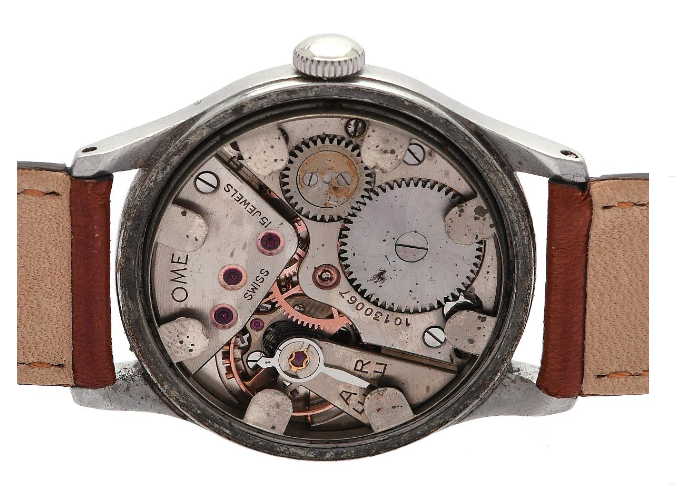

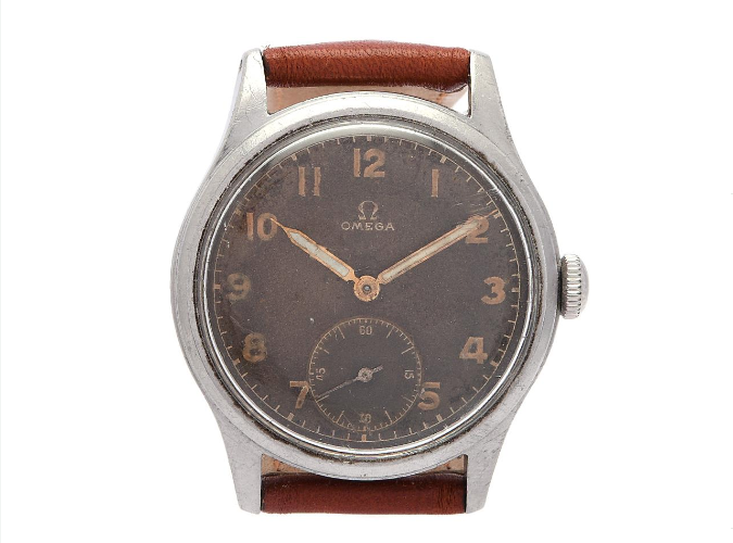

Hello fellow watch lovers,
I've been eyeing for an Omega Officer (black), or an Omega Suverän (black) as my first vintage mechanical watch. This one seems to be authentic to my untrained eyes.
Q1: Given the condition, should I get this particular item or continue searching?
Q2: What is a fair price range for this item to be paid?
Q3: What additional service should I plan for this item?
Seller's description:
"OMEGA, Sovereign, Cal 30 T2 PC, Series no. 10130067, Ref no. CK 2400, Boett no. 2400-2 / 3274, men's watch, 35 mm, steel, manual, plexiglass, small second hand, damaged dial, leather strap, ca 1944."
Thanks,
Rait

Lume on the hands look very strange (I'm not familiar with that reference)
I would stay away from damaged dials

Relumed hands, tired dial, tarnished movement. It's important to see the caseback.

The hands are relumed. It´s impossible to asses the dial without better pictures. In all, the watch is correct. The movement is dirty as seen.

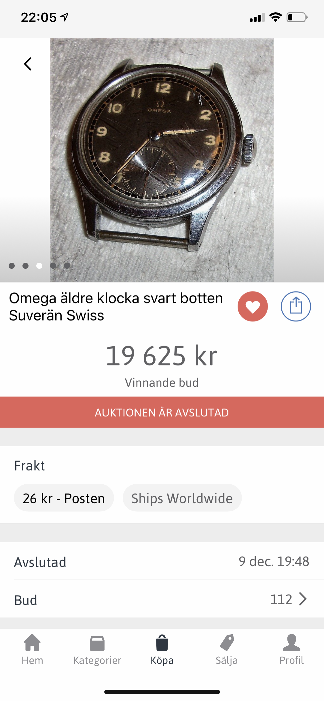

These are very sought after in Sweden and I think I would not be willing to go to more than €500 on this particular watch(I know, I’m cheap, but you have many unknowns), although I’ve a feeling it will go beyond this at the auction. The last black faced Suverän I saw (sold on Tradera) went for €2k to a member of this forum, but it was in lovely condition.

Is it only the picture or have the lugs been bent?
Well, the strap does his best to fit...

Looks like top lug is bent. Hands not original. Trashy dial, tired movement
I'd pay about $75.00 for the balance and gears and trash the rest.
Look for something else and in nicer condition

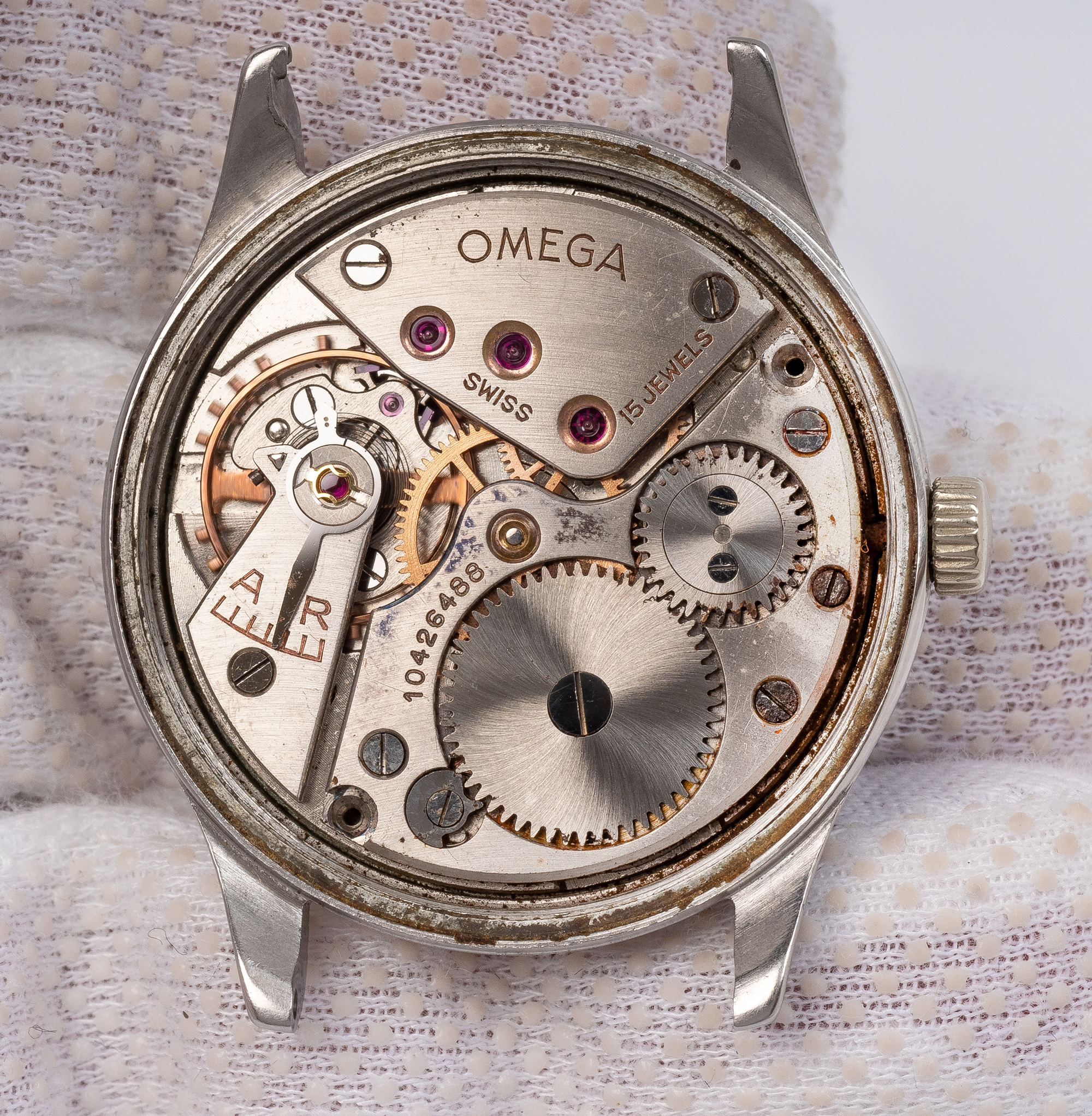

How do you manage to asses the dial with that picture (reflexes) and the heavily scratched dial?
Regarding the movement I enclose a picture of a similar "dirty" one. It runs flawlessly and these movements are real work horses. It has also experienced moisture as seen on the picture.
(I have no interest what so ever in the watch we are discussing).

First of all. You assessed the watch as correct when the hands are not correct. They would be silver to match the small second hand
Second - oxidation on the crown wheel shows a possible underlying moisture problem
Third - Lug bent and case has a dull finish which could mean metal fatigue along with pitting behind two of the bottom lugs
Fourth - Seller says dial is damaged
Your watch
Damaged lugs - garbage case
Rust around the outside, in some of the screw holes, on the crown wheel and on the stem
$75.00 as the balance looks good, and some gears
I rebuilt all these movements, so maybe I have no idea what I'm talking about 😀
Just because it says Omega. Doesn't mean it automatically has value. One need to examine the entire watch carefully to avoid falling into a money pit of repairs or worse. A complete waste of money on a non fixable watch
This is just my opinion. Everyone is entitled to their own. If you don't agree with it. Thats your choice and same for others, but I would not buy it. I would wait and look for one in better condition and pay a little more

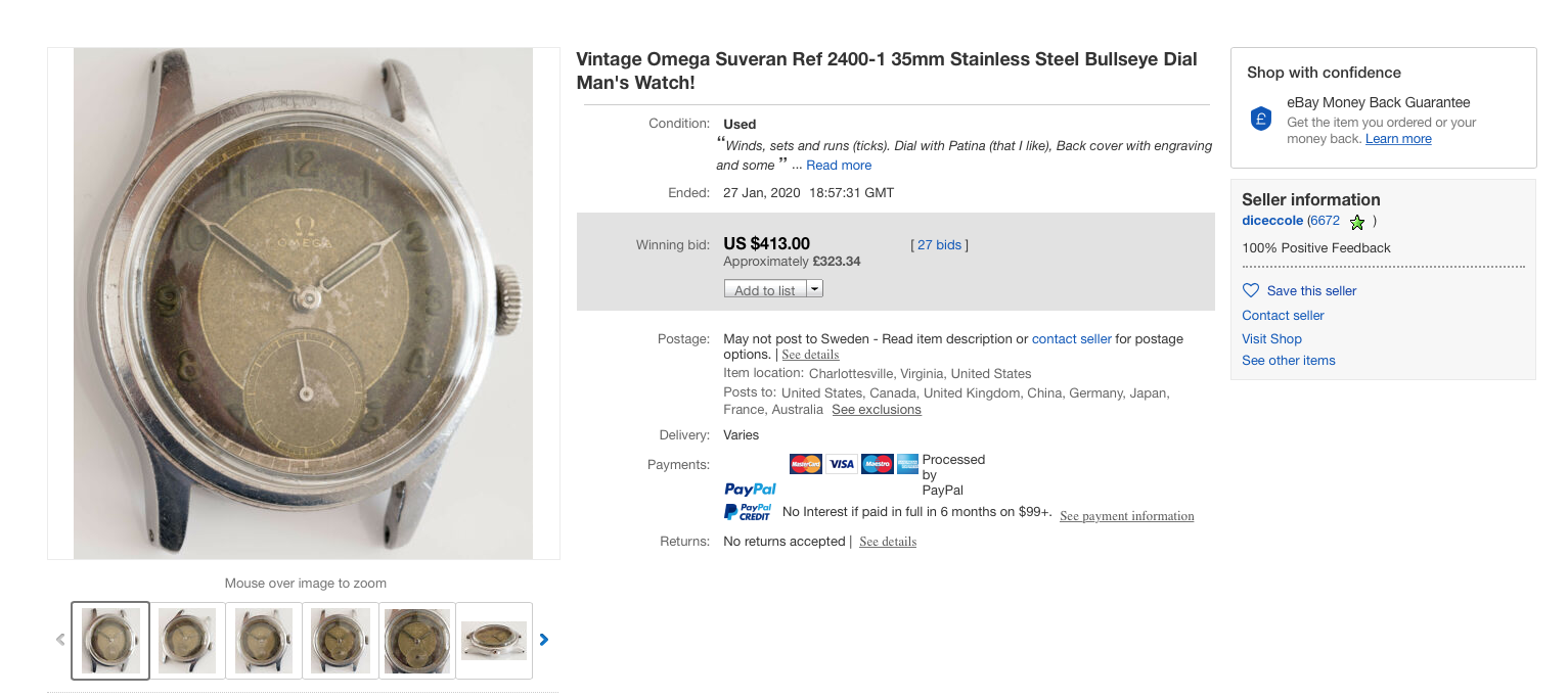

Moisture - Yes. Worn case - yes. Many of the Suverän watches suffer from heavy use. But it's the dial that is important. I can not asses how damaged it is. (damaged crystal). The radium looks good. I stand corrected about the colour of the hands, though the type is correct. The specific watch will be at auction on March 7. I will be surprised if it don't sell for at least US $400.
