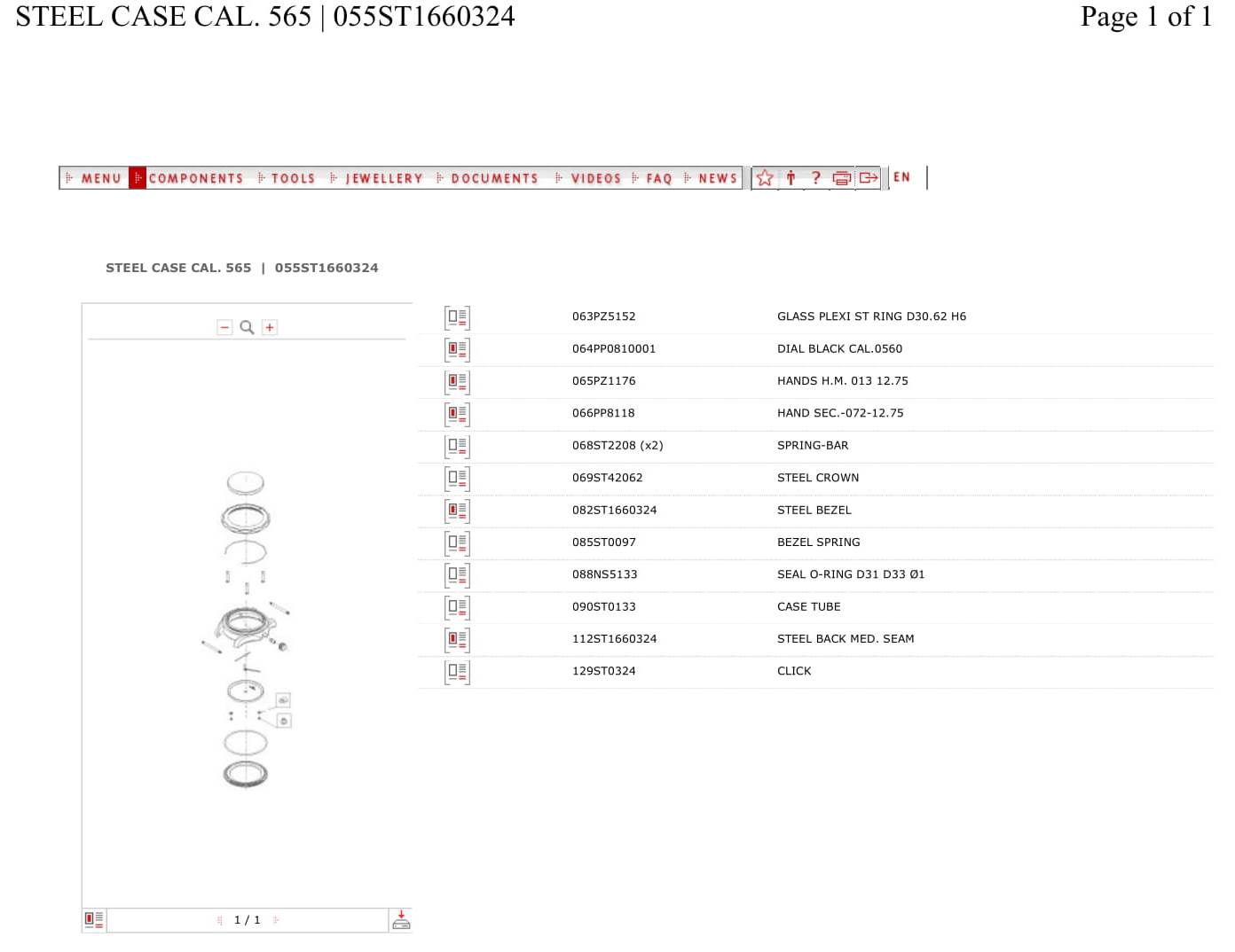

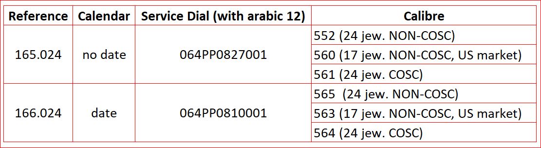

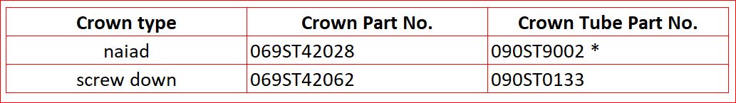

Please,can someone enlighten me which parts are needed to build a Watchco SM300?
2-3 years ago, I was just like you, I have had a crush on building the Watchco SM300 😀
Eventually, I gave up this project because I wanted a Big Triangle dial, but those do not exist as service dials. All what you can build is a Watchco with an arabic 12 o'clock index.
If that helps, here is some data which I have gathered that time.
That screen, shows you only one configuration, while most of the parts are common for the other configurations, here is a suplement.
Calibres 552/565(&562)/560/563 have been seen in the real vintage SM300.
561 and 564, as far as I know have not been cased by Omega but those may be a nice upgrade if you care about COSC.
Late(r) production watches had a screw down crown, early production had so called "naiad crown" which was smaller/shorter and imho is a much nicer crown.
That crown tube (090ST9002) for the naiad crown you need to double check - I cancelled this project before had it confirmed for 100%.
Bracelets are here;
https://omegaforums.net/threads/bracelets-for-166-024-166-0324.61033/
Good luck!
Bracelets are here;
Good luck!
