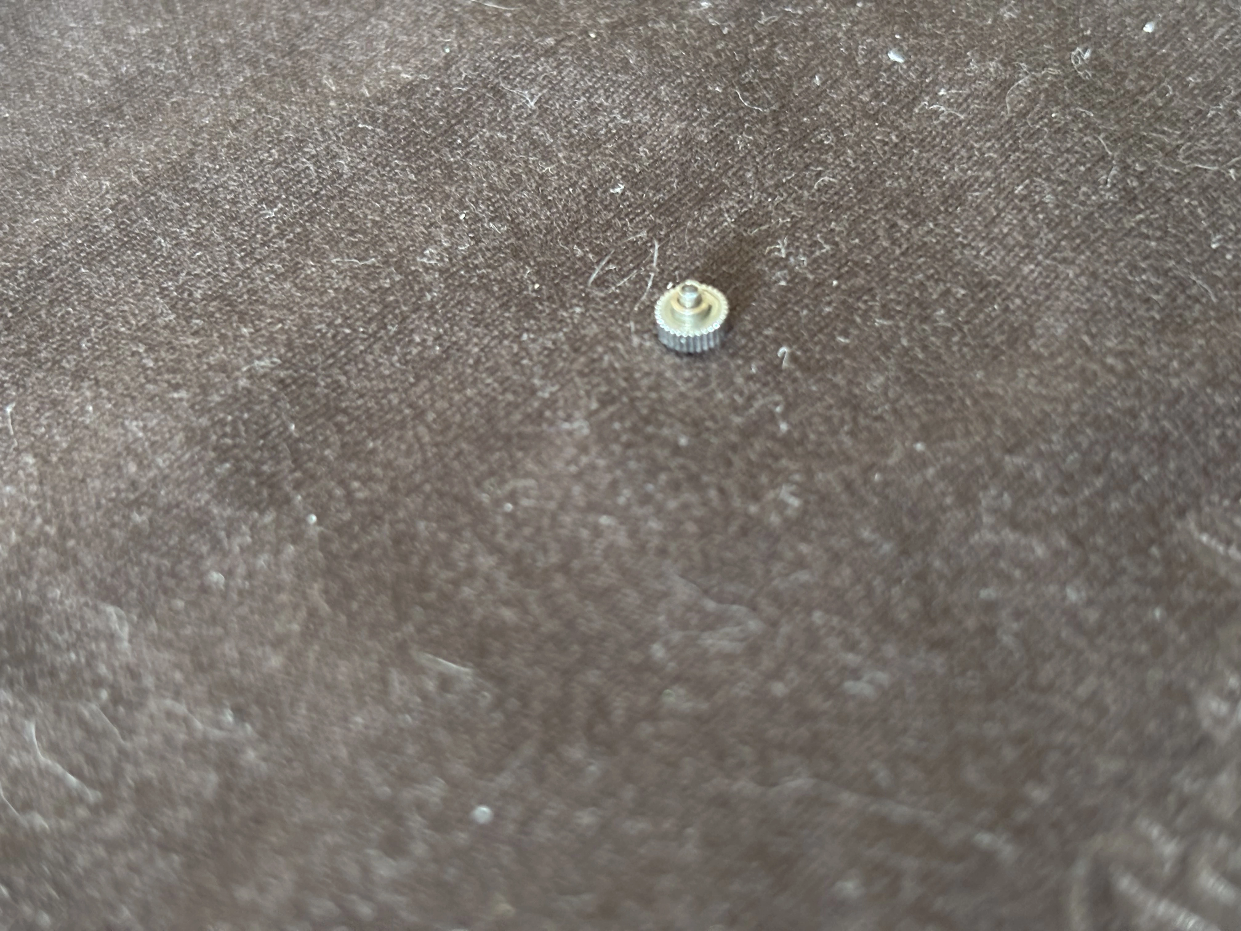

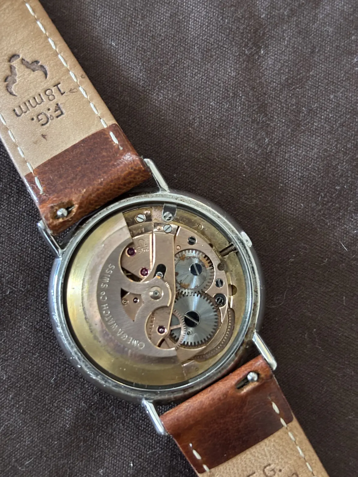

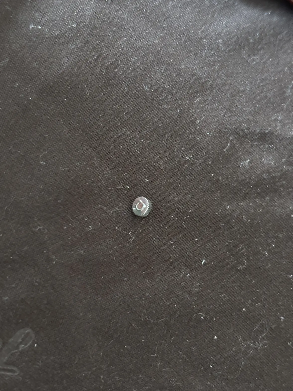

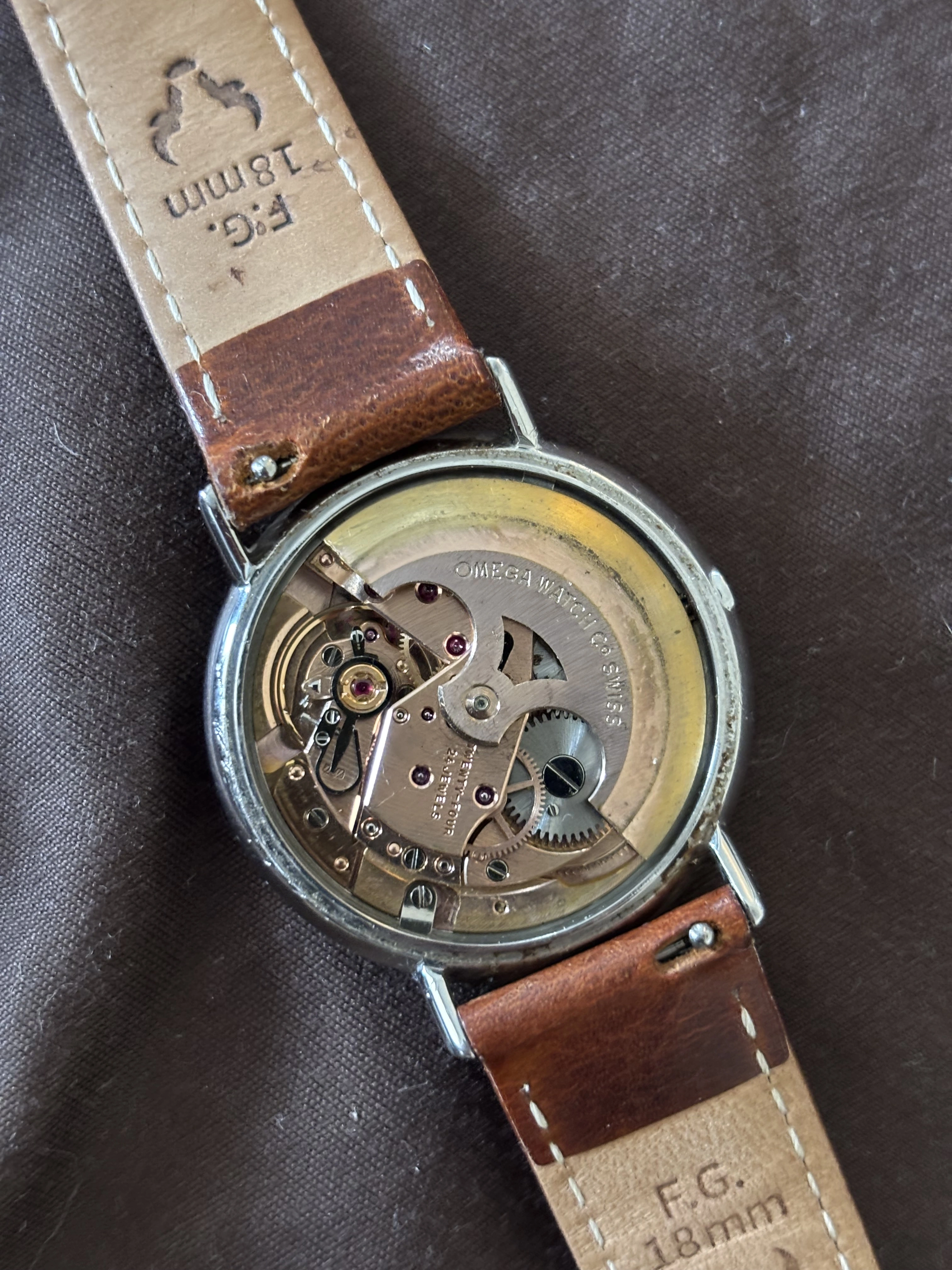

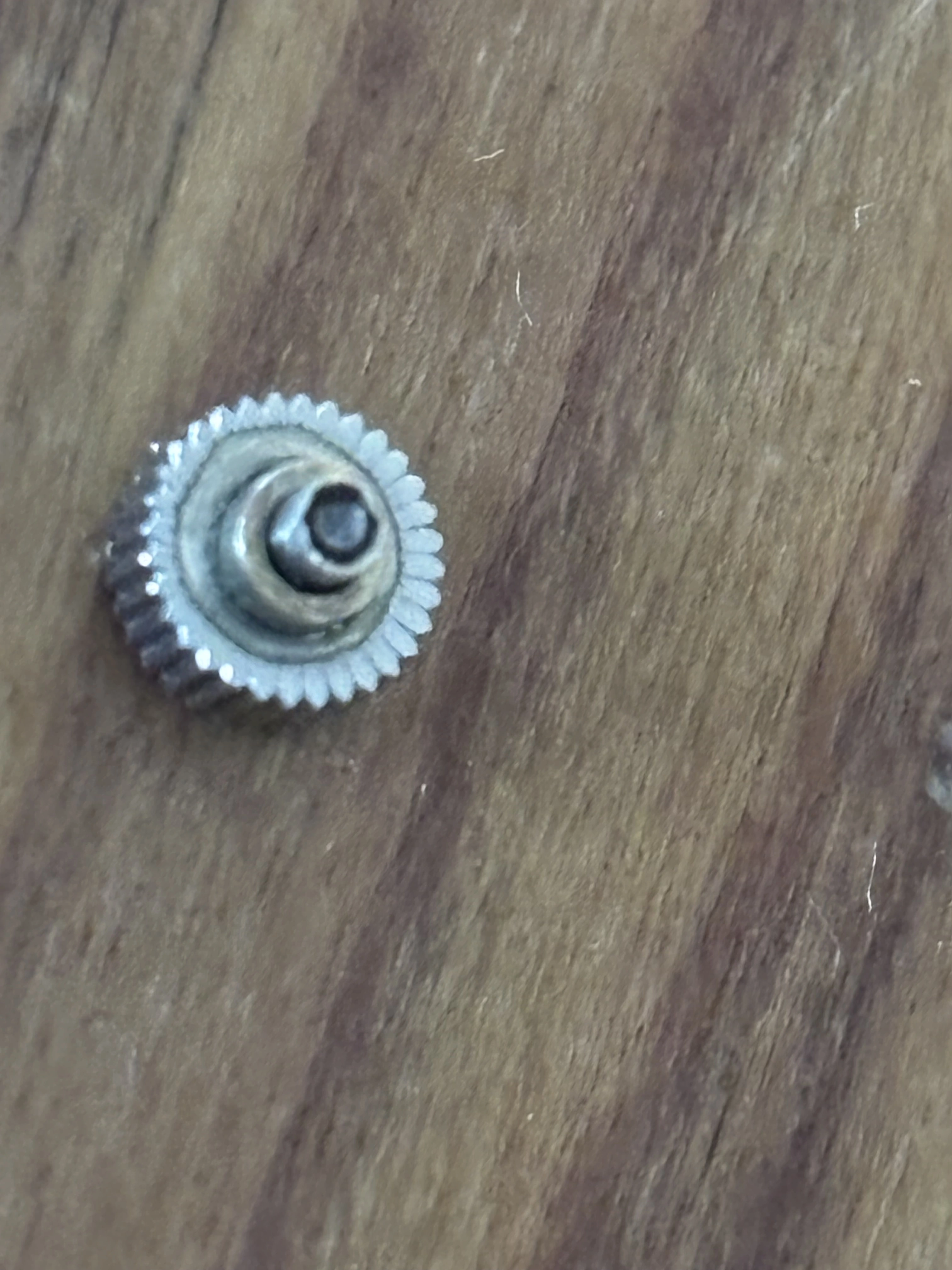

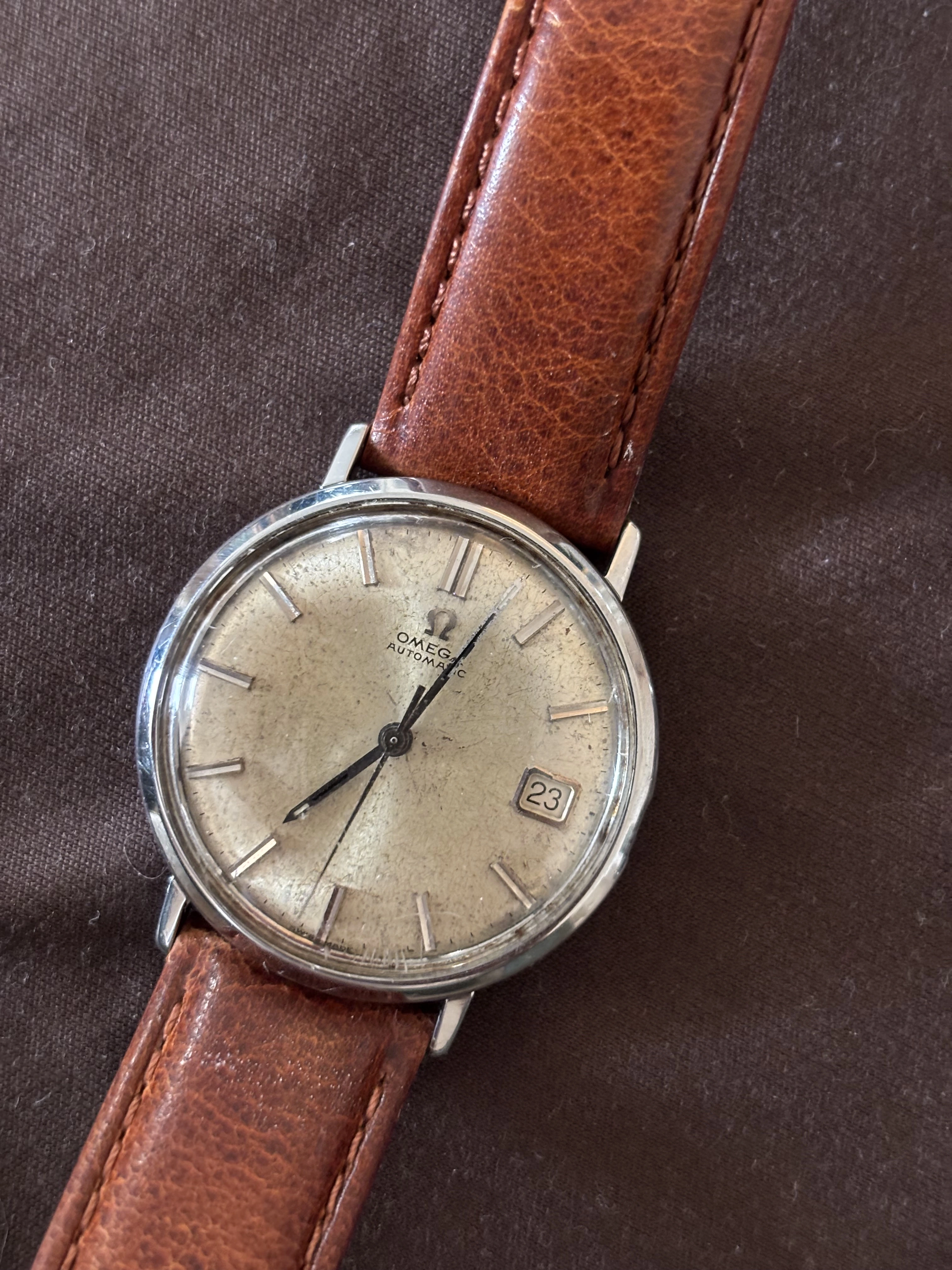

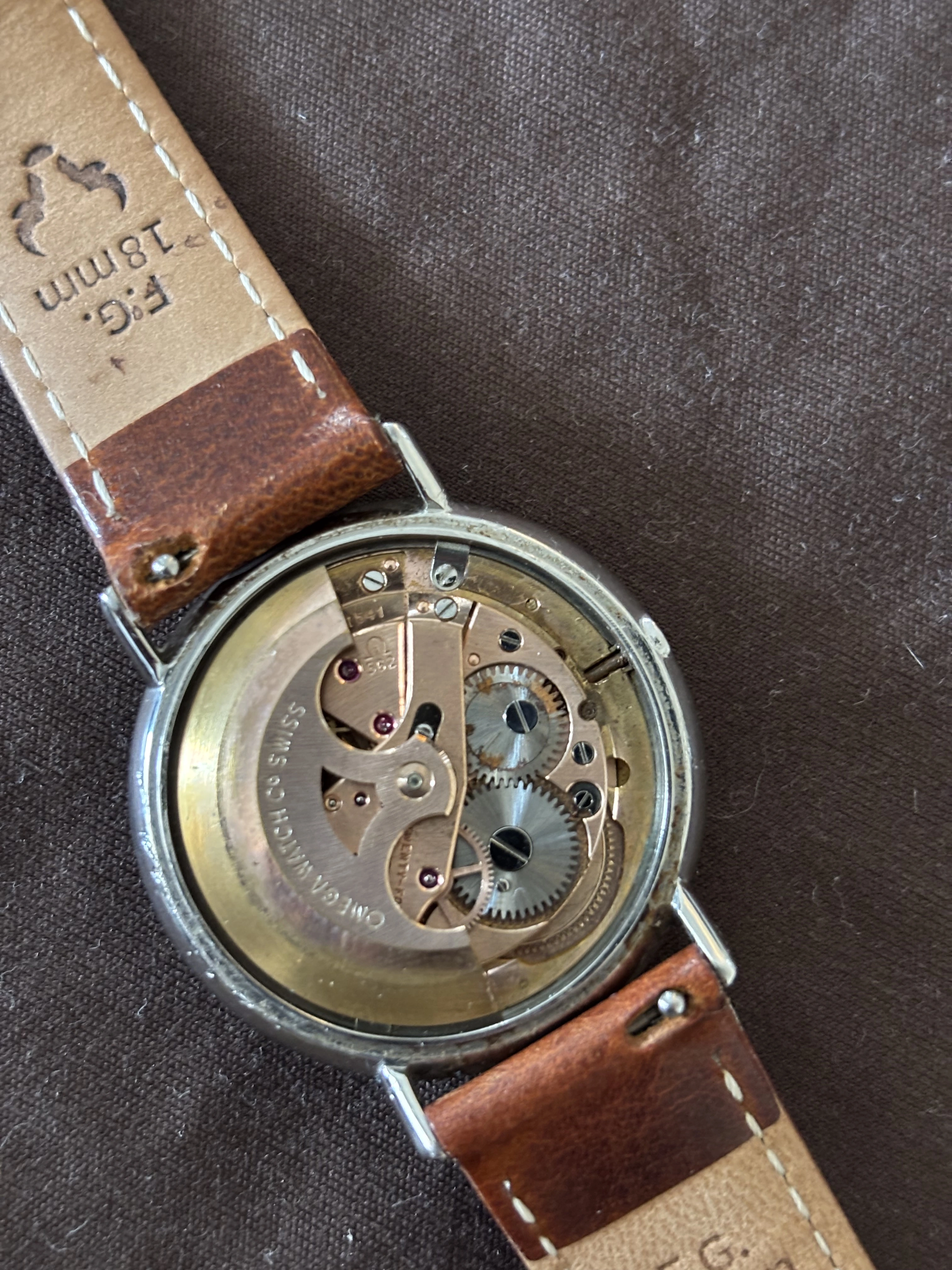

I’m currently working on my vintage Omega reference 14791 fitted with a calibre 562.

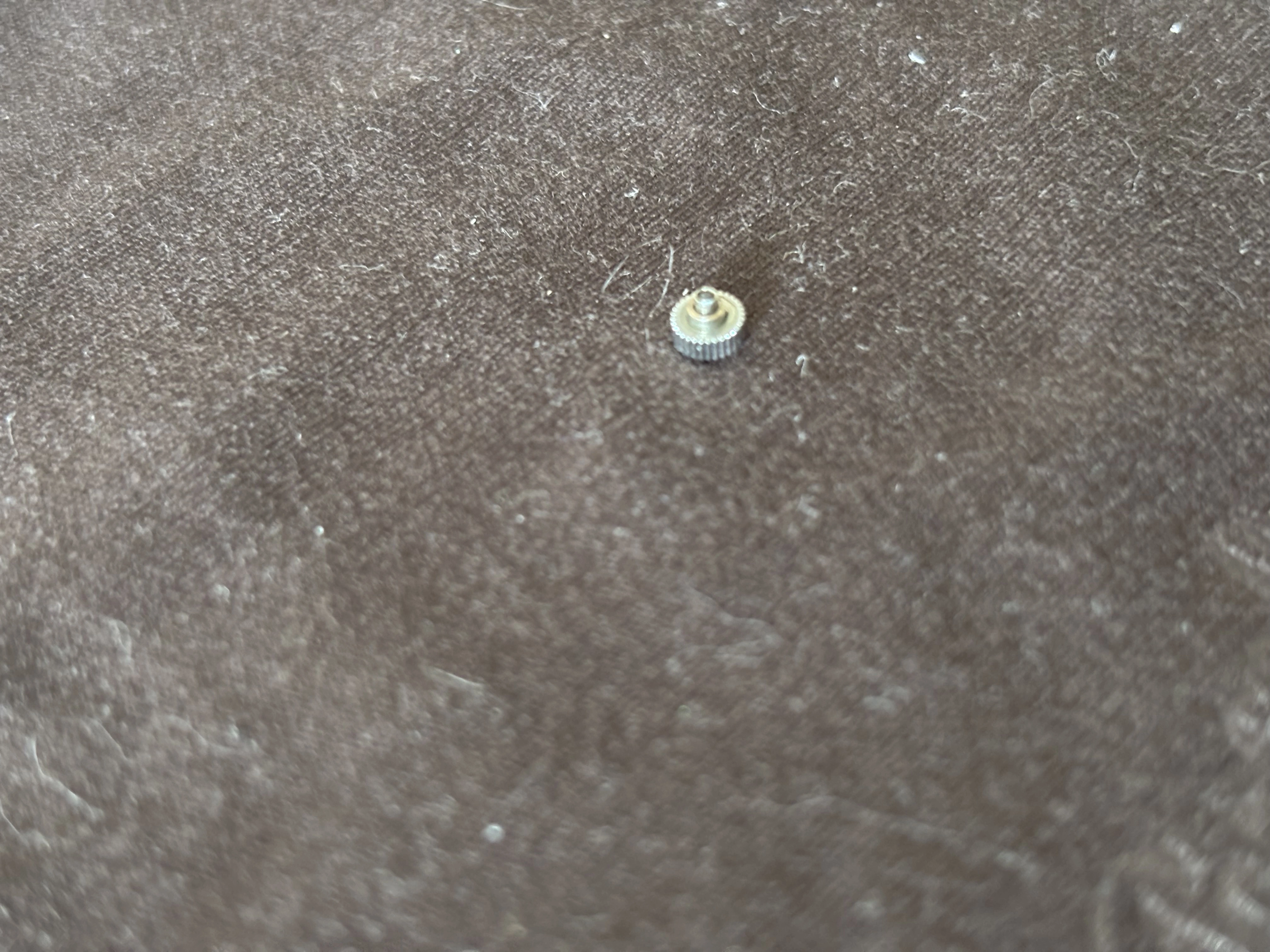

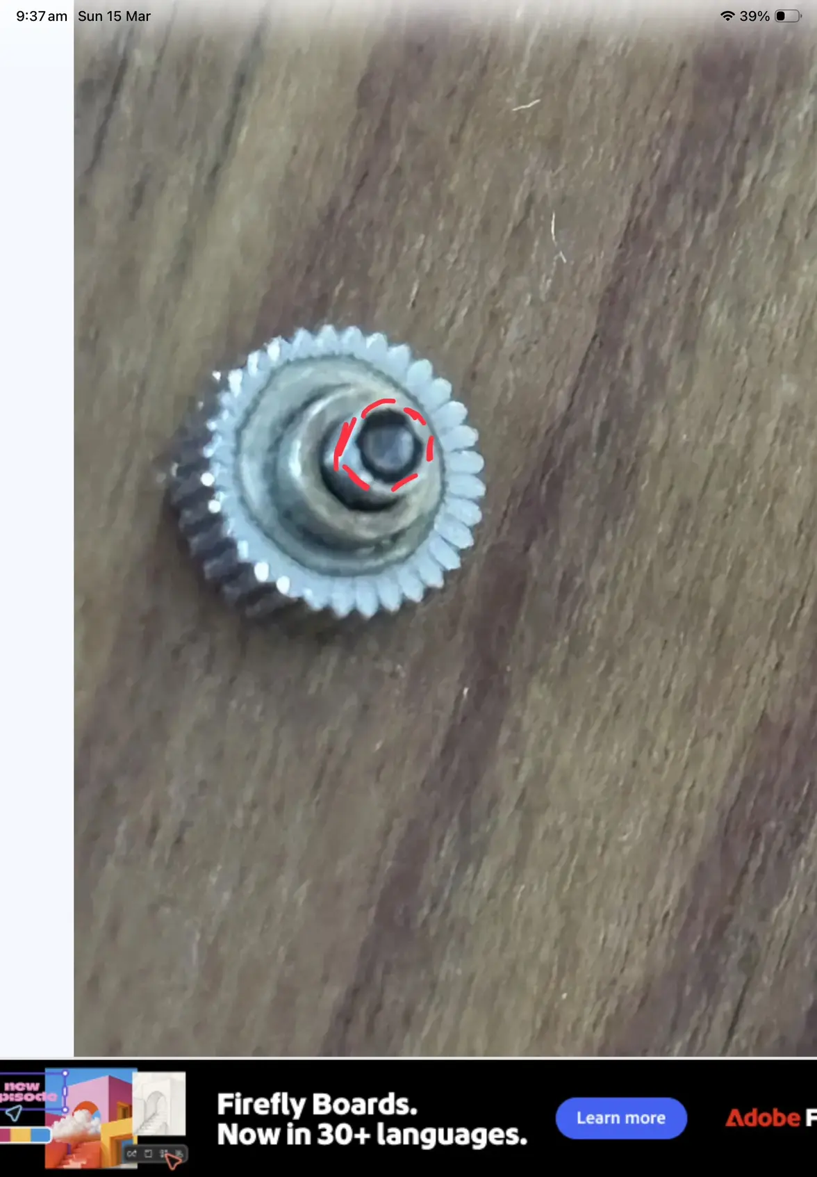

The crown came off, and after inspecting it I believe the winding stem broke and a piece of it is still stuck inside the crown.
The watch is still running: since it’s an automatic movement, if I get it going and set it to the correct time it will keep running on the wrist. However, without a crown it’s obviously not very practical to use and the movement is not very protected..
Ideally I would like to:
  • remove the broken piece of stem from the crown
  • buy a new stem (ref. 550-1106)
  • and reuse the original crown if possible.

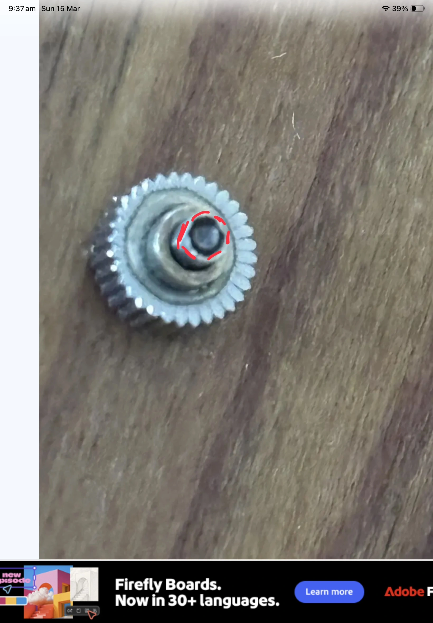

Here is what I can see so far:
  • the crown looks fine from the outside
  • there is a small metal piece visible in the center (likely the threaded end of the stem)

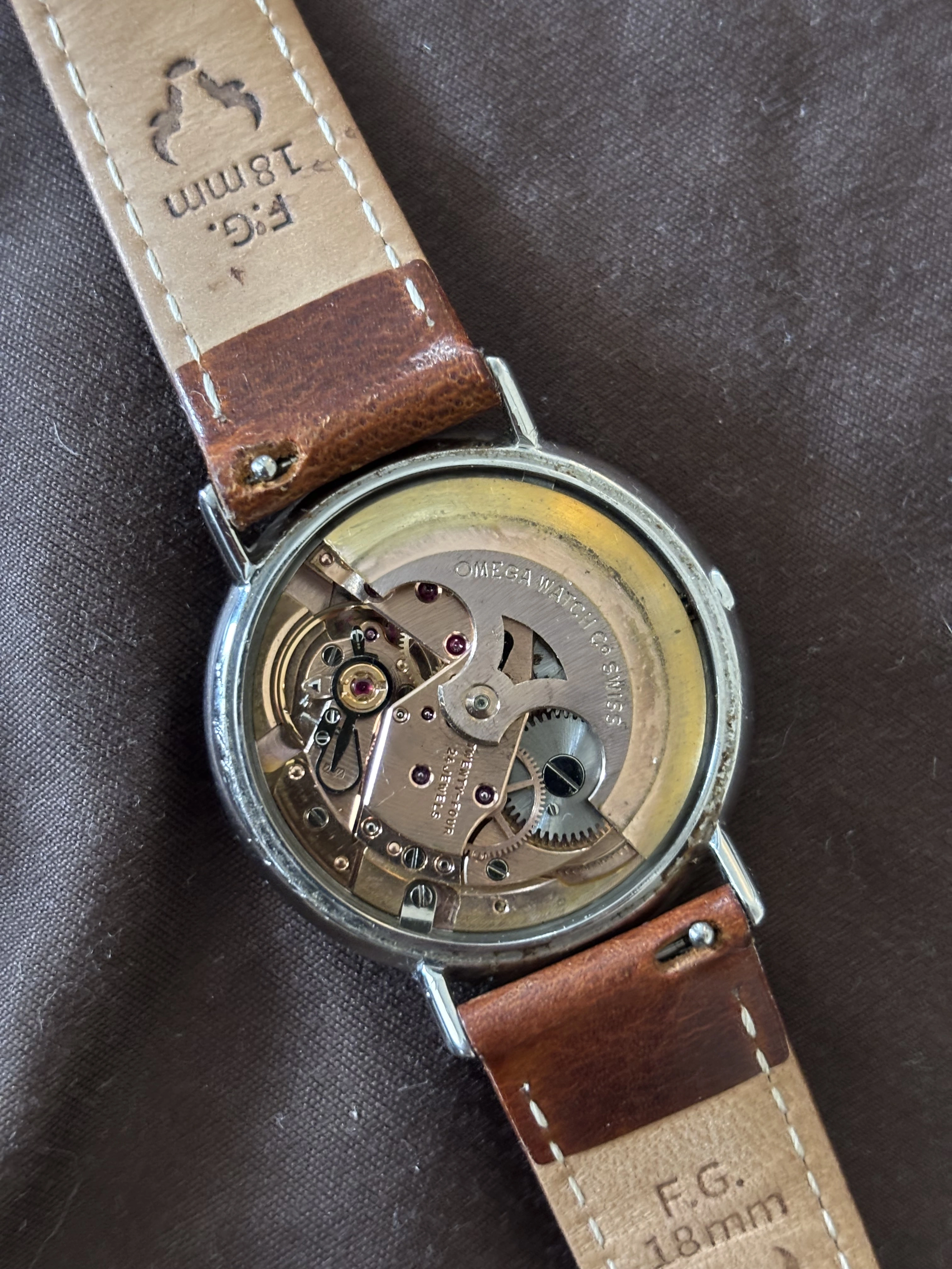

  • the movement itself looks clean, just a bit of rust.
My questions are:
  1. Do you think it is realistic to extract the broken stem piece from the crown?
  2. Is there a recommended method ?
  3. Is 550-1106 indeed the correct stem reference for the calibre 562?
  4. If the crown cannot be saved, does anyone know the correct crown reference for a case 14791?
I’ve attached a few photos of the crown and the movement.
Thanks a lot for any advice!

You could dissolve the broken stem in a saturated solution of alum, but as it looks pretty shagged you should probably have a new one fitted when you get the movement serviced.
(It needs it badly)
