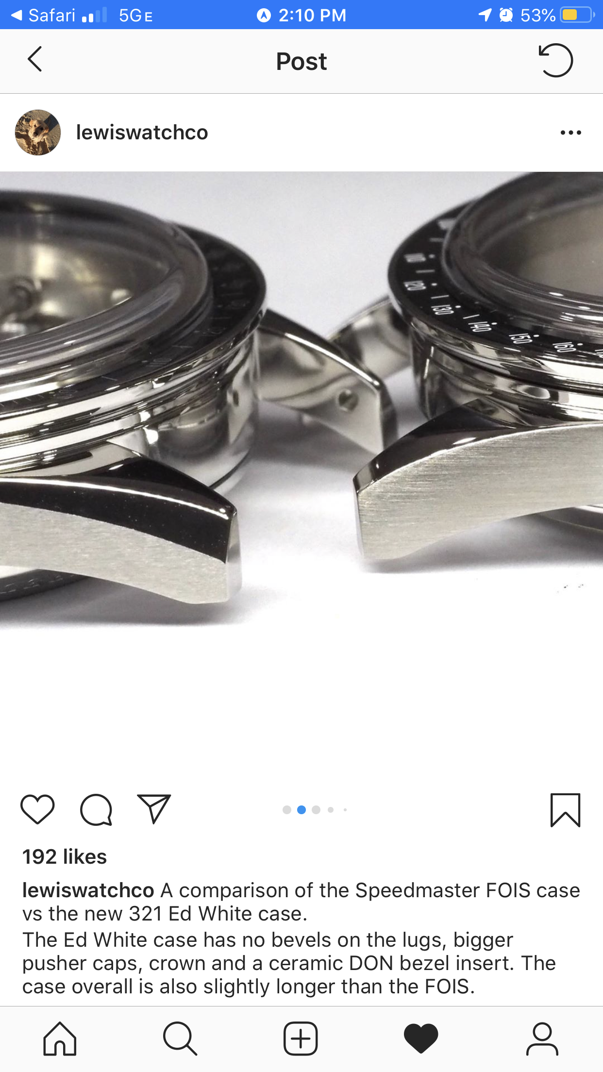

There are subtle differences in all the straight lug cases and several manufacturers. Your assumption that the cases from 2915, 2998 through 105.003 are identical is most certainly not correct. Did you search on funky lug bevels like I suggested? That would have given you some insight into the differences between 105.003-64, 105.003-65 and FOIS. Incidentally the new case seems to have a ridge between the lugs which engages with a lip on the new bracelet, that is not present on any previous straight lug. This will likely mean the bracelet can not be fitted easily to older watches, much to the disappointment of many here.

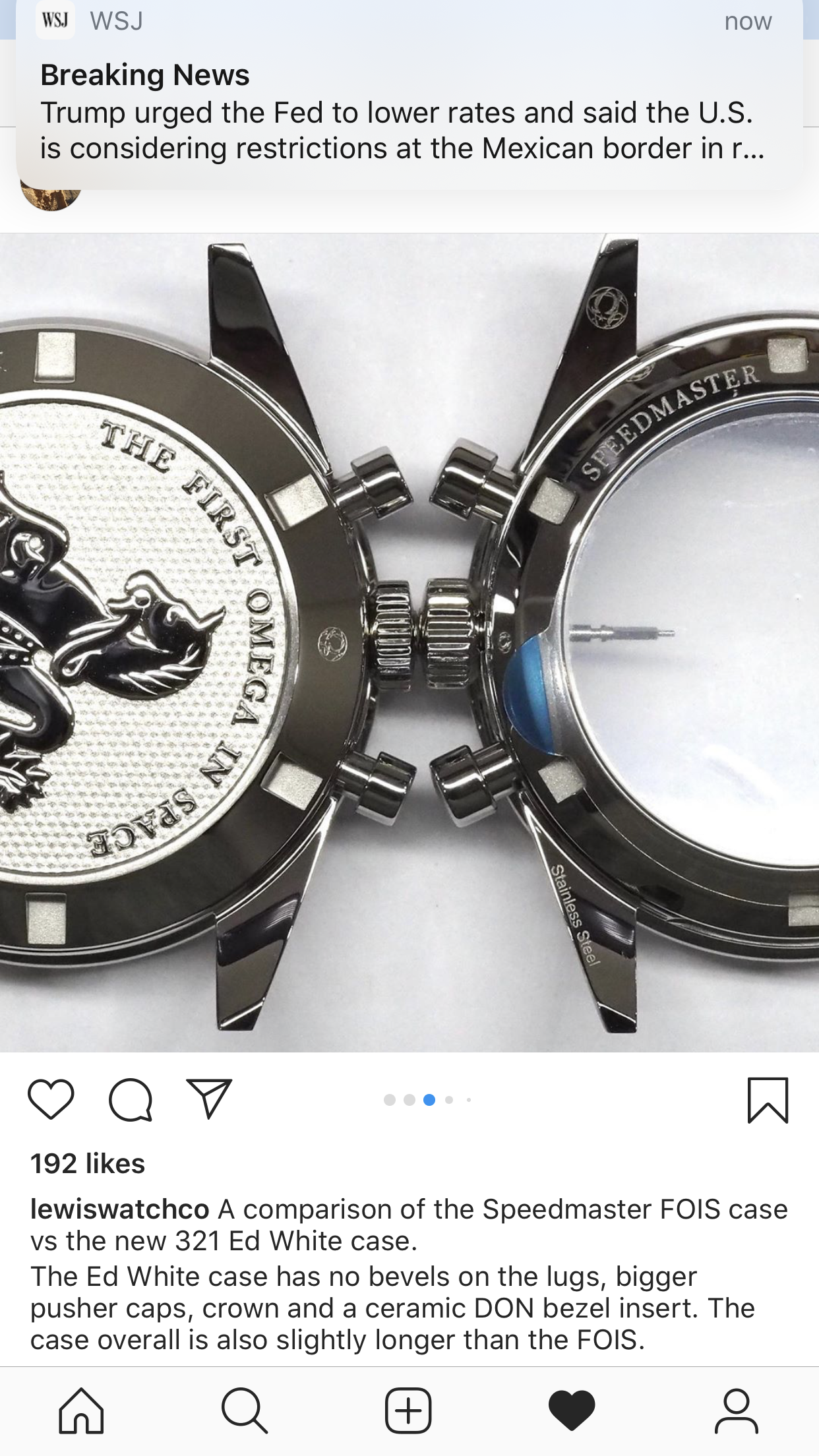

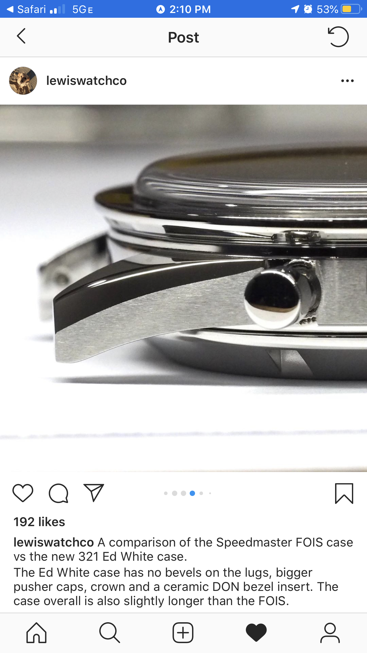

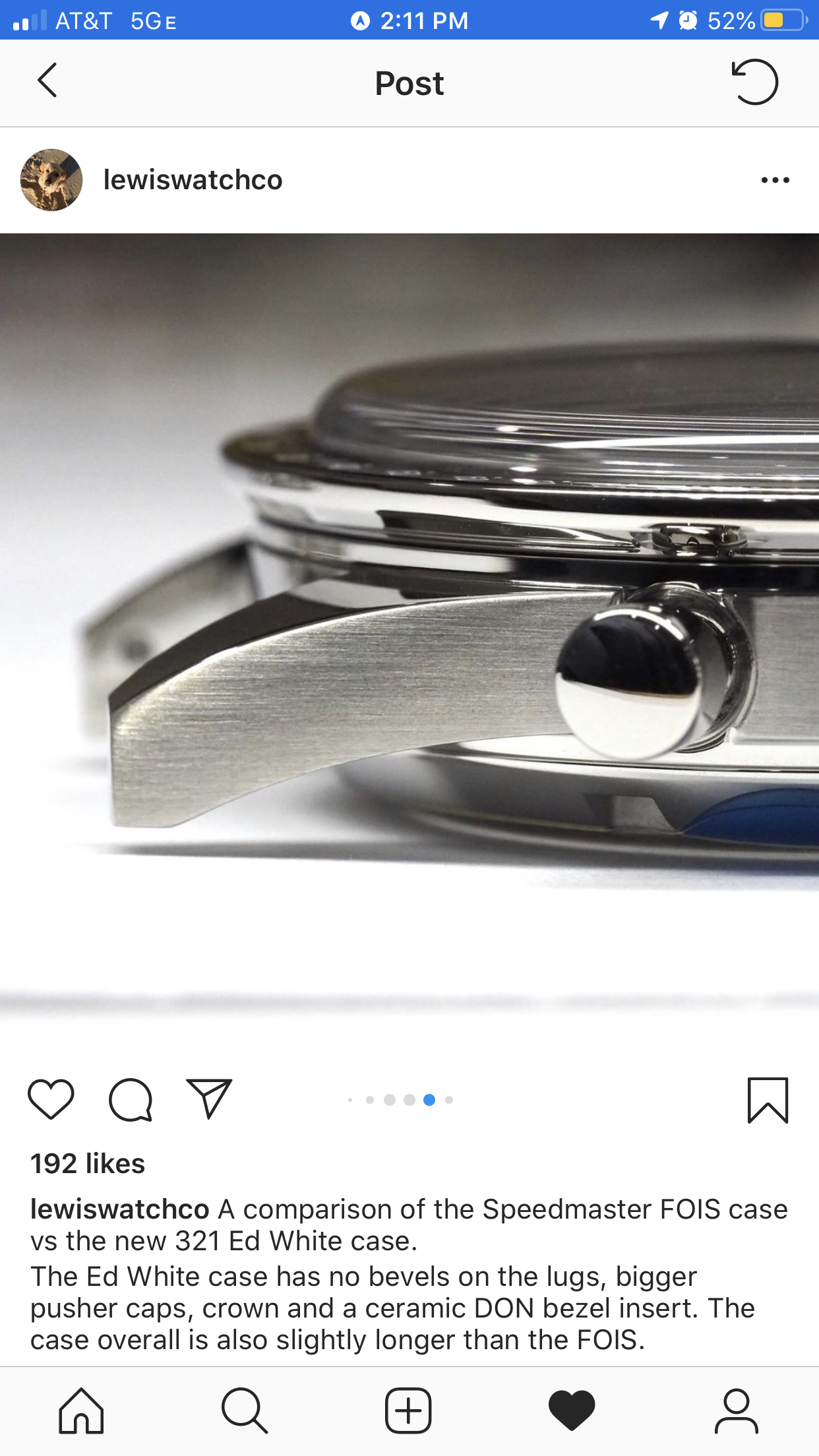

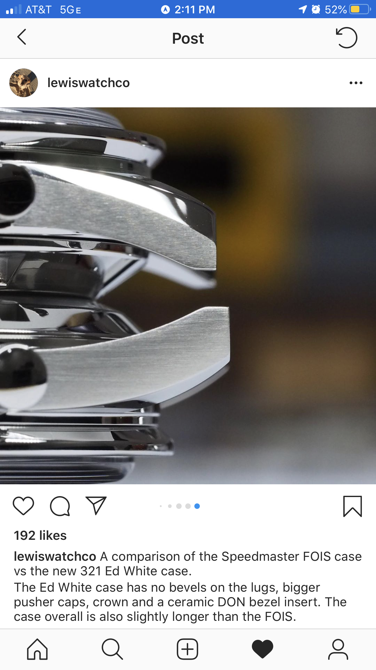

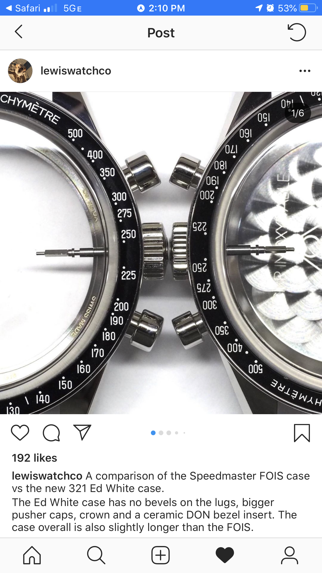

He hasn’t yet answered on is IG page why/how he got the photos or the case - which surely seems the most burning question!
Anyways, photos!
506
4,809
Anyways, photos!
I suspect he won't be selling it like the 50th anniversary bracelets 😉
3,997
9,030
i don’t know the backstory here. But his IG Comments were focusing a bit on bracelet fit and modification of the 321 to the FOIS case
Anyways, photos!
Here is a crazy theory:
Perhaps he is one of the 'single watchmakers who will assemble the whole watch' (for the Australian market). Perhaps Omega are tapping into their certified-watchmaker-network to do the assembly per continent, and just shipping parts...
Like I said...a crazy theory.
30,290
78,193
I suspect this theory is crazy. He just bought a case from Omega...they are available.
