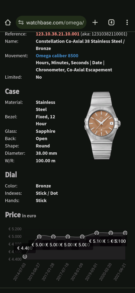

Hi
With this photo and model: 123.10.38.21.10.001, can you estimate the year?
Thank you

Not older than 2014 it seems:
Yes, and I think the new models were introduced in 2021 or 2022, so this one is likely from the later years and not that old. Just wear and enjoy.

the new collection of constellations launched in 2020. After reading of this collection, I think my model belongs to period [2007-2019] double eagles.
10,785
16,789
The dial text layout on your watch is not the same as the model launched in 2007 so it's not one of the first. I don't have much serial data on recent Connies but the look of the cards and box might give you a rough idea as they have changed over the years. If your cards look current then it won’t be any older than 2015 maybe. To give you some idea why serials can't be relied on without other data, I have a 3rd Gen SMP from 2015 with an 89m serial, and a 4th Gen 2022 model on a 83m serial. It's apparent the serials aren't running sequentially any more, they seem to be filling in gaps in movement sequences.
