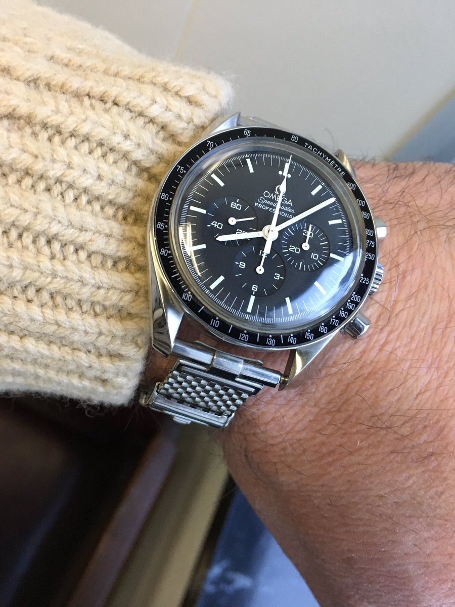

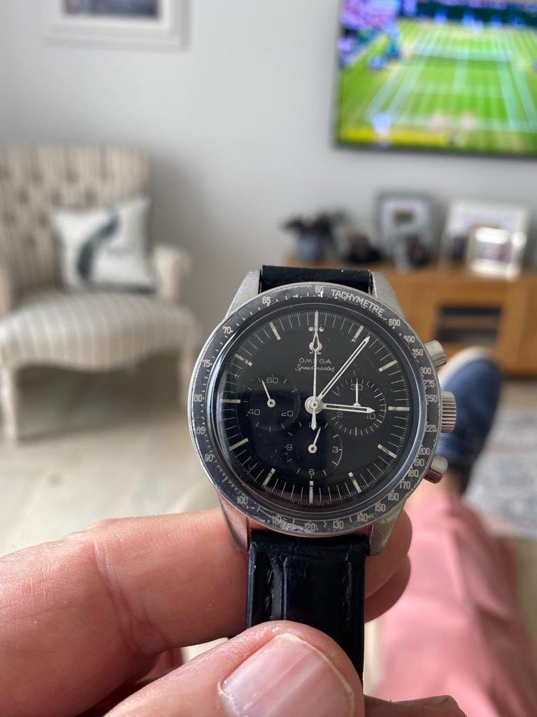

Hi new to watch forums trying to help my Dad with his omega speed master , he requires a replacement strap /braclet , not sure best place to try and find one , all I can see on it are the 1162/ 172 and 173 on the braclet any help much appreciated

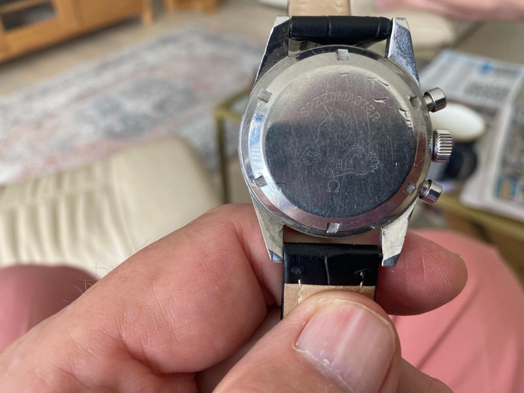

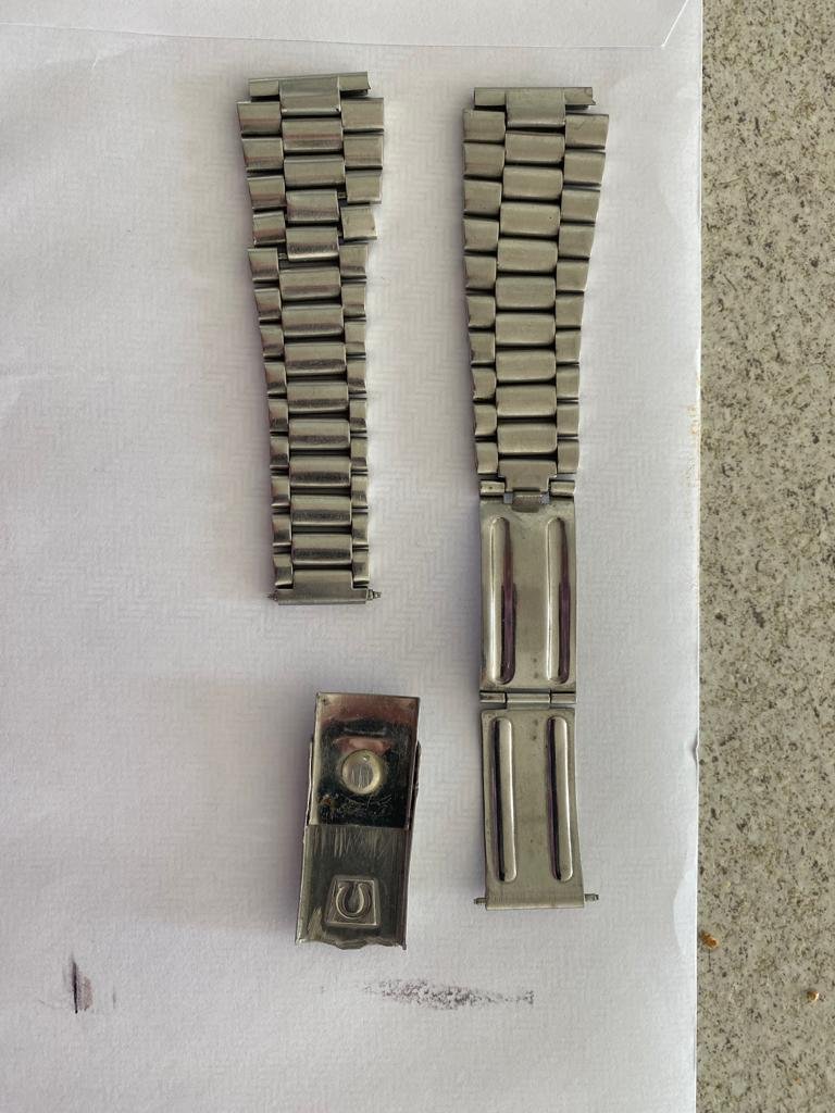

Can we see the other side of bracelet with close up of clasp if any numbers visible? Are the endlinks lost?
Looks like 105.003 Ed White with later replacement bezel need to see inside Caseback

Thanks for the answer I think a modern omega bracelet or a good used original if that’s possible

I’ll try and get some more photos , I think the end links are lost yes ,

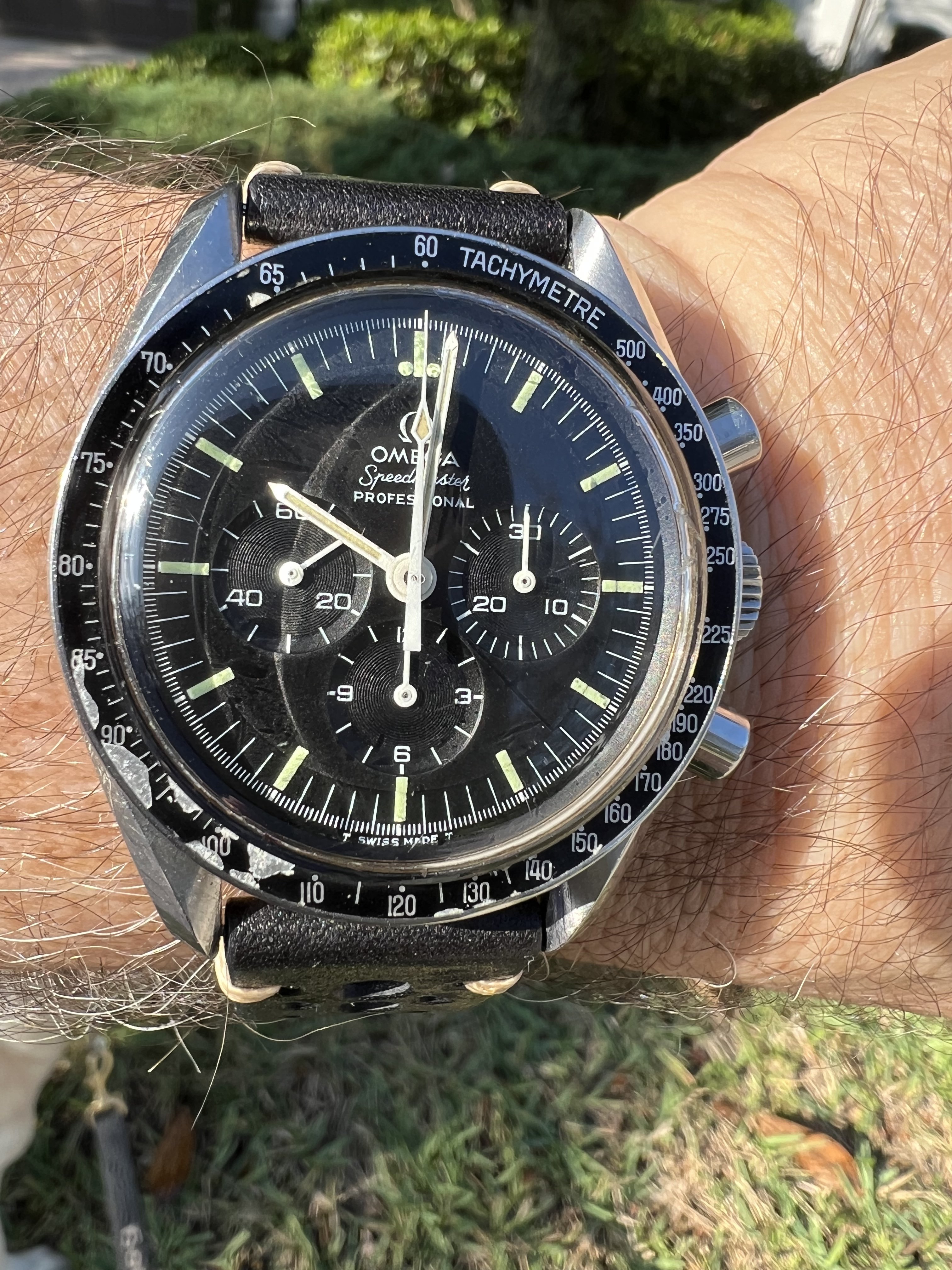

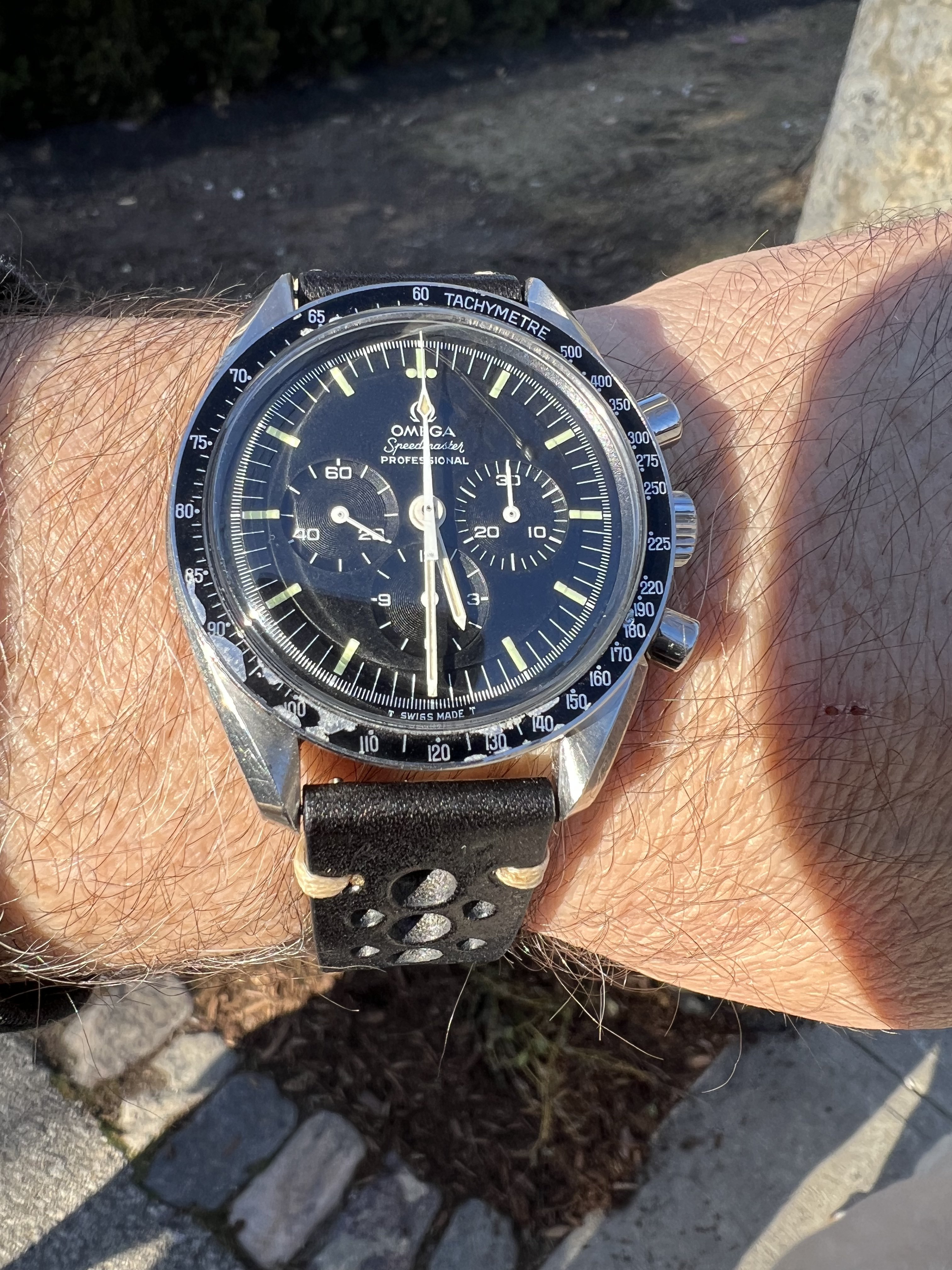

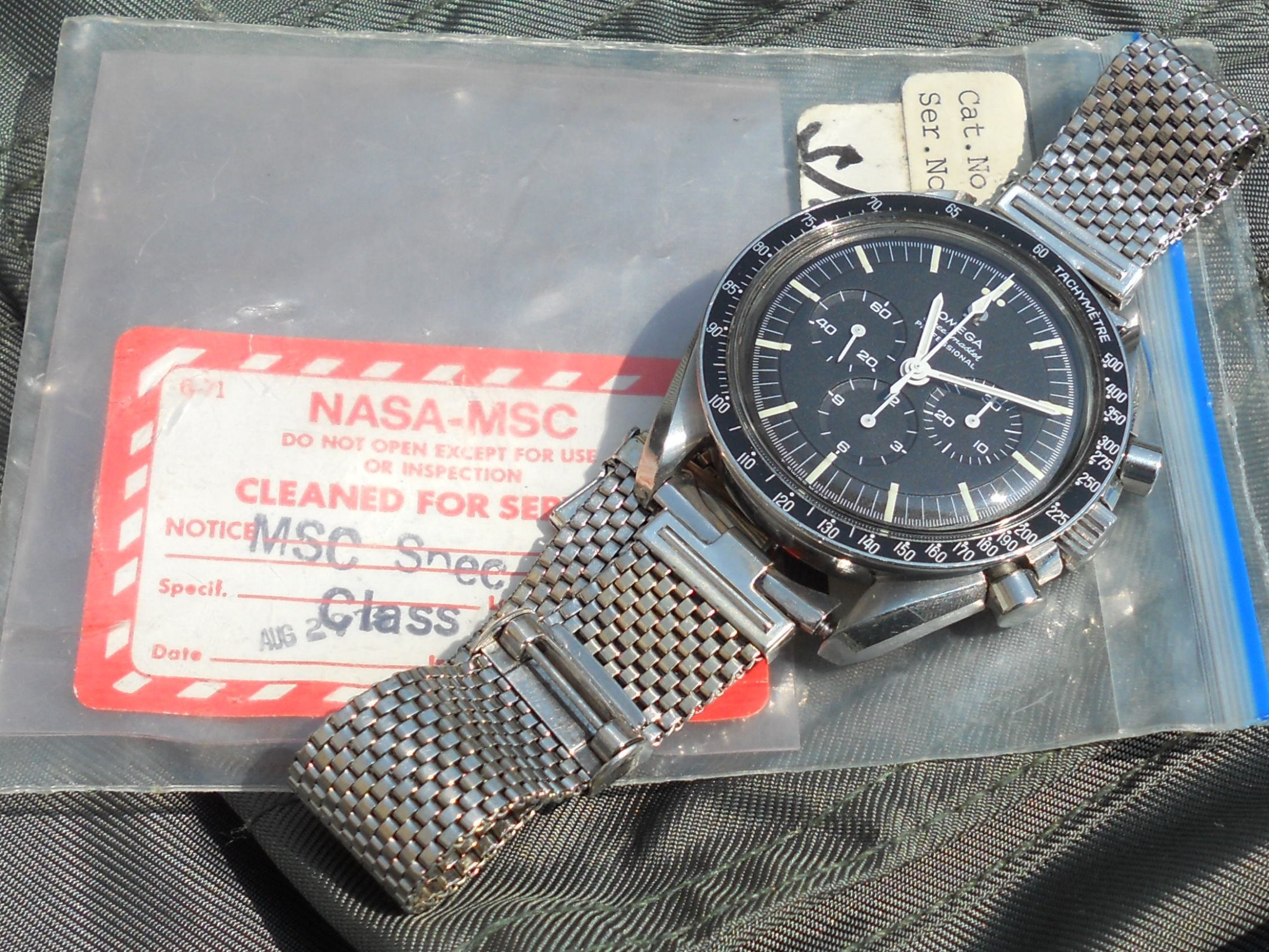

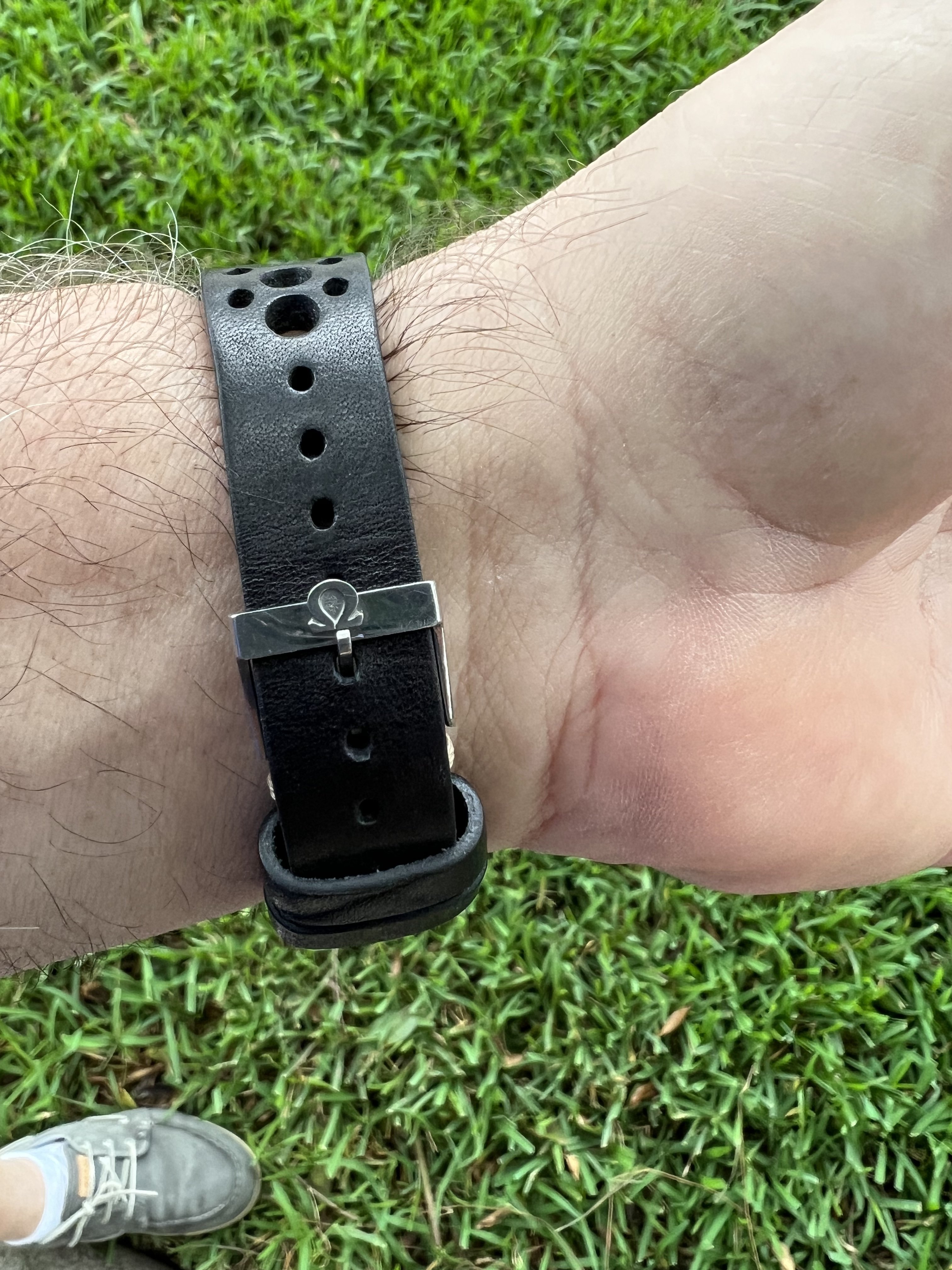

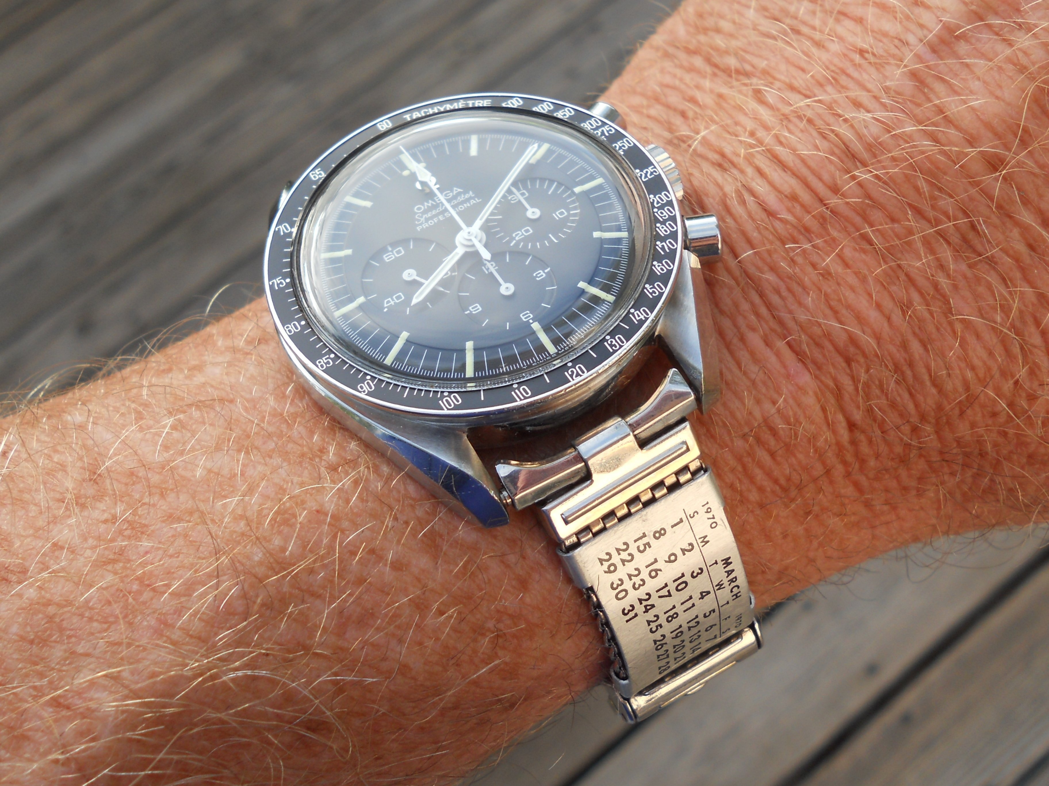

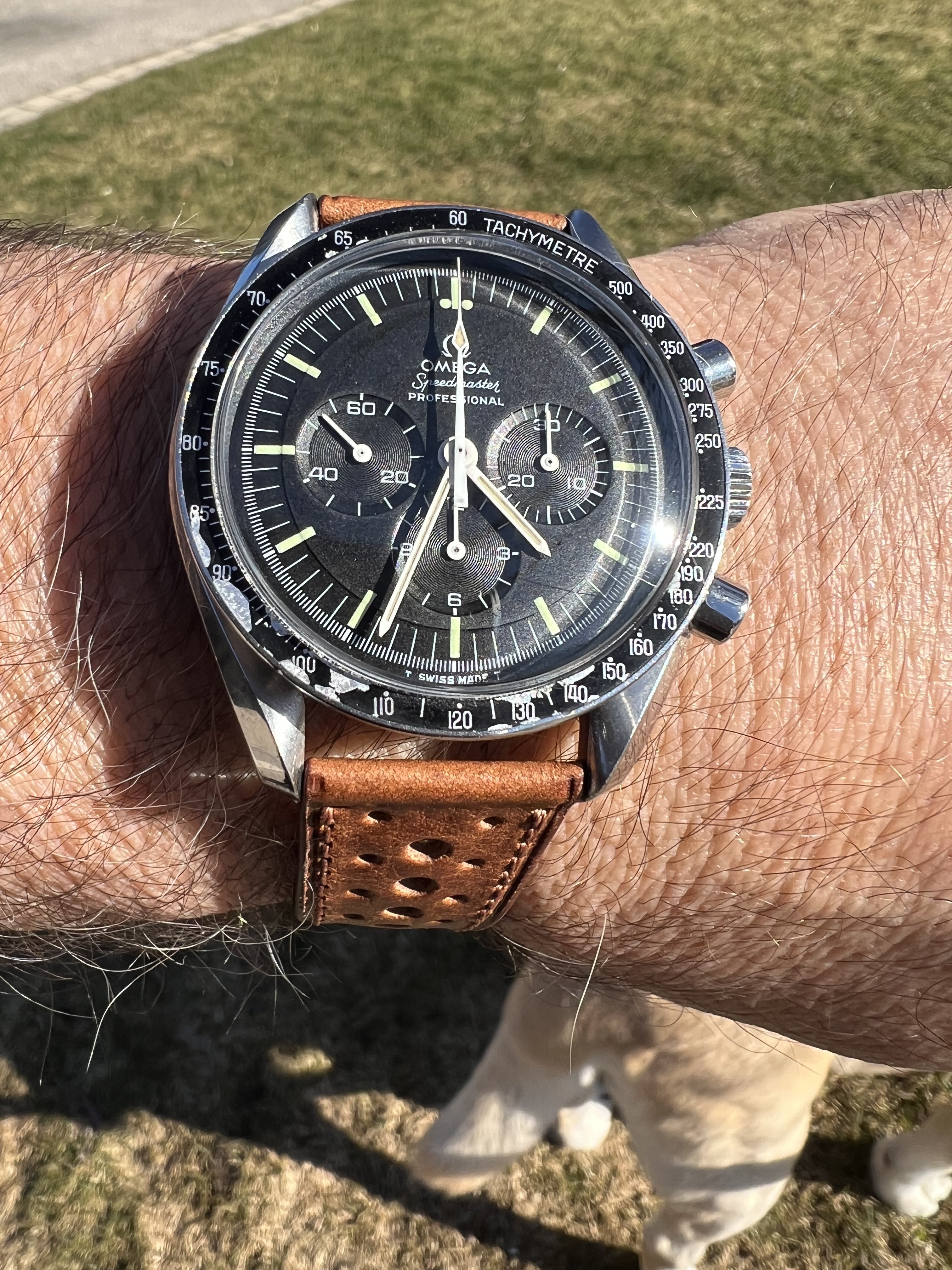

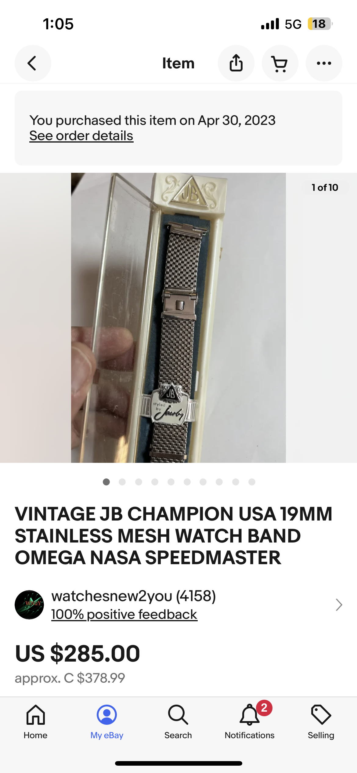

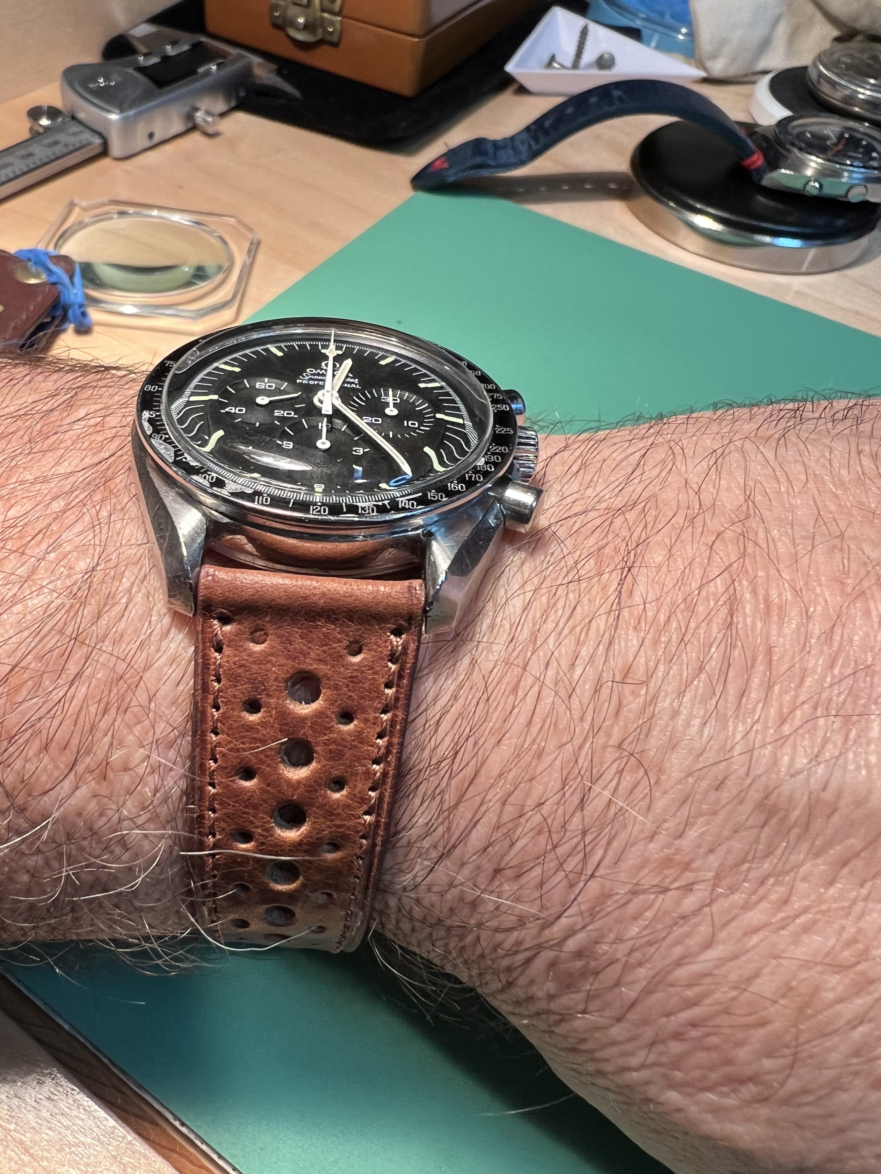

other options include the JB Champion which was actually worn by some astronauts and is much more affordable. The 19mm size works. I just bought one on EB price quite reasonable and you can find the Timely watch calendars from the year and clip them on like astronauts did. See pictures. Also looks good on black or brown rally style strap some pics below. keep us posted with info but lots of choices.

The bracelet you have is an incorrect replacement. The original band is either a 7912 with 6 Endlinks or a 1035 with 506 Endlinks. Both are expensive.
The modern Omega service item is 1125 but it won’t look right with that watch imo.

One more thought - notwithstanding @Davidt comment that existing bracelet is not correct for Watch, if you wanted to go the least expensive route and Dad doesn’t require period correct option for big you might be able to find modern Omega endlinks for the bracelet you have, would need bracelet number on clasp end and ask Omega dealer to look up if available. I did that with endlinks for another bracelet and they were fine and cost $48 each. but the Forstner is nice and fun you can find the little calendars on EB now and then
