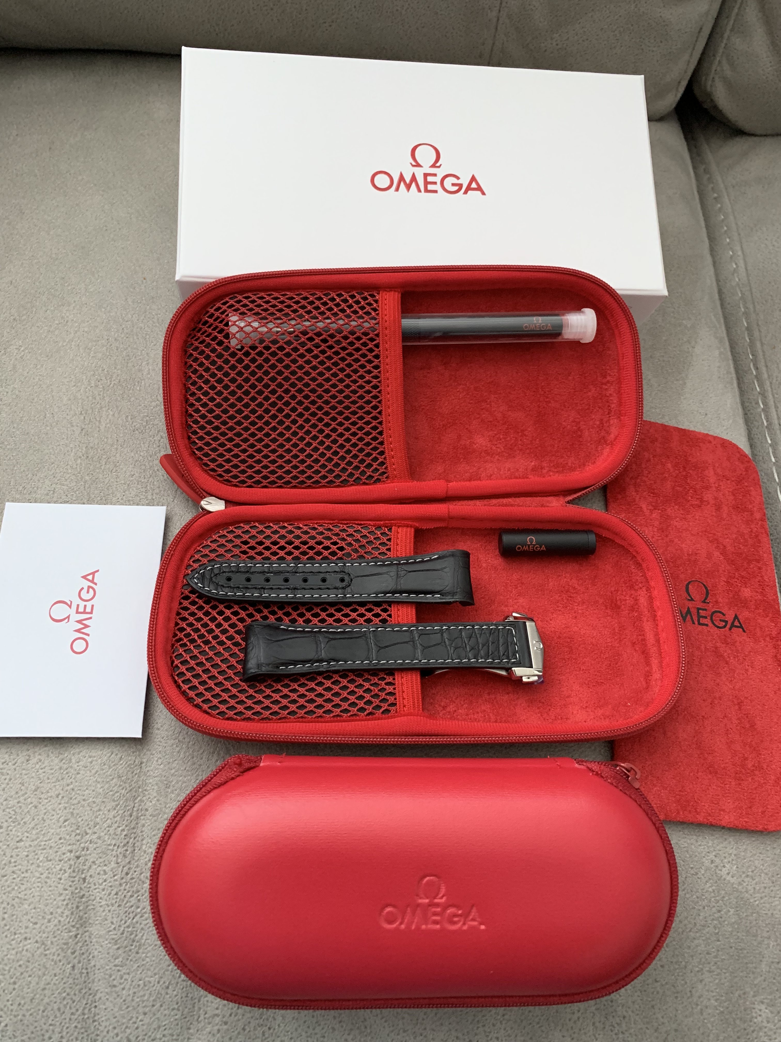

This is what I was given from my Boutique when I bought my alligator/rubber strap with deployant.
I keep my spring bar pliers in the case now also.
Much better tool than the Omega tool provided.

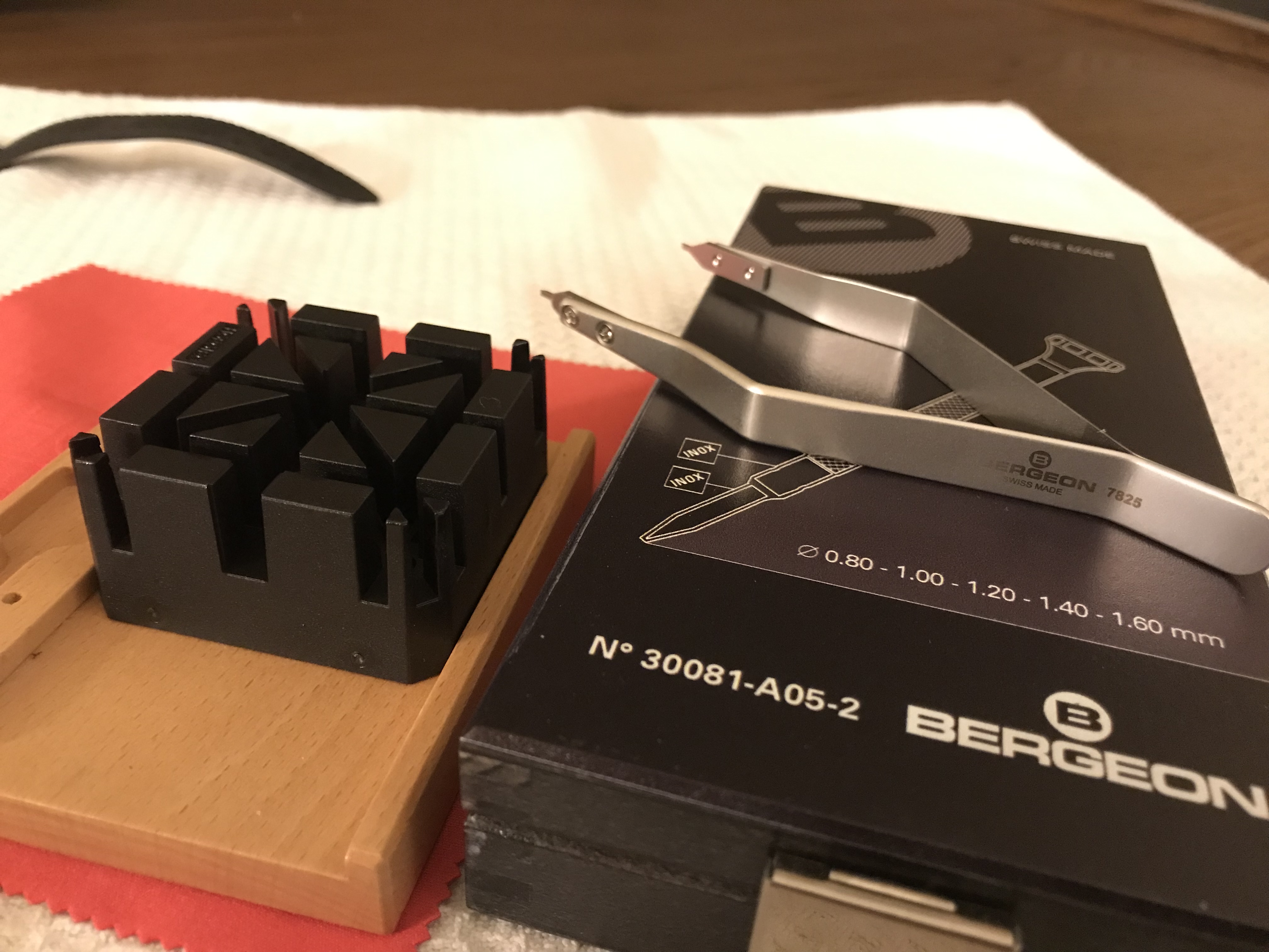

I like the Bergeon 7825. Actually using it right now

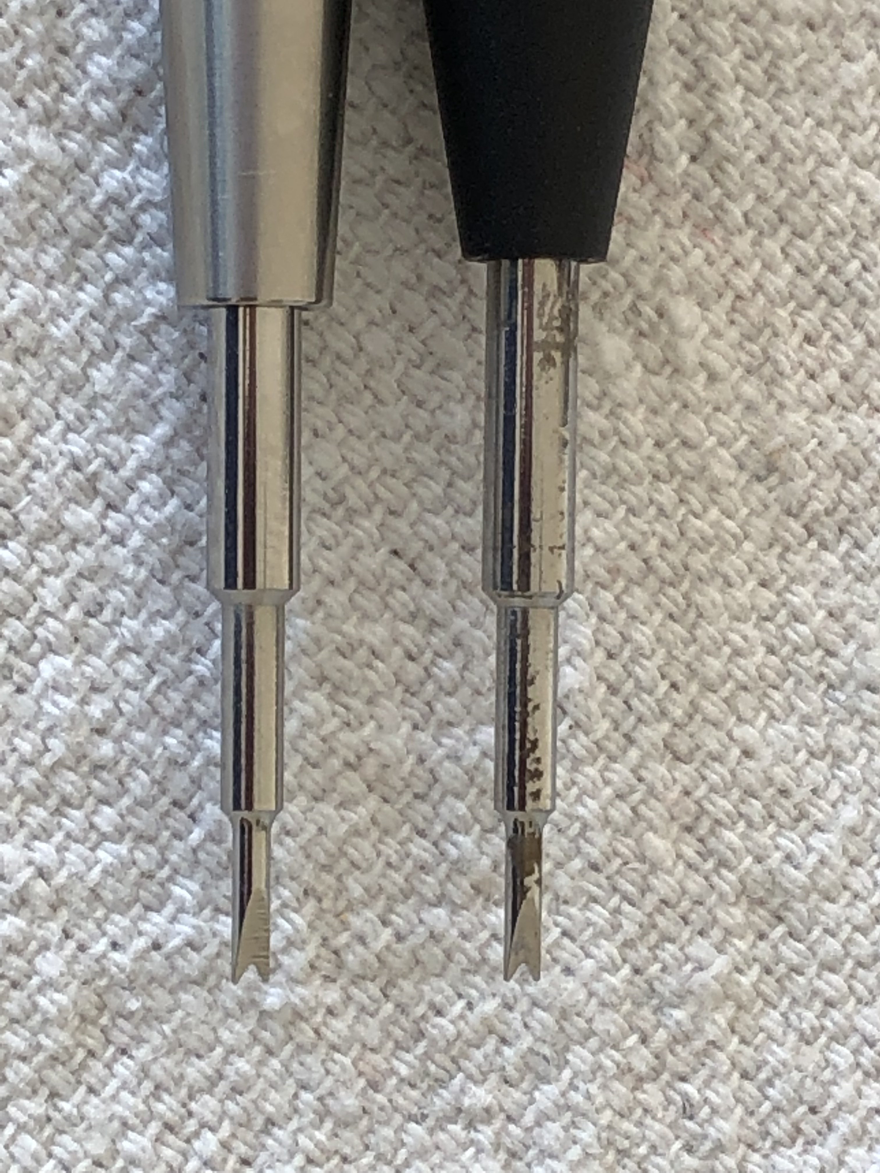

I have successfully removed and replaced the bracelet on my Speedmaster with the Omega supplied tool with no scratches. Today I borrowed a friends Bergeon 6767-F to try. It was so much easier to use, didn’t slip off the springbar once. Here’s a macro shot of the business end of both, Bergeon on the left. Surprised at the pitting on the Omega tool, supplied with my watch purchase this past April. I will be buying a Bergeon now.

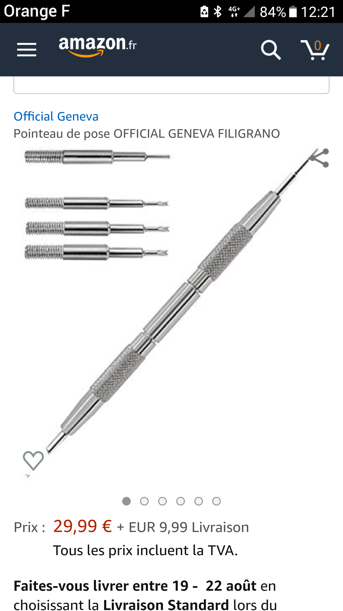

Hello, I'm also a beginner, and I use this tool, great to remove bracelets according to me, not so expensive... If it can help...
